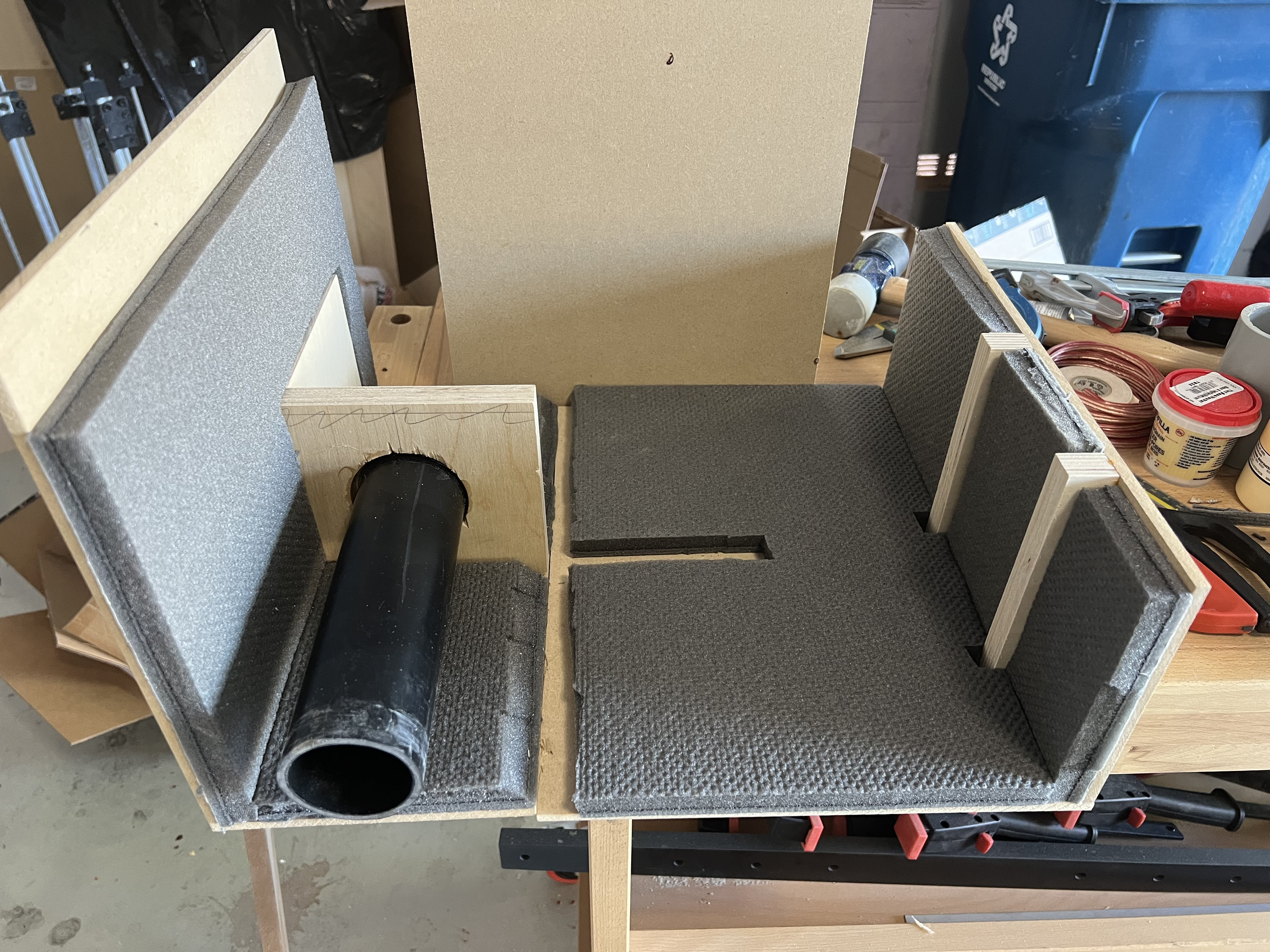

    I made a little progress yesterday. First got some foam installed. It's not shown, but I ended up using a staple gun as well. I was a bit worried it would penetrate the 1/4" MDF, and in some cases it did, but only barely so.

    Next up was placing the crossovers with Velcro. I had hoped I would be able to remove the crossovers from the Velcro and install them later, but once detached the Velcro barely seems to hold. So I decided we'll just close everything up starting now.

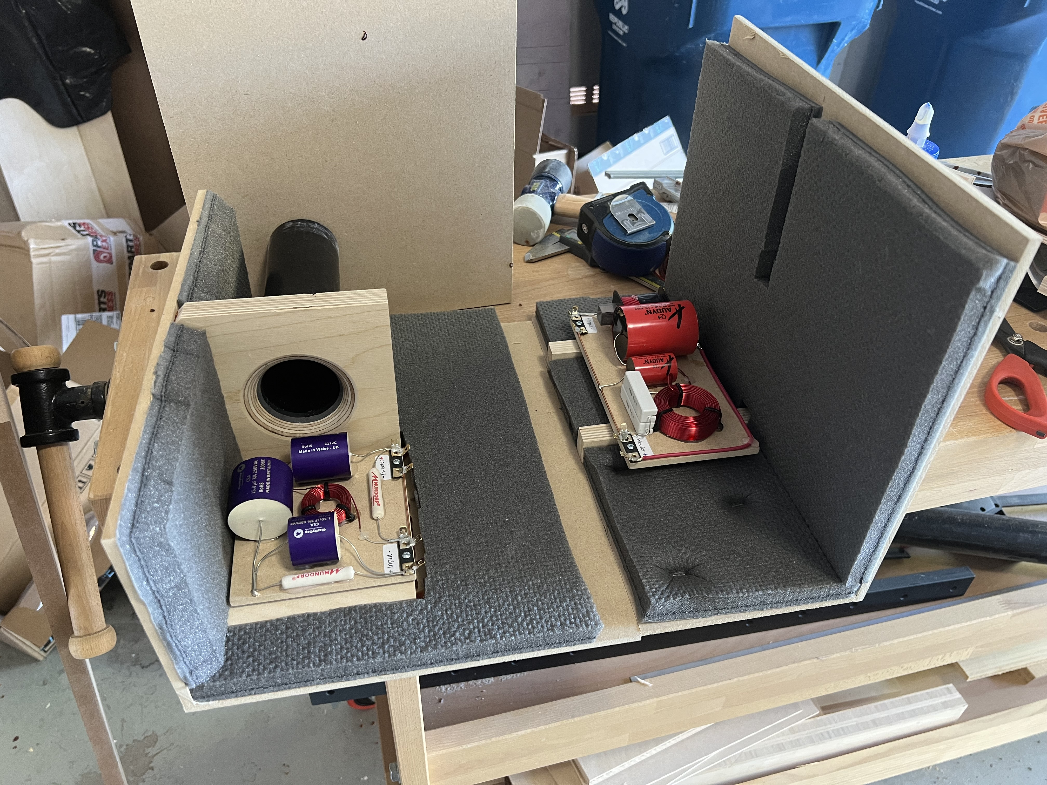

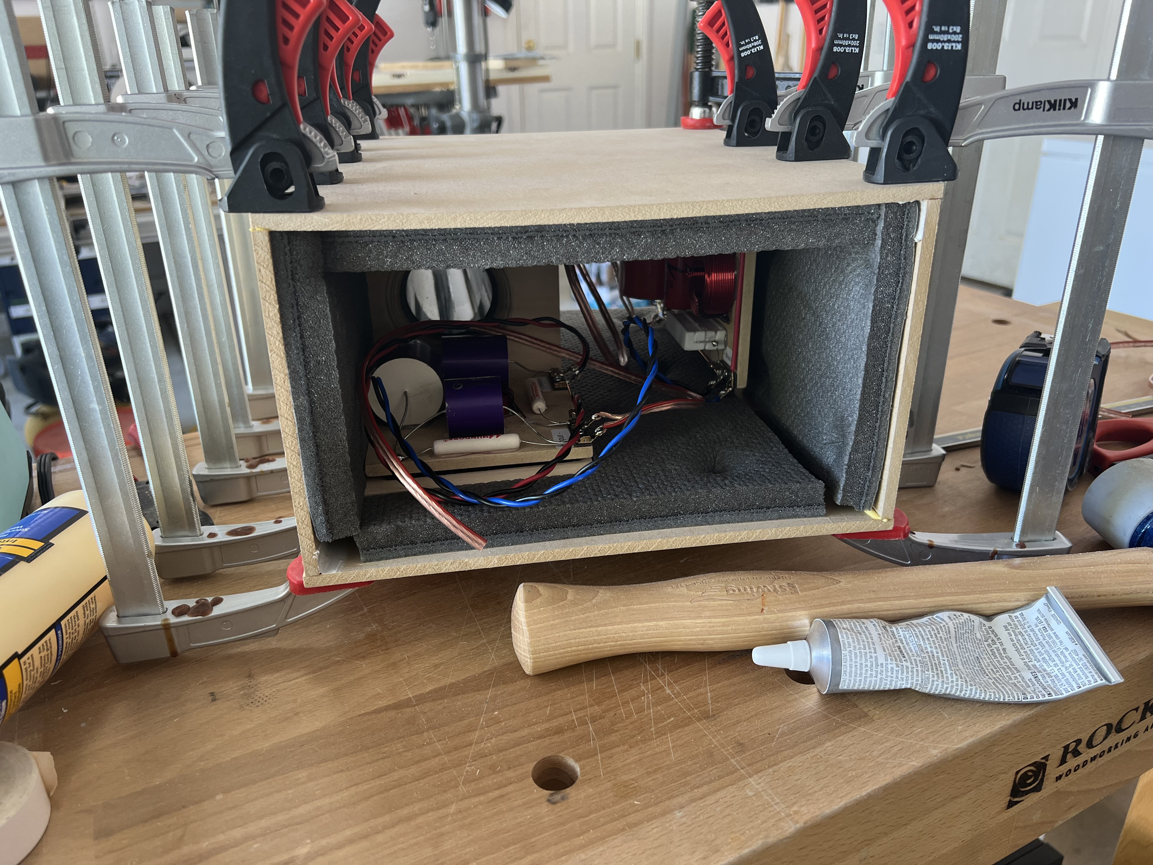

    I wired up the crossovers and went the extra mile to solder them this time. On the Overnight Sensations I just used terminals, then placed a dab of ht glue on them to keep them from moving. I wish I had soldered them now but whatever, they should be okay.
    Once wired up I glued the speaker halves together.

    So here they are at the end of the day, just waiting for the glue to fully set. They're already pretty beefy, despite the 1/4" MDF. You might note I also cut out the terminal hole in the bamboo at some point yesterday as well, though I don't have a picture of it.

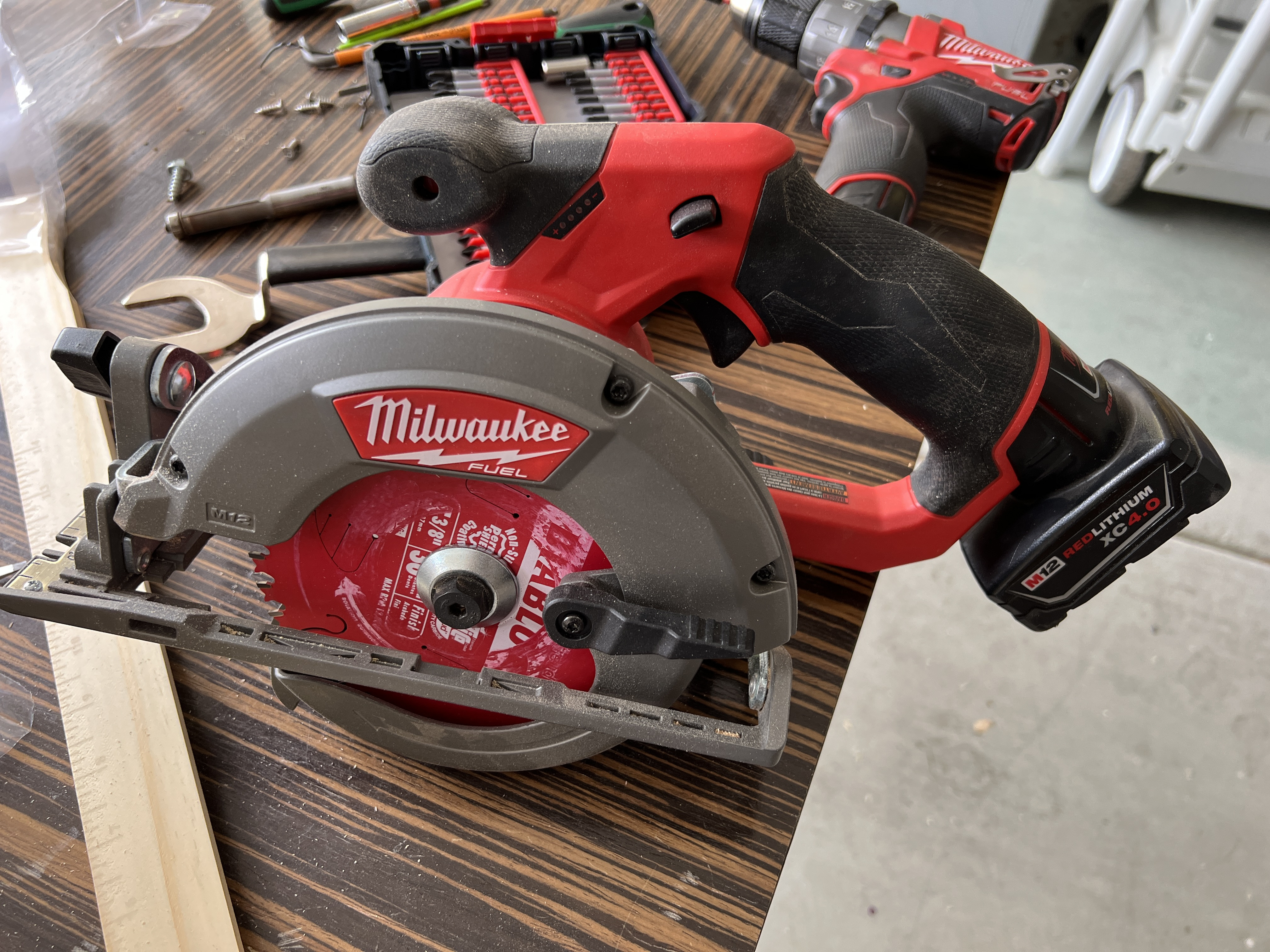

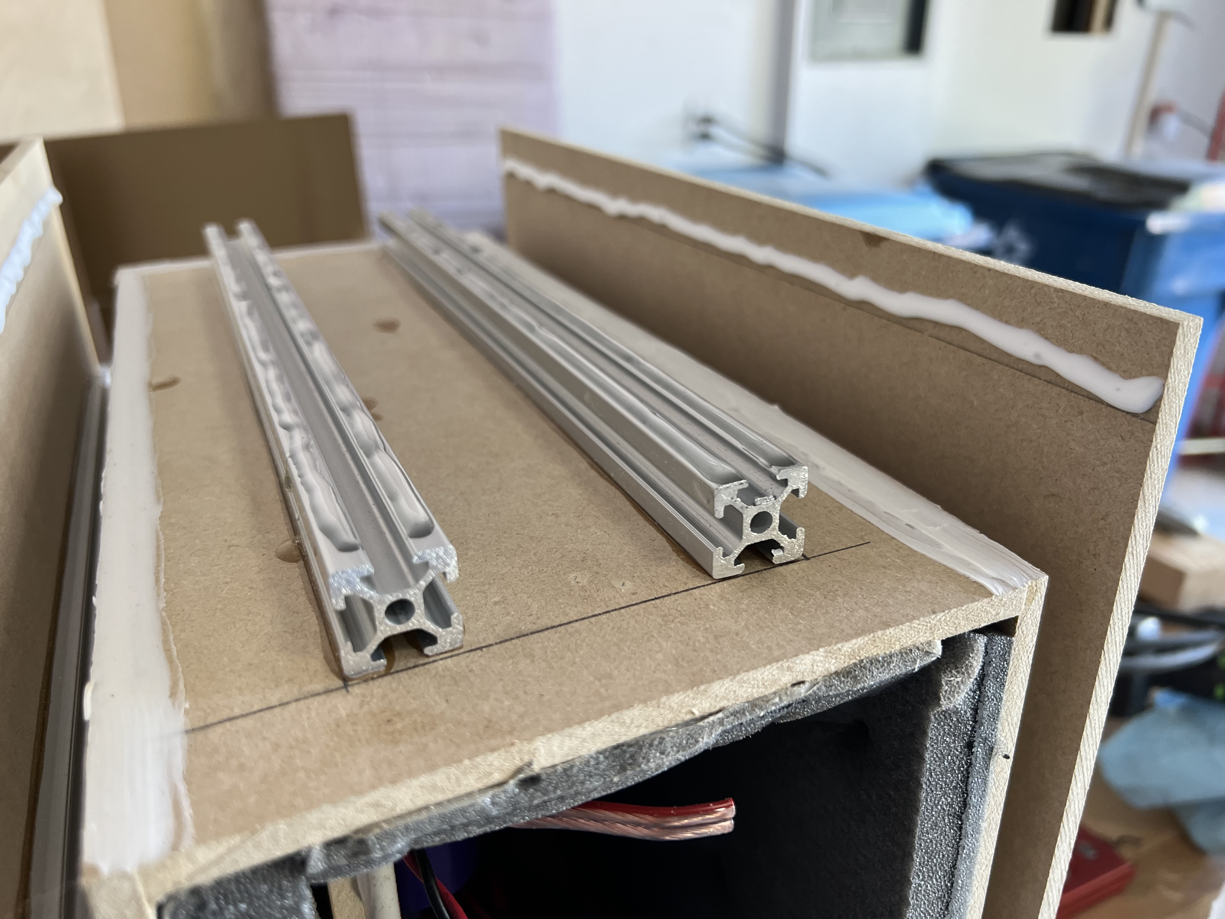

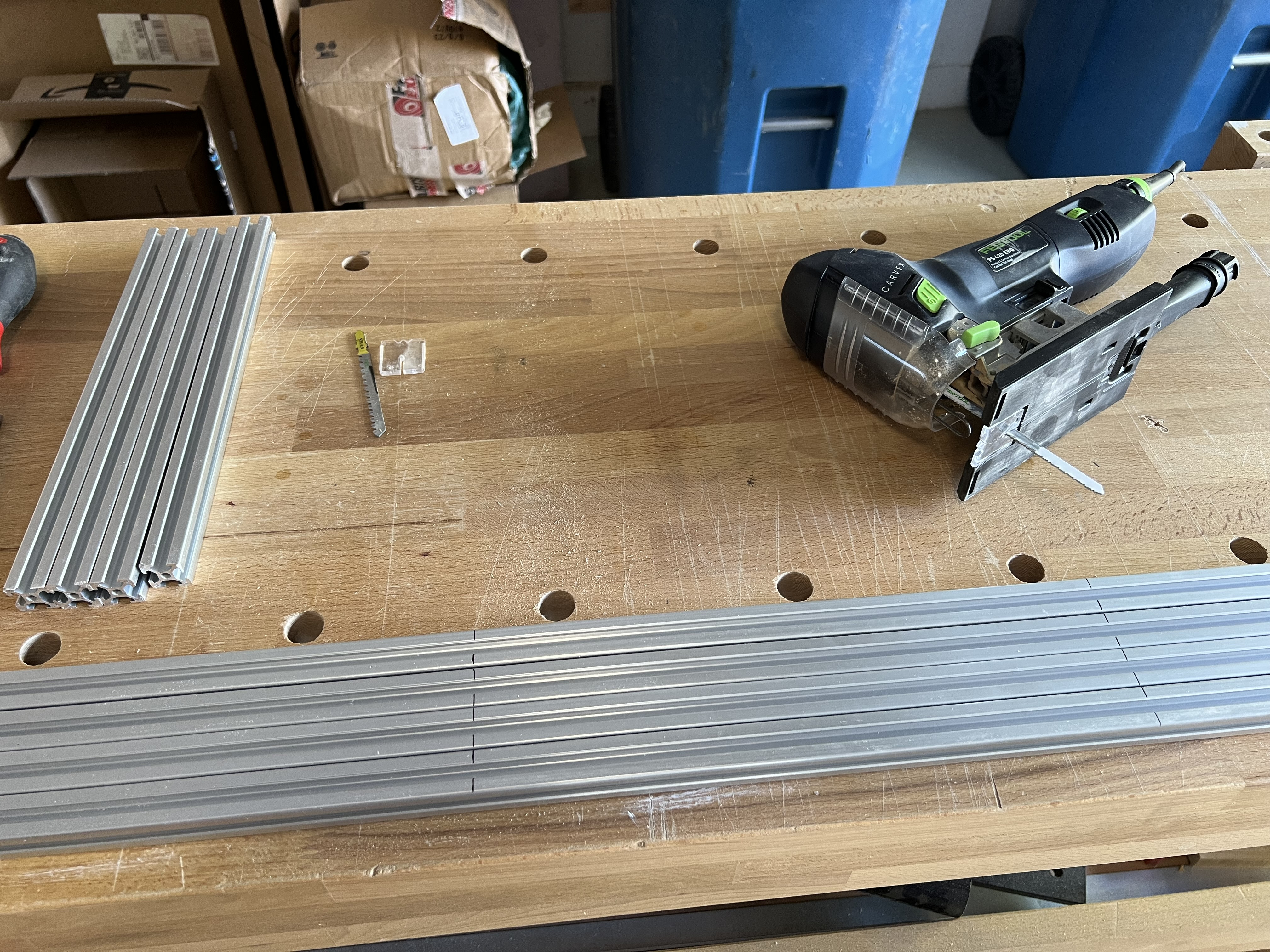

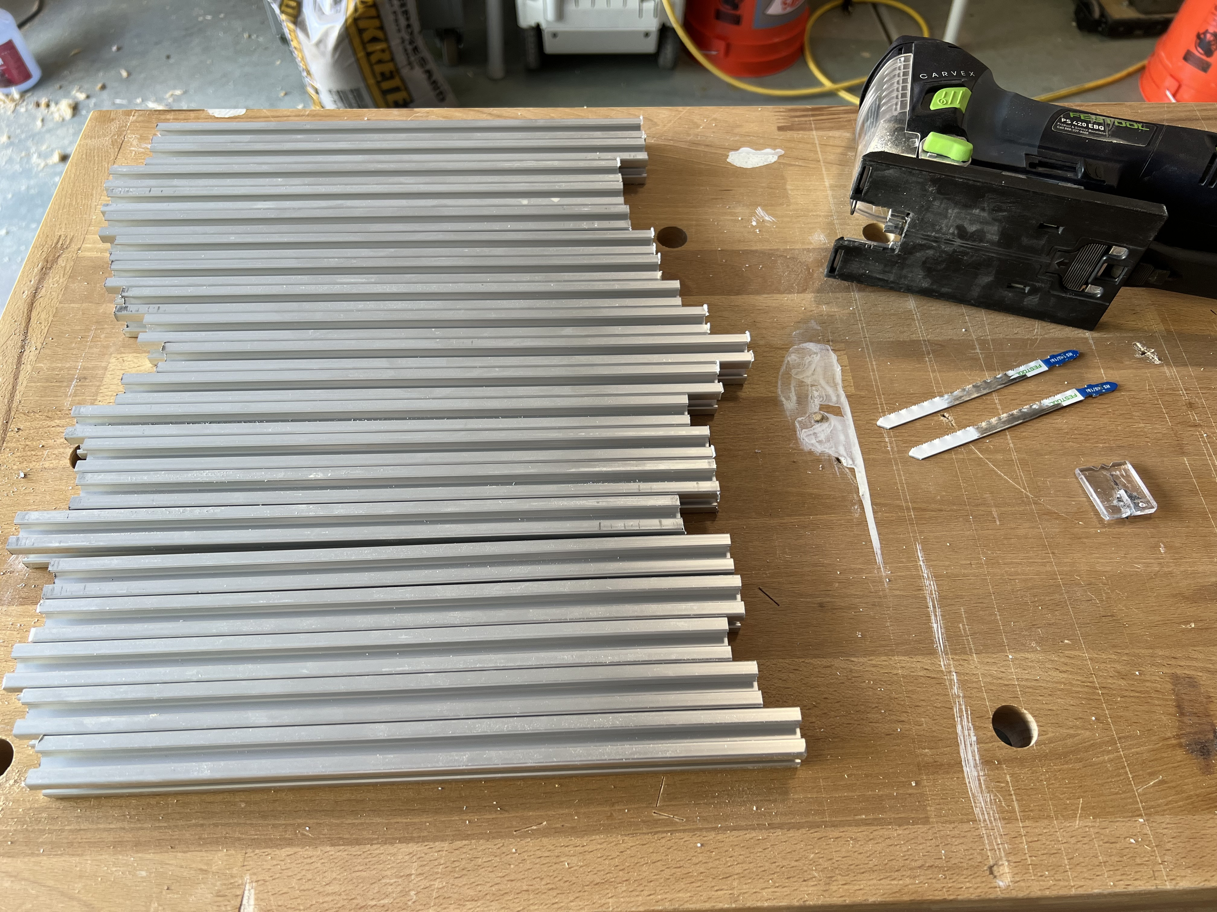

      So today I started work on the 2020 aluminum. I received a few jigsaw blades for metal in the mail recently and was anxious to try them out. The first couple cuts went okay, but I probably should have been using some cutting fluid to keep things cooler - one of the blades warped. Managed to only use two to do all 20 pieces though.
      Click image for larger version  Name:	IMG-0567.jpg Views:	0 Size:	3.46 MB ID:	944825
      Click image for larger version  Name:	IMG-0568.jpg Views:	0 Size:	3.17 MB ID:	944826
      I cleaned up the edges a bit with the sander - those later cuts were pretty rough. Likewise, I cleaned up the glue, routed the edges, and rough sanded the MDF on the speaker boxes. Then I used some JB Weld epoxy to glue the first six aluminum rods to the speakers.

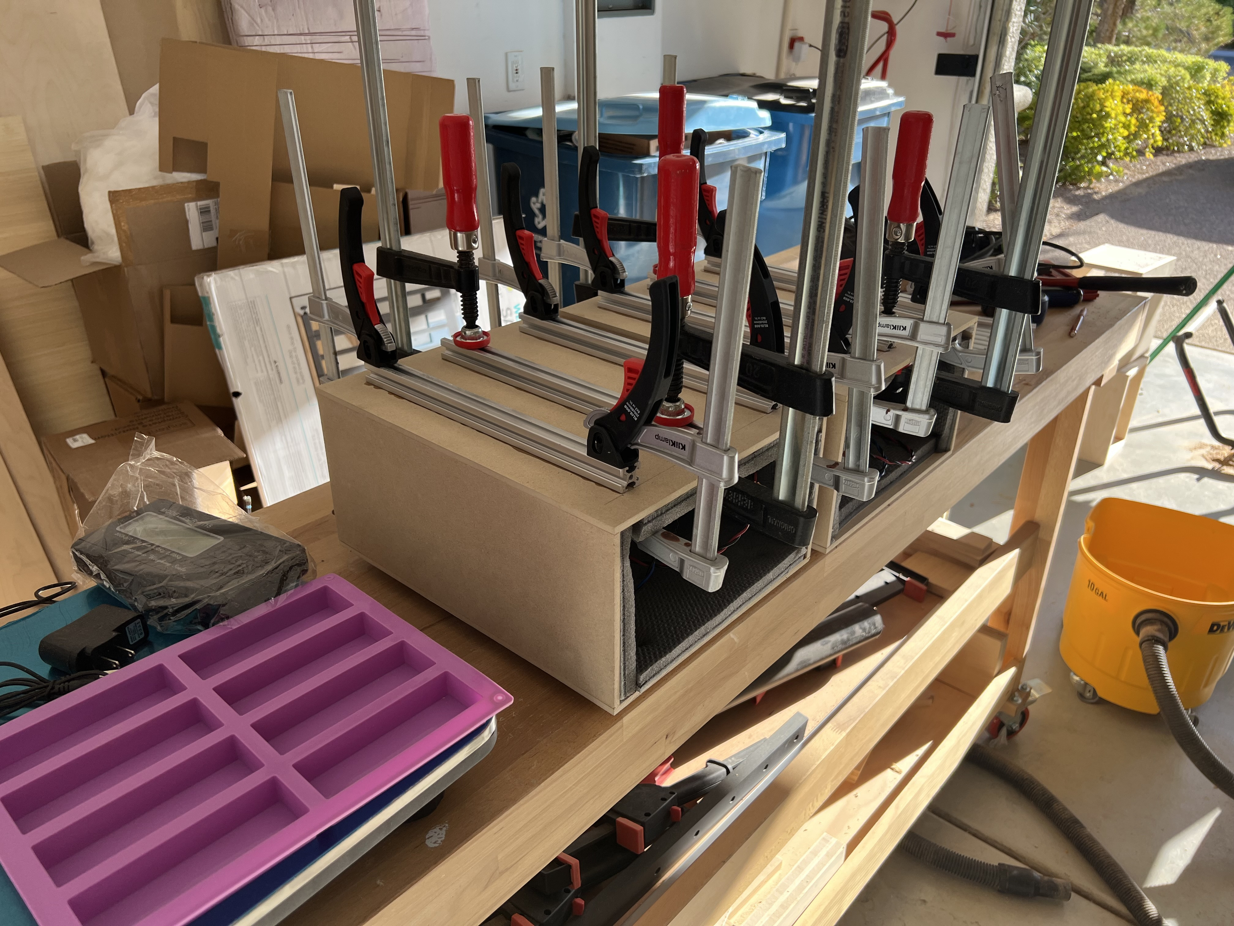

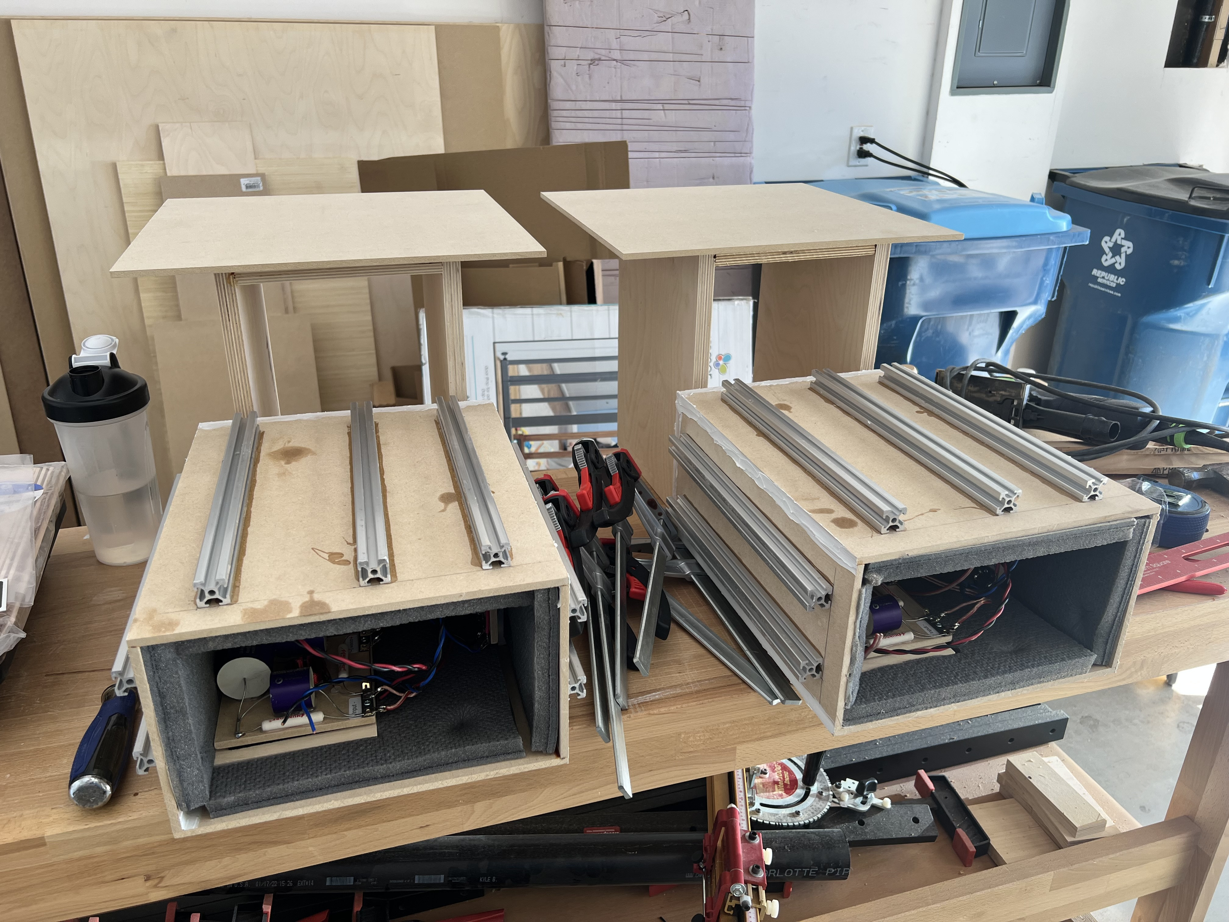

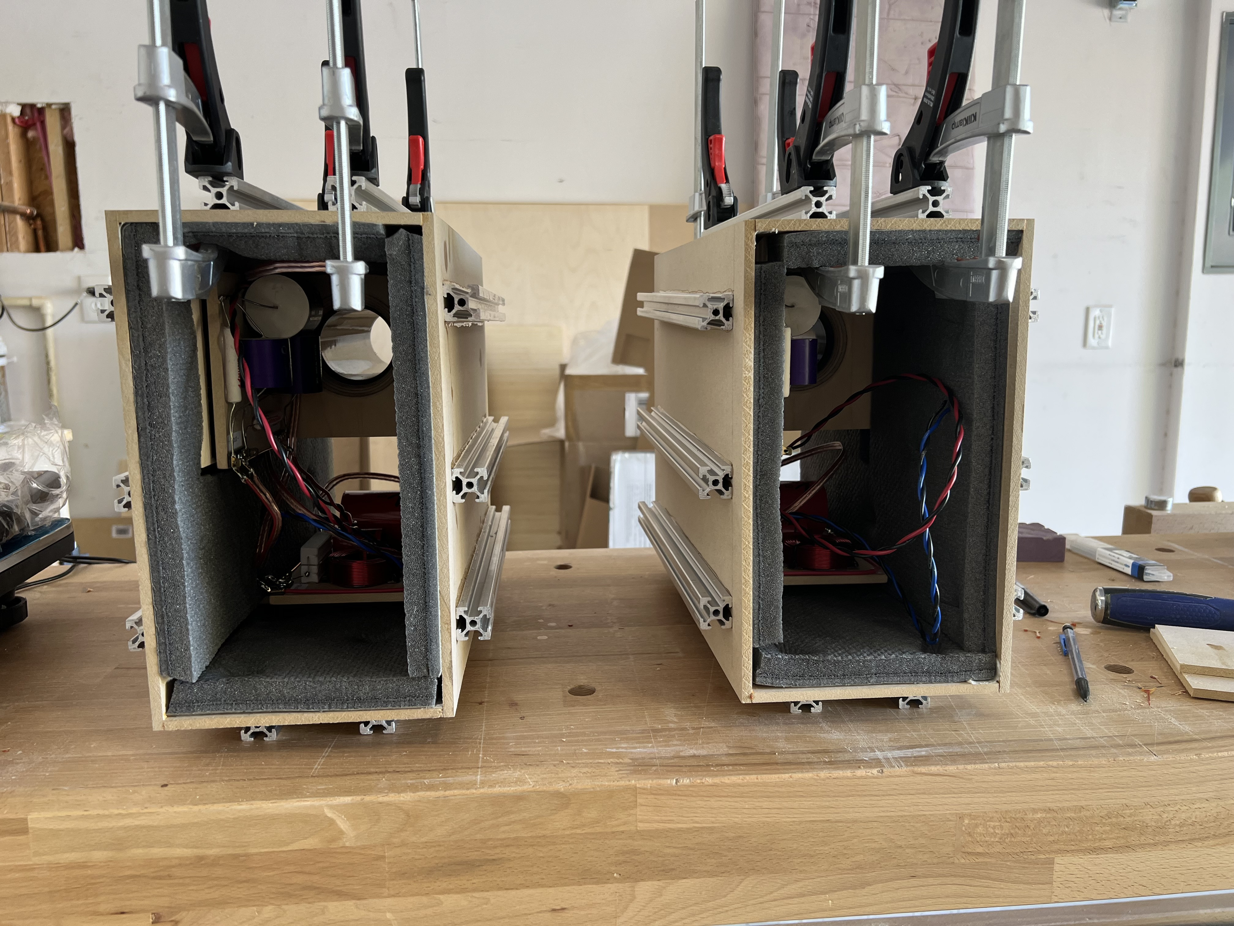

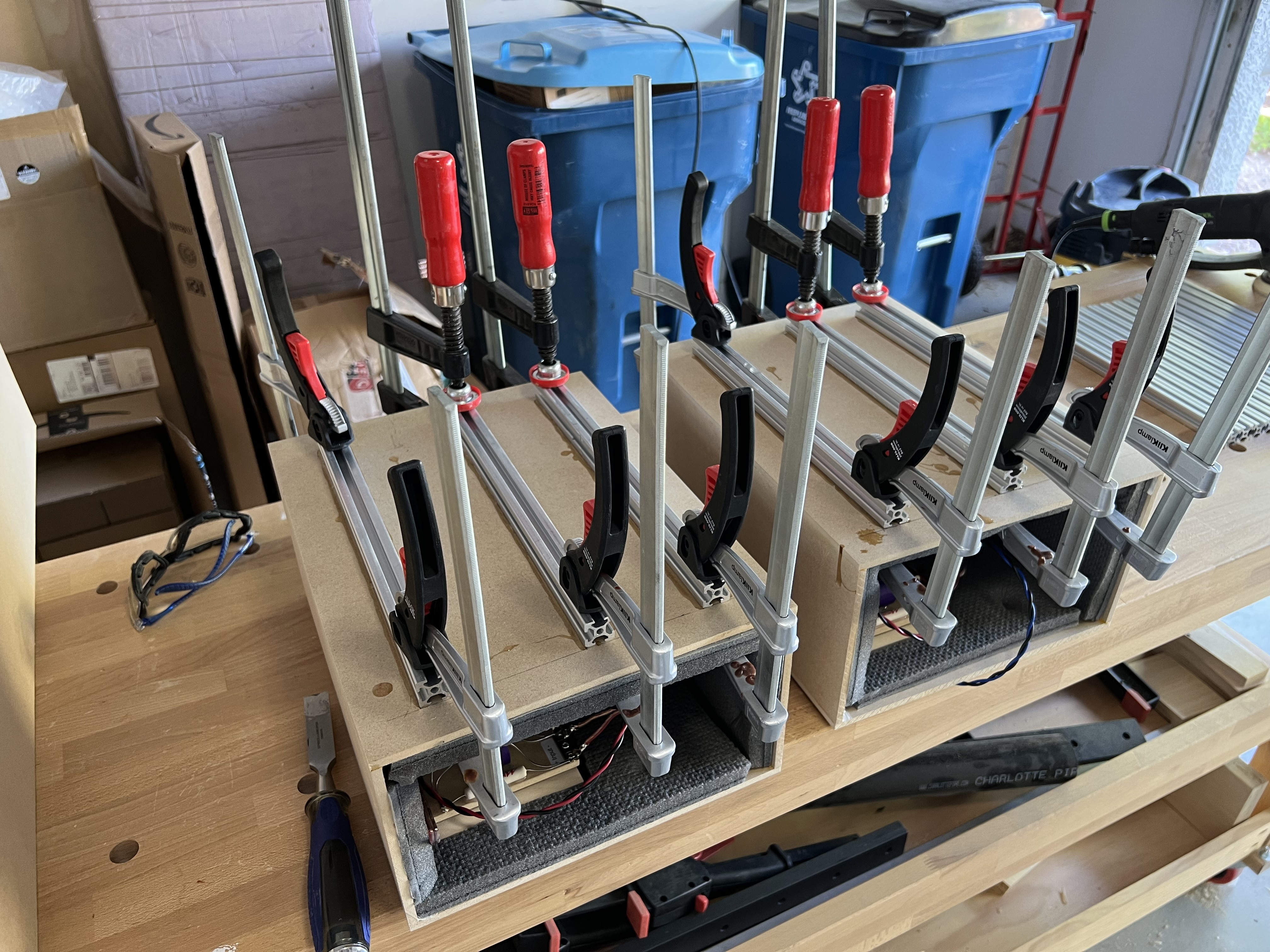

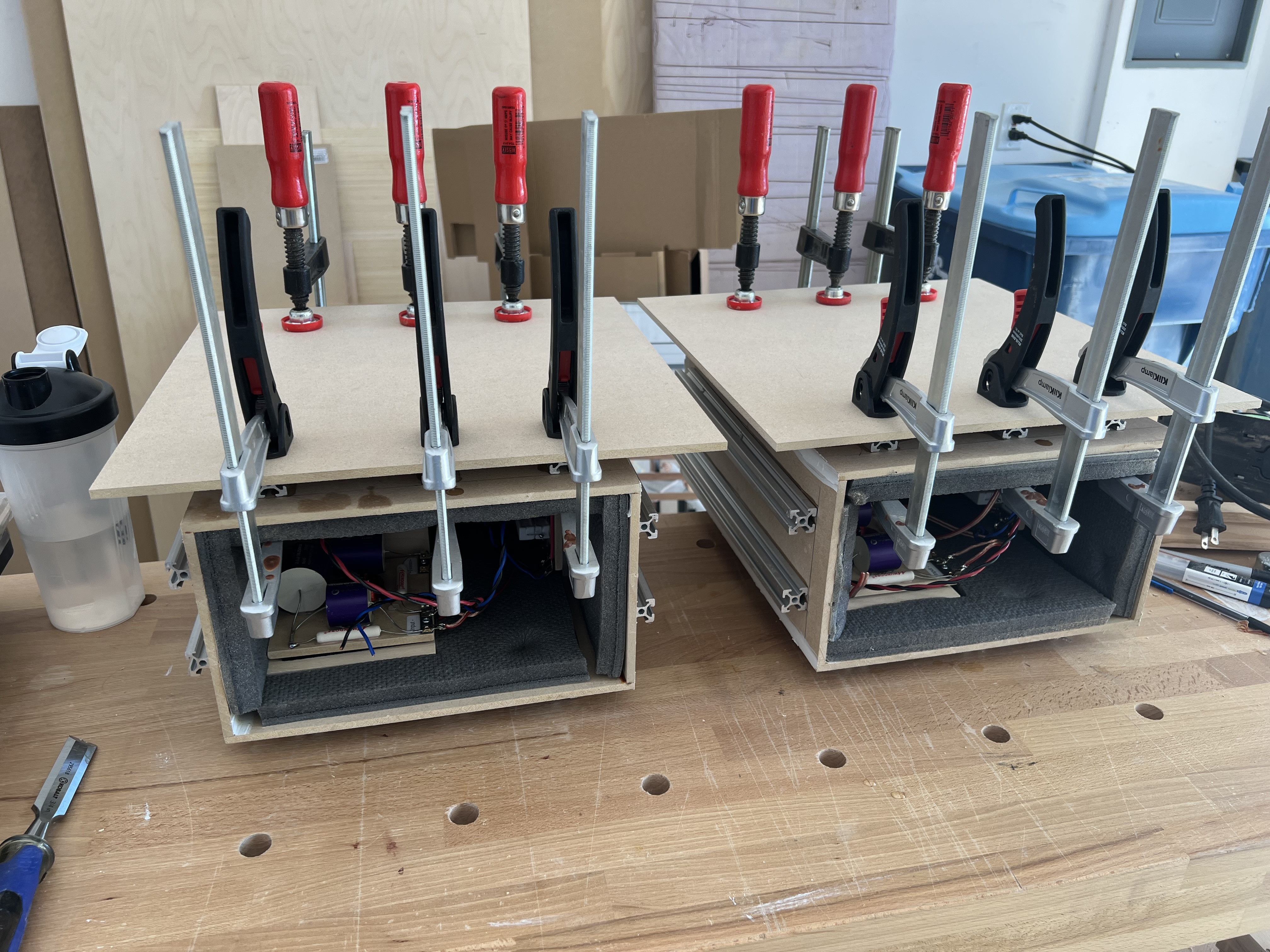

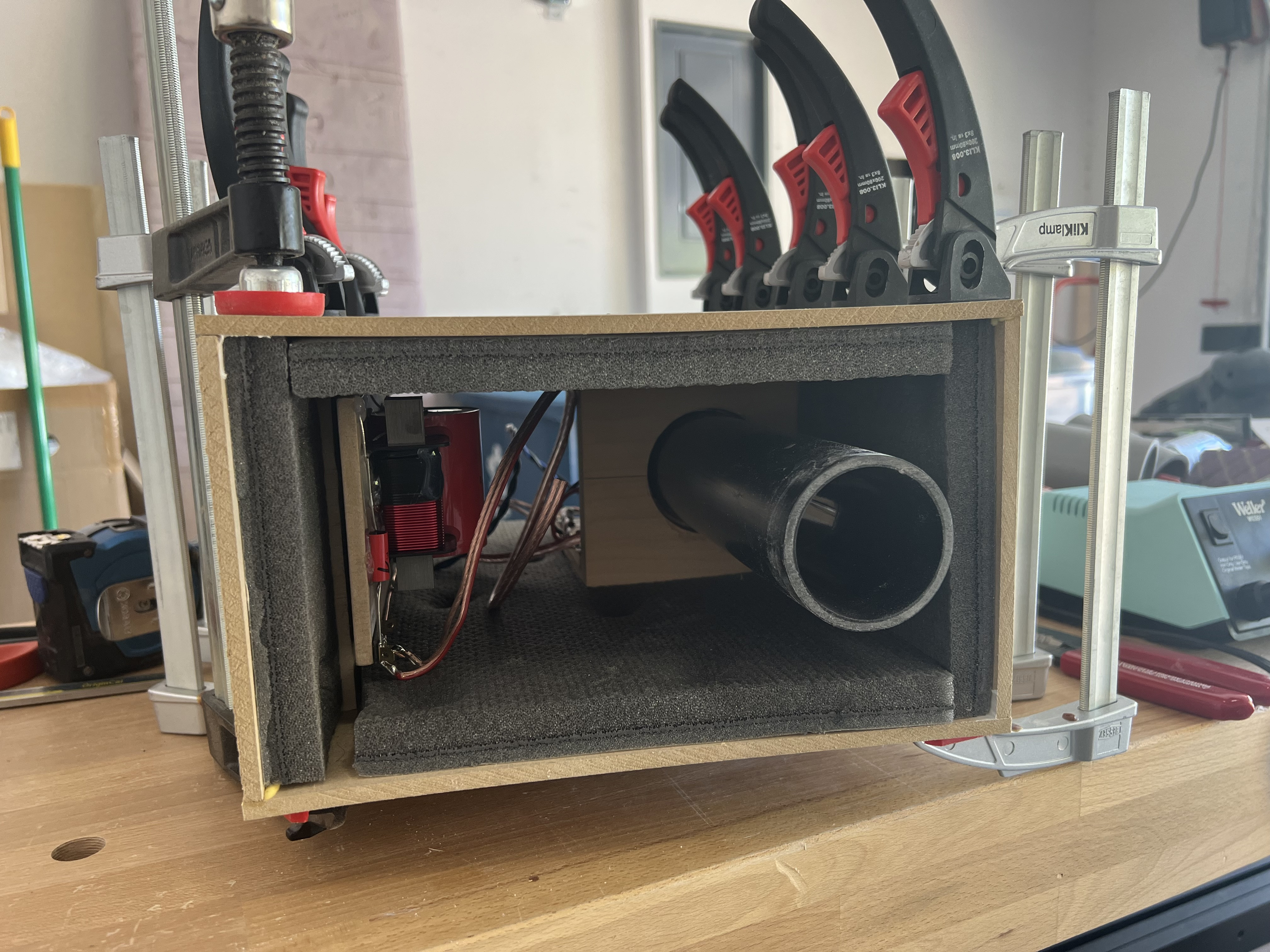

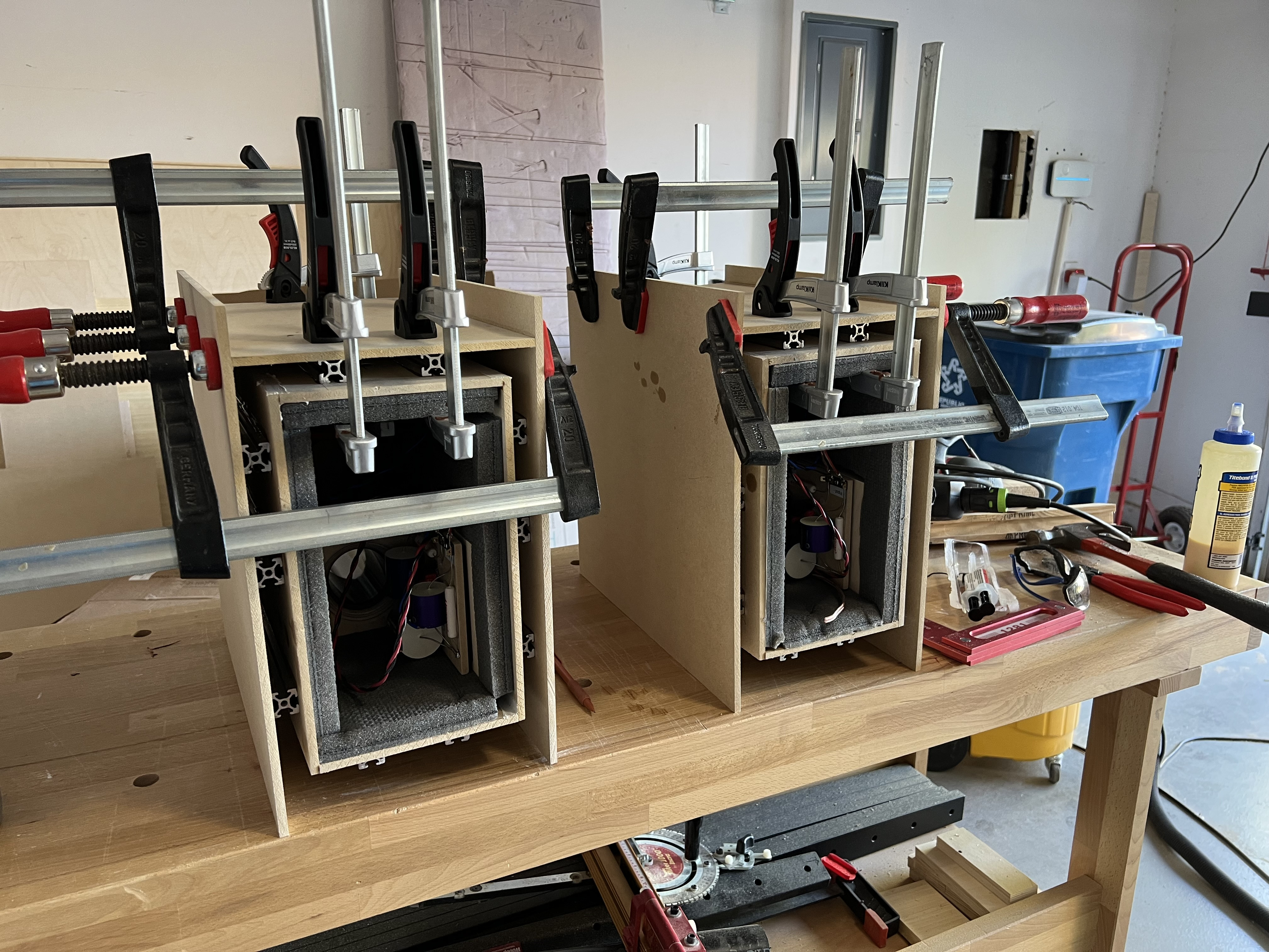

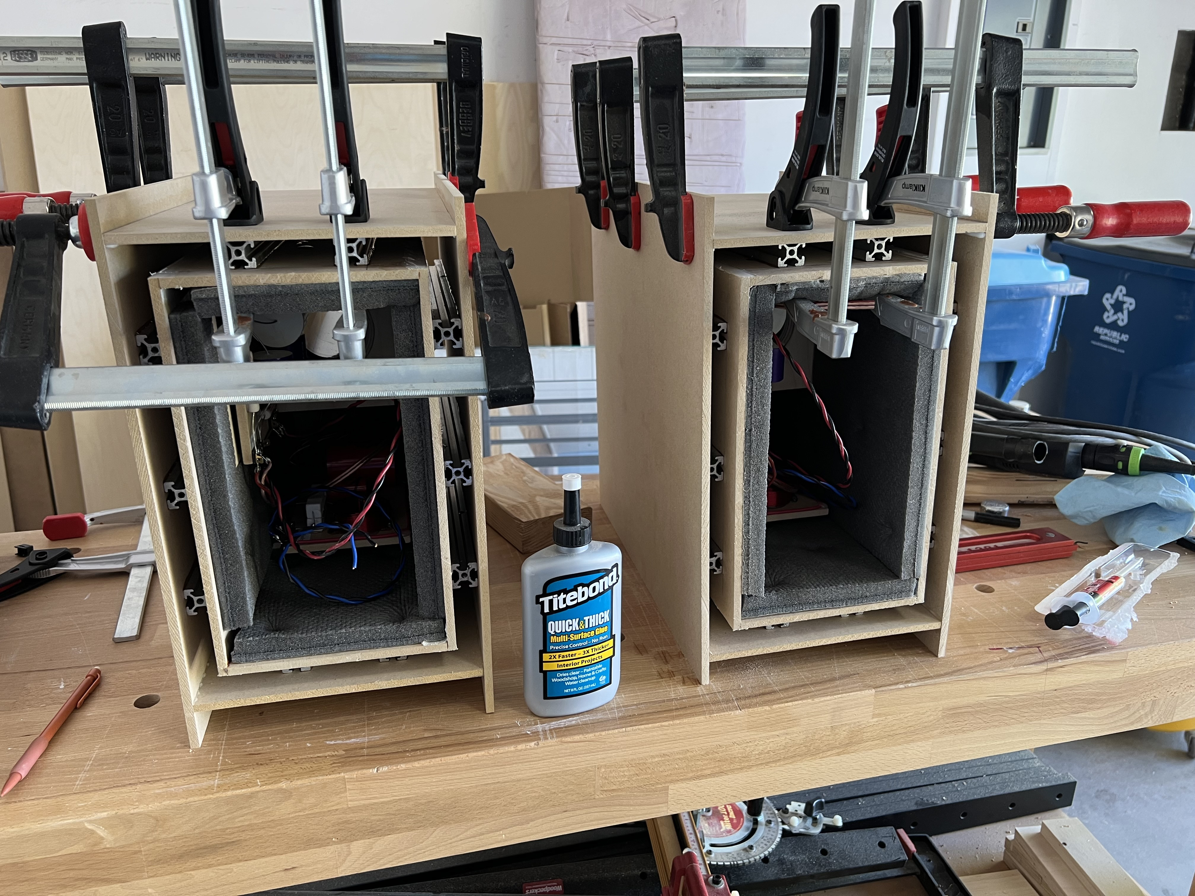

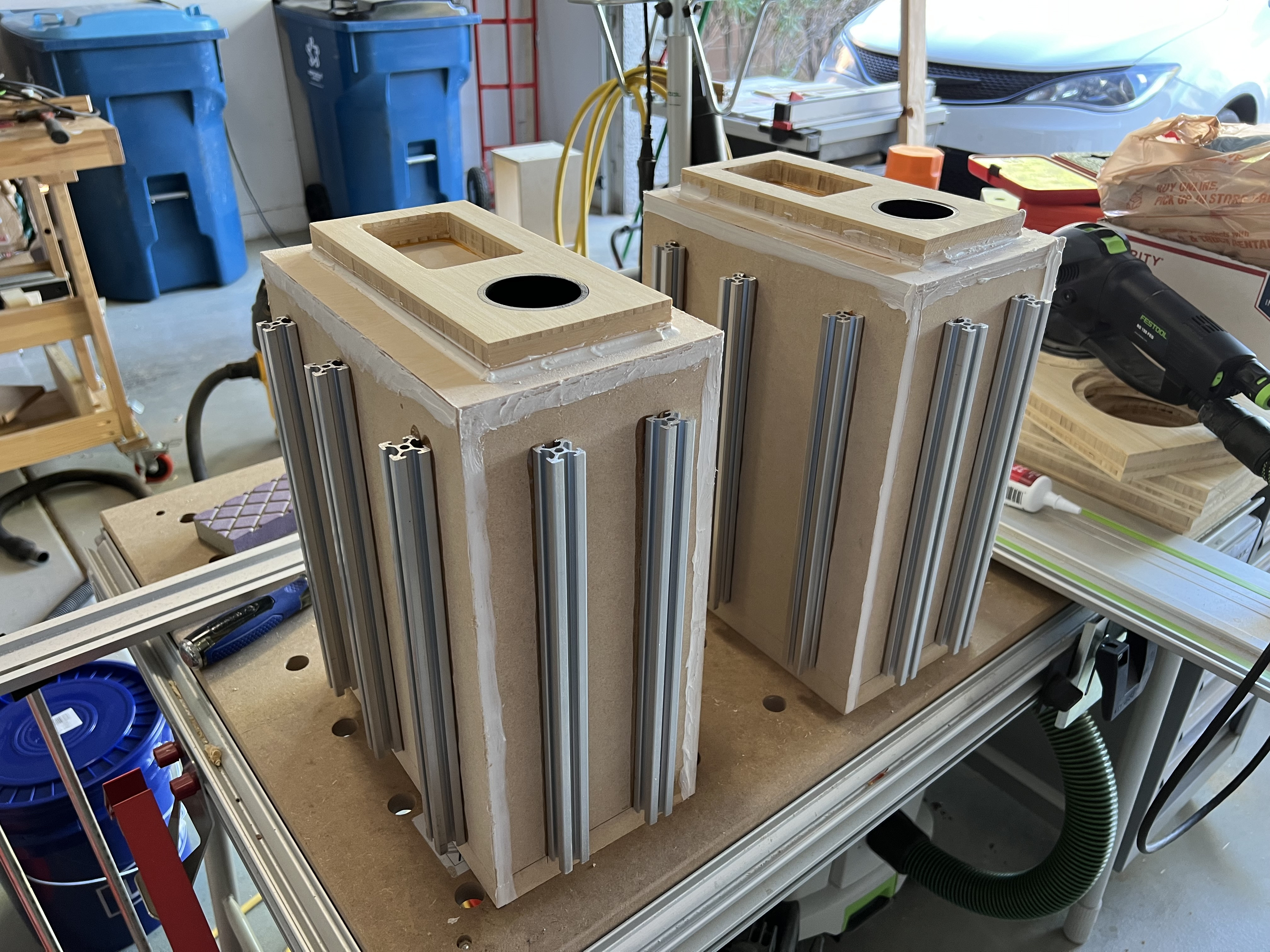

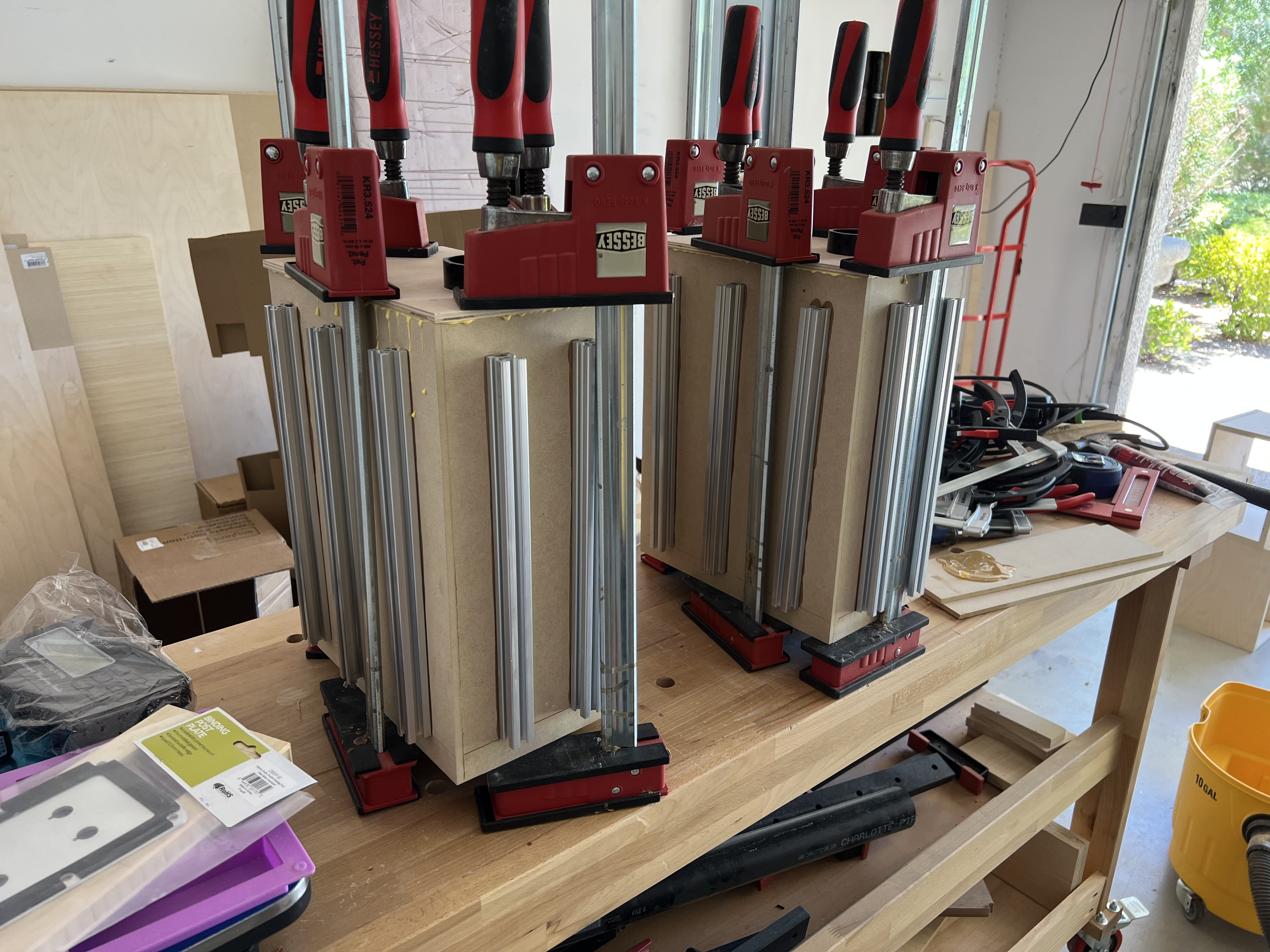

          Took a short break from work today to epoxy the last few aluminum ribs to the boxes. This process went pretty well overall, though using the small double tubes of JB Weld was probably about the least cost-effective way of doing it since I wasted at least a full tube. Oh well.
          Click image for larger version  Name:	IMG-0580.jpg Views:	7 Size:	2.80 MB ID:	944945
          I also discovered that at least one box is out of square, as xandresen predicted for a CLD-style enclosure made of 1/4" material. It's not bad enough that I'll try to do something about it, maybe 1/32", but it is bad enough I may use three feet for each speaker when wrapping these up. Of course, I don't know how I'll do that since you can't easily drill a hole in polymer concrete. Maybe more epoxy, I guess. I kind of wish I had planned on using 1/2" baltic birch on the exterior of these, or at least on the bottom so I could use brass inserts, but the baffle size is what it is, and a quick check of fitment suggests even using 1/4" material will be close. My CAD model must have been reasonably accurate on this, at least!
          I'm hoping to get out over lunch for a few minutes and insert some denim around the port then close up the back with a 1/4" sheet of baltic birch.
          Edit: Lunch has come and gone, but I managed to grab about 10 minutes of it for myself.

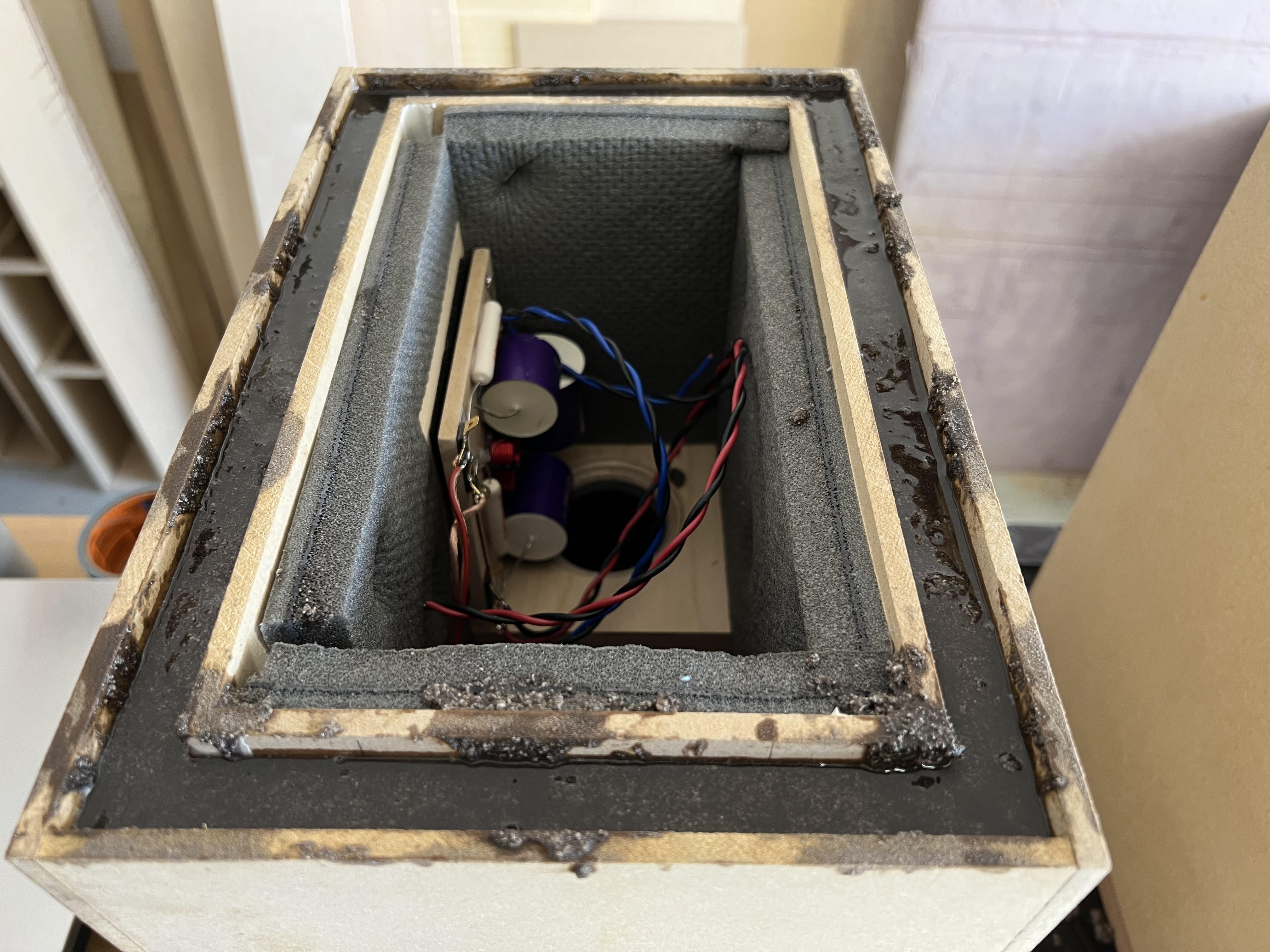

              Before work this morning I did a few things, culminating in sealing up the exterior of the interior boxes. I want to ensure there are no gaps in the seams where epoxy could intrude. I think this is the last step before adding the exterior panels, which I have yet to cut. Still waffling on whether I should use the MDF I have or drop some money on a 1/4" sheet of BB. It'd have to be delivered, which is yet another expense.
              Click image for larger version  Name:	IMG-0586.jpg Views:	0 Size:	2.82 MB ID:	945080
              Fortunately (or unfortunately) there is really no rush. I'm still unsure if I want to use the epoxy I have, but I might break out a bottle this weekend and make a few test samples. Not all parts for my vibration table have arrived either, so that's annoying (a week late on Amazon, how often does that happen). And finally, the forecast means I probably shouldn't be pouring a lot of epoxy anyway, though I think the small test forms should be fine.

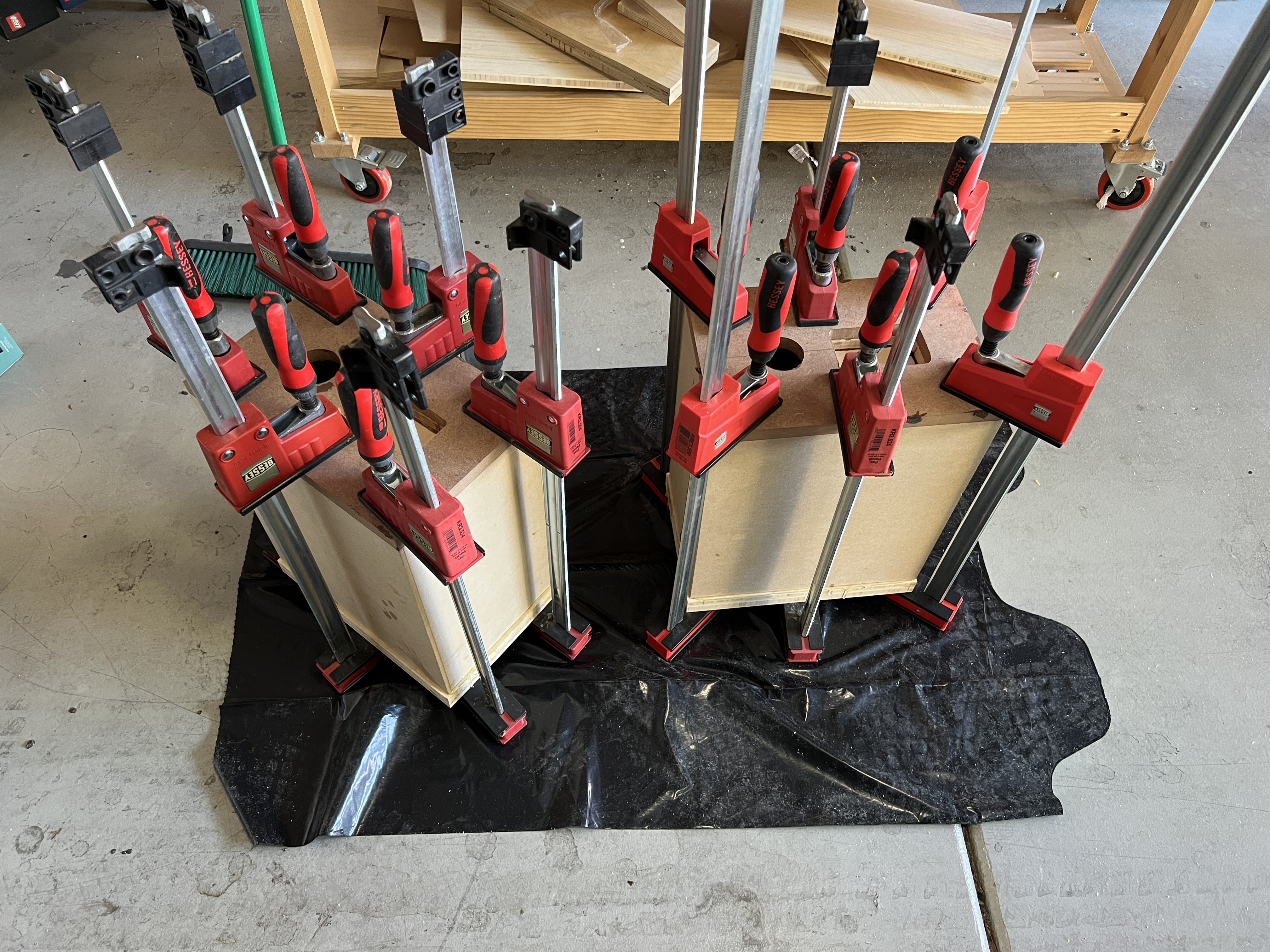

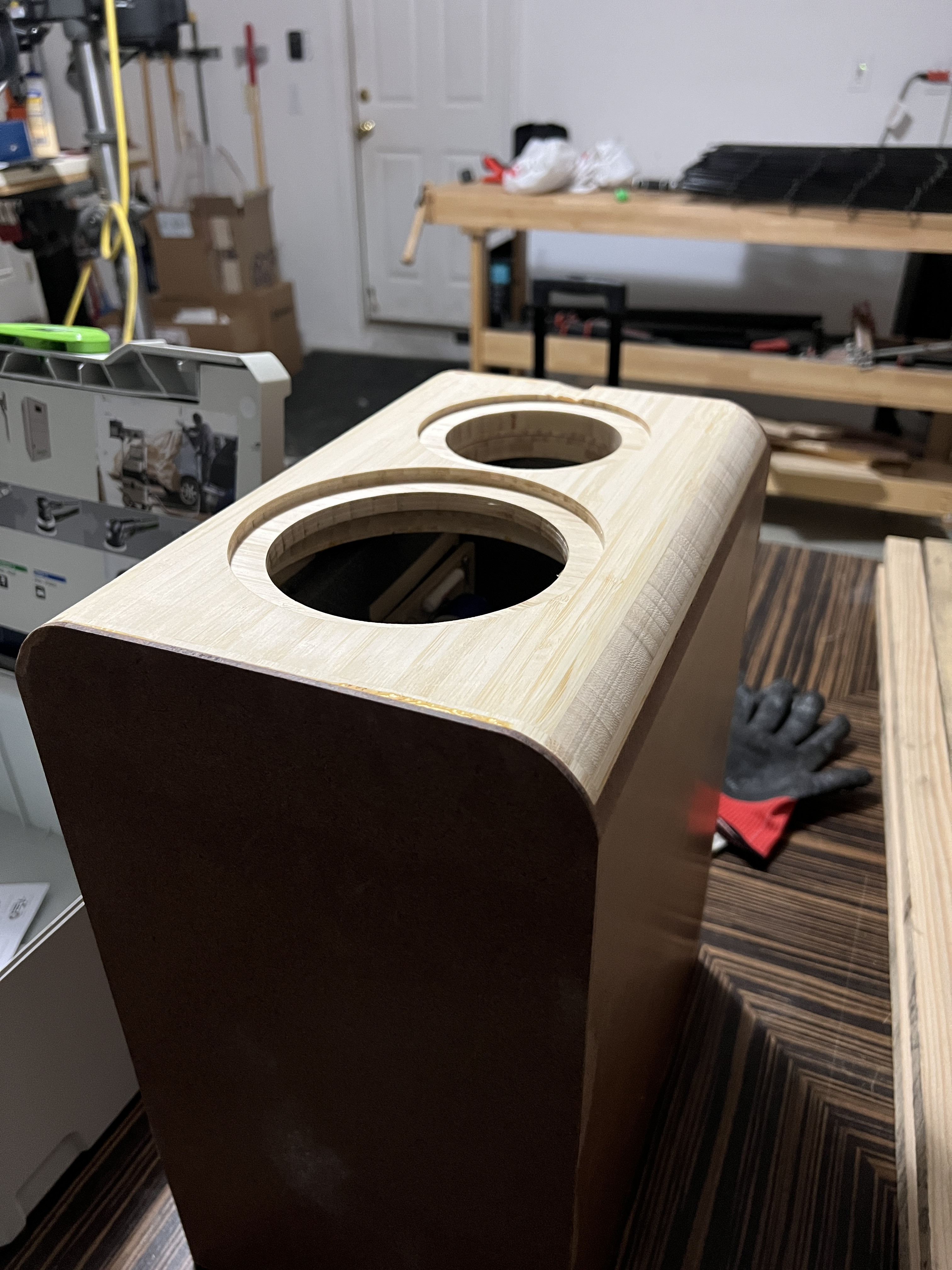

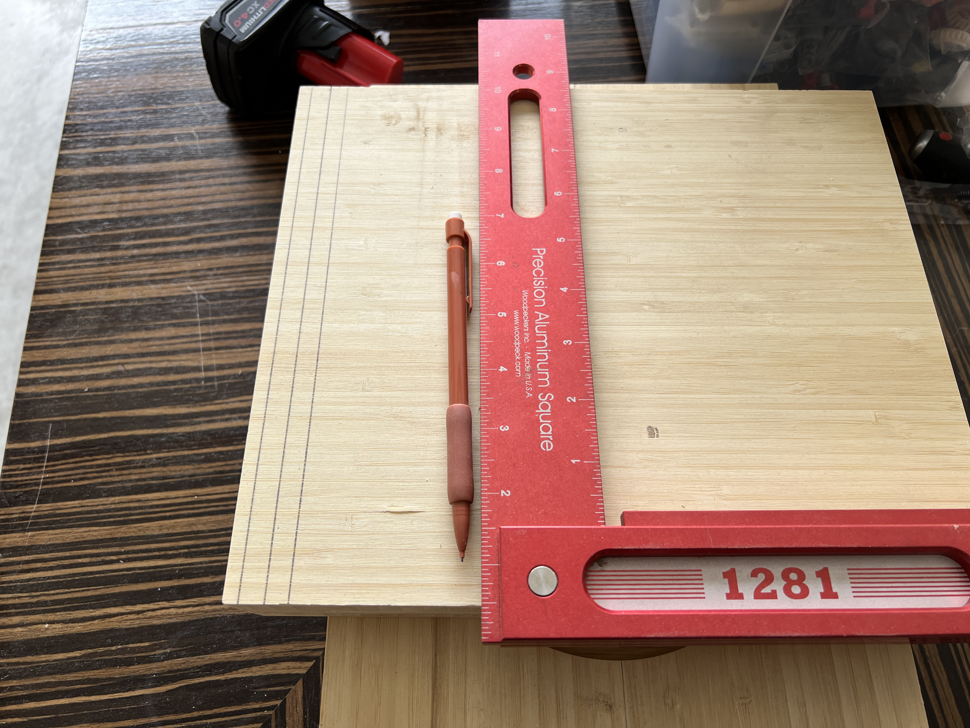

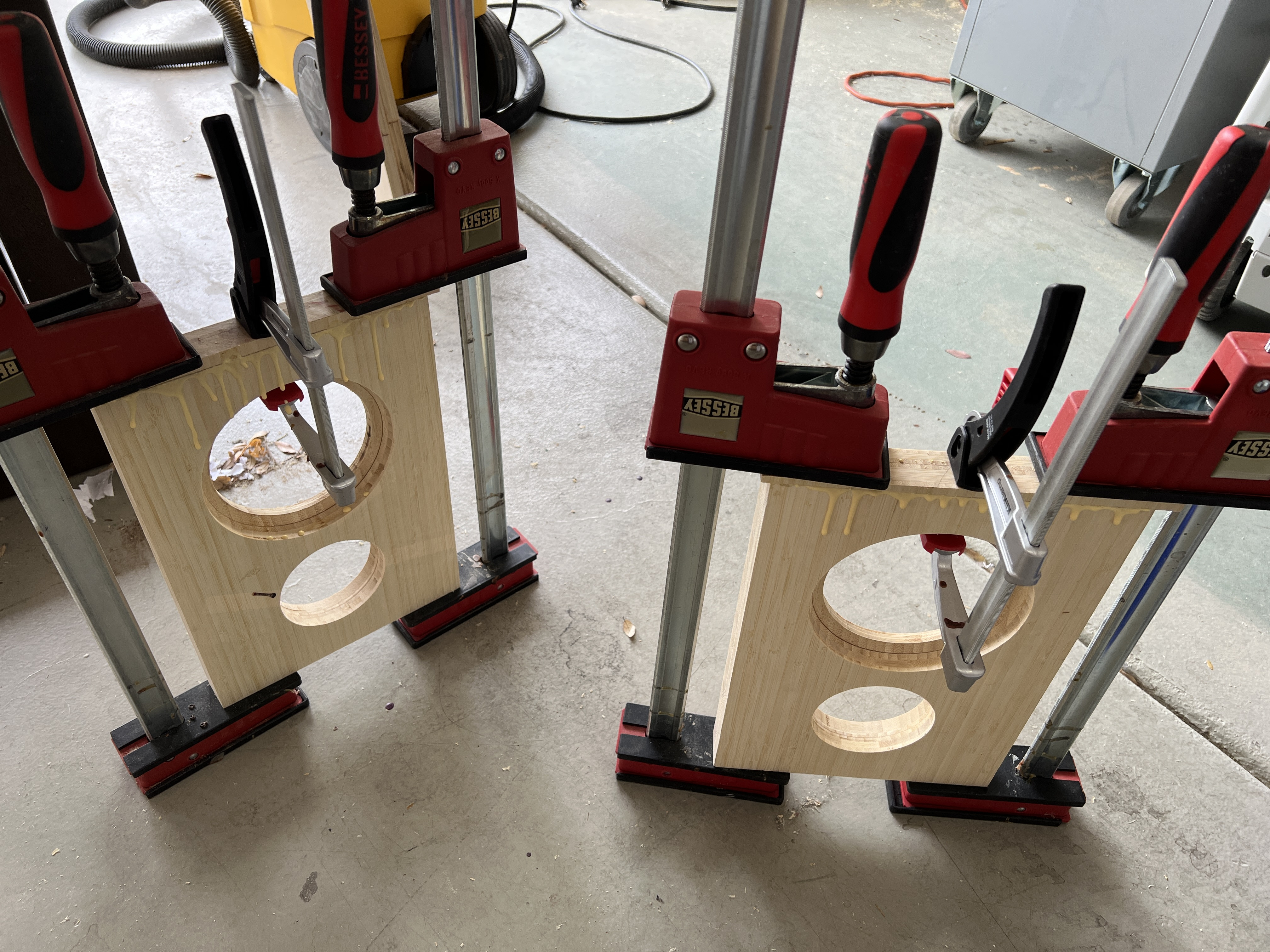

                Last night I started gluing up the exterior panels. I cut them to exact size on the height of the speaker and oversize on the depth and width, to be brought down to spec using a router later (maybe today). I set up the previous boxes I was going to use for the Keramiskas as a stop, applied more JB Weld epoxy, and placed the sides on the ribs. Looks pretty good considering I was rushing a little bit.
ID:	945140Click image for larger version
                  • 1557

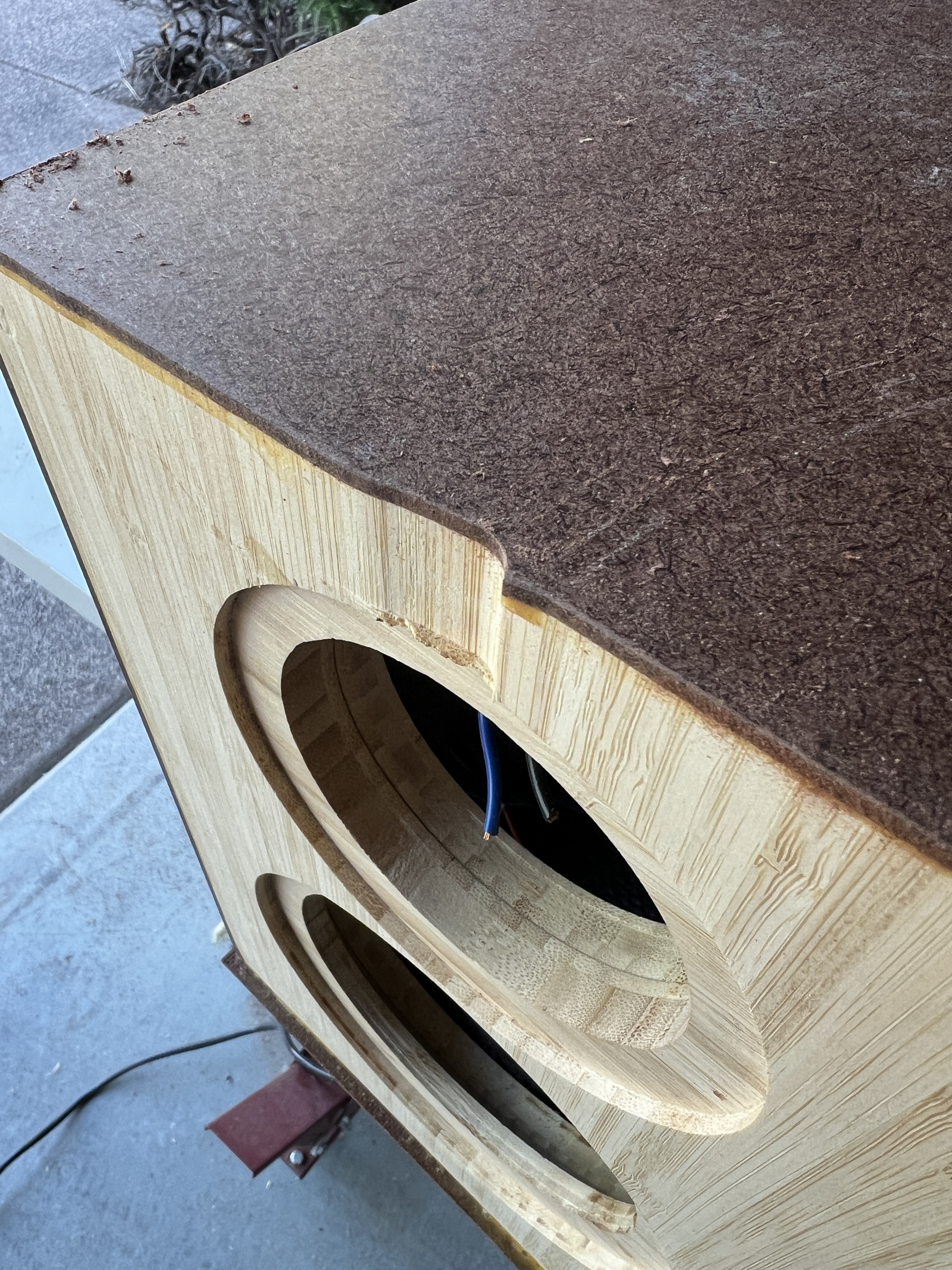

                  Well, I'm not sure I'd recommend doing this with 1/4" MDF. I'm pretty sure at least one of the project panels was slightly curved and I'm paying the price now. I think it's just too flimsy to guarantee 90 degree corners all around, and I'm quite convinced my own project is a bit on the curved side now. Granted, that could be a feature if you plan for it. If I do this again - and I might need to based on all the aluminum and aluminum oxide I will have once this project is complete - I think I'll use 1/4" baltic birch at an absolute minimum. It would be better to use 3/8" or 1/2" to ensure some stability, if you can afford to have VERY thick sidewalls. Maybe used in key places would be good to limit how deep these speakers would need to be to compensate.
                  Anyway.

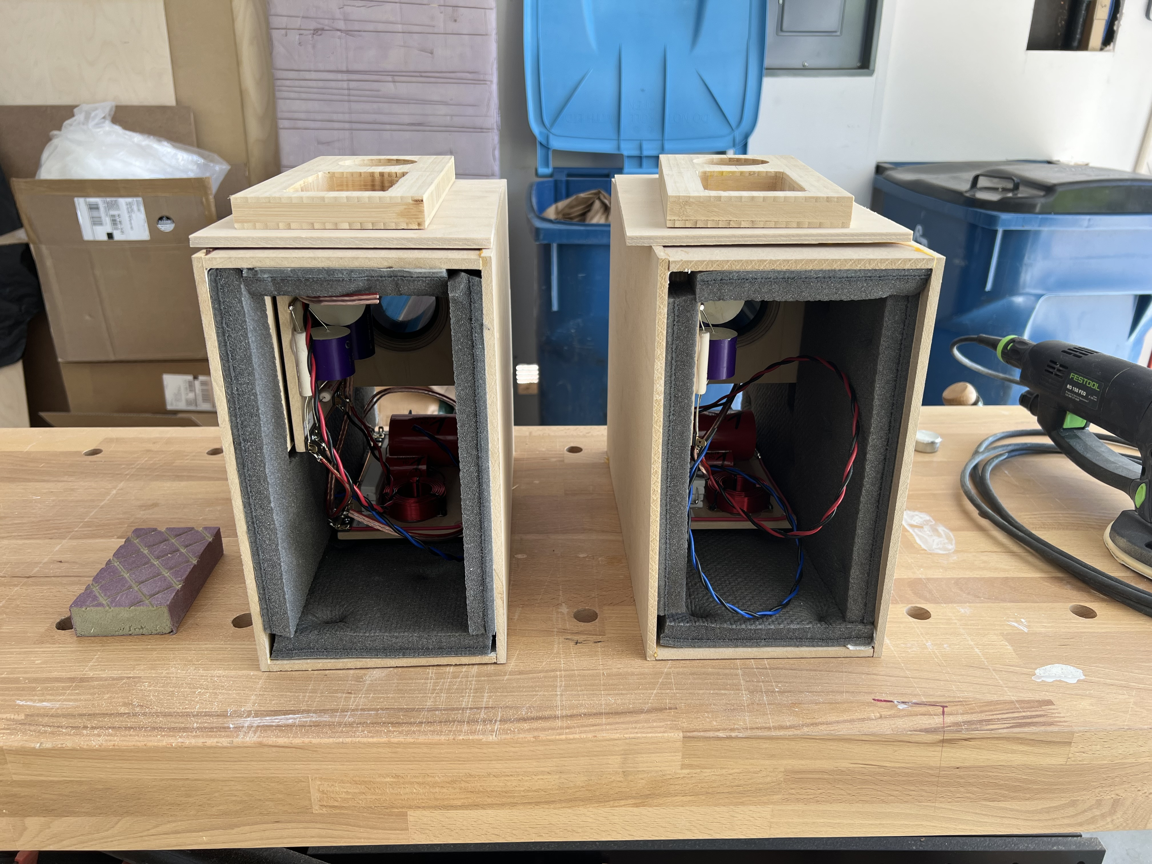

                  I cut down the top and bottom pieces and installed them this morning. I had to think a bit about how to glue both the sides and the ribs to these pieces without having the glue run and decided to use a thick glue I had on hand to do so.
                  This stuff is pretty great, it sticks to vertical surfaces without a problem.

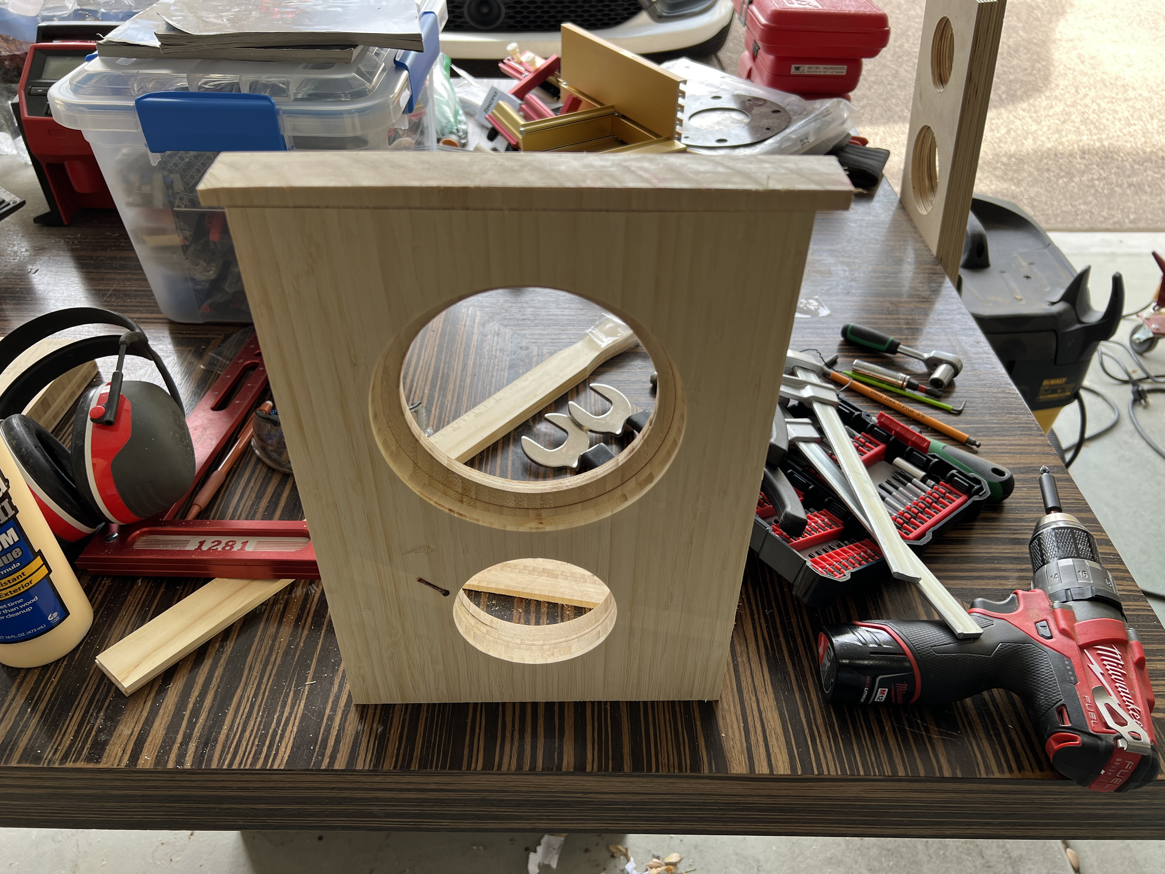

ID:	945146Click image for larger version

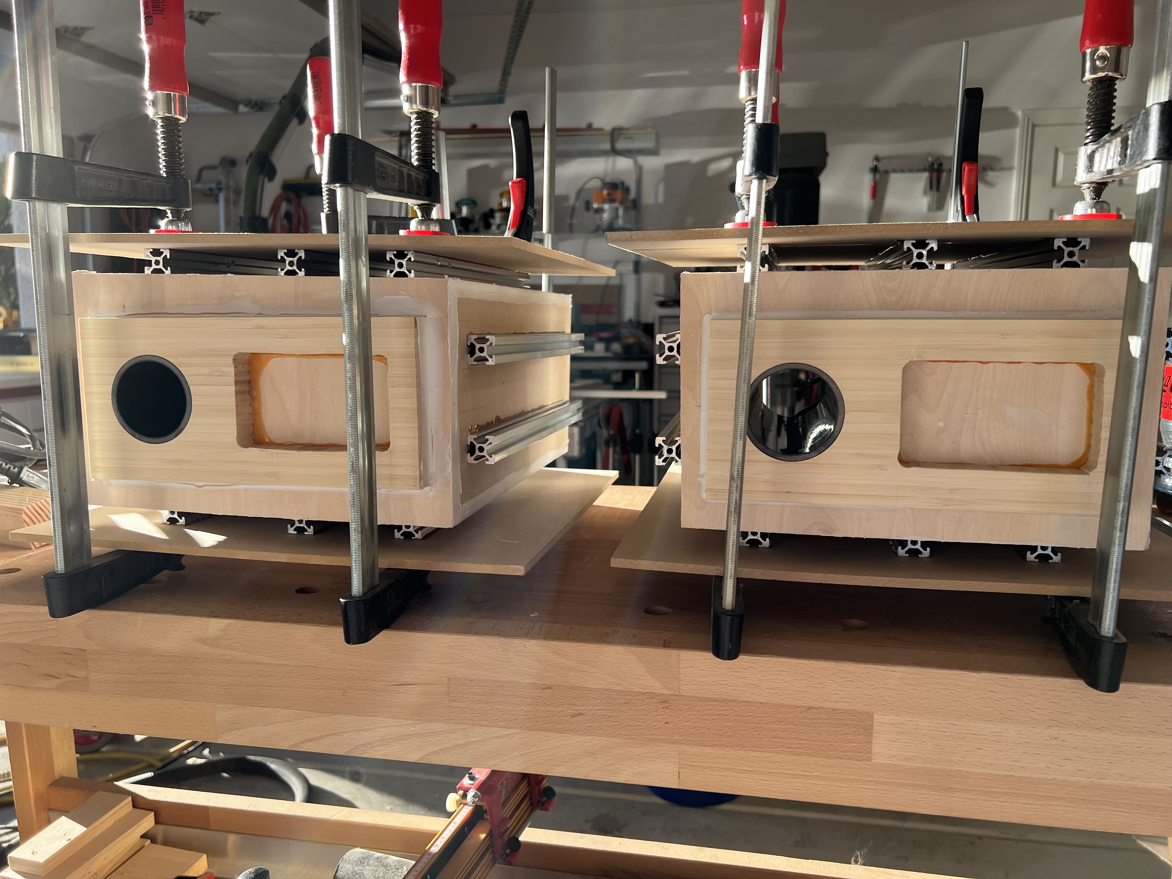

                    • 1557
                    Minor update.

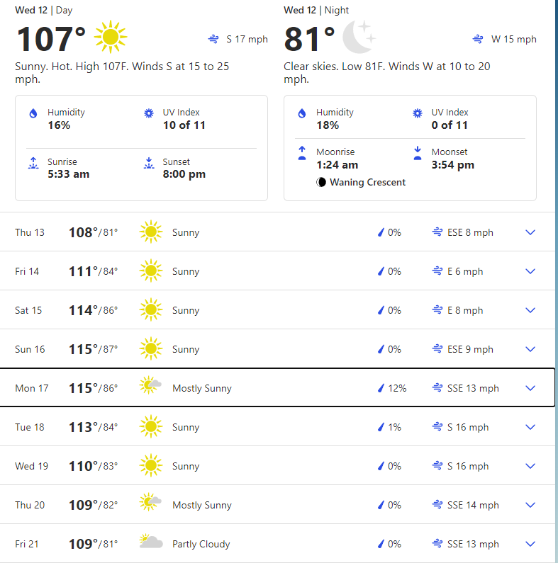

                    As the heat swelters this week (and probably for the next month) I've taken a slight break from the Keramiskas project. As of today I now have everything I need to build a vibration table, I'm just missing the time and motivation this week. Hoping I can get to it this weekend, and maybe put a small mix together for some trial bars. Waiting is okay, the sand I purchased was a might bit damp so I've been letting that dry out as much as possible. Perfect weather for it this time of year, so that's good.
                    The cabinets are ready to fill. I glued the backs on and evened up all edges with the table router...may have burned up the motor though, it released some smoke and some disturbing noise on the last cut. Need to find out what that is all about. In any case, they're just sitting on my bench, ready to go. I think I'll tape up all the exterior edges with painters tape before I pour, just in case

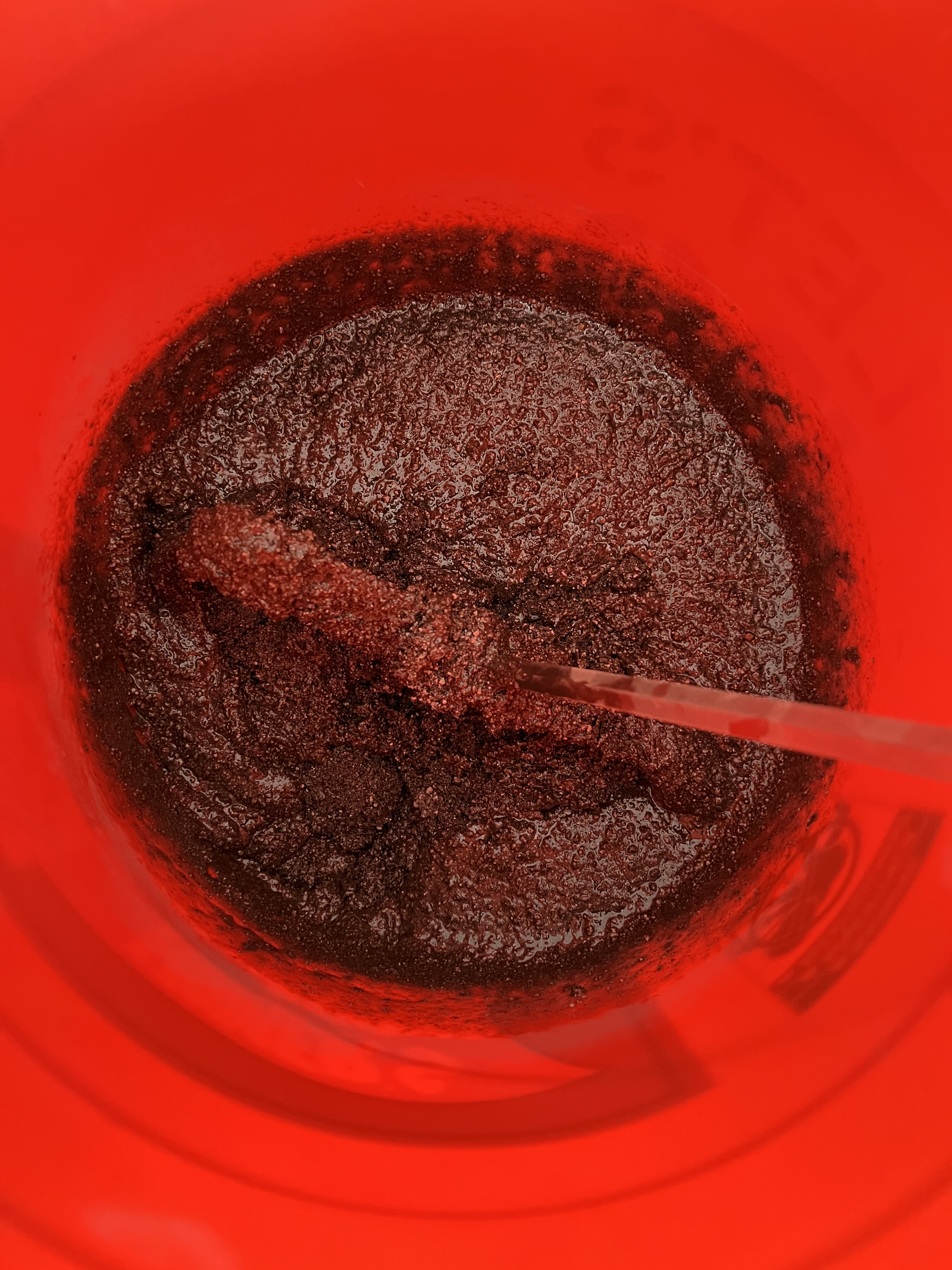

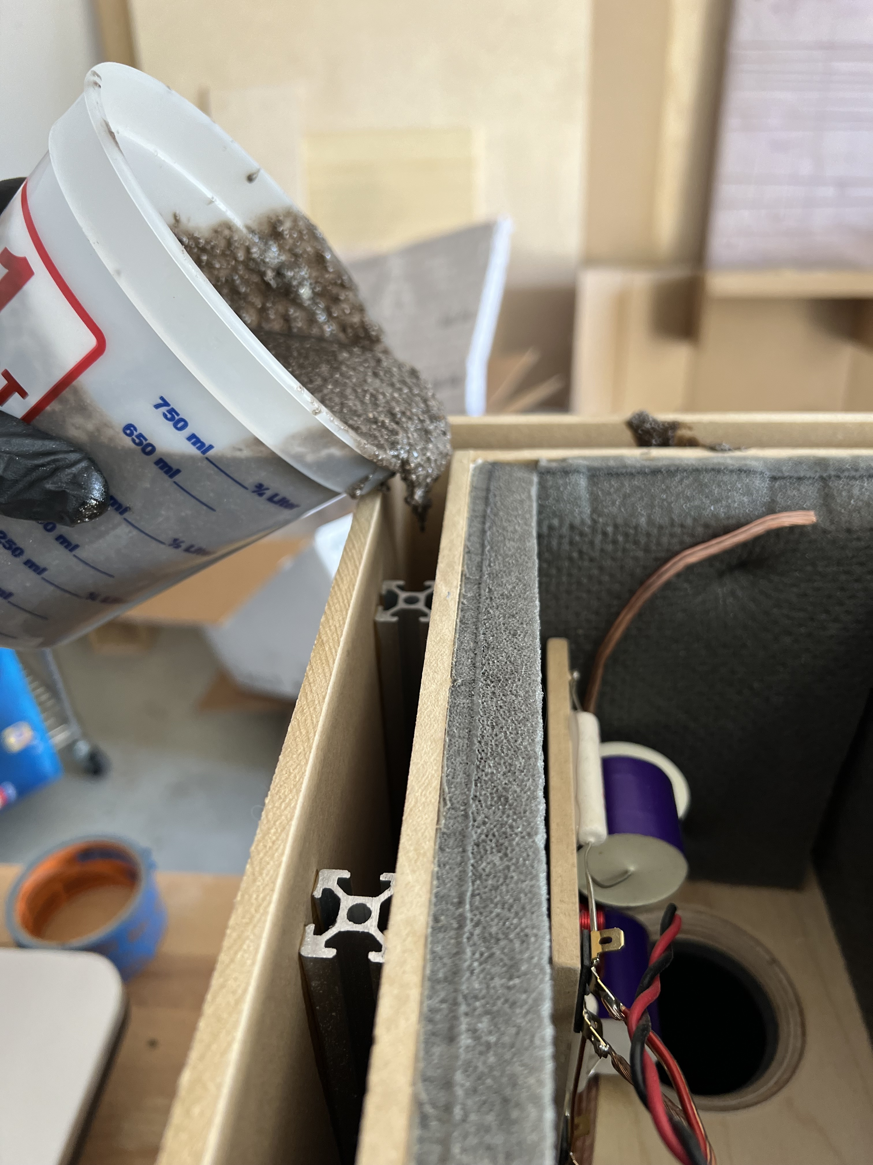

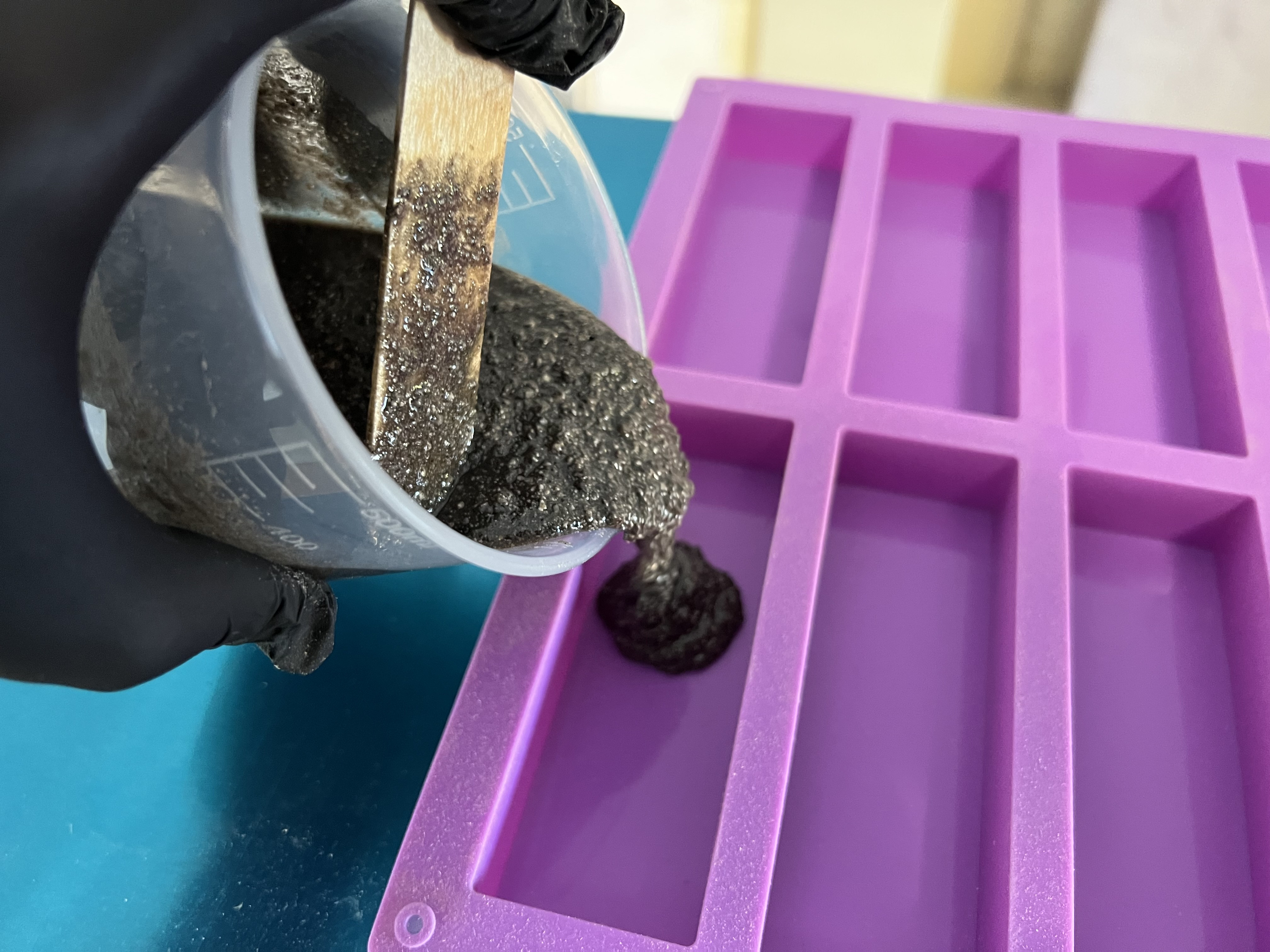

                      We have epoxy! I decided to use the mysterious smoking epoxy so we'll see if my house burns down. Unfortunately my mix was not exact; I had planned on doing a couple different mixes with varying amounts of epoxy while keeping a 67% sand / 33% aluminum oxide dust mixture static. I just assumed my scale could handle increments small enough for my mixture. Alas, it did not (0.05 kg is the smallest increment), though it should be fine for the actual pours since they'll be significantly larger. So what I ended up with was probably a 67%/33% mixture of solids with somewhere between a 10-20% mixture of liquid epoxy. I think it'll be fairly forgiving though, given my application and how the sample pours went.
                      Click image for larger version  Name:	IMG-0612.jpg Views:	0 Size:	3.27 MB ID:	945792

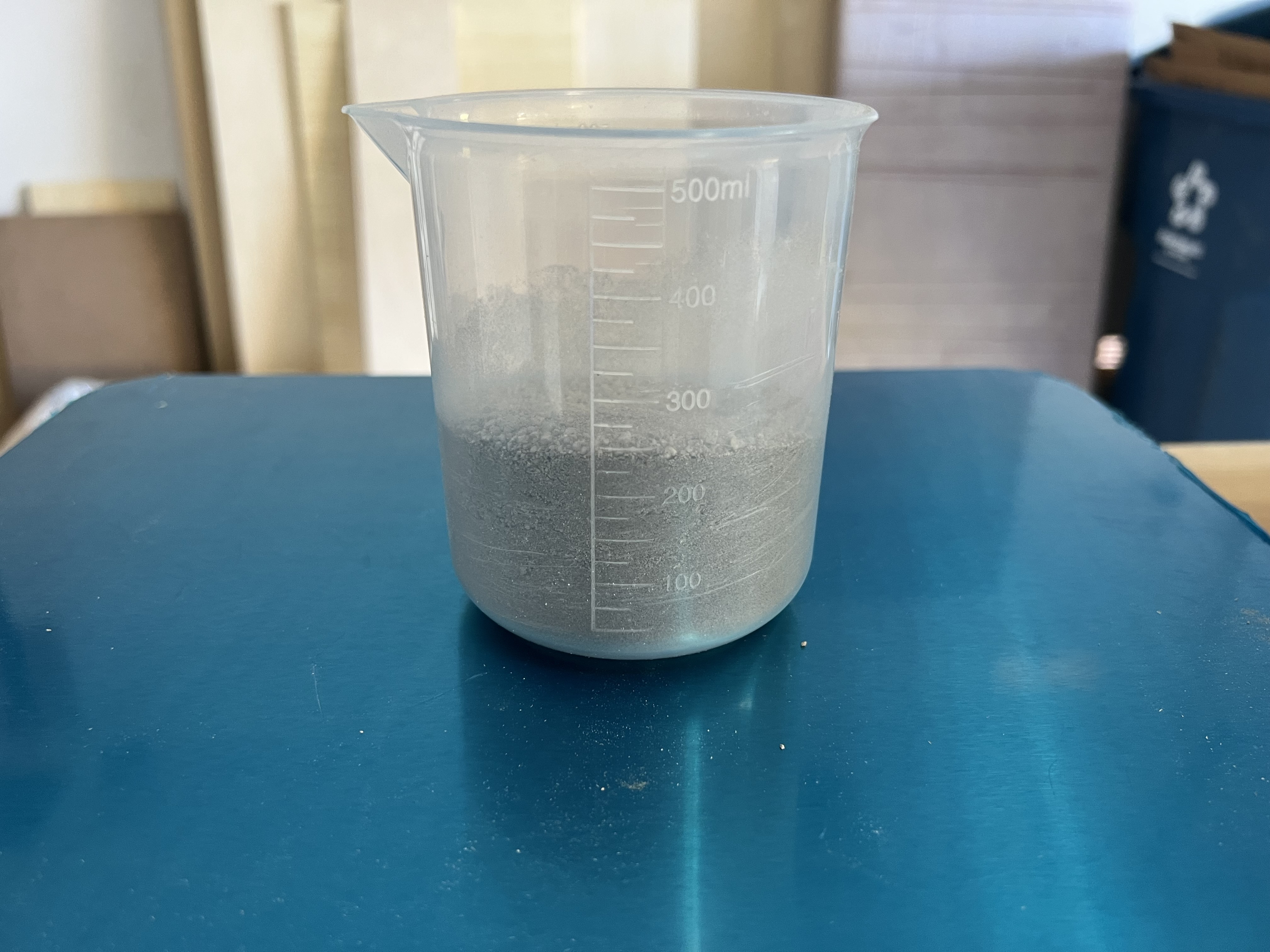

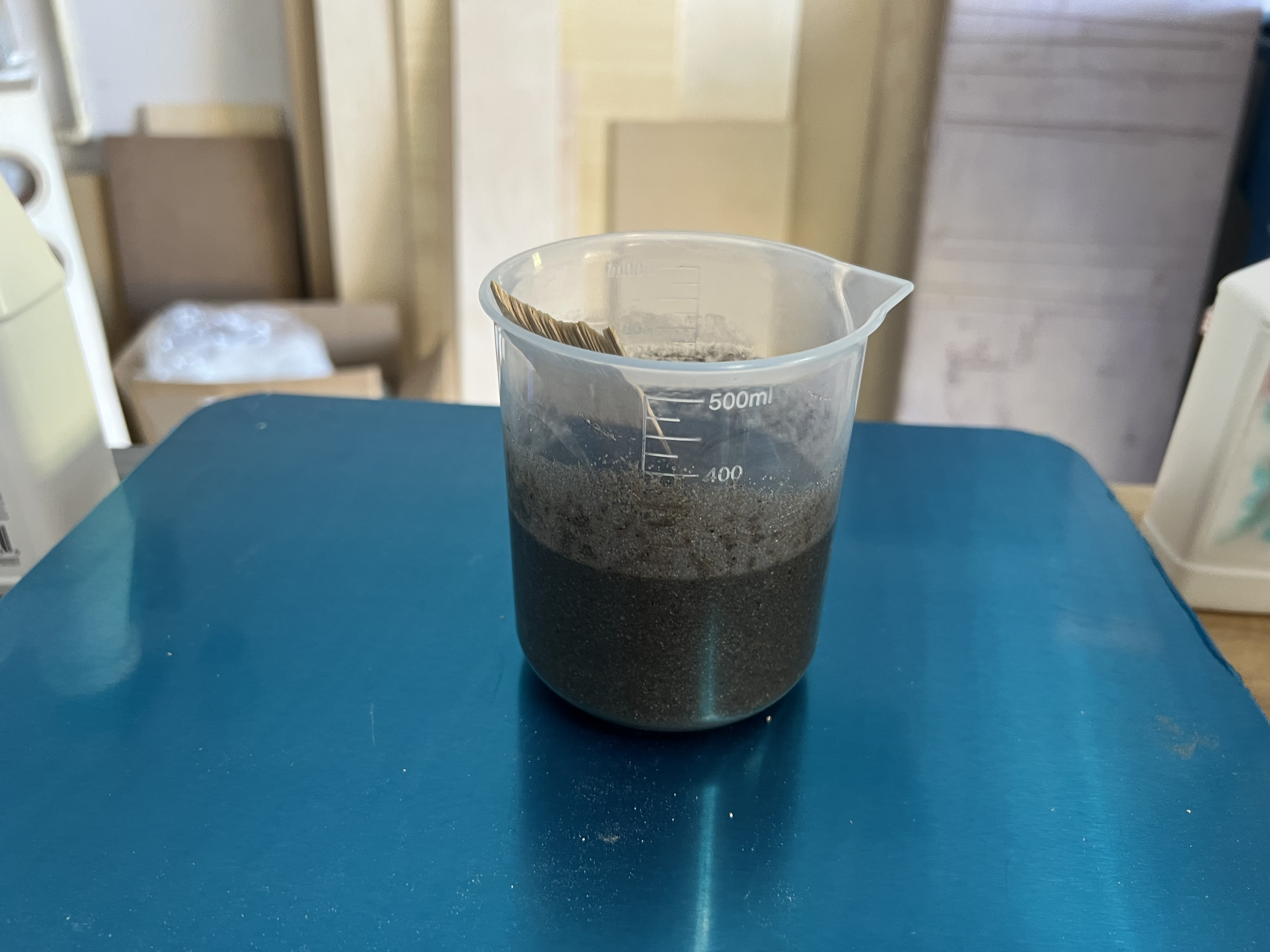

                      The dust and sand mixed up okay, I was just using a cheap tongue depressor which was pretty wimpy. I'll use something much more solid for the real mix.
                      Click image for larger version  Name:	IMG-0613.jpg Views:	0 Size:	2.73 MB ID:	945793
                      Said tongue depressor snapped when I added the epoxy, but only after I had mixed it up pretty well. For the real mix I'll wait and mix Part A first, then Part B once that is all mixed up. Should give me a bit longer work time.
                      Click image for larger version  Name:	IMG-0614.jpg Views:	0 Size:	2.05 MB ID:	945794
                      Pouring went well, it definitely still had liquid properties despite all the sand and dust...at least at first. Turns out I did not mix it as well as I thought and it was significantly thicker at the bottom.
                      Click image for larger version  Name:	IMG-0617.jpg Views:	0 Size:	2.01 MB ID:	945795
                      However, I think that's a good thing. Even the denser stuff levels out (the sample on the right side) when I tapped the scale a few times. The other three I poured at different thicknesses just to see how strong it'll be. Again, not a big deal for my application, but I'm curious. For actual mixing in a 5 gallon drum I'll use a drill and a big honking stirrer, so I'm more confident about a uniform pour compared to my hand mixed tongue depressor situation.
                      Click image for larger version  Name:	IMG-0618.jpg Views:	0 Size:	2.42 MB ID:	945796

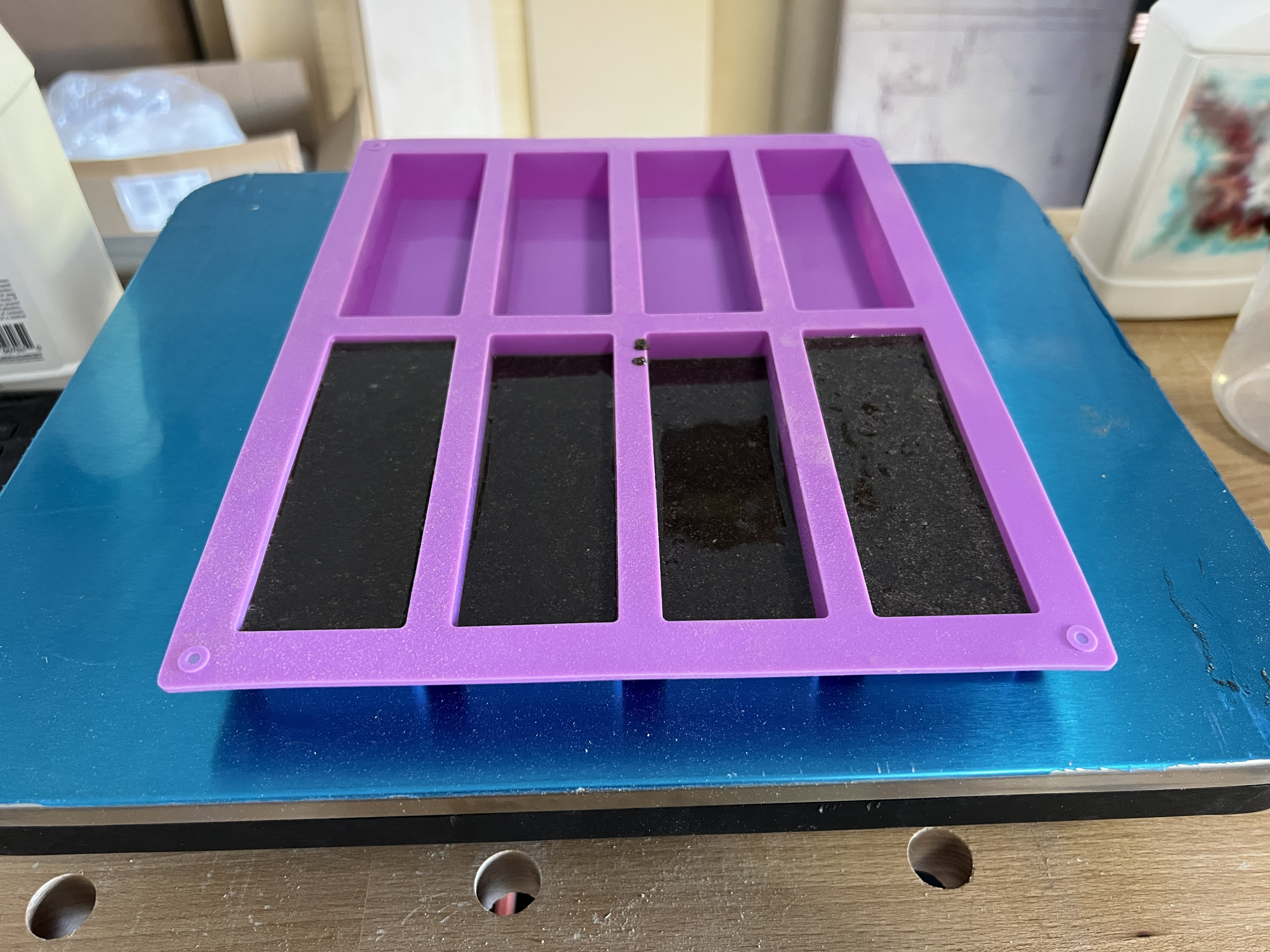

                        I checked on these today and am pleased with the results so far. They aren't 'quite' set all the way - this is most obvious on the pure epoxy brick as they are quite flexible, but otherwise solid. The polymer concrete is much stiffer, though I can slightly bend the thinnest sample when applying most of my strength. Pretty cool stuff, though it did not achieve the density I wanted...probably because I neglected to include the displacement of solid material by the epoxy. Best I saw was 1.34 g/cm3, a little less than the density of sand by itself.

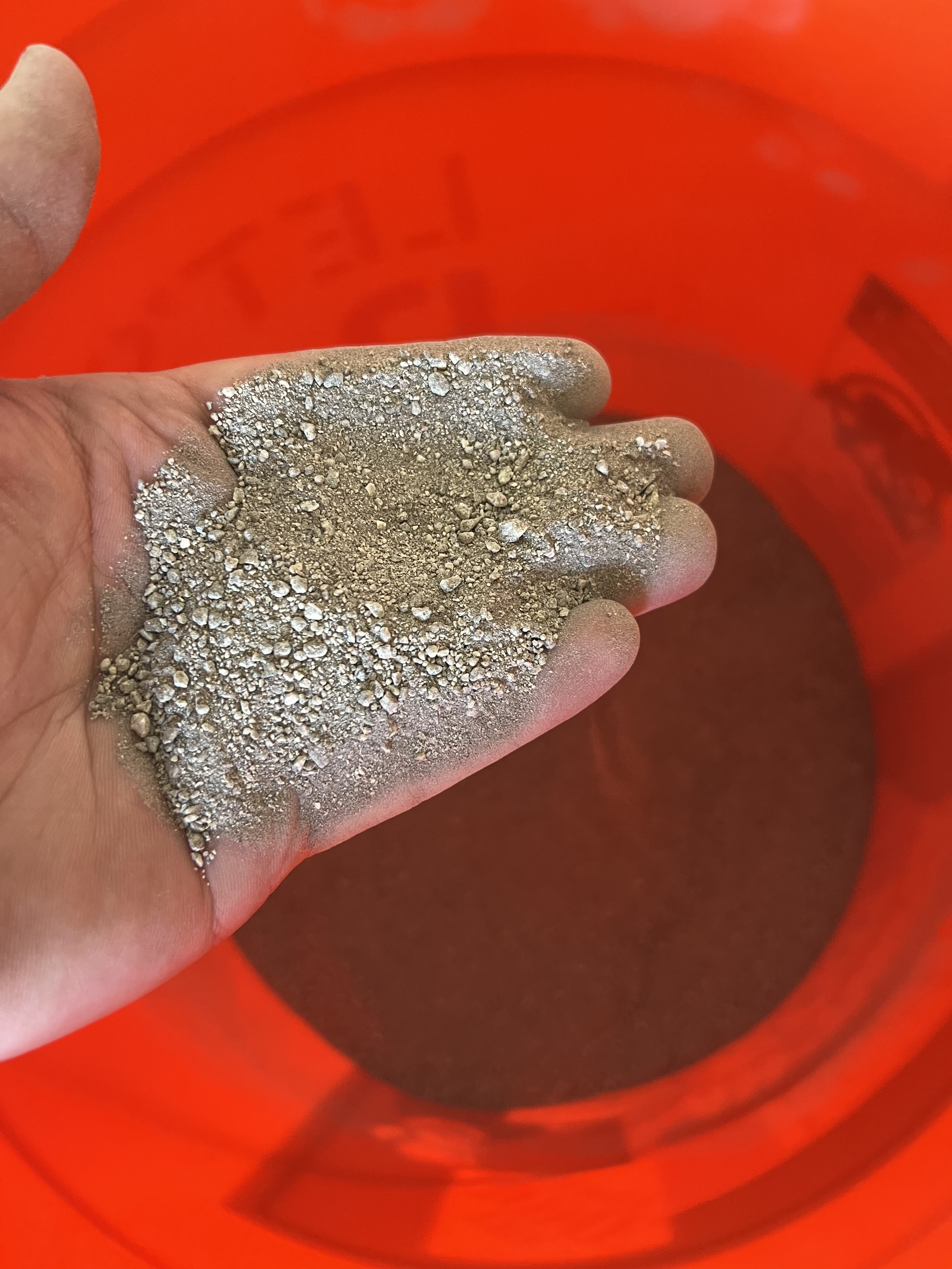

                            Since my schooling was in materials engineering I was intrigued by the concept and wanted to try it out, so I made a proposal for a speaker cabinet. Since I had already committed to completing my set of Keramiskas I decided they would make a good test subject. They are quite deep now due to the extra thick walls (3/4" vs over 1 1/4"), but otherwise share the same dimensions as the original design. Something I had proposed but decided not to do was make a polymer concrete-filled baffle. This was mostly because I already had baffles made that I didn't want to waste. I also proposed to make ribs in the cabinet, much like Rockport Technologies integrated into their aluminum subcabinet. For fun, I sources some 2020 extruded aluminum T-slot to use for this. Why? I don't know, but it was fun and reasonably inexpensive ($50 for both speakers combined).
                            So, that's pretty much where we're at. The cabinets are ready with the exception of taping them up, and I just need to build a small table for a concrete vibrator and pick a day to pour. Ideally one not so hot, but we'll make do.

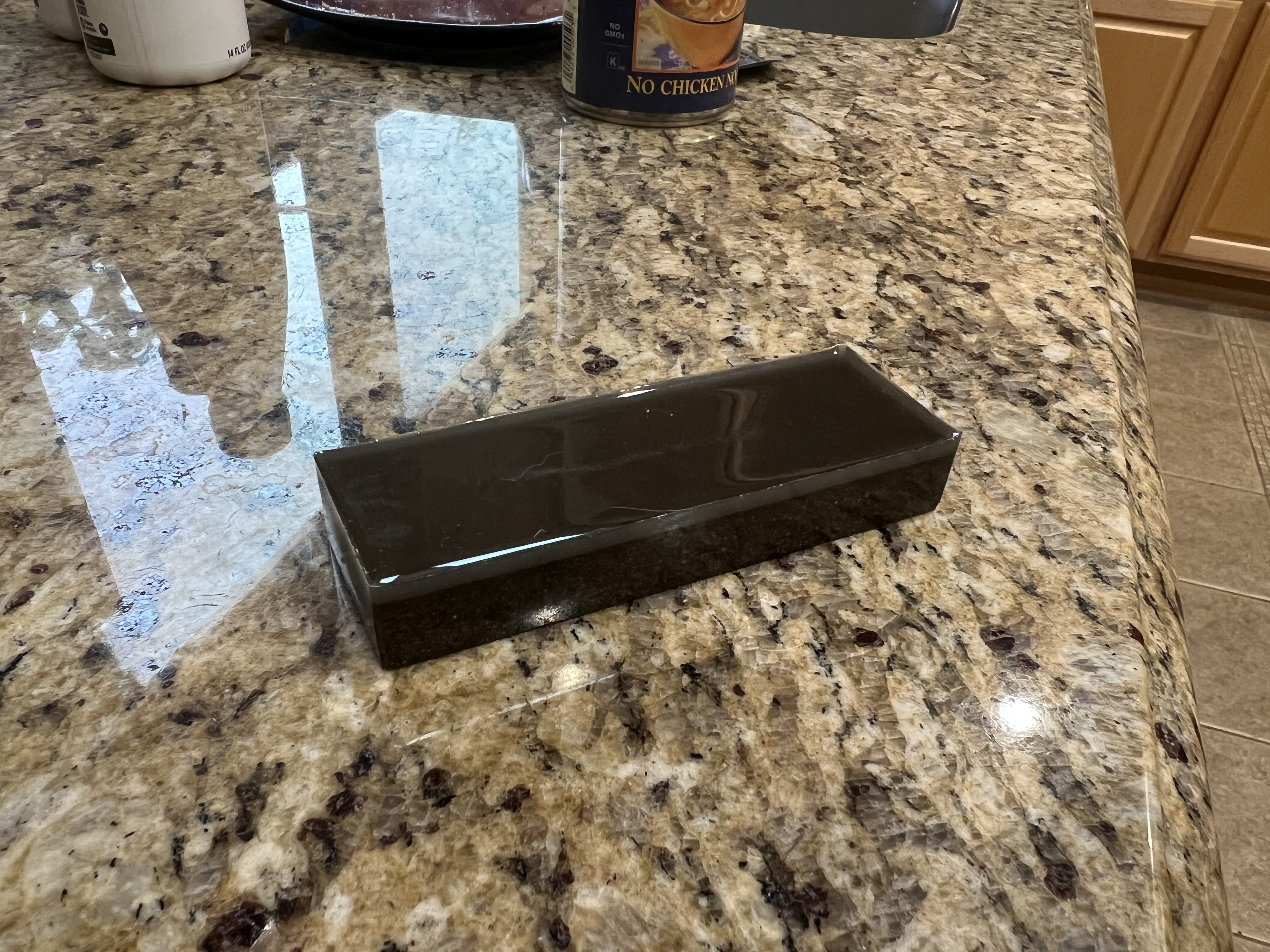

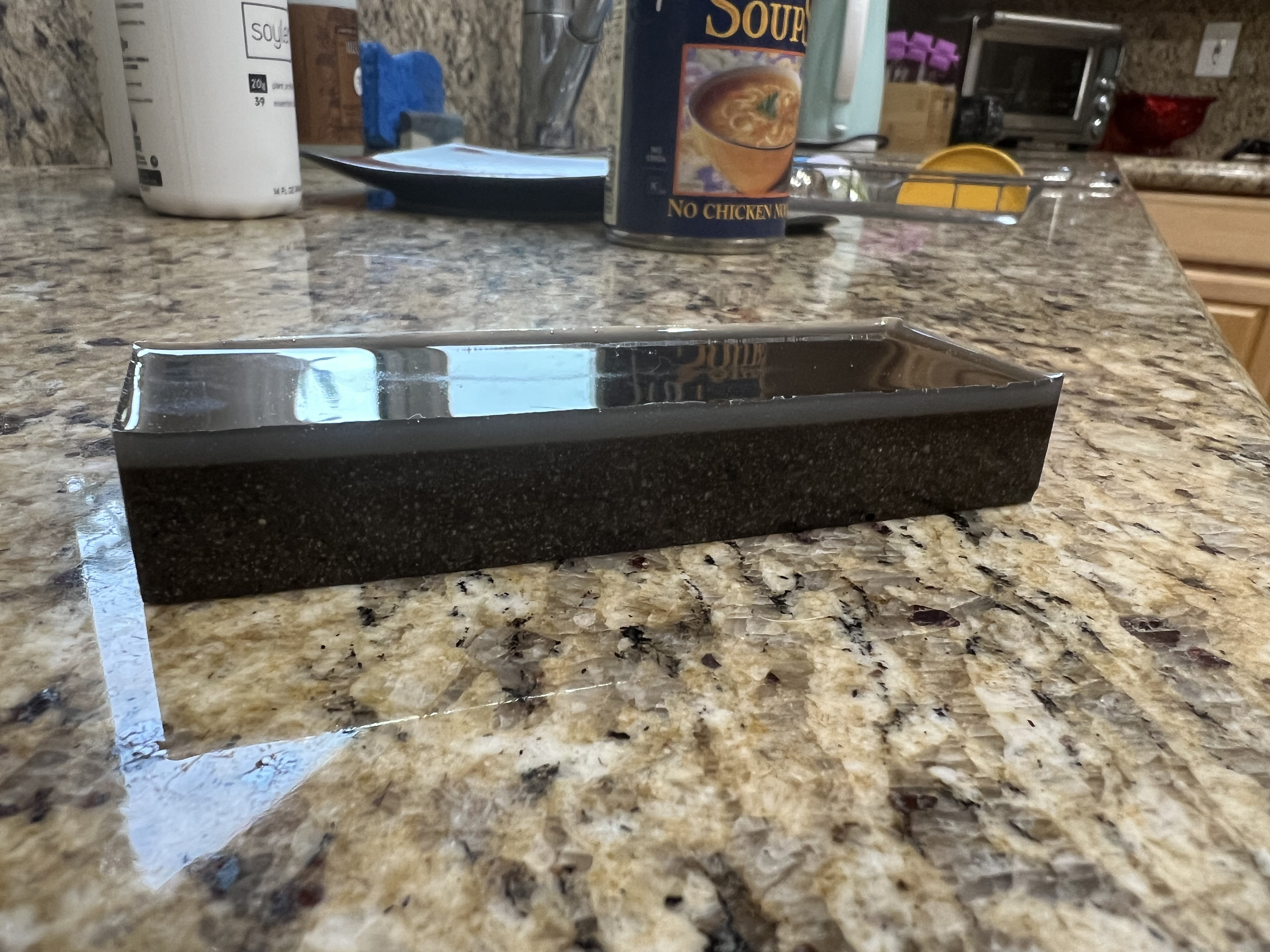

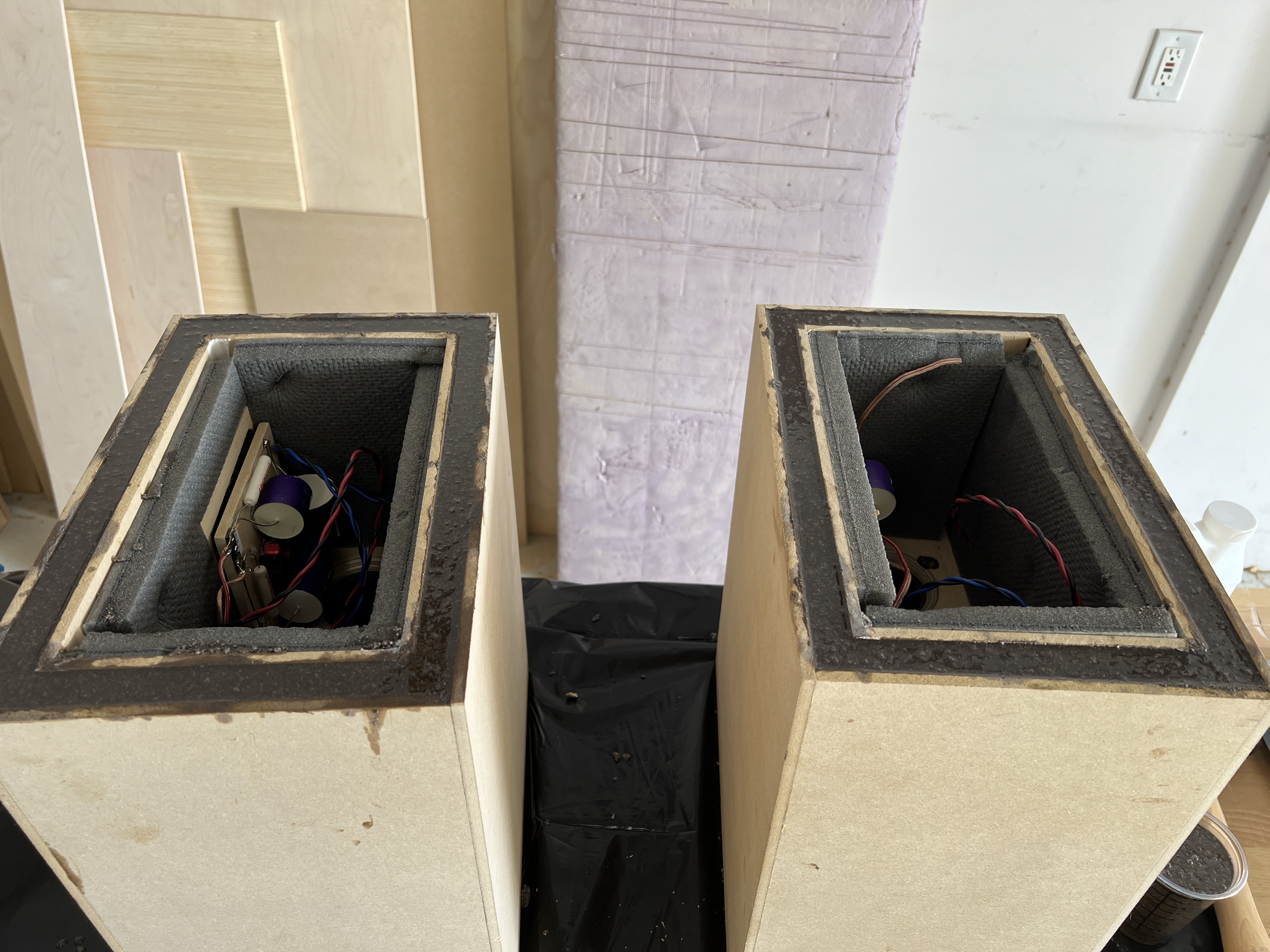

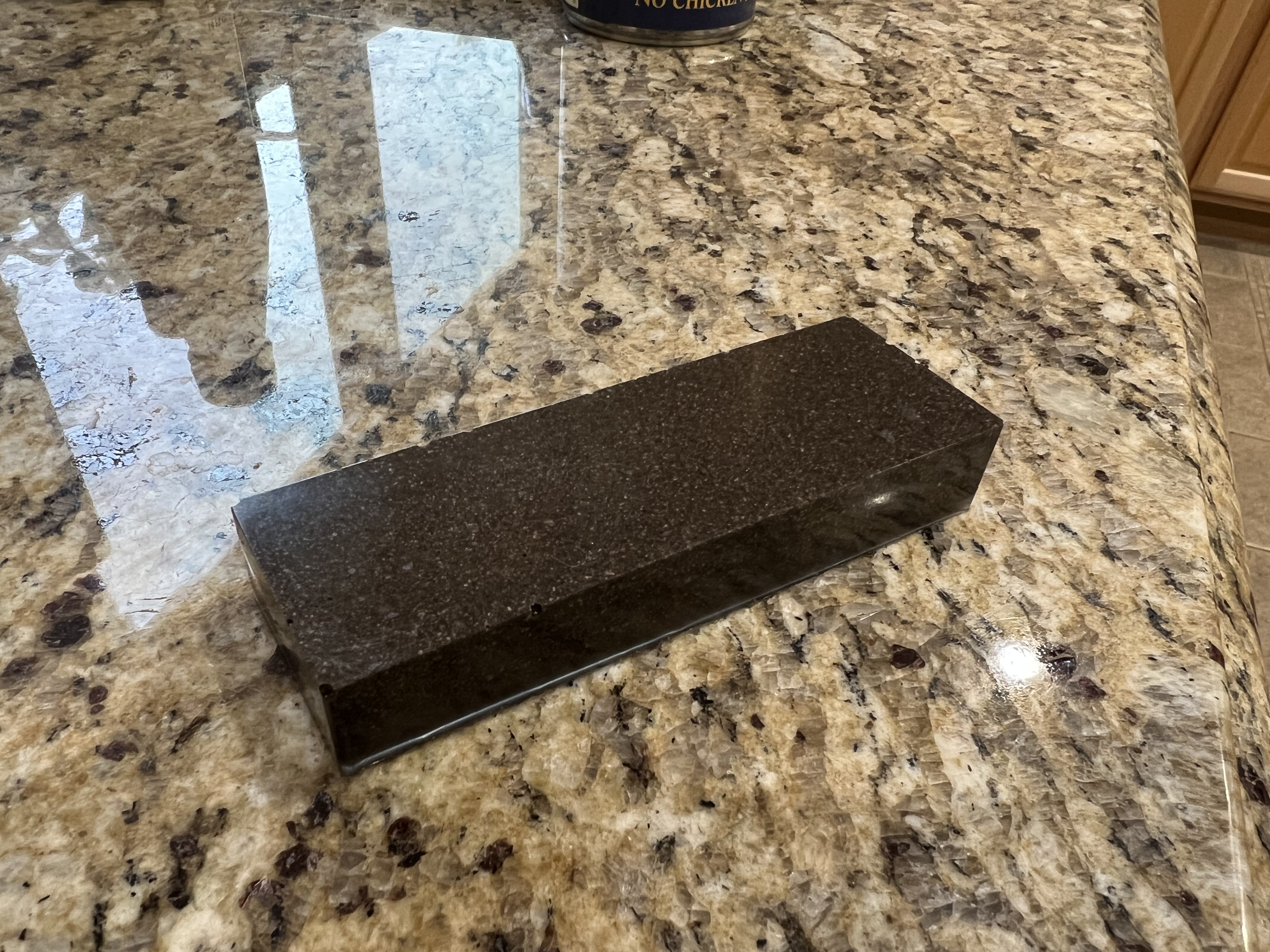

                            A few photos of one of the bricks I made. This one shows why it's commonly called epoxy granite. This is a very hard substance, much like a granite countertop. You'd need a diamond drill bit to penetrate it.
                            Click image for larger version  Name:	IMG-0623.jpg Views:	0 Size:	2.56 MB ID:	945872
                            You can tell there is a layer of mostly just epoxy on top. One thing I had assumed but didn't know for sure was whether the epoxy would wick up the sides a bit. They did, but that should not be an issue later. I'd like to avoid the layer of epoxy on top on the real pour if possible, I assume all I can do is keep testing the mixture so I don't have excess epoxy after the mix. I think I was closer to 20% on this run, so may 15% should be my next goal.
                            Click image for larger version  Name:	IMG-0624.jpg Views:	0 Size:	2.58 MB ID:	945873
                            A better shot of the side.
                            Click image for larger version  Name:	IMG-0626.jpg Views:	0 Size:	2.06 MB ID:	945874
                                A ruler next to your “brick” would be interesting to provide a sense of scale.
                                  technodanvan commented
                                  Editing a comment
                                  That's what the can of soup is for!
                                • 1557
                                Danny, this video shows how they fill the cavity between the speaker layers. https://www.youtube.com/watch?v=wZijzINOtCU
                                That's really interesting Steve, so they're probably just using a form of liquid rubber. I think someone else here mentioned doing something similar in a DIY design. I see it's readily available from McMaster-Carr too, so it's easy to get, though perhaps a little pricey. Granted, I haven't calculated how much one would need for a bookshelf-sized project. Being actual liquid though, you wouldn't need to keep the sides so thick since it's easier to pour.
                                Sorry I didn't think about using a tape measure (or banana) for scale. They more or less fit the dimensions of the silicone granola bar forms I grabbed a couple weeks ago: https://www.amazon.com/dp/B07RLWBTNH
                                Cavity Size: 1.57 x 4.56 x 1 inch - though none of my pours were quite as thick as they could have been. The heaviest one was 159 grams (about a third of a pound).
                                Edit...actually I was looking at one of the bars I made and realized it's nowhere near an inch thick, it's closer to 9/16". They also measure exactly 1.5 x 4.5 inches. Using the new (correct) measurements I get a density of 2.55 g/cm3, much better than what I had originally calculated, and right on target. This, despite some epoxy resting on top.

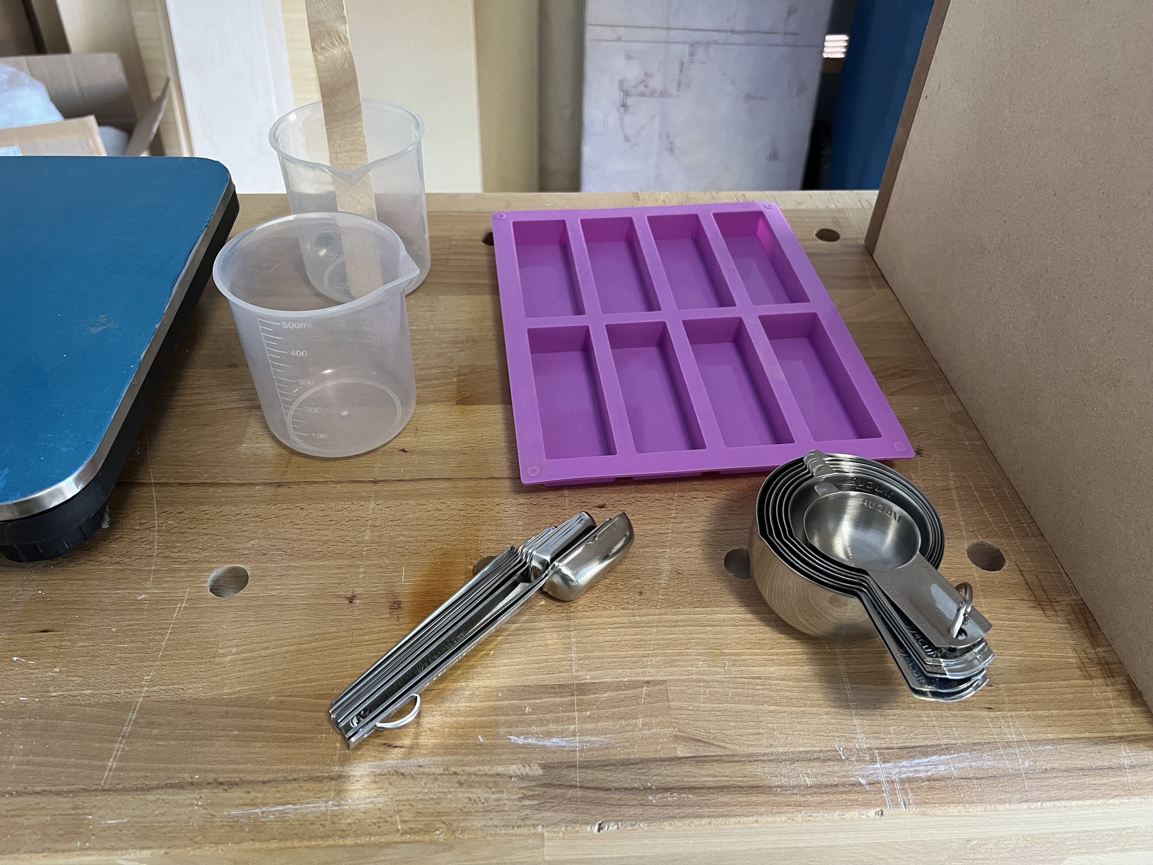

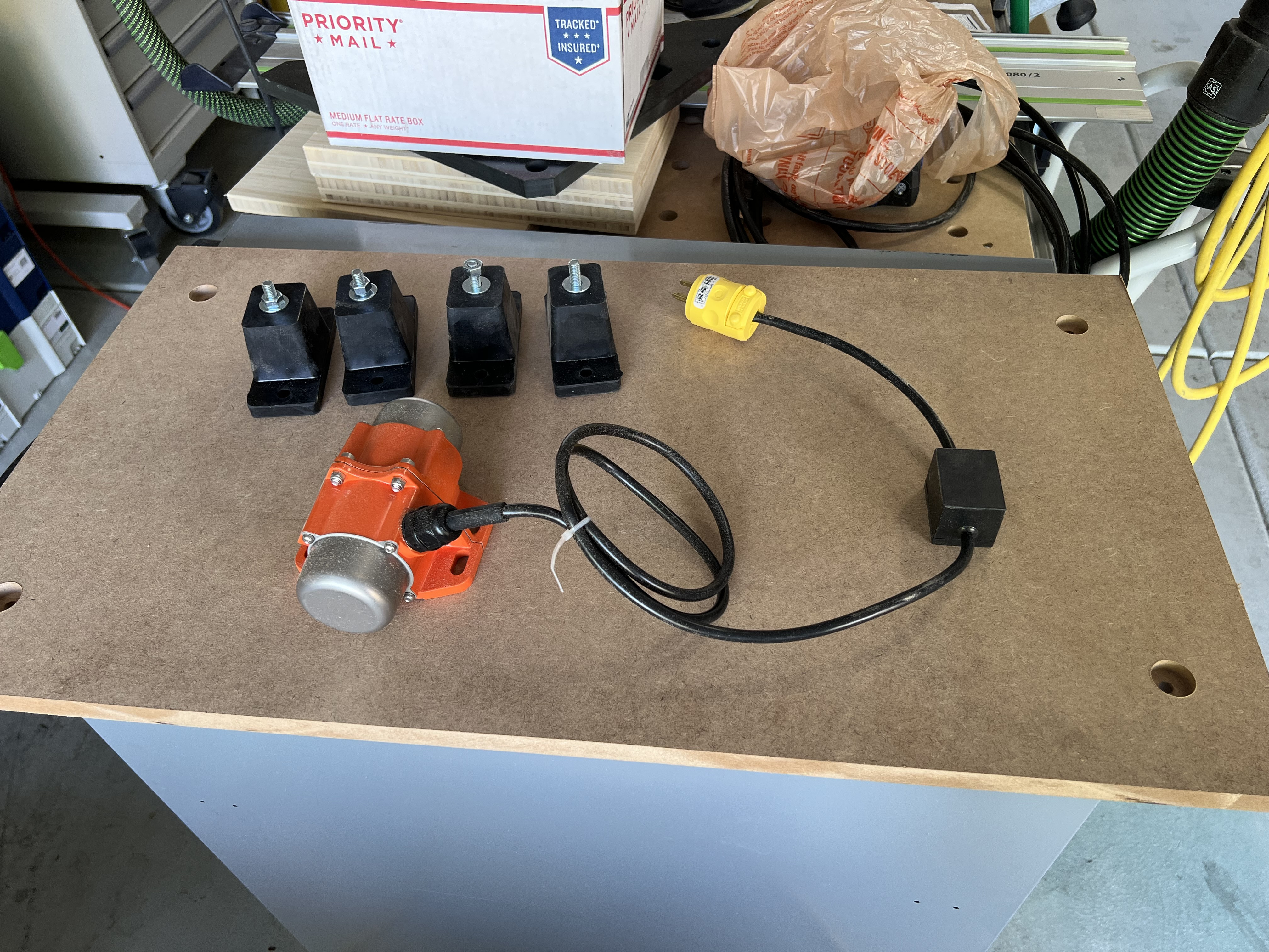

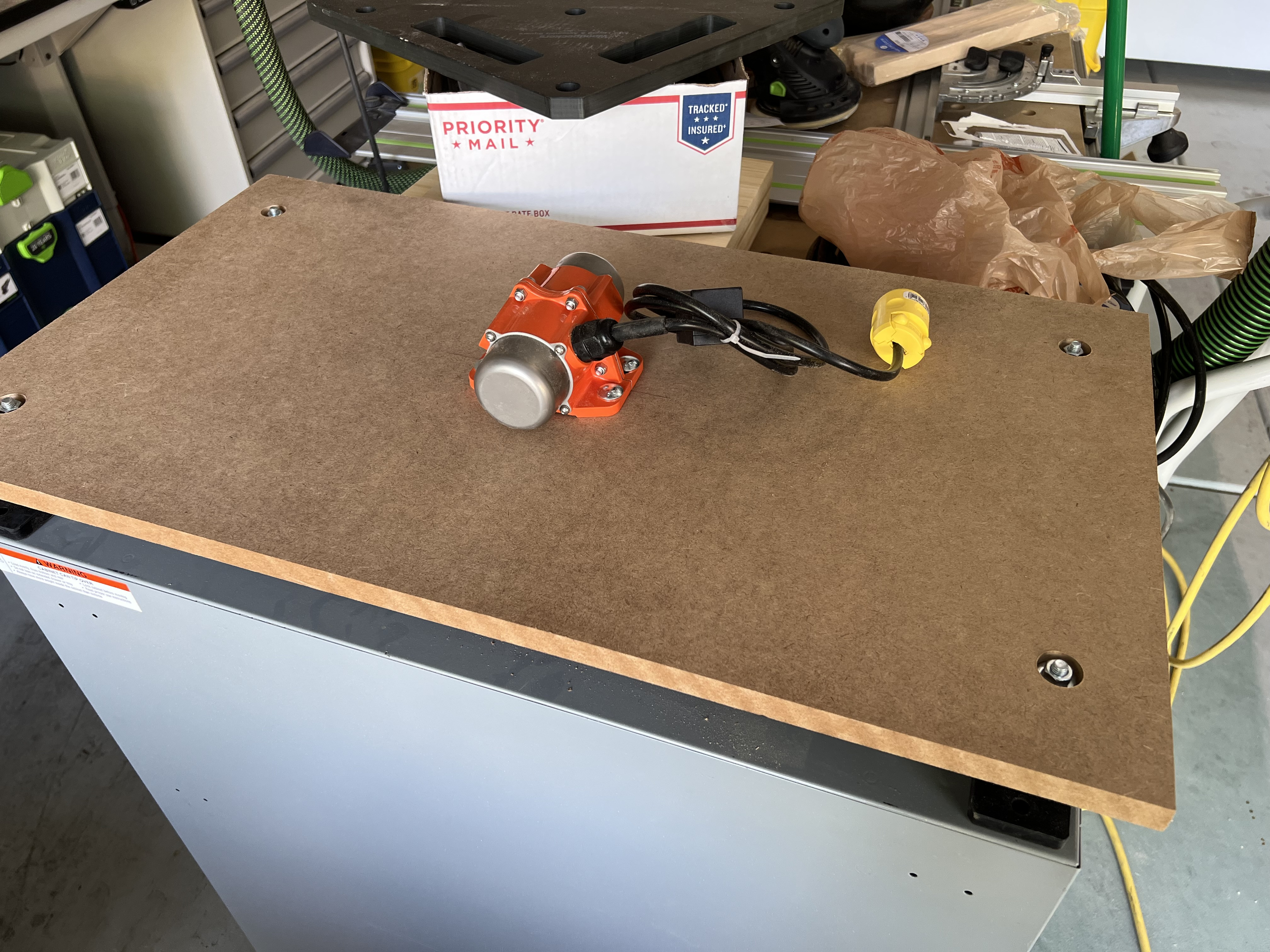

                                    I started work on my vibration table today. The parts:
                                    The initial assembly:
                                    So I say 'initial' assembly because the table vibrates way too much. It easily walks while knocking off anything on top of it. I'm thinking about attaching it to my workbench so it has a hefty base. I also think I need to add rubber sheets to the top...and maybe some low sides to keep things from falling off. The other option (or maybe this should be a 'both' situation) is getting an AC speed adjuster, though my understanding is they don't usually work well with these low power vibrators.

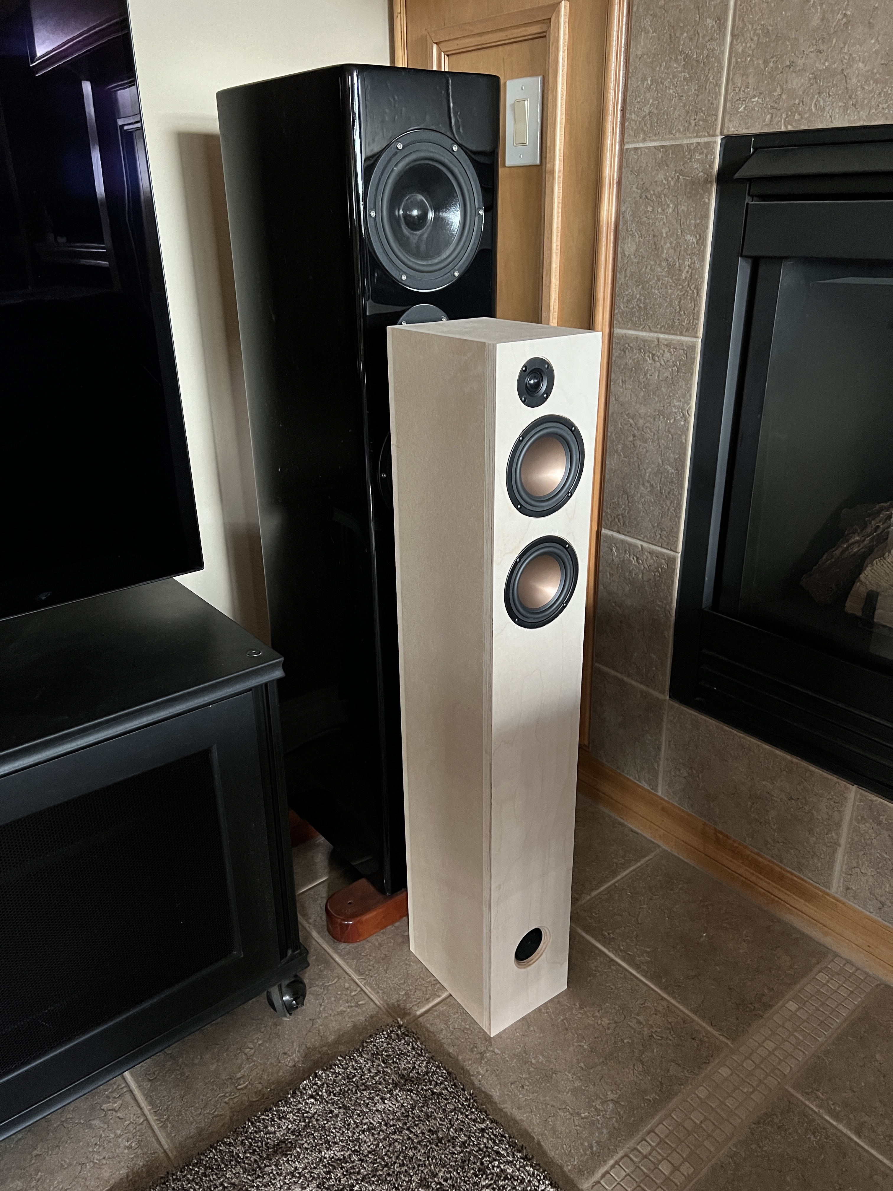

                                          1. Overnight Sensations TMM: The towers are complete and crossovers installed, just need to install the drivers and the terminals...after I figure out what finish to use and apply it.
                                          2. Speedster TMM: Basic cabinets are complete and baffles are probably ready to be adhered to the cabinets, after crossovers, stuffing, and wires are installed, of course. I need to figure out a finish for this as well.
                                          3. Kermiskas: The cabinet forms are done and just waiting for the polymer concrete pour. I'll probably tackle this before anything else as I'm curious how it'll go. Could be a disaster! Perhaps importantly, theSven had noticed the pure epoxy bricks had still not cured when he visited a while back - they were quite flexible, though returned to 'brick' form when released from tension. Since then, they apparently did cure. Only took a few months! Not sure how that'll play into the pour at colder temperatures in an enclosure, but we'll find out.

                                              Well, I finally poured some epoxy today. I didn't really take any pictures since the process was kind of involved, but it was...not as much of a mess as I thought it might be. I calculated the mix at 8.5 kg of solids (67% sand/33% powder) versus 1.5 kg of epoxy and mixed it with this honking thing. I was surprised the cordless drill could handle it, but handle it, it did. I actually had a hard time holding the mix bucket between my feet there was so much torque available.
                                              Click image for larger version  Name:	unnamed.jpg Views:	0 Size:	2.53 MB ID:	950038​Once I mixed the 8.5:1.5 mixture I realized I didn't have near enough epoxy. Maybe it's due to the cold (something around the mid to upper 40s this morning) but the mix was pretty dry. I decided having something that could pour would be preferable, so I doubled the epoxy in the mixture. Turned out a bit better, but in the end, it wouldn't matter.
                                              I had no intention of completing either speaker today which is good as I don't have near enough epoxy to do so. Ultimately I poured about an inch or so. Yeah, the whole 11.5 kg constituted about a single inch along the back of each speaker. I also discovered only the top of the mix prior to settling really 'poured'. For the second speaker I used a large mixing stick and scraped the mixture into the gap. It's probably not a coincidence that one weighs a bit more, at 13.3 kg (30 lbs), but it's not like I was being exact anyway. I'm predicting three more pours of similar size will be necessary to fill the boxes completely, with maybe a fourth small one of just epoxy to even it up. That would work out to somewhere around 70 pounds per speaker!
                                              I only have enough epoxy for one more pour, but should have plenty of solids to finish the project.
                                              I don't think I'm doing this again, unless it's for a REALLY special speaker. It's a lot of extra work.
                                                • 1557
                                                I tore down my router table today to clean up the lift and begin the installation of my new motor. I didn't take any pictures of that since it's not directly related to a speaker build (though it is a necessary step), but as I was doing so I remembered I never posted a few pics of my second pour. So, here's that. I have enough epoxy for one more round which I think should be enough to top them off.
                                                Here's the mixed aggregate I'm using. Not exactly play sand, but it seems to work like a charm. 67% sand/33% powder.
                                                Click image for larger version  Name:	IMG_0805.jpg Views:	0 Size:	2.44 MB ID:	950273
                                                And here's the mixture nearly ready to pour. I believe this picture was taken with only Part A of the epoxy mixed in. My picture of both Part A and B turned into a movie somehow.
                                                Click image for larger version  Name:	IMG_0806.jpg Views:	0 Size:	2.20 MB ID:	950274
                                                Finally, I opted out of using the funnel this time as it was simply far too slow. I just scooped and poured using smaller containers.
                                                Click image for larger version  Name:	IMG_0810.jpg Views:	0 Size:	2.36 MB ID:	950275
                                                Edit: For Jon, I do not believe I had any exothermic reaction again, and this time the pours were six inches thick. I think the combination of doing this below the recommended temperature and having a dense mixture helps keep things under control.

                                                      • 1557
                                                      More progress today. Topped off the epoxy in the cabs and lengthened the baffles a hair. I need to find some kind of high build epoxy to attach the baffles now...
                                                      Click image for larger version  Name:	IMG_0857.jpg Views:	0 Size:	2.68 MB ID:	950581
                                                      Click image for larger version  Name:	IMG_0858.jpg Views:	0 Size:	3.02 MB ID:	950582
                                                      Click image for larger version  Name:	IMG_0859.jpg Views:	0 Size:	3.04 MB ID:	950583
                                                      Click image for larger version  Name:	IMG_0860.jpg Views:	0 Size:	2.92 MB ID:	950584
                                                      Click image for larger version  Name:	IMG_0861.jpg Views:	0 Size:	2.82 MB ID:	950585

                                                            Minor progress again. I epoxied the baffles to the cabinets. I'm not sure how much I trust the '5 minute set time' on the Devcon, so I'll wait a few hours (at least) before cleaning up the edges. Then I need to decide if I'm going to call them done or laminate some hardboard or 1/4" BB to the sides and top/bottom.

                                                              Minor update: I decided to skin everything but the baffle with 1/8" hardboard. It covers up all the stains and such from the epoxy drips and provides a clean surface for sealing and painting. I thought I could just use the weight of the cabinets to 'clamp' the hardboard while it dries, but either the cabinets aren't quite square or the tables I have them resting on aren't. Probably both. So I'm clamping like normal.
                                                              Anyway, no pictures of this process at this time. I have the rear and sides done now, and will do the bottoms today. Speaking of the speaker bottom, I haven't quite figured out what kind of feet to use since I can't exactly drill or screw into the epoxy granite. Tentative plan may be to create my own stands, or modify something like the below from Monolith. Instead of feet on the speaker, I was thinking about putting 'feet' on the top of the stand, perhaps with adjustable height in the event i need to tilt the speakers up or down slightly. I don't know for sure, but I'd rather not have to design and make stands right now as progress has been slow - I need to get to the Crescendos if I'm going to get them done by October, and I have yet another speaker project I want to start on as well (though that is pending funding at the moment, and needs its own modifications).
                                                              As an aside, Monolith claims the speaker stands can only support up to 75 pounds. I shouldn't quite exceed that, but even still I think it's an odd number to choose given the design - it should clearly support much more than that unless the pillars are tinfoil-thin! I wonder if it's more about how tippable they may be when loaded and if so, how they calculated that.

                                                                In other minor news, we (my wife and I) elected to not finish the Overnight Sensation TMM at this time, so I went ahead and installed the drivers and such so we have working speakers. The tentative plan (per my wife) is to have them painted deep green and have some artsy person draw some mushrooms on the sides. These are going in her study, so she's calling the shots.
                                                                That said, I'm not sure I want to have them finished as they currently sound bloated to me. It might be speaker placement at the moment - one is in a corner with close boundaries - but my normal towers don't sound like this, bass is emphasized in certain areas of the room but not what I would consider 'bloated'. It could be because they aren't broken in yet, so I have them hooked up in the living room for music all day.
                                                                I'm not sure what else it could be. This was a Meniscus kit, so crossovers were pre-assembled and hookup was intuitive. I did move the port to the front - which according to the plans was okay to do - and maybe it's possible I put an incorrect amount of stuffing in it?
                                                                Click image for larger version  Name:	IMG_0927.jpg Views:	0 Size:	2.43 MB ID:	951312

                                                                    I think they're sounding better, but I'll need to switch back to my mains to be sure. Need to doublecheck the port dimensions too...I'm thinking about shoving a sock in there.
                                                                    I'm definitely warming up to them but I want to be sure it's not my ears that are 'breaking in'.
                                                                    • xandresen
                                                                      • Feb 2015
                                                                      • 60
                                                                      I don't think speakers sound different to a microphone after break-in, just to our very subjective ears. Takes me a week or two if I've made a big change.
                                                                      In the photo the speaker is placed very close to both the side and rear walls. If your main system has its speakers 3+ feet out from the walls, that could be the difference.
                                                                      Our hearing starts to hear the echos off the walls as part of the direct sound if the delay time of the echo is small. I don't recall what that delay time threshold is.
                                                                      This is one of the reasons for the usual recommendation to have 3+ feet spacing.
                                                                      I've often heard close spacing also affects the amount of baffle step correction needed, with none needed for a small cabinet right against the wall. Have never experimented with this.
                                                                      Take them out to your main listening room and compare with them side to side to the mains.

                                                                                    A 2-month update!
                                                                                    Overnight Sensations: We started listening to more music through the OS TMMs and decided to stop shortly thereafter. My wife could tell something was wrong - TV shows sounded okay through them but music was an absolute mess, whether the tweeters were wire in phase or not. I need to try them in 'opposite' phase to see if I screwed up the internal wiring somewhere and bust out a mic to see what's going on. I think they are definitely promising, but I screwed something up, somewhere.
                                                                                    Keramiskas: I wrapped up the hardboard cladding on the speakers about two weeks ago and finally got around to routing off the extra overhang. First speaker went fine...the second did not. The bit was a hair loose and slipped down far enough to cause the below to happen. I have plans to either fix this or turn it into a feature on both speakers. I ordered a couple new woodpeckers bits to do the job - I wanted to be certain I had a very sharp bit when carving out an even divot.
                                                                                    Click image for larger version  Name:	IMG_0951.jpg Views:	0 Size:	2.97 MB ID:	951968
                                                                                    After that screw-up I went ahead and used a very large roundover bit, probably taking 5-6 passes for each side of the baffles. Looks good, but I had a little tearout on the hardboard which will change my finishing plans a bit.
                                                                                    Click image for larger version  Name:	IMG_0962.jpg Views:	0 Size:	2.70 MB ID:	951969
                                                                                    Edit: After seeing what Dave has done on his speakers, I kind of wish I had the capability to make 1/8"-1/4" veneers and had used those instead of the hardboard. Ah well, perhaps someday that will be part of my skillset.

                                                                                      That sucks Danny, though I have been there a time or two myself. If you have some left over baffle material you could make a patch to drop into the divot.
                                                                                        • 1557
                                                                                        I think that's the general plan at this point. I thought about making a rectangular notch in both speakers and inserting a piece of etched aluminum in there post-painting...and even thought about making it extend to the bottom of the speaker...but that sounds like a lot of work for questionable gain.
