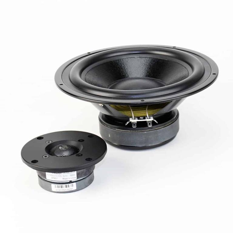

    Jon's 'Obi-Wan' project got me thinking about a few kits I have lying around, including one that is somewhat similar in that it is an 8" two-way. I'm talking of course, of Ben's (Wolf's) Zingers design. I purchased this at least a year or two ago from Meniscus since it was relatively low cost and seemed like a fun set of speakers. I've always wanted to try one of Ben's designs as well, so this seemed like a good opportunity to bust out the parts and see what I'm working with.
    This kit appears to still be available from Meniscus, which is a good sign considering parts availability for other speaker kits can be hit or miss. However, these particular parts have been around a bit - the Dayton Audio SD215-88 woofer and the Peerless DA25BG08-06 dome tweeter. Given the low cost of the kit, I elected to spring for the Clarity CSA cap on the tweeter. I did not, however, have them build this particular crossover for me, which was a mistake. Not because I can't do it myself, but they do good work and given the little mark up on their kits it's nice to throw them an extra couple of bucks. If you get one of their kits I highly recommend springing for the built crossovers.

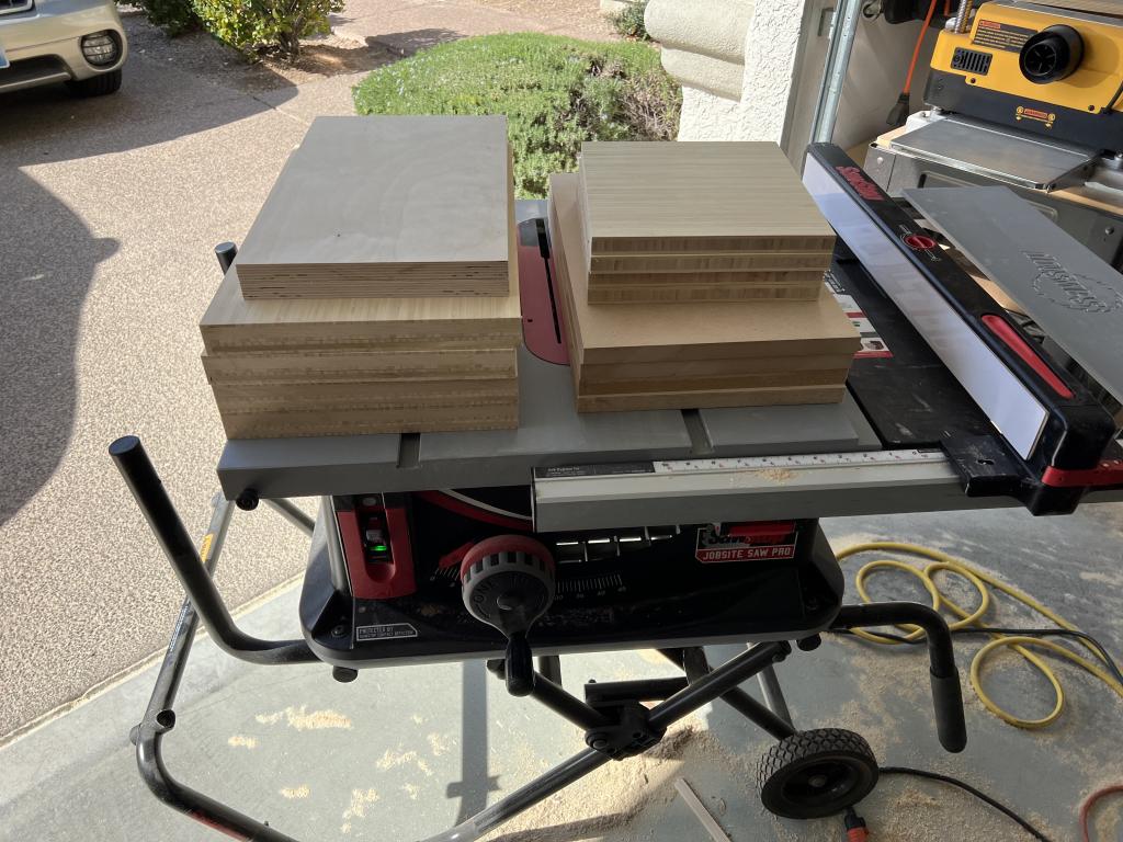

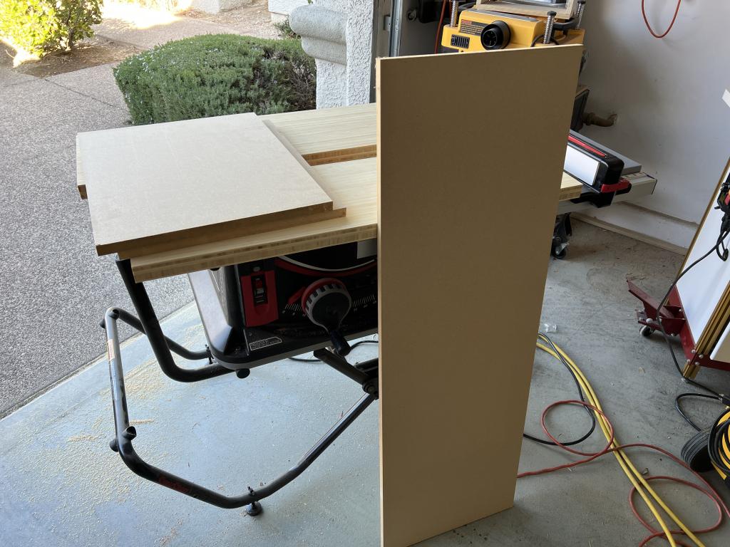

    Another part of this project was wanting to use up some of the copious scrap pieces of wood I have lying about in an attempt to better organize my garage. I found two nice chunks of Bamboo that were 1.25" thick - laminated for my failed Ardent go, but I had cut off the water damaged portions and this is what I had left. Only downside is they're about 0.25" too narrow for the 11.5" wide baffle the design calls for. Also, if I want to get both baffles and rears of the speakers out of the same stuff (I kinda do), they're also about 0.25" too short for the 18.5" height specified.

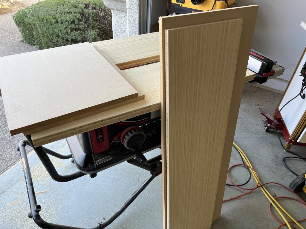

    Given the minimal difference in dimensions I've decided to use them and make the cabinet 0.25-0.5" deeper to keep the volume roughly the same.
    I also scrounge up a couple pieces of 3/4" MDF to use as the sides...

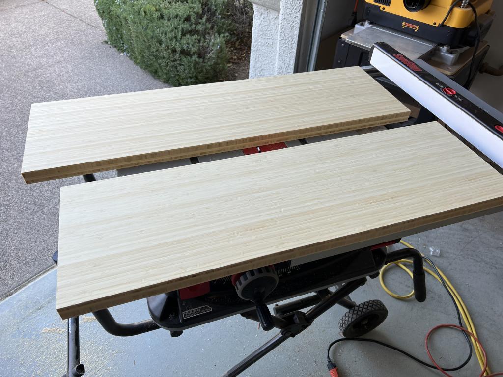

    Another 3/4" chunk of Bamboo to use as the top/bottom...
    And a nice piece of 3/4" Baltic Birch to serve as a pair of vertical window braces.

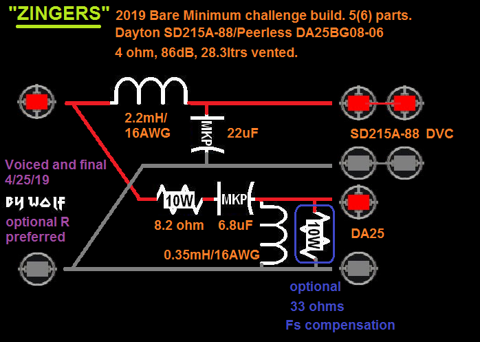

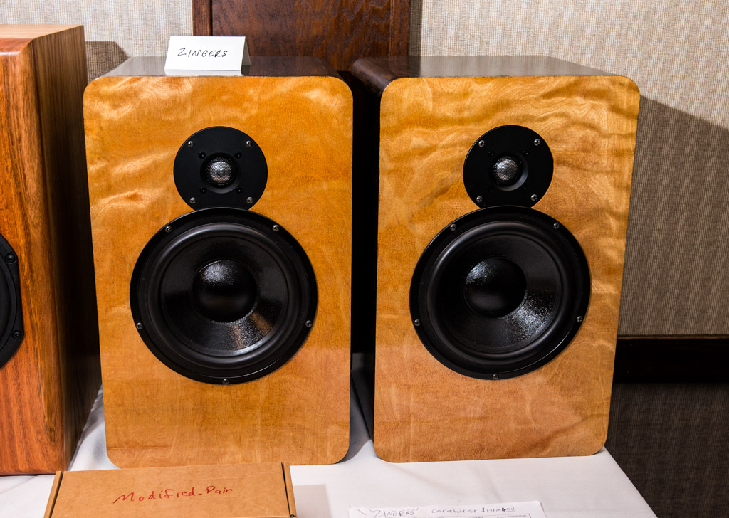

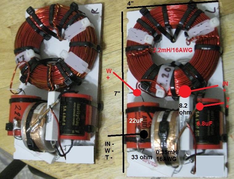

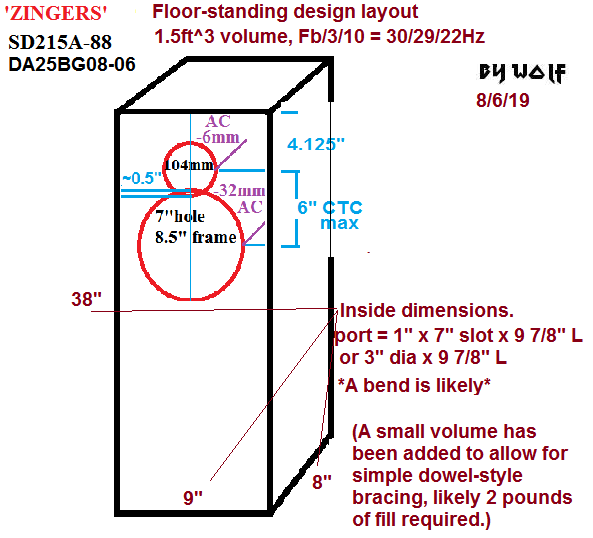

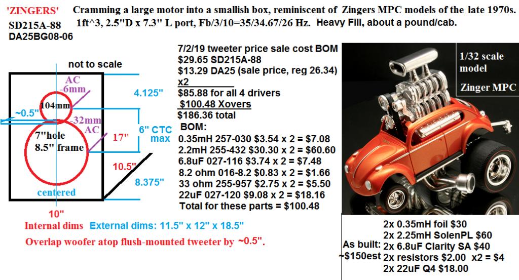

    Nice material! So, you're building the stand-mounts then I take it. I don't think there is enough wood there for the floor-standing version.
    Like I keep saying- these Zingers have no right to do what they can. I did most everything wrong on them from a typical speaker build. Also of note- the baffles should not have rounded edges as that actually makes the alignment between the drivers less effective. Your dimensional shift should be minimal vs my build.
    I'm glad you chose one of mine, and I hope they give you years of enjoyment!
    Let me know if you have any questions,
    Wolf

Name:	Zingers Xover Schematic.png
      This is interesting and I'll have to keep it in mind. There are a few blemishes on the baffle pieces that a big roundover would remove, so I might have to get creative with my sanding. Would a minor roundover (say, 1/4"?) be acceptable just to remove the edge, or is that hard edge a necessity?

        Funny thing about that kit- It was a kit before I knew it. We're all square and all, but the writeup build thread at PE has both boxes listed that Meniscus pulled the data from. The floor unit came out later, but not awfully long. FWIW, the stand mount will have more cone control due to the tighter air-spring, so I'm not really stressing either alignment.
        As to your question- Yes, a 1/4" or even 1/8" roundover should minimally affect things.

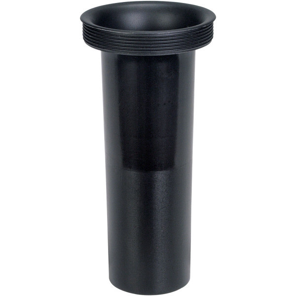

          Hey Ben, can you confirm the port is supposed to be 2.5" ID? The one that was sent with the kit has a 2" ID and it's throwing me off.
          • wolf_teeth
            • Feb 2011
            • 230
            Yeah, the stand-mount is as 2.5" diameter, the floor-unit is a 3". Don't know why Meniscus would supply a 2"....
            Wolf
              • 1577
              Interesting, what did you use for the tube? I'm having trouble finding 2.5" PVC locally, and it doesn't seem like the common port manufacturers make that size either. I found this one I suppose I could cut down.
              https://www.parts-express.com/Port-Tube-2-1-2-ID-x-8-1-2-L-Flared-260-478

                Electrical conduit, the grey stuff.
                Wolf
                  • 1577
                  Thanks, I'll see if I can track some down.

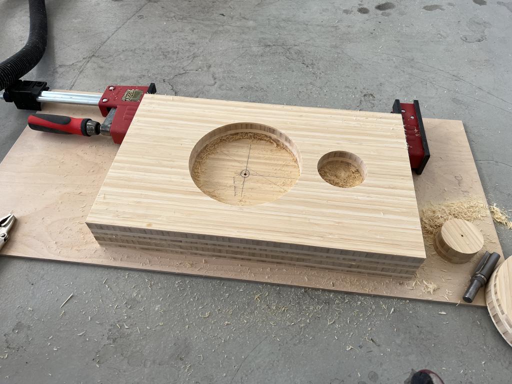

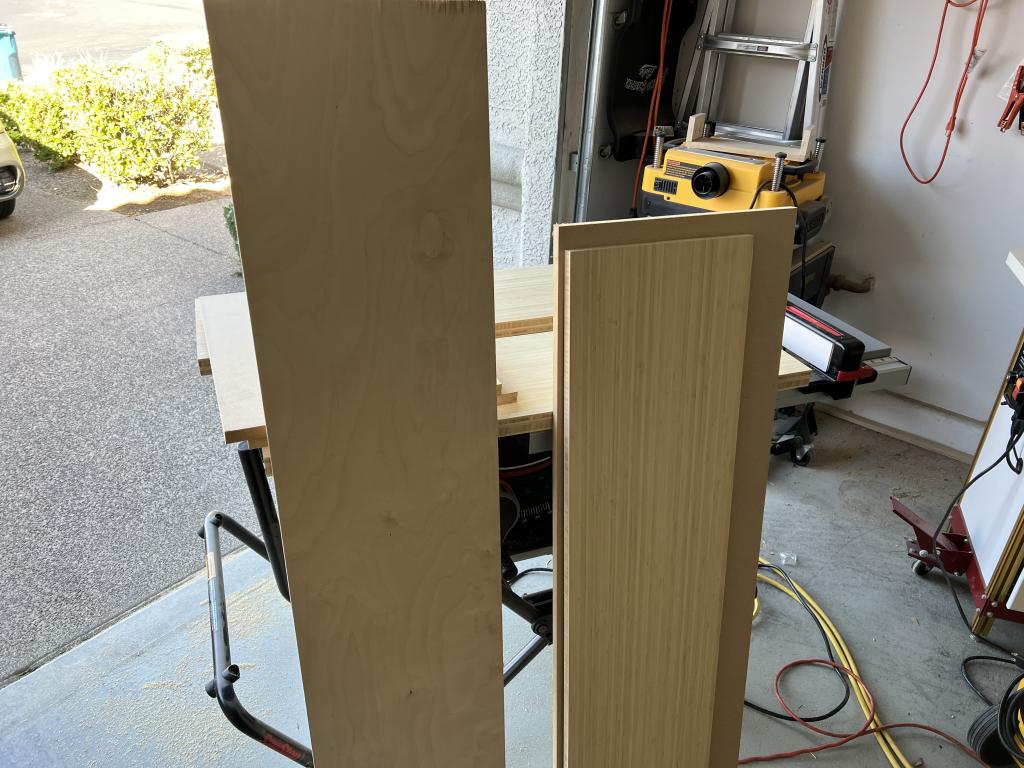

                    I took some time off this week to try and reset a bit. Unsure I made any progress on that, but I did move forward a little on this project. Only two mistakes so far, both classic Danny-isms (aka lack of patience). Figured I'd include them here, and my fixes, since to me that's the most interesting part of the build log. Someone told me a while back the difference between a good woodworker and a novice one is how well they cover up their mistakes. Not saying I'm 'good' by any means, but I'm....okay.
                    1. I used the wrong drill bit for the Jasper Jig pin on one of the baffles - 3/16 vs 1/8. This was originally going to be solved by clamping the good baffle (once holes were cut) to the bad one, then using a router to copy the pattern. That would have worked, except the bearing on the bit being used tore off at some point and I burned the baffle a bit, plus cut into places that should not have been cut into. This only affects the tweeter, which is unfortunately since now I'll have to use a pattern to cut the recess. Haven't gotten around to solving that problem yet. What I ended up doing to finish the job was to keep the baffles clamped and used a jigsaw with a 4" blade to rough cut the hole, then used a different router bit to clean it up. Worked like a charm.
                    2. On my first glue-up (one side + one top/bottom) for each speaker, I failed to use anything to ensure it was square. Of course they are not square now. Adding the internal brace helped solve this problem, but it's still at least 1/8-3/16ths out of square. Plan is to just move forward anyway and hope no one notices.

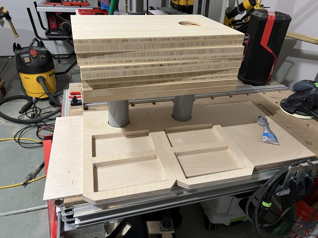

                    Rough cut of all pieces.
                    Baffles being made. You can tell that the bottom baffle here has the wrong pilot hole in it for the Jasper Jig. This picture was probably taken about the time I was figuring out the best approach to cutting through it.
                    Braces.
                    Ports being attached to the braces. I use Goop for this, seems to work pretty well. At least it's better than other adhesives I've tried.

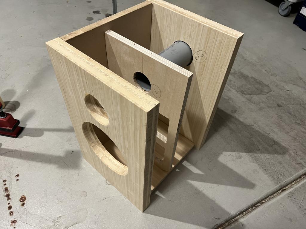

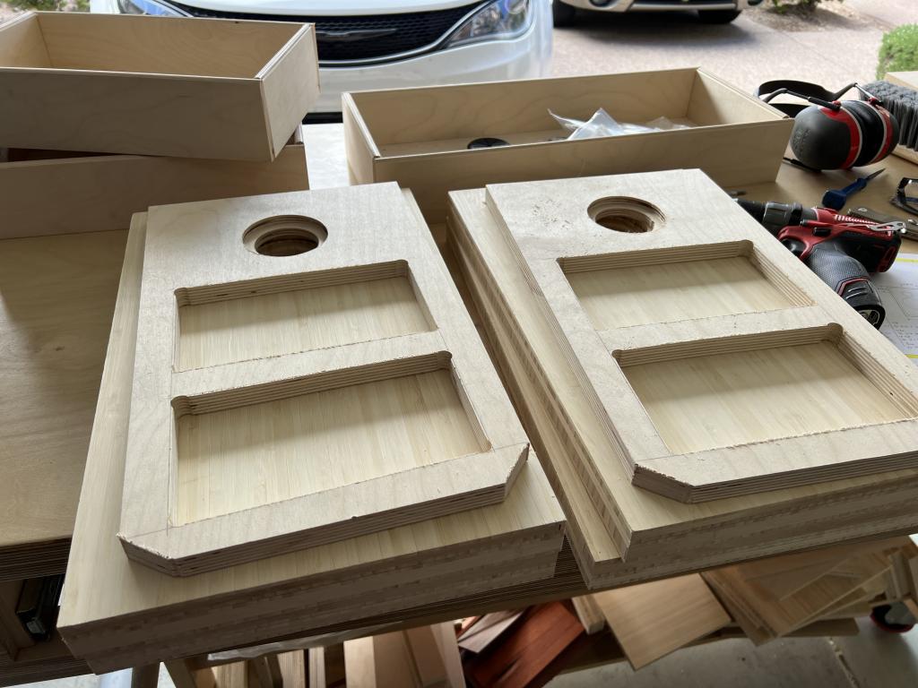

                    Mock up. You can just barely see this is the baffle where I screwed up the tweeter cutout, it isn't completely circular.
                    I should point out I'm making my own ports for this. I found the conduit Wolf recommended, albeit in a 10' length, and recessed that into both the brace and the rear of the speaker. This will then be cleaned up and rounded over, making for a flared port at both ends. If I remember correctly, you count roughly half the flare as part of the length of port, so I ended up with around a 7 inch piece of PVC, with the rest of the length taken up by the roundovers. That part is going smoothly so far, though I had to think a bit on making sure they'd line up correctly. I do hope I have other projects with 2.5" ports coming up though...unsure what to do with that honking piece of PVC!
                    I do this often enough I should probably make a jig to cut PVC 'straighter', but that 4" jigsaw blade does a pretty darn good job too.

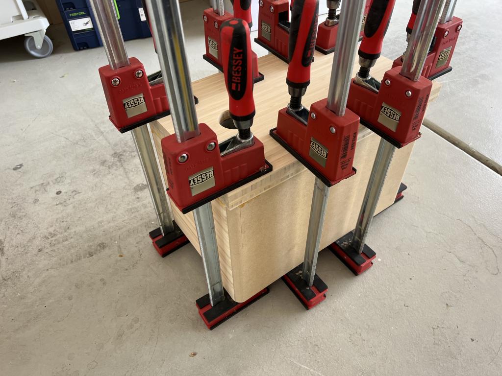

                            Made a little progress today. Cleaned up the glued joints, rounded them over, then adhered the back piece to the rest of the cabinet. Will glue the other one tonight or tomorrow morning...I could use a few more clamps.

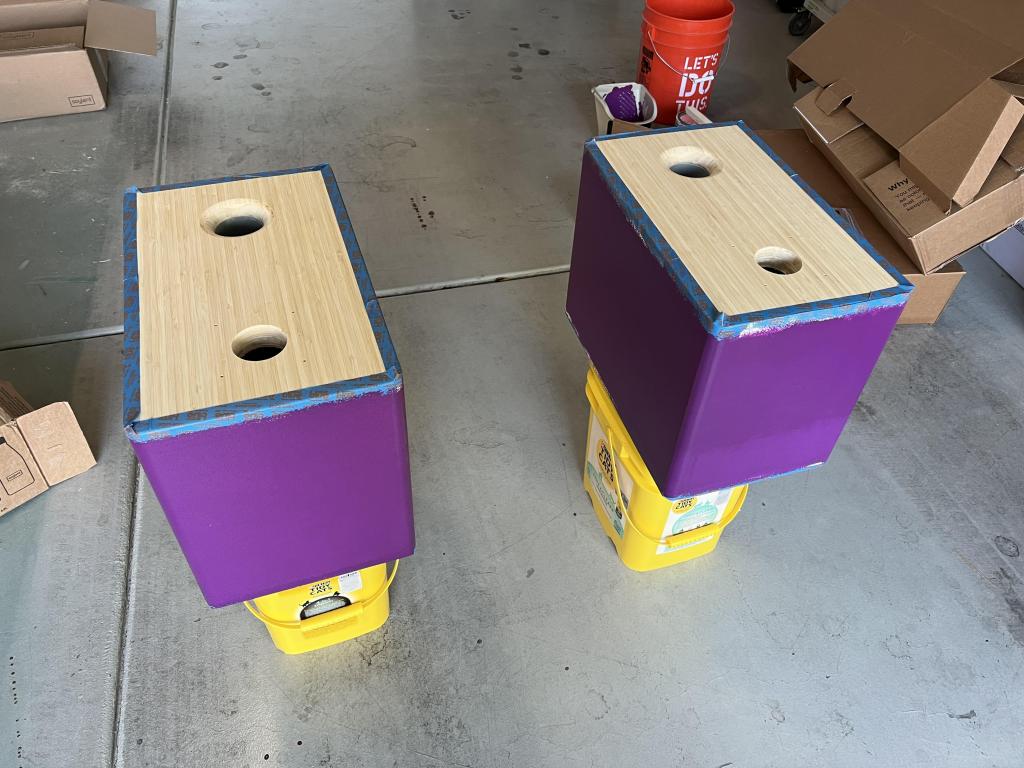

                                  Skipping some updates regarding sanding and such, but rolled on my second coat of paint this morning. I couldn't find a shade of red at Home Depot that I liked but did see a purple that called out to me.

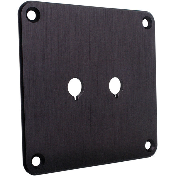

                                  Click image for larger version  Name:	unnamed.jpg Views:	1 Size:	102.0 KB ID:	866740

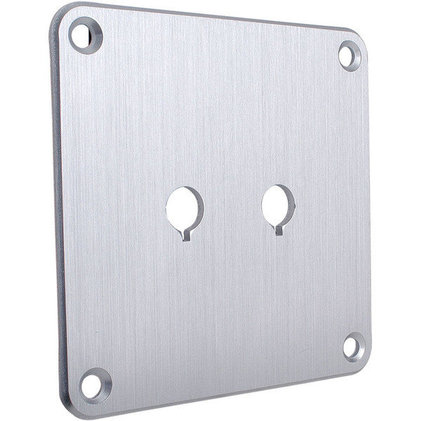

                                  I currently have black input plates for the terminals but I'm reconsidering that now. Any thoughts on black vs. silver aluminum with the color combination I have?
                                  https://www.parts-express.com/Dayton-Audio-SBPP-SI-Binding-Post-Plate-Silver-Anodized-091-600

                                  Dayton Audio SBPP-BK Binding Post Plate Black AnodizedLooking for a higher-performance alternative to standard terminal cups? The Dayton Audio binding post plates are the answer. Made from 0.110" brushed aluminum, they are available with silver or black anodized finishes. A pre-installed gasket and beveled outside edge allow easy installation without requiring time-consuming recesses. Simply attach your choice of binding posts to the plate, cut a hole in your cabinet with a jig saw or hole saw, and screw in place. Designed to work with your choice of Dayton Audio Premium Binding Posts.Specifications: Black anodized finish, accommodates one pair of binding posts, overall dimensions: 4" W x 4" H, maximum cabinet cutout: 3" W x 3" H, hole spacing: 30 mm.

                                      Thanks Carl! I'm thinking I'll do a black plate with the nickel/chrome binding posts, then see about finding some chrome hardware to install the drivers with to match the look.

                                        I could go either way with silver or black. That would be a tough choice for me. I really like the purple color. It’s funny I say that because I keep complaining at work about how our slide decks have way to much purple. I guess I like this shade way better!!
                                        Painter in training

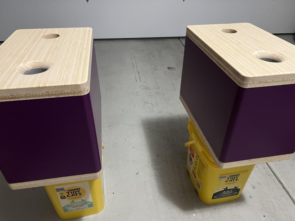

                                          • 1577
                                          The purple looks even better under more reasonable lighting...
                                          I'm honestly thinking of leaving the bamboo raw, I really like how pale it is compared to the purple. Unsure I'd like it as much if I clearcoat it, but it may be necessary. Any thoughts on that? I'm not concerned about humidity given my location.

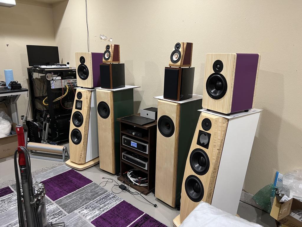

                                                                  They are very, very easy to turn up too! While current placement is far from ideal, they still sound great. Quite room filling, and I imagine they'd work fairly well outdoors as well. I'm not sure what else to say, I threw everything from vocal/jazz to metal at them and really didn't find any obvious faults. They're also more forgiving of the source material for some bad metal/rock albums I have. I'm very pleased, just need to find somewhere to put them!

                                                                    Come on, Dan- how you like the bass? They dig deep, and are very clean in that area.
                                                                    But you are correct- I was very stunned at them turning out so well. I did a lot "wrong" (as accepted best practices go) on them, and they excel well at most recordings. They are a bit forgiving, but that is due to the way I eased the tweeter into summation. These do not get the dreaded peak that 8" 2-ways are famous for having if done wrong or without a waveguide. I don't feel they lack for vocals just above xover, but that would be the spot where they are not the best or precisely transparent. The HD of the woofer is great in the lows, but only decent in the upper end.
                                                                    I had wanted to try the woofer in a 2-way for awhile with the older RS28, but never got around to it. I am glad I waited and used the Peerless, as it hits all the marks.
                                                                    And yes- metal they do! If you have not heard the new "Meshuggah - Immutable" album, give that a whirl, or maybe my reference piece "Circle of Dust - Brainchild".
                                                                    Enjoy, and thanks for the rave!
                                                                    Wolf
                                                                      • 1577
                                                                      Bass is fantastic, really brings the 'boom' on songs that need it, but is tight enough for rock/metal.
                                                                      I added the Meshuggah album to my Amazon cart, but am having trouble sourcing Circle of Dust - must be limited runs of CDs? [edit, nvm, found them on Bandcamp]
                                                                      I've listened to Kauan - Ice Fleet, Archspire - Bleed the Future, Tool - Undertow, and 1914 - Where Fear and Weapons Meet. Very pleased with all of them, though Ice Fleet almost made them sound boxy - need to play that again on the Ardents to see if that's the intended sound or if I need some additional stuffing. I threw some Melody Gardot, Kacey Musgraves, and the new Robert Plant/Alison Krauss album in there too, to lighten things up a bit - also good.
