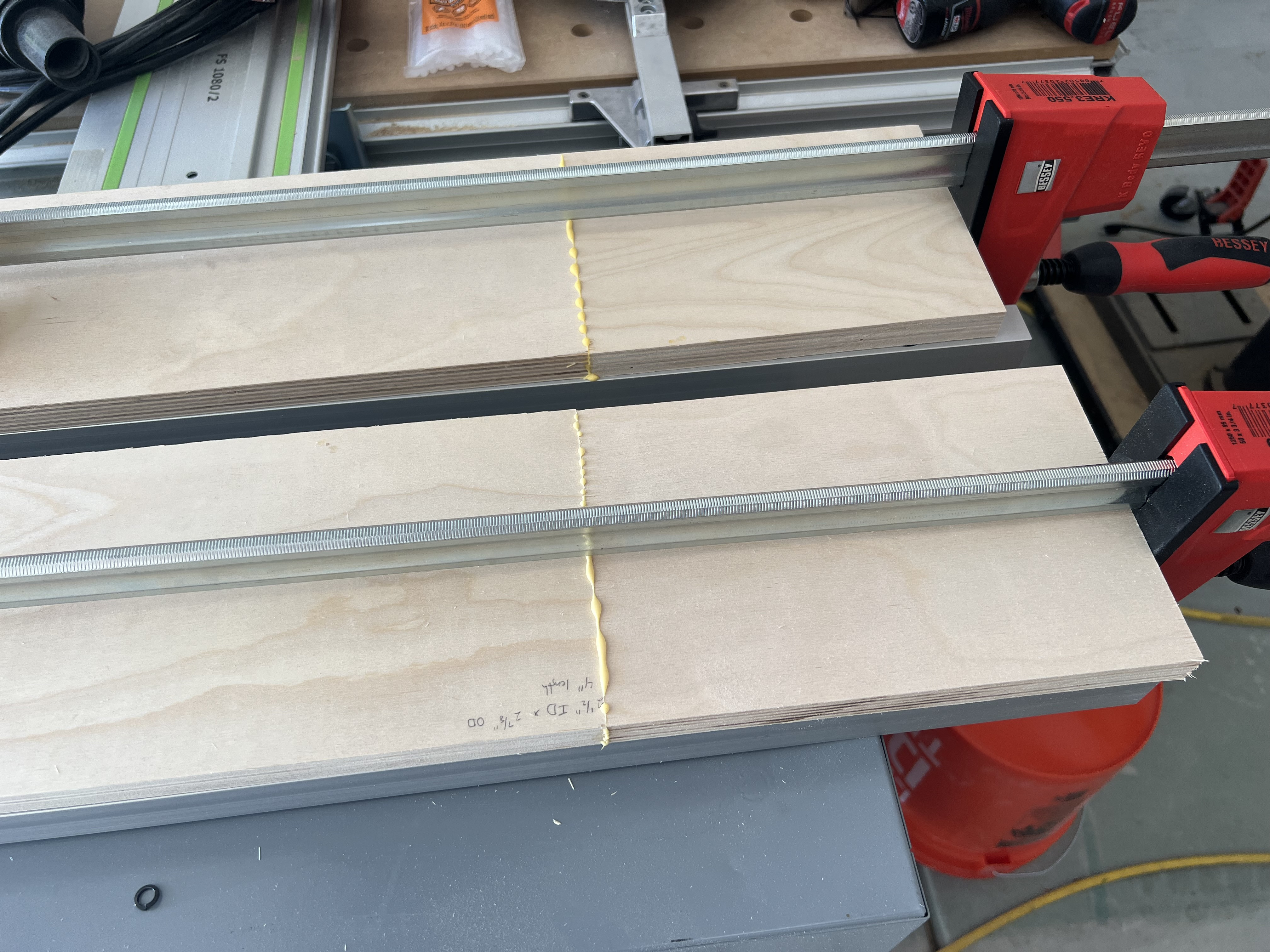

    Click image for larger version  Name:	IMG-0418.jpg Views:	4 Size:	2.30 MB ID:	933711
    Click image for larger version  Name:	IMG-0419.jpg Views:	4 Size:	2.96 MB ID:	933712
    Click image for larger version  Name:	IMG-0420.jpg Views:	4 Size:	2.62 MB ID:	933713

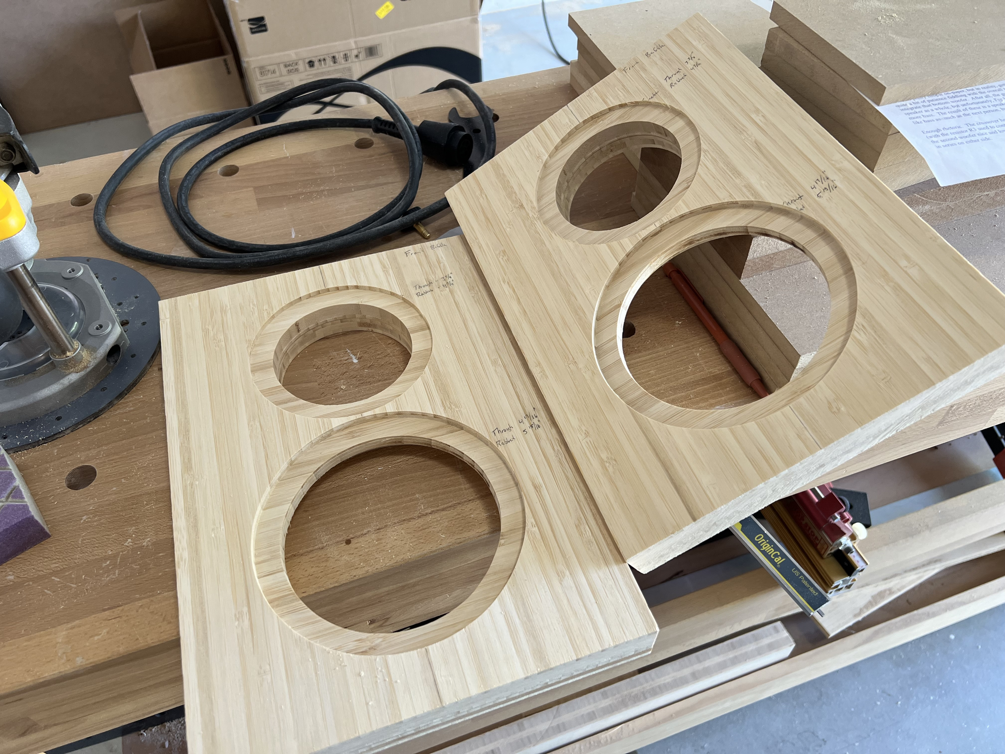

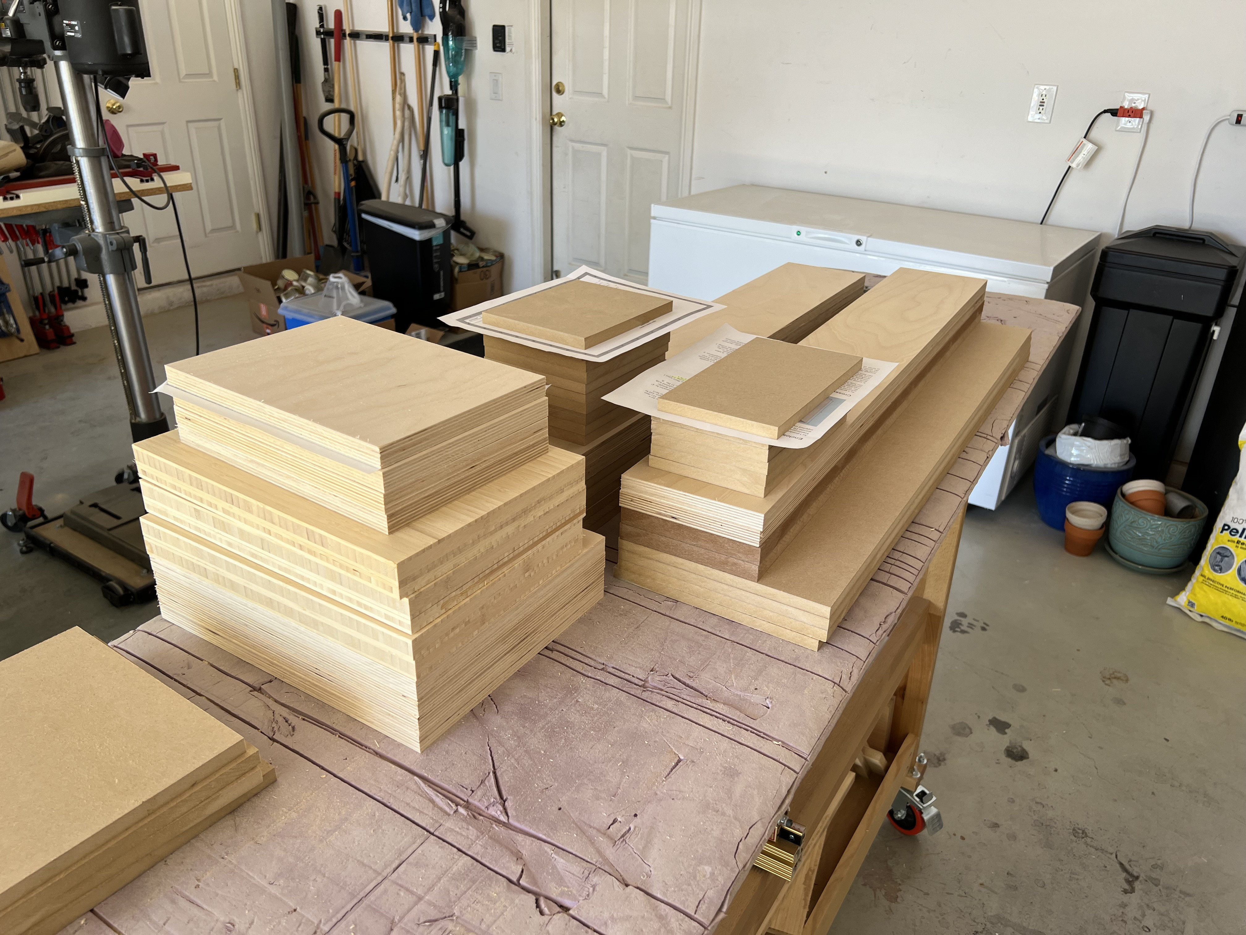

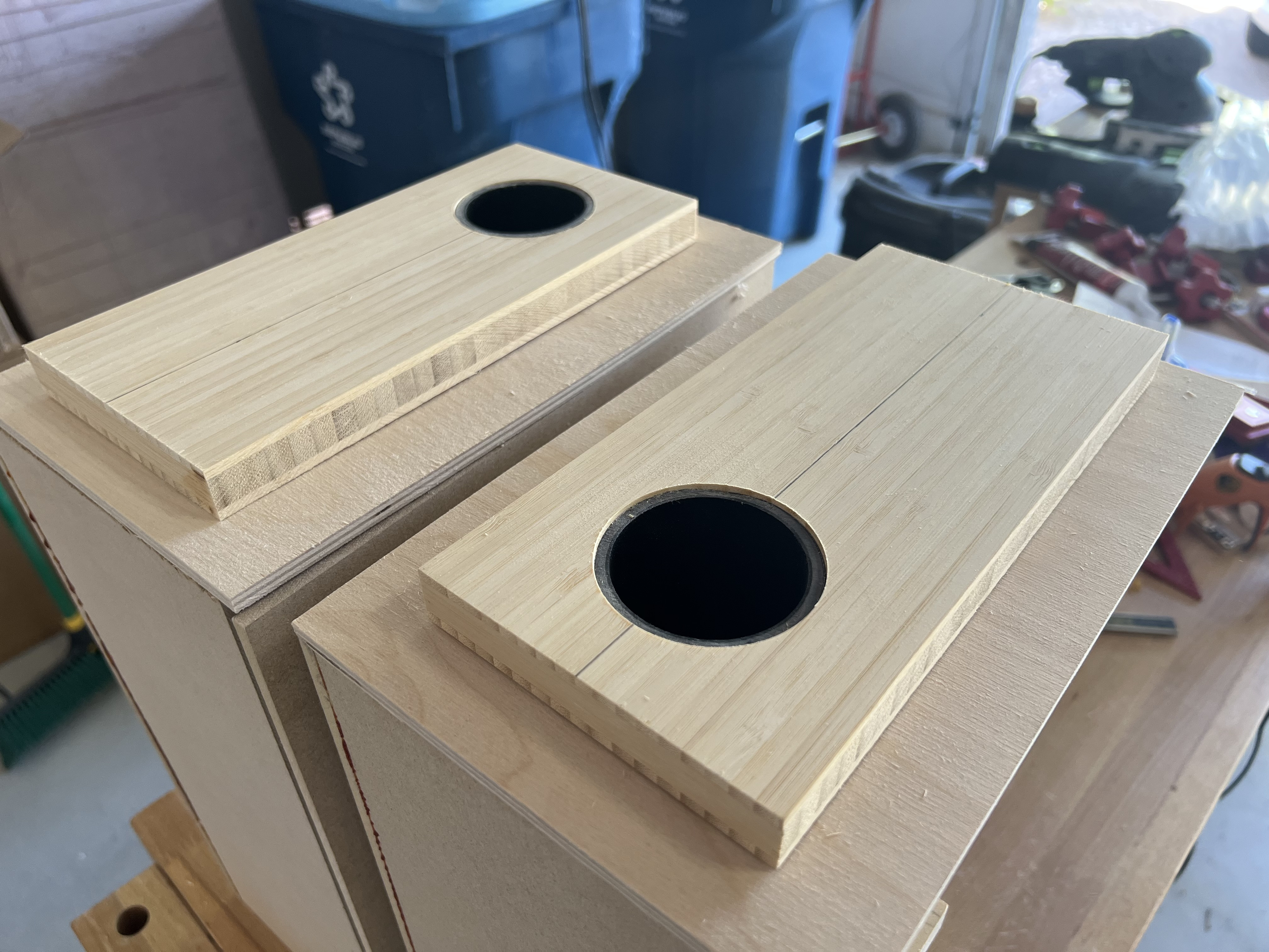

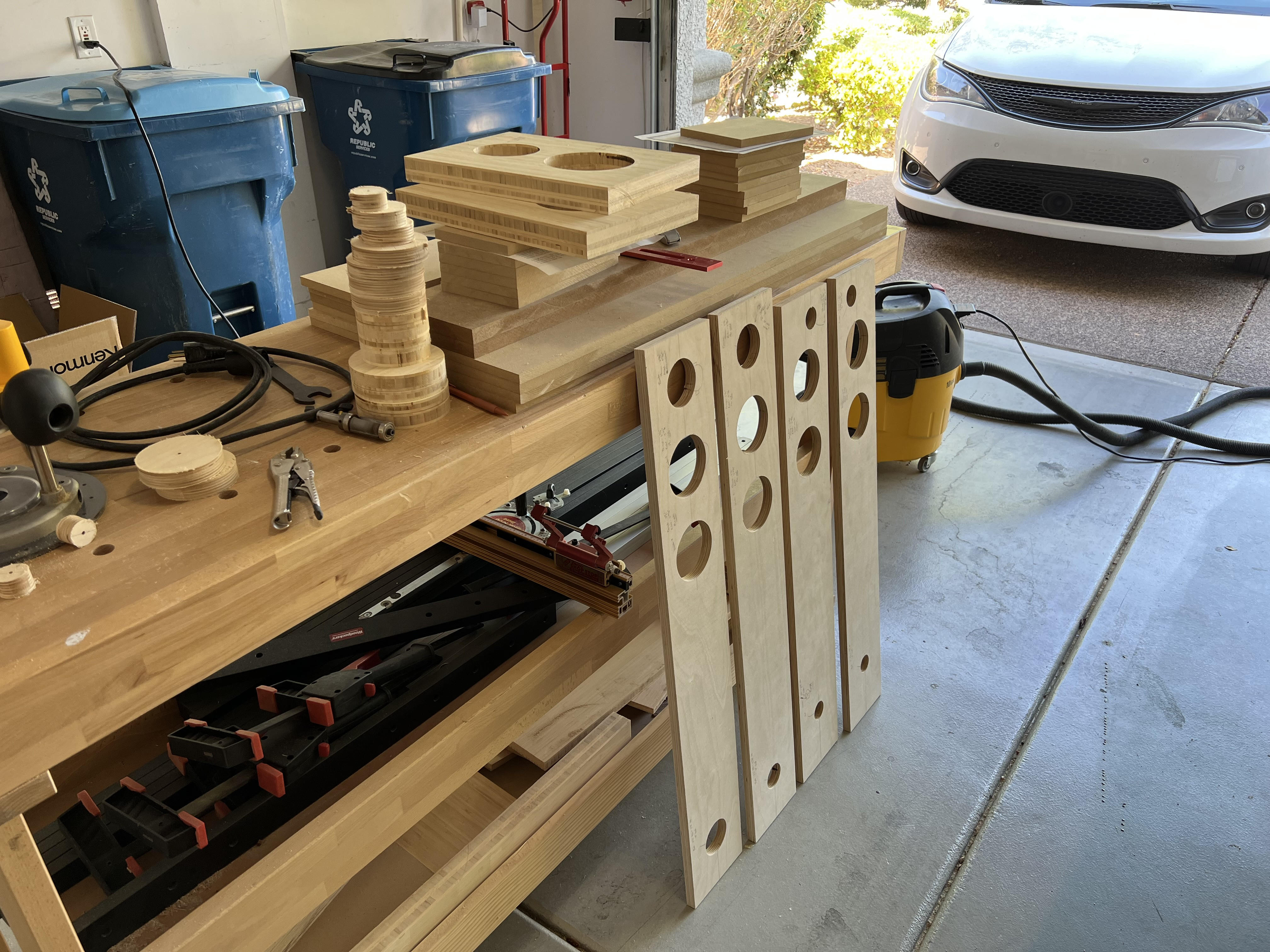

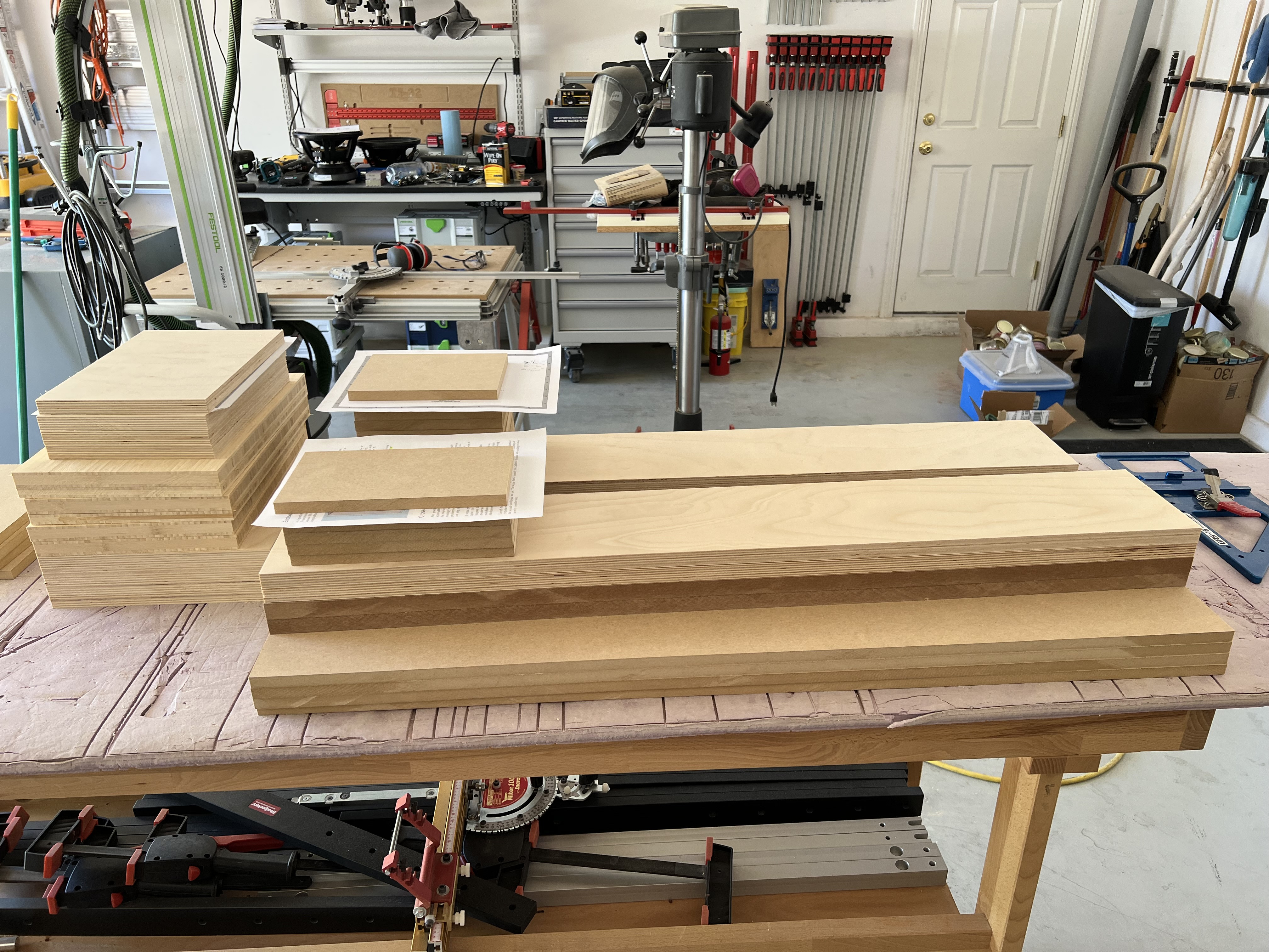

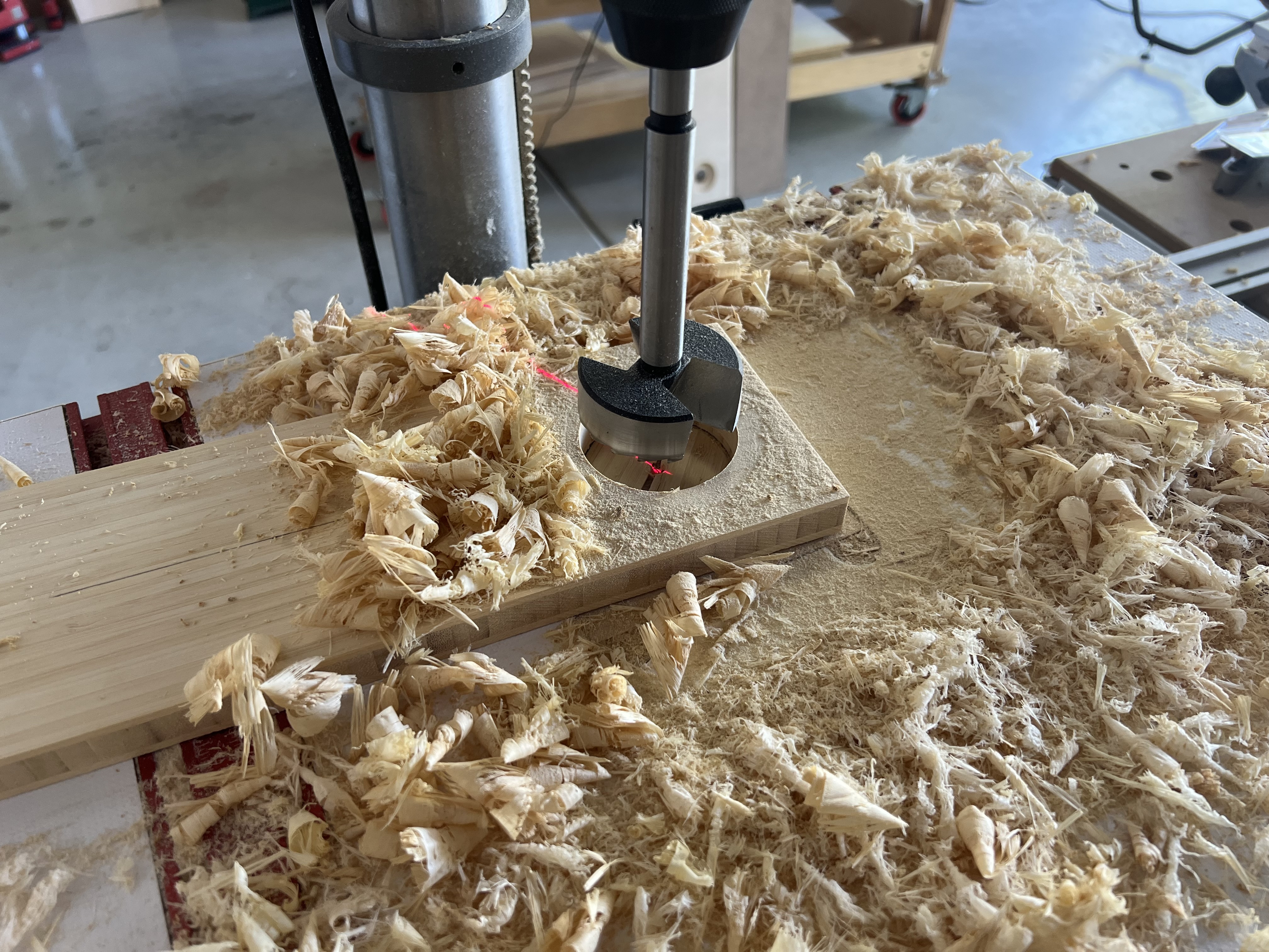

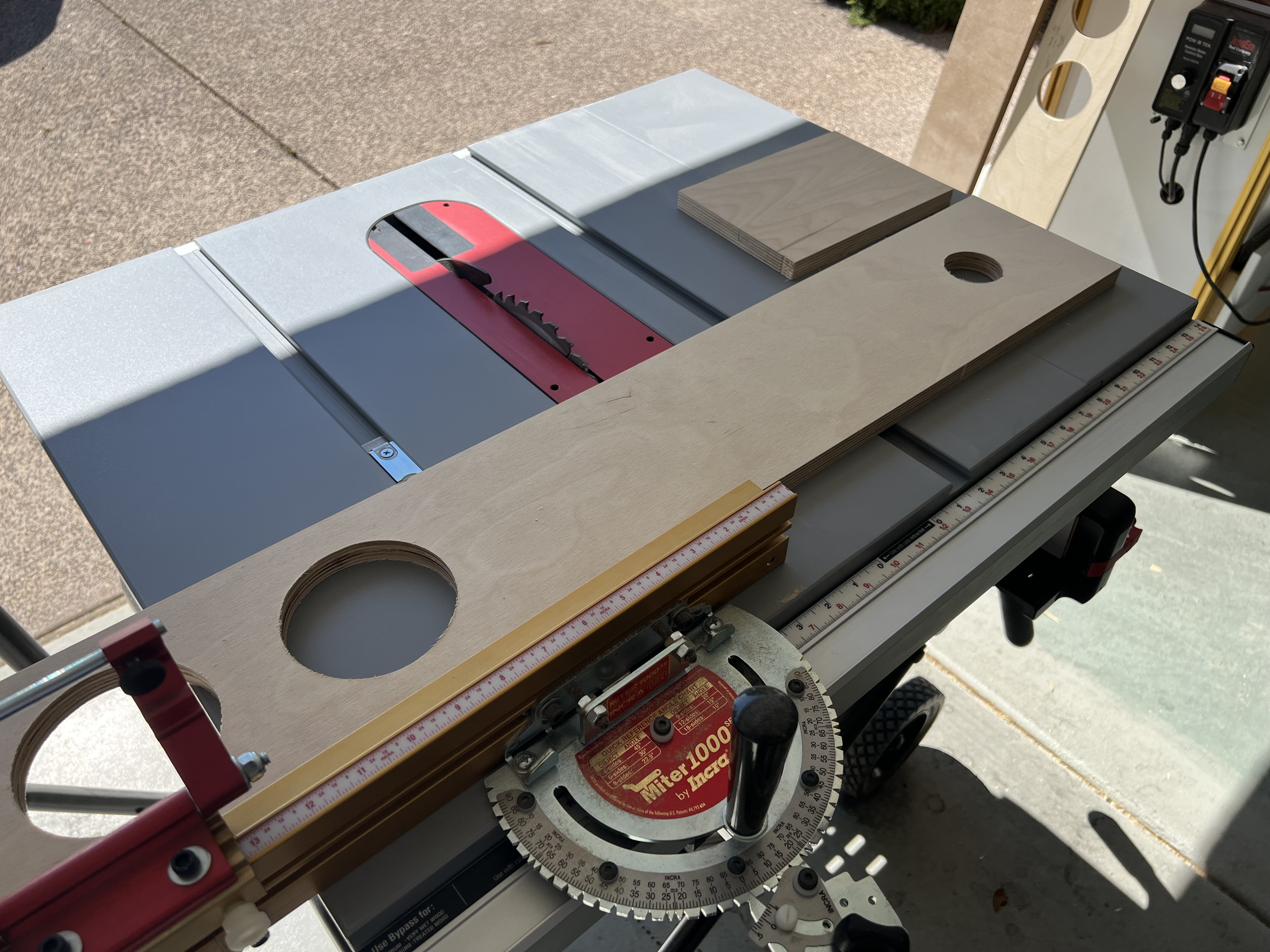

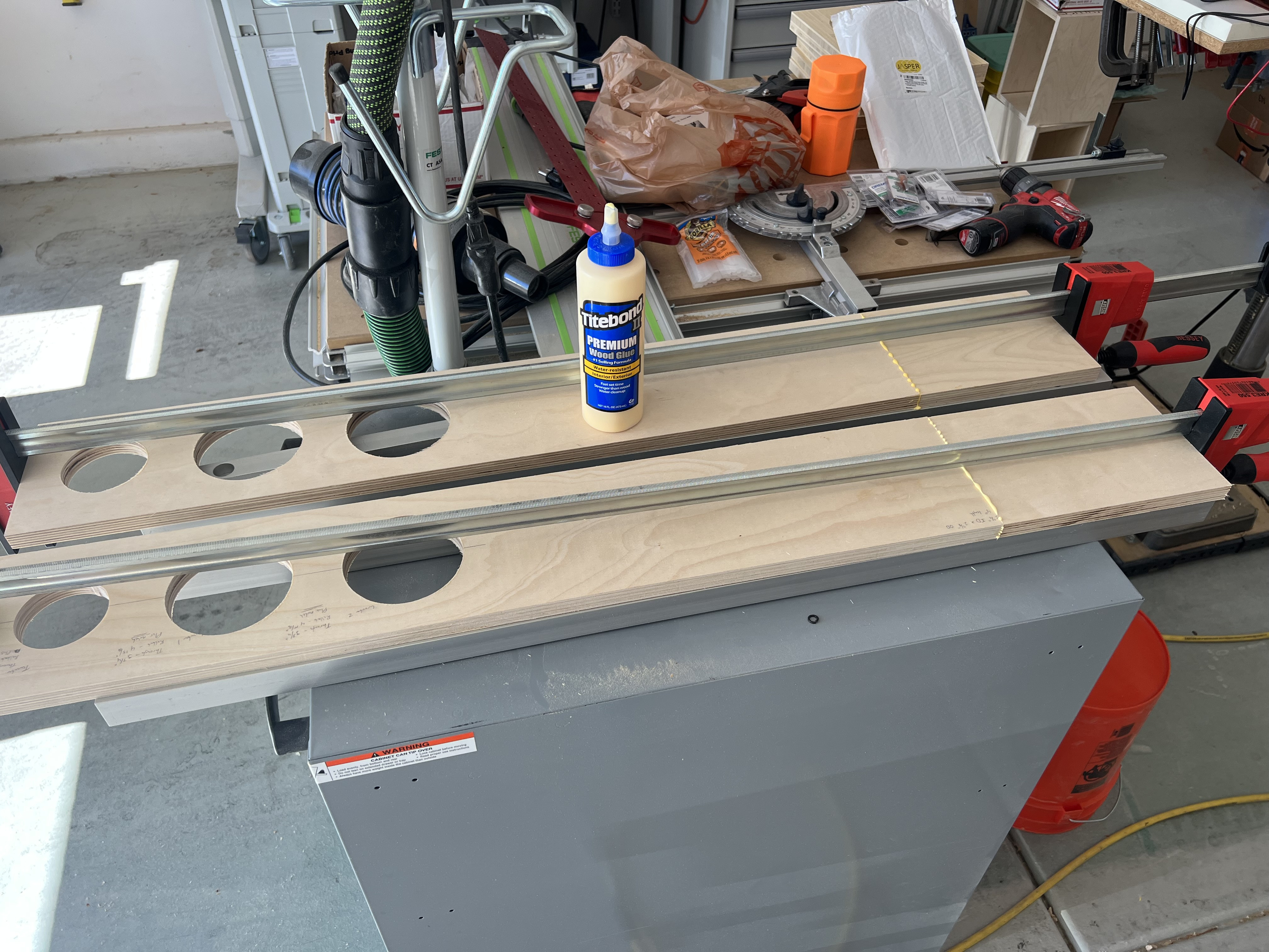

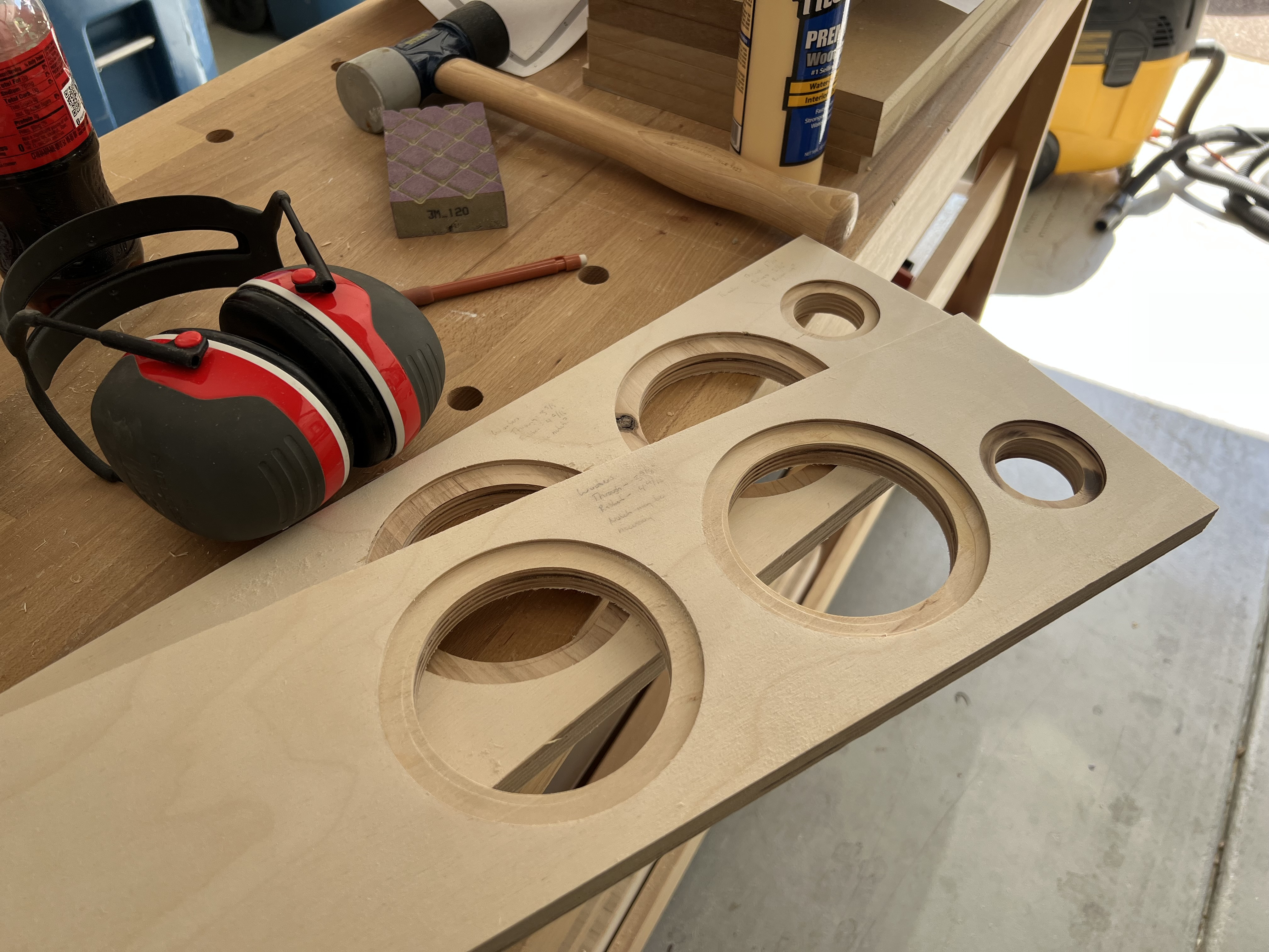

        Well, I did a little work last weekend cutting all the necessary holes. Turns out it might not be smart to do all three of these at once as I messed up on several. Fortunately, most were just cut a little small so it was reasonably easy to fix with a small rabbet bit and a flush trim bit. However, one port hole was cut too large (by maybe 1/8"-3/16") and I'm still trying to figure out how I'll fix that. It's an odd size (2.5" ID) so I have to make it myself - no buying a precision port for this project.
        Also, I'm unsure if I want to rabbet the drivers for the towers. Given their likely use case I am not concerned about edge effects, and more concerned about aesthetics and how I'll finish them.

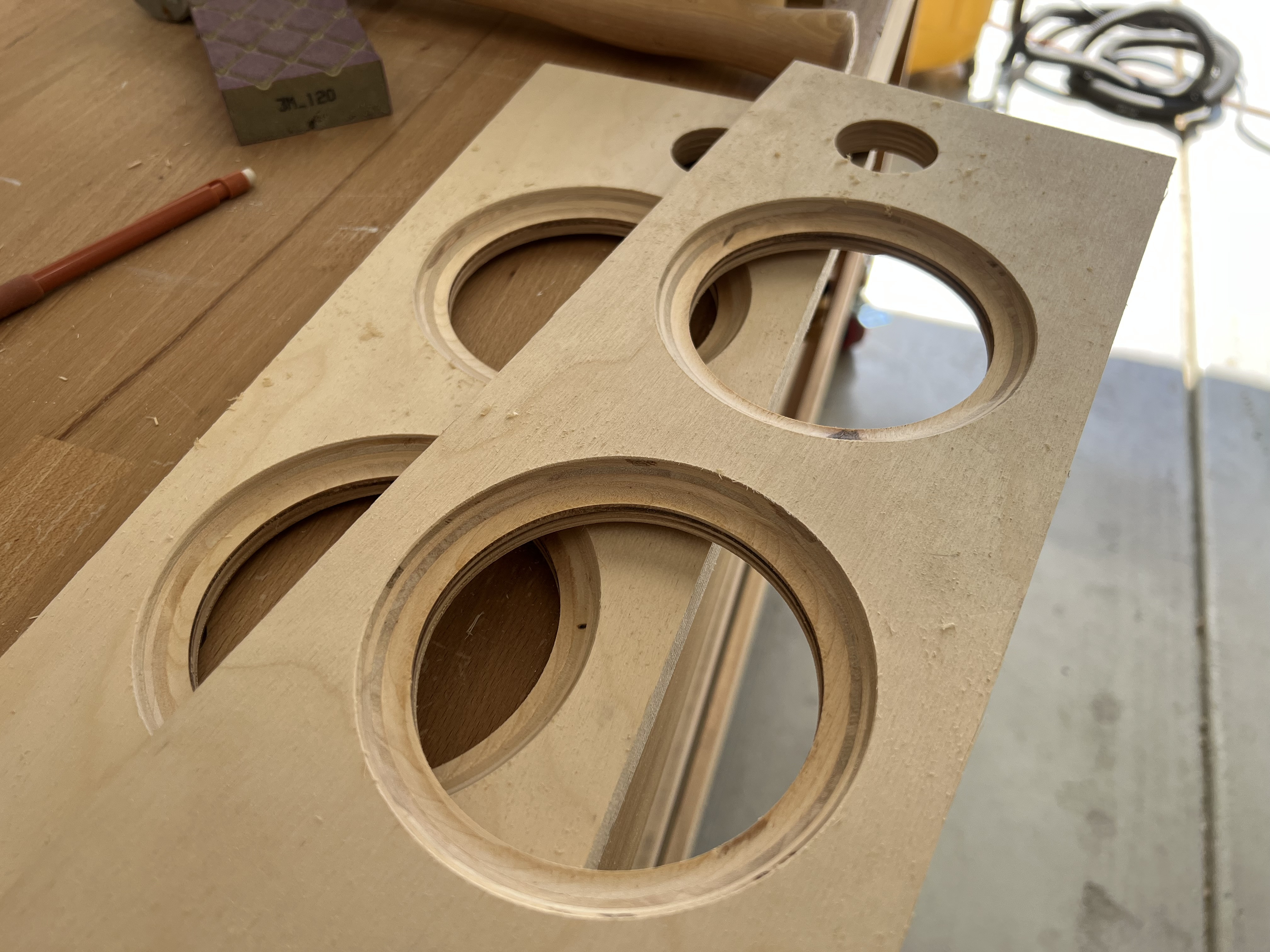

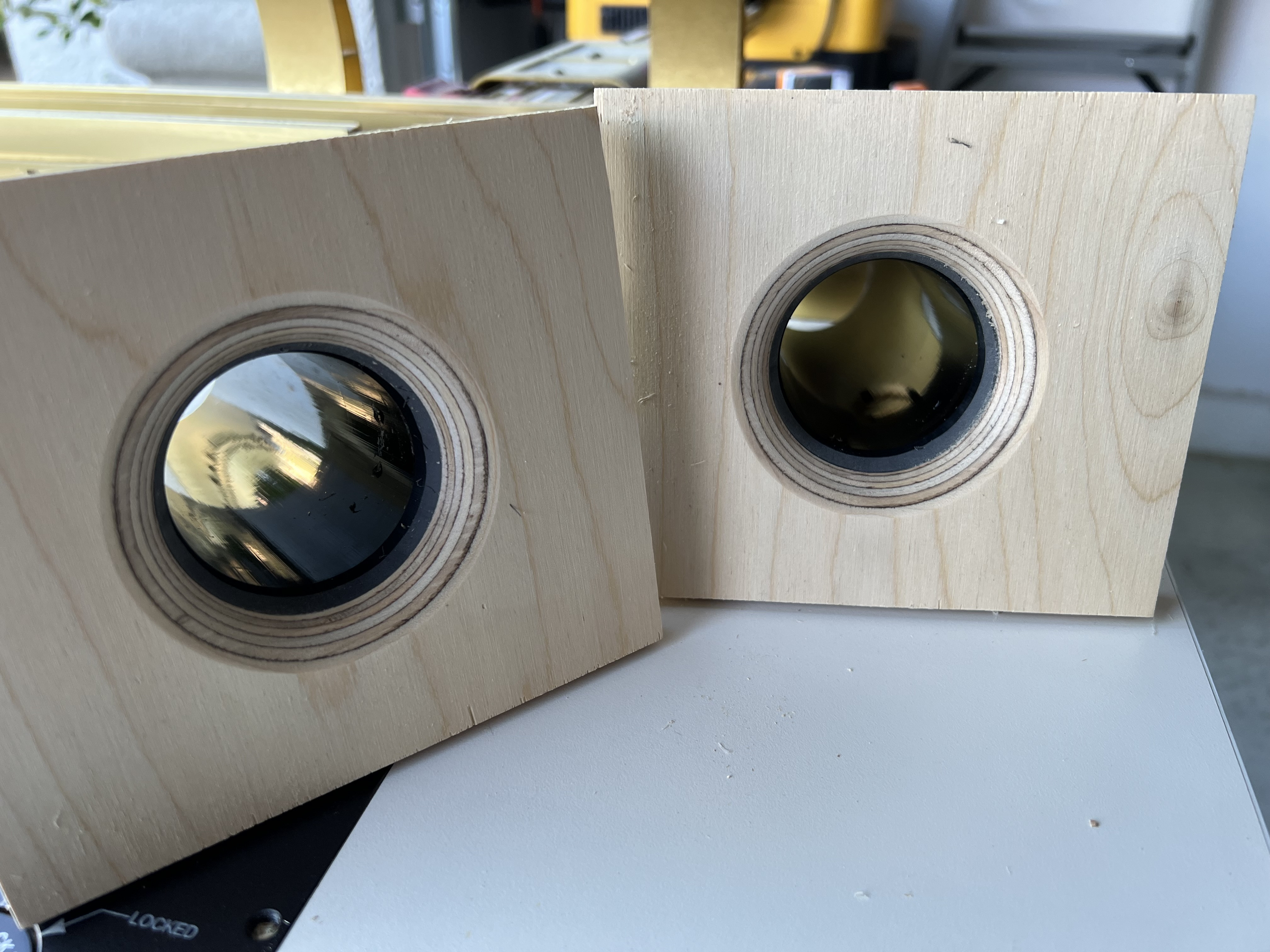

        I did flush mount the drivers for the bookshelf speakers. The tweeter is a VERY snug fit, so I might have to widen that by a smidge before finishing the bamboo.

        Hoping to get back out there this weekend. I think it might be time to start gluing up the rest of the boxes.

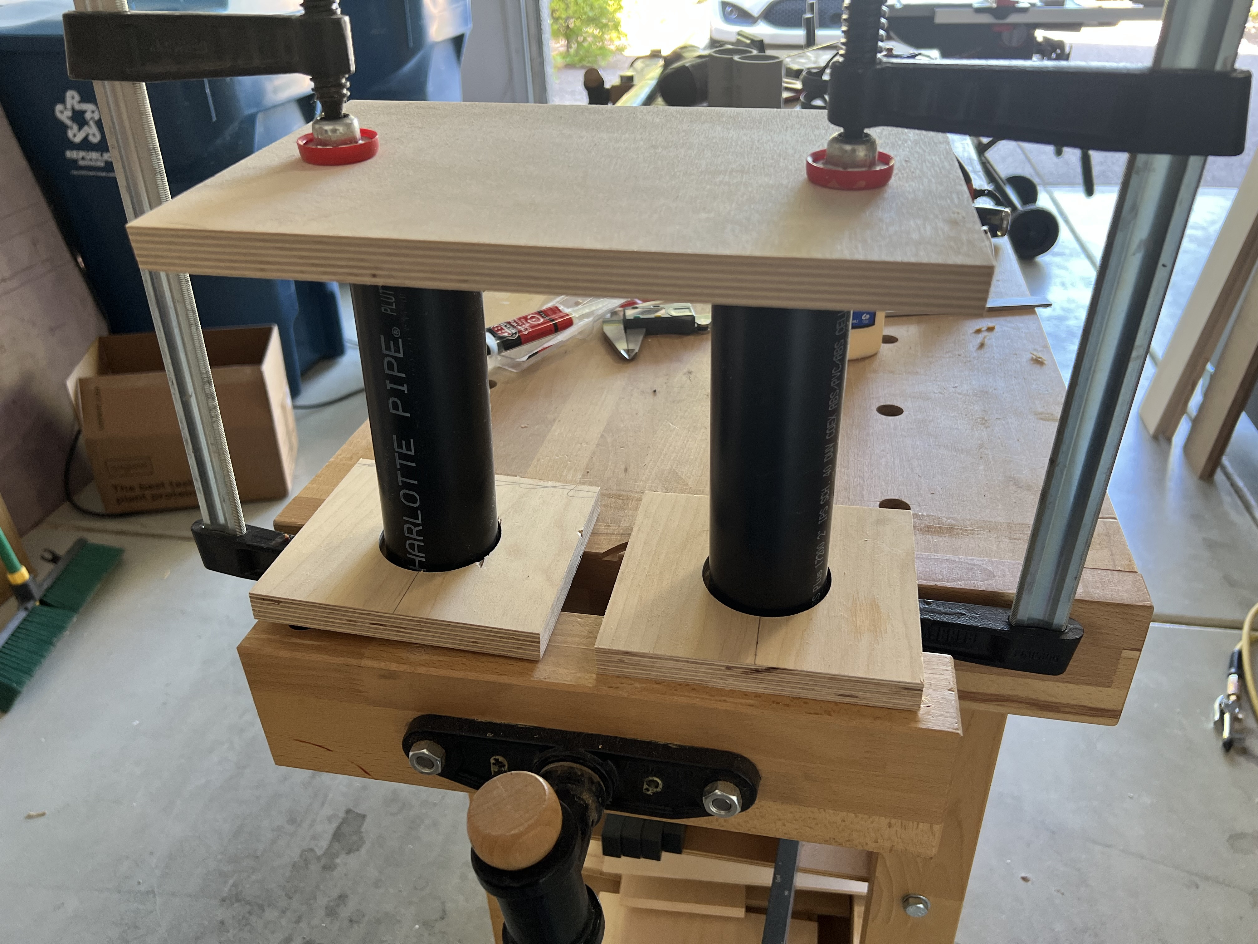

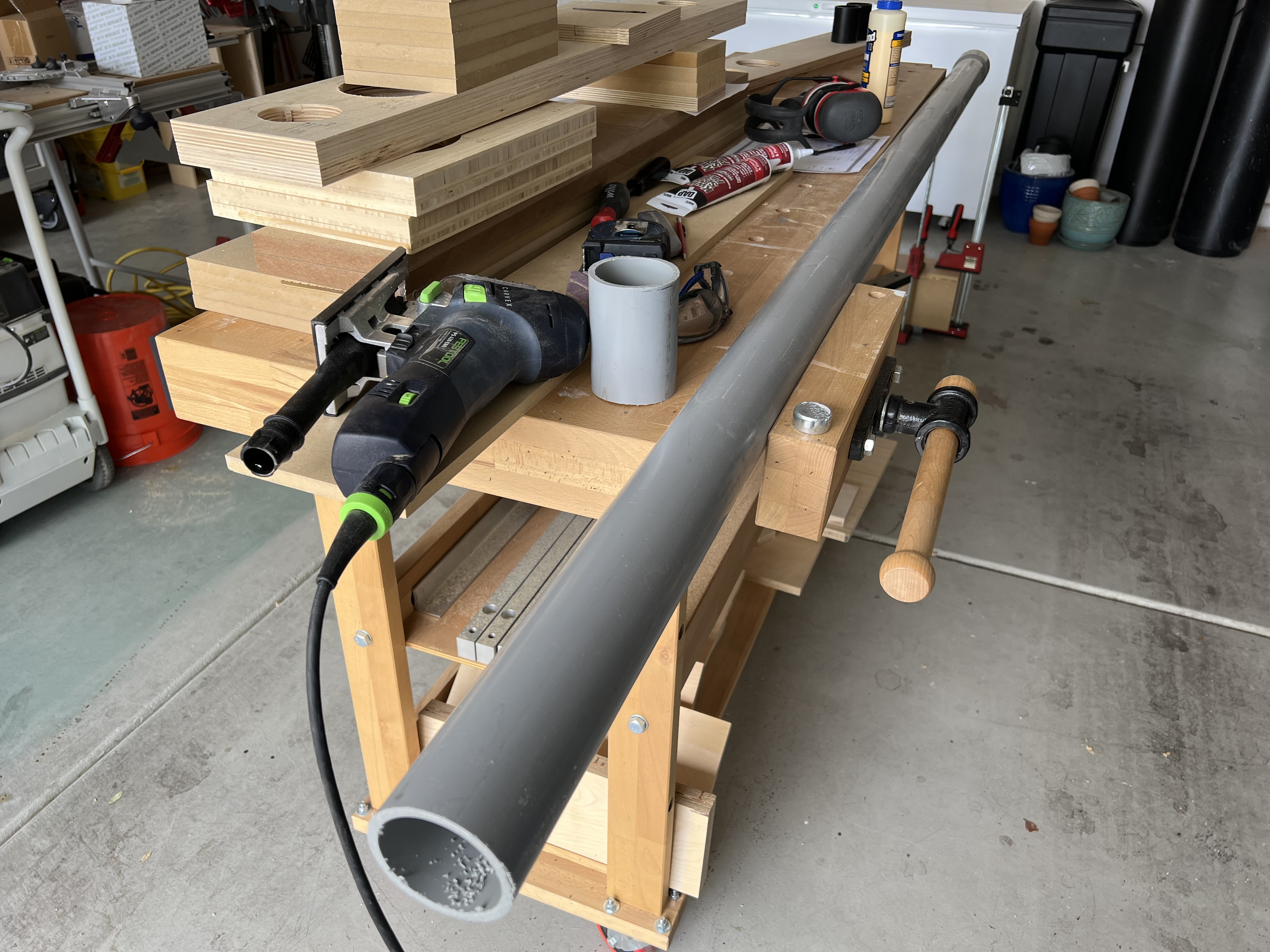

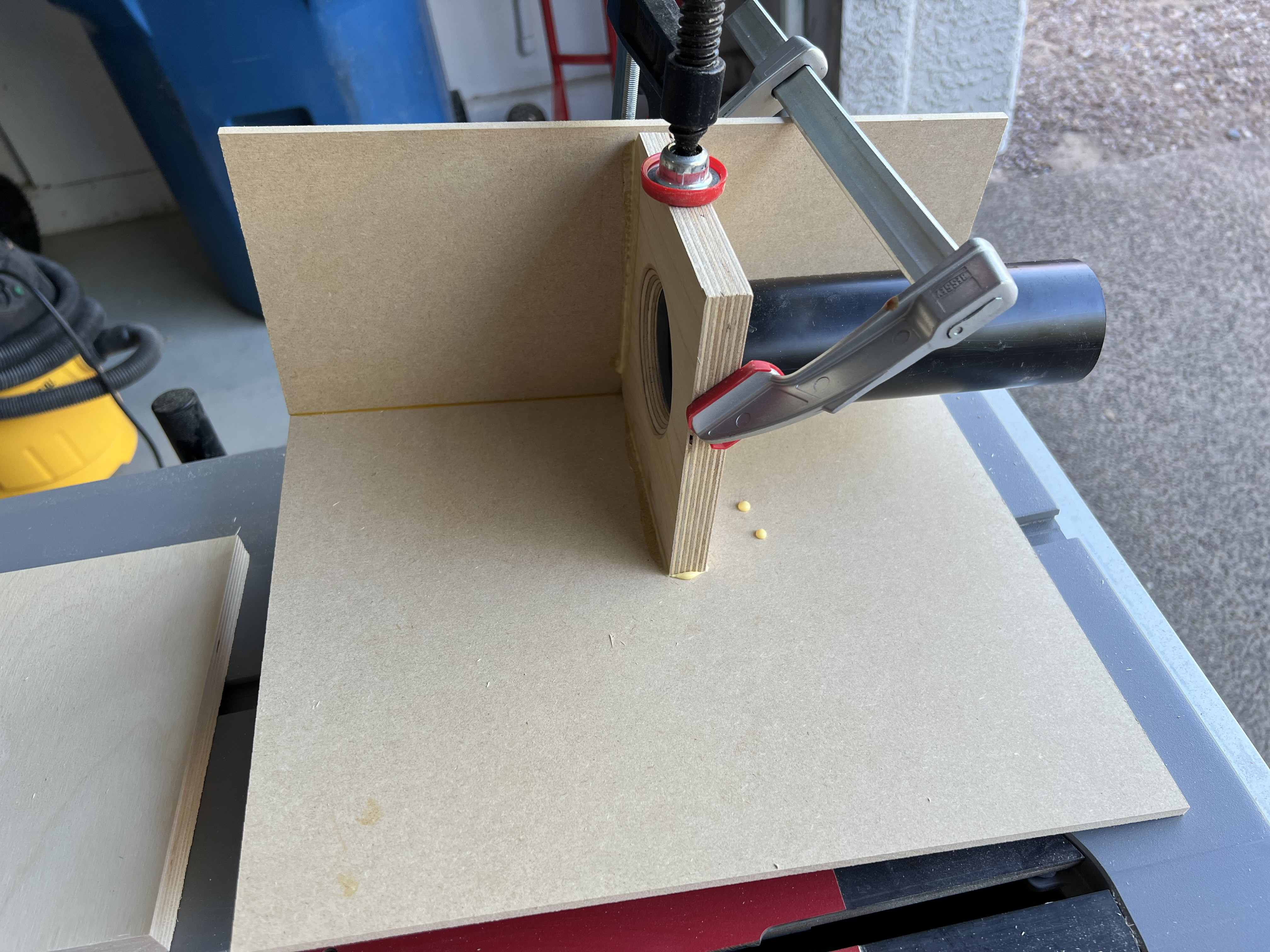

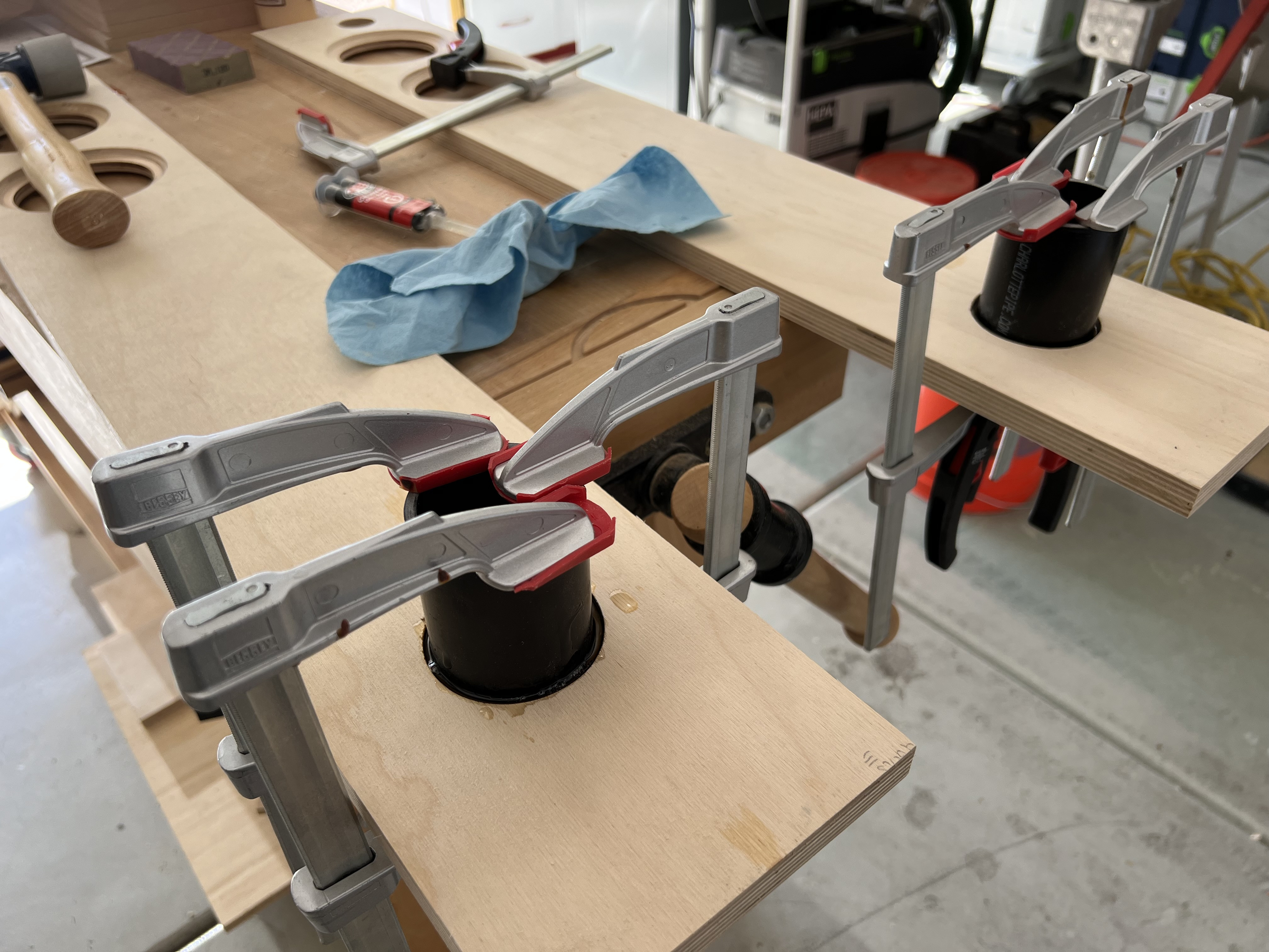

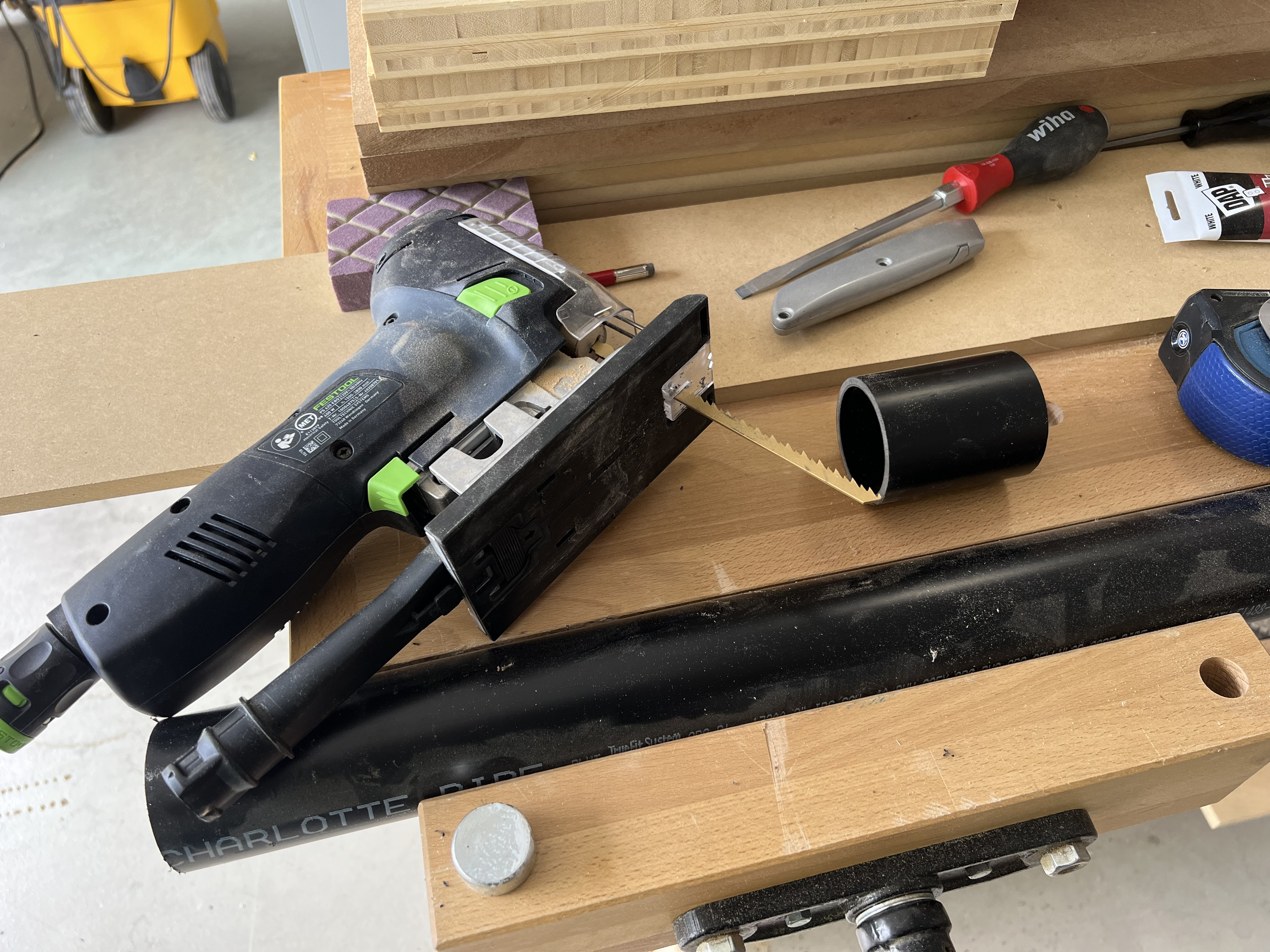

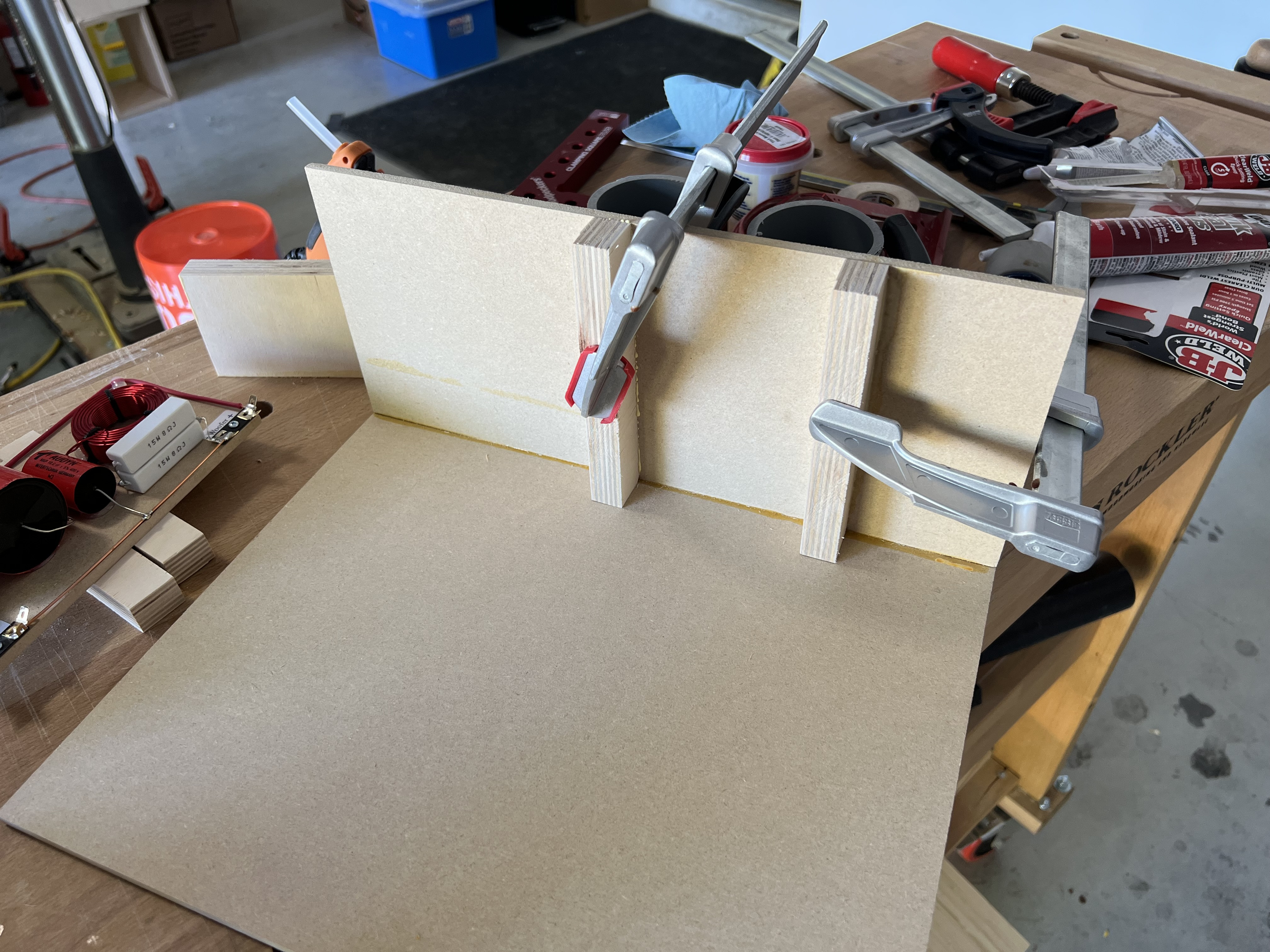

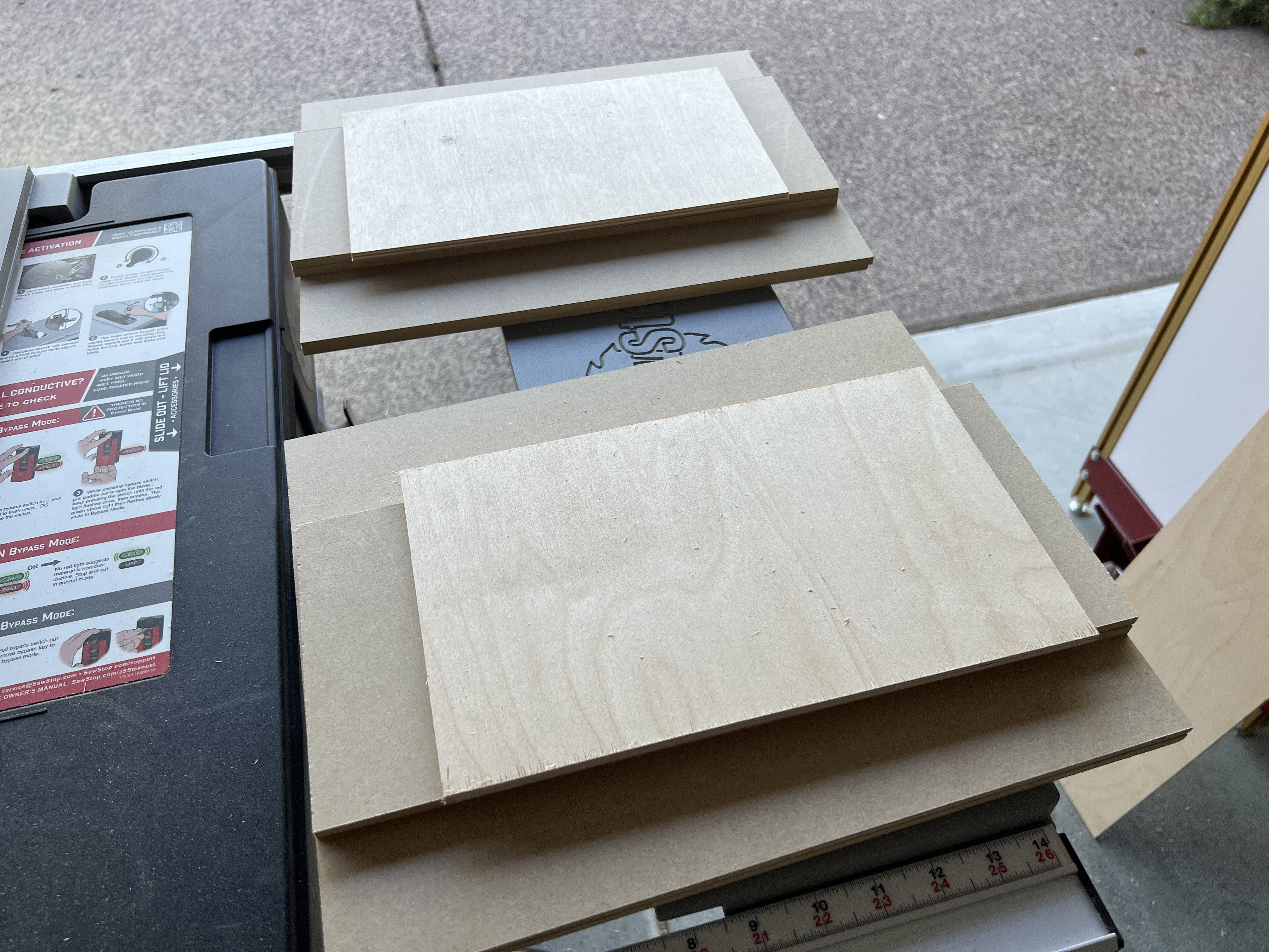

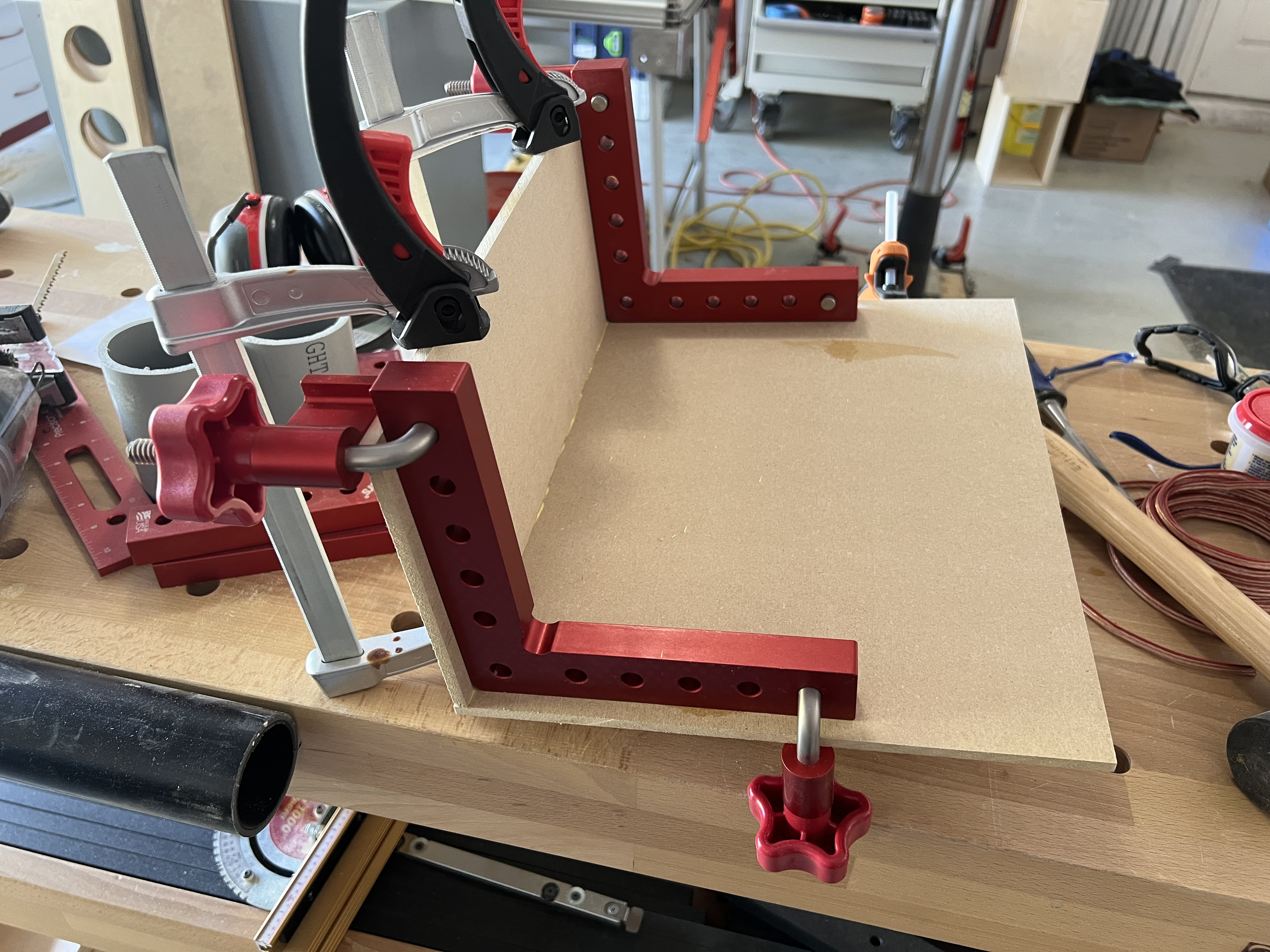

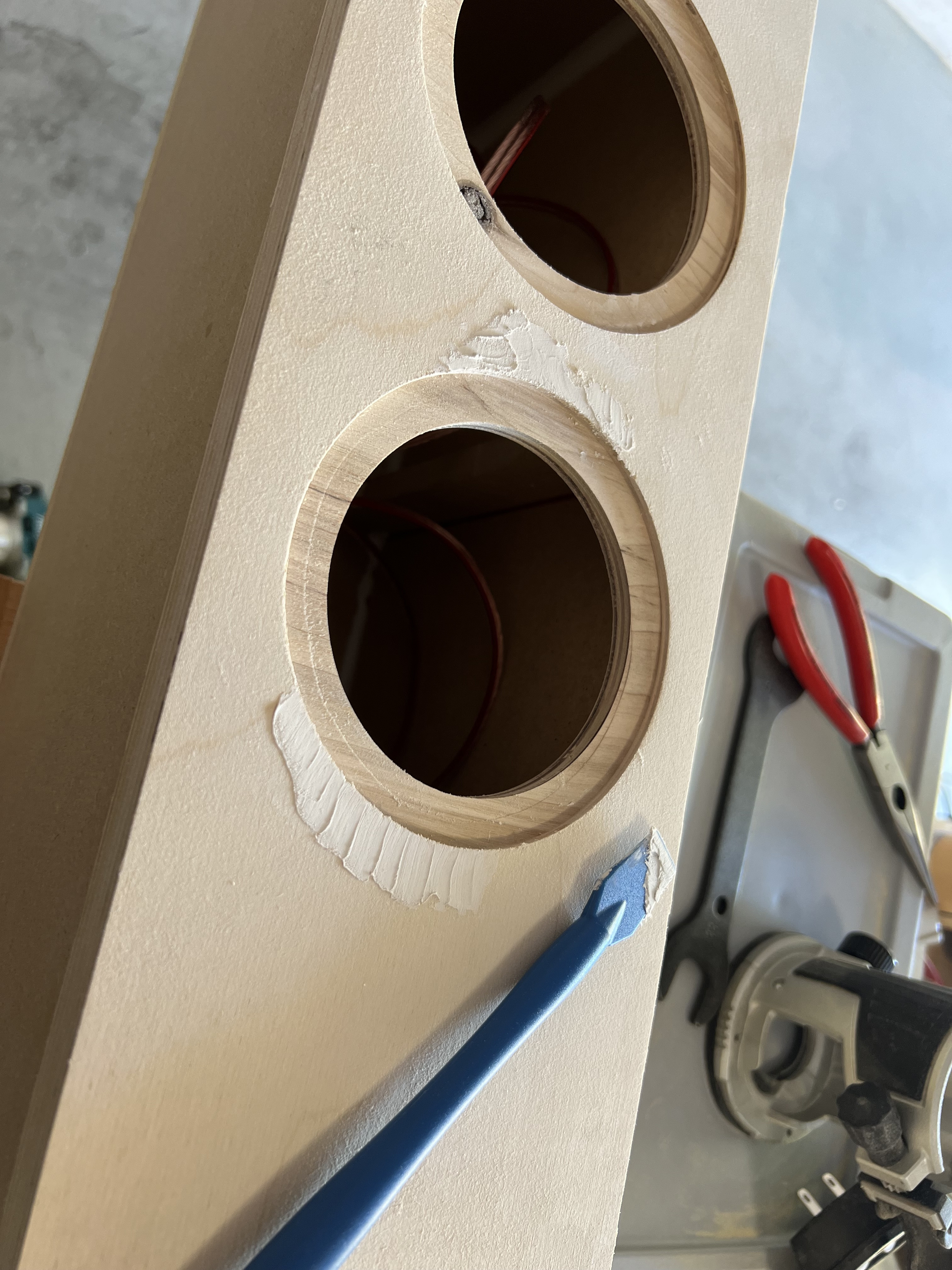

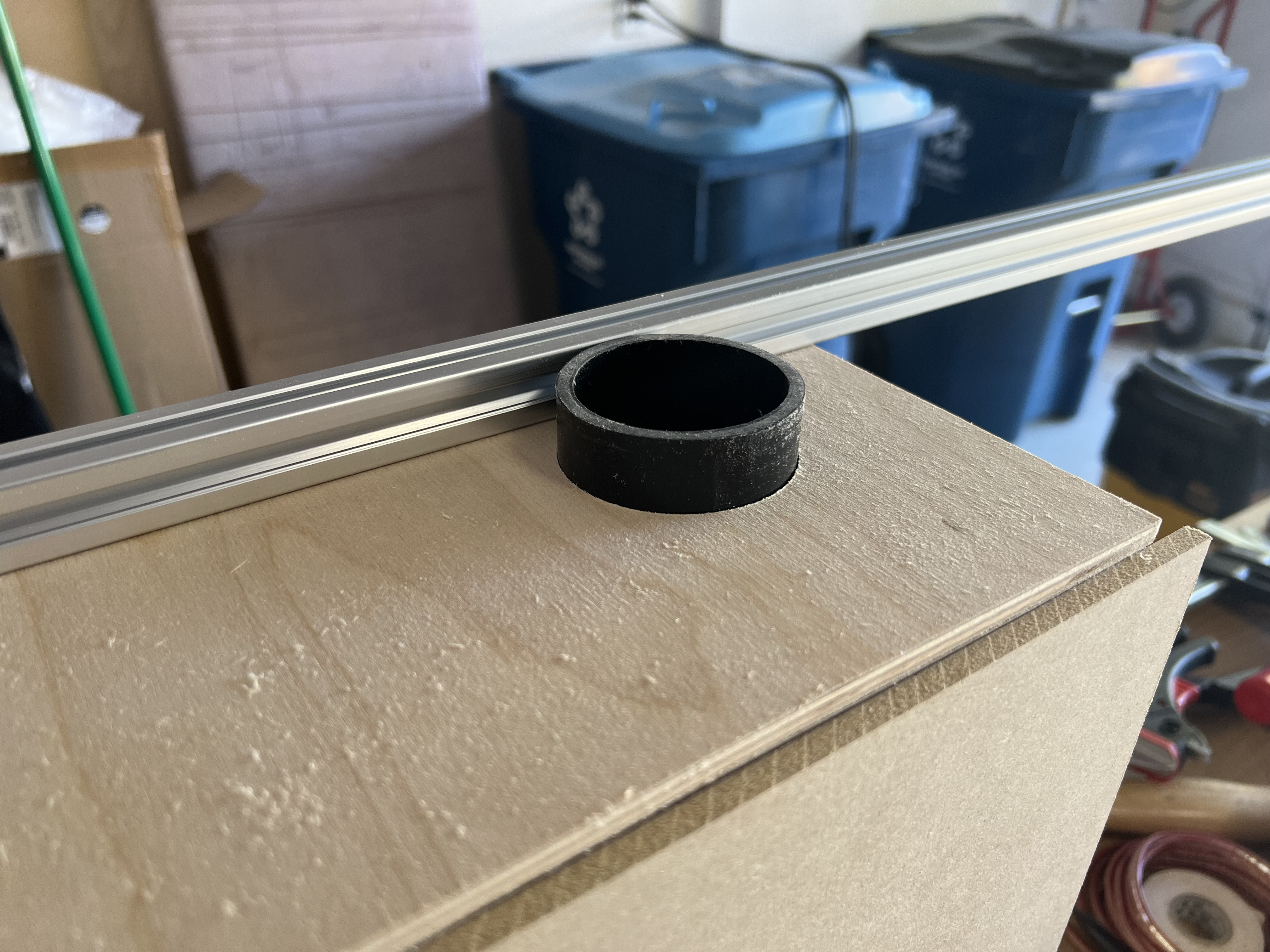

              Made a little progress over the weekend. First I cut down some PVC for the ports on two of the three kits. I haven't decided if I'll port the third set (Keramiskas) yet. I went ahead and countersunk the drivers for the Overnight Sensations TMM and carved out a bit of the backside as well, then epoxied the ports in place. I think I'll wrap up the OS build before doing much else on the others, it'll be nice just to get them out of the garage to free up some bench space. Just gotta install the crossovers, shove in some stuffing, and glue the baffles in place...maybe all done next weekend.
              Oh, as far as mistakes go one thing led to another and...one of the baffles was sort of accidentally epoxied to the floor. Fortunately, I caught it before it COMPLETELY set and it is salvageable.
              Click image for larger version  Name:	IMG-0461.jpg Views:	0 Size:	2.92 MB ID:	940074
              Click image for larger version  Name:	IMG-0463.jpg Views:	0 Size:	2.44 MB ID:	940075
              Click image for larger version  Name:	IMG-0464.jpg Views:	0 Size:	2.51 MB ID:	940076
              Click image for larger version  Name:	IMG-0465.jpg Views:	0 Size:	2.50 MB ID:	940077
              Click image for larger version  Name:	IMG-0468.jpg Views:	0 Size:	2.27 MB ID:	940078

                Oh, as far as mistakes go one thing led to another and...one of the baffles was sort of accidentally epoxied to the floor. Fortunately, I caught it before it COMPLETELY set and it is salvageable. [/FONT][/SIZE]
                OMG!!! I could only imagine how it would have gone if you had not caught that and had to figure out how to get that off the floor. The build is coming along and great to see all the photos of the progress.
                Painter in training
                  • 1024
                  Yeah...even with the floor being painted I'm not certain how well that would have played out. As it is, I've mostly been able to tear off the epoxy by just lightly prying on it with an abused chisel.

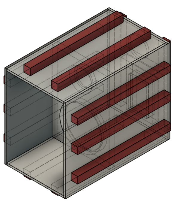

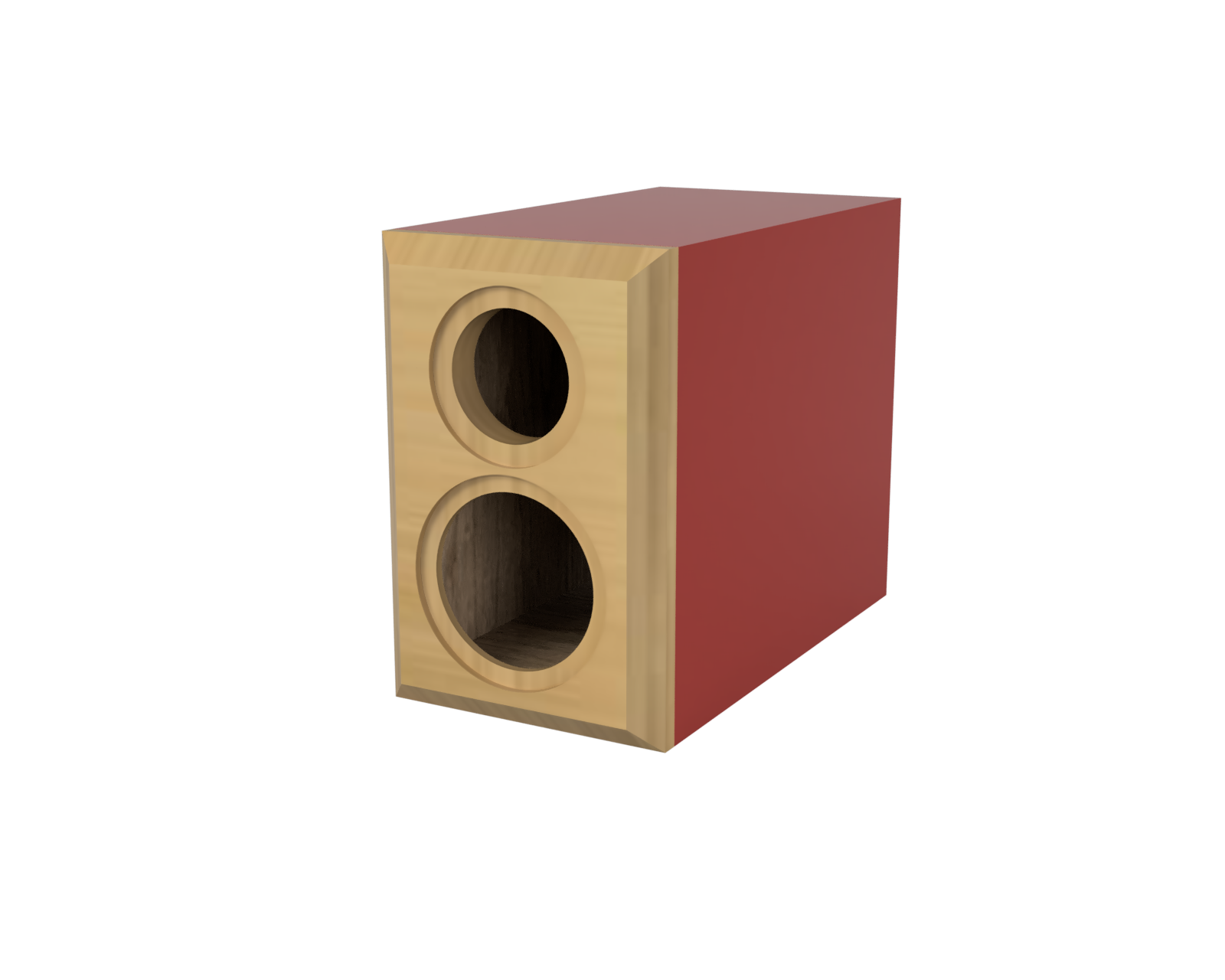

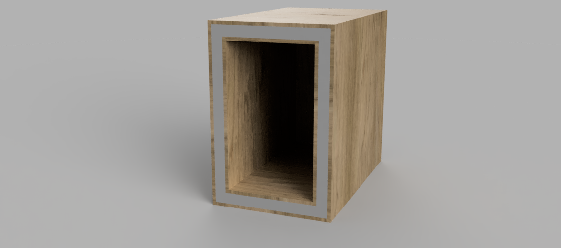

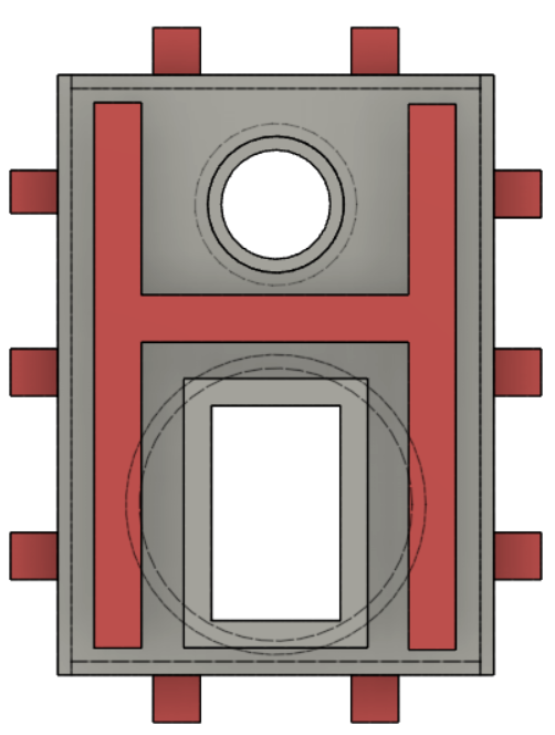

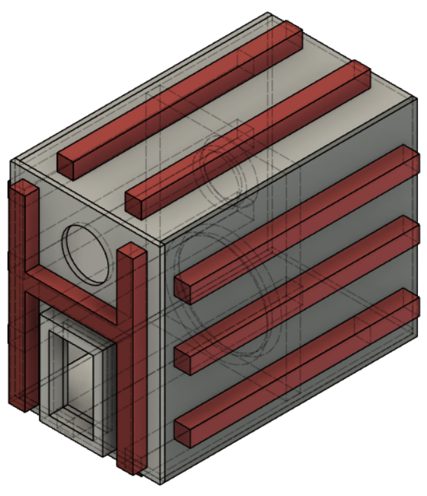

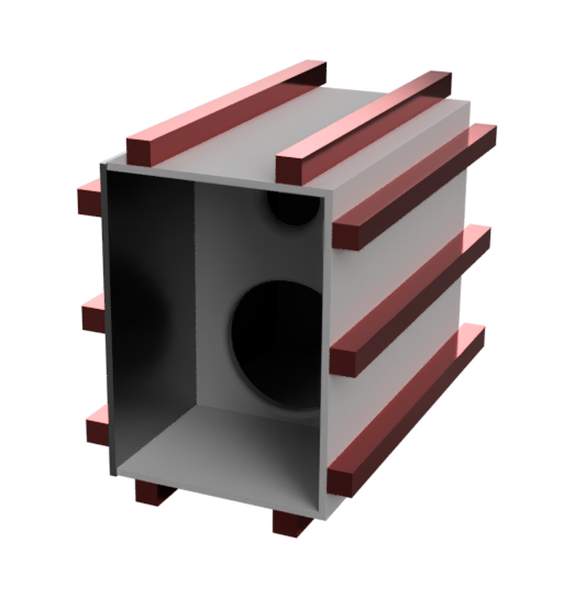

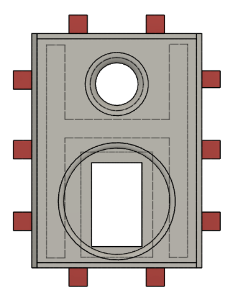

                      Well I've been working on the Keramiskas plan a bit since the Overnight Sensations TMM are basically done (minus a finish that has yet to be determined by my significant other). I started modeling the inner core to figure out dimensions and such. Here's what I have so far:
                      • The inner panels are all 1/4" Baltic Birch plywood. Depth of the speaker has been increased by several inches (around 3, I think) to account for the thicker sidewalls (~1.25" all around)
                      • The brace/inner roundover for the port would be 3/4" BB or MDF (whatever scraps I have).
                      • The red ribs would be aluminum stock, adhered to the inner BB with epoxy.
                      • On the rear there is an additional block of wood surrounding the terminal cutout, this isn't necessary for the port as the port would be inserted (though it is not shown here).
                      • Surrounding this on all sides except the empty front would be either more 1/4" BB or Hardboard. Probably BB since I'd need to order some anyway.
                      • Polymer concrete (epoxy granite) would then be poured from the baffle side while the box rests on its back, on a vibration platform to encourage the epoxy to flow to all corners. Care would need to be taken to ensure no overflow remains - this would need to be level in order to attach the baffles (which are 'traditional' 1.25" thick bamboo plywood leftover from my failed Ardent project a few years back).
                      This looks pretty good from where I'm sitting. I think I'd shorten up some of the ribs a hair and make the terminal block as thin as possible, but otherwise I think it should work. I did think about doing this the opposite way - adhere the baffles first and pour from the rear, but I'm not sure there is a clear advantage to either method.

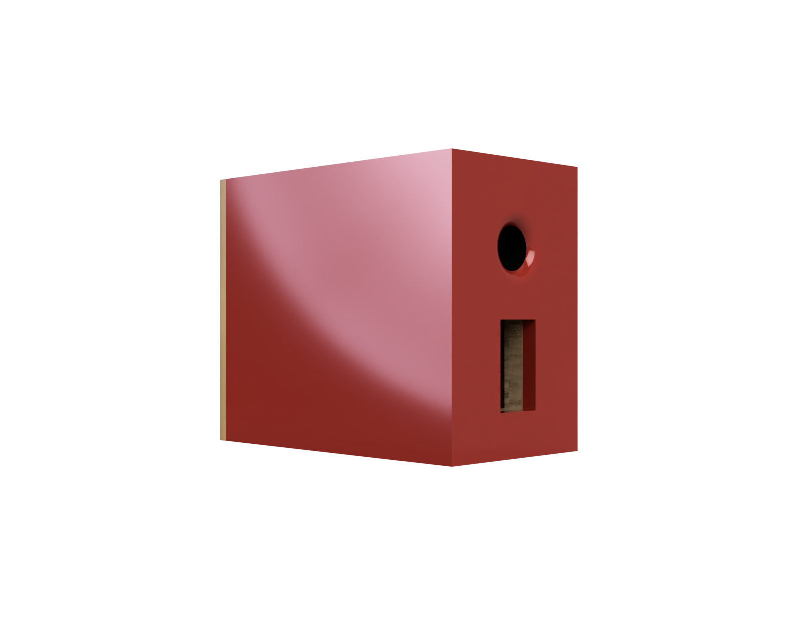

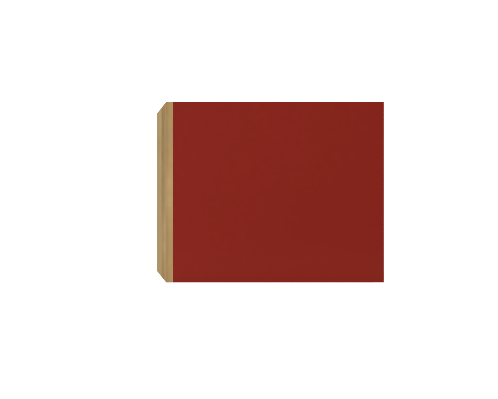

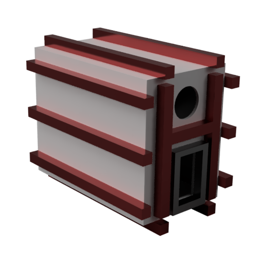

                        I played around a bit more this morning after thinking on it last night. I brought the outer ribs in by 3/4" to bring them nearer to the center of each panel - in theory the corners should be stronger anyhow, so they need less reinforcement. This also provides more room around the corners to pour the epoxy. I also shortened the ribs by a few inches as they really shouldn't need to go end-to-end. This gives more room for the epoxy to pool at the front and rear. Finally, I thinned the terminal 'block' and expanded the H-frame on the rear to give more room for the epoxy to flow better around the terminals and port.
                        I think the only thing I'm worried about at this point is whether the epoxy will be too viscous to flow to the hard-to-reach areas. I think I'll need to run a couple experiments getting the right mixture for this. Weight should be interesting, according to Fusion 360 this inner box and frame already weighs 26 pounds - we still need the outer panels, baffle, and polymer concrete (not to mention drivers and crossovers). That seems high to me, but it seemed about dead on for the subs so maybe I'm underestimating the weight of the aluminum.

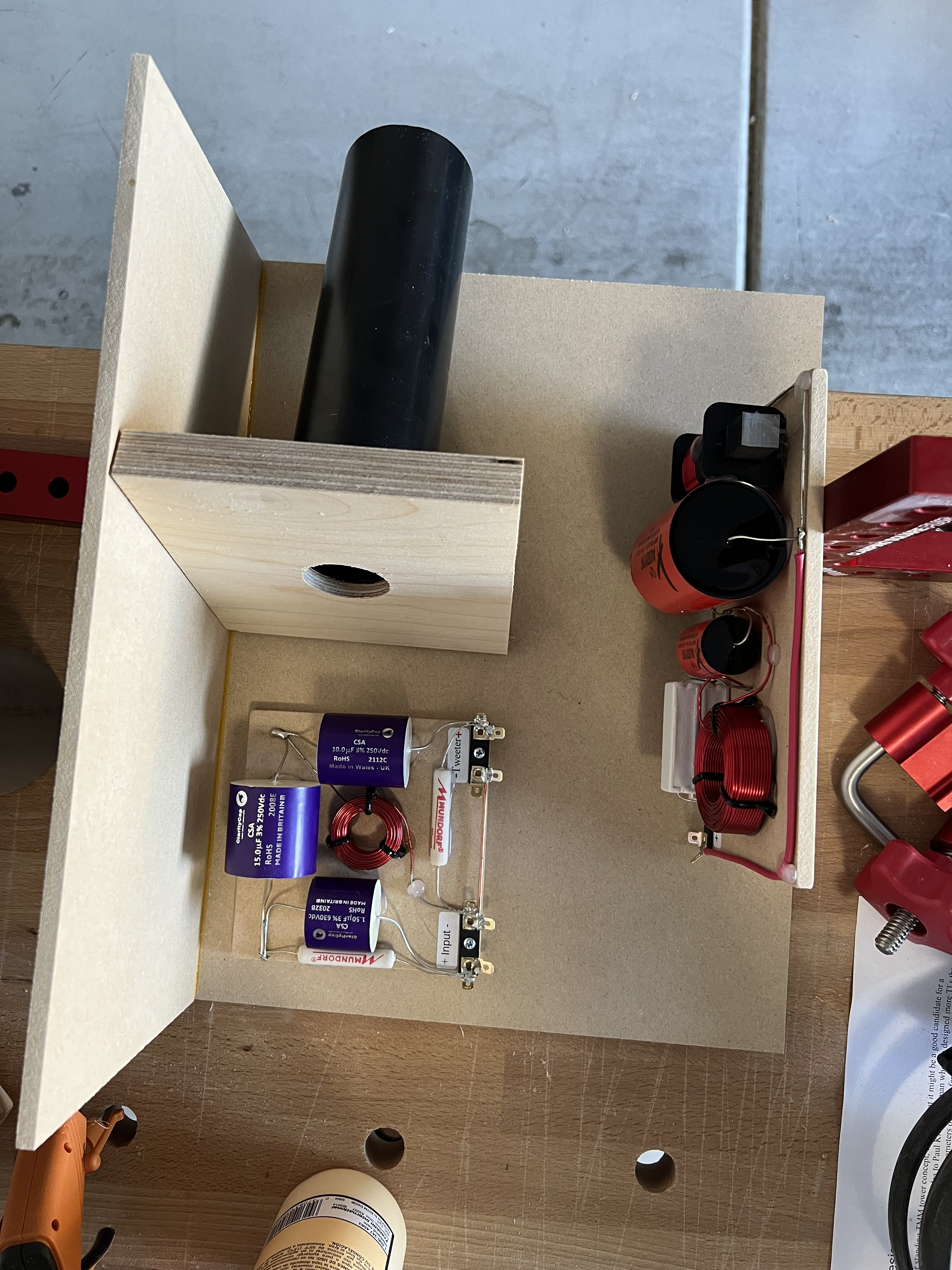

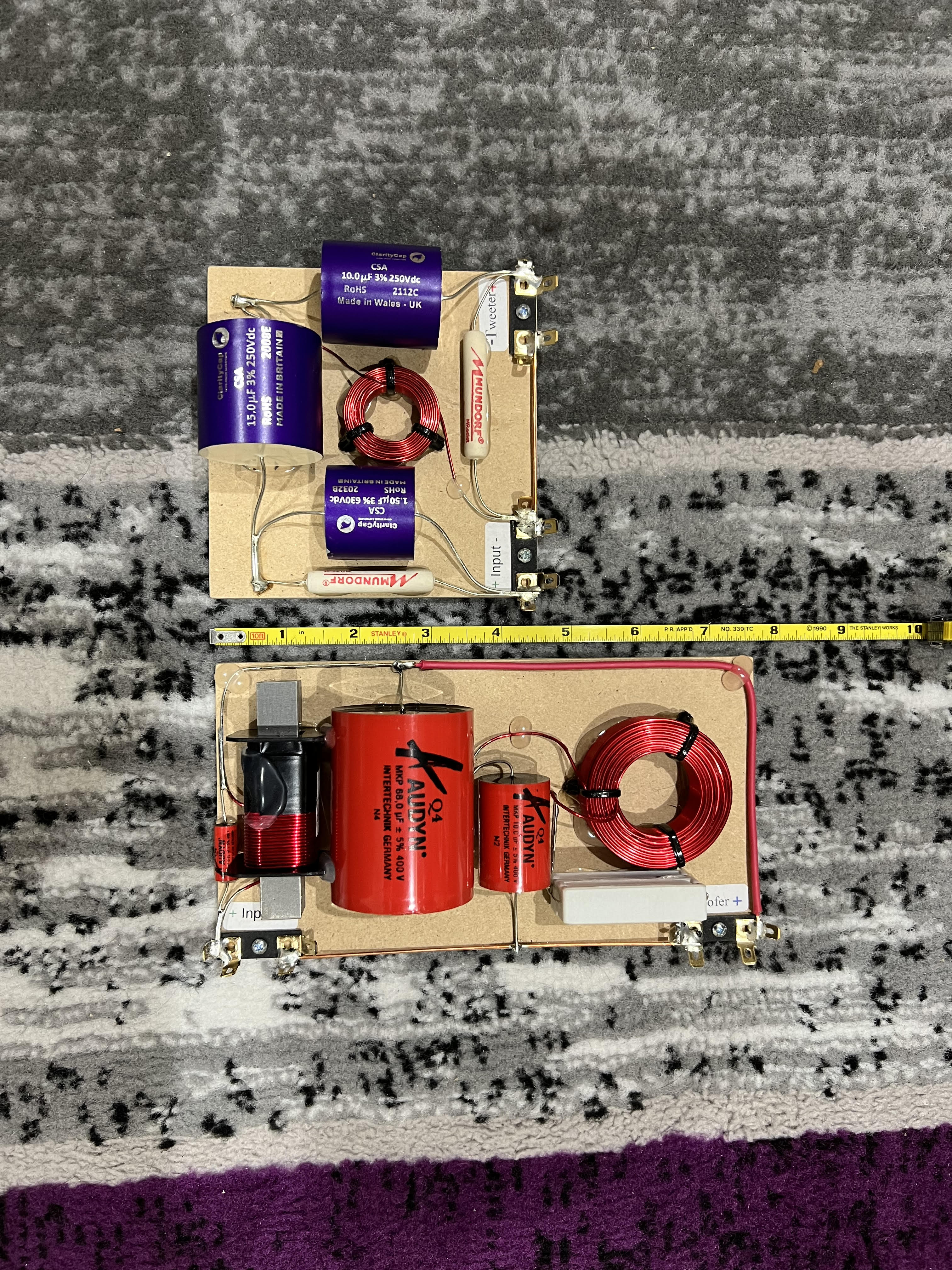

                        That reminds me, I need to bust out the crossovers to see how big they are. They'll need to fit through the driver hole (and brace hole) and work within that layout. I may need to adjust the brace to be a square on the bottom to allow fitment.
                        Click image for larger version  Name:	Front.png Views:	1 Size:	75.5 KB ID:	942019
                        Click image for larger version  Name:	Profile.png Views:	1 Size:	341.7 KB ID:	942020
                        Click image for larger version  Name:	Rear.png Views:	1 Size:	96.7 KB ID:	942021
                        Click image for larger version  Name:	Rear Profile.png Views:	1 Size:	370.5 KB ID:	942022

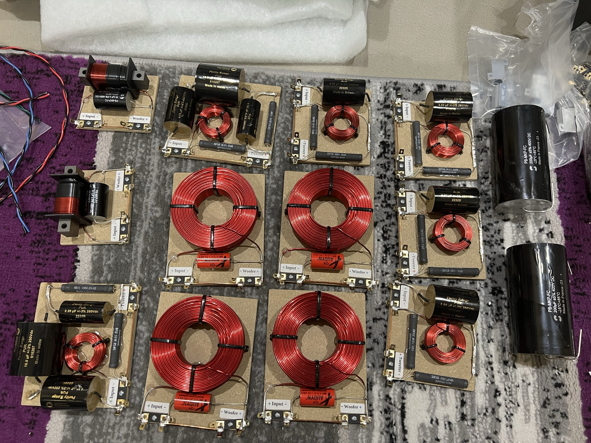

                        Edit: Crossovers are pretty good size. I'll need to adjust the brace so at least one can rest on the bottom of the speaker.

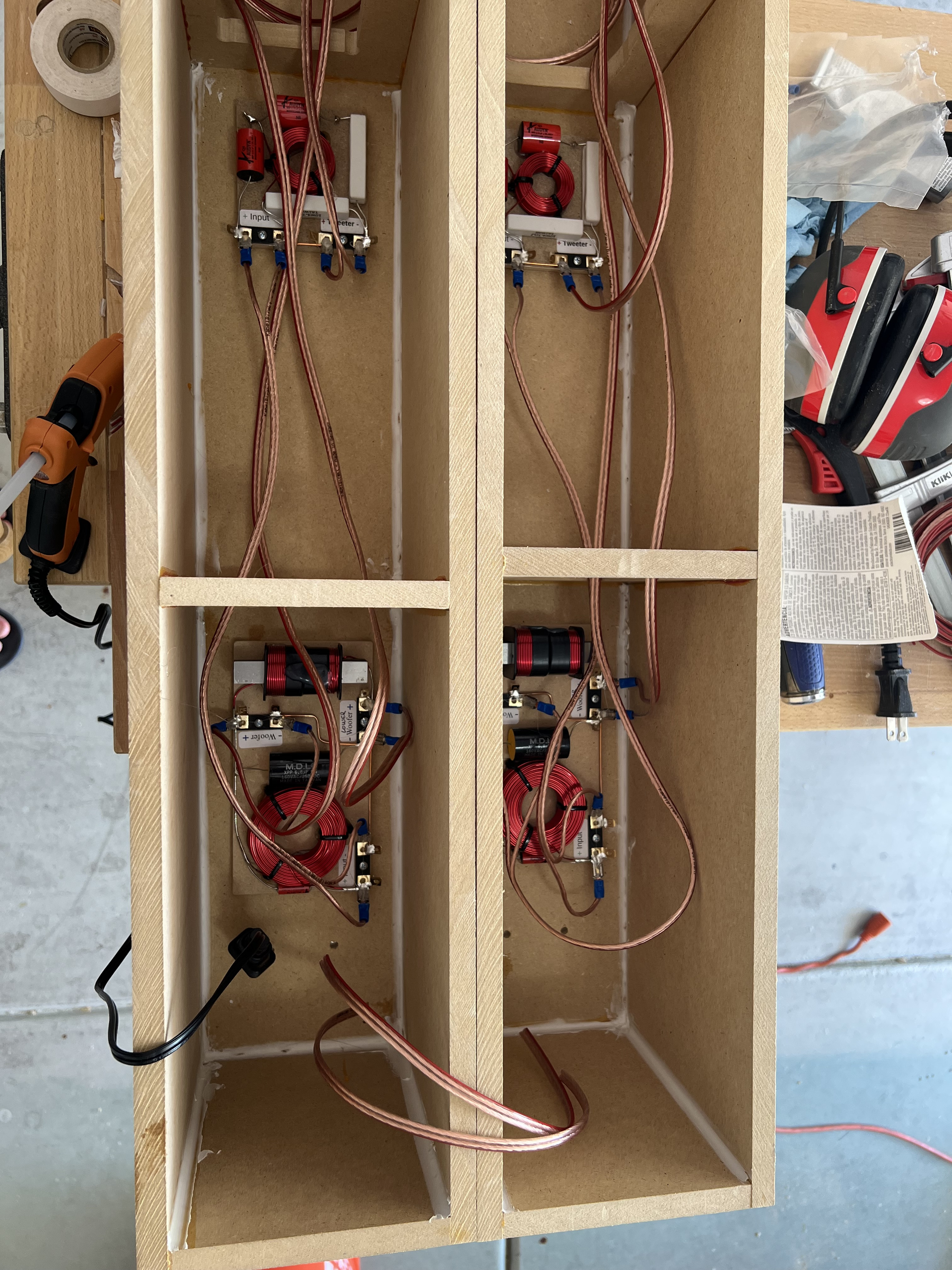

                          • 1024

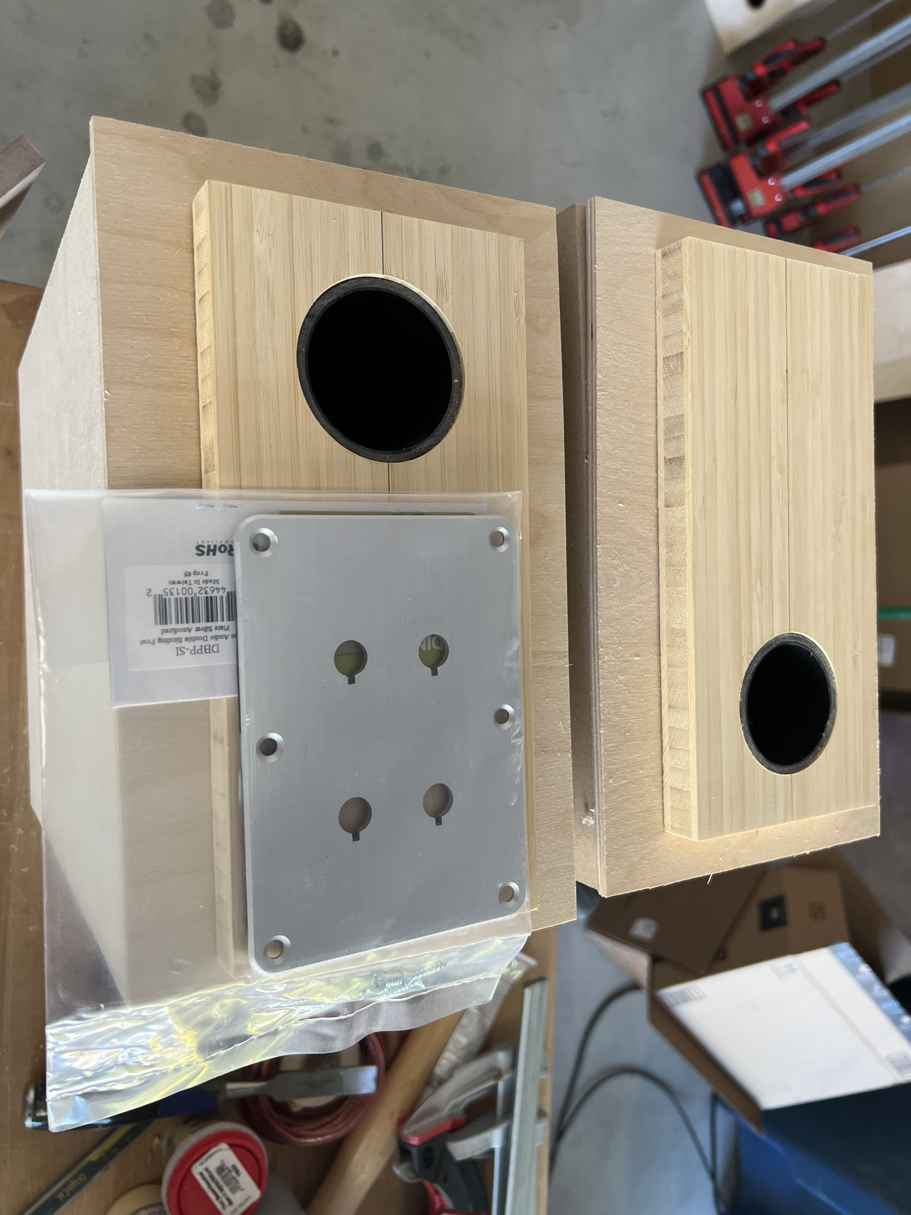

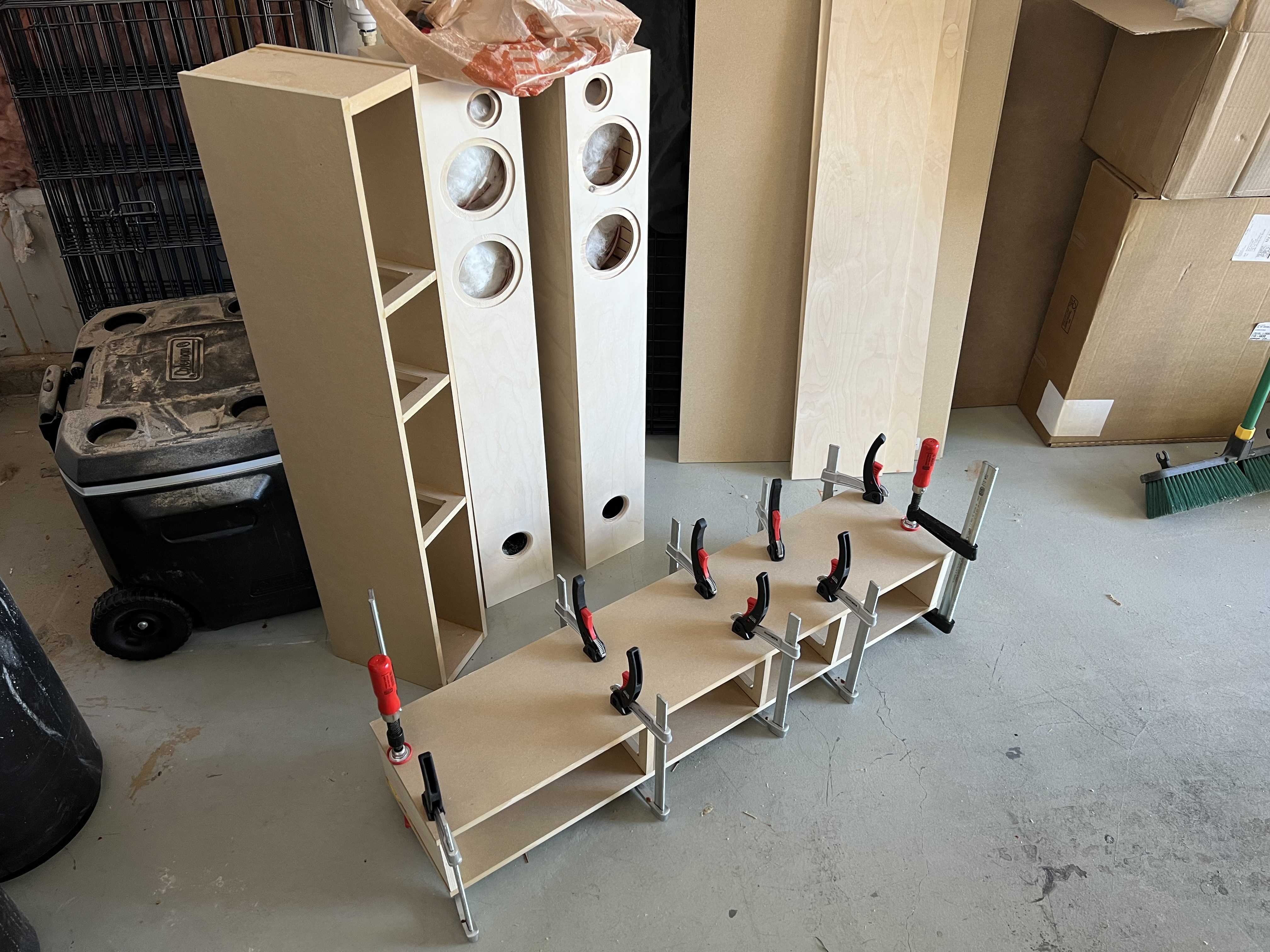

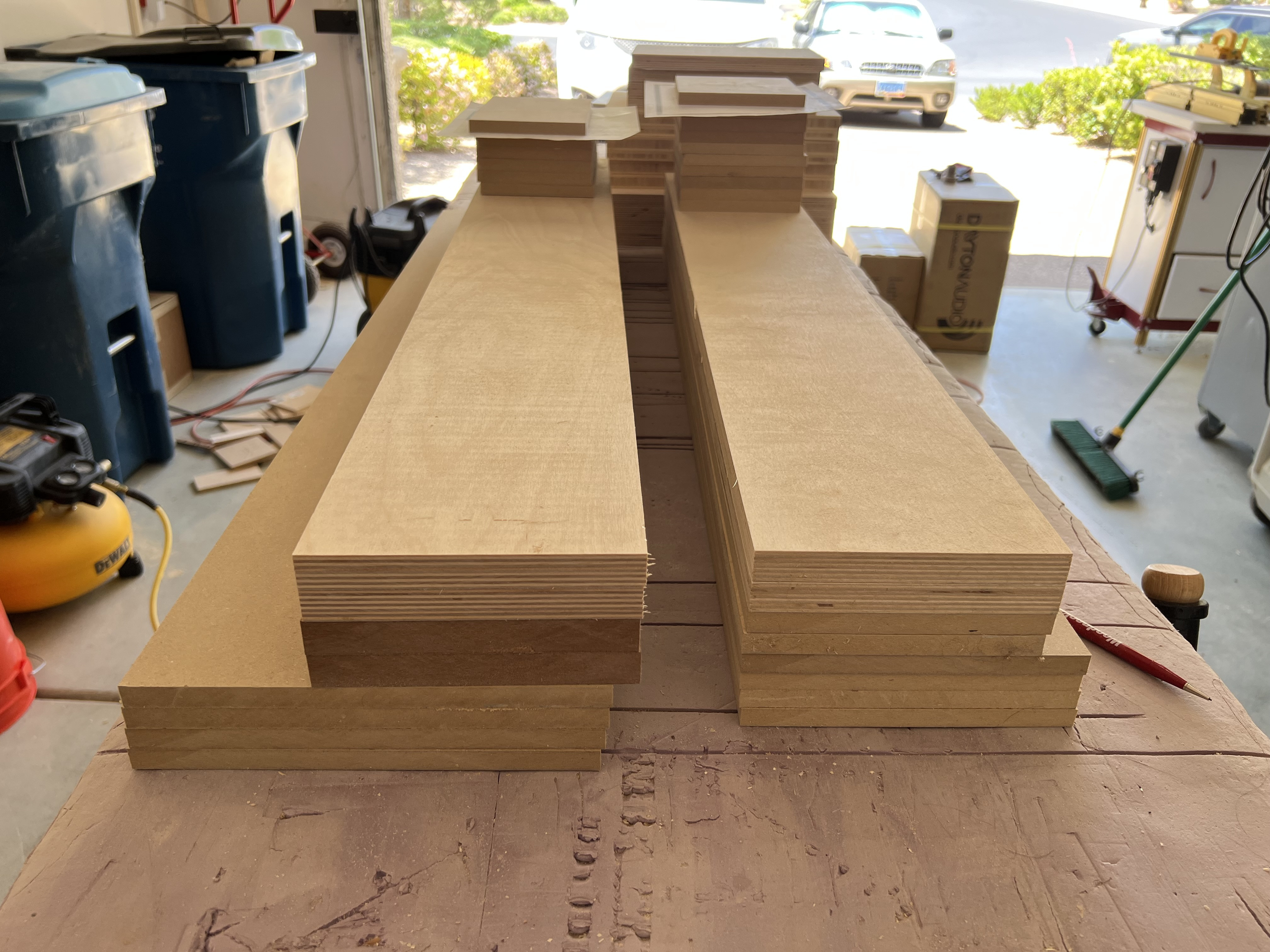

                          Here's a few pictures showing where I'm at on the Overnight Sensations. Crossovers are installed and baffles have closed up the boxes. I had to change my plans on the terminals but that worked out, I'll just use plastic cups on these since I have a pair in the parts box gathering dust. Just need to figure out the finishing scheme and do so sanding. My spouse indicates dark green or burgundy could be an appropriate match for the HiVi woofers.
                          Click image for larger version  Name:	IMG-0475.jpg Views:	0 Size:	3.07 MB ID:	942025
                          Click image for larger version  Name:	IMG-0478.jpg Views:	0 Size:	2.58 MB ID:	942026Click image for larger version  Name:	IMG-0479.jpg Views:	0 Size:	3.26 MB ID:	942027

                                • 1024

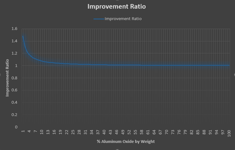

                                I ran some new models this morning and came up with ~500 in3 of volume for the epoxy - or around 8L per speaker. This model doesn't take into account the aluminum bar (I was lazy) so in reality I'll use less. Model claims a weight of 57 pounds per speaker - not counting port, brace, baffle, speakers, or crossovers. I think that's a worst case estimate, I imagine the finished product may approach that once everything is considered.
                                I also did some research last night on the type(s) of sand used in epoxy granite, as that's basically all the material is. Something like 80% by weight sand and 20% by weight epoxy. The devil is in the details though - if you have larger sizes of sand you don't get very good packing (imagine those racks of 12" bouncy balls at Target/Wal-Mart - there is a lot of air between them) so you generally want smaller sand mixed in to fill those gaps and maximize density. There is a place in Denmark that will make any mixture you ask for but I'm kind of hoping I can get the same service in the US...and I'm hoping I don't literally have to order a ton of it. I've also been trying to determine if metal sands (or even tiny weights, such as lead shot) could be used in the mixture. I have a feeling that consistency is more important though, and those weights would be too large to be effective.

                                  Hey Danny, I curious, why epoxy? I apologize if the reason has already been given. Something that came to mind was an elastomericroofing sealer would offer a better dampening solution?
                                    • 1024

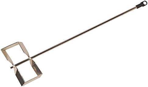

                                    Hey Steve, this is kind of going back to the 3-D printing thread. I'll link the wiki articles again. This composite material is commonly used for damping of heavy machinery in place of real granite or iron or steel slabs as it generally costs less and is much quicker to form and set. It also doesn't expand or contract at normal operating temperatures. While a viscoelastic product as you suggest could also be effective at damping vibrations, I'm going more for the densest, heaviest substance I should be able to pour and form. Remember I'm only using 1/4" wood for the forms, so most of the strength and stiffness of the walls is coming from the 20mm thick epoxy granite (and the supporting ribs). Since it's self leveling and flows as a liquid I should get minimum porosity (with an appropriate as-yet-to-be-determined mixture) and a near uniform product provided the vibration table I make is sufficient to the task.
                                    One thing to keep in mind is that mixing epoxy is an exothermic process; making large amounts can apparently heat up so much the mixture starts to smoke! I don't know that I'd need to mix THAT much, but it is a reminder this should be done in small batches.
                                    https://www.adambender.info/post/201...e-frame-how-to

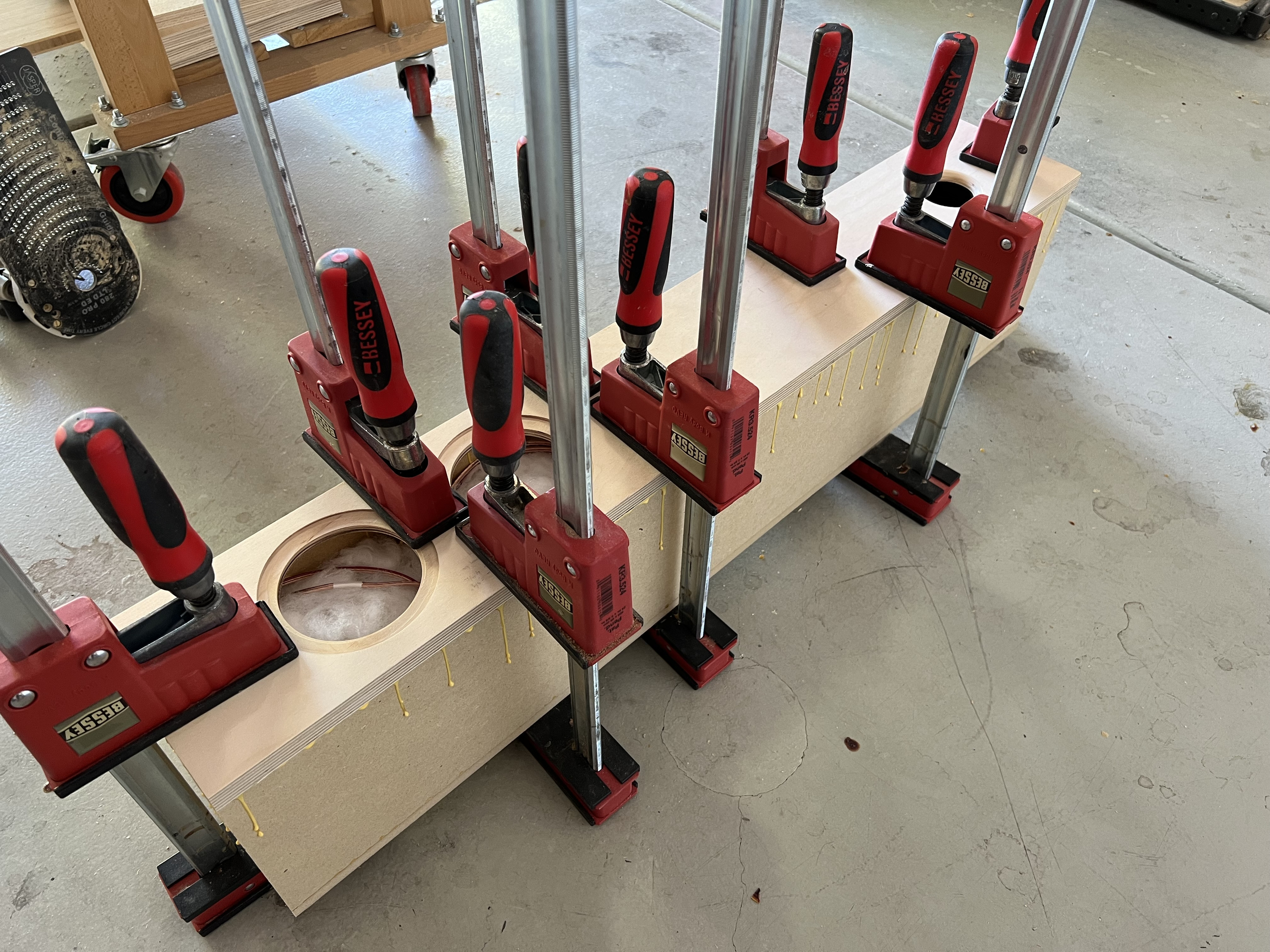

                                                  Well, I spent some time in the garage today since I started work early (and therefore finished early). Turns out I was unproductive, the heat is coming to the Vegas Valley! Cut a few braces for the Speedsters before calling it quits. Hit Home Depot for some 1/4" MDF for the Keramiskas - I decided I didn't want to pay for shipping one sheet of 1/4" Baltic Birch so I'm going the cheap route. The aluminum came in and it looks really nice. It'll be a shame to cover it up but so be it. It's far too smooth though, I'll need to roughen it up to ensure the epoxy sticks to it.

                                                          • 1024
                                                          I tackled the messed up port through hole on one of the Speedsters TMM baffles this afternoon. The problem was I cut slightly too large a hole for the port (2.5" ID). Out of the various options I decided to chop off the end and just glue another piece to the end of the baffle. I'm planning on having these painted anyway so I'm not too concerned about it.
                                                          Click image for larger version  Name:	IMG-0487.jpg Views:	0 Size:	2.61 MB ID:	943688
                                                          Of course, you might note in my haste that the through hole on this particular piece of wood was not particularly large...so mistakes were made, more wood found, and now we should be good to go.
                                                          Click image for larger version  Name:	IMG-0488.jpg Views:	0 Size:	2.64 MB ID:	943689
                                                          Click image for larger version  Name:	IMG-0489.jpg Views:	0 Size:	2.59 MB ID:	943690
                                                          Click image for larger version  Name:	Kylo.gif Views:	15 Size:	1.50 MB ID:	943461
                                                          Kylo will definitely approve of the color scheme for the Speedsters. Unless plans change they should be black. Very black.​

                                                            Got some work done this morning before it got too hot outside. First I started gluing up the second Speedster tower.
                                                            I cut out all the interior parts for the Keramiskas. Such a small stack when it's only 1/4" wood!
                                                            I also cut out the interior brace that will serve as an interior port flare, cut the ports out, and glued them up with two part adhesive.
                                                            Finally, I started gluing up the interior bits for the Keramiskas. Since the wood is so thin I'm going to take it slow, I'm concerned about permanently bowing these panels if I clamp too hard. Hoping to go back out sometime this afternoon to glue up a few more panels. I'm kind of thinking if I do this again I might adhere the aluminum to the panels first, then assemble them...but that would only add strength in one direction so maybe it wouldn't be a benefit.
                                                            I was going to start cutting the 2020 T-slot but discovered I don't have any metal bits for my jigsaw. So I guess there's no rush on assembling these right now.

                                                              I got up early this morning to do a little work, unfortunately it was mostly gluing so once that was done there wasn't much else for me to do but wait. Maybe I'll go out this afternoon...but given the expected temperature...
                                                              ...maybe not.
                                                              I finished the interior flare on the ports with a 3/4" roundover that ended up cutting into the plastic a bit. No matter, the epoxy held.
                                                              ​Once that was done, I mocked up the interior of the cabinets with the crossovers. Looks like I have enough room for some options, but I'll stick with the below plan (mostly).

                                                                    Here we go again, making mistakes! I discovered that I did some incorrect math after I made the first piece for the back of the speaker, just a 1/4" piece of baltic birch plywood. I noted that the port didn't look like it extended very far, and I was right. It doesn't even extend past the aluminum layer, much less 3/8" into the next piece! So I sat down to think about how that might work and ultimately decided that I won't put the aluminum forms on the back. That bums me out a little, but I found a nice scrap piece of bamboo that will serve the purpose.
                                                                    First I used a new 2 3/8" Forstner bit (Amana via Amazon) to push a hole through both ends of the scrap. Then I chopped them down to size with the tablesaw.
                                                                    Test fit...
                                                                    Getting ready to make another hole...

                                                                    This is creative cabinetry 101, and a good save with the bamboo!
                                                                    Painter in training
                                                                      • 1024
                                                                      I'm not sure it's a save...but I think it'll work! Might have a gap in the port that I'll need to fill in later, but at least there should be no epoxy intrusion. I'm currently at a standstill as I await a few packages from Amazon and Parts Express, but I think they'll arrive before the weekend so I ought to be able to make some progress then. Jotting things down here so maybe I get the order of operations right this weekend:
                                                                      1. Cut foam to size and install in box where possible. Leave unadhered joints somewhat bare so sealant can be applied later.
                                                                      2. Install Velcro in boxes and on crossovers, be sure to staple it down in the box.
                                                                      3. Glue box halves together.
                                                                      4. While glue is drying:
                                                                        1. Build vibration table
                                                                        2. Cut down 2020 aluminum - need 20 ~12" pieces (use five 4' rods)
                                                                        3. Sand and adhere back to other Speedster
                                                                        4. Apply interior sealant to first Speedster
                                                                        5. Cut rabbets for speedster baffles
                                                                          1. Install ports once baffles are ready
                                                                        6. Cut and fit foam for back pieces to the Keramiskas, cut out terminal hole
                                                                      5. Apply interior sealant and remaining foam pieces
                                                                      6. Use table router to clean up all joints
                                                                      7. Rough sand whole box
                                                                      8. Rough sand 2020 aluminum
                                                                      9. Mark sides for placement of 2020 aluminum
                                                                      10. Epoxy aluminum to one side at a time, clamp well.
                                                                      11. Glue 1/4" back piece to each box. Consider gluing the 3/4" bamboo spacer simultaneously
                                                                        1. Clean up edges with table router
                                                                      ​​​​​​In the meantime, when I'm not playing with the puppy, I started sorting through some of my new parts - including the crossovers. I snapped a pic of the below because I like how neat everything looks. I'm going to miss Meniscus for their crossover work...may have to bug Steve Manning about making them for me in the future! Or I 'guess' I could practice and become better at layouts...
                                                                        • 1024
                                                                        I've been researching epoxy granite a bit more today, both scientific papers (those few I could find) and more traditional internet searches (various forums and Youtube). This video was interesting, and has me reconsidering the sand + smaller particles. While strength is generally a nonissue, density is what I'm after for this project. The correlation of increased strength to increased density cannot be ignored.
                                                                        In this video the tests are performed. I present the results, discuss around the different test specimens and finally what I take with me from this test.
                                                                        I think I'm going to order some 180 grit aluminum oxide blasting powder as my "smaller particles". It's much more cost effective to get 50 pounds of it....so...maybe I'll be doing this on another set of speakers or two if I like the result. The only thing to figure out now is what ratio of sand to powder, then determine the appropriate amount of epoxy. The guy in the video used 67% sand to 33% powder, then used around 13-14% by weight of epoxy. I think I'd prefer to have a little more epoxy to ensure wetting of all particles, and had previously seen 20% used with sand. I have some silicone granola bar forms in my cart...I was thinking about making some small batches of various mixes to see how they look (in terms of porosity) and calculate density. I'm waffling on this because Aluminum Oxide is about twice as dense as your average sand...so 100% powder should, in theory, yield the best density. This conceptually makes sense. But I need to find a happy medium between sand ($6/50 pounds) and powder ($140/50 pounds).
                                                                        There is probably some sort of cost versus density chart that would show this. I could calculate theoretical maximum density without measuring it and come up with a dollar/density value...just thinking out loud here.
                                                                        This is all totally opposed to augerpro's findings of course, I'll save that for a larger project!
                                                                        Edit: I did it! With some convoluted logic and math later...I get something I'm calling an improvement ratio. Basically, this is the cost vs density of n+1 (where n is the % aluminum oxide) divided by cost vs density of n. You'll see we get diminishing returns...curiously starting right around where the guy in the video was using, something like 30-40%.
                                                                        Click image for larger version  Name:	Improvement Ratio.png Views:	1 Size:	30.6 KB ID:	944308

                                                                          Have you looked at silica powder to mix with the resin? That is pretty dense and cheap too. I used this a fair bit in the car stereo days to build custom fiberglass subwoofer enclosures. After you had your first layer of fiber laid with resin you would thicken the enclosure with the resin / silica mix and it would make the enclosure super rigid.
                                                                          Painter in training
                                                                            • 1024
                                                                            That really interesting, I had actually been researching that as well, my final undergrad project partially involved silica. In this case, the density is much closer to that of sand than it is to aluminum oxide. However, it's like 1/3-1/4 the price of aluminum oxide...but what I could find wasn't quite as fine. I don't know that would make a major difference. I do think it would absolutely work!

                                                                                  I just wish I had a way to show how this method compares to other materials whether that be a mechanical device or a mathematical model. I suppose one way to do that would be to construct a 'normal' cabinet and an augerpro cabinet, then measure frequency response. Better would be to acquire a laser doppler vibrometer and measure panel resonances. It'd be easier to mock up individual panels for this purpose, I think. That might be out of my price range, but something like the below could work, maybe. At least it has a range to 15kHz, unlike some physical meters.

                                                                                  I purchased a new mixer rod for this project as my other one is capped by plastic fins - I didn't think they would do well in this substance. I got a laugh yesterday when it arrived, it's enormous! I did not look at the size when ordering. Should be great for a 5 gallon bucket though!
                                                                                  https://www.amazon.com/dp/B074PC786L
                                                                                    Not at odds with my testing at all! Brute-forcing the issue with serious mass is probably a quite effective method. I only started testing to 1) quantify the changes in mass/materials, 2) find a cost-effective sweet spot that was easy to implement. Some of these brute-force methods seem a bit extreme to me, and not many DIYers do it for that reason. Not to mention cost and just having to move 200lb speakers around. I liked CLD because it followed the "work smarter, not harder" ethos. I mean just look at the results from two 1/4" MDF sheets joined with Weicon versus the 3/4" plywood and MDF. One could join the two methods of course, although I would want to quantify the benefits first because I think there is definitely a point of diminishing returns.
                                                                                    I read your other thread, and I'll post some random replies here to your questions. I think a box of 12 Weicon should be quite enough for two floorstanders, even if you triple the layers as you thought about doing. I have a 3D-printed trowel .stl on my website that can help you get a consistent 1/32" layer.
                                                                                    Building box-within-a-box is how I started my testing, but I tell you it's a PITA and easier to trap air bubbles. Now I like to roughcut the panels, glue them with Weicon, and then cut to final size. This way you can also use the advantage of 1/4" wood bending a bit to "roll" it onto the thicker board, to prevent air being trapped. I didn't see any disadvantage in my testing when I switched to this, even though the isolation of box-within-a-box seems to our minds more ideal.
                                                                                    I'll quibble a bit with Xandresen that you must use microspheres. The results of my testing show that you get big improvement without doing that. And where else in industries that use CLD is that a requirement? Nowhere that I can see. But it was an interesting idea of Geddes, and of course I have a box of glass microspheres that I had intended to test! But I haven't yet. It may very well be better than just the Weicon, but that is not the same as saying the Weicon does nothing.
                                                                                    Also the aluminum-backed butyl sheets certainly work, look at the results I've measured. But I've never done the MLV and don't really intend to since it is not CLD. The aluminum is what provides the CLD damping. Without it, it's just a little mass added to the panel.
                                                                                    It would be great to see someone use my testing method to continue nailing down methods I didn't fully explore. Like the concrete you mentioned. If you want the details let me know, I'd be happy to share and start getting more data and validation of methods. For example, while I did measure both 1/2" and 3/4" materials to get some idea of mass/stiffness changes, I never doubled up 1/2" or 3/4" to test the brute force approach. Mostly because the CLD results were so promising. But I would still like to know if there is a sweet spot there. Then perhaps join the two methods.
