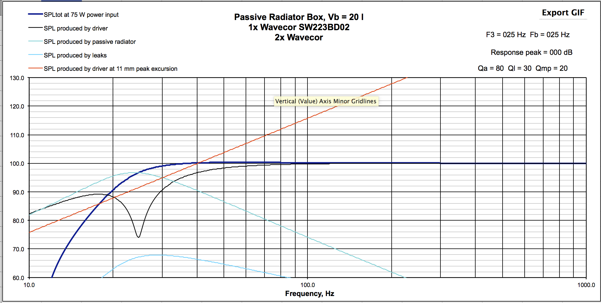

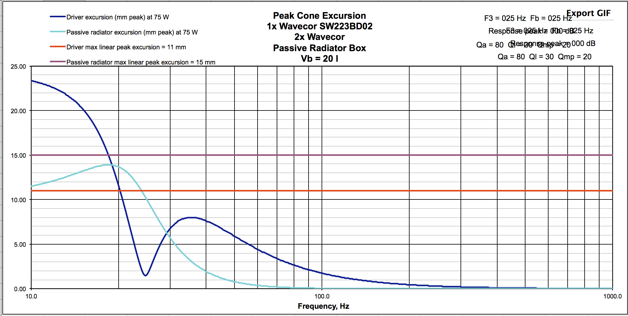

                    Alignment for 20L and PR's
                    Just to show you what the alignment would look like with 20L per SW223BD02 and the preferred PR setup:
                    And the excursion at this power level:
                    Punch that up another 6 dB per cabinet for the Ardent dual woofer setup (this analysis is for a single SW223BD02).
                    Mind you, this becomes a skosh pricey if realized with the Wavecor PR's, two per SW223BD02. The more practical way would be with 10" PR's, one per SW223BD02.
                    Now, going back and checking the files, in mid 2015 I did do a "what if" with 10" PR, in 70L, (nearly double the size of the existing Ardent), and then one can get down to 20Hz at -3dB, with a steepish roll off below that. A result of that, though, is that the PR's don't contribute much to output until one get's below 30Hz. And the ringing on step response goes on longer...
                    But that's 70L net low frequency volume, compared with 40L for the standard Ardent, and 40L for the above proposed PR. Take the dual 10" SS PR down to 40L volume, and it looks a lot like the curve above- nearly identical. The only tricky part might be the 10.6" diameter PR (Scan-Speak or Seas) on the back of an enclosure that's just 11-1/4" wide. That rebate would have to be routed after the enclosure was assembled, though I think the through hole could be partially routed (enough to finish with a follow bit) at the panel stage.
                    Something on my list of to-do's is to determine if there is a significant difference in LF large signal behavior between the Scan-Speak and Seas parts- the SL26R is a pretty knarley looking part with that silver cone and the massive surround. It may have better large signal behavior if the suspension lives up to the promise of better linearity under long throws. Time to find the first Minerva test box...
