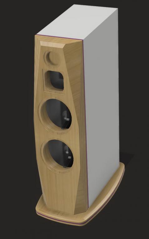

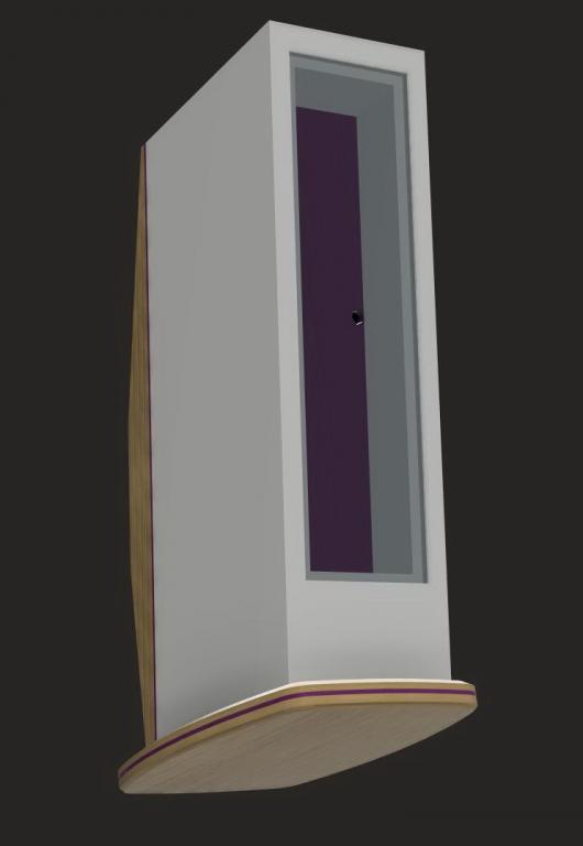

          Just a little update of where the project will be going. After pretty much losing the month of January due to my wife and I having Covid, I don't recommend it, I've been able to get some time on drawings for Danny's approval.
          Cabinet will be deeper to accommodate the crossovers being in the back of the cabinet in their own space.

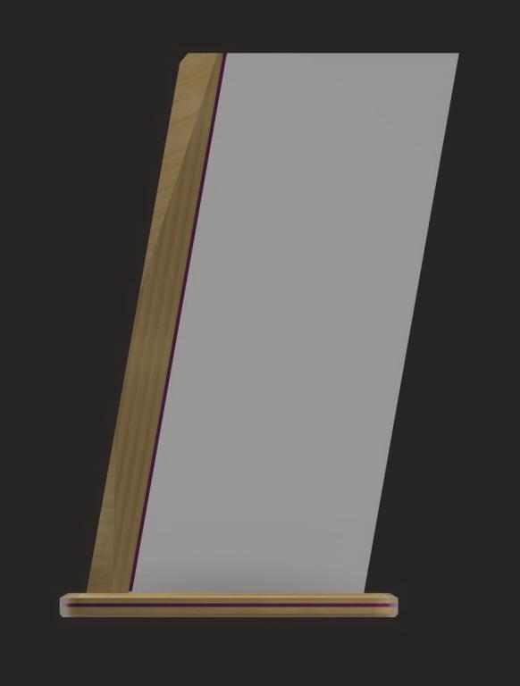

                Is the purple line in the wood an added layer for some style? Looking forward to seeing these built and how they turn out.
                Painter in training
                  • 1577
                  Yes, it'll be a bit of purpleheart for some fun little highlights. The crossovers will be built on the same.

                      Yeah, that was my fault ..... with the natural bamboo and Danny wanting to go with white on the rest of the cabinet, I thought it might look good to have a visual break between the two.

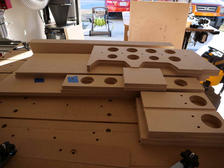

                                  • 2142

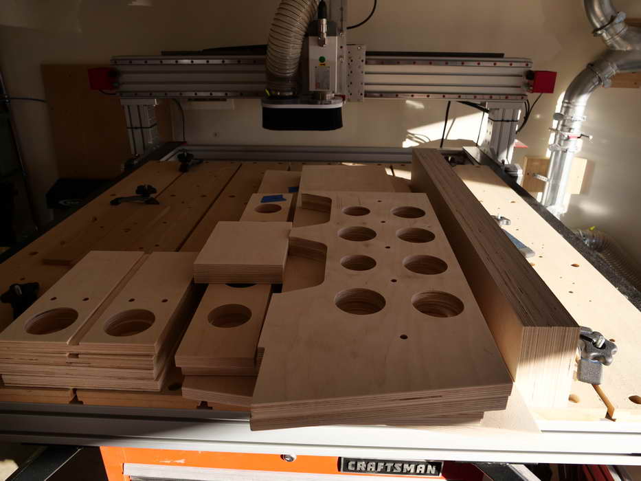

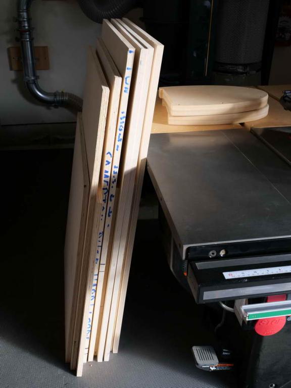

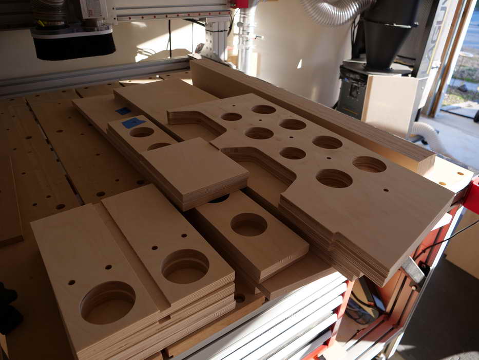

                                  Turning sheets into parts. I've been taking advantage of the decent weather we've been having and open up the shop doors and have a good chunk of the Baltic Birch parts cut.

                                      Still have more birch parts to cut and then on to mdf for the inner layer of the cabinet. The purple heart that I ordered appears to be lost in a snow drift somewhere. It was due for delivery on the 12th and UPS can't seem to find it. Rockler is going to send out a new shipment ...... hopefully the snow storms will hold off until it gets here.

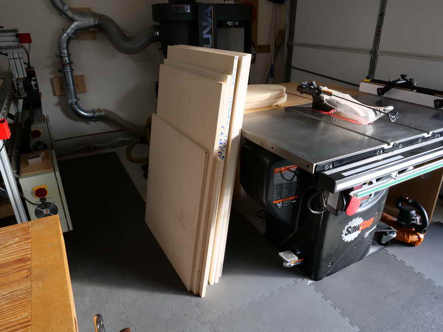

                                                    The pile is getting bigger ..... added in the mdf inner layer.

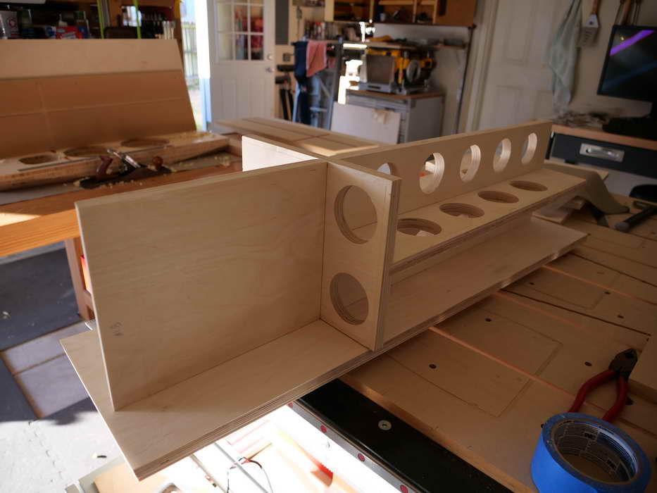

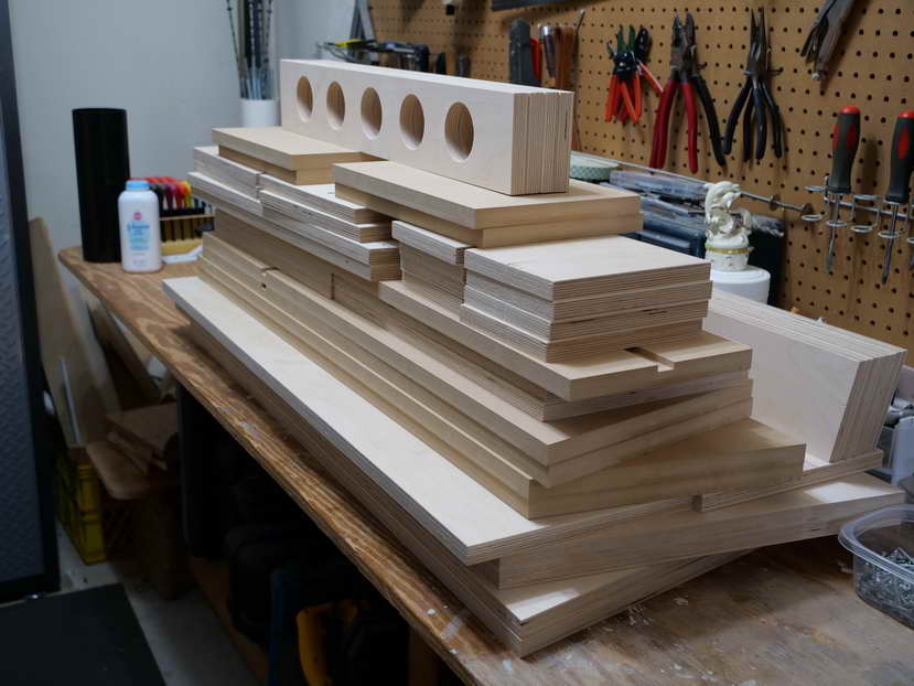

                                                          • 2142

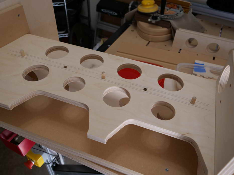

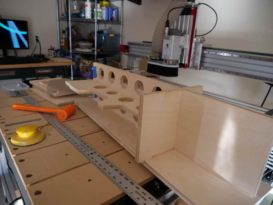

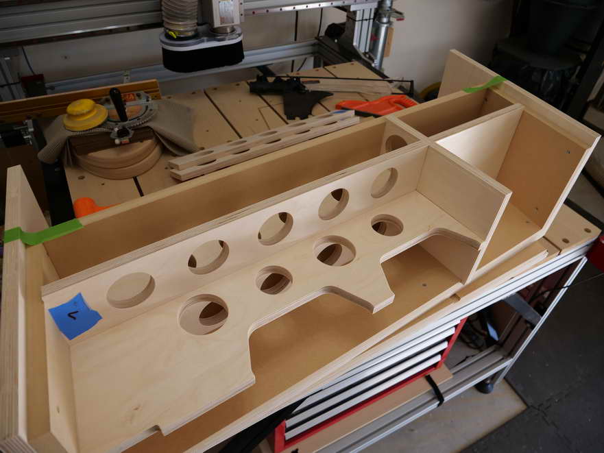

                                                          Since my CNC is only 3 axis and not 5, I've been getting some of the boards trimmed to length with their 10 degree beveled ends.
                                                          Fitting pieces together as I go for the first cabinet.

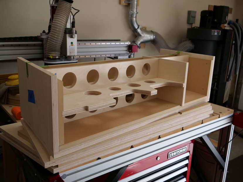

                                                          Here is the extra cabinet depth for the crossovers.

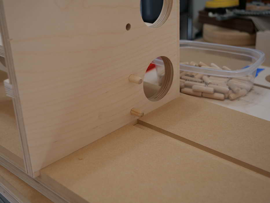

                                                          To save some time in not having to perform two sided machining on the CNC, dowels are being used in a few spots rather than dados.

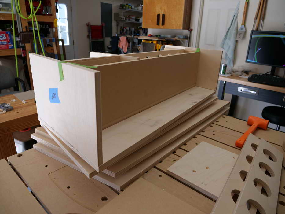

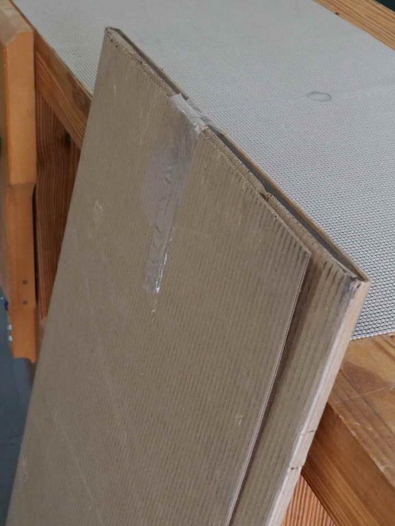

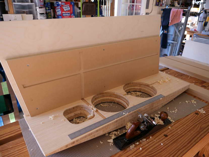

                                                                Made a little discovery yesterday .... even a 3" thick slab of bamboo is not perfectly stable. During a dry fit up of the first cabinet I discovered the baffle I picked was bowed, ~1/8". Apparently sitting on Danny's garage floor for ~3 years made it un-happy :cry:
                                                                So I had to pretend at being a woodworker and pulled out a hand plane and was able to bring things back in. I have not checked the second one yet, keeping fingers crossed.
                                                                Real wood shavings and everything.
                                                                Here's the woofer bracing assembly ..... need to round over the hole edges before that gets glued up.

                                                                  Yeah, I checked that myself and should have warned you. I have bad news on the second one...
                                                                  Are you going to be able to wrap these up while the humidity there isn't too crazy? I'd hate for something to crack once it's been relocated.
                                                                    • 2142
                                                                    What I'll do once I dry fit both baffles and "tweak" them, is to clamp them together back to back. That ought to help until they are glued in place.

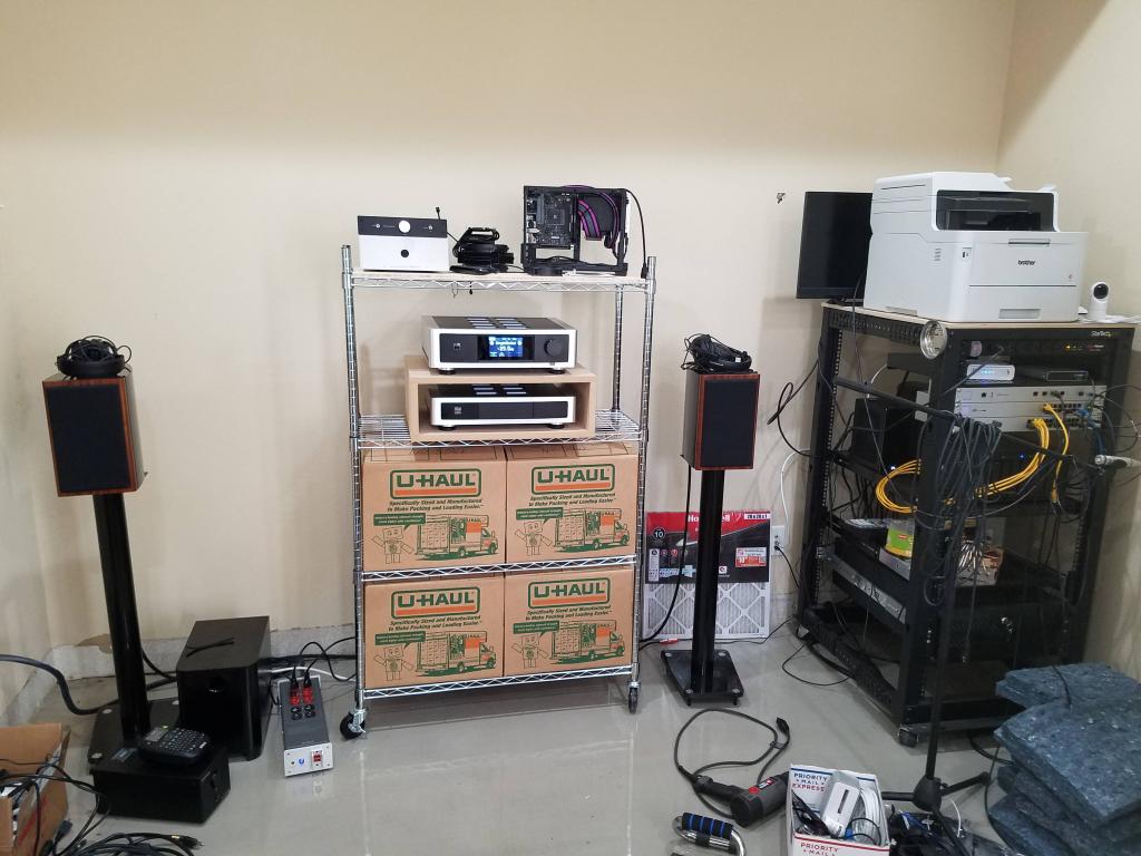

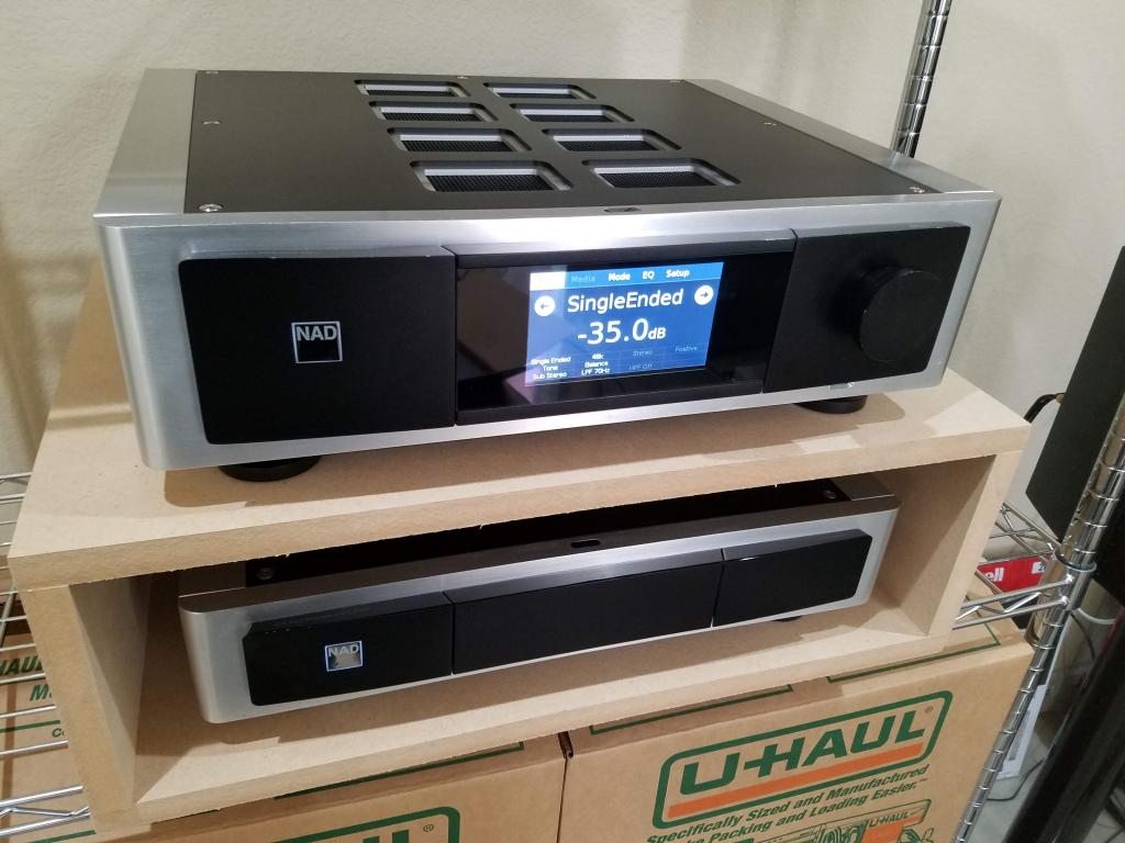

                                                                        Well, the other half of my new stereo arrived yesterday and was promptly put on a 50 cent shelf. Just need the Ardents themselves and some cables (on order) and I should be set - other than a cost-appropriate shelf, of course! Probably a series of rugs as well since the floor is just concrete.
                                                                        I need to figure out a better place for the network rack as well.

                                                                          Nice Danny ..... though we need to work on that stereo equipment rack
                                                                            • 1577
                                                                            Yeah yeah. I was looking at making something out of T-Slot aluminum extrusions, then found a company that makes racks out of it already with composite shelves (including granite).
                                                                            Prices are higher than I'd like, but I'm sure it'd approach four digits to order all the extrusions and parts I'd need to make my own - plus the time to make simple wood shelves. I'm not set on it yet but have yet to see a DIY design that I like. Maybe for Christmas.
                                                                            Alternatively, since this is a Class D amplifier I was considering a 'classic' audio rack with glass door. Sort of like the below, but using bamboo throughout to match the Ardents. Maybe a sliding shelf for a turntable too.
                                                                            Of course, none of that addresses the boxes of CDs I have - four of which are seen in the aforementioned stereo rack and another three are sitting behind me...
