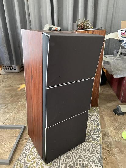

    Vintage Bang and Olufsen Recycle build

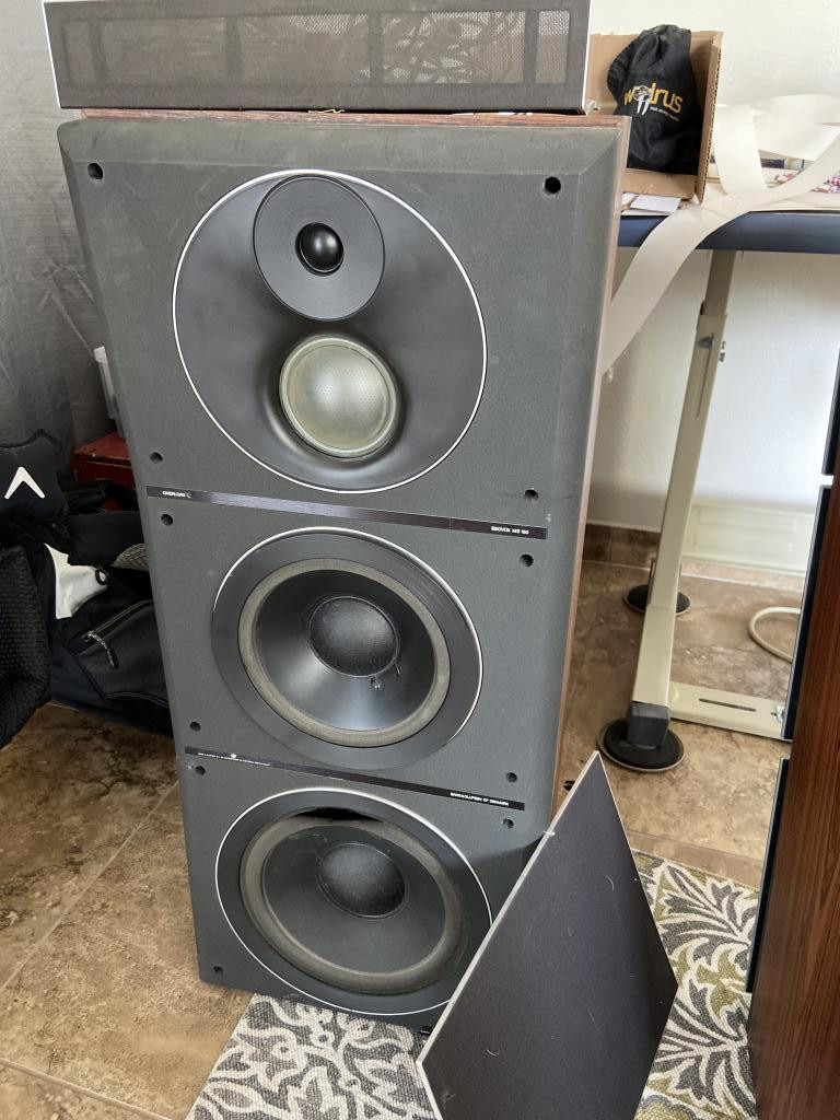

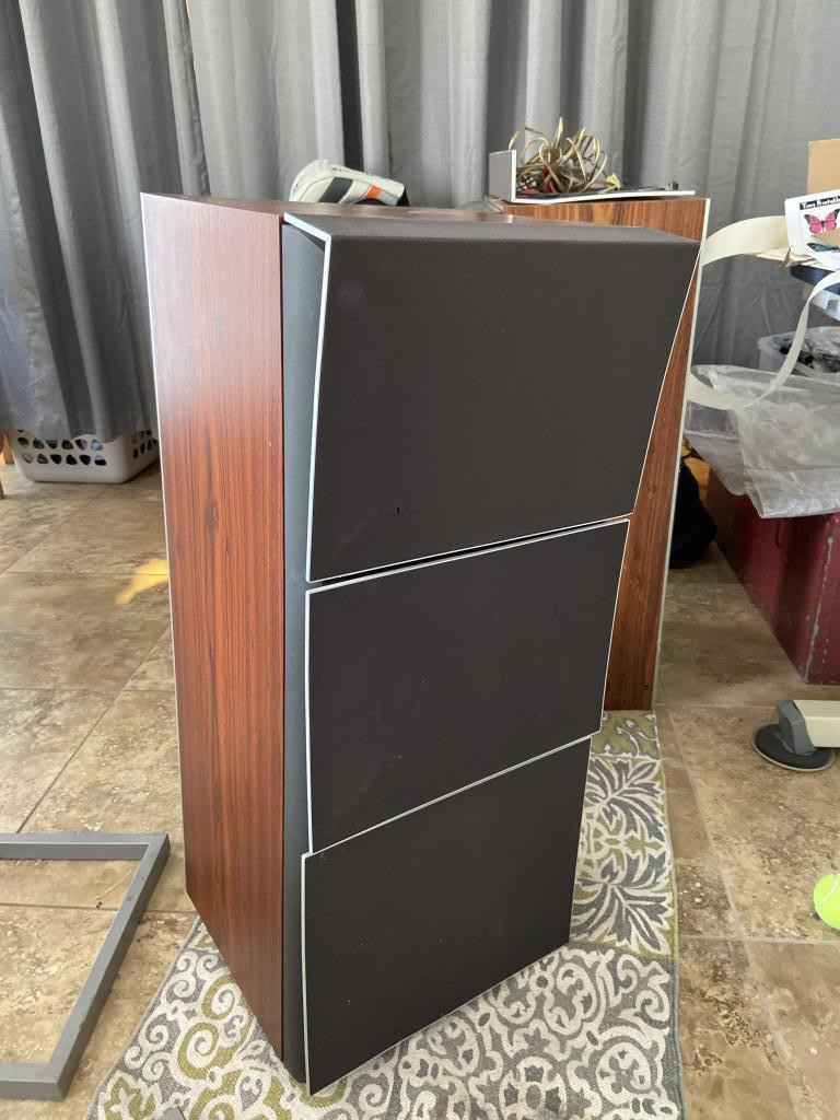

    Objective:
    Well I am itching for a build and have these lying around and want to do something with them. The surrounds on the drivers are shot, and the crossover parts are 40 years old. I am thinking of reusing the cabinets and building a 3-way or something that will go down fairly low. I will reuse the stands and keep the vintage look of Bang and Olufsen with new drivers and parts. My thoughts are that there are experts in this thread that can help guide me in some directions.
    My Skills:
    I have build two surround systems 10 speakers in total from kit speakers from Zaph and Madisound. I have yet to design a crossover, but am familiar with the process and components. I am aware of free software but have not used any. I do not have testing equipment, but it on my list of needs. My woodworking skills are decent. I have build furniture, chicken coops, speaker cabinets, etc and have the tools. I am good with soldering and have designed reef tank lighting and such. I sew and have made my own backpacking gear and make fly rods. I like DIY and like a challenge.
    Specs:
    -Cabinet size is external 33"h x 14"w x 11"d
    -Downward firing port- Have not measured it yet but will when I take the baffle off. I can reuse this port, but it is not necessary.
    -The speakers sit slightly at a back angle on the stands and I would like to keep them. Will Measure this angle.
    -The current baffles are curved. I will probably redesign the baffle, but could reuse. The Mid driver and tweeter probably sit vertical when on the stands.
    -Can scrap everything but the cabinets and stands.
    -I do not know if there are any dividers in the cabinet.
    Initial Thoughts:
    I was thinking of a 3 way design. Something similar to the Travelers or Finalist. I am open to driver suggestions. For an 8 inch I will probably go with the ever popular Dayton used in these two designs. If I use the existing baffle, the bottom driver is 8" and the middle driver is around 7". Thinking trying to design a system to the baffle will be more complex than just making my own baffle. The back angle of the stand will call for crossover adjustments if the baffle is flat.
    I am open for any kind of suggestions. I do want to recycle and up cycle the cabinets.

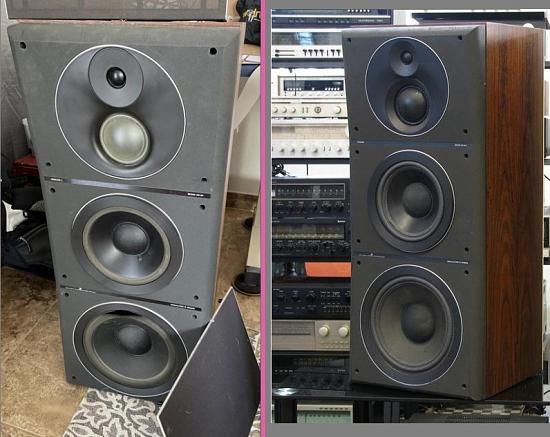

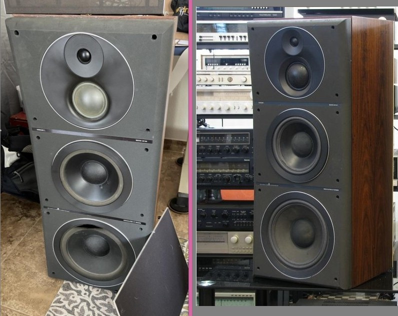

  • bbe22
    • 7
    ? original on the right
    Last edited by theSven; 04 May 2023, 12:13 Thursday. Reason: Update image location

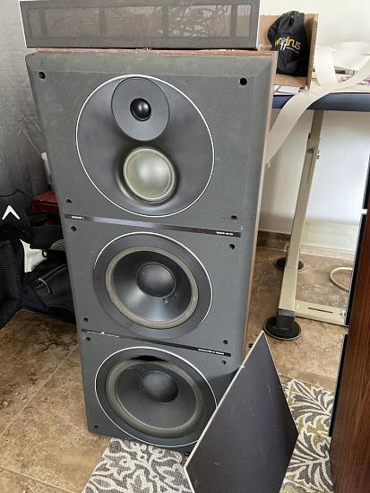

          Well, I took the baffle off today and dismantled the speakers. Found a few things:
          The bottom woofer is 10" not 8"
          The Middle woofer is 8" not 7"
          The tweeter looks like a 1 1/4" and the other midrange is about 3 1/3".
          The bottom two speakers will fit right in on a rubber flang and screw right in with brackets.
          I will need to make a baffle to fit in the tweeter hole. I could probably fit a 4" driver and a tweeter. Probably about 8 inches of space here.
          A bit Baffled on what to do. As simple as the 10" and the 8" would be to retrofit, makes me want to try and use the baffle.
          The cabinet seems sturdy. Would probably put some braces in, if not separate the 10" from the top end.
          Would love your thoughts.

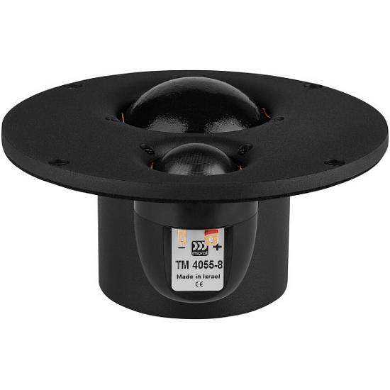

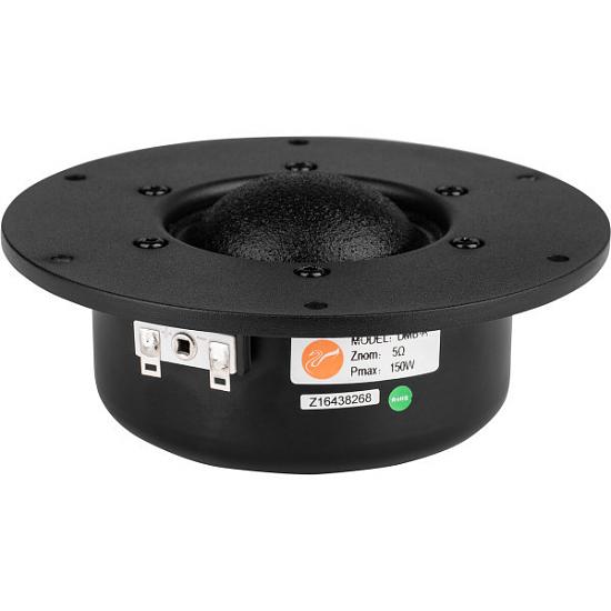

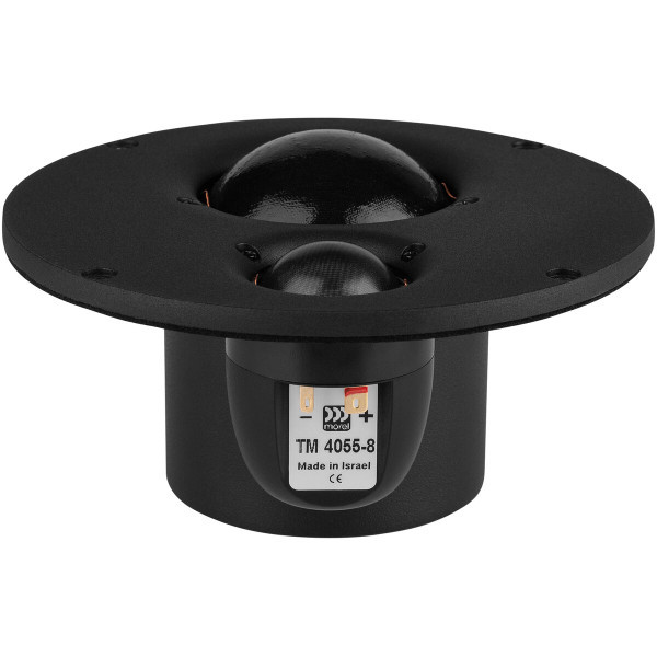

                Neat project! That baffle is too interesting to not reuse it
                Are the tweeter and mid on a removable panel? What is the tweeters flange diameter?
                https://www.parts-express.com/morel-tm4055-8-2-midrange-and-1-1-8-tweeter-speaker-plate--287-038

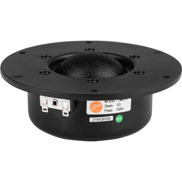

                https://www.parts-express.com/hivi-dmb-a-2-fabric-dome-midrange--297-716
                Just thinking out loud, but you could use an 8" woofer and fill the 10" hole with a passive radiator. Have you looked into having the original woofers re-foamed?
                Last edited by theSven; 09 April 2023, 03:00 Sunday. Reason: Update image location

                    I did see that Morel the other day. I am not necessarily thinking of filling the existing holes. I might just replace the 9 inch baffle with something I can cut a tweeter hole in. Or a small midrange and tweeter in.

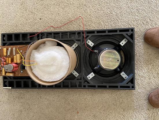

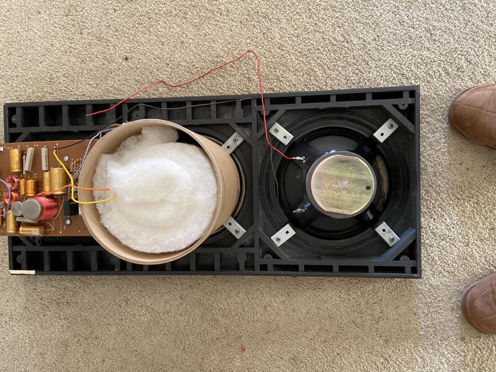

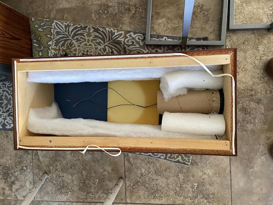

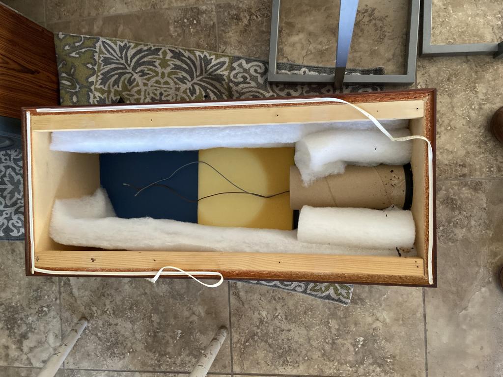

                        Pictures of insides
                        Here are some pictures of the inside.
                        Last edited by theSven; 09 April 2023, 03:01 Sunday. Reason: Update image location

                              After seeing the pictures of the insides of these, it makes me ponder our DIY construction builds.
                              Now, I realize that mass manufacturers have to build things as easily and cheaply as they can to a certain extent to make money. When you look at their cabinet construction, it's nothing like a DIY'er would build for the same box size. No cross braces at all, AND their cabinet is made out of particle board, not even MDF. MDF feels a lot stiffer than particle board to me. Are the sides of these boxes imparting a lot of resonance?
                              Their port is a cardboard tube, and at the end of the day, that probably gets the job done. We'd opt for something like PVC, though.
                              That's kind of an interesting concept on the mid volume too. It appears that the cardboard tube probably sits against that piece of foam on the back side of the cabinet, essentially closing off the tube, and making that a separate chamber for the mid. Again, cheap, quick, and effective enough?
                              It would be interesting to know just how much "engineering" goes into all of this stuff, and figuring out the "exact" location that they should put the batting, and why they chose the locations they did.
                              When I do something for myself, whatever that is, it is always too easy to overbuild, and overengineer EVERYTHING. You do end up with nice stuff, and at the end of the day, for me personally, that's the reason that I do things for myself. At least I know what went into it...

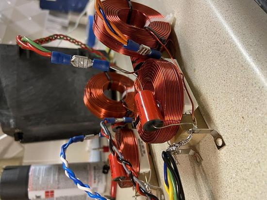

                                                    • 1678
                                                    Both of those speakers are the originals in the pictures above. One is the MS150 and one is the MS150.2 hence the slightly different look.
                                                    If the only thing wrong with the speakers is the shot surrounds why not replace them?
                                                    https://lautsprecher-technik.com/Speaker-Repair-Parts/Speaker-Refoaming-New-Edge-Foam-Surrounds-Repair/Bang---Olufsen-Speaker-Surround-Refoam-Edge-Repair-Kits/Bang---Olufsen-Beovox-MS150-Speaker-Surround-Re-Foam-Repair-Kit---Midrange.html?language=en
                                                    Bang & Olufsen Beovox MS 150 Speaker Surround Re-Foam Repair Kit - Woofer. The most common problem with speakers are rotten, torn or damaged surrounds. Constant vibration, moisture and the time cause foam, rubber and cloth surrounds to degrade. This causes distortion or the speaker to lose sound. Our easy to install repair kits will make your old speakers sound just like brand new. You can repair your speaker with flexible Surround (Edge) easly and make it brand new with vibrant sound quailty. Our foam surround has flexiable design, produced by polyether technology, making it durable. polyether foam have excellent heat, light, ozone/weathering, and aging resistance. To correctly repair your speaker, it is sent with repair guide which includes videos and images.
                                                    Just check that the crossovers are still functioning well and enjoy them as they are.
                                                    Edit - it seems like there is a lot of information on these if you do a bit of searching.
                                                    Welcome to Beoworld Welcome to forum.beoWorld.org, the ultimate destination for Bang & Olufsen enthusiasts! Whether you’re here to explore, learn, or connect with fellow fans, you’ve found the perfect place to dive into the world of B&O. From vintage treasures to the latest innovations, BeoWorld is your community for everything Bang & Olufsen. Enjoy your […]
                                                    A chap here recaps the electrolytics in the crossover and leaves it at that. A sensible option in my opinion. Along with surround replacements you'd have your speakers up and running fairly quickly.
                                                    Last edited by theSven; 09 April 2023, 03:02 Sunday. Reason: Update image location

                                                                          Did some cabinet work this weekend. back, top/bottom, right/left will be 1 1/2" thick with mdf inside and the plywood with Venere outside. I will have two braces between speakers. I cut rings for the 8" and 7" RS drivers that they will attach and be locked into the baffle. I may find a way to deaden the baffle a bit. I will start glueing up tomorrow. Still waiting on the tweeters, they were back ordered. I will get some pictures up when I get the insides glued. I have been getting little interest on the forum, so I may move the thread elsewhere. Seems as though my speaker hack job may be more suited for another forum. May need some hillbillies to see my vision. If I move it I will come back and post the finished project with hopefully some measurements and a subjective unprofessional review.

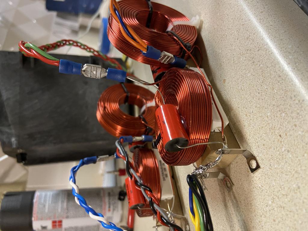

                                                                              Here is the crossover for the mini project. Test sounds good, will build the baffle soon.

                                                                                Even recycled the hookup wires by braiding three of the internal hook up wires. Cool fun little project. May recap my old NAD to run these little guys.

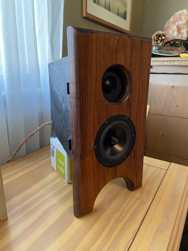

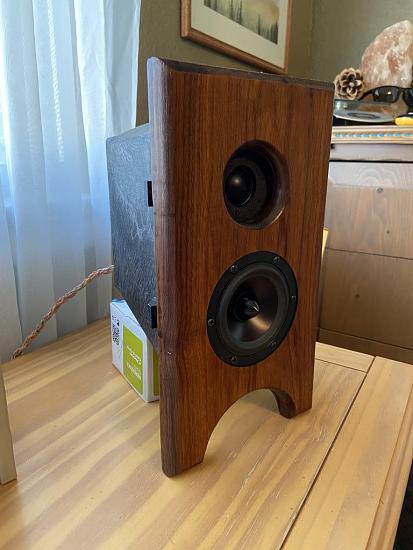

                                                                                      Finished mini speakers with original tweeters.

                                                                                      • thehillboys
                                                                                        • Sep 2010
                                                                                        • 55
                                                                                        I kept the enclosure that the mid and tweeter came in and attached it to a walnut baffle made from a piece of scrap Walnut I had lying around. They sound good. Sealed enclosure so they might need a sub eventually. Running them with a Topping Mx3 at the moment. Designing a stand to keep the back up. Right now I am using the driver box to prop them up. I do not have measurements, but a bit of bass boost from the MX3 helps the low end. Probably could have used a bit of a baffle step for the 4 inch, but the bass adjustment on the MX3 does the trick. When I can afford a test mic, I will take readings and see if it is worth it to boost the bass. A sub will also cure the issue. Can't hear anything strange in the mix without testing them.
