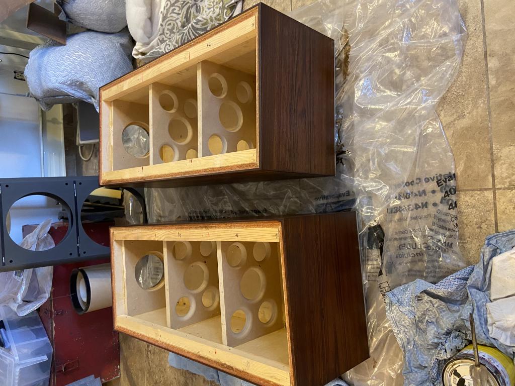

      Modified cabinets
      • thehillboys
        • Sep 2010
        • 55

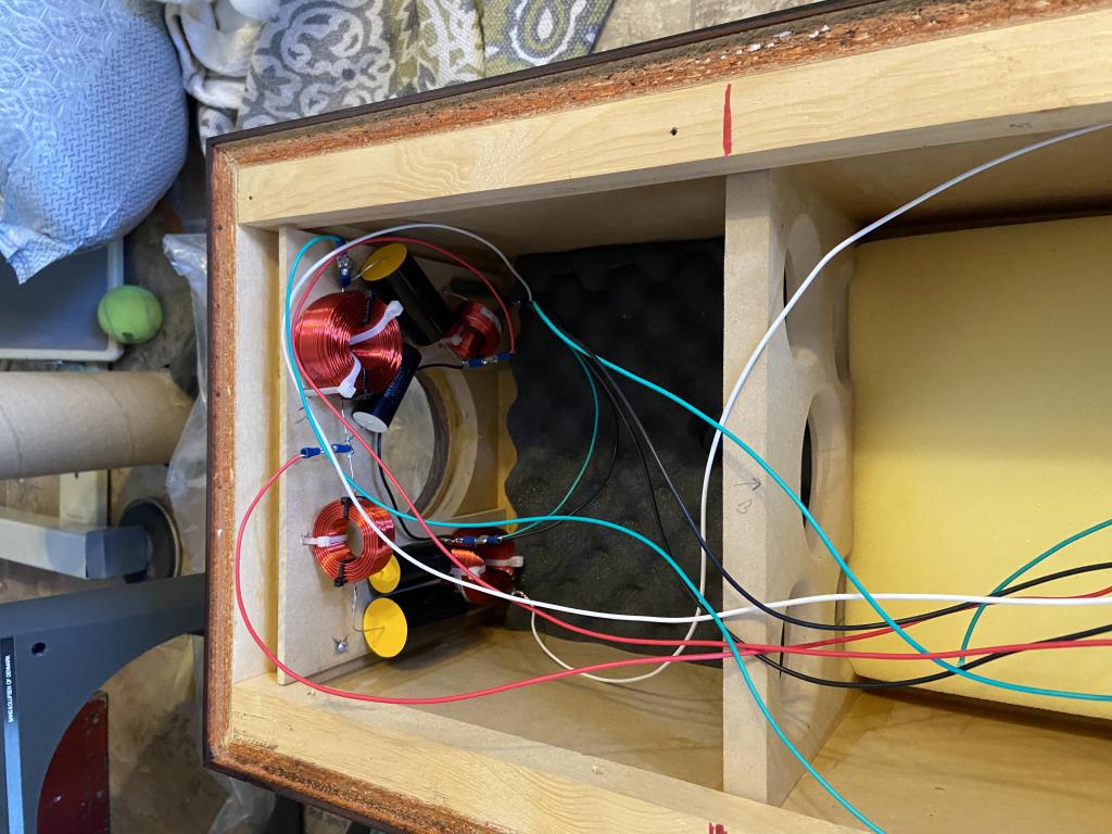

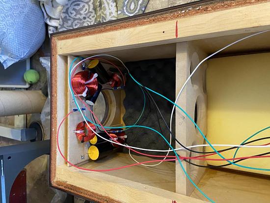

        Cabinets with one coat of stain. Modified internal cabinets with two braces and 3/4 MDF lined walls. Makes the walls 1 1/2 inches plywood outers MDF inner walls. Makes them very dead. Starting work on crossovers and baffles next. I am gong to try the mid inclosed and sealed in the cardboard tube that the other mid was enclosed in. The 8" and tweeter will be in the remaining enclosure. Going to use the previous tubes. With the volume and the tube, it calculates it tunes to about 40.

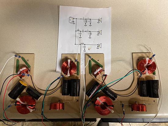

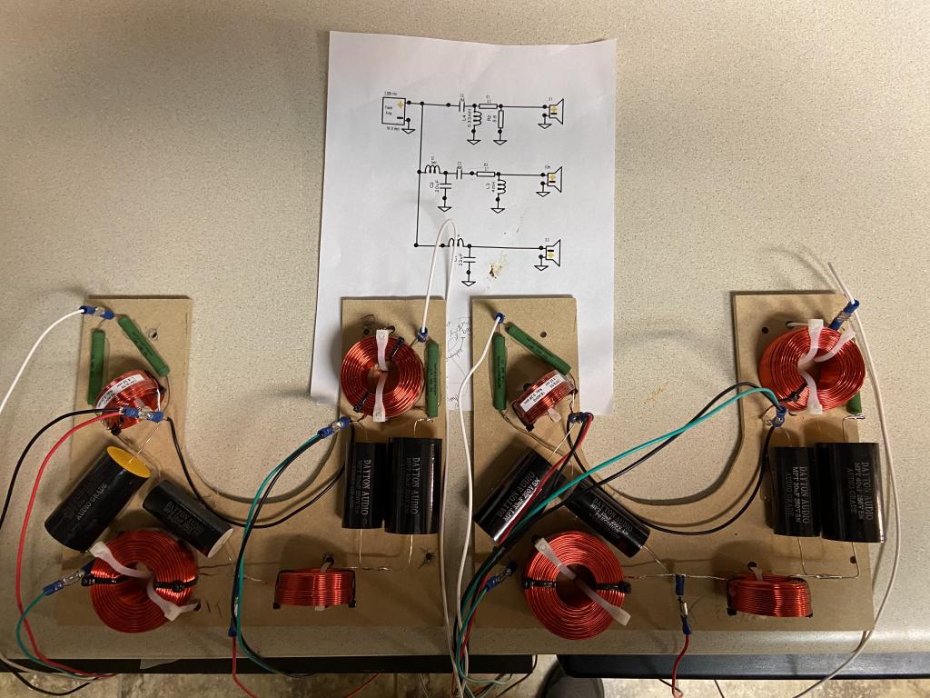

            Crossovers finished. Working on the baffle now. Should have something to test tomorrow.

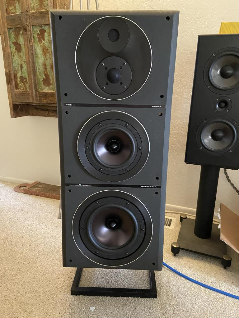

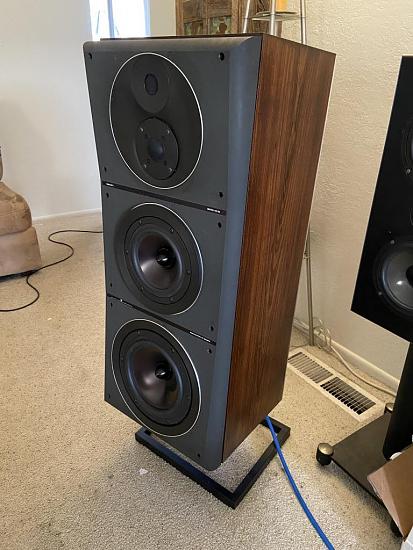

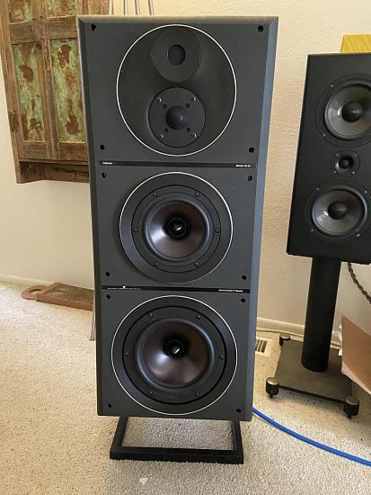

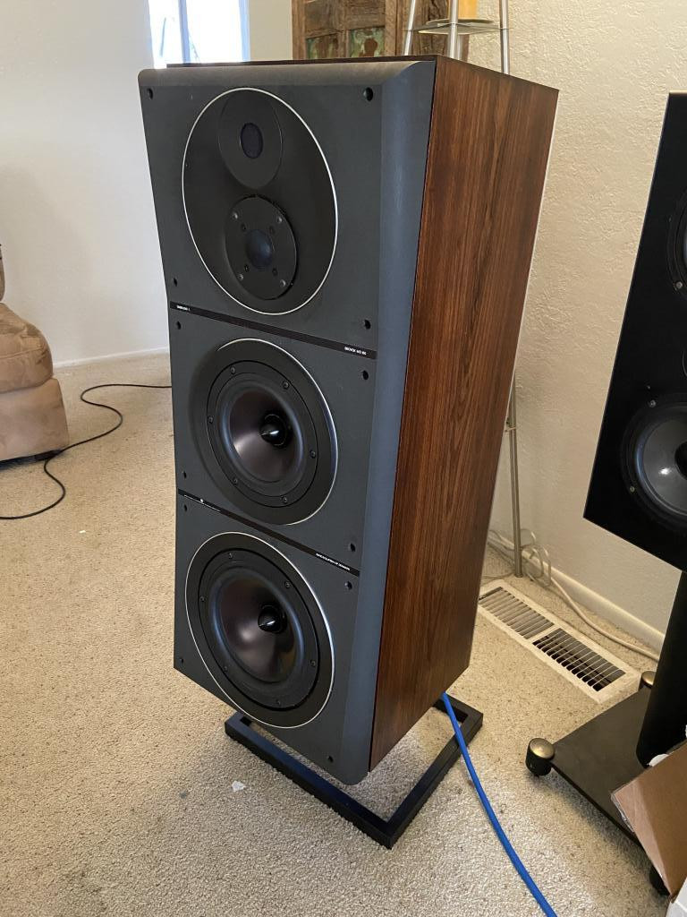

                A couple of new pics. Assembled and testing. I still have to apply tru-oil to the cabinets and get black screws for the baffles. Coming along.

                  The tweeter is in the original mid range hole and the original tweeter hole is a dummy covered with a mdf puck covered in grill cloth and glued to the baffle. I built rings for the baffle for the 7 and 8 inch woofers to attach to. they fit pretty good in the original holes. I used the original hardware to clamp the rings down. They are heavier than the original so they are taxing the stands a bit. I also did not account for the binding posts interfering with the stand so they are leaning a bit back than normal. Fix this at a later date.

                                The top tweeter hole is a dummy piece of mdf covered with speaker grill cloth. The crossover is a 3 way so the RS180 is crossed both around 350 and 2000k. It is enclosed in its own tube recycled from the originals. I had it stuffed densely at first and have backed off to about half of the original amount of Poly. The 8" on the bottom could go a bit lower. I have it tuned using the original port tube that was 4" diameter by 10" long. With the volume estimated I think it tuned to about 39db.

                                  I was going to enclose the tweeter and mid into their own sealed enclosure, but with the baffle it would have been difficult to get it sealed off. Why I reused the tube for the mid. It also increased the volume for the RS225-8. Crossover diagram is above.

                                      They were originally a four way. The tweeter is in the 4" hole where the upper mid was originally.
