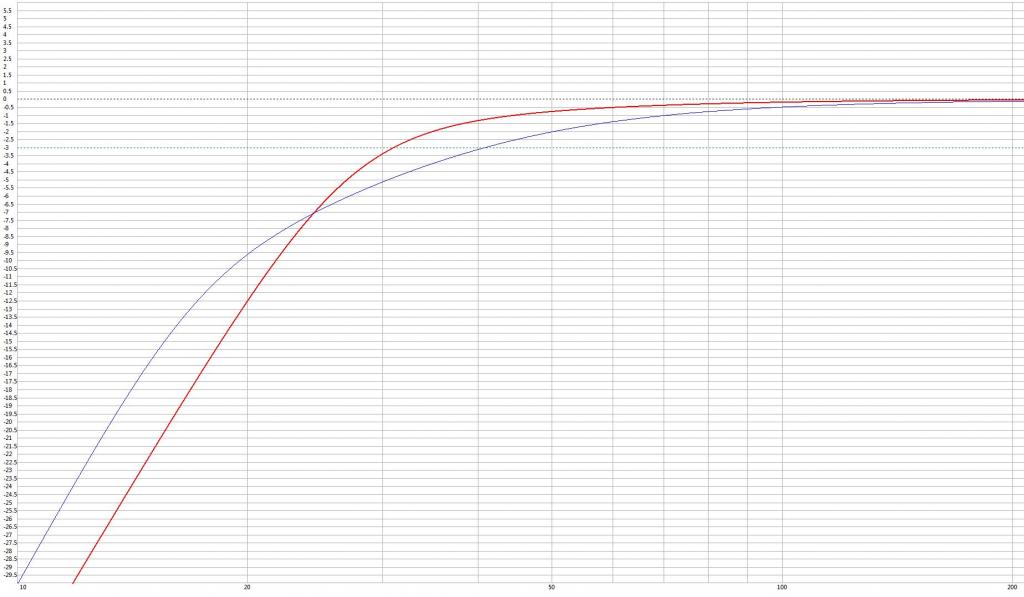

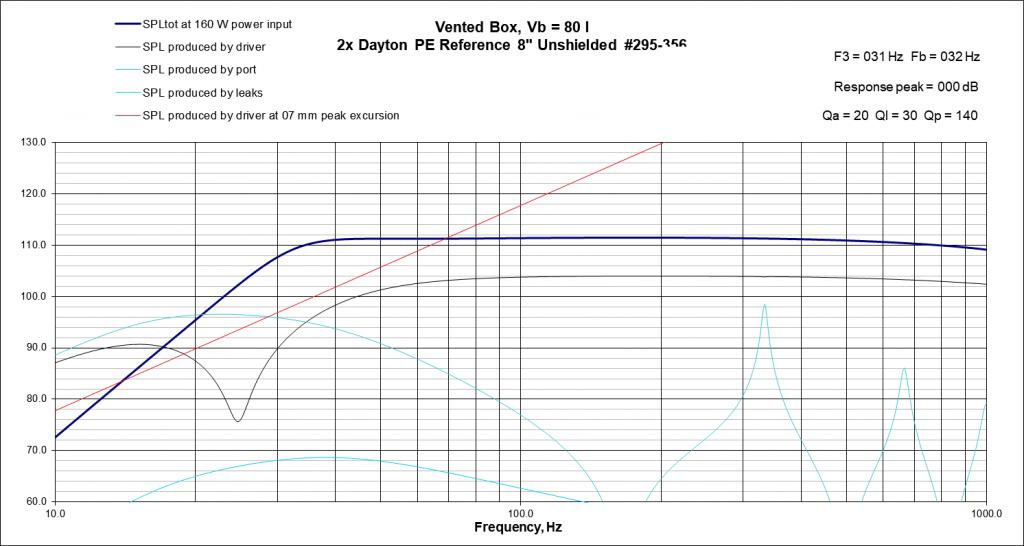

                  I listened to the song on Amazon. It's a nice song but it has some very low bass in it. The bad news is, based on what you're hearing, two of the drivers are toast. They need to be replaced. I'd suggest you get in touch with Mark and work it out with him.
                  Here's a graph from Unibox that'll give you a good indication of what you can expect from (2) Rs225's.
Name:	VB Response Dayton PE Reference 8.jpg
                  This graph is not based on a listening position of 12' or more but is based on one meter
                  I'd suggest you move forward with a sub if your listening tastes are low bass and cranked a bit. Roll the sub(s) in at 50-60 Hz. and you'll be able to crank them hard without damage. The Bordeaux will be good for 112+ at 50-60 Hz. without damage.

                          This is a good page about speakers and power “handling”
                          Jim’s graph is useful but as usual, the are a few ways of interpreting this:
                          1) the speaker can “handle 160W”, but only where the red line is above the blue line. ie. above 70Hz
                          2) in the low bass- eg. 30Hz, the speakers physical Xmax limitation is 10 dB less than what it would play if fed 160W...
                          3) the power handling at 30Hz is limited to about 16 watts.
                          This is all technical jargon, but the sensible approach is-
                          Turn it down if you hear audible distortion.

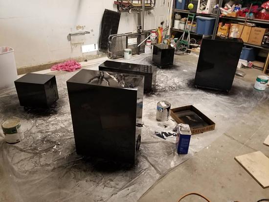

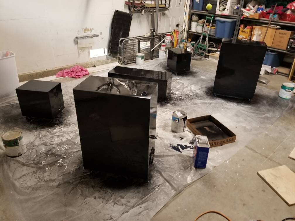

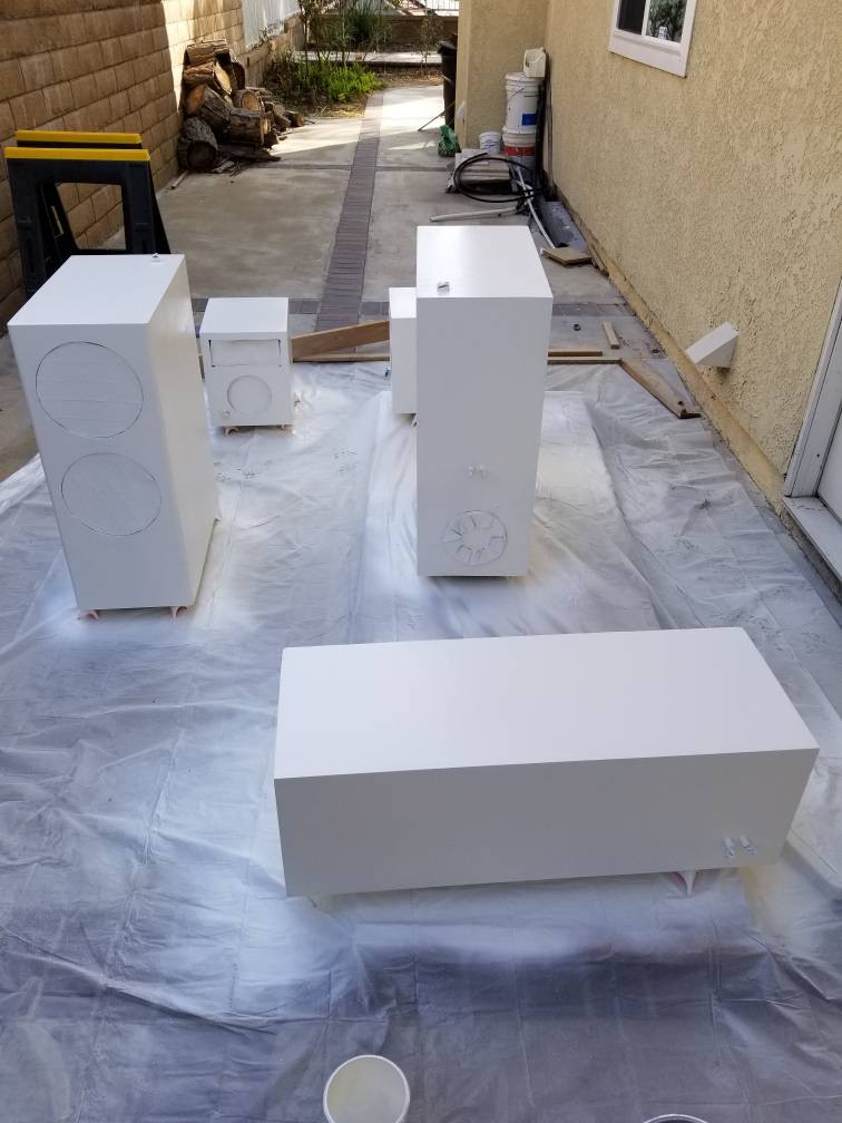

                                                    These speakers are for my parents.
                                                    I have been trying to convince my dad to go glossy white I think that will look really nice. But he is traditional and wants black speakers.
                                                    Here is how they look primed.

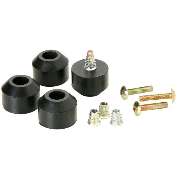

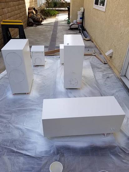

                                                      Where do you guys get speaker feet from not spikes.
                                                      Another update

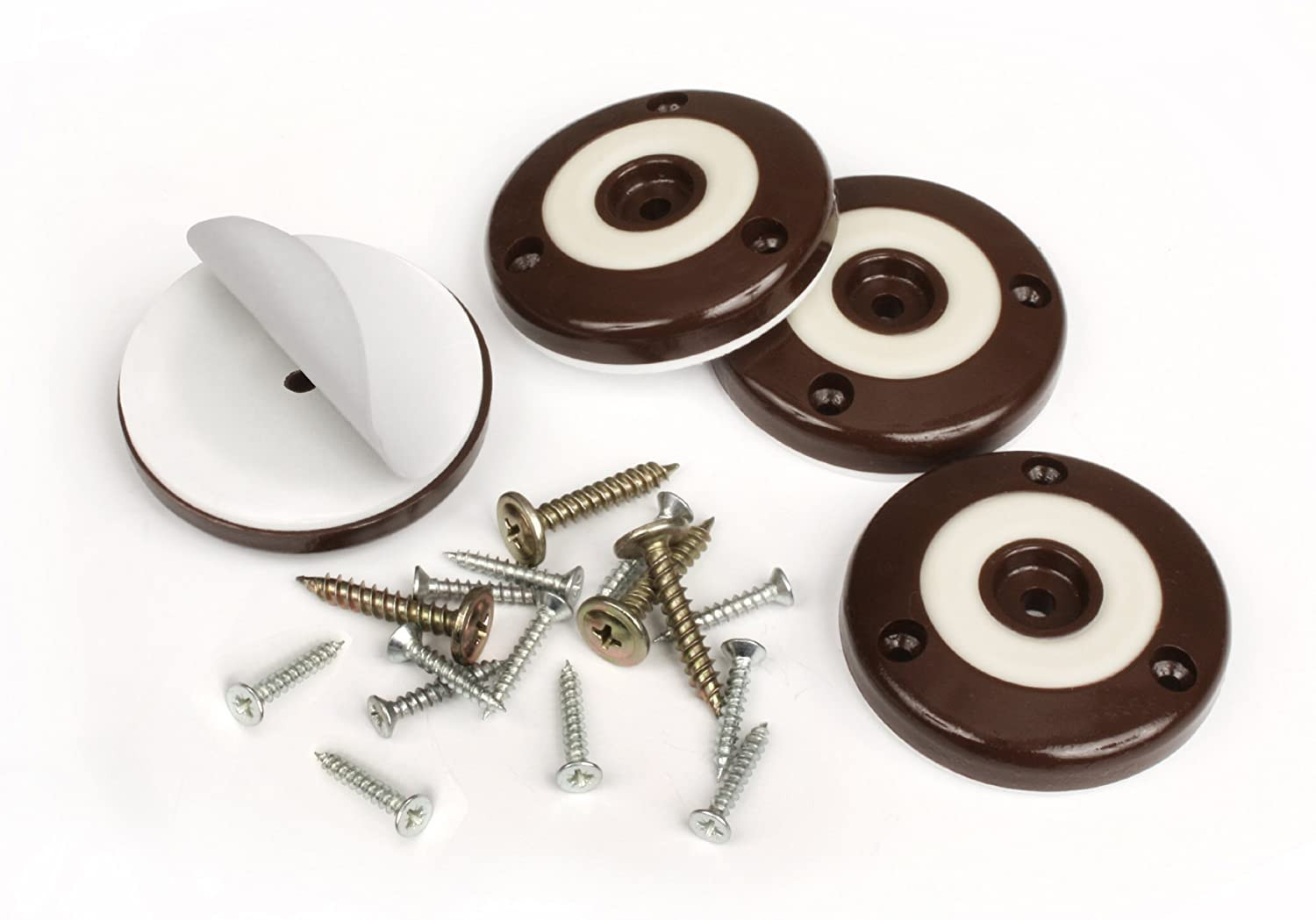

                                                        #118
                                                        I used these for my Statements II build.

                                                          Here’s another option i’m happy with.

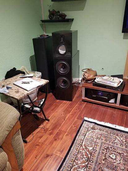

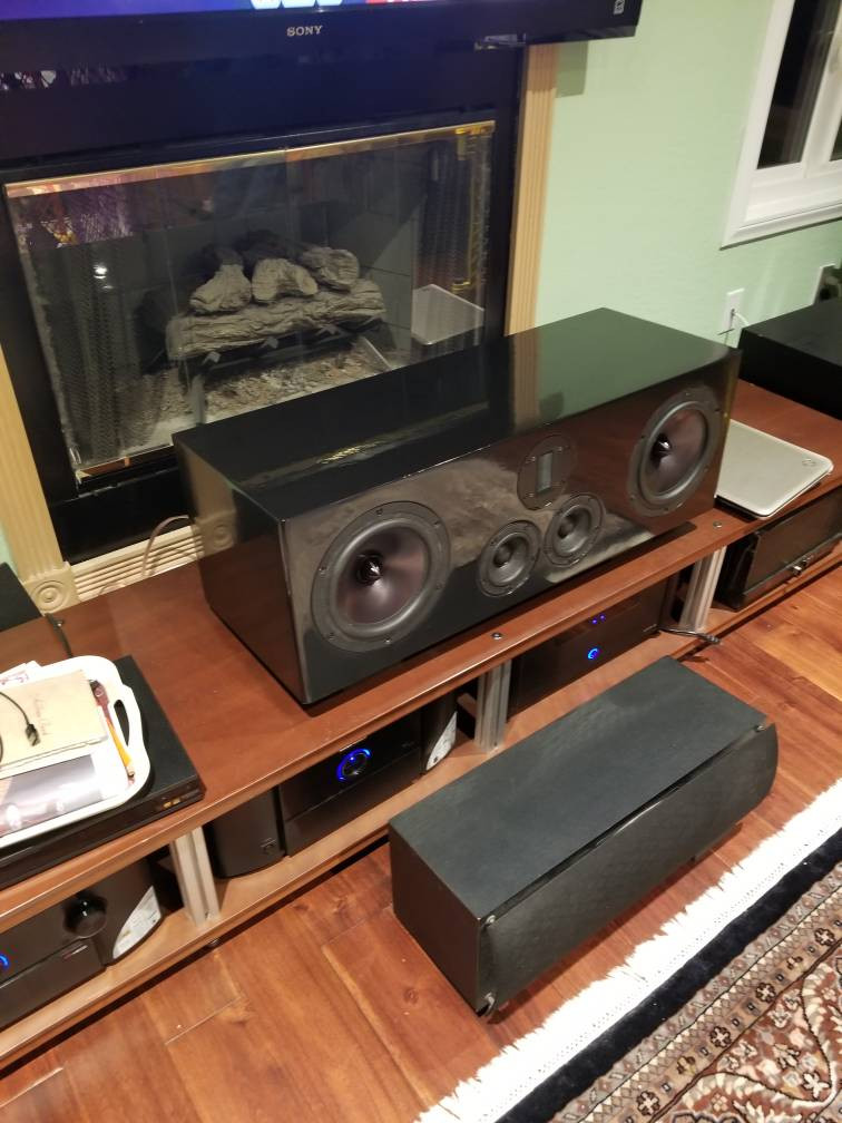

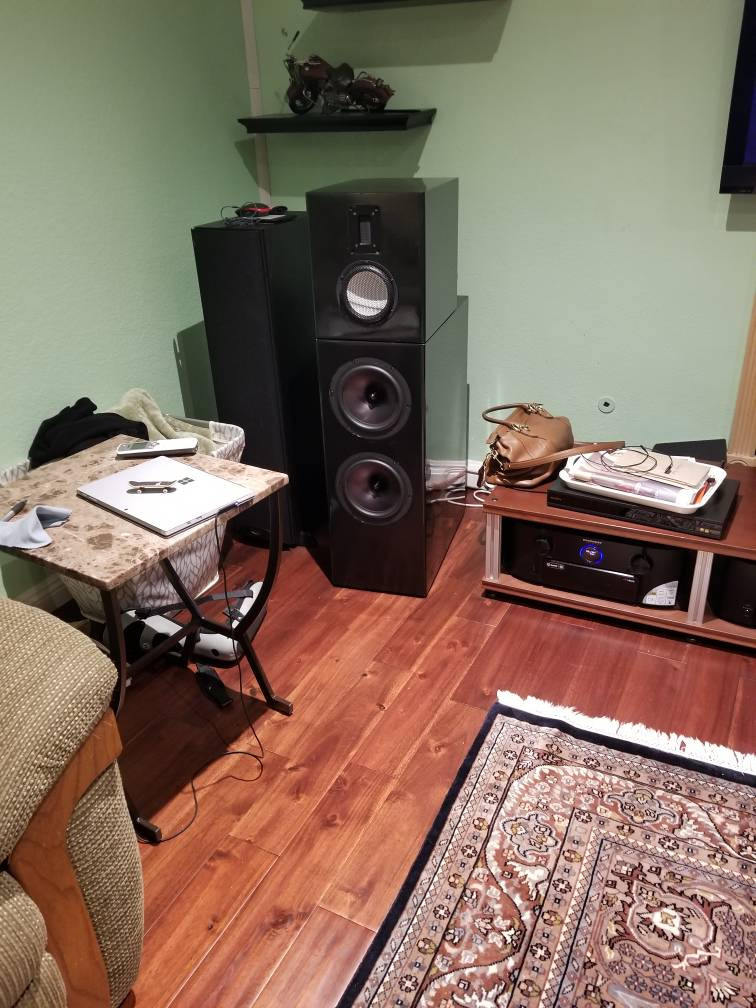

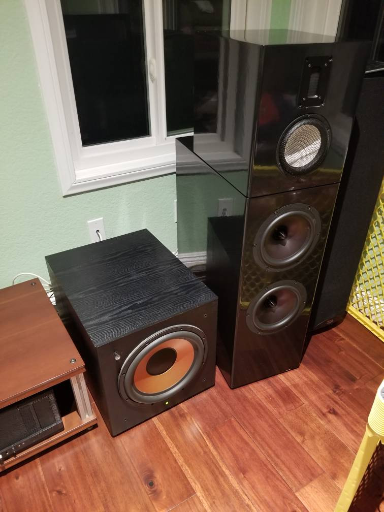

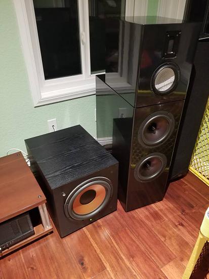

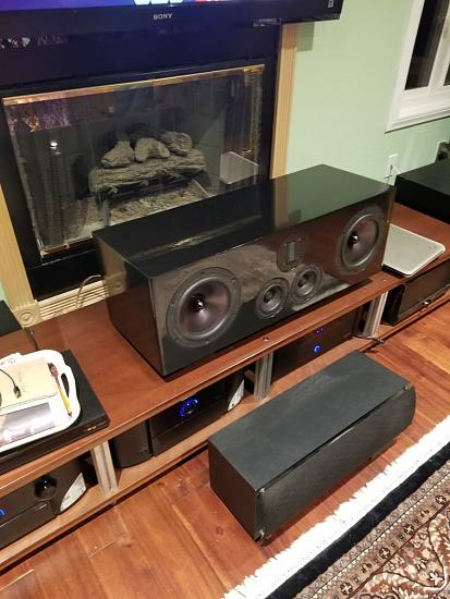

                                                                Finished build pics attached.
                                                                Sent from my SM-N950U using Tapatalk
                                                                Last edited by theSven; 10 April 2023, 14:14 Monday. Reason: Update image location
                                                                  • 571
                                                                  #123
                                                                  They turned out great! You must tell how you did the black finish....and how they sound. Overall great job.
                                                                  • boinger
                                                                    • Nov 2018
                                                                    • 77
                                                                    #124
                                                                    Thank you. They sound amazing, some of the tracks I listened to compared to our old speakers were just a night and day difference.
                                                                    The black finish was very confusing..
                                                                    I kept trying to find information on how to get a piano black finish, but it was very varied and so many different techniques.
                                                                    We had used some black paint from sherwin williams and was trying to figure out how to clear coat it. We weren't really sure what would go on top of the paint without lifting or dissolving the paint.
                                                                    Since we were unsure we basically just went back to basics. Did a shellac finish for the gloss layer with a french polish to get the glossy look. Apparently shellac works on literally everything. Just doesn't take kindly to water and damages easy. But I figured I am not planning to wet the speakers or be rough with them so it should be okay.
                                                                    Also apparently shellac finishes are really easy to spot repair should the need ever arise. You don't have to re-sand and refinish the whole thing.

                                                                                    What seems to be the problem. I made a mistake myself and had wired the midrange out of phase which made it sound echoey and recessed.
                                                                                    • Efalegalo
                                                                                      • Jan 2007
                                                                                      • 162
                                                                                      #133
                                                                                      More Bass
                                                                                      Originally posted by boinger
                                                                                      The mids sound great although I will be honest I was expecting more bass. For the cabinet volume.
                                                                                      Boinger,
                                                                                      I had the same experience.
                                                                                      Try this: remove the inner tube of the port, leaving just the flares end to end.
                                                                                      It should be a 5-minute exercise.
                                                                                      If you try it - let me know what you think.
                                                                                      It made a HUGE difference for me. See the predicted difference below (grey = 5" inner tube, red= no inner tube).
                                                                                      - D
