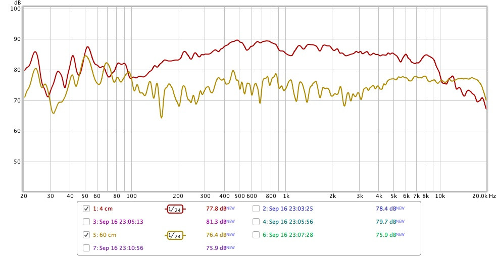

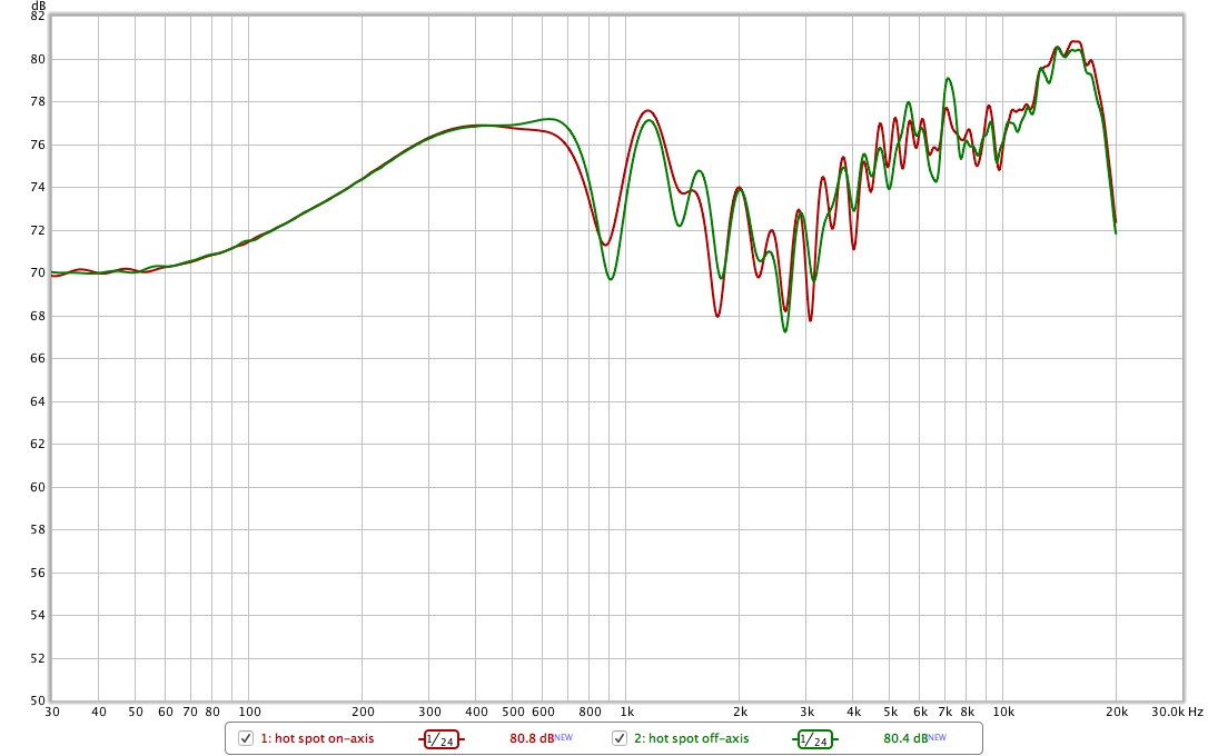

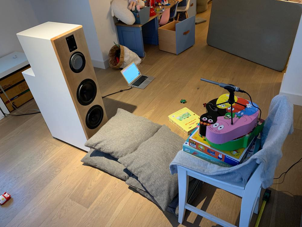

    I've bought a measuring microphone, the MiniDSP UMIK-1, and I've done some measurements of the full range of the speaker.
    1. at about 4cm from the front of the baffle, microphone positioned between the tweeter/mid woofer
    2. at the about 60 cm (2 feet), same height.
    During the first (near field) measurement I was quite sure my build wasn't effected, but the further away I measure the less sure I get.
    Do you think my measurements conclude to anything? Or do I need to do additional tests, and if so, what is the most effective way of figuring this out (without me damaging the tweeter 8))?
    Many thanks in advance!

    Krizork,
    Try taking another measurement from about 1 meter away. Point the mic approximately between the tweeter and the mid-woofer.
    Also, bring the speaker into the middle of the room, away from the corner currently pictured as well as other near boundaries. Make sure the nearest boundary is at least a 1 meter away.
    Next - gate the measurements. Go to "Tools" --> click "IR Windows", then under "Right Window (ms):" ----enter say 3.5
    Gating will kill measurement resolution below say 500hz, but you should still enough resolution to test whether you have an issue in the 2Kz - 5Khz region.
    Lastly - increase the steps for your measurements. A 10db step is too much to pick up any oddities. Go for at most 5db per step.
    If you find that you have a dip in the 2Khz - 5Khz region, try moving the mic up and down by few centimeters (e.g 5 or 6 cm) and remeasure. If the dip persists, you may have a similar issue as I did.
    Goodluck.
    • Dave Bullet
      • 476
      What you have there @ 60cm shows a great speaker IMHO. Most designers pick a listening axis. This is usually the tweeter. So measuring at short distance and not on the design axis will a) introduce errors associated with nearfield measurements (not taking into account the baffle step which you can see rising in your 4cm distance measurement - but allowed for in the design at your 60cm measurement) and b) introduce a lobe off vertical axis that may emphasize (peak) or recess (dip) a particular frequency band which won't be apparent on the listening axis
      The rule of thumb is to measure at a distance at the lowest XO point / 3 or 3 * the CTC spacing between widest drivers (crude and from memory). In the case of most 3 ways - this is at least 1 metre.
      As Efalegalo stated - the longer the wavelength (lower the frequency) the bigger the listening space you need (further from first reflection surfaces) to get an accurate measurement. In most normal listening environments this is from ~ 300 to 500Hz and up. Anything below that will include room effects. This isn't a bad thing (i.e. you can use Room EQ wizard to calculate an equalisation curve to compensate for your room) - but it doesn't indicate the actual speaker low end performance.

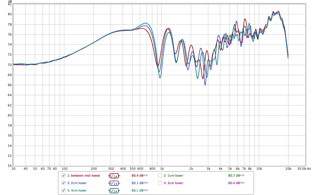

            Hi Curt, thank you for the extra info and tips.
            I've done the measurements as described by you guys, approx 1meter away, right window at 3.5.
            Here are two measurements with the mic height just between the mid-woofer and sweeter, one on-axis and the other is 10' off axis:
            I've also altered the height at my off-axis measurements:
            To me it looks like there is a dip around the 2k2 region, would you guys agree?
            Many thanks again, also to you Curt for sharing your wisdom on this matter.
            • Zvu
              • Oct 2013
              • 436
              You can measure it from 75cm distance and you (or anyone else) can hold the mic in hand. It would be much cleaner measurement, without that much combing, and easier to see the problem.
              But from what i see on your measurements, i'd say you have at least 6dB dip between 2kHz and 3kHz.

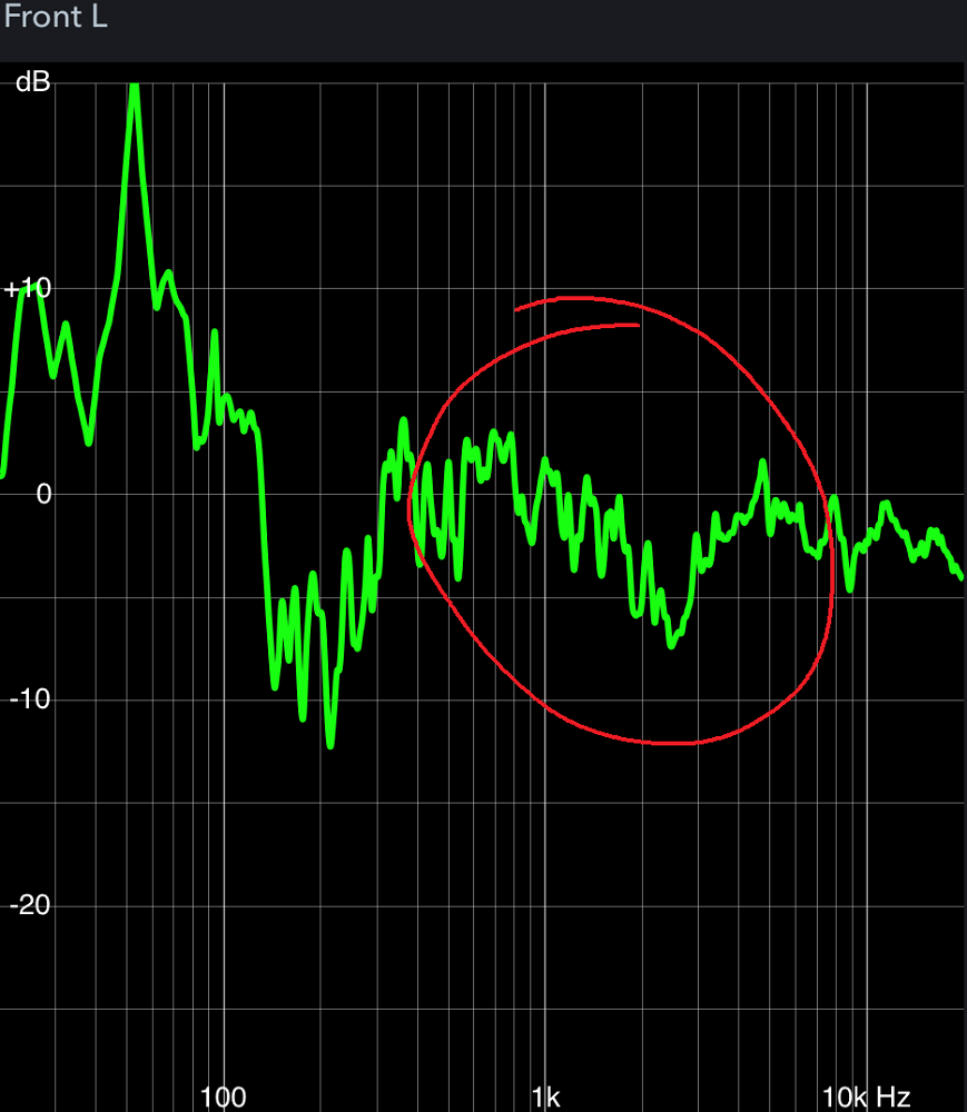

                                    With the old x-overs I always found the voices a bit low in volume compared to the rest of the instruments (at first I thought maybe this is just how these speakers sound) but now with the correct x-overs it is a lot better.
                                    I could get my receiver's Audyssey to correct this somewhat but this has more focus and more articulate. The right frequencies coming out of the correct speakers apparently helps (who'd a thought that?!).
                                    Stereo imaging has improved as well, where with the old x-overs I had to sit exactly dead-center for the voices to find it's spot in the center, now there isn't that much difference in the stereo-image when I move to the left or right.

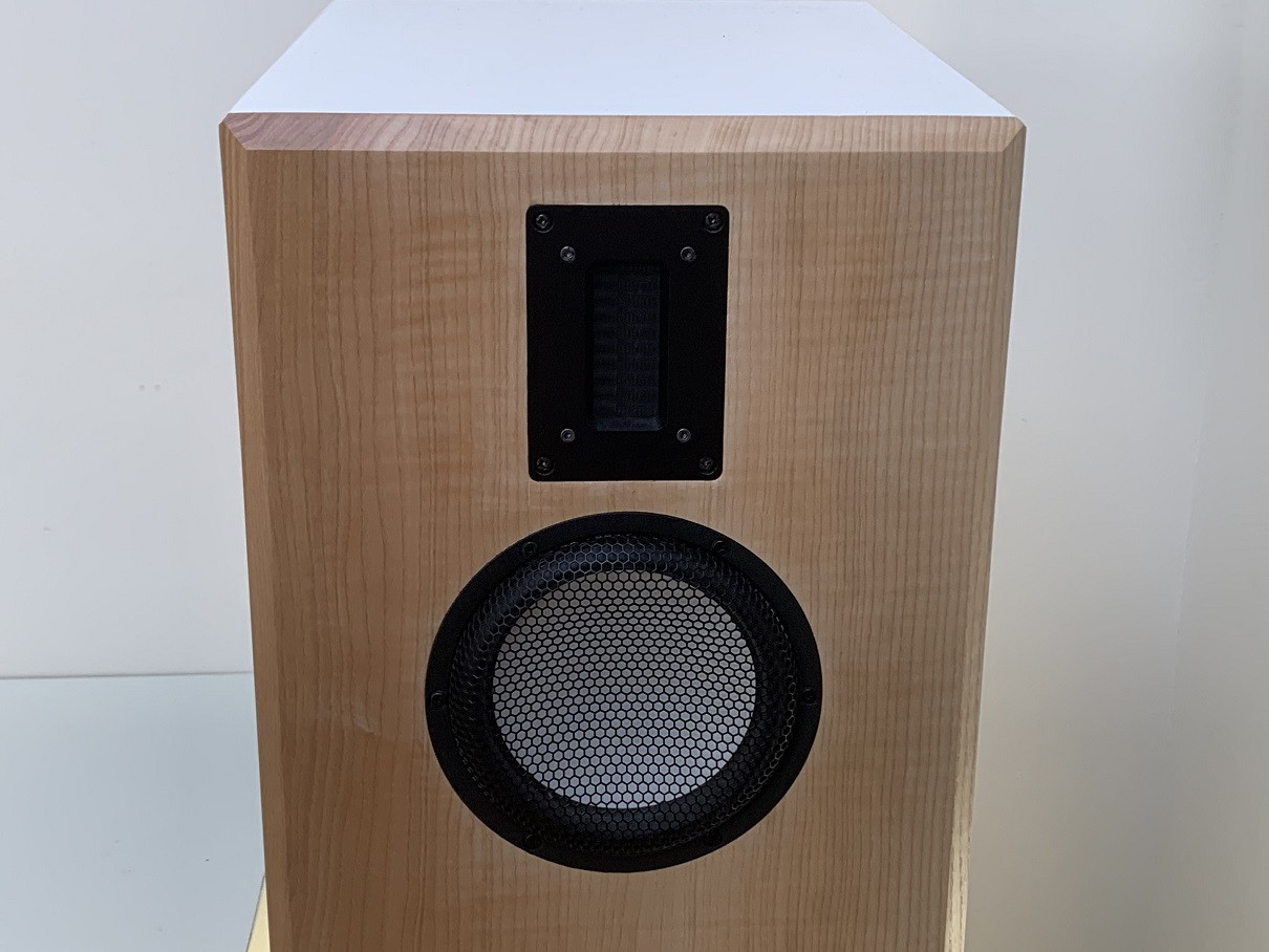

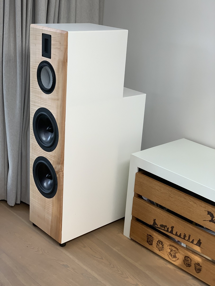

                                    I also took my chance to refinish the speakers a bit, instead of rounded baffle edges I now have a 45' angle which I like a lot more. And instead of acrylic polyurethane I now have a hard-wax oil (Osmo PolyX) finish which looks great.
