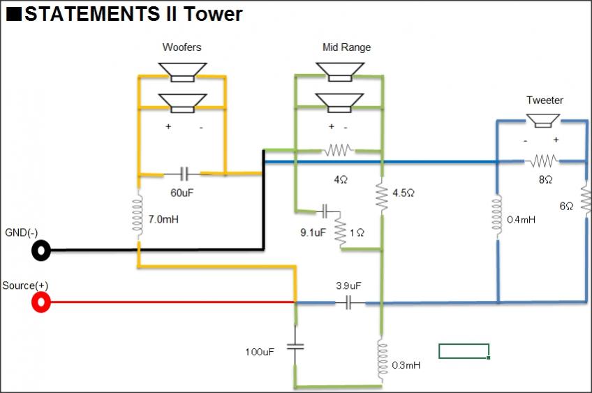

              This is a sketch when the 3 circuits are connected together.
              All 3 circuits going to be on a single piece of wood and it going to be rested on the base inside the tower. So the wood piece will have a 3" hole cut in the middle and the parts would be assembles around that hole in a way minimum amount of circuit wires will be used.
              Tell me what you guys think.

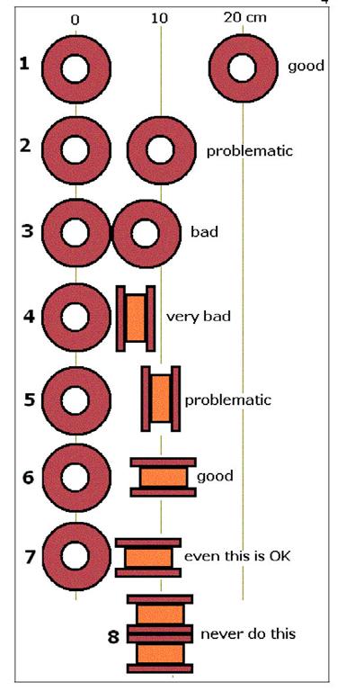

                  Thanks for the picture and advice. But I don't get it, after sealing the enclosures how do you going to remove them?
                  And is there any industry standard on the minimum distance between inductors?
                    Hi Dan,
                    Size the crossover board or boards so they'll fit through the woofer cut out. I position mine for the Statements II's in the bottom next to the port attached to the side wall. The brace below the bottom woofer is also an excellent position. It takes a little creativity but it's worth the effort if they have to be removed for troubleshooting. Yes, I've had to do it more than once.
                    Here are suggestions for inductor placement.
                    Click image for larger versionName:	Inductor placement (Large).jpgViews:	6Size:	43.5 KBID:	860062

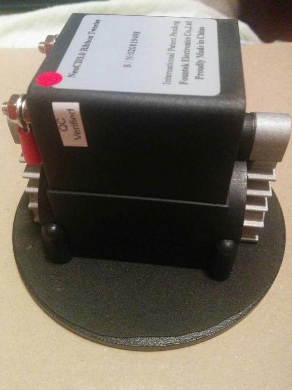

                      Somewhere I saw that you use some kind of sealing when you mounting the drivers for all the drivers. And in another thread I saw you said you only have to use gaskets for the tweeter since the woofer and the midrange come with gasket installed.
                      But when I look at the tweeter it seems it also comes with some kind of material glued to there back side. I took a photo of it. Any thought on this?
                      Here's the photo .
                      And the tweeter hole on the front baffle, you need to cut a circle with 3.53 inch (Just over 3 1/2 inch) diameter. I both measured and done maths from the datasheet, and it comes to that value. So if going to stick with the original layout and cut a 3 5/16" hole, you will have to cut rabbit ears to make way for the heat sink. Thought I should write down this so for someone reading this it might be useful.

                        The tweeter cutout can be a bit difficult. In the picture below you can see how I handled the hole in the baffle for the tweeter heatsink.
                        Also, remember you need to notch out the mid tunnels a bit as seen here. The tweeter sits between the second and third brace from the top. You can see the notches I made.

                          I'm glad to see I'm not the only one who free hands the routing on the tweeter and mid chamber notching
                          I believe the glued stuff you're referring to is the gasket that helps ensure a tight seal. Can't have any air leakage!

                            Thanks Deewan for the tip. I saw it everybody doing that notch out thing and wondering why they were doing it. This clarifies it.
                            Kevin, If the tweeter comes with the gasket glued, do I still need to add more gasket material behind the tweeter? I asked this because I saw Jim said somewhere that you need to add gasket only on tweeter since it doesnt come with it but Woofer and mid ranges dont need it.
                            Cheers.
                            • kevinm
                              • Jun 2013
                              • 417
                              Hmmm. Maybe they didn't use to, but I know mine came with plenty and yours look like they did as well. I haven't had any air leak problems on my sealed set, so I think you should be good.
                              If k r,ember correctly, I didn't have to apply anything to any of the drivers for the Statement IIs
                                Thanks Kevin. That's a relief.
                                May be they didn't use to in the past.

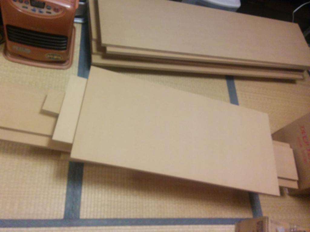

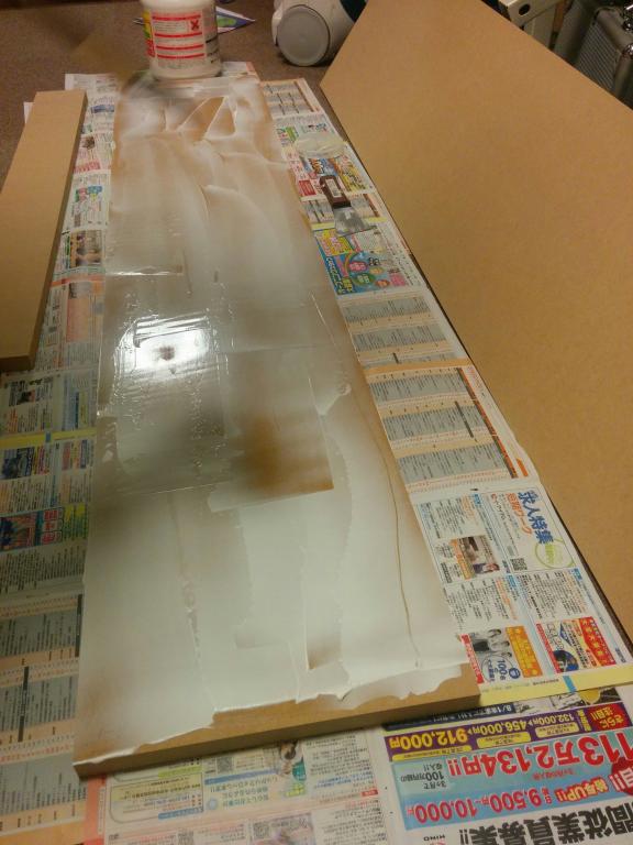

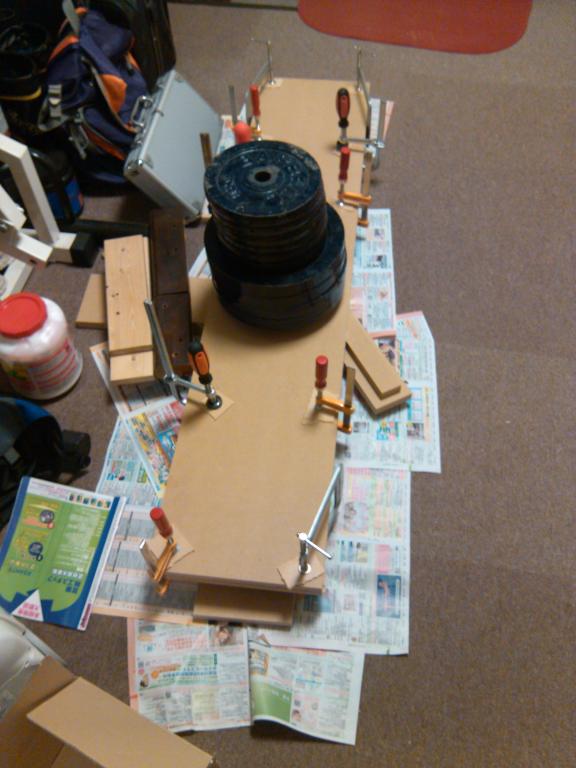

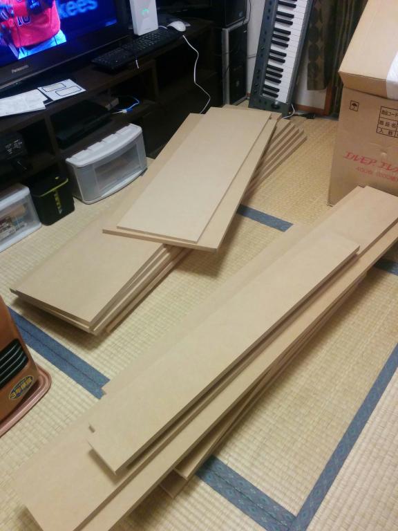

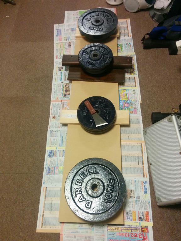

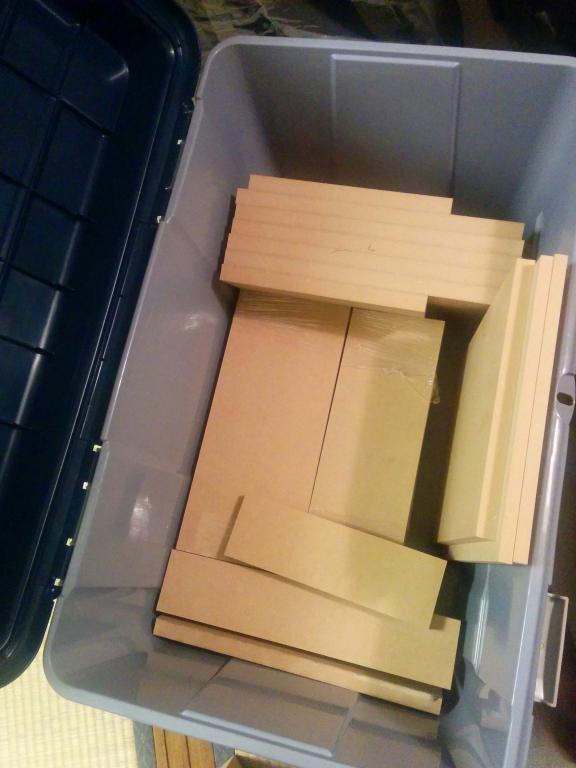

                                  Big progress.
                                  Ordered MDF and had them cut from the home center. Not all but most of the cuts since it will be real difficult to cut them in my house since I live in a small apartment. We hardly have space to sleep here, so having a work space is out of question. But with the sheets cut to manageable sizes, I will be able to manage the rest. Here is the pile of wood I got.
                                  Click image for larger versionName:	2.Wood Pile 2.jpgViews:	1Size:	46.2 KBID:	860115
                                  Click image for larger versionName:	1.Wood Pile 1.jpgViews:	1Size:	49.3 KBID:	860114
                                  Click image for larger version  Name:	3.Wood Pile 3.jpg Views:	1 Size:	43.6 KB ID:	860116
                                  Click image for larger version  Name:	4.Wood Pile 4.jpg Views:	1 Size:	55.0 KB ID:	860117

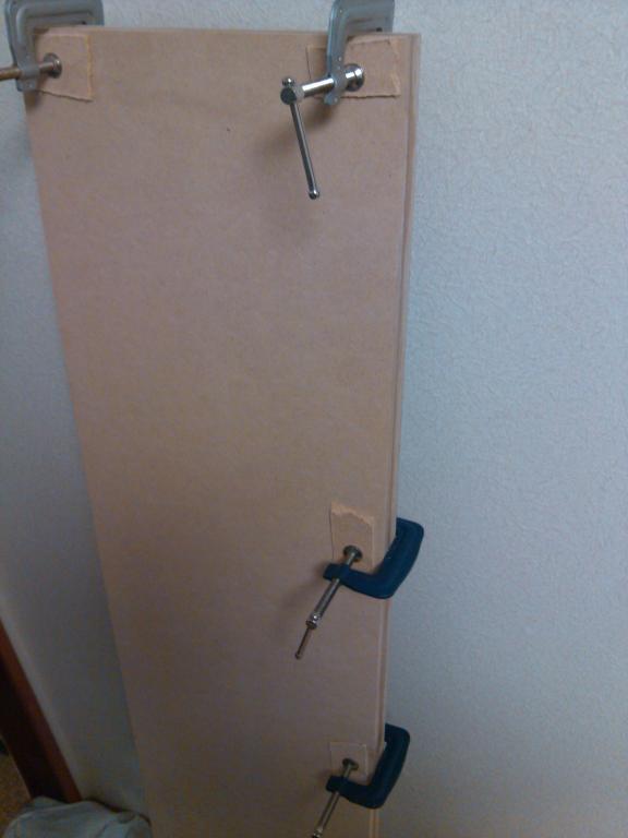

                                  So with the wood being cut, who can wait to start working on the cabinet. So immediately after brought them home from the home center I got to work and start gluing 21mm and 12mm pieces of front baffle.
                                  Click image for larger version  Name:	5.1st Baffle Gluing.jpg Views:	1 Size:	57.3 KB ID:	860118
                                  Last edited by theSven; 12 August 2023, 15:36 Saturday. Reason: Update image style
                                  • danwee12345
                                    • Sep 2015
                                    • 64

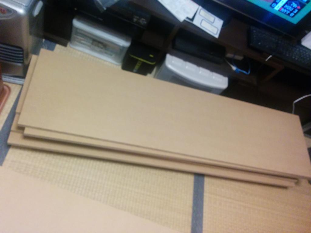

                                    But when pressing I didn't use clamps along the edge line, so after waiting for a few hours and checking the result I was shocked to see some air gaps between the two flanks along the edge. Hoping to remedy the issue, inserted some more glue to the air gap using a cutting knife and pressed using clamps.
                                    Click image for larger versionName:	6.1st Baffle Glued and Pressed.jpgViews:	1Size:	74.2 KBID:	860119Click image for larger versionName:	7.1st Baffle Air Gap Remedy.jpgViews:	1Size:	30.3 KBID:	860120
                                    Learning from the experience, 2nd baffle getting the right treatment from the beginning. Will check the result in the morning.
                                    Click image for larger versionName:	8.2nd Front Baffle Glued and Pressed.jpgViews:	1Size:	55.0 KBID:	860121
                                    And also progress in tools department too. Got a circular saw, a cheap Makita second hand one and my mini-router (trimmer) will be arriving tomorrow. It's only a 6mm one because I didn't want to buy a mediocre but expensive 12mm one at this time, so will have to be content with it for the time being. Will buy a top of the line router in the future since it's an essential tool in your kit.
                                    Hoping to make more progress tomorrow. Once you started you can't wait and you can't sleep.
                                    Last edited by theSven; 12 August 2023, 15:37 Saturday. Reason: Update image location
                                      Looks like progress is made.
                                      As they say - you can never have enough clamps...
                                      I usually add a piece of wood, for example a 2' by 2' or 2' by 4' between the clamps and on each side of the wood that is glued together to ensure that the pressure is evenly distributed.
                                        You can also distribute the weights more evenly to the same end, but more clamps can't hurt.
                                        Something I learned the hard way, you should rough up the MDF a little before glue up. Sand lightly with 100 or 150 grit just to give the glue something to grab. Sometimes the surface is just a little too slick for a good bond. I had baffles delaminate. I've done countless builds without an issue but this time it was a problem.
                                        • danwee12345
                                          • Sep 2015
                                          • 64
                                          Oh..Too late.
                                          All the three baffles are glued. Anyway if it falls apart after speakers are made I will have them sanded before gluing again.
                                          Anyone else had the same problem?
                                          • kevinm
                                            • Jun 2013
                                            • 417
                                            In my experience, Bob and Tek have given solid advice. You should be fine squeezing some glue in there a reclamping - as long as you think it's limited to the edges. If you sense buckling in the middle, you might want to drive some screws/brad nails in it.
                                            Bondo will be your best friend.
                                              I agree with Kevinm. If you are unsure about your glueup of the baffel I would have added scruves around the edge of the baffel and the driver holes that goes almost trough from the inside out. That way you will be sure it will not split up and it will have no impact on tha outside/finish. If you do this, remember to predrill the holes. If not the MDF will be likely to split.

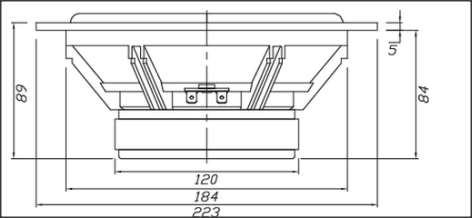

                                                  Can someone clarify this to me?
                                                  From Dayton site (and my own measurements) says the woofer inner circle diameter is 184mm. But Jims drawing suggests you cut a hole of 187.3mm (7 3/8") . Is there any reason behind not cutting it to the fit?
                                                  Click image for larger versionName:	Snap 2015-10-09 at 01.36.48.jpgViews:	1Size:	36.5 KBID:	860122
                                                  Last edited by theSven; 12 August 2023, 15:37 Saturday. Reason: Update image style
                                                    Exact fits are great for extremely accomplished cabinet builders, which I am not, so I leave a little extra for a "nice" fit every time. :W That is particularly applicable to the recess cut. Depending on how you're finishing the cabinet, will determine how much larger than exact I cut. My rule of thumb is 1/16" which only leaves 1/32" around the driver. The inner cutout can be a little sloppy to ease installation of the driver.
                                                    YMMV....
                                                      I would highly recommend to NOT do the cut before you have the drivers at hand.
                                                      Then I would highly recommend making test cut in a scrap piece before doing the actual cut.
                                                      I made a circle jig for my router and adjusted that until I got a "perfect" cut (that took several attemts) and then use the prepared and correctly setup jig to make the final cut.
                                                      • kevinm
                                                        • Jun 2013
                                                        • 417
                                                        YMMV....
                                                        Additionally, it leaves room for some of the "finish" to get in hole. When I built some piano black bookshelves, I had to sand the inside of the tweeter recess because I did them too tight.
                                                        • danwee12345
                                                          • Sep 2015
                                                          • 64
                                                          YMMV....
                                                          Jim, Thanks for the reply. Will try to cut exact diameter then.

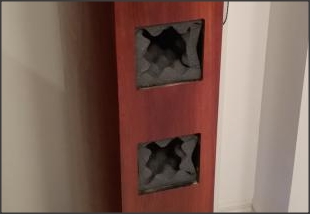

                                                          I have few more questions regarding cabinet structure.
                                                          1. Would it be ok to cut out the center on the horizontal back braces? ( Just like Shelf brace: H)
                                                          2. If I have a sturdy way to mount the pass-throu tunnels without the vertical braces, is it ok to do without those braces? Or is there any sound effect taken into consideration other than strengthening the cabinets?
                                                          3.Should it be ok to make the hole on the back (C) 1" smaller from each side so the acoustic foam won't be exposed.
                                                          Click image for larger versionName:	Snap 2015-10-09 at 11.51.04.jpgViews:	1Size:	30.2 KBID:	860124
                                                          You can see the foam in the above image. If I make the hole smaller then the foam would be covered by wood. (More aesthetically pleasing)
                                                          Cheers.
                                                          Last edited by theSven; 12 August 2023, 15:38 Saturday. Reason: Update image style
                                                            Thanks TEK and Kevin for the tips. I'm yet to put my hand on the mid rangers, but I've already got the woofers and ribbons. Mids are on the way.
                                                                Cheers.
                                                                I'm out of town for a week with only access to my cell phone.
                                                                Short answer, follow the plan. You can be creative with bracing if you like. What is the benefit?
                                                                I've never made the mid tunnel smaller but it will change the rear radiated sound which will affect the speaker balance. Why not a grill instead?
                                                                  I made a circle jig for my router and adjusted that until I got a "perfect" cut (that took several attempts) and then use the prepared and correctly setup jig to make the final cut.
                                                                  This is great advice!!!! Make sure you follow this advice!
                                                                  Cheers.
                                                                  1) Yes, I think that would be fine. It will add a SMALL amount of internal volume since you are removing some mass, but nothing that would make a audible difference.
                                                                  2) As long as your way of mounting the midtunnels doesn't cut the internal air movement from the upper and lower parts of the cabinets, I think it would be fine. However, those vertical braces are a good design to allow internal air movement and provide support and reduce vibration to the side panels.
                                                                  3) I agree with Jim, I would not shrink the outlet of the midtunnels. It will have an impact on your sound. Depending on where these speakers are located, you will never see the foam. I have bright green foam on my midtunnels, but it's never see because I can see the backside of the speakers. 99% of the people who see my speakers do not realize the speakers are ported out the back.
                                                                  Big progress.
                                                                  I don't think this needs to be said, but just in case. I would strongly advise NOT, DO NOT EVER, cut MDF in a place/room where you live. The dust from MDF is so fine you will be finding it for years. Also, it is not healthy to breath in the dust. While I am sure you did not mean you would cut the MDF in your living space, I wanted to be 100% sure you knew to not attempt it.
                                                                  Other than that, you are off to a great start to this build. Keep up the good work!!!
                                                                    :agree::agree::agree::agree::agree:
                                                                    I'll go a step further and recommend not using MDF at all realizing that you have already started down the path with it. Cabinet grade Baltic Birch ply is more expensive, but the dust particles are larger, they settle and can be cleaned up efficiently. I proved this to myself rather dramatically with back to back builds using MDF and BB. Even working outdoors the MDF dust got into my pores, and into my nose through a paint respirator fitted with dust filters. My girlfriend kissed me and commented that I tasted like sawdust after I showered. Just handling the mdf pieces seemed to be an issue - I vacuumed them after cutting but they still billowed clouds of dust when I put them down. Shop vac dust collection is a problem because unless you have a cyclone separator like http://www.oneida-air.com/category.a...5C357DFE131%7D the filter will clog in short order. Non HEPA filters will pass enough MDF dust that you end up spreading as much as you pick up.
                                                                    Just an old fart who finally discovered the joys of working with BB ply instead of MDF.
                                                                    • danwee12345
                                                                      • Sep 2015
                                                                      • 64
                                                                      Yes. You are right. What was I thinking.ops:
                                                                        Thanks Deewan and Bob. I didn't know that MDF is that hazardous. You saved me a lot of trouble here. This forum rocks.
