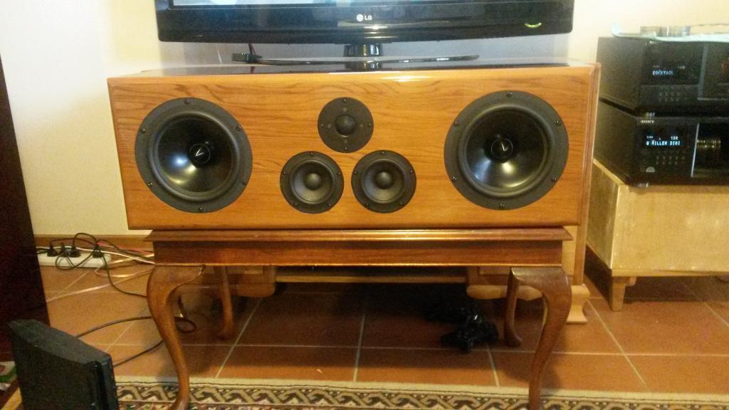

New center channels for the Statements II and The Finalists!
    You can't have a new speaker without a new center channel to compliment it for home theater.
    Statements II and The Finalists Center Channel
    During the last several years the original Statements have been frequently used as mains for home theater systems. The original Statements center was designed to be as small as possible and integrate seamlessly with the Statements by also utilizing an open back design. That worked great for me in my home theater/listening room, but for many, it did not due to the open back mid.
    Enter the Statements II Center
    Along with the new Statements II design, Curt and I felt it was time to rethink and create a new center channel for it along with a similar variation for The Finalists design. Since the drivers and voicing are similar for both The Finalists and Statements II, the center channel designs vary only in the tweeter used and crossover changes to accommodate the difference between the two drivers.
    Yes, size matters!
    But, you can only use a cabinet so small for two 8” woofers, two mid-woofers and a tweeter/ribbon sitting on top of them. The cabinet measures 34”W x 11 ½”H x 12 ½”D. The cabinets for both speaker systems are sealed for both bass and midrange. I experimented extensively with the original Statements center and found that a sealed center design worked great with the Statements since the main purpose of the center is to anchor the sound to the screen. The cabinet is not insignificant in size but allows many more placement options than the original open back design. For example, it makes a great TV stand!
    Integration is perfect!
    Since the center channel duplicates the driver compliment in the mains, they’re a perfect match. Center channels carry up to 70% of the sound in a typical movie and are arguably the most important speaker in a high performance home theater system. Since the center is so closely matched to the mains, panning, bass extension and high frequencies integrate seamlessly and have the ability to reproduce dialogue with exceptional clarity.
    The Finalists and Statements II centers are both the same except for ribbon vs dome and the crossover changes in the tweeter circuit. The picture is of my larger cabinet rather than the one that is speced at 34" wide. I had a pair of original RS225 shielded drivers on hand so I built a sealed Statement on it's side. The cabinet drawings will be available from Curt's website and Meniscus.
    Enjoy!

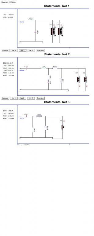

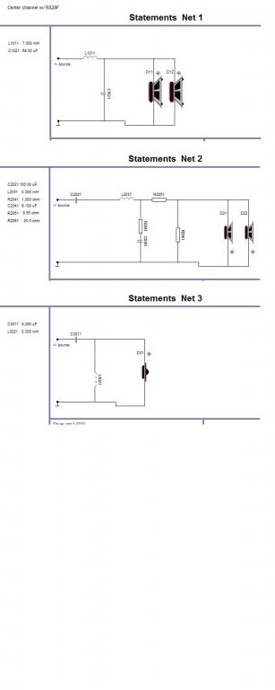

              Hey Jim, any chance you can upload (or list) the resistor changes for the Statement version of the CC? As far as I can see, it looks like a few resistors for the mid/tweet are different from the full size Statements.
              Thanks!
                Thanks!
                Hi Kevin,
                I've not had time to create a BOM for the projects. Meniscus has the parts list as part of the kit they're offering so I've not taken the time to do one. It'll be a awhile before I get caught up to the point I can get one done.
                Sorry!

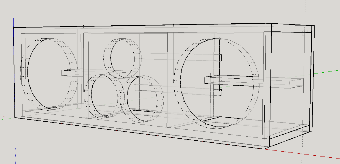

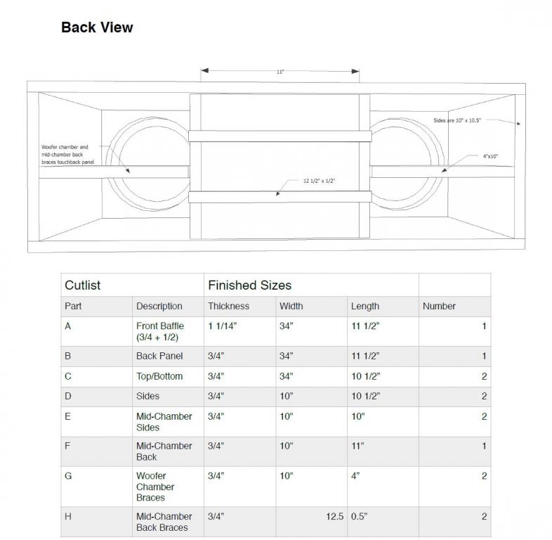

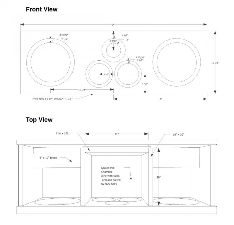

                  Box construction
                  Jim,
                  Can you clarify the placement of the 1/2" strips and 4"x10" braces? I presume the strips are equally spaced, one over the other, leaving slots connecting the two RS225 compartments. The 4"x10" braces appear to be horizontal, mid height in the box, and bracing the speaker side, speaker back, and mid compartment. Also, should the baffle edges have a roundover?
                  Matt
                    Originally posted by fordmaker
                    Jim,
                    Matt
                    Hi Matt,
                    The (2) 1/2" strips are placed horizontally between the the mid compartment and the inner wall of the cabinet back to tie everything together and make the cabinet solid. I spaced them evenly so wires could pass through from the woofer. You should stuff the space between the mid and the inner back heavily with either foam or acoustic fiber after the wires are threaded through. Since it's a small space, we want to eliminate any port effect between woofers.
                    The braces behind the woofers were placed in the middle of the back wall of the cabinet to tie the mid compartment, back wall and cabinet ends together for strength. If you need to move them up or down a bit for crossover clearance or whatever, it won't hurt a thing. It's just a brace.
                    The cabinet is very solid when assembled.
                    No roundover is required.
                    HTH

                      Hey Jim, one more question I didn't see in Mark's plans....is the mid chamber stuffed or lined?
                      Thanks!
                        Thanks!
                        Actually, I did a little bit of both. I lined the walls with 2" foam and then added a little stuffing in the cracks and loosely filled the back 1/2. I don't think it's critical which you use as long as you kill the back wave.

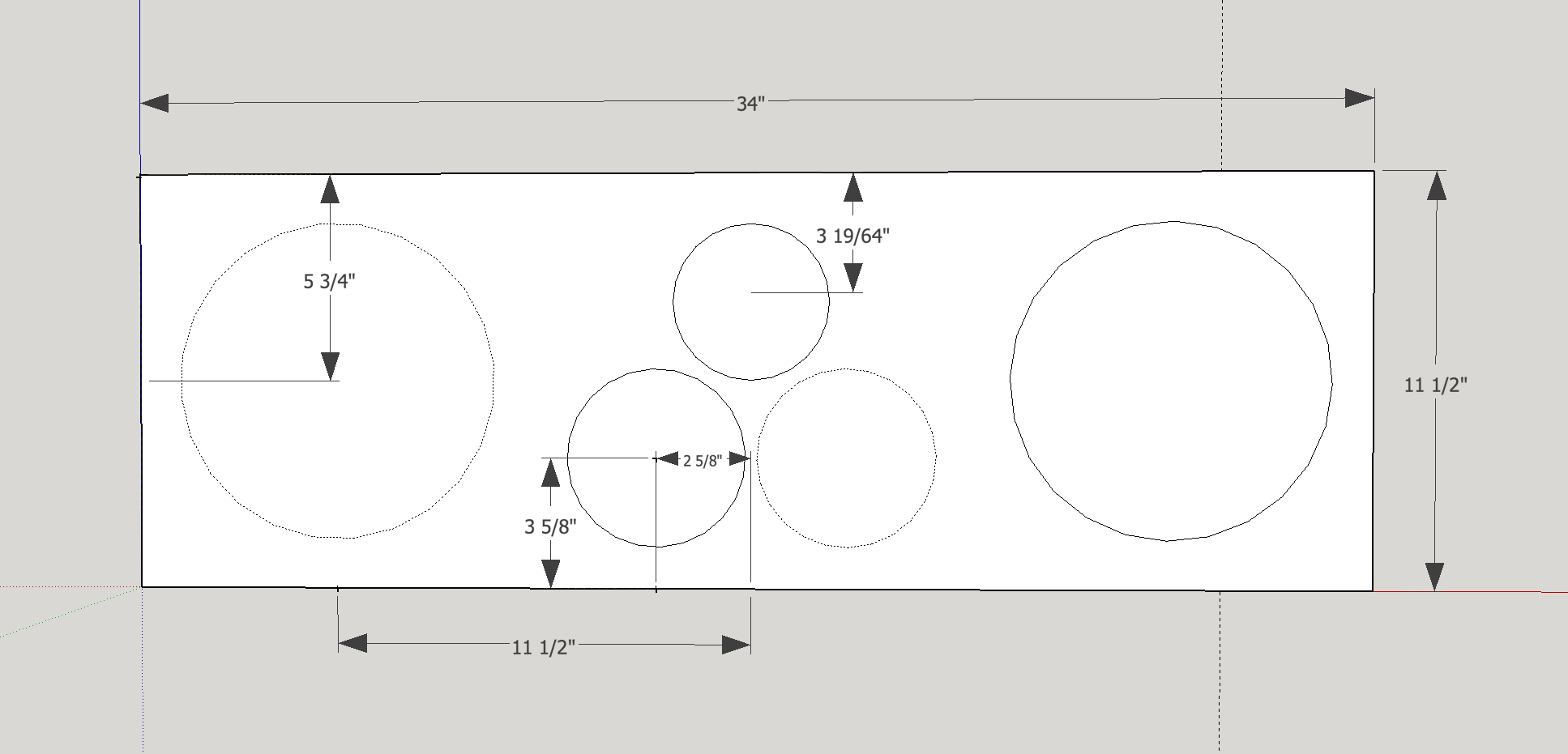

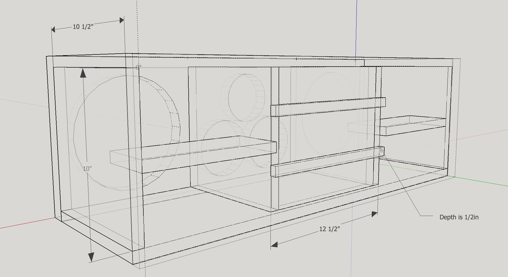

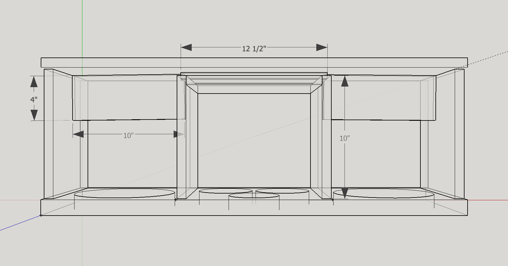

                            Hey Jim,
                            I threw the dimensions into Sketchup to help reduce my cut mistakes...does this look correct?

                              Kevin,
                              It looks like you have the front panel as one solid piece, instead of (3/4") 32 1/2" x 10" inner front and (1/2") 34" x 11 1/2" outer front pieces. The back panel looks like a 34" piece instead of an inset 32 1/2 piece. My plans also show the side pieces to be 12" x 10".
                              As I look at this, I think we may be working from different cut sheets. My plans show what may be a functionally identical box, but with the pieces fitting together and overlapping differently. I'll stay tuned to see Jim's comments.
                              • kevinm
                                • Jun 2013
                                • 417
                                Mark is that you?
                                I did notice that on the drawings....but I knew that would screw me up when I was making my cuts, so I improvised. The front is setup as 3/4in + 1/2in glued together - only because that's how I've always done it. Do you have experience behind your method? Is it easier?
                                • fordmaker
                                  • May 2009
                                  • 21
                                  Kevin,
                                  Sorry, I should've signed my previous post. I'm Matt!
                                  This will be my first cabinet build, so I can't speak for the designers on what may be easier or better. I was just comparing your Sketchup pics to what I have on paper. It would seem that we may be working from the same plans after all, which is cool. I show 3 9/16" from tweeter center to top of box vs. your 3 19/64". Perhaps the sketch I have shows the hole for the RS28F and I need to go back and verify what it should be for the ribbon. I appreciate your work ironing out the details and measuring twice (before cutting, hopefully, just once)!
                                  Matt
                                  • kevinm
                                    • Jun 2013
                                    • 417
                                    Hey Matt, no problem. For a minute I thought you were Mark from Madisound. Good catch on the tweeter height - you are correct.
                                    Now I just have to figure out how to change it....hmmm
                                    I've always used configurations like my schematics above because they are the easiest for me to conceptualize while I am cutting/gluing together. Separating the baffle boards into separates will make it easier to flush trim since you'll be only flush trimming 3/4in. I think a lot of people keep them separate incase they botch one of the cuts up. However, I was worried about trying to match driver holes on two separate boards, so I prefer to glue it together, then cut out the driver holes and then glue to the cabinet. As they say, there are more than one to skin a cat!
                                    (A rather gruesome idiom when you think about it)
                                      Ok, the tweeter hole center is 3 9/16" for both the NeoCD3.0 and RS28F. They're close enough in size that the actual position didn't need to change. However, the cutout and recess are different for each driver. Please measure the actual driver before cutting for accuracy. I usually add a 1/16" for "slack" but you may be more precise at cabinet making than I am. 8O
                                      The 2nd question regarding the cabinet panels. I cut them a little different so that the fewest seams would be visible but still be easy to assemble. So. here's what I did and what the cut list should be based on;
                                      Top & bottom are 34" x 12"
                                      Inner front & back are 32 1/2" x 10"
                                      Sides are 10" x 12"
                                      Outer front (1/2") 34" x 11 1/2"
                                      The inner front, back and sides should be sandwiched between the top and bottom with a full width 1/2" thick front baffle.
                                      I inner mid pannels consist of;
                                      (2) 10" x 10" panels
                                      (1) 10' x 11" panel
                                      This provides a 11" x 10" inner mid compartment.
                                      I hope this makes sense.
                                      I'd like to have copies of your sketch up drawings when you get done.
                                        Ahhh, the reason behind the madness. Makes a lot of sense now...

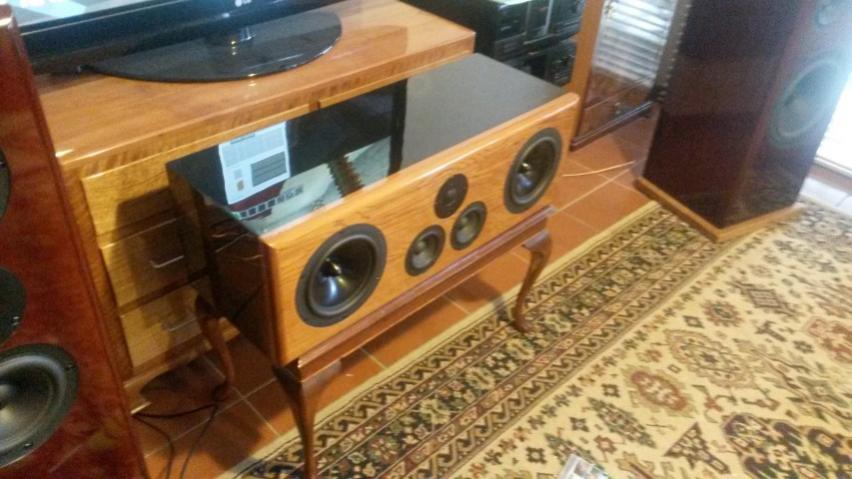

                                                                  Hello Jim, I am looking at building a Finalist centre with the Dayton dome tweeter and was wondering if there any pictures or updates with this.
                                                                  I was hoping it would match up with the Zaph SB 12.3 speakers I built

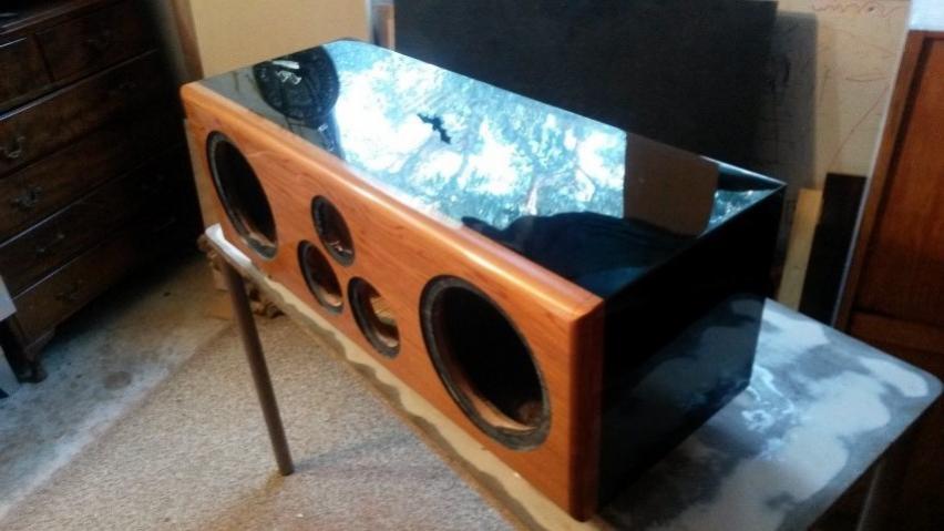

                                                                          Nearly finished my Finalist centre.
                                                                          Was wondering if I line the internal walls with foam or felt

                                                                              Some shots of the Finalist centre I have finished.
                                                                              Sounds excellent. Hearing more detail than ever before and has matched up well with my Zaph SB12.3. Ypoa runs the centre at 4db higher than the mains which blends nicely.
                                                                              Thanks very much Jim and Curt for your design.
                                                                              Last edited by theSven; 02 May 2023, 18:30 Tuesday. Reason: Remove broken image links

                                                                                Finalist centre pictures
Name:	20151127_174234 (Small).jpg
ID:	860339Click image for larger version
Name:	20151127_065756 (Small).jpg
ID:	860338Click image for larger version
                                                                                  Hi Tony,
                                                                                  They look beautiful! Great job! :T
                                                                                  Of course, I'm very pleased to hear that you're happy with the sound.
                                                                                  Enjoy!
