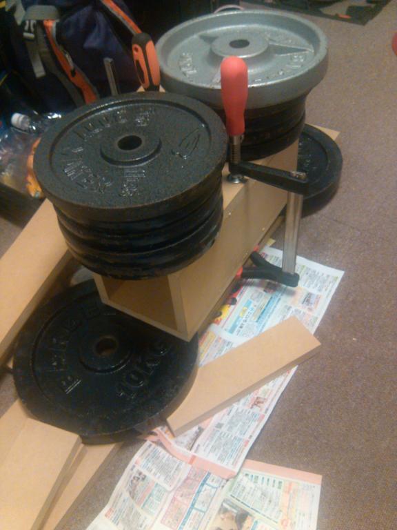

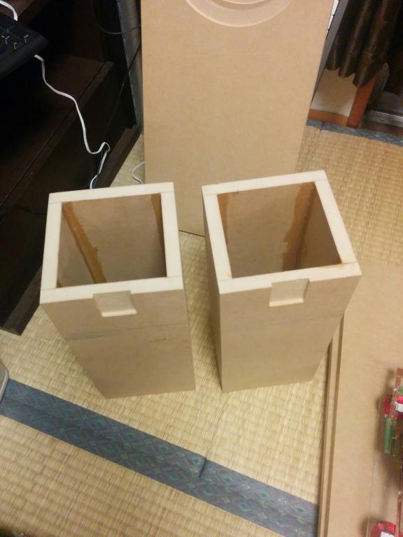

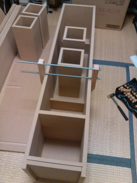

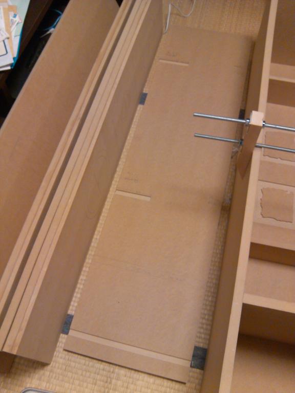

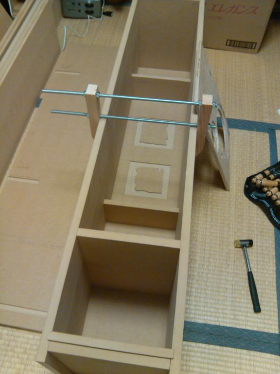

                          BTW, all the cuttings and grooving been finished and did a pre-assemble without glueing.
                          I think I have done a pretty good job.
                          Click image for larger versionName:	13.Test Assemble 1.jpgViews:	1Size:	43.4 KBID:	860155Click image for larger versionName:	14.Test Assemble 2.jpgViews:	1Size:	37.2 KBID:	860156Click image for larger versionName:	15.Test Assemble 3.jpgViews:	1Size:	44.4 KBID:	860157
                          Still waiting for the Solen caps from meniscus to be shipped, so will be another two weeks before I can them I think. And with days getting shorter and raining it's been slow progress.
                          Last edited by theSven; 12 August 2023, 15:46 Saturday. Reason: Update image style
                          • danwee12345
                            • Sep 2015
                            • 64
                            And those clamps are home made exclusively for this project.

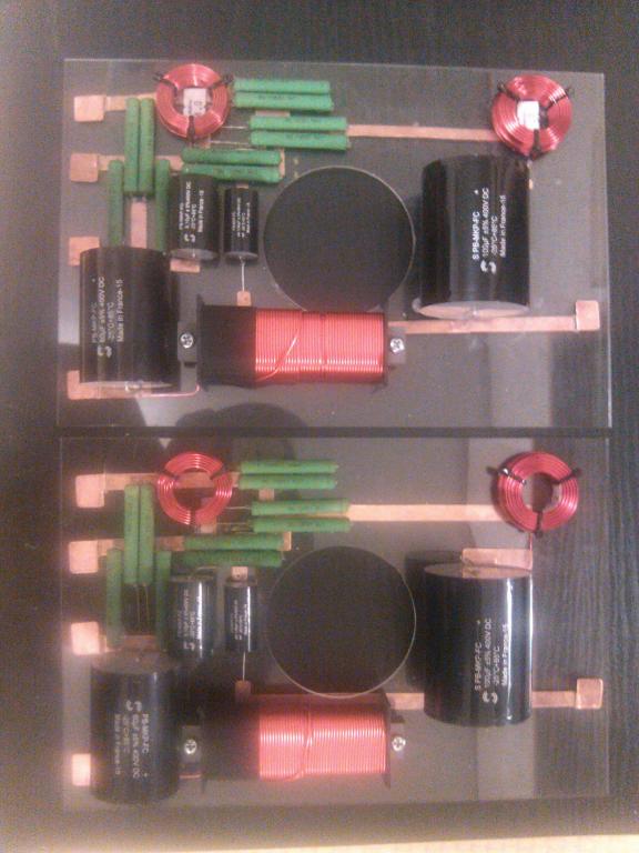

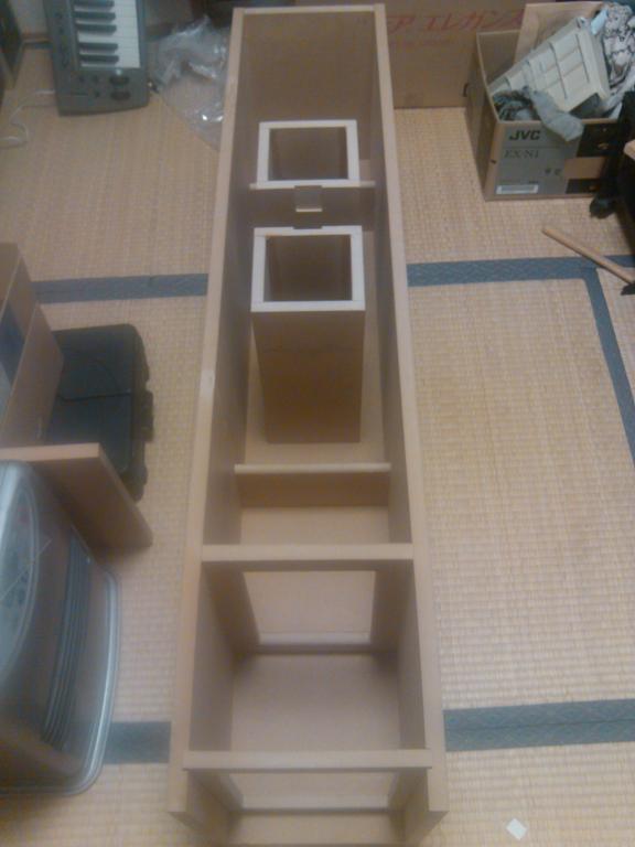

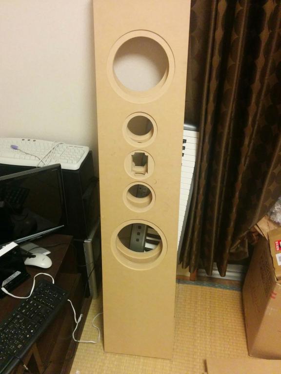

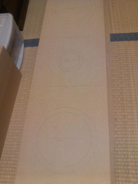

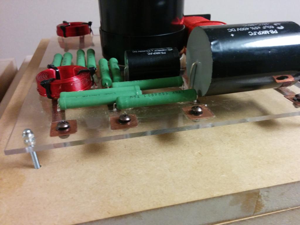

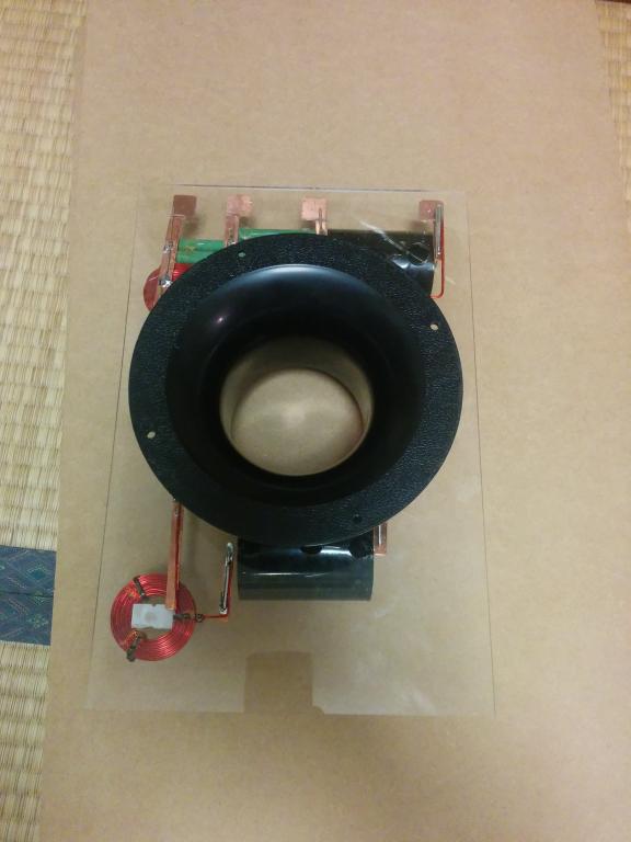

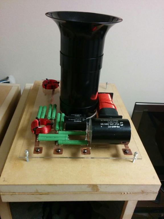

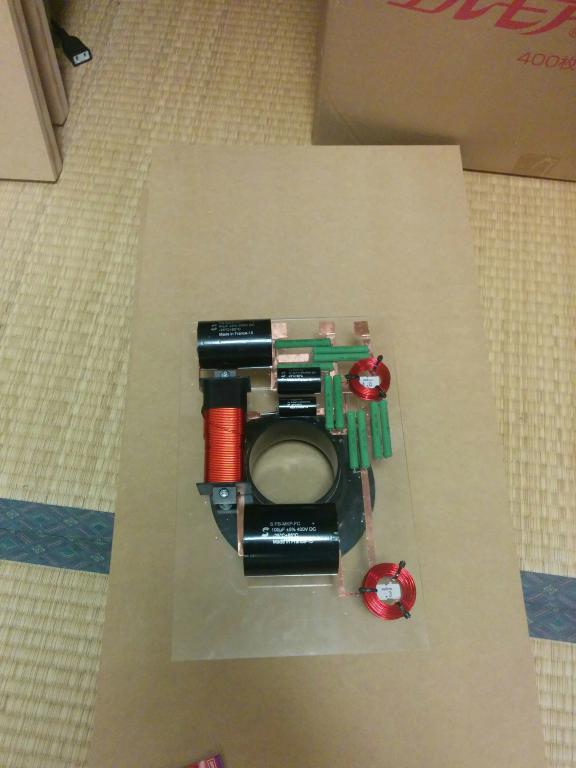

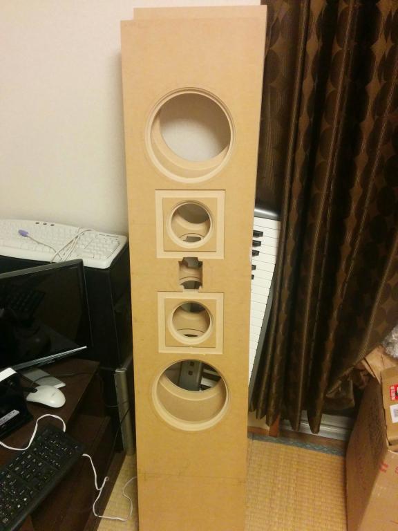

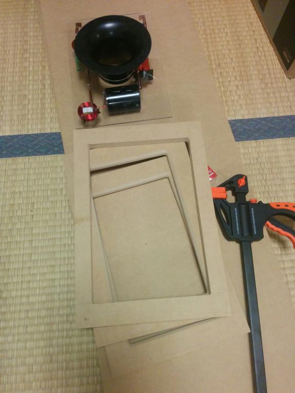

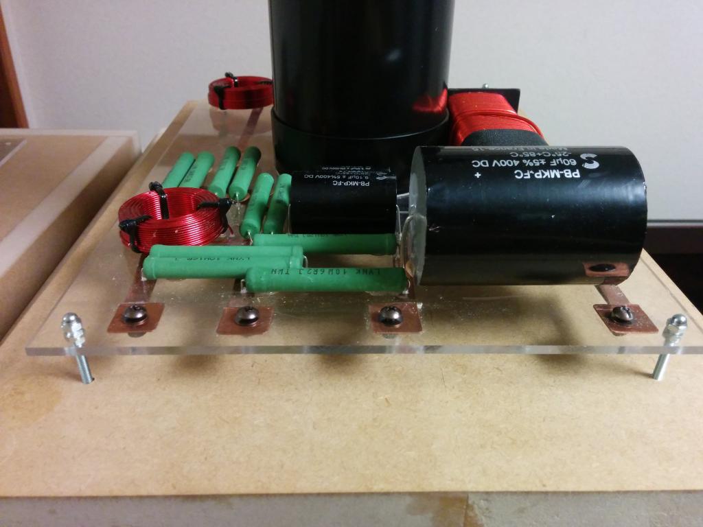

                                            Some progress made in the past few days. Crossovers almost done. Acrylic board used as the circuit board and arranged around the port. Really happy with how it turned out.
                                            Also mounting circles are cut on the baffle walls . Mid tunnels are done. Braces are done. Now only have to glue all the components together which will be starting hopefully tomorrow.
                                            And base idea is somewhat similar to Spleen21's build. Thanks spleen.

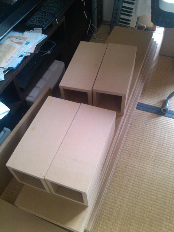

                                              Here is a picture of the Mid tunnels.
                                              Click image for larger versionName:	IMG_20151023_013152.jpgViews:	1Size:	45.2 KBID:	860198

                                                • 571
                                                Cool...looking good! Is that copper tape on the Acrylic and did you solder directly on it?
                                                • danwee12345
                                                  • Sep 2015
                                                  • 64
                                                  Its 0.5mm thick copper strips. So 4mm wide strip is effectively 14AWG copper wire. I bought a larger piece from the home center and cut it into pieces as I want. That part is the most difficult and time consuming. Then I soldered the leads onto the copper strips. Also I planned the layout even without the copper strips the leads would have enough length to connect each other. Copper strips are for the protection of the board and for the looks.

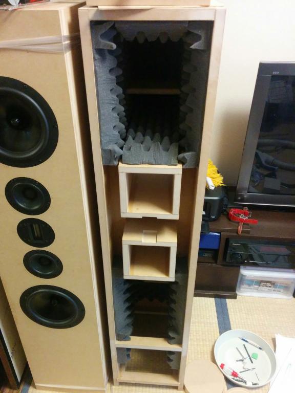

                                                    Cabinets are glued . crossovers done.
                                                    Next attaching acoustic foam inside the cabinet and wiring.
                                                    Click image for larger versionName:	IMG_20151025_222259.jpgViews:	1Size:	57.5 KBID:	860211Click image for larger versionName:	IMG_20151025_222419.jpgViews:	1Size:	37.9 KBID:	860212
                                                    Last edited by theSven; 12 August 2023, 15:49 Saturday. Reason: Update image style

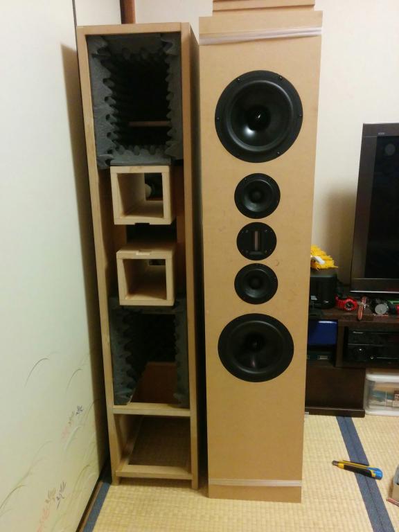

                                                      Everything looks great but I do have a couple questions.
                                                      Do you have the mid tunnels attached to the side panels? That adds strength to the cabinet. My rule of thumb is no spans greater than 12" without bracing.
                                                      Also, can the crossover board be removed once the cabinet is fully assembled? That's pretty important at least for folks like me that have an occasional oops! :W

                                                        Thanks for the concerns Jim. But all have been thought out. The mid tunnel attachments are not yet glued because the cuts are bit wider. I have to shave off at least 1mm from the braces. Hopefully will do it tomorrow.
                                                        And for the crossovers, they will be mounted on a detachable base. You can see that extra brace at the bottom of the cabinet which was not in the original plan. Bases are going to be attached to it with 6 bolts and nuts so it will be removable if there is a need.

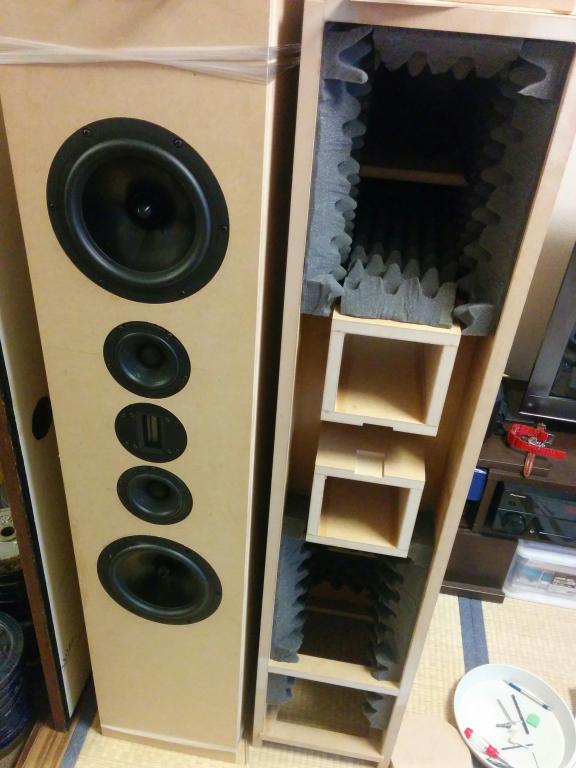

                                                            Question time.
                                                            Should I add foam all the way down to the base or should I stop at the bottom brace around 30cm (12inches) from the bottom?
                                                              Originally posted by danwee12345
                                                              Question time.
                                                              Down to the brace is fine. The purpose of the foam is to prevent sound wave reflections into the back of the driver. I don't see how it could reflect from the bottom of the cabinet into the lower driver.
                                                                Thanks Jim for the quick explanation. So it wouldn't be detrimental if I do foaming all the way down to the bottom I guess. Because Meniscus sent me a good load of foam material now I probably have an excess of it. I want to use them all as much as possible otherwise it will give me a headache looking for space to store them.
                                                                  Foam below the brace won't hurt a thing. Just make sure not to block the passage to the port and you're good to go.

                                                                    Foaming is done. Baffle walls are completed and did a rehearsal fit to just to have an idea how they look. They look majestic indeed.
                                                                    Bases are being built. So now am in the final part of the build. Only wiring and bases are the remaining tasks. Exciting times ahead.

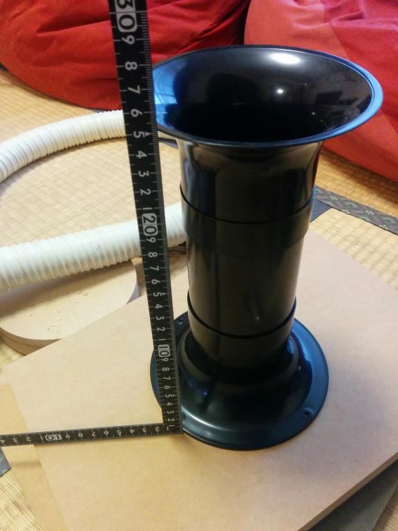

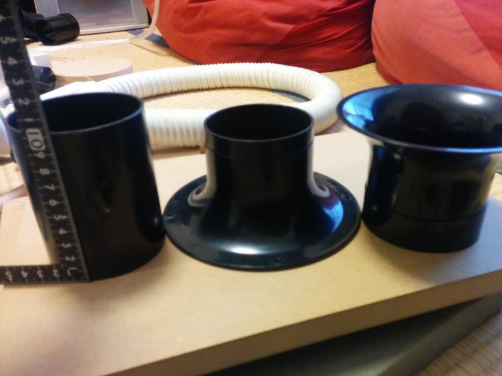

                                                                    What should be the length of the port (with flares)? Is it 4 inches (10.2cm) in total? The precision port meniscus sent me is way longer than that. Do I have to cut it?
                                                                    Click image for larger versionName:	IMG_20151030_162903.jpgViews:	1Size:	48.4 KBID:	860246Click image for larger versionName:	IMG_20151030_162951.jpgViews:	1Size:	62.9 KBID:	860247
                                                                    Please somebody help me here.

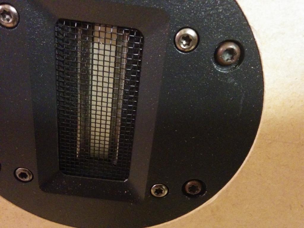

                                                                        And closer look of the bolts used to attach the drivers to the baffle. Used torx screws with button head. (4mm for mids and tweeter, 5mm for the woofer)

                                                                        • Curt C
                                                                          • 792
                                                                          You will have lots of port tube left over for your next project...
                                                                          The 3" port tube is cut to 4" long. Add the flares and you are golden! Total length is around 10" if I recall correctly, but don't quote me on this.

                                                                            Thanks Curt but I don't get it. The ports meniscus sent me is 10" long in total (with flares). The middle part (tube) is only 4".
                                                                            (Sorry, English is not my 1st language). If it's 10" total length there will be no tube left.
                                                                            And I found this which says it should be 7" in total. Now I'm really confused.

                                                                              Wow! Those might be the cleanest crossovers I've ever seen!
                                                                                Regarding the port tube, I believe meniscus pre-cuts it for you, Curt was referring to the port tube you would get if you bought it new from Parts Express (or other vendor).
                                                                                Thanks Kevin for the complement and clearing confusion. Appreciate it.

                                                                                  I finished my tower builds and have been enjoying them. What sounds they give me on HD movie tracks. WOW..
                                                                                  But since movies come with DTS-HD 5.1 sound to fully enjoy them I decided I have to build the center channel asap.
                                                                                  I was just wandering anyone here who built a center statements II how you build the cabinet to access the Xover later if the need arise?
                                                                                    Excellent! I'm pleased to hear you're enjoying them!
                                                                                    First, decide which side of the cabinet you'll place the binding posts for close proximity to your electronics and then position the crossover behind that woofer near the back of the cabinet and close to the binding posts. It should fit fine and not having foam where the crossover is attached doesn't hurt a thing.
                                                                                    EDIT: I forgot to answer the question. ops: Cut the width of the crossover mount board so it'll slip in the woofer cutout opening which will allow removal if necessary.
                                                                                    HTH
                                                                                    • danwee12345
                                                                                      • Sep 2015
                                                                                      • 64
                                                                                      HTH
                                                                                      Thanks Jim. I forgot that option that you can always remove the sub to access the xover since I opted for base removal to open the cabinets in my tower build.ops:
                                                                                      And about the positioning, you mean I should place the binding posts not at the middle, but rather somewhere behind left or right sub? Is it going to be a problem if I place them right in the middle?

                                                                                        Oh.. What I was thinking. If I place the xover at the middle I won't be able to access them later. right? But still I can place the binding posts in the middle I guess.
                                                                                        Please let me know the efficiency of the speakers if you happen to know. I'm trying to decide on a power amp to drive these beasts and I want to think if the power is going to be enough in the long run.
                                                                                          There's only 1/2" clearance behind the mid compartment and the back panel so there's not room or any way to get to the binding posts internally for installation or connection. It really doesn't make any difference which side you place the binding posts and crossover, I just prefer to keep my speaker cable runs as short as possible so I pick the side closest to my amp.
                                                                                          The Statements (1 & 2),centers and Anthology's are all about 88-89 db. I suggest a separate amp with no less than 100 wpc @ 8 ohms and the ability to drive 4 ohm speakers. That describes just about any decent separate audio amp built for the last 30 years. I prefer stout power supply class A/B amps of 150 wpc or more. I'm currently using an Emotiva XPA-5 in my Statements II system and like it a lot. The only receiver that doesn't cost more than a good amp that I can recommend are the higher power Marantz models.
                                                                                          HTH
