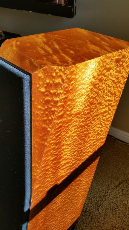

      Couple of Pics for this evening. First one I was waiting for the sun to come out for a good picture. It almost came out.
      Glamour shot will have to do for now.

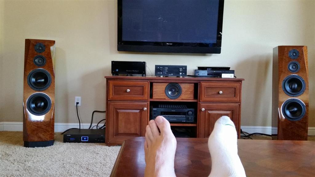

      Second picture is "I'd give my left sock" to be sitting with Bob listening to the speakers. I never made it to Bob's place (long drive)
      but the sentiment is still there.
      First impression summed up by the wife unit, I've got goose bumps---. Also said it's like being in a room with a grand piano as compared to a cheap upright. We have a very nice Yamaha upright, it's not cheap.
      Alison Krauss sounds like I could touch her, maybe in my dreams. Mids sounded sharp for the 1st hour and are much better now. My last set of quality speakers really changed ~ 50hours.
      What's the consensus of hours for the change on these from those who have many hours on them?
      Very Happy Man.
      Ron

        Congratulations Ron. It's been a long road and you finished ahead of me since I'm listening with breadboard external crossovers for now.
        Mine settled in pretty quickly, more change in the bottom (smoother) than the mids. Then again we have different midranges.

          Those look amazing Ron ..... both you and Bob have done a killer job.
          • Renron
            • 750
            Thanks guys. They are wonderfully articulate and powerful without being boomy. One Country Western song, Honky Tonk Badonkadonk has bass notes that hit so hard you can feel them in your chest 18' away. Still not Boomy, 'they're powerful. The sweet spot is enormous.

                    Beautiful Ron :T...looks like you really achieved the deep finish you were after. Great clarity.
                    I am using a varnish finish as well...Pratt and Lambert 38 clear. I would love to hear the details of your finishing steps. Did you wet or dry sand to level and what products did you use? Then what was your rub-out/polish process?
                    I am forging new ground with mine and pretty nervous of the next steps. As I applied coats of finish I was surprised at the grain exposure of the bamboo. Sanding a test piece revealed the shiny grain pockets. I'm at 8 wipe-on coats after some seal coats and things are looking better. If time permits this weekend I'll do somewhat aggressive sanding to help level then on to 8-10 mores coats. Anyway I'm using this half-way point to test some methods. It will be 5 days+ since the last coat so hopefully it will be pretty cured. The final coats I'll wait 3-4wks before proceeding. I'm aiming for a even satin sheen.
                    Anyway...back on topic I look forward to seeing more pics of yours...great job!
                    • Renron
                      • 750
                      The cabinets have some orange peel on them, but I can live with it. I sanded and polished the tops and front facet because the dust nibs that felt terrible when you run your hand across the top. Varnish is absolutely beautiful and looks exactly like I was hoping. Very rich tones.
                      I wouldn't do it again though. Too much trouble for what it's worth IMO.
                      I would spray a Water borne dye for color, spray some de-waxed shellac as a sealer then 3 coats of a water borne gloss or auto clear coat. Sand lightly to bust up the raised wood fibers and lay down another 2-3 coats and call it good. Maybe on my next pair of Ardents. (just kidding) Only Jon does that kind of stuff, well maybe Bob, and Benthe8track, and Dar47....... Are they Nuts? 1 1/2 years to plan and build these marvelous speakers. Well worth double the time invested.
                      Ron

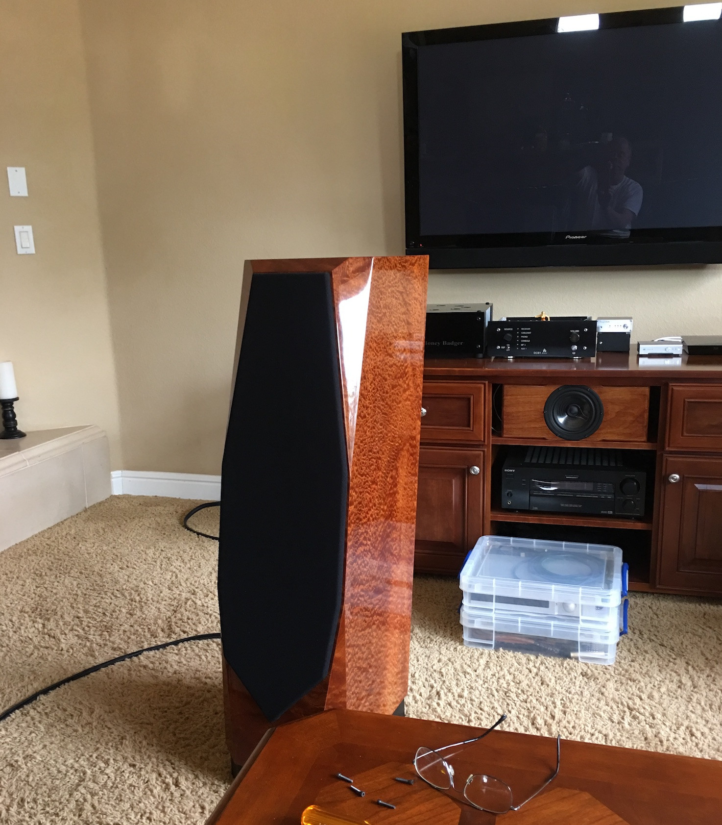

                                        here's one of two. Installing the grill cloth was the least fun I've had during this entire process. I started with .190" screen spline. Couldn't make it fit worth a darn. So, I bought all the different sizes I could find, (4). .160 works for me. I can get all the corners installed and the straight track stays tucked in the groove.
                                        Not a fun part of the build. But, I think it sounds better with the felt around the tweeter. I did not put felt around the mid, I tried it, but I liked the sound better with felt on the tweeter only.
                                        I'm working on the other one as I type this. With my other two hands......
                                        Ron
                                        Wife unit and I both agree, they look better with the grills on. Sound better too. IMO.

                                          They WERE designed to be flattest with the grille's and felt in place...
                                          but some people do like a slight smile in their frequency response. :B

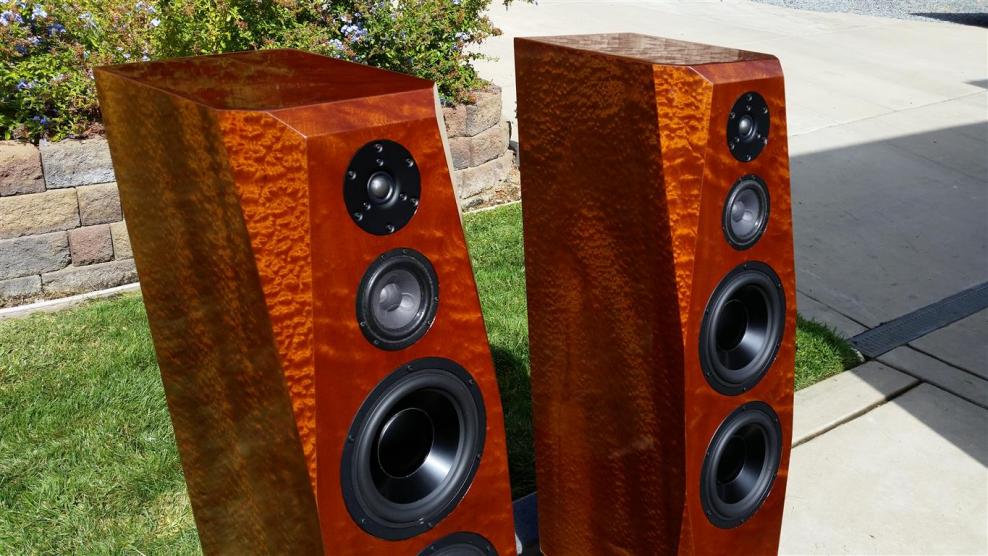

                                                      Glamour shot
                                                      Sunshine photo, and compound used.

                                                        Very nice, Ron.
                                                          • 1891
                                                          Where are my sunglasses 8) ..... very nice Ron

                                                                            Jon arrived exactly on time Sunday morning, I think he secretly waited close by until 9:00 O'clock just so he could be punctual.
                                                                            After a warm greeting and introductions it felt as thou we were old friends becoming reacquainted. Such a nice gracious man.
                                                                            We unloaded his cute little car/van and the springs moaned a sigh of relief after unloading all the expensive equipment Jon brought with him for testing and the listen session that followed. I'm just kidding about his Honda Element, it's a very capable vehicle with an enormous cargo area considering the size of the vehicle. I drive an Extended Cab Ford F-250 longbed diesel truck, which is more like driving a Cho-cho than a car. I'm not compensating for anything, I have a boat and a travel trailer I tow. (I know what your thinking Bob)
                                                                            Shortly after stacking up multiple boxes of what what most of us would consider Uber high-end equipment, Jon and I enjoyed a toasted croissant and strong coffee, cafe Au lait style. He asked for it and deserves it. Any man that can tolerate and enjoy a cup of my coffee should get a medal for bravery.
                                                                            Jon proved his mettle with a second cup, and later in the day a third. This guy is an animal!
                                                                            We discussed the differences (in theory) between the Mid-Priced and Full Monty Ardents along with pleasantries of a more personal nature. How Jon got his addiction for audio and his roots in his professional life. Oh, I'm sure y'all know audio is addicting, be honest.
                                                                            I had Bob Ellis' Schiit Modi 2 Uber DAC along with my DIY HoneyBadger and Pass DCB1 preamp warmed up and ready to go for a music test for Jon. I put on Allison Krauss and within (I'm not exaggerating here) 10 seconds Jon had heard enough. He knew something was rotten in Denmark. (just for you Tek) American Slang meaning something was obviously wrong. Without embarrassing me, Jon said he wanted to set up his test equipment to substantiate his diagnosis. Dr. Jon is in the house.
                                                                            After measuring the first speaker, sure enough, his prediction that the mid driver was wired out of phase was apparent by the huge dip in the waveform.
                                                                            "Mid polarity inverted, and all looks as expected... " link here;
                                                                            OK, have the data now for the ScanSpeak 12MU4731- have FRD and ZMA files, too- First, a composite set of curves at 0 degrees, 15, and 30: Here's the impedance curves- point to a fairly clean motor with good inductance control: It will certainly be easy to work with, as regards crossover filter- no undesirable
                                                                            Now I'm willing to admit I make lots of mistakes, but I interpreted this meant to invert the polarity of the mid range driver when installing the wiring. :huh: We'll let you be the judge of it's meaning. (Joke between me and Jon)
                                                                            So after a quick pull of the driver and swapping out the wires we retested the speaker for response flatness. Bam! Nailed it!
                                                                            I must share that I was enjoying Jon's company and stories so much that I pulled the wrong midrange speaker out first. We had the test setup on the other speaker and didn't want to move the mic. If I had been thinking instead of yammering, I'd of pulled the DUT (driver under test) first before removing the other driver from the secondary speaker. It all worked out well as I had to change it out anyway. We laughed at my mistake and moved on to testing the properly wired speaker. We laughed quite a bit during the day and I enjoyed Jon's company. Did I mention he's a really nice guy?
                                                                            With his extensive collection of Hi-Rez files on his computer loaded up we sat back and listened to the above listed songs with our eyes closed. To say I was amazed would be a gross understatement. The dynamics of the horns of Harry James took my breath away. I told Jon it felt like I was sitting in the front row of the Jazz club and had to wipe the trumpet splatter off. That's REAL!
                                                                            One of my personal favorites was from Lorde, the song Royals. It's a pop / light Rap song and her voice was just magical, magical.
