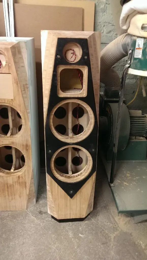

                                      Yeah the magnets on the grills worked out well. I recessed the magnets in the baffle .060" and that seemed to be the perfect depth for attaching them securely without having to fight with them to take them off. I had another late one this eve and got the boxes prepped for hardboard, got the grills on, installed the inserts and the bases. Laser cutting the felt tomorrow hopefully, probably more sanding and hopefully getting the hardboard on. My raw veneer should be in tomorrow as well so maybe I can bookmatch it and get it ready. Anything but more sanding..
                                      A matching centre would be great! I also want to copy TEK and make a similar faceted box for my little Dayton 12".
                                      Excuse the dusty and blurriness:
                                            Click image for larger version  Name:	IMAG0191_zpsususakvk.webp Views:	26 Size:	57.1 KB ID:	934254
                                            Looking very, very good, Ben! with inset felt for diffraction control, these should work very nicely! :T

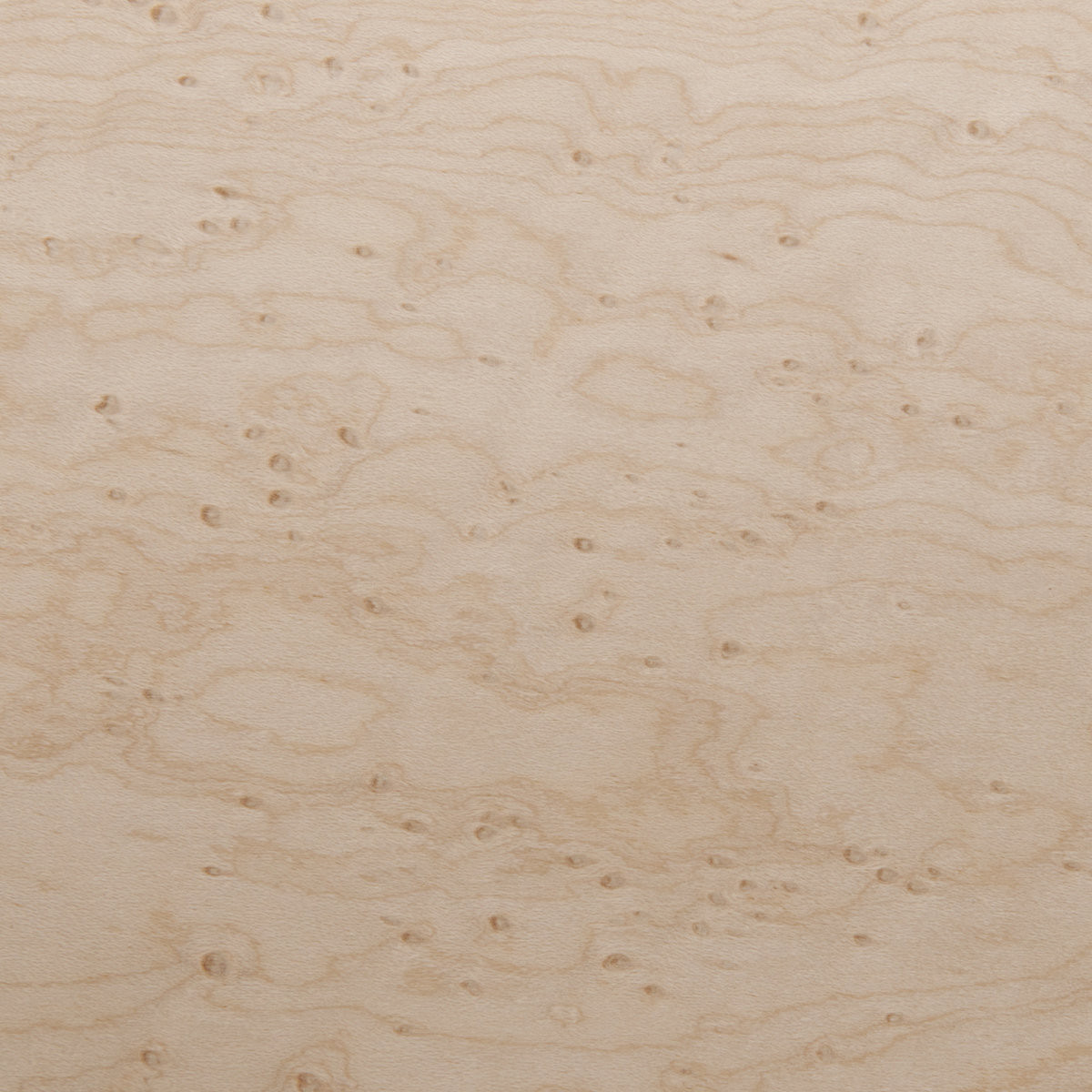

                                                  I found a little spare time early this AM at Starbucks and bit the bullet and ordered veneer. Decided to go ahead with Birdseye maple; a little old school relative to my normal taste, something in between Ben's Walnut burl and typical curly Maple. I have a good feeling about it, though...
                                                  I was hoping to have this evening off, (to do experimental concept work on the crossover, using past measured data for the mid and tweeter, and the measured data for the NS12's, as a stand in for the woofers,) but now we're setting up a follow up interview in more technical depth for the candidate we had a dinner interview with last night- he's here from Chicago on "normal" business for his employer, so we have to be flexible, but it looks promising so far- we may actually have two fairly solid if differently skilled candidates to make offers to fairly soon. The sooner they are on board, the sooner the possibility of going back to my more "normal" role. This would be welcome, especially because of the commute it otherwise involves for me.
                                                    Excellent choice in veneer, I always loved birds eye on guitars. Good to hear things will be getting back to a more normal pace for you!

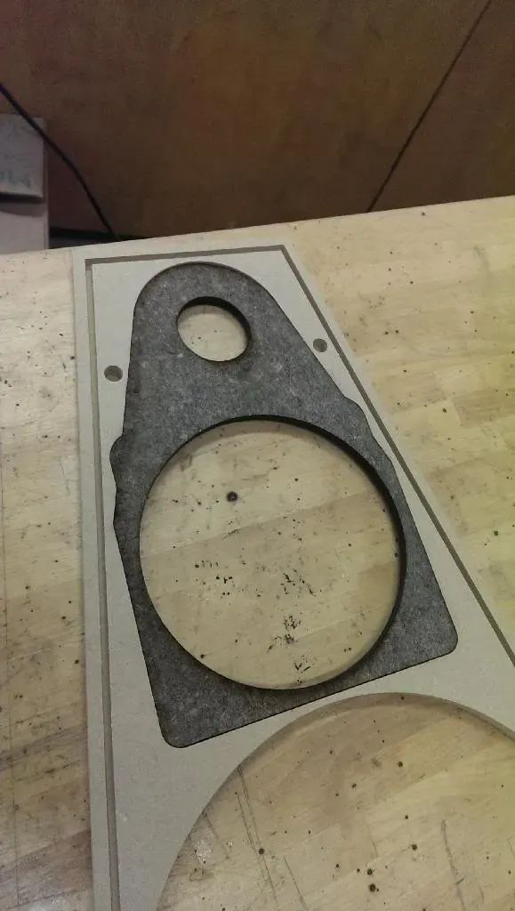

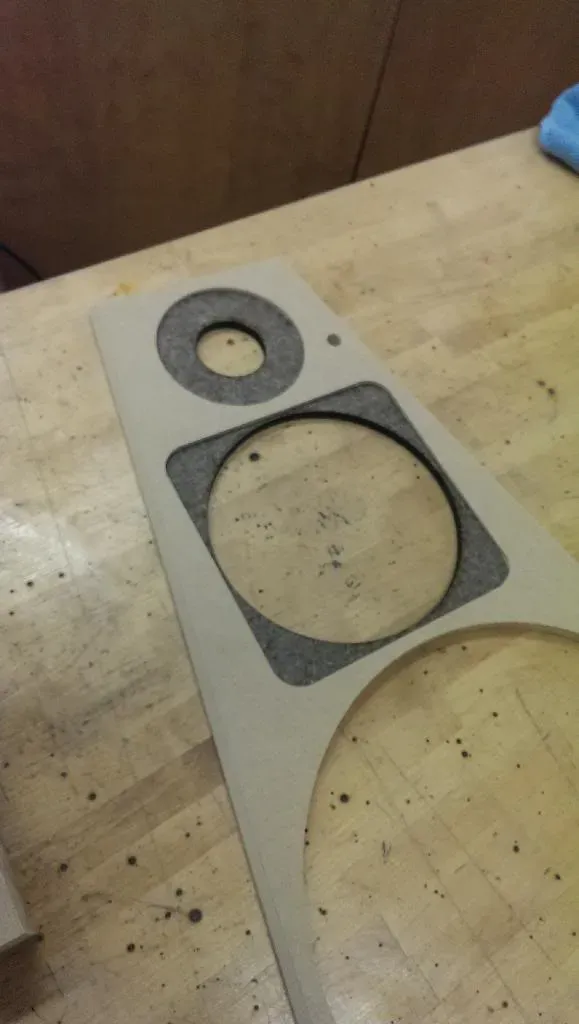

                                                    In addition to laying up the first bit of hardboard on my boxes we got all the laser cutting done this eve. Fun fact about laser cutting wool felt, it smells like burnt hair.
                                                    The fit turned out perfect though so I can't complain:

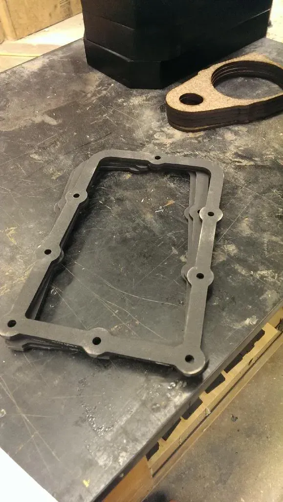

                                                    We also found some closed cell foam laying around that looked like decent gasket material. So we laser cut that too. It should provide a nice air tight seal for the bases:

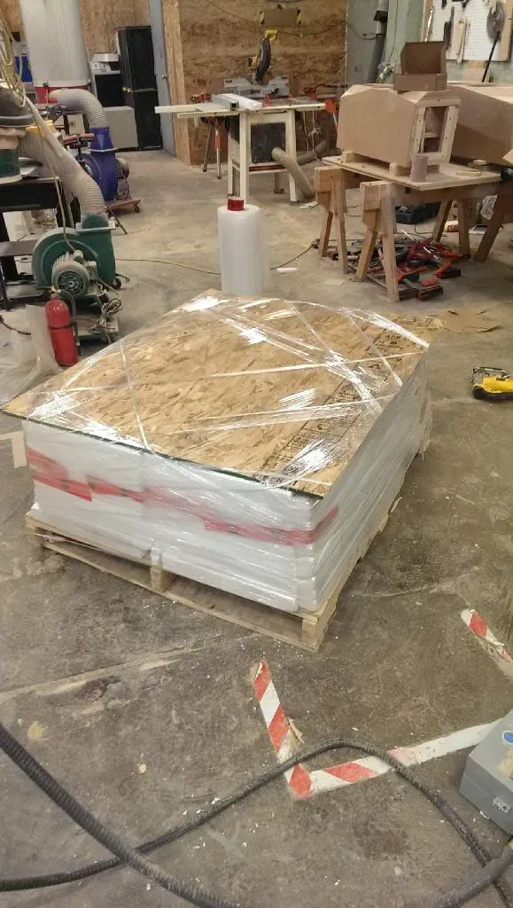

                                                    Now that that is out of the way, my dad is going to grab a pallet from work and we should have Jon's set ready to ship by the weekend

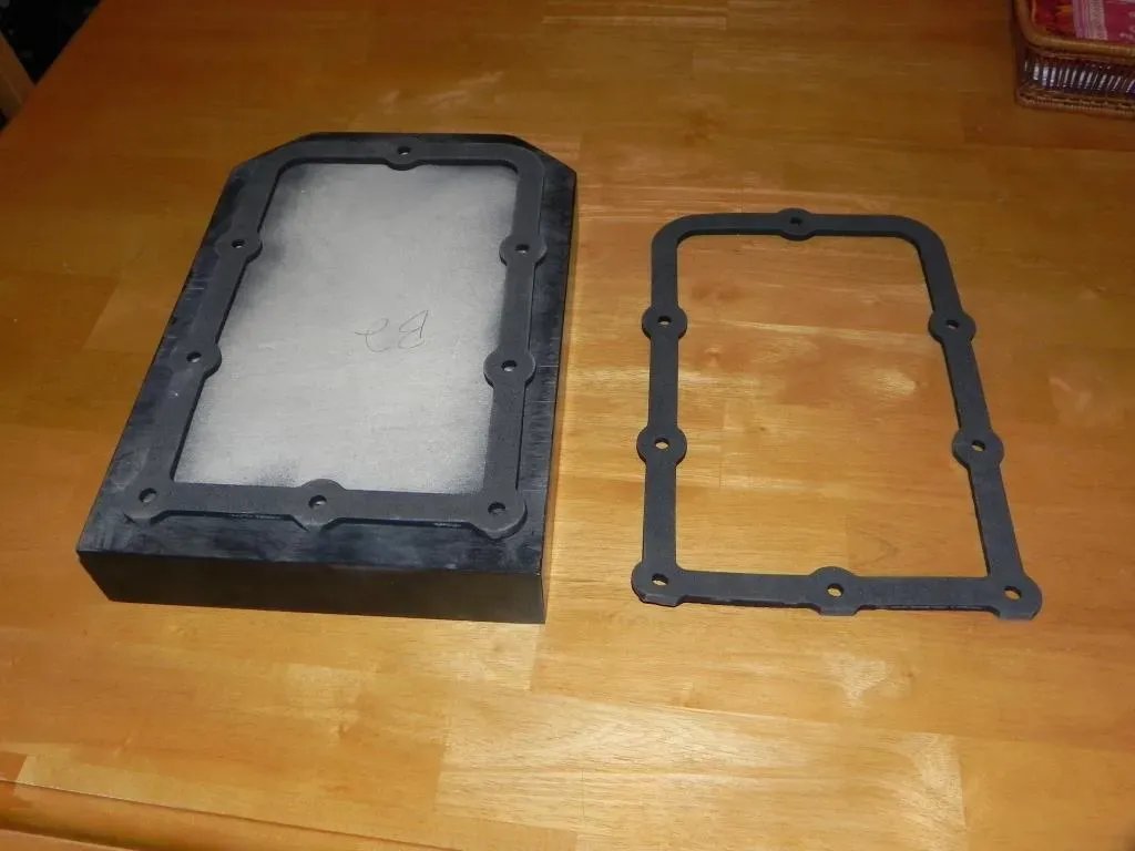

                                                      Geez, Ben I didn't know you snapped those shots. Anyways here one of the base gaskets.

                                                        We can hold that felt in place perfect with a couple of dabs of Hot glue. I put the felt in a bag and I think I can small a sheep on fire still! They should stop smelling maybe after the burnt edges are sanded off.
                                                          Click image for larger version  Name:	IMAG0197_zpsvkuynqiq.webp Views:	24 Size:	43.4 KB ID:	934256
                                                          Click image for larger version  Name:	IMAG0198_zpspbj1d05g.webp Views:	18 Size:	26.6 KB ID:	934257
                                                          Click image for larger version  Name:	IMAG0199_zpsco3of7rr.webp Views:	24 Size:	75.7 KB ID:	934258
                                                            Good looking base gaskets- classier than the weather stripping I cut and used!

                                                                Ordered some trim bits this morning from Rockler, spreading the business around.
                                                                Look familiar? :W
                                                                I'm guessing you have customized this one beyond the standard picture you posted- I'll need to do the same, just getting ready to "rock and roll" here...
                                                                Purchasing department also scored on something I've been hunting for a while, this time on eBay:
                                                                In case that's a little puzzling, it's just a portable compact spare for my NSX...

                                                                            Got shipping notice on the veneer about 3 AM today (yeah, I was just staying up all night watching my iPad Air, hoping to see that so I could go back to sleep at peace with the world.... :B
                                                                            And yesterday, in tangentially related news, I got most of the way through preparing the crossover BOM for the Isiris, which of course is the starting template for the Wavecor Ardent; I have some ideas about how to surgically pare the cost without paring the performance- will involve careful specification and selection of inductors and capacitors. I'm getting setup for LspCAD simulations, have to get some data off my Mac Mini, and transfer to the new retina Macbook Pro or the Mac Pro. I'm jazzed and ready to "rock and roll"! ;b>
                                                                            Even if that is something of a musical contradiction!

                                                                                      #222
                                                                                      So it looks like an epoxy finish is a good choice for PSA, I spent way too much time reading about adhesives, wetting and surface energy but it appears that it will be a good choice. The old man wants to use sanding sealer but the can doesn't say what's in it so that makes it a bit tricky.
                                                                                      Just more sanding and epoxying on hardboard today. Oh and this:

                                                                                        #223
                                                                                        Your very own little speaker factory :-)
                                                                                          • 16038
                                                                                          #224
                                                                                          Sets my heart a racing...
                                                                                          Click image for larger version  Name:	IMAG0203_zpsdgc98tnf.webp Views:	23 Size:	90.8 KB ID:	934262
                                                                                          my, my... What a nice pallet you have there!
                                                                                          yeah, after a little more research and thought, epoxy as the base coat for me, too. Have plenty on hand, have good dust control and a respirator mask...
