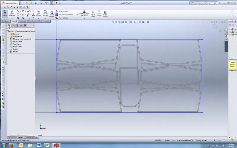

                                              well, it looks like you've got it under control... cutting it close, though! I'm trying to figure out where I can layout a few tables together and a big sheet of ply as a working surface! What do you have for a plotter - something that will do the pieces at 1:1? I don't have access to a large format plotter anymore - though I can print up to 17" x 38" on my Epson 3880- that's not big enough for a side wall template. Well, no worry, I can cut a template in 1/4" MDF/HDF for most of the pieces easy enough, and use that to block out the veneer sections.
                                              For being someone experienced in 3D CAD, I still do a lot of stuff pretty old school- habits from the 70's and 80s. Probably like your Dad.

                                                Yeah I'll get the old man to plot it in two parts at his work. Here is the file if you want to use it for your veneer. I just did a .5" offset around what the model shows the size to be.

                                                    #250
                                                    You got a lot better deal than I I think. The 'merican dollar is surging so my statement says my veneer ended up costing over 700 bucks The CNC is out of commission for renos and my buddy says no no more wood on their big laser so it looks like I'll have to plot a template and do it the old fashioned way. Fingers crossed.
                                                    Click image for larger version  Name:	Untitled_zpscf1e71bf.webp Views:	19 Size:	24.7 KB ID:	934274
                                                    That's close... Maybe to close? Is it intentional that the wood grains on the top is from side-to-side instead of from front to back?
                                                        I showed the progress to some local guys and they gave me a chuckle by referred me to this.

                                                                    It's going to be tight for sure. I just ran the area in solidworks quick before I ordered, decided I should get some raw for the backs and it still is going to be real tight. Being a burl (and because it's made up of quarter matched sheets) the grain is kind of all over the place. The layout may change a bit when I can flatten it and place the templates on it. I wish it was about 4" longer then I could keep the nice book-matched pattern going from the base, facet and along the top. Ah well.
