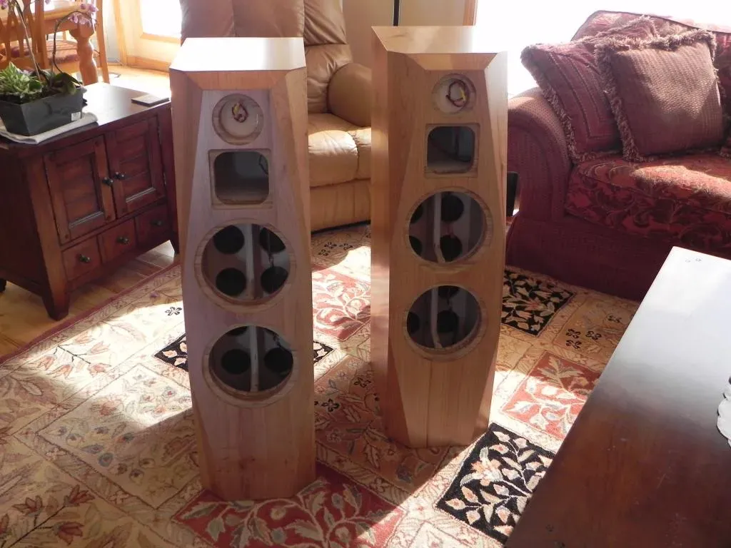

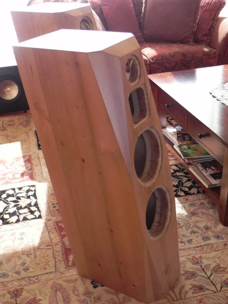

                              Picked up the cabs this morning. Love the conversion varnish. My cabs look pretty nice. They have 1 run in the finish that I'm going to have to fix. I think if I was finishing them my self I would go for another sand and 1 maybe 2 more coats. So I'm going to have to resist perfection. I'll let Ben speak of his.
                              Some quick pics, I do love my choice of rustic plank cherry with just a touch of natural stain (just linseed oil and solvent). These have 4 coats of gloss and it looks like 1 satin. The look through the finish is perfect and the varnish is already hard, (maybe 2 days of drying). Lacquer is harder but this looks to have some properties of a poly and maybe more scratch resistant and looks rich.
                              Lighting was tough and Photo not my forte.
                              Click image for larger version  Name:	myard005-1.webp Views:	24 Size:	75.9 KB ID:	934552
                              The painter was right, it would hardly be worth rubbing the finish out.
                              Click image for larger version  Name:	myard001-2.webp Views:	29 Size:	51.4 KB ID:	934553
                              The side have the contrast I wanted, glad I sent the first veneer back for a new batch,

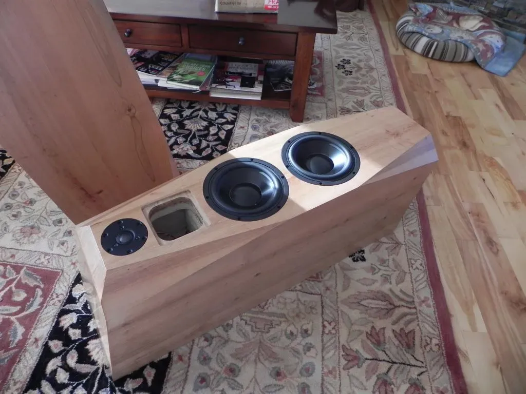

                              Okay Ben and I couldn't resist dropping in some drivers to see. It's going to be hard not to rip the grills off when anyone comes over just to show off and for me to shut up as my wife already says okay Dear they are beautiful. :lol:
                              Click image for larger version  Name:	001.webp Views:	29 Size:	70.3 KB ID:	934554

                                Looks great! Two thumbs up! :B
                                Expect them to harden further after sitting up a week- I'd give them that long before doing much handling. Even a catalyzing finish takes a bit of time to reach it's final hardness- this type is supposed to be very durable, with good UV protection, from what I read.
                                Now, my question at this point, is where are the midranges? :W

                                  Thanks Jon, I will let them rest to harden further. The mids will come when we have a complete Madisound order, trying to do only 3 bulk orders to include xvover parts for both Ben and I. Got the solen still need the Madi. and Parts. Unfortunately we get dinged with higher shipping in Can. and the dreaded PST, GST which makes it worth while to only ship once if possible. Although Ben just got some grill cloth and a assortment driver screws in a second Solen order.

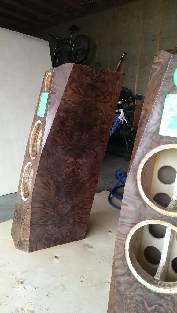

                                      #513
                                      Long story short the surface wasn't what I asked for so I'm wet sanding them and hes going to apply a few more coats. He sanded the tops between coats and it turned out well but the other surfaces are unacceptable. I really like the product and the color at least. It'll be ok but I'm pretty annoyed at the prospect of more sanding.
                                      Only have a quick cell phone pic but I think you can see the orange peel and grain peaking through the finish.

                                        #514
                                        I can see what you're talking about Ben. The color looks great, but I can see why you'd want to address the surface finish. It should be possible to get that "right" with just a bit of work buffing it out now, and another coat and some finish work on that.
                                        Your's are really going to be super with that Walnut burl figuring and color after you get the finish sorted out!

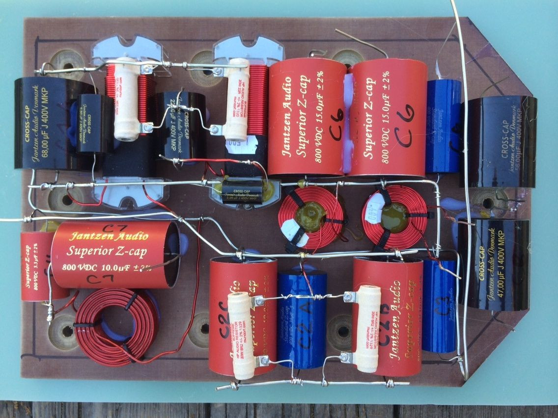

                                              Making progress, far from finished...
                                              Well, just had too many chores and errands to do this weekend- definitely slows me down when the only free time is on Saturday and Sunday. Not finished, but made some real progress, shows the general concept which looks like it's going to work, but doesn't give me the room I would like for using feed through connectors and what not- going to just have to drill holes in the base for feeding through the Cardas SE-11 and sealing with hot glue.
                                              My gravestone epitaph will likely say something like "he lived and died by hot glue... a true believer!".
                                              The tweeter crossover is in the lower left corner, the woofer crossover is in the upper left corner, and everything else is midrange! :B
                                              Main input and ground buss wires are just AWG 12 tinned solid copper.

                                                Okay now that would probably take me a week to try and follow this.;x( waiting to see how your terminating all of that.:E
                                                I do think from your photo of the spacing a mid and tweet would go little more comfortable on the base. One daughter board for the base section on a side wall would work nice, may leave room for termination strips. At least I think I can do that without screwing it up. Really nice seeing all those parts though.

                                                    This is a rather lower component count xover for Jon
                                                    I can see that someone's going to be playing music through his Ardents soon enough.
                                                      The first statement is VERY true- this is one of the smallest 3 way crossovers I've ever done- the only one competing with it would be the Modula NeoD CC!

                                                        This is a low count, small component three way crossover, Hank. Certainly for me- you should see how much bigger the Isiris crossover is, which nevertheless uses many of the same concepts described below!
                                                        I'll have to collect the boards together from the MkI Ardent and photograph them for you to show the contrast... it's amazing, truly.
                                                        A lot of the difference is due to a number of specific design decisions-
                                                        • Sealed enclosure with larger, higher Qts drivers instead of smaller drivers in a ported enclosure- this eliminates the need for compensation of the vertical column resonance of a lined enclosure to eliminate interaction in the LF crossover- that scratches off a large LCR network; it has numerous other advantages, including a more amplifier friendly impedance curve (more oriented towards voltage drive instead of current drive), and much nicer step response and LF definition.
                                                        • Ultra linear woofers with distortion monotonically dropping to 1 kHz allows a higher crossover point and smaller midrange networks without (I hope!) fidelity issues - all of this has been balanced against floor bounce issues and the needed height of mid bass to low midrange radiating source
                                                        • Switched from a Duelund network concept to Evil Twin's NatalieP concept with a quasi LR3 transfer function, all drivers wired in phase- Duelund places big demands on midrange bandwidth and linearity above nominal crossover frequency, requiring LCR equalizers for the midrange.
                                                        • NatalieP type crossover function supports steeper attenuation of drivers, and requires time alignment with mid behind tweeter, woofer behind mid- again, simplifies network issues- the Duelund network, like all other classical types, assumes location of acoustic sources in the same plane, and special efforts to compensate for that
                                                        • NatalieP transfer function works well further from driver Fs resonances, eliminates Fs impedance interaction, and allows eliminating Fs LCR zobel networks on drivers - big component count reduction
                                                        My intent here was to employ a level of "production product engineering" on a par with what the Winnipeg team has delivered in this collaboration, so I've spent quite a bit of thought about how to get high performance at minimal cost. Just like a commercial product designer would have to do, but maybe not with as many compromises.
                                                        Yes, this has more parts than a "Finalist" crossover, for example, but the Finalist places great demands on the drivers, with high overlaps and what is effectively a 1st order design, using an LR1 alignment. This will have consequences in measured and perceived distortion at higher playback levels...
                                                          I'll try to make this a little easier for you guys when this is finalized, by preparing a merged picture schematic rendition somewhat like this one for the NatalieP.
                                                          I'll draw out a schematic using the same component layout as the board, and also do an overlay on the picture of the board when it's finished. Hopefully, as my Deutches colleagues would say, that will make it "Alles klar".
                                                                I snapped this after sanding and cleaning with mineral spirits. I kind of like the satin look and now I'm waffling between full or semi gloss and satin.

                                                                  Yeah, this doesn't look bad at all- it reminds me of the image of an Avalon Time you posted back in the 10th page of this thread. Isn't hindsight always 20-20, though? :W
                                                                  I think the only person with a more challenging schedule than mine, Ben, is YOU!!
                                                                  As to the choice, you can always shoot for full gloss and knock it down to satin without much effort... these might look best in semi-gloss or satin, though. Either way they're going to be very striking. I think my maple may be better in full gloss; or at least, I should try that first.
                                                                    Yeah exactly, that's nice about gloss you can knock it down.
                                                                    Since we've been tying to keep production considerations for these guys I think a good option would to paint them. It would cut out several processes and we are almost there since we sealed with epoxy anyways. I've always been enamored with the finish on the Sony SS-AR1:
                                                                    Click image for larger version  Name:	711sony.1.jpg Views:	30 Size:	101.9 KB ID:	934559
