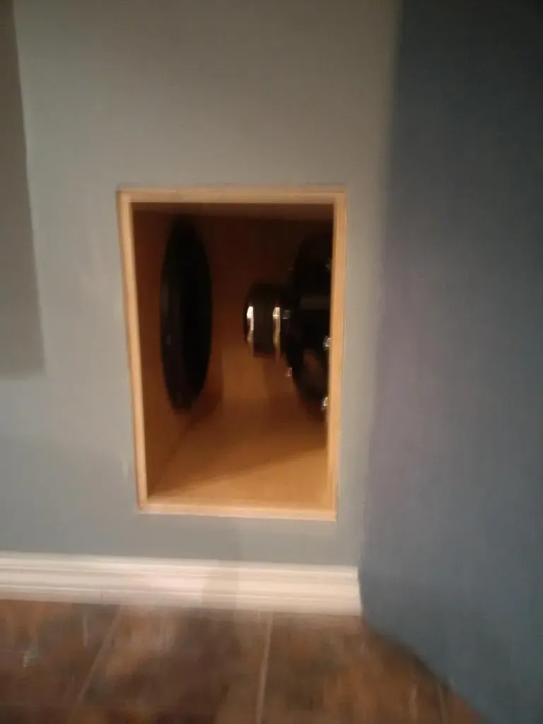

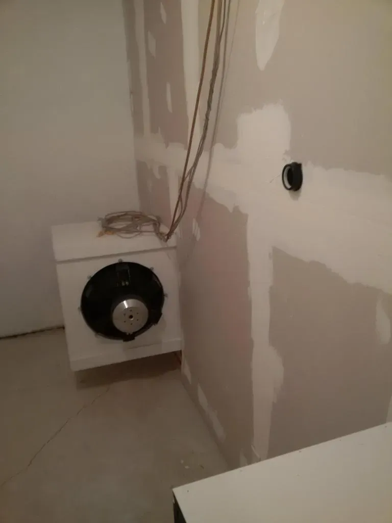

          I'm thankful for getting my IB manifold installed. :W
          This is the front wall layout I'm trying for.
          Back storage room framing.
          Hole through the wall to the front room.
          Manifold in place.
          A look in the manifold form the front room.
          Click image for larger version  Name:	IMG_20141013_190723.webp Views:	19 Size:	13.7 KB ID:	934618
          Sorry for the sh%% cell phone shots, I'm tired but happy. I'll take some better shots when the Ardents and all is in place.
          Last edited by theSven; 25 June 2023, 19:36 Sunday. Reason: Remove broken image links

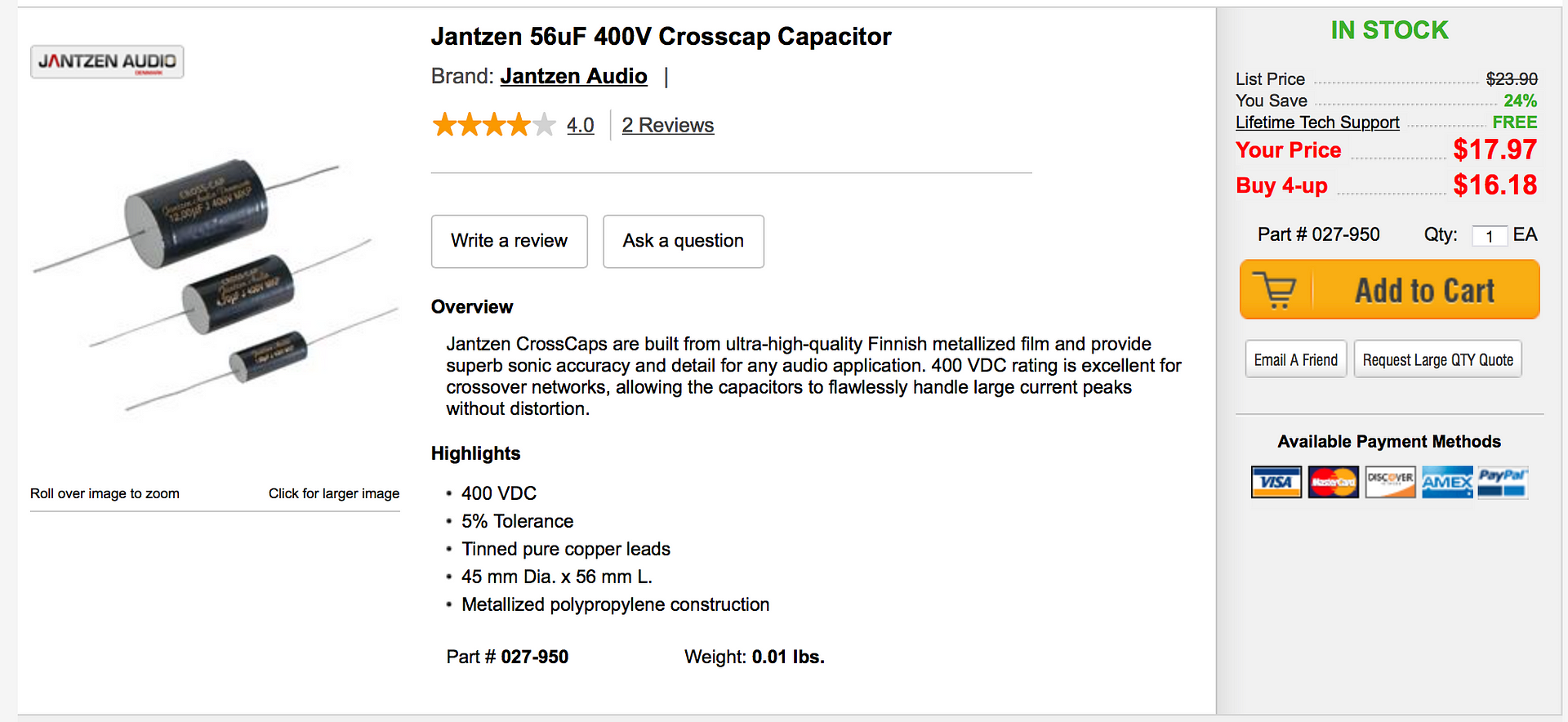

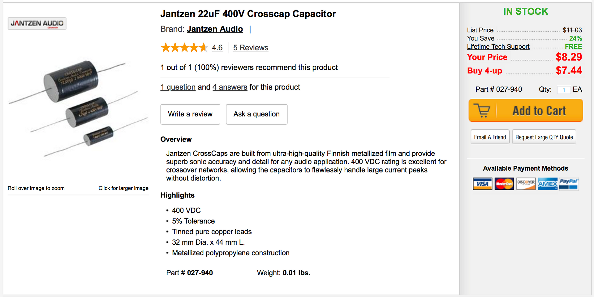

            Originally posted by dar47
            Okay, here is an updated one. This has the C3A1 (or could be called C6c) changed and I added your MR caps in the tweet. Jon still has to call this the final production model though.
            Click image for larger version  Name:	WavecorArdentXover.webp Views:	0 Size:	91.3 KB ID:	934617
            I'd downloaded PNG snaps of the web pages for most of the parts, but hadn't had time to go through them. I'm at Starbucks, and found you did a good job except for PE par numbers for two caps in the woofer crossover:
            Other than than it looks real clean! :T

              Hey, that's HUGE progress, literally! I bet these are going to seriously kick some butt! (oops, I hope that's OK for a moderator to say... :W )
              Did you do this yesterday, or are you just giving Thanks on Canadian Thanksgiving yesterday? :W

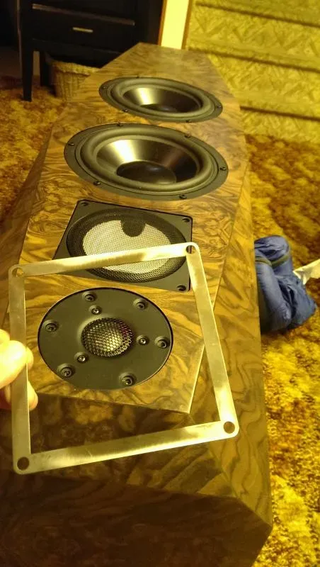

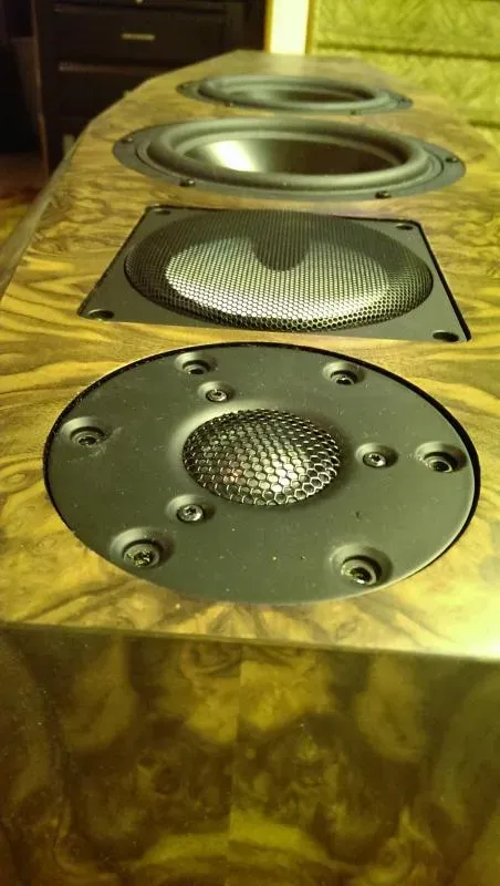

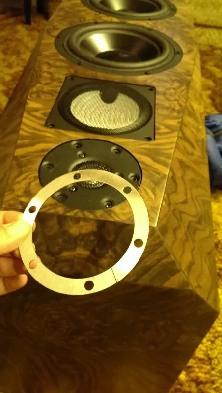

                Just a little update. The rebates were close but not close enough for me and that caused the drivers to sit a little too low.
                So I had a friend laser cut me some stainless shims:
                And the result was a runout of under .010" which will have to do

                  Talk about OCD! 8O But they look nice! :T

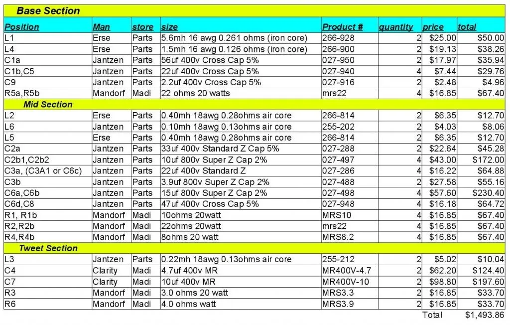

                    #999

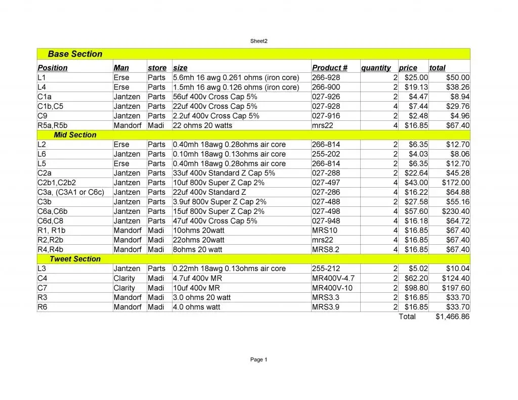

                    Nice find so maybe this is the final?
                      #1000
                      Nice, did you order for all? haha.

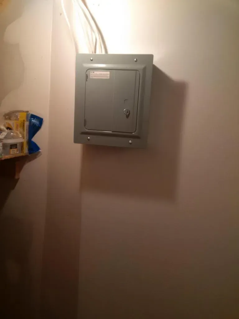

                      Well I had a productive night, managed to get the 8awg 3 wire conductor from the panel in the garage through the wall and into the storage room down stairs so now I just have to wire up the sub panel and I have got all the power I need for my room.:W
                        Bad light in the basement and a cellphone.
                          Click image for larger version  Name:	WavecorexoverBillofMaterials.webp Views:	0 Size:	112.2 KB ID:	934625
                          I do like Ben's walnut burl, but then you know, I like my Maple, too! And your Cherry! I've got some nice Cherry for GF's sub build, I need to get back to working on that, as well as the other speaker projects, as I SHOULD have a free weekend finally (training the stormtroopers went fine yesterday... )
                          I also want to spend some times with the files Ben linked to on his DropBox account, and start to consider preparing a build document for the Wavecor Ardent similar to the one I did for the Modula MT XE. That will be shared with you guys for review and critique of course, before any "general release".
                          And I need to load and finish my second WA! Stereo would be nice... then it's updating the Isiris, with the crossovers moved internal. A lot to do this Autumn. On the 25th, though, we're leaving for a few days on the Channel Islands, and when I get back, I'm driving up to Seattle to pick up that Yamaha on the 1st. So those two weekends are already committed. Then it will be November already!

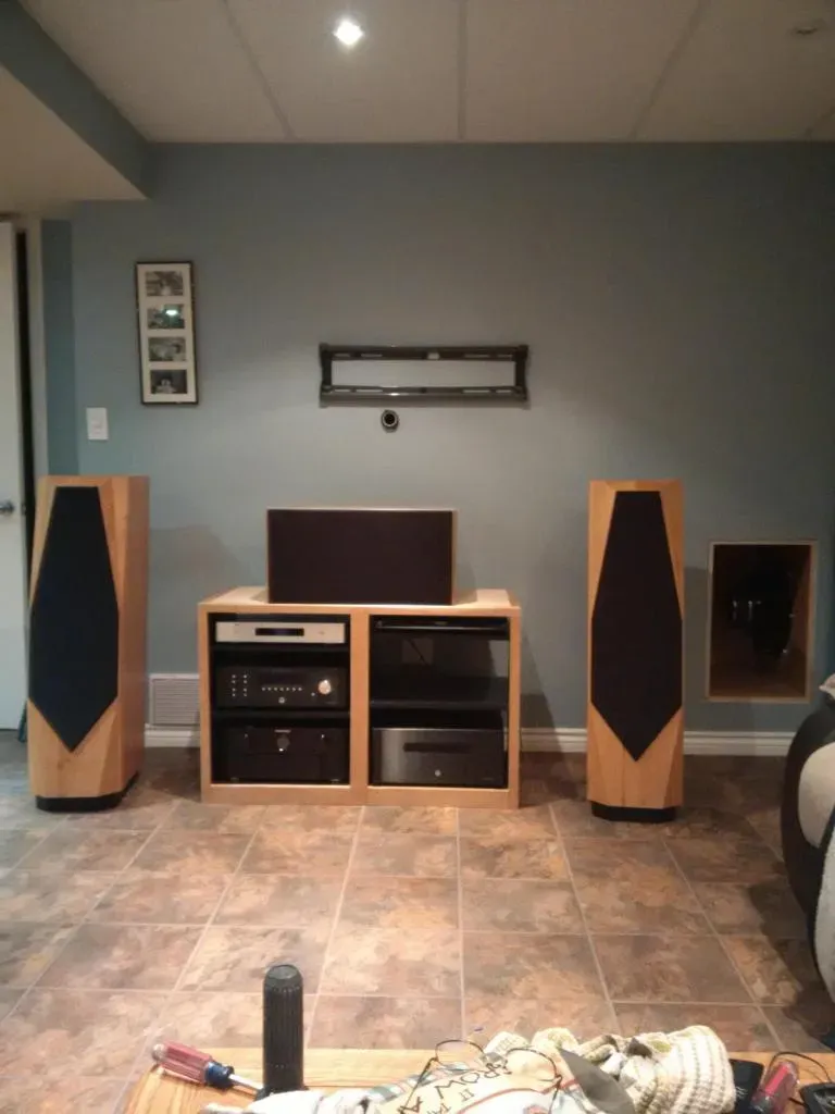

                                                Made some progress on my storage and front wall, things are turning out well.
                                                IB all tucked in and wall is now dry-walled.
                                                Click image for larger version  Name:	IMG_20141019_225458.webp Views:	13 Size:	12.3 KB ID:	934627
                                                New cart for gear inside the storage area, added some pass through holes for wiring between the rooms. I just used abs plumbing fixtures seamed to work well and you won't see them. After the cable is passed through I can stuff the holes to keep the storage some what sealed for the IB. You can see the new electrical sockets on my 3 new dedicated circuits at the bottom.
                                                New sub-panel in the storage area as my main panel is in our attached garage. Wasn't fun fishing wire into the garage and running 36' along the trusses to the other end of the garage where the main panel was though.
                                                Click image for larger version  Name:	IMG_20141019_225524.webp Views:	13 Size:	11.7 KB ID:	934628
                                                And a sneak peak of what the main front wall is going to look like :B, I like the center channel on the new stand and I don't think it looks that big next to the Ardents. Hope I have cleaned it up enough and have spacing for good sound?
                                                Click image for larger version  Name:	Ardents.webp Views:	13 Size:	33.4 KB ID:	934629

                                                  Great progress, there, and I really like seeing the pic of the cabinets where you're going to setup! :T
                                                  Between the Ardents and your IB sub, I definitely think you're going to have enough low end there! :B

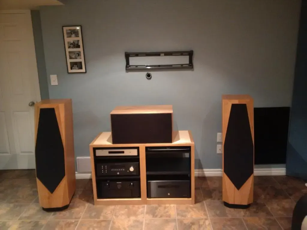

                                                                                New grill on the IB manifold.
                                                                                I have been doing everything else but making my final xover purchase, just got cable and termination for new interconnects and speaker wire, worked out wireless network in the house (Irule remote) and making plans for HTPC. I still need the sub amp and a new tv which is tugging at me. I started thinking on this way back with the original Ardent speaker camp and it looks like I'm going to be the last of the original 3 to hear the Wavecore Ardents.:roll:

                                                                                    Haha, Bob
                                                                                    That's the worm hole effect, but you do got the WAF going :T My wife would never take the time to look at a build thread, so if she loves it just take your time you may be able to reach higher. They do present a nice clean front stage though,
                                                                                    Click image for larger version  Name:	roomwithgrill.webp Views:	0 Size:	24.6 KB ID:	934632
                                                                                    If you hustle a little bit you'll likely hear stereo before I do! But then I'm going to work on some layout concepts for you guys starting next week for the crossover boards.
                                                                                          Haha, Bob
                                                                                          That looks amazing. I can't believe you are staring at them without the crossovers. 8O I couldn't wait. I would have the crossovers laying unsoldered all over the floor with temporary wiring. Not pretty, but they would be making music.
                                                                                          Do you have plans for a rug or room treatments. That photo looks like a very lively room.
                                                                                            #1035
                                                                                            Thanks, Ryan
                                                                                            The room is well treated with acoustic panels and a heavy curtain sectioning off the area to the left. I have a large area rug in front of the listening area which is temperately move for the re-org. I'll post some shots when all is back in place. Hope to have all my parts to finish in place by the end of the month. ops: Ben's stuff is on the way to Cal and he is off next week so he should get Stereo pair first!
