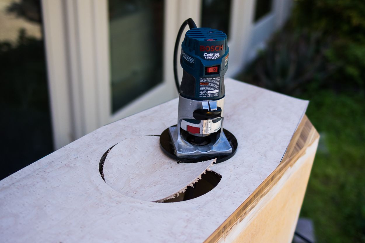

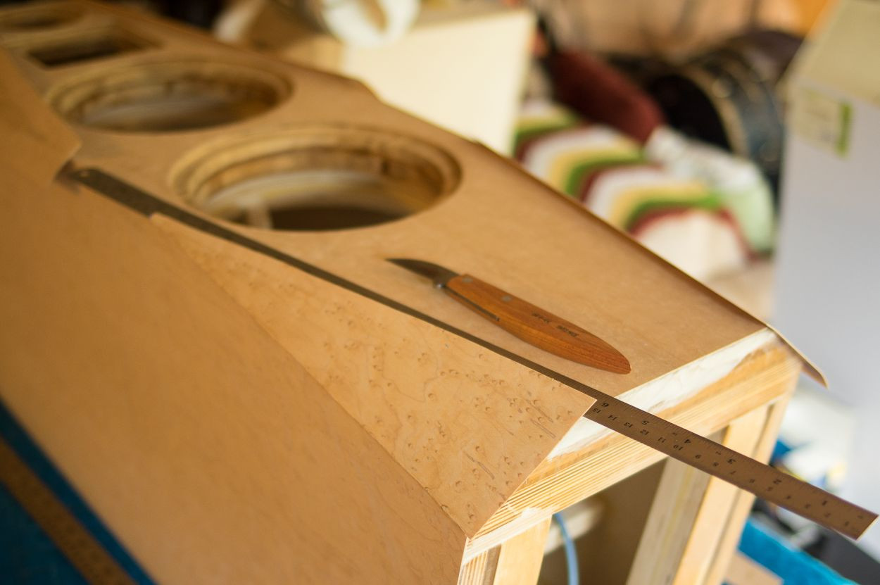

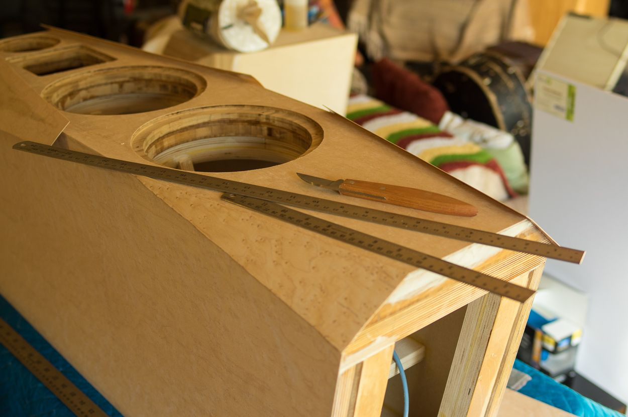

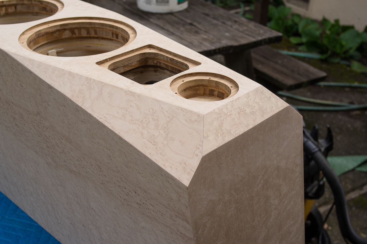

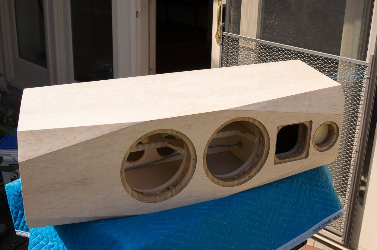

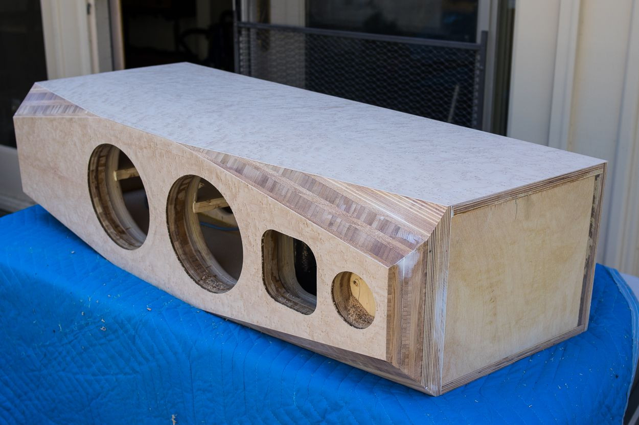

                        Making more progress...
                        OK, got some real work done, too, though not as much as originally planned- but there's always tomorrow...
                        I didn't take time to grind down one of the trim bits for the rebate work, but just set it up for the basic FP holes for now....

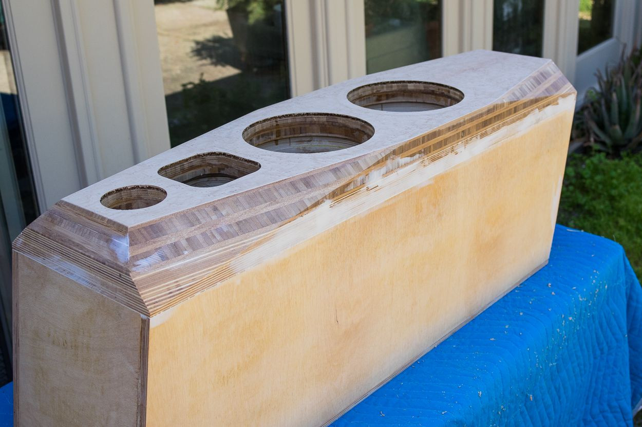

                        The real trick for most of the top veneer cleanup was that Swiss roughing knife and a steel rule backed against the underside of the veneer, followed up with the orbital sander with 80 grit Abranet pads

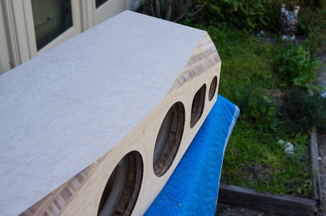

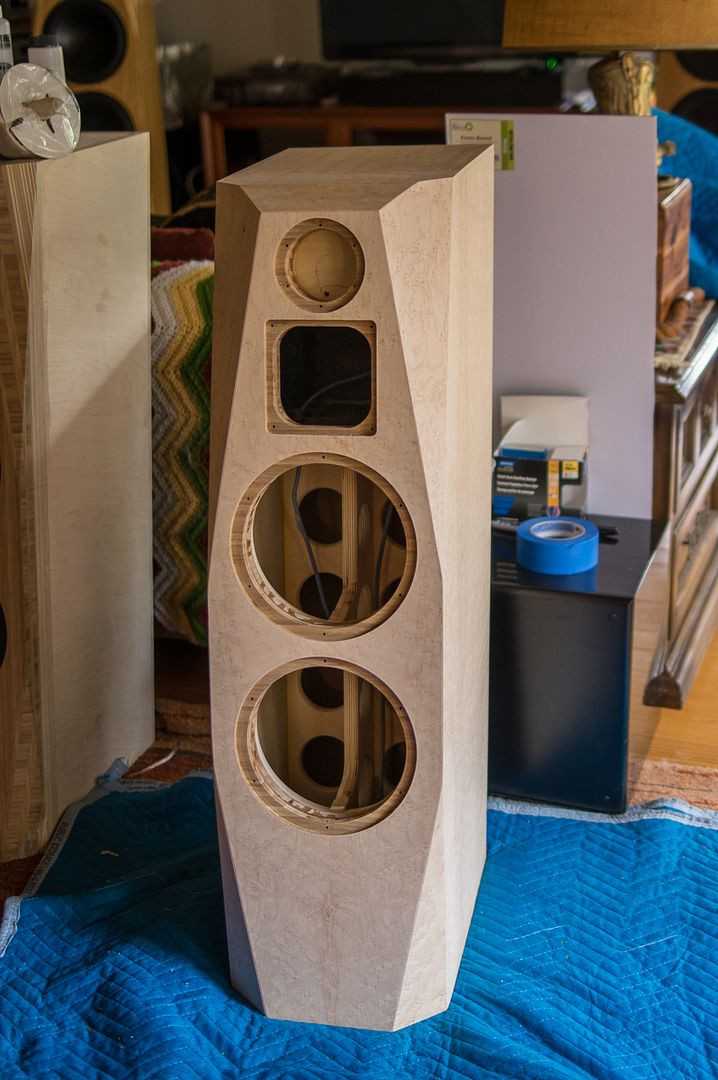

                        The first of the sides was applied, with a little positioning help from my POSSLQ. Then trimmed the same way...
                        So far it's going together pretty well - expect to do the other side tomorrow, perhaps the top bevel edge and top. Also have some car things to take care of, and laundry for the week- having no time except work and sleep during the week is really a drag...

                              #464

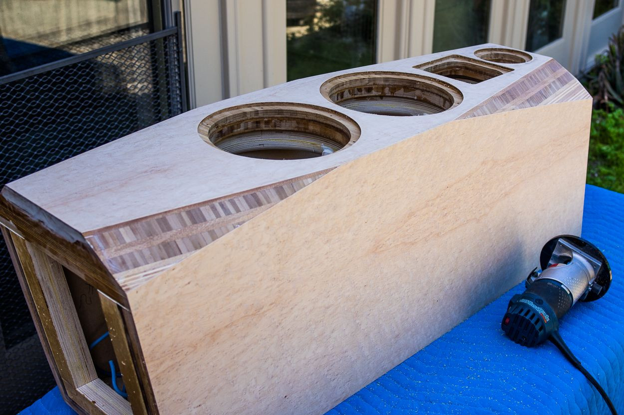

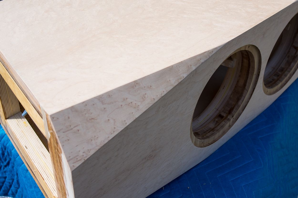

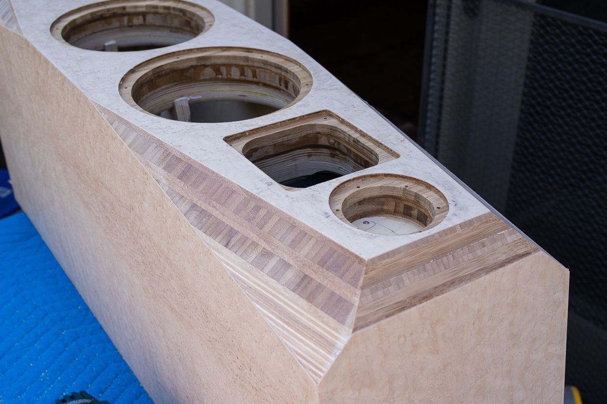

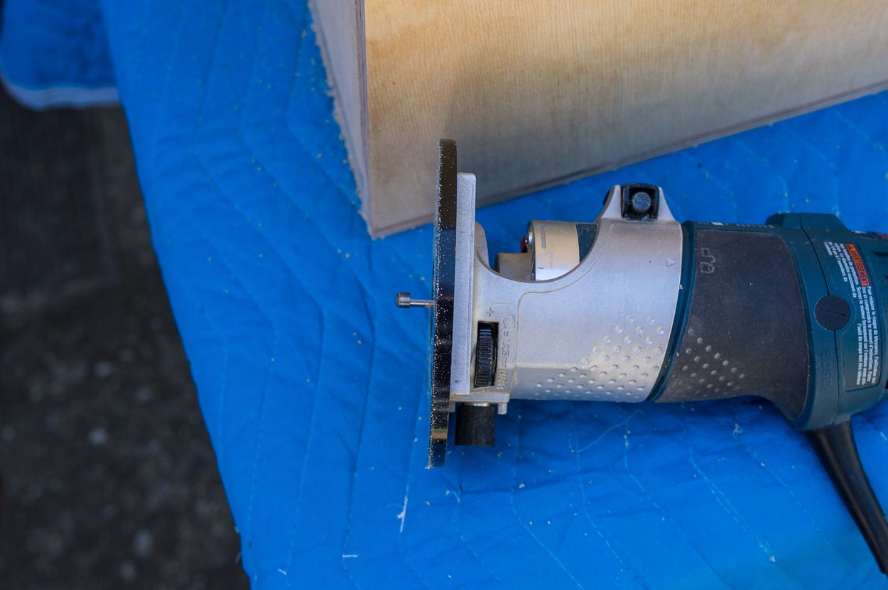

                              Slow work takes even more time...
                              Finding three hours to work on these today took some juggling and effort - but it was worth it. Part of the time was spent fixing up GF's bench grinder and grinding down one of the carbide trim bits- spent about 8 times as much time grinding the bit as actually trimming the inside veneer! I also got another side put on and the top put on, and after these pics, did a "wipe on" update of the epoxy on the bevel facets. Things are coming together pretty smoothly, so far according to plan.
                              While I was looking for my factory shop manuals for the NSX this morning, I also came across my good books on veneering and finishing... ones I haven't paid any attention to so far... maybe I should thumb through one just for the heck of it? :huh: :roll:

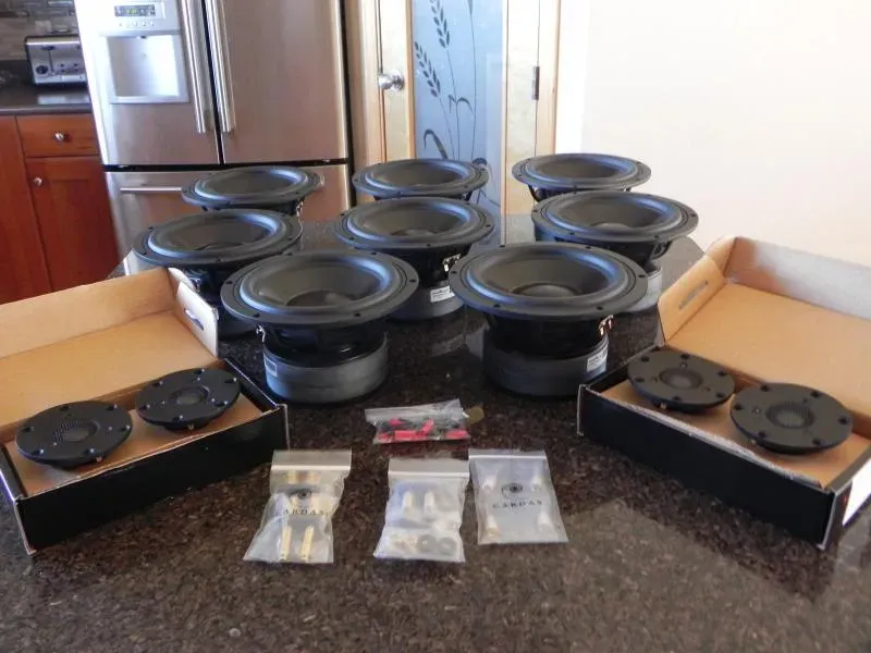

                                                              Good shipping and receiving day yesterday! Many parts and materials arriving- Cinch feedthrough barrier terminals off eBay, Titebond polyurethane hot glue for the crossover construction, the last of the polishing disks, tips for the new Weller WESD51 soldering station (my 15 year old Weller temp control station is becoming problematic to buy parts for) and some more Vampire binding posts.
                                                              Now, if only it weren't scheduled to rain tomorrow- would make things much easier. But there's plenty to do building inside, too! :B
                                                                #481
                                                                This is good, the American factory is keeping up it"s end :T The Canadian Ardent division is starting to see final assemble parts trickle in, HeHe.
                                                                The Wavecor's are black, even the spider and terminal leads. Thought we had a scratch on 1 of the frames but after touching (bad eyes) it was just some plastic. 2 shipping boxs were 60 lbs each, these are not going to be a light weight speaker. :B

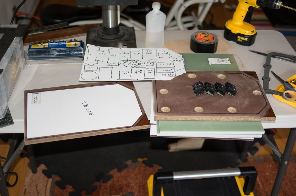

                                                                    I think I have a (revised) tentative plan for getting a crossover laid out and built this weekend, too. It's going to rain Saturday, we've been told, so apart from doing some low dust sanding of the facet bevels that were recoated with epoxy, Saturday should mostly be cutting out the new phenolic sheet pieces with a new sizing plan, and investigating if it's possible to lay it out so that I can still use bolt holes in the location of your original template which you guys sent to me. If so, it may get assembled in the end using those flat top furniture assembly bolts which you can buy at the hardware store, I suspect. All plans subject to change once the enemy (reality) is engaged.
                                                                    Mostly considering using these because
                                                                    1) Low profile
                                                                    2) I have a bunch of them

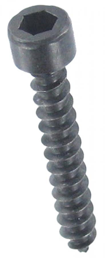

                                                                      Speaking of fasteners, does anyone other than madisound sell these guys:
                                                                      If not I'll have to wait until we place our madisound order, I'm not keen on paying 40 dollars to ship 6 dollars worth of screws.

                                                                        #485
                                                                        Hmmm, haven't seen these locally- that's why my initial build for driver testing here was using the philips head stainless steel Private Messages wood screws- the best local alternative. I'm guessing you've already checked all of your relatively local hardware sources? What about Solen in CA?
                                                                        this AM I'm trimming facet edges, and working on the baseplate assemblies- have a pair with mounting holes cut in the pattern of your template, with Forstner bits used for recesses; it looks promising, but I have to figure out if things can be arranged so that I can use the Cinch barrier feedthrough connectors, or whether I'll only have room to route the Cardas SE-11 through holes; - that seems a little unprofessional in assembly technique, but with the space issue, I may not have a choice. Hope to have that mostly sorted by the end of today, but it's sunny this AM, and yesterday was raining, and a bunch of rain coming up, so I'm focussing on wood working this AM (and filling out paper work for the Antarctica trip in 2015 that MUST be turned in today, scanned and emailed, according to GF.

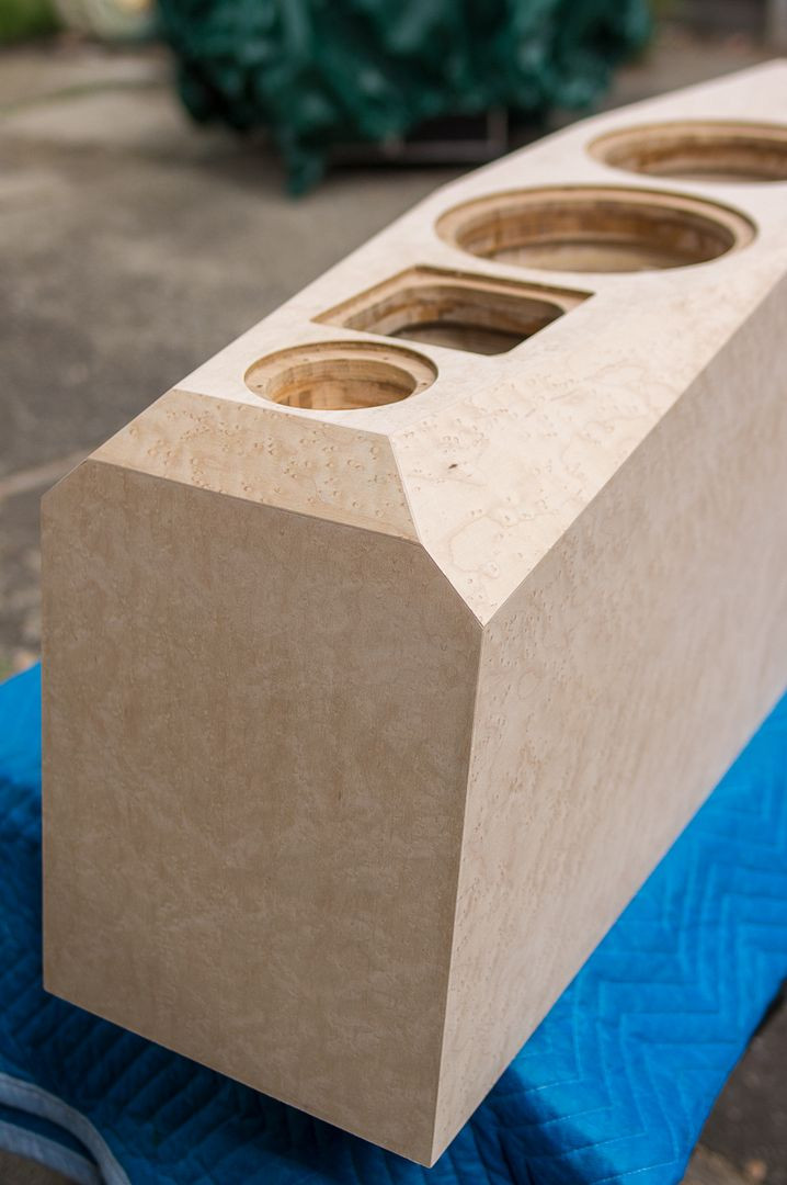

                                                                          Facet edges are trimmed, and the top front facet bevel has been applied, last veneer on this cabinet (officially Test Article 2). Now I need to work on Antarctica trip paper work, and then later before heading home to do laundry and see daughter for dinner, I'll be working on the crossover layout and component mounting. Think I need another trip to the hardware store, too...
                                                                          Pictures will go up later today. I'm taking very mindful approach for the veneering work, which is working out well, but it occurs to me that writing that up a bit may help others going down this path- I could create a Wavecor Ardent Build Hints & Techniques, but maybe I should just make some pages in Microsoft OneNote and export into PDFs and link for download? You and your dad don't need that, many of the more experienced guys don't, but there might be some who'll want to tackle these without quite as much cumulative experience. I will also need to take the CAD files and see if I can put together an updated set of "conventional construction" PDFs.
                                                                              Had the same problem. Solen has them but that might only save you $10 or so. I found the #7 Kreg pan head screws would fit the drivers I'm using (Anarchy) but I have to paint them. At least they were only a few bucks for 100 pieces. I also tried Fastenal and couldn't find anything for under $50.
                                                                              • benthe8track
                                                                                • 371
                                                                                #489
                                                                                Yeah I wish I knew Solen had them, I'll give her a call tomorrow. Hopefully they cut me some slack on the shipping considering we just bought near 5k from them last week.

                                                                                  #490
                                                                                  Hmmm, first post submitted at Starbucks this AM didn't "take". :W
                                                                                  Working on crossover base plates and veneering this weekend, not nearly as much free time for that as I would have liked, due to other issues. Still, some progress...
                                                                                  Doing the facet veneer, before trim with knife:
                                                                                  And afterward, before sanding
                                                                                  Back out doors for sanding with the orbital sander, 120 grit, Mirka pad, taking care to keep off the adjacent veneer face:
                                                                                  Post sanding on facet bevel:
                                                                                  Post sanding after top bevel:
                                                                                  I think the birds eye will look pretty nice after the lacquer clear coat- just may justify the price!
                                                                                  And back indoors for storage. Next weekend focus is purely on crossover construction and testing.
                                                                                    #491
                                                                                    Wow! Those look so nice, love the maple and it looks like your prep paid off with nice crisp lines. I think the maple in a well lit room is going to be stunning. I didn't see any pics with inset magnets to hold the grills on, did you decide to go another route for grill?
                                                                                      • 16202
                                                                                      #492
                                                                                      Haven't gotten to that stage yet- that's the next thing, forstner bits for the magnets and the binding posts recess on the back side. Step by step, inch by inch! That will all happen before the finish sanding and actual finishing process. I lost an earlier post today at Starbucks going in to some detail about that.
                                                                                      I do have some hopes about how these will turn out, based on my past experiments with curly maple and birds eye maple with clear lacquer. I'm really on pins and needles about how your cabinets are going to turn out this week!
                                                                                        #493
                                                                                        In the nautilus clones I used magnets to help hold the front baffle on. The B&W mounts from the rear with an M6 bolt and I didn't like the idea of the entire weight of the front baffle + drivers being support solely by it. As a result I 'forstnered' (forester Jon? seems like your spellcheck got you, it almost got me!) in some 18mm neo magnets. 12 per side, 6 into the baffle and 6 into the cabinet set to attract one another. The magnets are 35 grade and 6mm thick. Between the baffle and cabinet is a layer of foam weather sealer strip, so the magnets aren't in direct contact, but even still I completely over engineered, I have to fight if I want to remove the baffle.
                                                                                        So if you do go the route of magnets make sure you keep things somewhat toned down because you don't want to damage that lovely veneer, or stand the risk of having a magnet pull itself out. As a side note, I used epoxy to glue the magnets into the polyester resin + marble dust and simply hot-melt glue into the MDF. The hot-melt surprised me, it holds the magnets in really well. I think the idea of putting a thin layer of rubber matting or similar between the grille and the cabinet would be a good idea anyway. It would prevent things from slipping, add in a layer of protection from things 'snapping' into place and prevent the grille from perhaps resonating against the main cabinet.
