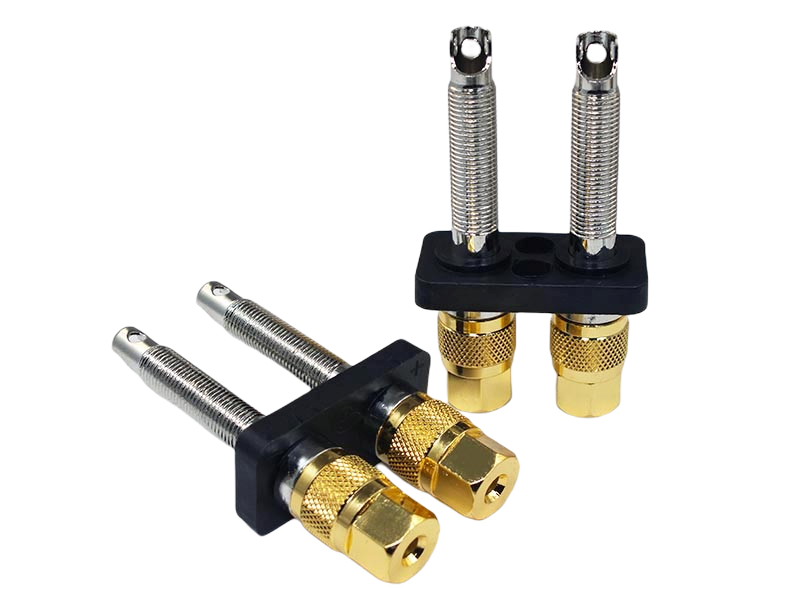

                    Binding posts, do you buy extra long? 2 or 4 of them? I usually hog out the inside of the back leaving 3/4" of material, place 4" from the bottom with with 1 1/2" spacing on center from the center line. We can mill these as well. If you have a preferred post and location let us know.
                      Sorry, I can not resist badgering in your thread........
                      Just want to make sure everyone is aware of these Cardas Terminals
                        • 16125

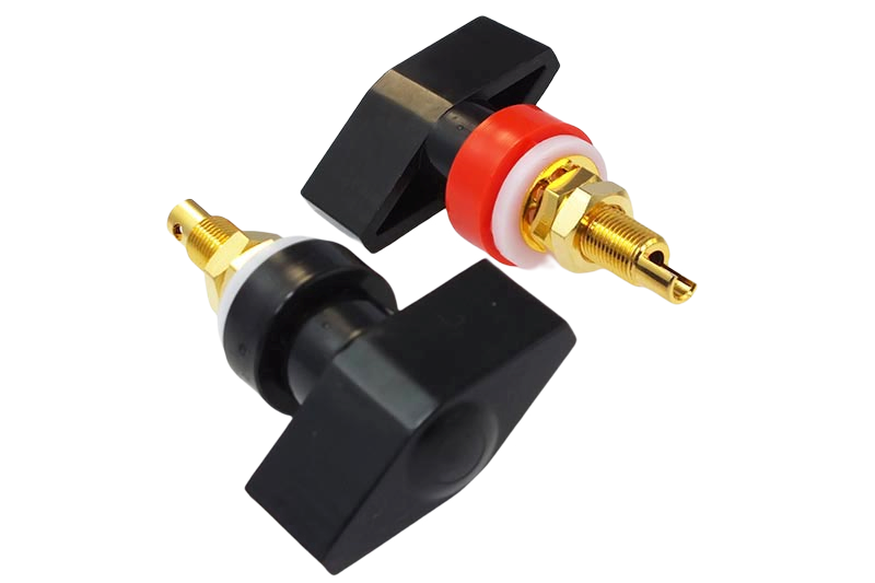

                        This really comes down to whether you want to use 3/4" spaced conventional binding posts, retaining the ability to run with 3/4" aligned dual banana plugs, or if you are mostly into spade type connectors. I've used both, but on the Isiris and Ardent I used BFBP which are super for spade lugs, having rather large handles, and not needing to use wrenches.
                        BUT, the size of the handles is such that you can't use 3/4" spacing- you need to put them wider apart. In the Isiris I used these spaced 2" apart.
                        For me, I have both normal length and long length Cardas; for speakers with 3/4" binding post centers, I normally use the latter (Cardas GCR-L ) and the full depth of the panel. I realize these are pricey for a lot of folks; Note they're about double the BFBP price!
                        And a similar set of Vampires
                        are almost as pricey ($72 for a set of two)
                        The Vampire or Cardas stuff can be had from Parts Connexion in Canada.

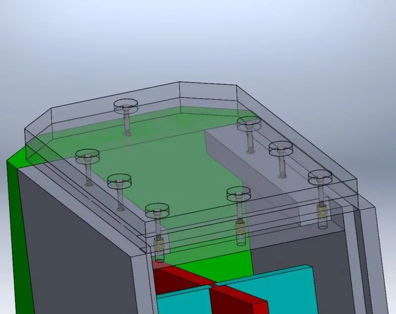

                                        I think my dad touched on most of it. In that model the grill is in contact with the baffle. I am looking at some thin felt from mcmaster.com to surround the edge of the hardboard frame where it will come in contact with the baffle. I need to open the grill up a bit so the thicker felt can rest inside. I have an idea how I'll support it but haven't drawn it yet. I've seen lots of great grills made by hand, no need for a CNC
                                        Please post up more info about those magnets I'm curious.
                                        Finally got a post up in the Ansonica thread describing the magnet configuration I'm using. The 1/4" magnet will be attached to the grill and pass ~1/2" into the baffle to mate with the 1/2" ring magnet embedded in the baffle.

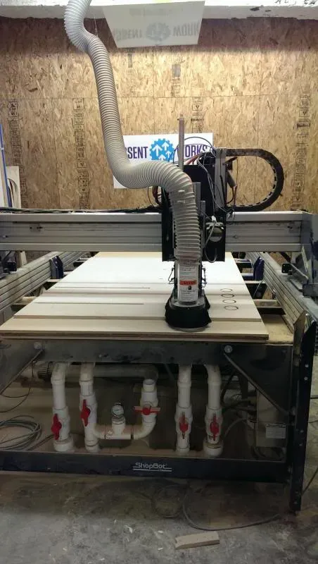

                                                  Finally an actual update!
                                                  Got all of the bracing cut and half of the Baltic baffle parts. Still waiting on the compression bits before we can cut the bamboo. It was a good learning experience and such a time saver. We could cut a full sheet of Baltic in about 15 minutes conservatively.
                                                  Here is the machine:

                                                    • 16125
                                                    Damn, now that's the way to cut speaker parts out! :T :T (that's two thumbs up!)
                                                    What's the bed size on that baby?
                                                      Ya, it makes me feel a little disheartened with all the hand work I've done making speaks. it can take a 4'x8' sheet and make parts in 15 min.
                                                      The vacuum bed is cool, it sucks the panel down right through a 1/2" MDF. You can leave a thou. and pick the parts out like those old bolsa wood toy plane parts sheets. We going to tighten the tolerances to 1/32" on the rest of the dados, it's cutting very accurate. One of my little tests was to Stack 6 baffles from different sheets on top of each other and see how they line up, again a little disheartening machine wins again. So far it's more fun then a barrow of monkey's .

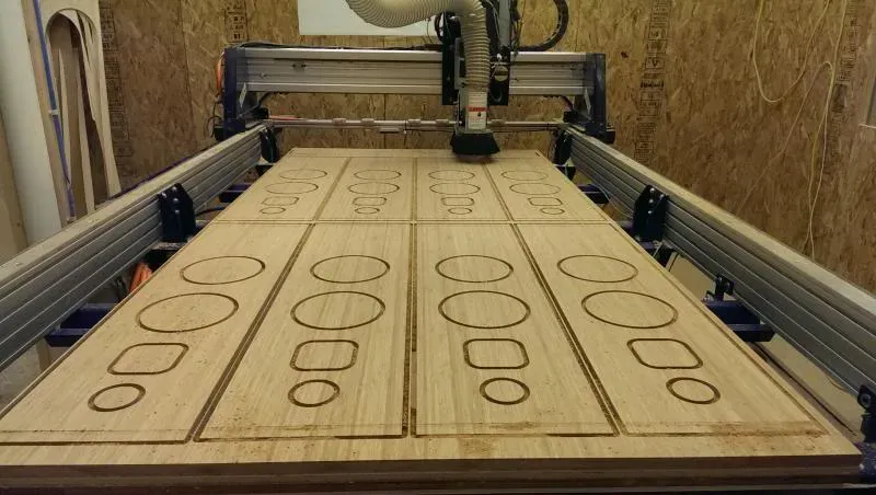

                                                          Our carbide compression bits came in today. Now we can cut the bamboo and the rest of the plywood parts with out worrying about tear out.

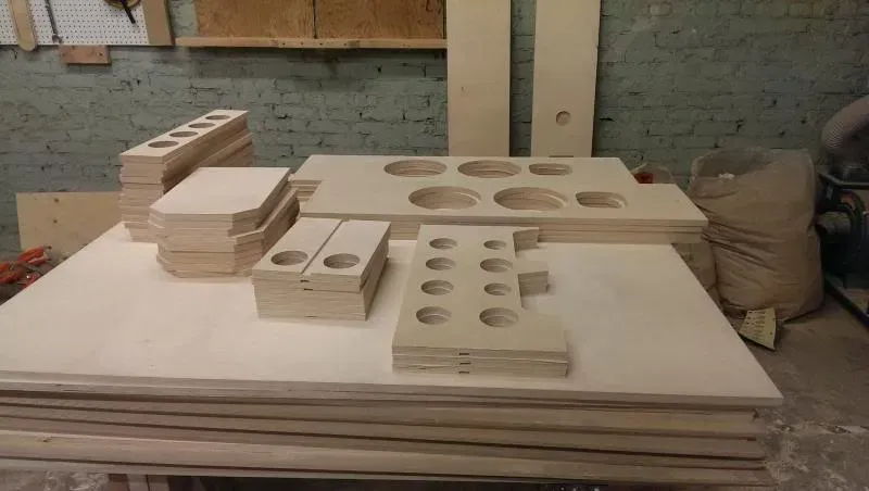

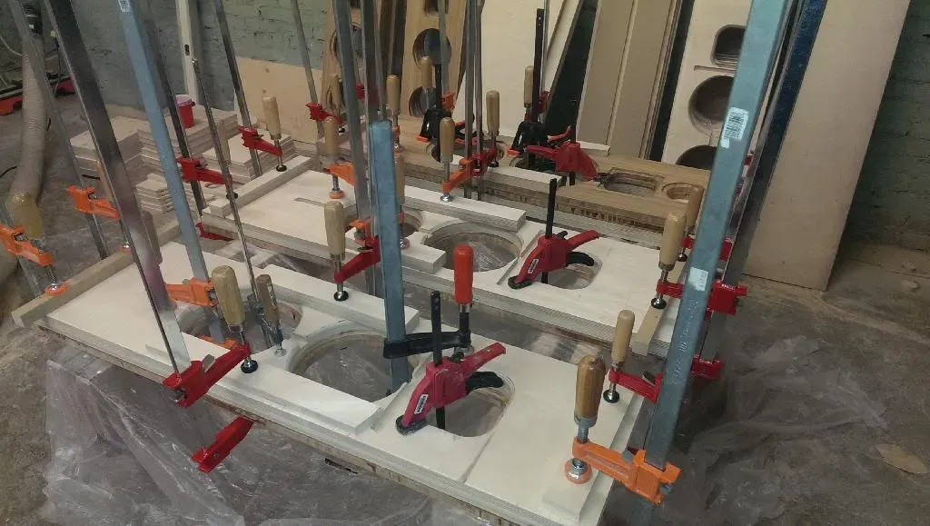

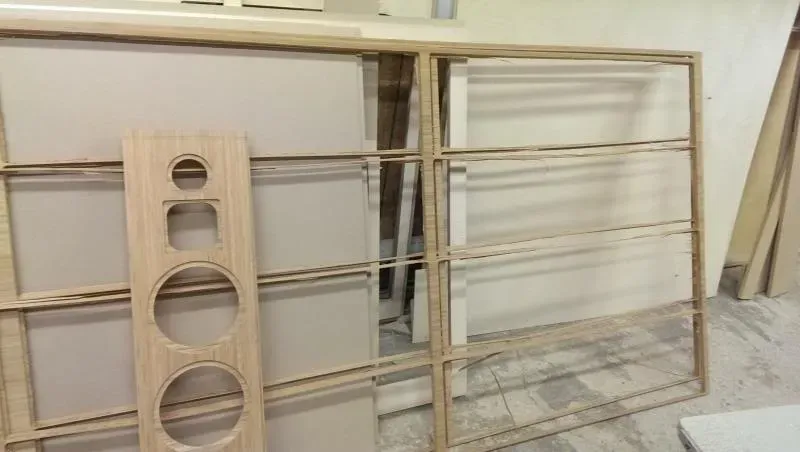

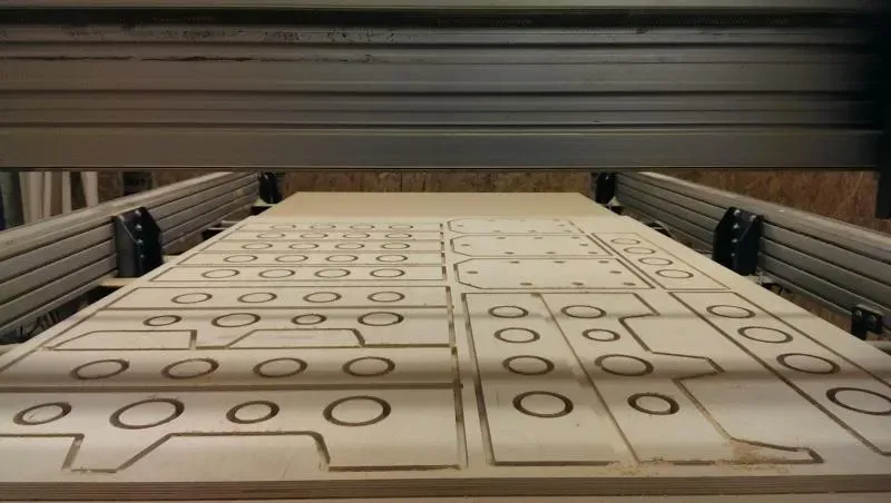

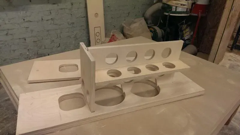

                                                              We put a long 8 hours in today. Got all of the Baltic parts cut and started on the Baltic/MDF side panels. They warped a wee bit from the .5" MDF glued on them (works the same as veneer I guess) so we couldn't use the vacuum table. Made a spoil board and screwed it down to there. The carbide only ate one screw head too haha. Speaking of carbide one of the brace panels came off the table and broke one of the nice carbide bits we waited so patiently for.
                                                              Learning lots though and having a ton of fun. Hoping to get back to it tomorrow and cut the bamboo (fingers crossed).
                                                              Test fit the bracing, fits great.

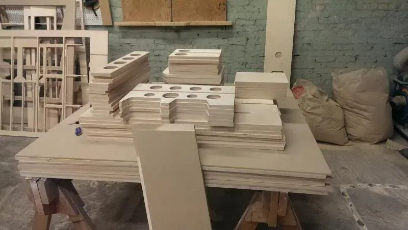

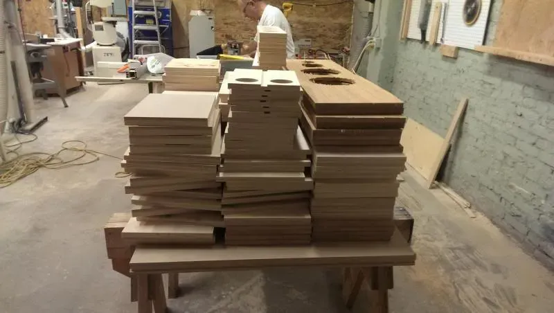

                                                                        Lots of lessons for sure. The baltic was a great learning experience so by the time we got to the bamboo this evening it was a breeze. We took 3 little test cuts (mostly because there was hardly any material to spare) and they were mostly to verify the z-axis.

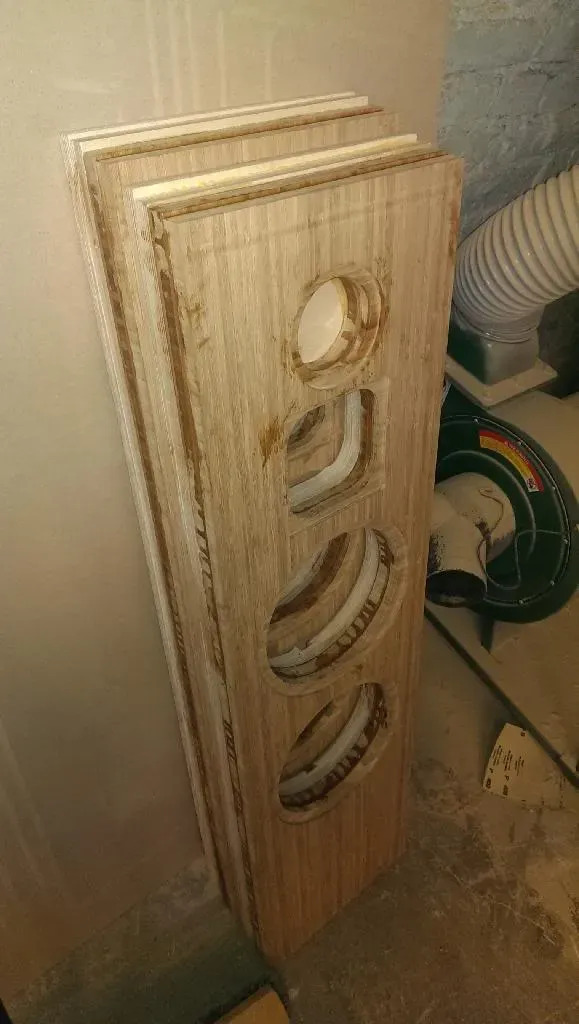

                                                                        You can see we didn't waste any space:

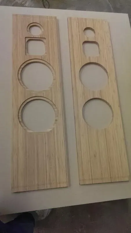

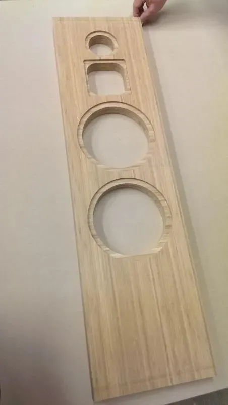

                                                                        The bamboo turned out great we ended up ditching the hardboard on the front so the pockets were adjusted to compensate:

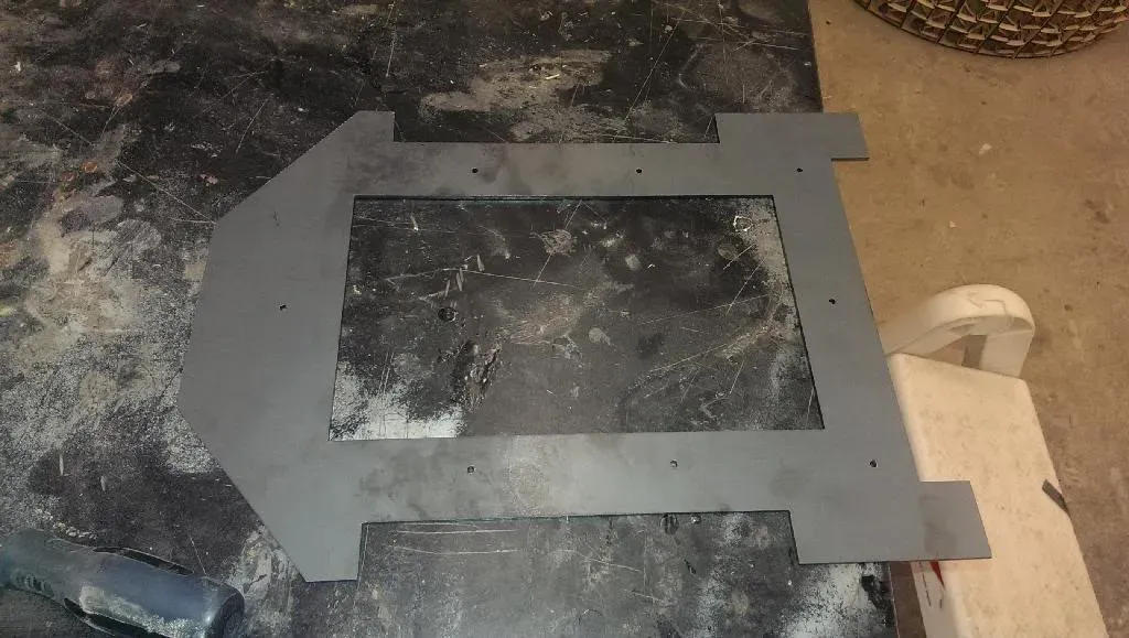

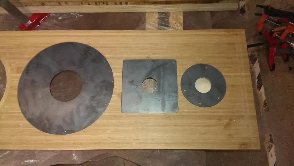

                                                                        I still need to get the material and cut the grills but essentially now the part where my dad takes over (aka actual woodworking) to add the 10 degree cuts and start gluing things up. Excited for the next bits.

                                                                              Thanks, it's been a torrid pace the last 4 days. We have all the parts except a few bottoms Ben forgot ops: Just kidding he has done a great job managing the machining and he even sourced us some epoxy after going to the only place in town, a boat supply store and seeing a sign on the door that said back January 29!. I guess it make sense, who works on boats in -30 C weather?
                                                                              Things should slow a bit as we only have 15 clamps to epoxy the baffles, never enough clamps Best part is getting to spend a lot of time with my son and seeing him obsess with the project. Ben is going to try and CNC a facet with a blank to see if it's worth while option.

                                                                                  Started gluing up the baffles. Using epoxy from these guys:
                                                                                  http://www.entropyresins.com/home
                                                                                  I always thought West Systems was nice for indoor use but this stuff blows it away. It kind of smells like pumpkin

                                                                                      Got the first 3 baffles glued up:

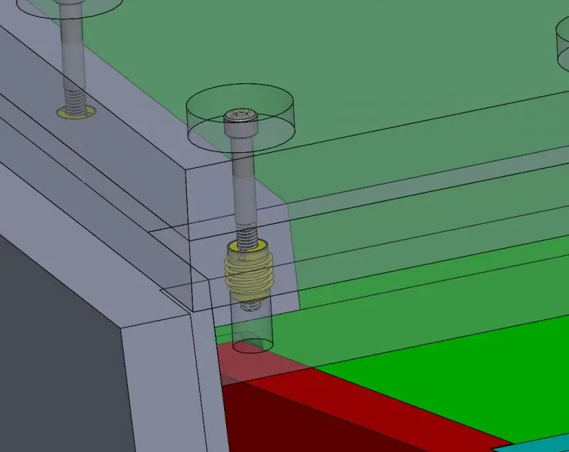

                                                                                      Since I couldn't find a boring bit that fit the collets for the machine we have to drill the speaker mounting holes by hand so I had a buddy make us up some drill guides. Was going to go all out and add drill bushings but they were 7 bucks a pop so just went with 1/8" mild. The fit made me a little less worried that we would build these things and the drivers wouldn't fit (since we don't have them yet).
                                                                                      Also made a guide for drilling the bottom cleats for the threaded inserts. Well send this one with your stuff Jon.
                                                                                      I'm going to build a fixture and test cutting the facets today on the router. If the surface finish is acceptable that's the way well go, if not I'll have to make the tooling so we can get a local cabinet maker to cut them on his panel saw.
