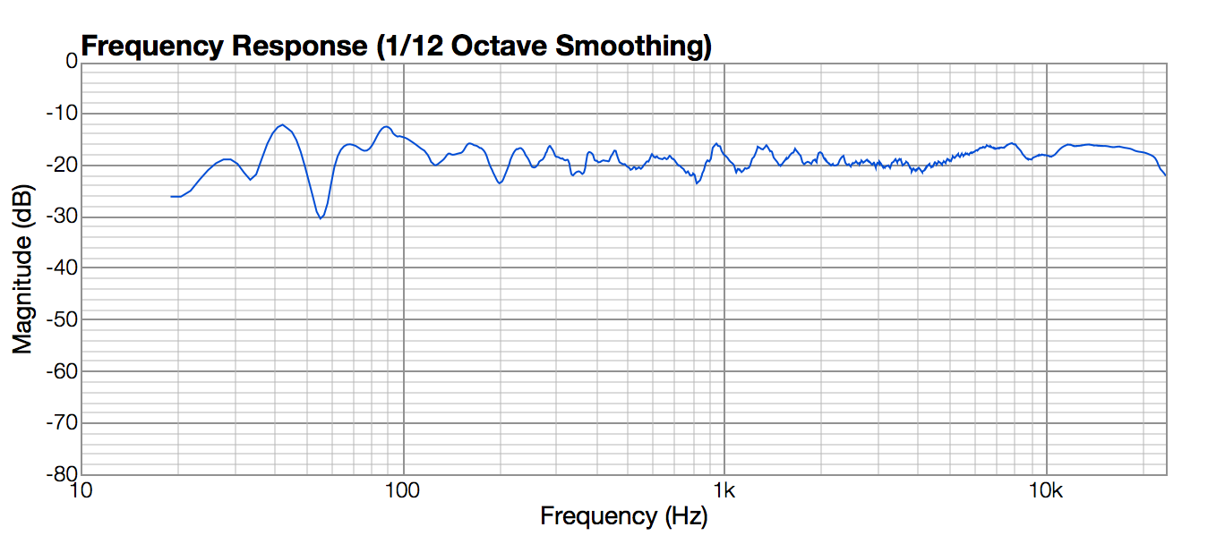

          OK, got a bit more done today... first off, the externally mounted caps on pigtails are now in the crossover box, and I upgraded the mid shunt cap from a Standard Z to a Superior Z. SO go sue me....
          Next, I reconfirmed the 1meter and 1.5 meter response with the grille on, and for grins, also with the grill off. As different as that looked, though it worth recording and posting here:
          Notice how much the response above 4 kHz changes, and the different in flatness of the range above 10 kHz.

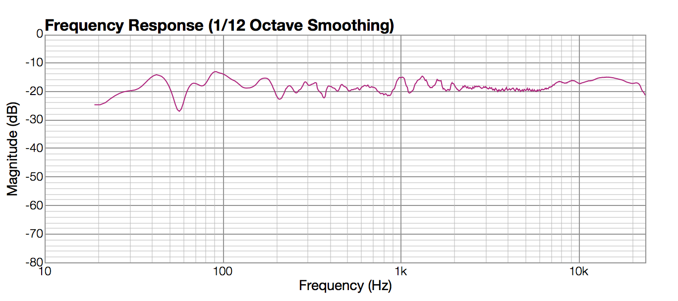

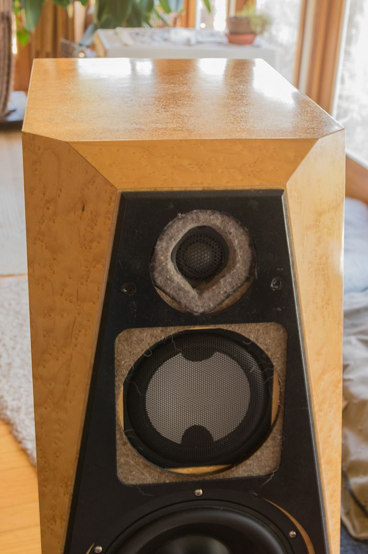

          Now here's the response with the grille panel in place, but with a new felt ring assembly cut to give a moderate size opening, but using a softer felt that I have, quite a bit softer than the material you guys had for the grill panel. The opening size was determined by gradually opening it up from a small diamond until the response curve looked smooth but minimally attenuated. I will add a picture of that to the post later, but I'm short of time right now.
          Here's what that looks like:
          This last one is with the grille cloth stretched onto the frame (I such at doing it with the screen door cord, though I was sucking less towards the end)
          This is measured at both 0 degrees and 10 degrees. We still have some rise at 0 degrees, but I think the 10 degrees looks pretty nice (15 is essentially identical) and that could probably be considered the design axis, as you'll hear that more (including in the power response) than the exact on axis response.
          And for direct comparison to the last measurement post, with 1/6 octave smoothing.

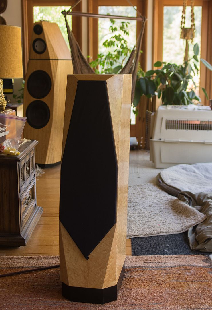

          Here's the speaker with grille- the grilles need a bit more work- :W
          If you really want to knock the top end down a bit, it can be done easily, but I like what I'm hearing here, and I didn't like the original Ardent version on the top with the "expensive" cloth dome tweeter.

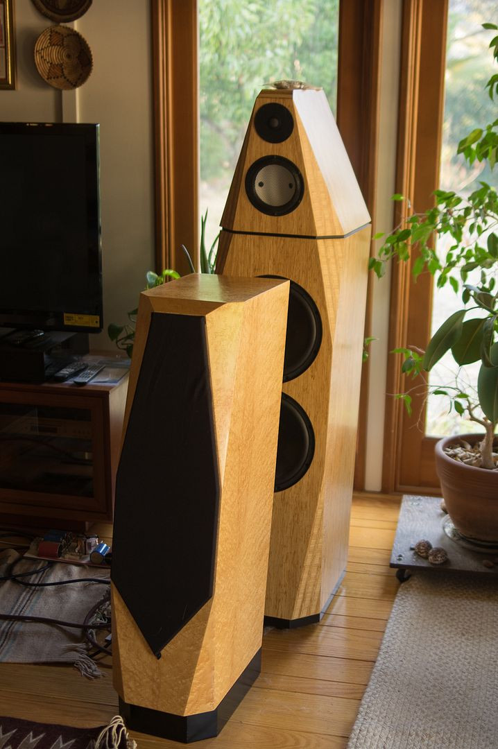

          OK, it's after dinner, and I've moved one of the Isiris back out of the way- and plugged the Ardent into the big system.
          Oh mama! :yeah: :dancenana:

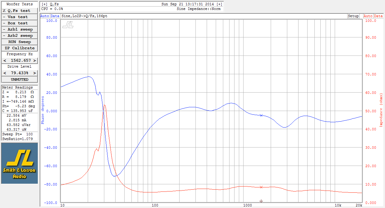

              One more bit of info I forgot to post earlier- the impedance curve. Measured it today after putting the base back together. Pretty nice, that's a good feature of the NatalieP style quasi LR3- we have to give Evil Twin a nod of thanks for that! :W Red is the magnitude, blue the phase. No special efforts to make it this nice, just how it turned out.
              NO changes in the network from what was posted above and from what your dad put a sheet together for. Tell you what, I'll give it the old Mark 1 eyeball review one more time top to bottom, then give you the "release to build".
              Listenig to some other stuff on the good old mono system, including some Courtyard Hounds "Skyline", Gloria Estefan "Conga", and Five for Fighting (in a pop mood tonight- "Superman (it's not easy)", Crowded House "Don't Dream it's Over", and David Garfield (formerly of Steeley Dan) and his solo album version of "Jose". That last one was an acid test for the first incarnation of Gen1- highs too hard, bass just didn't have the weight and slam, and voice was a bit pinched, and yet not fleshed out properly for the harmonics. Not the case here.
              Well, these may be shorter than their big brothers, but frankly, other than sheer volume capability, they don't give much if anything away to them. (sensitivity, too, of course). But an excellent set of tradeoffs. I'm quite pleased the more I hear, but I'd better not sprain my wrist patting myself on the back!

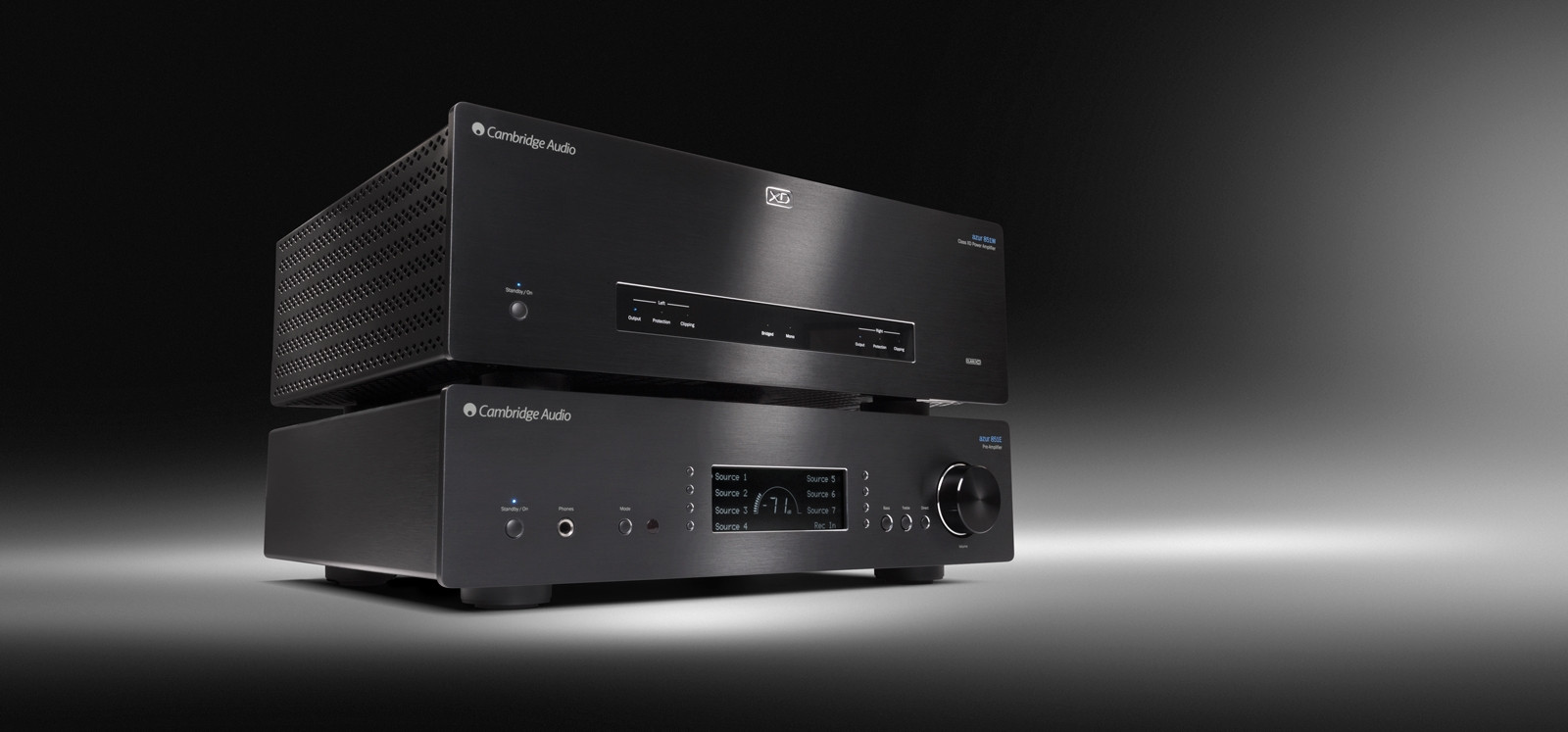

                            The Cambridge 851e did arrive today, I did just have time to unpack it, but the changes in industrial design and execution look quite nice and definitely have my interest whetted for the weekend.

                              Yeah that's sharp, I'm going to borrow some of that industrial design for my ncore build for ease of manufacture. Can't wait to hear your impressions of how it sounds.
                                #960
                                That is a very nice looking piece of equipment. 10-15 years ago I'd never have thought that CA would have gone has far as they have, but hats off to them, they've really managed to succeed in, what is, quite a difficult industry.

                                  I think they've done it the plain old fashioned way- offering a lot of value for a reasonable amount of money, and been willing to work steadily on iterating their design and manufacturing concepts.

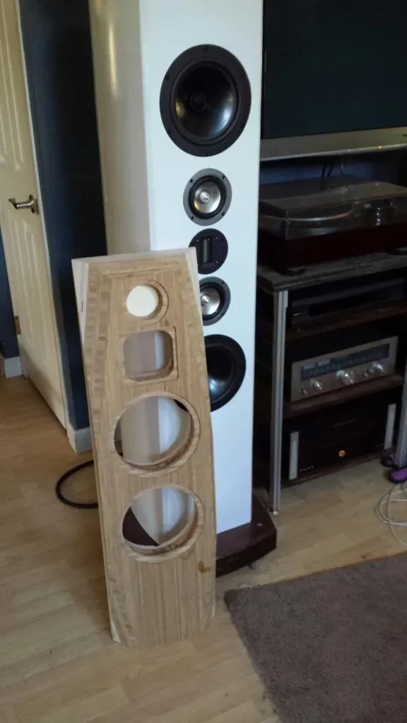

                                                      I am now the proud owner of a pair baffles, the quality and workmanship on these is top notch, I can't wait to get started on these. Hopefully my OT will continue so I can start buying all the parts.
                                                      The baffles arrived yesterday in perfect condition, the smudge in the lower right is from one of my dogs giving it the smell test, which it passed. My wife is excited to have a smaller set of speakers in the living room, compared to the statements.

                                                          Congratulations BigJohn! You know, my GF is kind of impressed with the one that's finished in her family room- as you can see, it's quite a bit more petite than the Isiris, which she calls the pair "Bonnie and Clyde". And yes, she has named the Ardents, after a pair of her friends from Canada (what could be more appropriate?), and calls them "Rob and Jeanette".
                                                          In the near future I should have more time for working up some drawings and illustrations for the new cabinet design, I've got the 2nd generation CAD files from Ben, but some things are a bit cloudy in the looking glass here, including whether I have to keep commuting to Cupertino for a while anyway- possibly until Christmas, though the development phase is over.
                                                          That will be interesting to see how you compare the two designs- the Statements are a heck of a value proposition for what they cost and the effort to build, but I'm very happy with the tonality and performance of the Ardent since implementing the Wavecor woofers in this design. It's much closer to the capabilities of an Avalon Time than the Indra, it's original inspiration.

                                                              #975
                                                              Glad they arrived in good shape! :T Ya I think your going to free up some space and gain some quality. :B
                                                              Love the way my buddy Jon, the other Jon in Winnipeg coffinized them for transport. I'm still farting around with my storage-front stage area but hope to have the rest of my parts in and installed for the end of November so I'll give you my impression between the Ardents and Statements, although it's been a while since I have heard the statements. Keep us posted when you manage to get started.
                                                                        Thanks Jon, I'm excited to build these and compare them to my statements, I agree that they are quite good for the money and I plan on keeping them and when we build a new house here in the next few years i plan on building the statements II center and 2 more full size statements to use as surrounds, I know this is total overkill, but I have most of the drivers and it seems fun.
                                                                        The Ardents will be my main music speakers and probably get the most use.
                                                                        I'm glad they arrived safe too, and thank you again for helping facilitate this, I was a little worried by just the shear weight of the coffin, but when arrived the coffin didn't have a scratch on it. The coffin they is built like a tank, in fact I'm keeping them in it until I can find the time to build the new boxes. I'm very interested in your impression of them vs. the statements, I believe the statements will hold there own, but the ardents will win out.

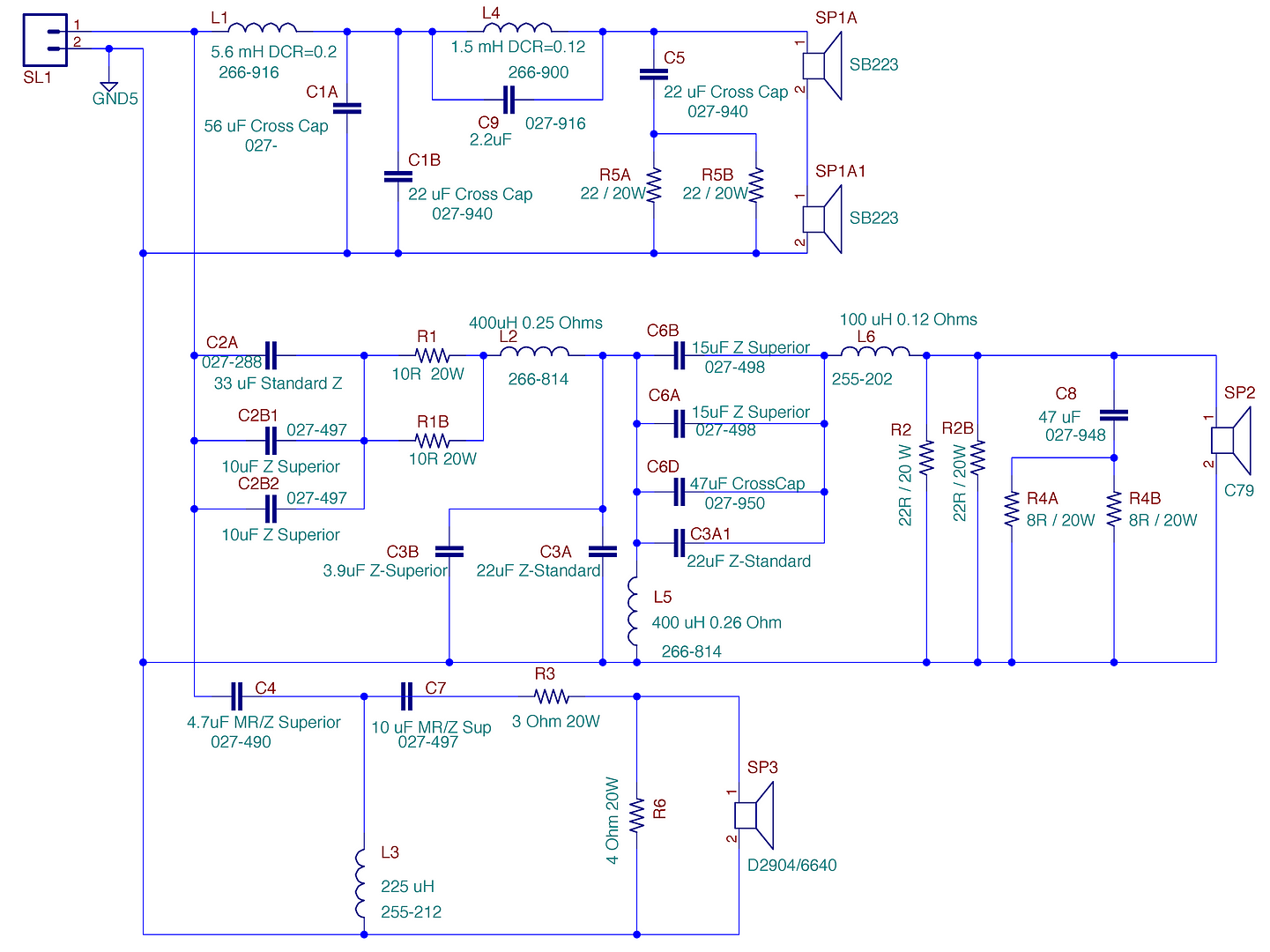

                                                                              DSL went down at GF's early this morning, and is still down as of 12:30 PM, even after talking to AT&T some hours ago- now they're pitching that she needs to get UVERSE because they really aren't supporting DSL anymore...
                                                                              Anyway, I'm at Starbucks for a little sandwich and to post this; this is the actual schematic as built- but keep in mind, though some parts are different, the net electrical values are in most cases the same or nearly the same- I made some substitutions because of what was on hand and because of form factor (how to squeeze 7 gallons into a 5 gallon can, you know....

                                                                              And now I see one of the parts in the second series pass cluster is mislabelled as regards designator, being called C3A1 instead of having been updated to C6B. Main parts affected are C1, C3, and C6. Any combination that adds up to the same total can be used- I mixed quality levels on the mid series pass. Resistors are all 20W Mundorf. My current favorites.

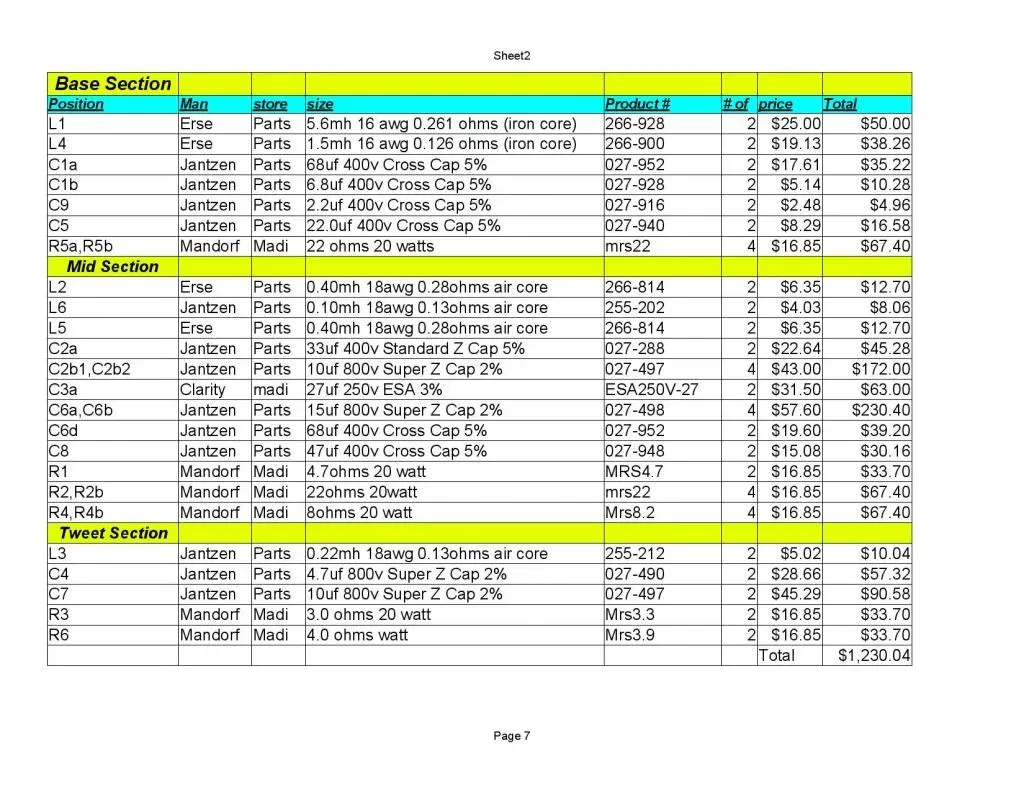

                                                                                I just got back from the mountains but just wondering if the above lines up ok with the BOM?
                                                                                Really appreciate all the work in a hot house.:T I'm glad your liking the sound and it will be interesting how you rant these when your done stereo pair.
                                                                                I think i'm going with the Jantzen super Z option for mid and tweet. I did add 27uf ESA for C3a, cheaper then last xo with 2 parts but more then the SA slightly.
                                                                                Here my bill just xover without taxes and shipping. Still need to add the mids and some small what knots. Ben considering the $300. hit for the MR's though. Haha.
                                                                                Click image for larger version  Name:	ArdentXoverBill-page-007.webp Views:	20 Size:	104.7 KB ID:	934507
                                                                                We will save on multiple item pricing ordering together and just 1 shipping cost so all is good.

                                                                                  #985
                                                                                  Okay, here is an updated one. This has the C3A1 (or could be called C6c) changed and I added your MR caps in the tweet. Jon still has to call this the final production model though.
