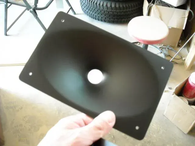

    These two unlikely driver mates can work quite well together if you add in one more ingredient: a wave guide. I have so wanted to use the XT25 with a wave guide because it seems to like them. One man who made wave guides more reasonable to use is Dave Pellegrene. His website is located at:
    acoustic waveguides
    I chose the 8x5 unit for limited vertical but excellent improved horizontal dispersion although I hear no drop in highs standing up as I did with the bare XT25. Horizontal dispersion is wall to wall. I lived with the XT25 for quite some time. Its night and day.

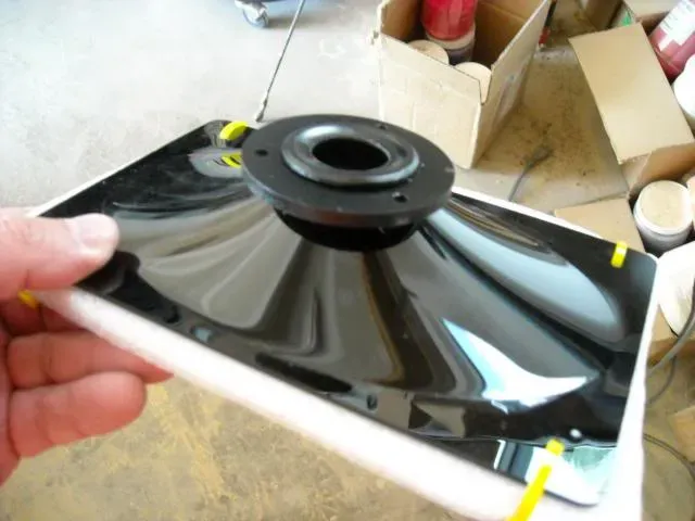

    The rear mounting plate that Dave makes which makes it so easy.

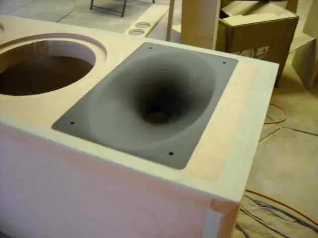

    The tweeter with its faceplate removed with the Dave supplied studs to bolt up the guide. Make sure you get studs that bottom out in the tweeter body or you will have the stud turn as you try to tighten the nut. You can use loc-tite on the studs if they arent bottomed out but you have to wait for that to cure before you try to tighten nuts on them. Dave sent me out longer ones when I brought the problem to his attention. He was great to deal with.
    All together and a little bit of sealant to assure an airtight fit. I know I have one because its a sealed box with movement on one mid bass as I push the other. This is essentially now a $70 tweeter with industry leading dispersion and low disrtion on the low end. The tweeter is 35 as is the wave guide. Its worth every penny.

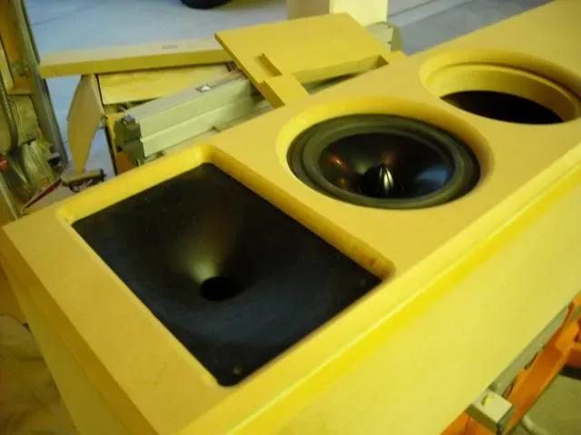

    Trial fit for counter sinking and here you see my grills that have cutouts for the drivers just behind them. The grills are not very invasive on the sound. I can't hear a difference.

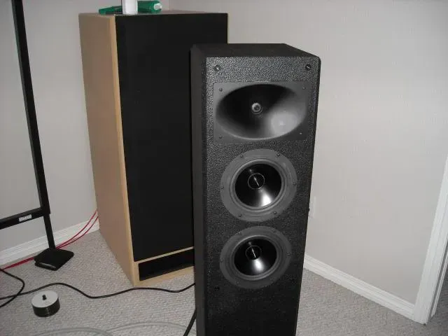

    Drivers mounted in finished cabinets

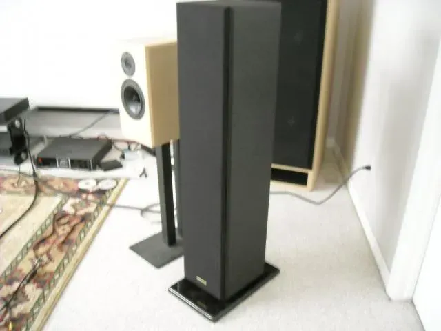

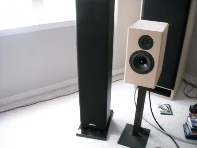

    Complete with grills on. I had name plates made up for them. I named my 'speaker company' when I was 12...Axis. Do they look stare bought? Go easy on me.

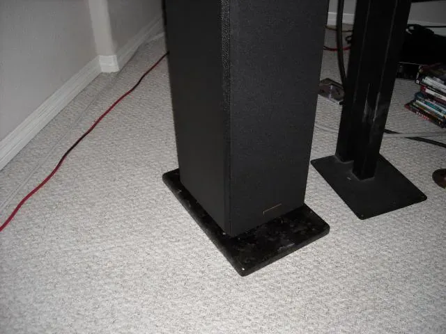

    Granite bases:

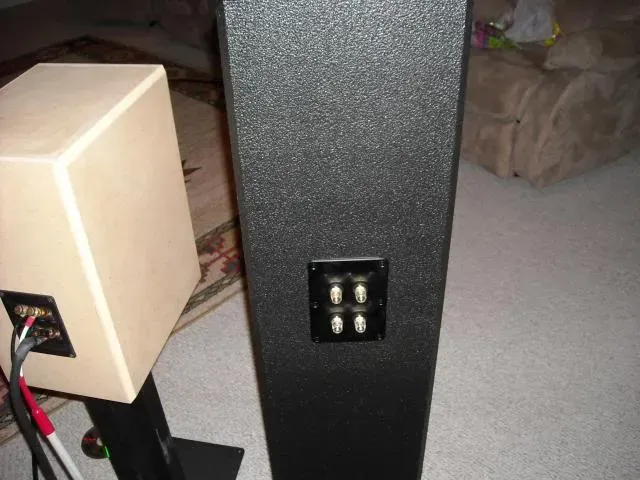

    Rear shot showing seamless edges. This was the side with all the seams. Once primered, you cant tell its a seam. The trench method works.

    Sound: The tweeter dispersion is unreal. The sweet spot is anywhere in the room for highs. It doesn’t seem to roll off even at 60 degrees off axis. Standing anywhere in the room is the same too. Height doesn’t seem to affect dispersion in my application. I have 600 watts for the tweeters. It used to fry the bare XT25 at 2K LR4. Now I see clip lights at 1700hz LR4. Even at 1500hz, theres no strain. The cap filters quite a bit. I figure its 10db headroom since thats the boost from the WG.
