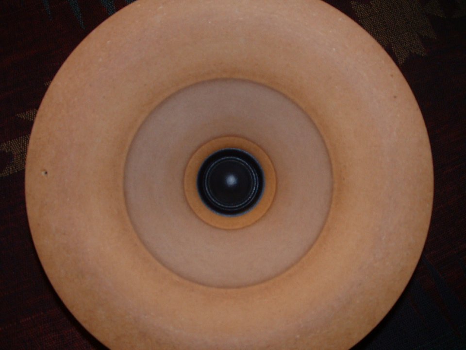

    Hi all,
    I have been working with EdL (thanks Ed) for the last couple weeks in preparing to measure some DIY WGs for use with non-compression drivers. That is, the tweeters will be standard off-the-shelf dome tweeters. Ed has turned some examples and sent them to me. Soon I will be doing some measurements (I have to go out of town for work). The measurements and related WG profiles will be posted as done.
    We are currently shooting for a guide to match the RS 180 7" Dayton MidWoofer. The principle idea being to control the sound field to match the RS 180 at crossover and to provide low end boost so that the crossover can be below 1200 Hz without heroic crossover designs.
    At this stage of the game we are still not certain where a good foundation would be for a base line WG to compare results against. Since there are many of you out there that have seen and heard (and hopfully measured :T ) Genelec, Amphion, SP Tech, or other fine high quality WGs for dome tweeters, we are asking for some help.
    So, has anyone out there physically measured any commercially successful Wave Guides for dome tweeters or have a well founded opinion of how they should be shaped and sized?
    From looking at pictures of commercial WGs (and seeing the SP Tech speakers but not measuring them) it seems that basic dimensions for RS 180 use might be 7" to 7.5" mouth diameter, throat to match the tweeter used, and a conical flair rate of perhaps 100 deg (more? less?) total included interior angle for the Guide.
    Can anyone confirm or deny these basic assumptions?
    How about measured round-over radius at mouth and throat?
    Does anyone have any actual physical measurements?
    If you have taken physical measurements or acoustical measurements, please describe what it was you measured. Right now Zaph has the only data I am aware of. Great work Zaph! :T
    If you wish to provide an opinion, please give a commercially successful example product that uses a standard dome tweeter and solid support (perhaps acoustic measurements?) for the opinion.
    BTW we do not intend to clone someone else's work. But we would like to start at a good point and develop what we feel works for us.
    We hope that with a little help from our friends we can find and deliver some useful data for our own projects and for the DIY community. Hope you can help.
    Thanks everybody :T
    P.S.
    Attached is a pic of one of the WG's we are working on. It is sporting a Vifa silk dome. Can't wait to measure it!

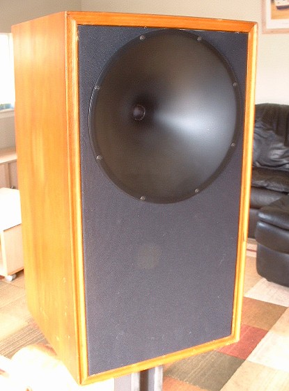

        My take on the Waveguide:
        modified 12" EV woofer with a Peerless soft dome and the 12" steelsound waveguide in a ~2 cu ft sealed box. The woofer crossover has one coil and a notch filter, the tweeter has a resistor and a 1uF cap. Crossover is around 1000Hz.
        Have a couple of 1/3 octave measurement only. It is quite flat in the 400-20k band. It needs BSC below 400 and starts to roll off at 50 Hz. With an additional 2 cuft "backpack, it starts to roll off in the 30s.
        Dispersion is well controlled on and off axle, vertical and horizontal.
        BSC and Linkwitz transformation is done in the digital domain. With the LT it is good down to ~25Hz.
        I did not hear any difference with changing the throat interface or using Geddes like foam plug ( and equalization), but I have a very different opinion on diffraction than Mr Geddes.

          Hi Frank,
          Very cool! I didn't know you were working on such a project. I had given some thought to putting something similar together after visiting Dr. Geddes. I was thinking a 12" or 10" woofer and WG might be a bit better, especially when used with a seperate sub.
          Curious, what is your opinion on diffraction? You tried the foam insert? Are these being used in your downstairs system?

            Josh,
            Yes, I use 10 or 12 of them downstairs. I did not like the separate subs (2 * 18" BTW) rather went for the LT.
            I've tied to file the vaveguide throat to differents diameter and profiles but I did not hear any difference when level ard FR matched.
            Tried the foam plug with the necessary FR correction, but also did not hear difference, but I did not use compression drivers
            My opinion on diffraction is that many are happening at the live event too ( musicans, instruments, chairs, scores, seats around you in the audience, the audience itself etc). They are not "disturbing" the perception, rather merge with the ambience.
            In a correct reproduction chain additional diffraction and the possibly low level of the listening room ambience should merge with the ambient trail of the reproduction. This should cause no bigger difference than wether the next seat to you is empty or not on a live event.

                                                      I have used the Finnish Chorus waveguides Ergo mentioned. Their flare seems rather similar to the flare of Genelec 1031 studio monitor waveguides. Unfortunately they weren't available seperately anymore last time I checked.
                                                      One guy on a German DIY forum ("Marvin") did some 3D modelling of these:
                                                      I started a thread about my experiments here:
                                                      In diesem Thread möchte ich den Stück für Stück den Werdegang meines großen Vorhabens, den Selbstbau eines über den größten Teil seines Übertragungsb
                                                      I have used these waveguides together with Seas 27TDC and modified Vifa D25AG35 tweeters. There are more measurements with different tweeters but the same waveguides here:
                                                      Mein Bruder und ich haben heute etwas Zeit gefunden und drei verschiedene Hochtöner (Seas NoFerro550, Vifa XT19SD, Seas NoFerro12) an Elefantino´s Wa
                                                      Monacor sells a very cheap plastic horn for their DT-300 tweeters which can be modified (i.e. shorted) for waveguide use with other tweeters as well. You will also find measurements for these in the first thread above.
                                                      I hope you can make some sense of these threads despite the language. I'm sorry that I don't have the time to do an extensive translation.

                                                          Hi AJ,
                                                          I saw your project a while ago (on Madisound board?) and I could have bet your work was worth the trouble. Why did you cease development? Weren't you satisfied with the result?
                                                          All of my measurements (and Thanner's too) were done with the compact Finnish waveguides that are provided with Chorus speaker kits. You can find some images of these at http://www.chorus.fi . Personally I don't have any experience with the Monacor horns yet.
                                                          I think these shallow Finnish waveguides are optimised for directivity control. Lower frequency boost slowly decreases from 2k to lower frequencies. I would not use them for crossovers below 1.5k.
                                                          I forgot to give you the basic poperties of the waveguides:
                                                          mouth diameter 130 mm (plus 2*5 mm flange)
                                                          throat diameter 38 mm
                                                          depth 22 mm
                                                          transition from throat to mouth could be best described as nearly constant circle segment
                                                          Hope this helps.

                                                                      • AJINFLA
                                                                        • 682
                                                                        AJ I hope you realize that your speakers are missing a tweeter...
                                                                        Whew...found it! Had me going there for a second Cotdt... :spin:
                                                                        Andrew's old handiwork.
                                                                        Cheers,
                                                                        AJ
                                                                        Last edited by theSven; 30 July 2023, 13:48 Sunday. Reason: Remove broken image link
                                                                        Manufacturer
                                                                        • cotdt
                                                                          • 393
                                                                          omg... is that what I think it is? How did you do that? pretty amazing...
