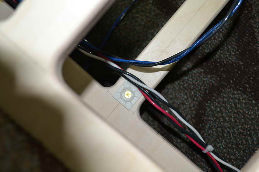

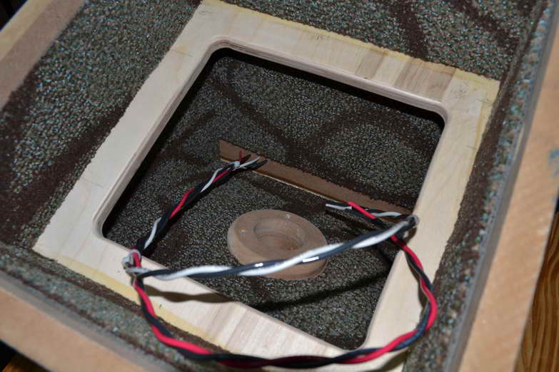

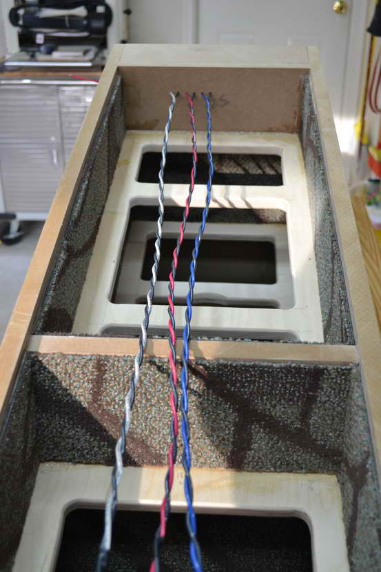

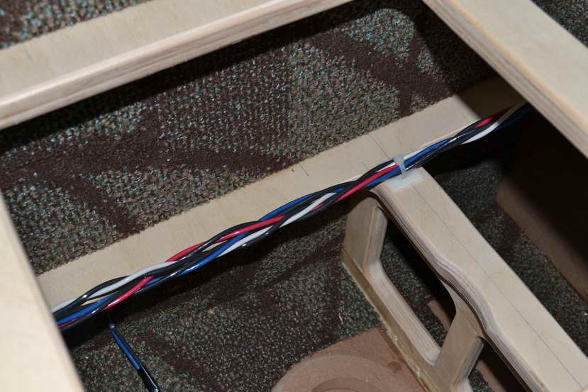

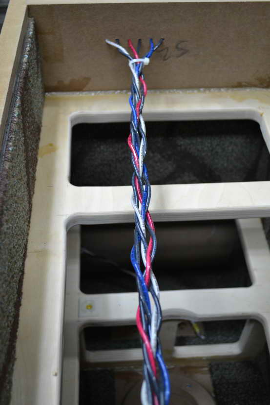

      Cabinet Wiring
      Getting the cabinets wired up before the baffles get glued in placed ....
      Not that pretty stuff that Jon is using in his cabinets, I do love how that Kimber stuff looks ...... but I think this should work ...

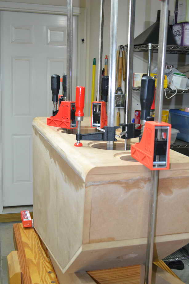

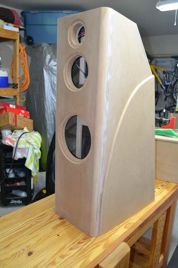

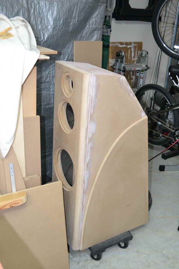

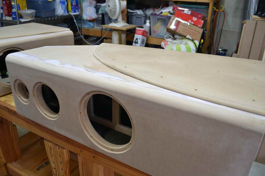

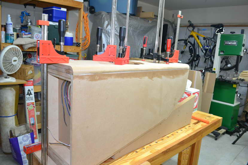

                  A little update from right before the holidays ...... Gluing the baffles in place now that the wiring is all done.

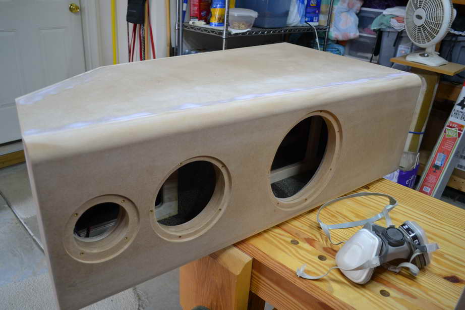

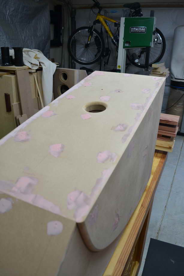

                  And now for the "fun" part ...... filling in the defects with bondo and sanding, getting ready for the side cladding's.

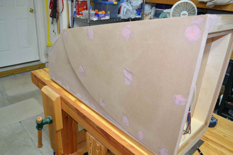

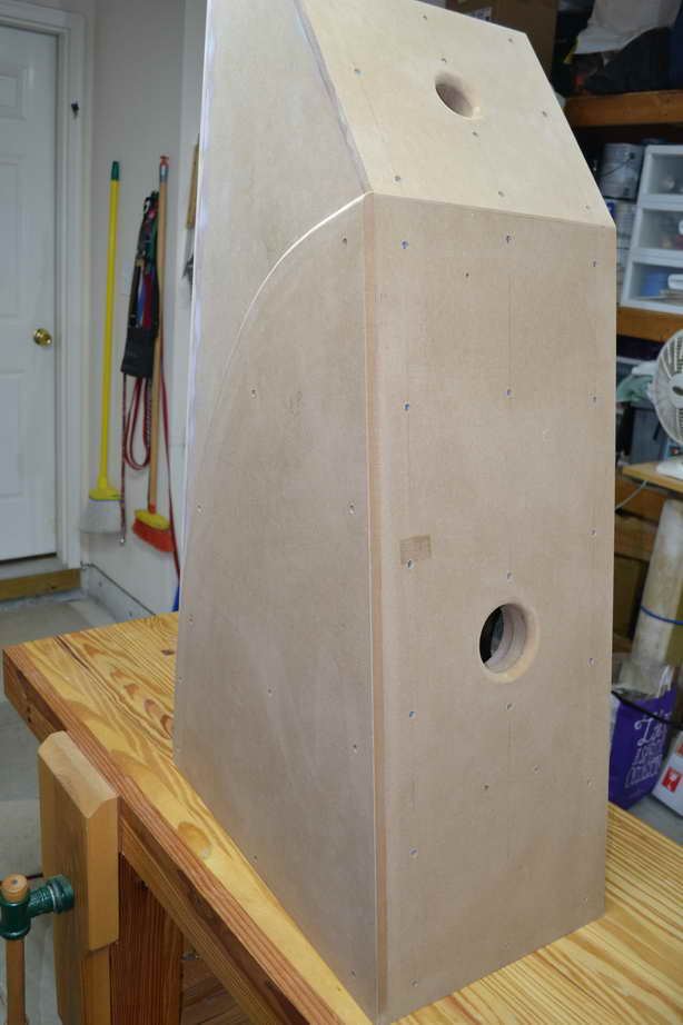

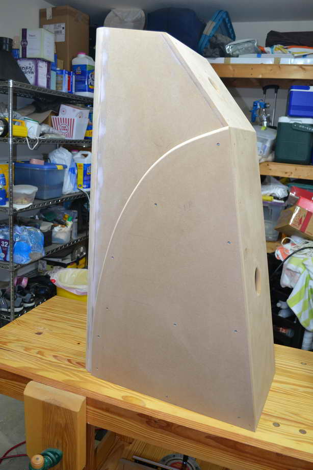

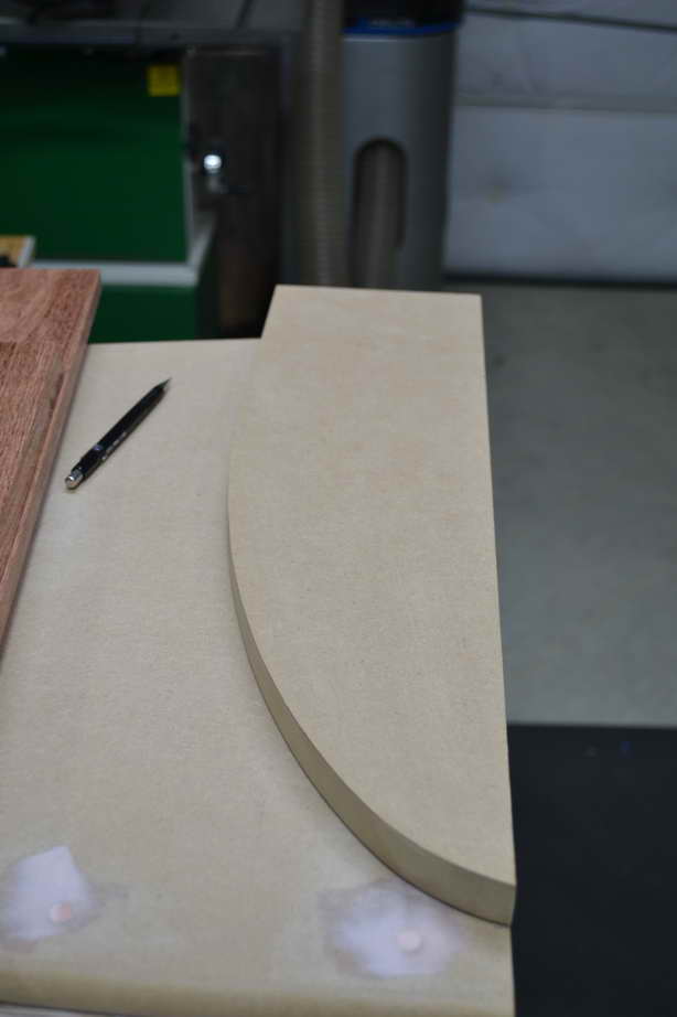

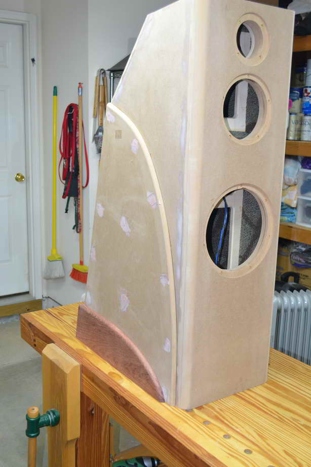

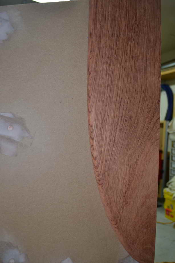

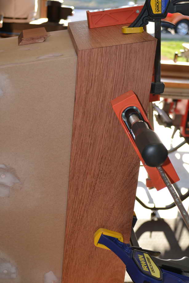

                    A few more ..... glued and screwed one of the side cladding's in place on each speaker .... prior to flush trimming with cabinet.
                    A few after trimming ....

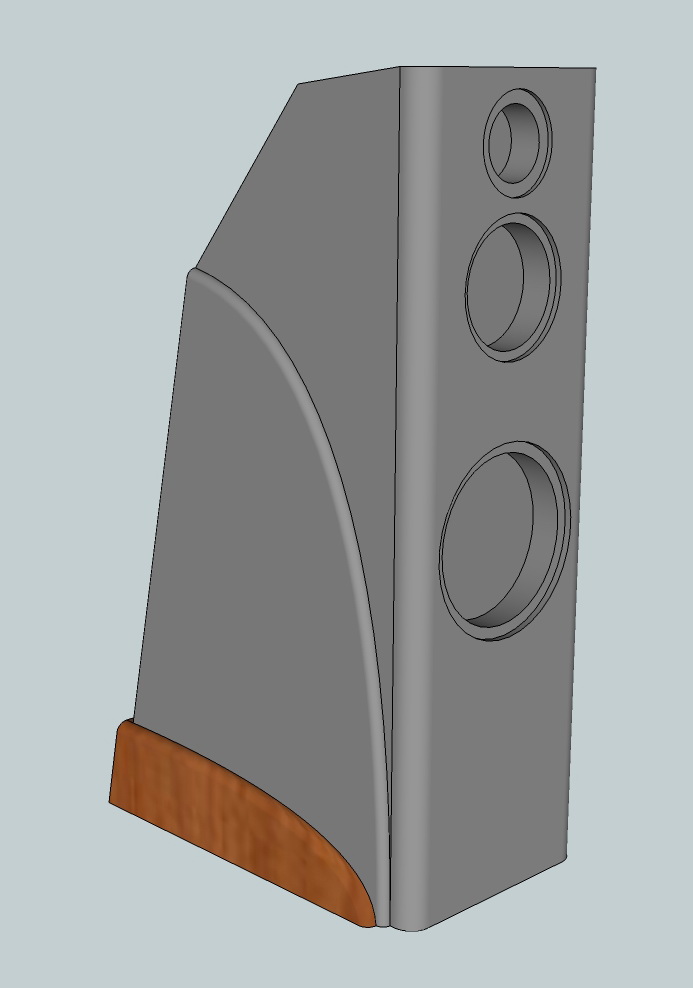

                        Click image for larger version  Name:	Overall Look 2.jpg Views:	2648 Size:	53.8 KB ID:	857924
                        Click image for larger version  Name:	Overall Look 3a.jpg Views:	2706 Size:	36.0 KB ID:	857925
                        Last edited by theSven; 16 May 2023, 09:24 Tuesday. Reason: Update image location and quote
                          #102
                          If I were doing that, I'd be bolting it in place - but I'd also be giving it a bit of a recess to sit in so a little bit of warp down the road isn't an issue.
                          Looking amazing, and I'm sure you'll figure it out in.

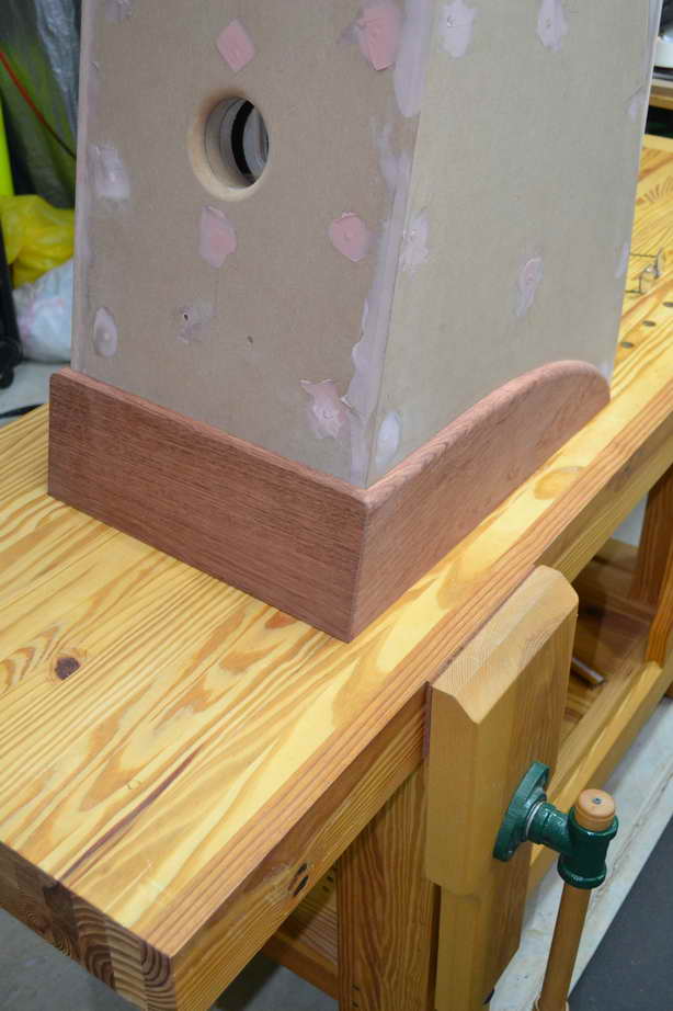

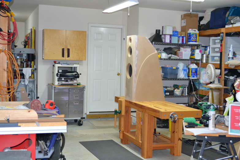

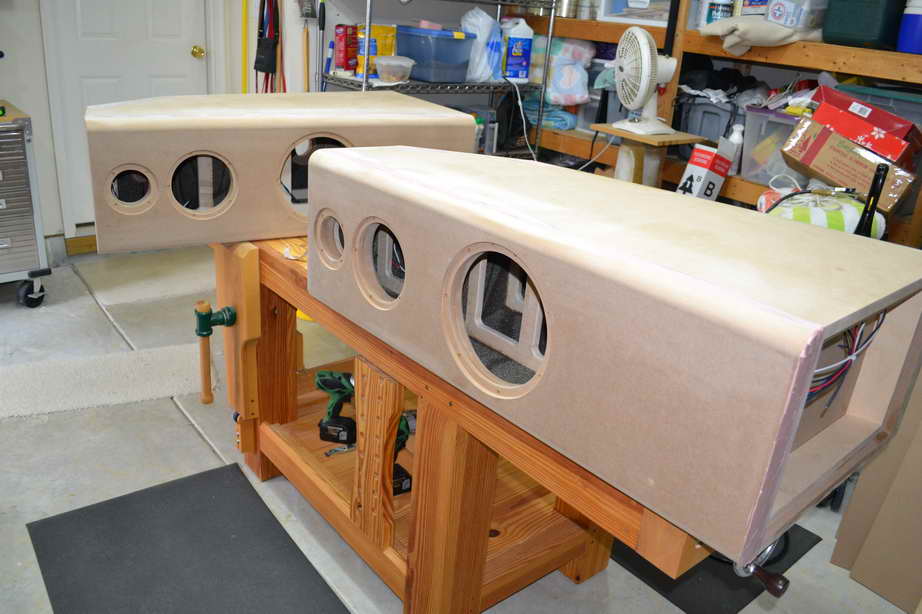

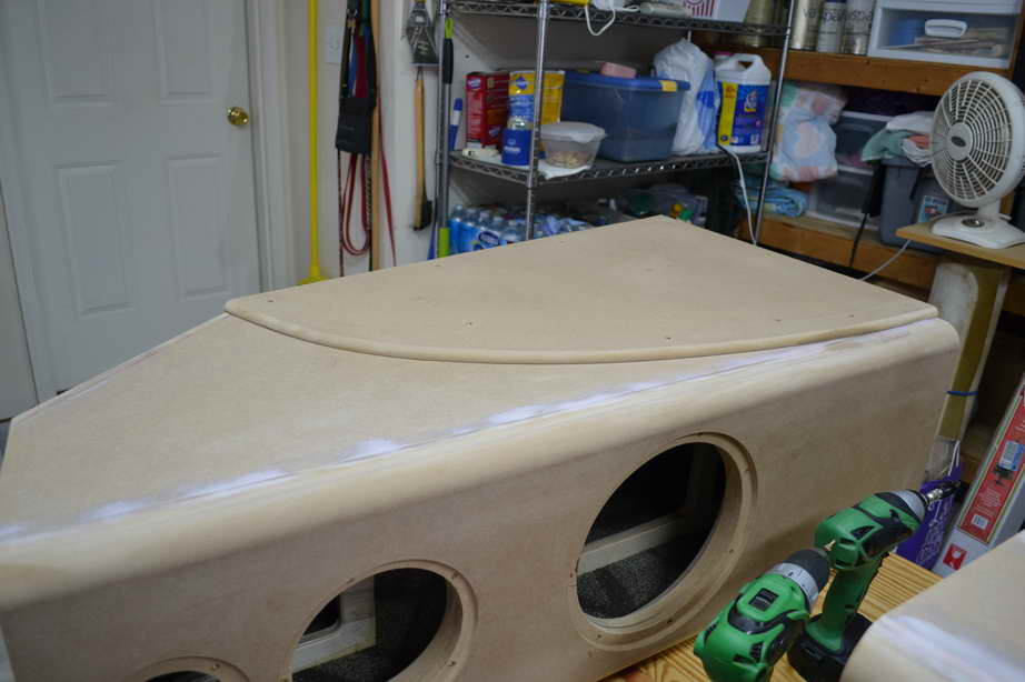

                            Finally got back in the garage after the holidays and got a little work done. Felt good to be making some progress again even if it was filling screw holes with bondo .....
                            Getting the cabinets on and off the work bench is now a two person operation. Not sure what they way, but trying to get them on and off the bench by myself is out of the question.

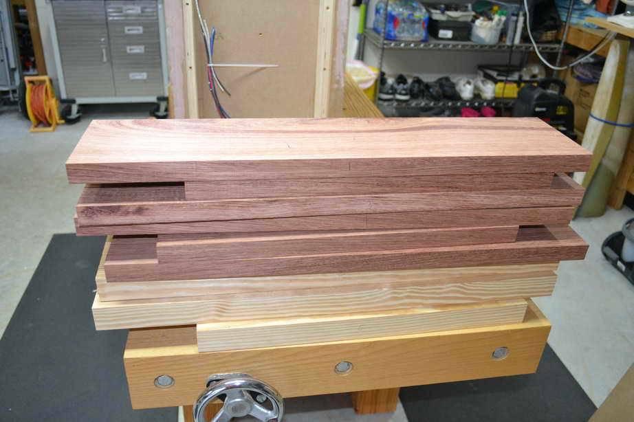

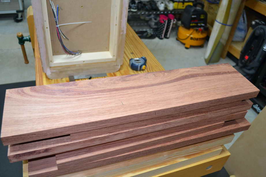

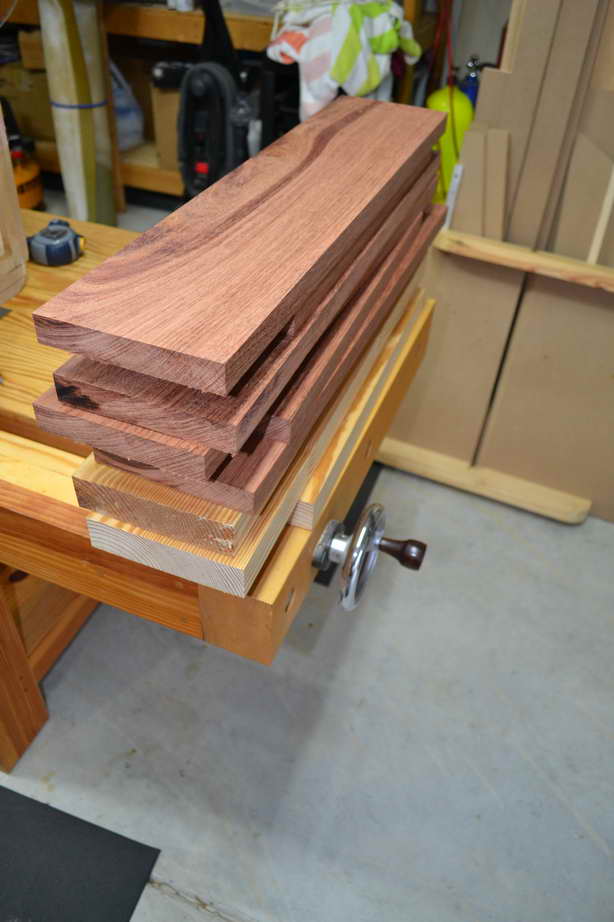

                              Did manage to make some sawdust today though ...... started sizing the bubinga for the trim around the bottom of the cabinets.
                              The SYP is for test pieces, had some left over from building the bench. Since I'm joining the corners with 45 degree Lock Miter joint on a 12 degree angle, I figured it might be good to make a few practice runs at it first.

                                Point of no return? NO returning them to the bench by yourself? Do you have a weight? :W
                                I'm close to that point- 118 lb for the bass modules is up there, but still doable- with 35 lb from the empty upper module, that will cross the line. I'm dreading gluing them together, and will likely put that off until I have them over at GF's just before lacquer booth time.

                                  #106
                                  Not sure on the weight, I'm planing on borrowing the heavy duty scales we have at work and get a number, my guess is somewhere north of a 100 lbs. At this point I can pick them up and position them around on the dollies but I'm afraid of damaging them trying to get them on and off the bench ..... as well as potentially my back in the process. One of the joys of getting old I guess.

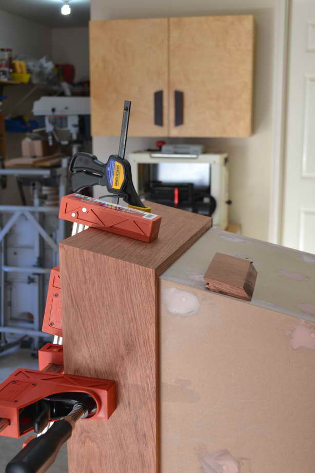

                                                              • 2140
                                                              #120

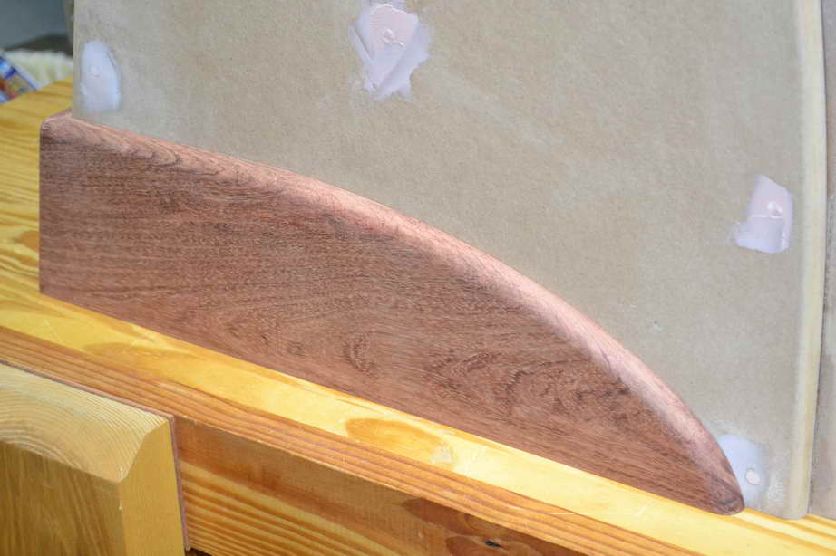

                                                              "Best laid plans of mice and men ..."

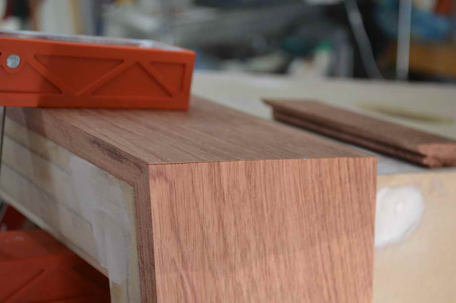

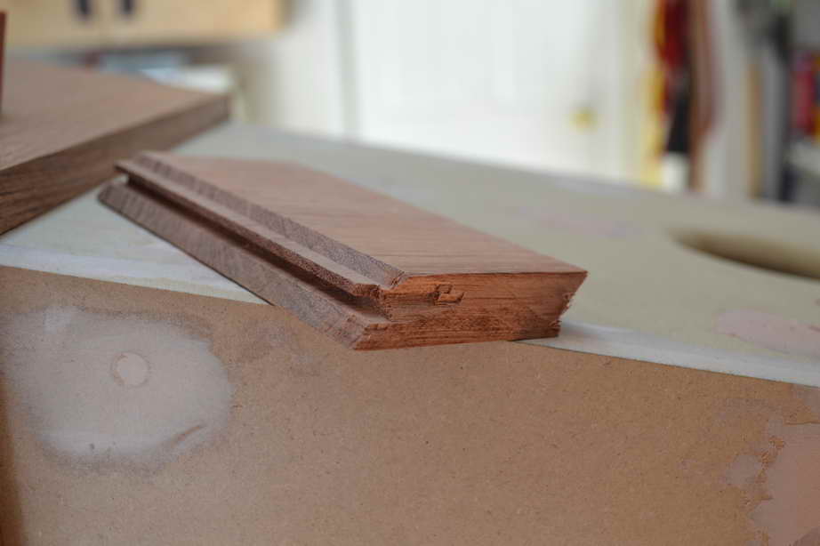

                                                              Got some nice weather to open up the garage and work on the trim for the cabinets. The plan I had for joining the trim at the corners did not go as planned. Between test lumber twisting, first time working with bubinga (hard as nails), first time using a miter lock bit on the router and compound angles, my butt was promptly handed to me over the course of the morning.
                                                              After a lunch break I decided to punt and go with a "straight forward", yeah right, compound 45 degree joints. Had a little better success with that, though the bubinga put up a fight being so hard. May need a little putty in the corners but not too bad. I ran across a good video on matching putty colors that I will post in the Woodworking Tips thread.
                                                              Here is some of the fun I had ..... this was after taping a piece of scrap to the edge for run off in hopes of stopping splitting, appears not to have worked !!

                                                                          One down, one to go .....
                                                                          After the dry fit looked good I went ahead and made a template and got things rough cut,flush trimmed, and then glued up.
                                                                          Putting the round over on the edge was a major pucker factor with how the bubinga was chipping. I decided to stop the trim short of the ends and shaped the remainder by hand, which worked pretty well.
                                                                          I'm really liking how the grain looks even with just some rough sanding. Can't wait to see it with a clear coat on it .....
                                                                            #127
                                                                            You're hiding that on the back?!
                                                                            That looks incredible. Very nice work. Can't wait to see the rest shape up.
                                                                              • 16175
                                                                              #128
                                                                              Looking very good, Steve- yes, roundovers on hardwood can be a real pucker factor operation- the only thing that works for me is multiple passes with gradual depth increases and tool bit changes in radius. A little good hand work goes a long way...
                                                                                • 2140
                                                                                #129
                                                                                Thanks cjd ..... your right, it does seem to be a waste having that beautiful wood hiding doesn't it. When I worked the initial design out it just seemed to look better rather than just on the sides.
                                                                                  • 2140
                                                                                  #130
                                                                                  Thanks Jon ...... I did the multiple pass thing and this stuff still wanted to chip close to the ends, so files and sand paper seemed to be the route to go. Did not think about changing radius size though.
