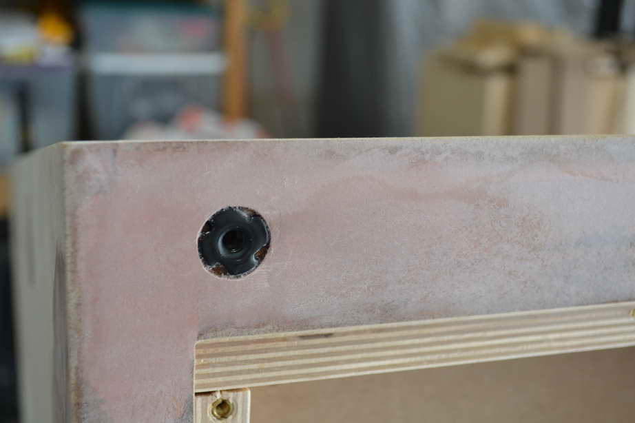

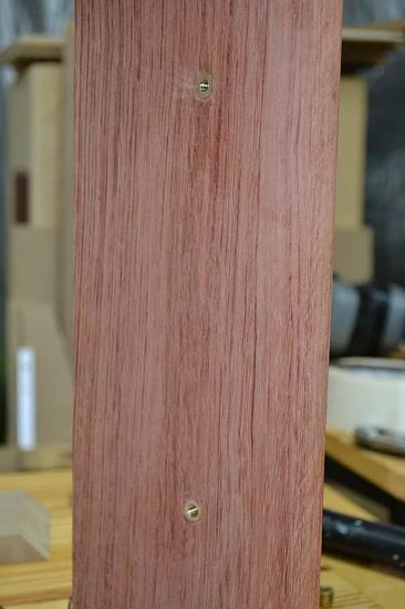

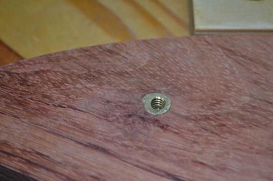

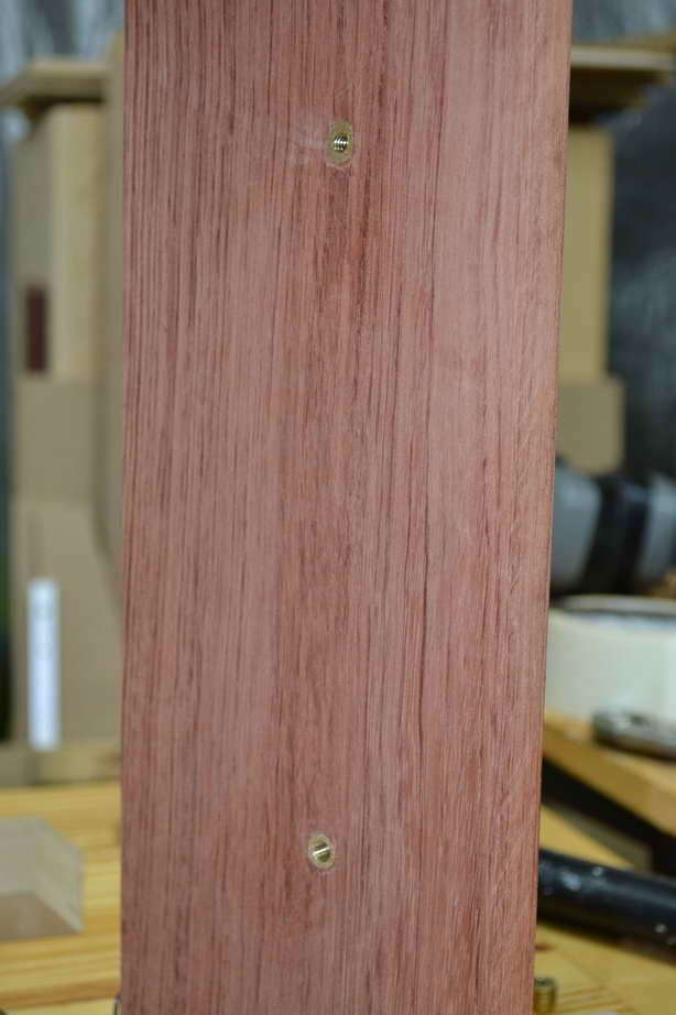

                      Painfull Fiddly Bits

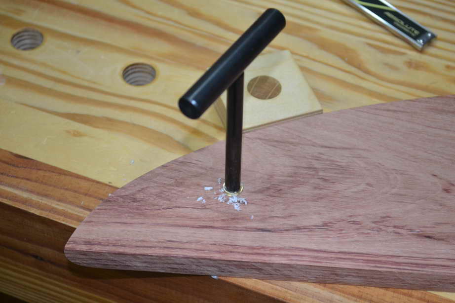

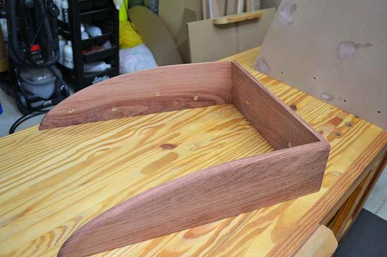

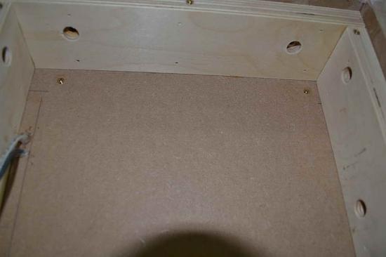

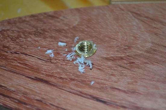

                      Have not been able to spend much time on the speakers for well over a week, got side tracked with an upgrade to the home theater setup. Finally got DirecTV to cough up new hardware for whole home HD/DVR, which turned into a new TV and receiver and a rewire of the whole system.
                      Was able to spend some time on the speakers tonight and started on threaded inserts to hold the bubinga trim in place.
                      Whole placement for the bolts ....

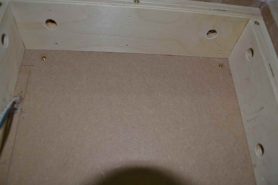

                      After transferring the holes I started into getting some inserts put in place .....

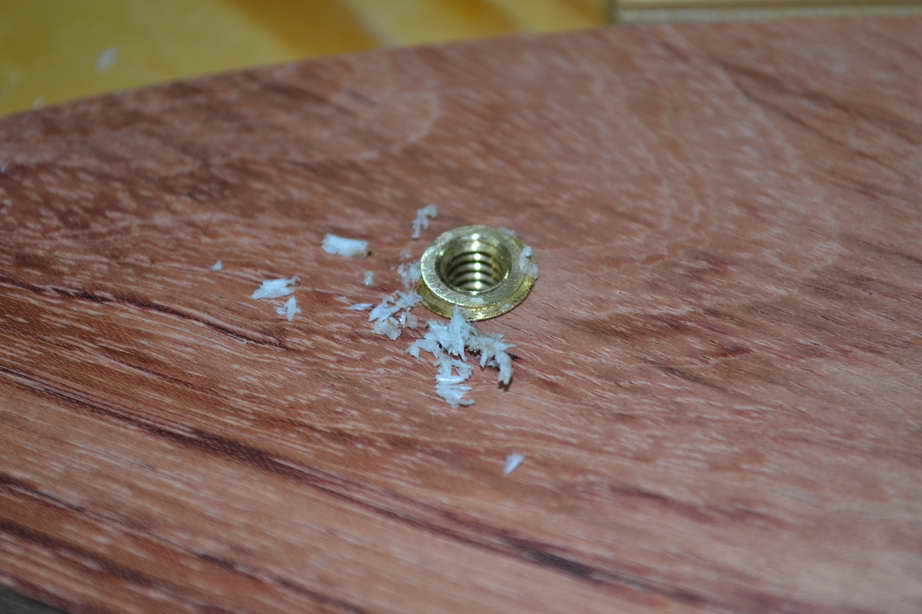

                      I had to trim the length of the inserts due to the thickness of the trim, inserts were too long, this is after I did some initial trimming......

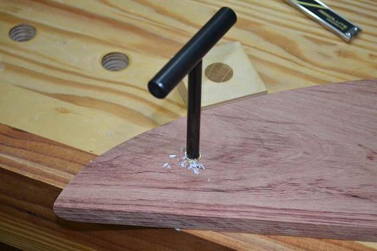

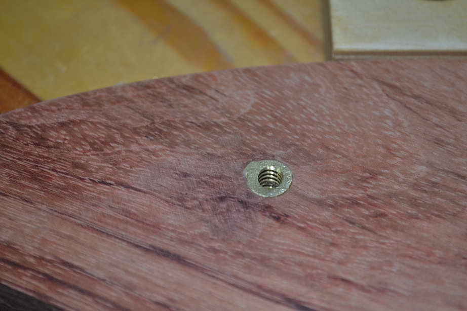

                      Had to flush trim with a file and sander, royal pain .....
                      A few more in place .... this is going to take a while since it's a time consuming process. The biggest issue is keeping everything square with having to drill everything by hand.

                        #146

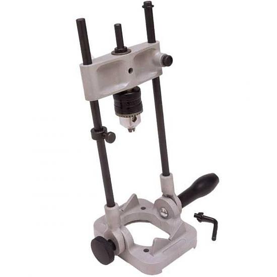

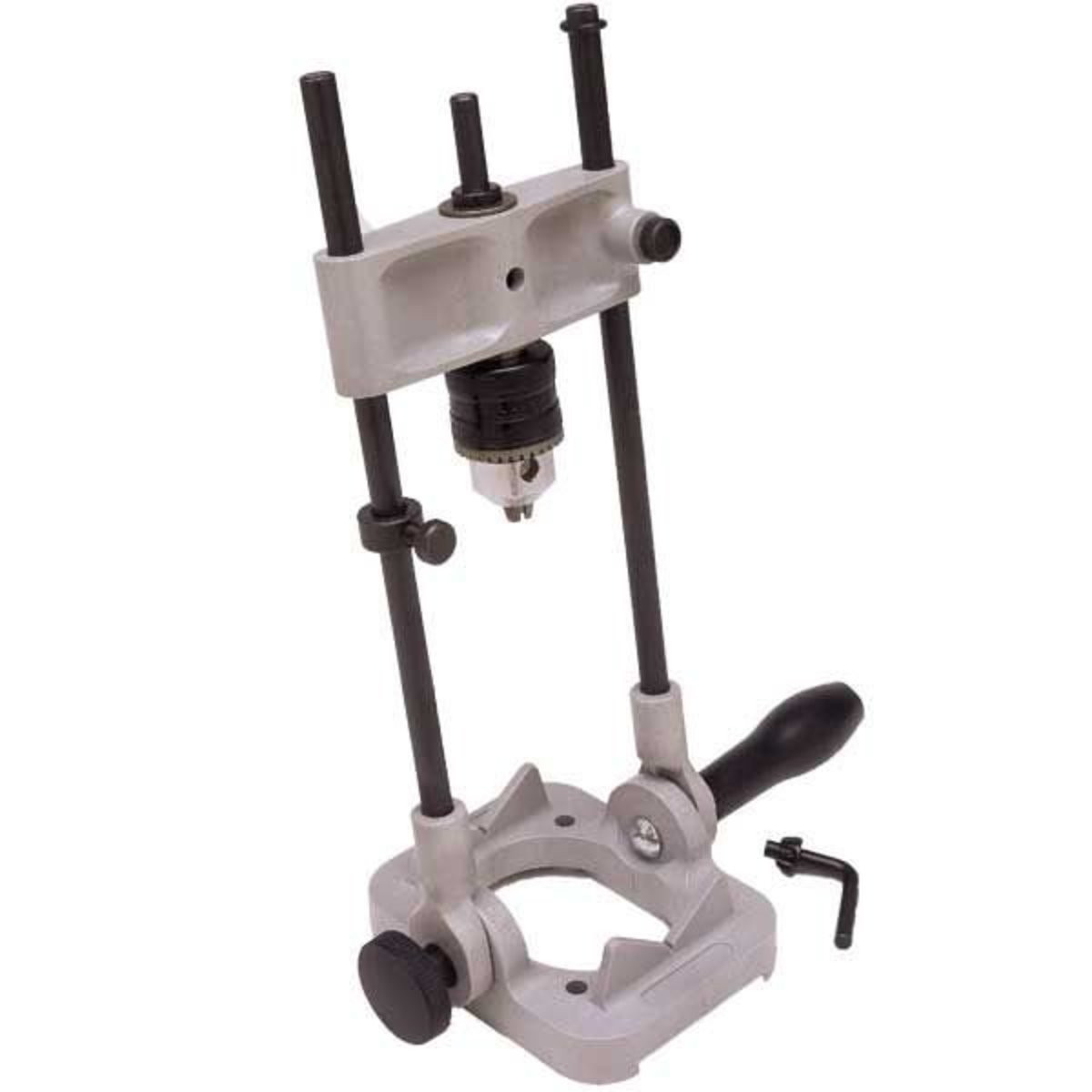

                        There are guides like this General Tools Accuguide that make a big difference drilling with hand held drills when you need to control the angle. Woodcraft, among others.
                        Click image for larger versionName:	super_zoom.jpg?c=1480836161.jpgViews:	0Size:	83.9 KBID:	936746
                        As usual, looking very good so far, Steve!
                          • 2140
                          #147
                          Thanks Jon .... I actually have one of those guides which I used for pilot holes from the outside. I ran into a little bit of grief when I drilled the recessed holes for the screw heads on the inside. Since the holes were so close to the sides I had to use a 90 degree chuck with a spade bit, less than optimal to control
                          A couple of the holes ended up a little offset as a result. I'm thinking about how to go at it on the second cabinet to get a better alignment.
                            • 2140

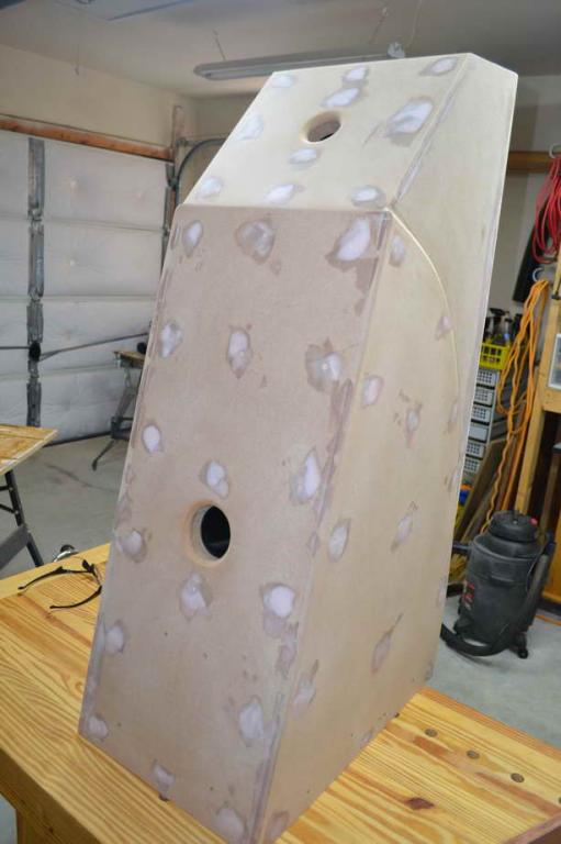

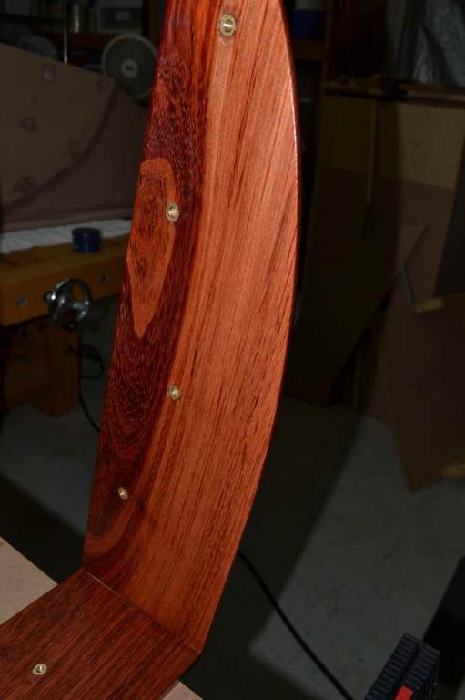

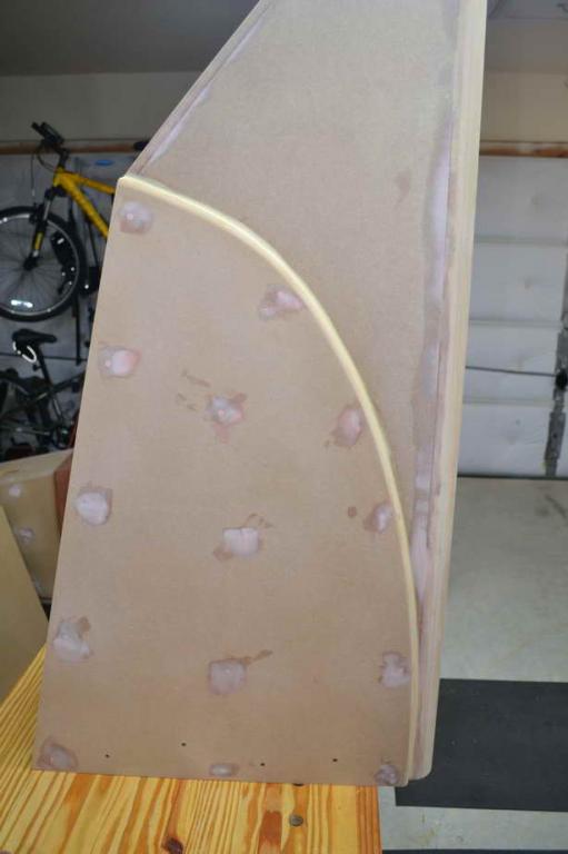

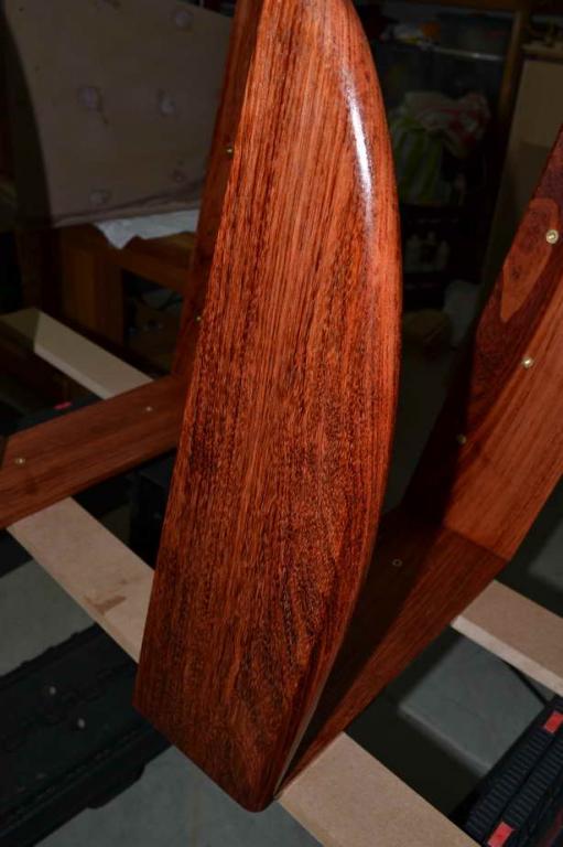

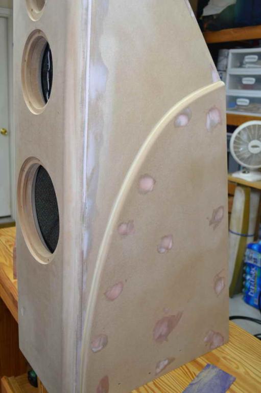

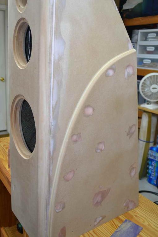

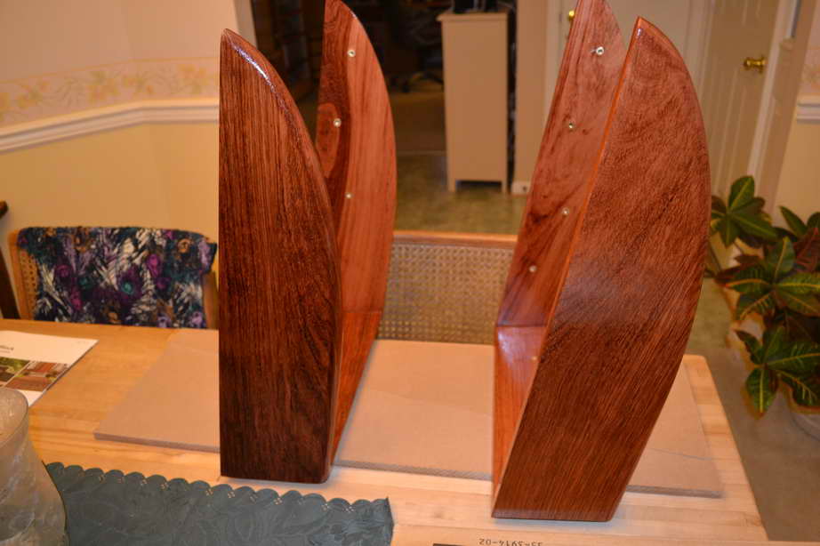

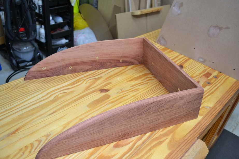

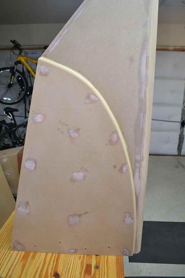

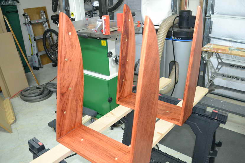

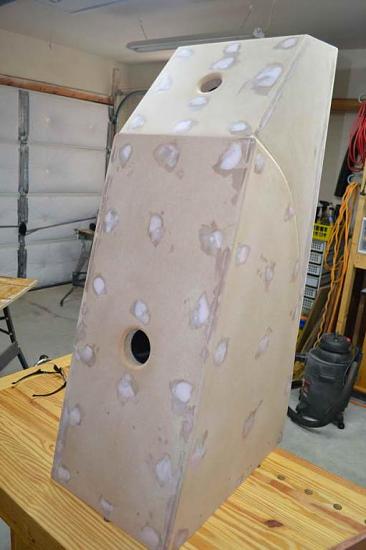

                            Still making some slow progress. Got the second bubinga trim piece done and attached to the second cabinet. Was able to get the bolts to line up better the second time around.
                            Now we're having fun with bondo and lots of sanding .......

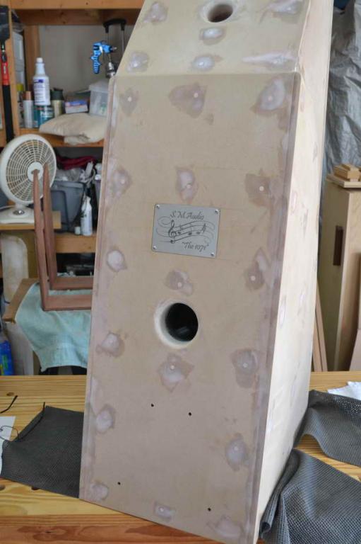

                            Also trying out some seam sealer in a few locations. The guy who is going to paint the cabinets recommended it as an easier solution to seal up joints over bondo.
                              • 2140

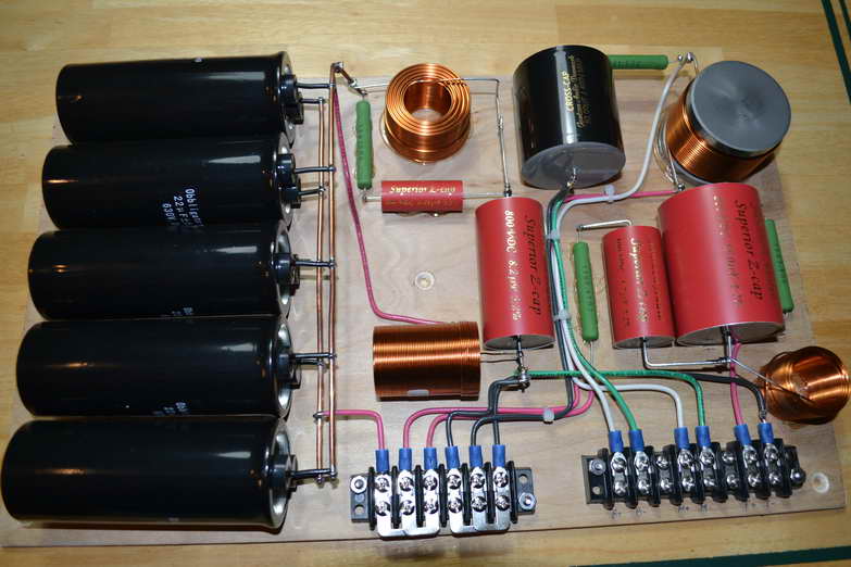

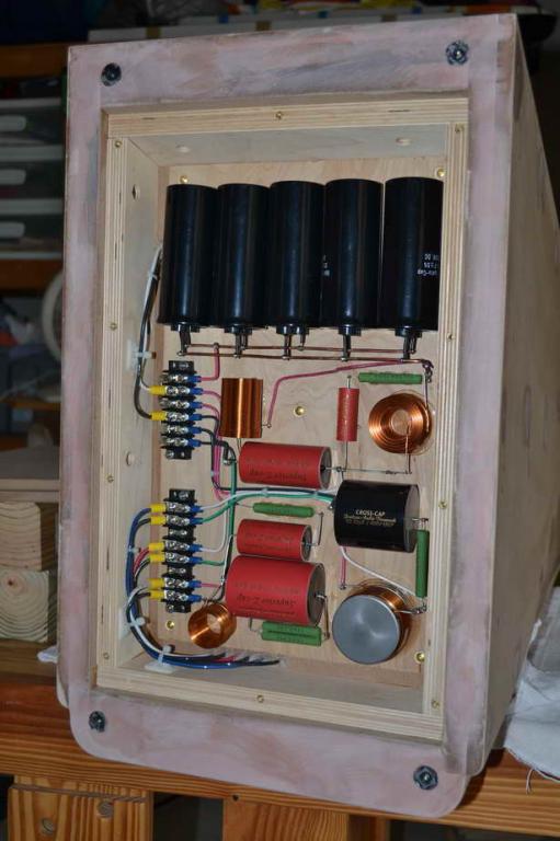

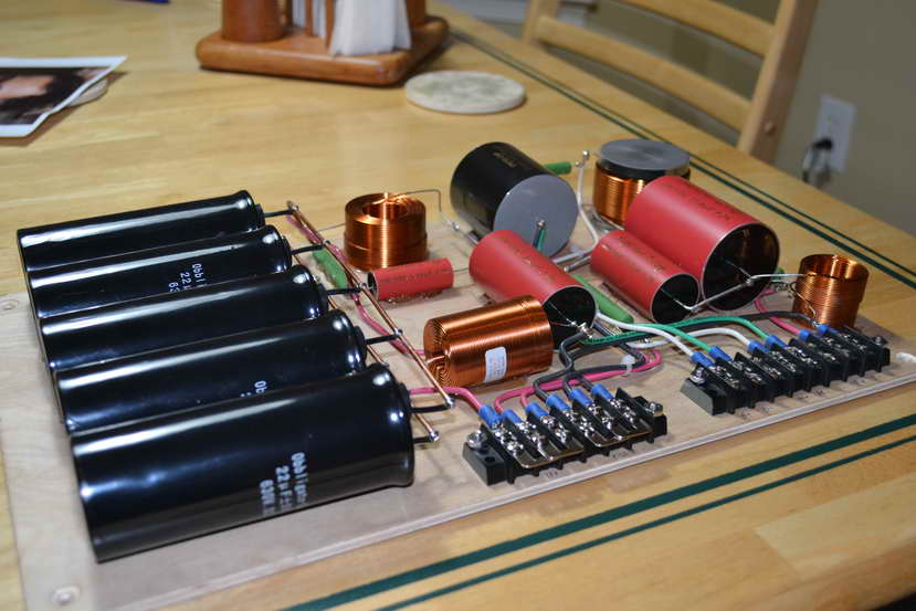

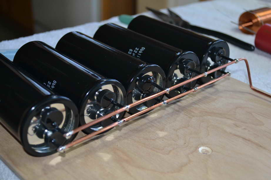

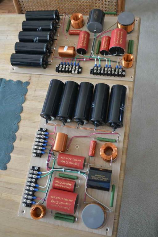

                                              I was also able to get a little bit of work done on the crossovers.
                                              This is after the Goop set up on the 110 uF of cap that Troels calls for on the mids .......
                                              A couple after getting things cleaned up and soldered in place ......
                                                • 2140

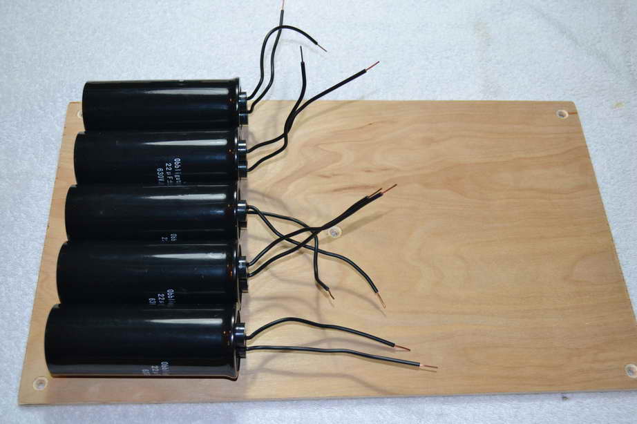

                                                Oops no pictures, I will have to fix that later when I get home.
                                                  • 2140
                                                  #159
                                                  OK lets try this again since it didn't work yesterday ....
                                                  Got a little time on the speakers this weekend. For the most part got the majority of the bondo work and sanding done on one cabinet. I got some good advise from the a local auto paint supplier here in town. I was going to pick up some more bondo and was talking to one of the guys that worked there and he suggested switching to U-Pol Fibral Lite, instead of regular bondo. Apparently it's a short hair fiber glass paste that is a lot easier to work with. It goes on very smooth and can be built up more and is stronger than straight bondo, it sands up very smooth as well. For any other body work noobs like me out there, this stuff is pretty nice to work with.
                                                  Since I do have most of the bondo work done on that cabinet I went ahead and got the threaded inserts in place for the cabinet feet .......
                                                  I was able to get a pretty good deal on a couple of sets of these .....
ID:	858146Click image for larger version
ID:	858148Click image for larger version

                                                    #160
                                                    One more time .......
ID:	858151Click image for larger version
                                                      • 2140

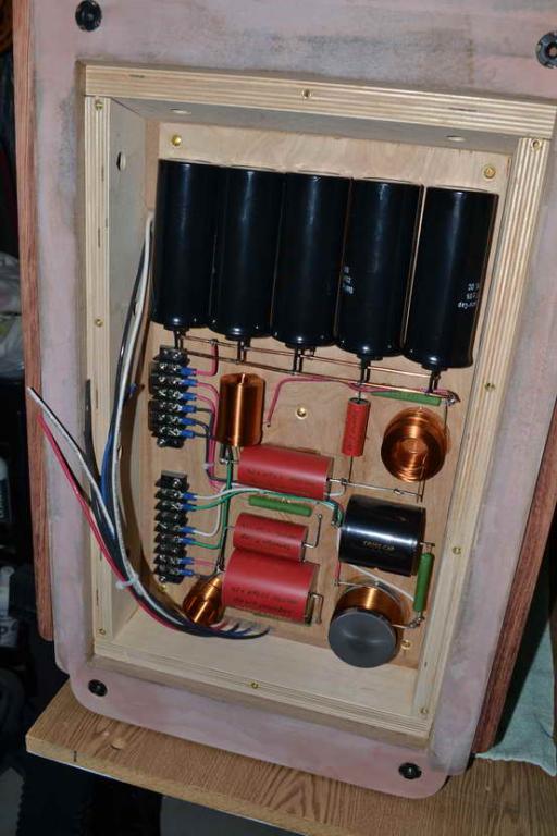

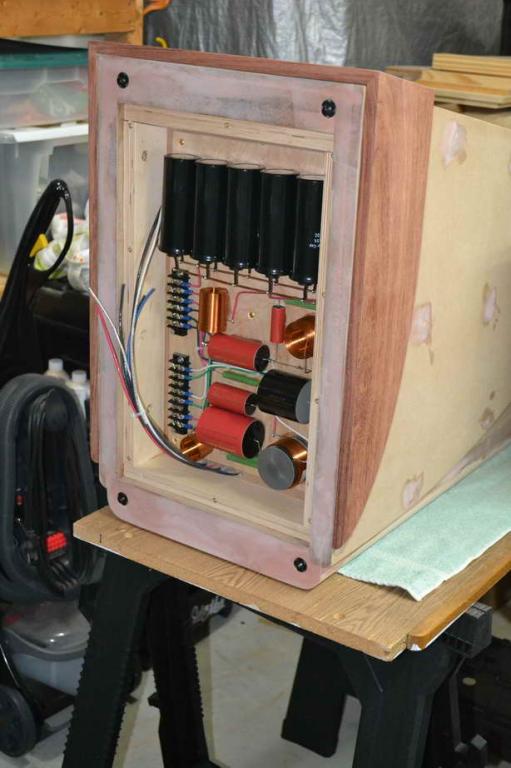

                                                      #161
                                                      One Down .....

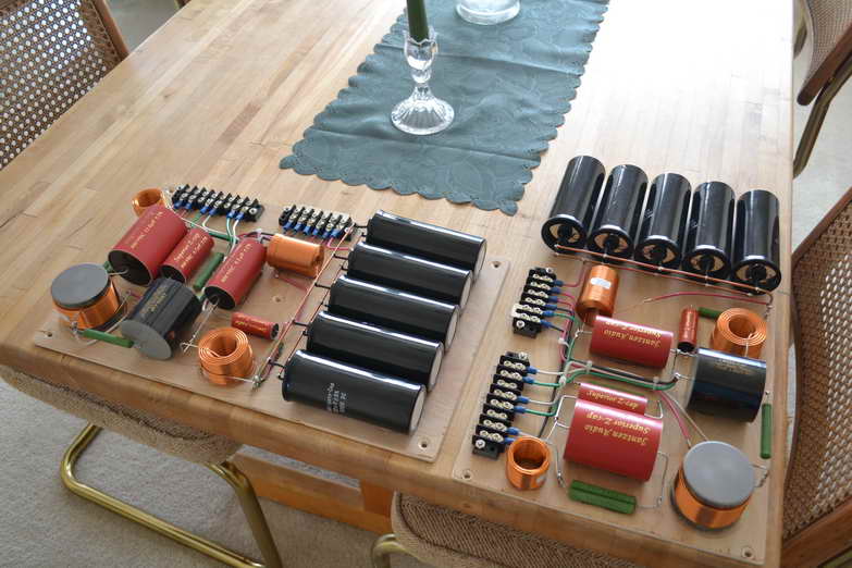

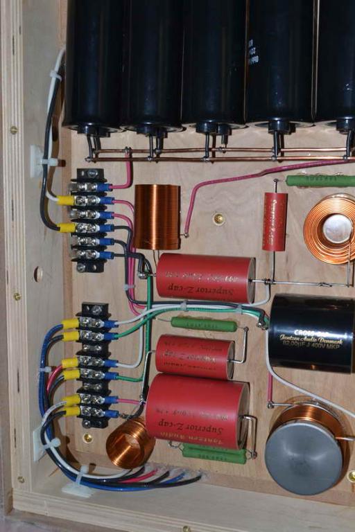

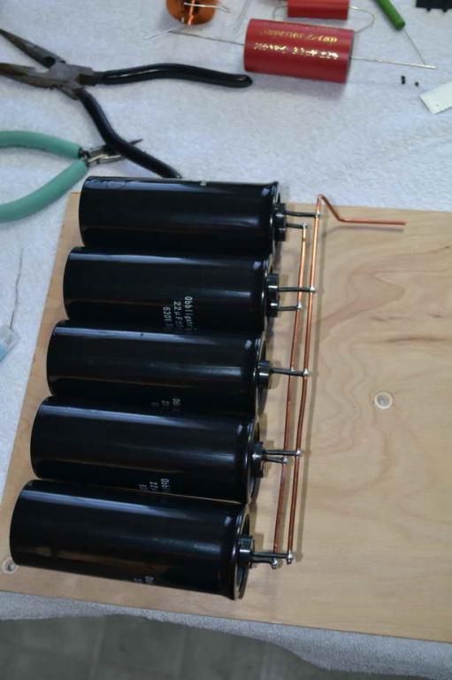

                                                      In between coats of bondo and sanding I've managed to get one of the crossover boards put together and done a test fit in the cabinet. Have to terminate cabinet wiring to length yet but things fit more or less as planed. Now back to sanding .........
                                                      • jim1961
                                                        • Nov 2012
                                                        • 357
                                                        #162
                                                        [ATTACH=CONFIG]21601[/ATTACH]
                                                        [ATTACH=CONFIG]21602[/ATTACH]
                                                        [ATTACH=CONFIG]21603[/ATTACH]
                                                        [ATTACH=CONFIG]21604[/ATTACH]
                                                        Very nice looking!
                                                        All those superior Z caps cost more than some peoples whole speakers :E
                                                          • 2140
                                                          #163
                                                          Thanks Jim ..... yep those things are not cheap, which is one reason I did not use them for the 110 uf on the mid-range, that would have added another ~$700 just for that. I went with Troel's recommendation and used Obbligato's instead, which still brought the bill to painful. 8O
                                                            • 16175

                                                            Originally posted by jim1961
                                                            Very nice looking!
                                                            Very nice looking- much better than my prototype crossovers! :T
                                                              • 571
                                                              #165
                                                              Great work Steve :T When do you expect to have the cabinets painted?
                                                                • 2140
                                                                #166
                                                                Thanks Jon ...... I'll bet your final versions are pretty nice though!
                                                                  • 2140

                                                                      Look at this way ....... once there inside the cabinet no one will ever know:W And with this build I've gotten a feel for expensive, I can only imagine the bill for yours, especially with all that pretty Kimber Kable your using to hook things up!!
                                                                        • 2140
                                                                        #170

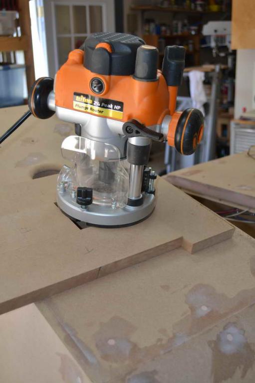

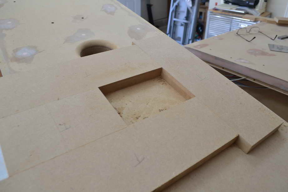

                                                                        Slow Progress continues ......

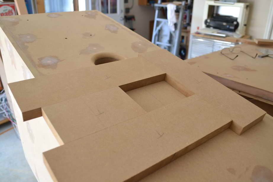

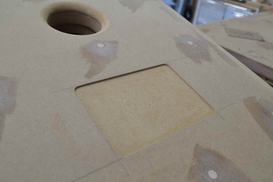

                                                                        Still making some slow headway ........ Bondo work and sanding is mostly done. Between traveling for family events and sickness, both me and the guy who's going to paint the cabinets, it looks like the end of April for actual painting, I'm hoping it does not slip any more than that. I decided to add a little something fun to the cabinets, a name plate, After seeing them on the Wilson speakers and liking how they looked I decided to give the idea a go myself. After getting the artwork done and a bit of looking around I found a place that could make what I wanted from what I had laid out. DISCLAIMER ...... Keep in mind this is in no way implies me taking credit for Troel's design, I just thought it would look cool to add.
                                                                        Made a template for the router first .....

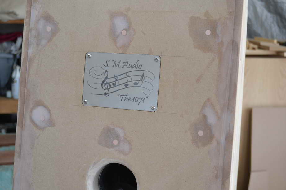

                                                                        Pocket after routering ....
                                                                          • 2140

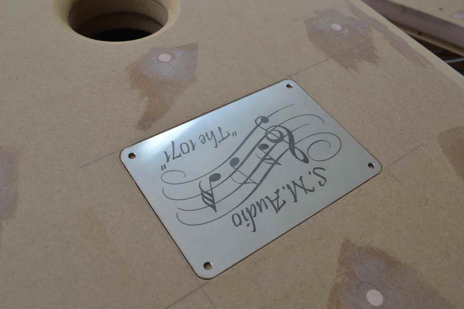

                                                                          #171
                                                                          A fit of the name plate before drilling for screws ........

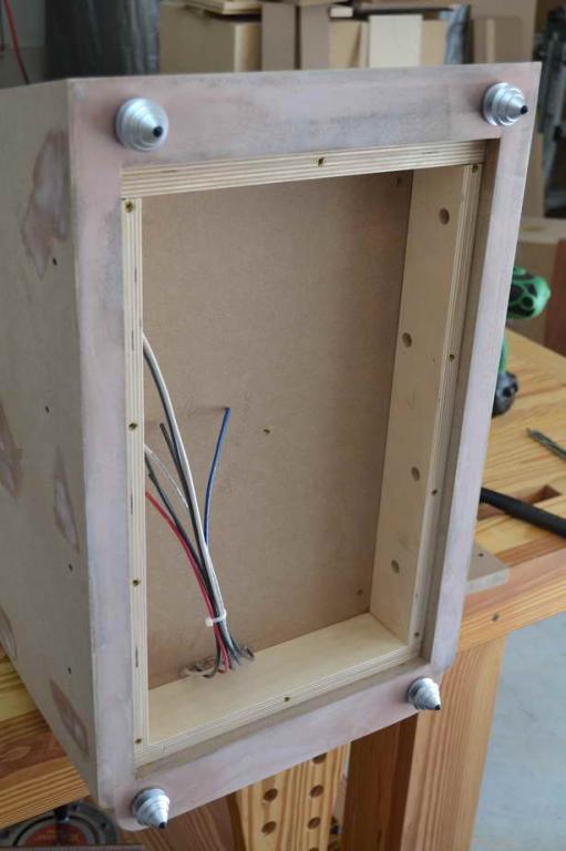

                                                                          Mounted with stainless steel screws .......
                                                                          Also managed to finish up the second crossover board this week while I was home with stomach flu .......
                                                                          Need to run back to the electronics store to pick up some more jumpers for the input terminal strip, I did not get enough the first time around.

                                                                            #172
                                                                            [ATTACH=CONFIG]21733[/ATTACH]
                                                                            [ATTACH=CONFIG]21737[/ATTACH]
                                                                            [ATTACH=CONFIG]21734[/ATTACH]
                                                                            [ATTACH=CONFIG]21735[/ATTACH]
                                                                            [ATTACH=CONFIG]21736[/ATTACH]
                                                                            Wow, top job on the nameplate. I was actually thinking of doing something like this myself but that looks way cooler than anything I had in mind. What is the plate made of, aluminum?

                                                                              Nice progress Steve! Sorry about the stomach flu, but another crossover built is a good way to turn lemons into lemonade! And the nameplate is quite classy!

                                                                                Thanks guys ....... Mark the material for the plate is stainless steel, 1/16" thick

                                                                                  Well the cabinets are all ready to go to paint, unfortunately the guy that's go to do the painting has a brother that is about to loose the battle to cancer. So we are on hold until that gets resolved. In the mean time I have started putting some finish on the bubinga trim pieces ......
                                                                                  Getting things ready to go for the first coat .....
                                                                                  After one coat ....... already the color and grain is looking pretty nice .......

                                                                                        So in between coats of Arm-A-Seal finish, and with the cabinets not going off for paint yet, I decided to start working on the final wire up of the crossovers in their cubby hole. Here's a couple of picture of how that's going to look .......
                                                                                        • meb46
                                                                                          • Jul 2010
                                                                                          • 398
                                                                                          #179
                                                                                          Steve - those are some super clean crossovers! Very impressed!
