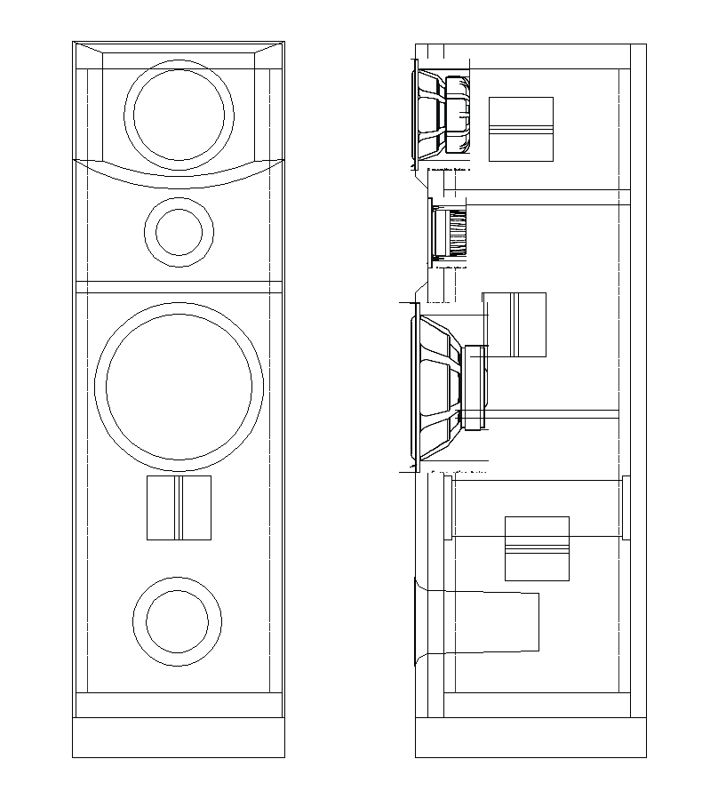

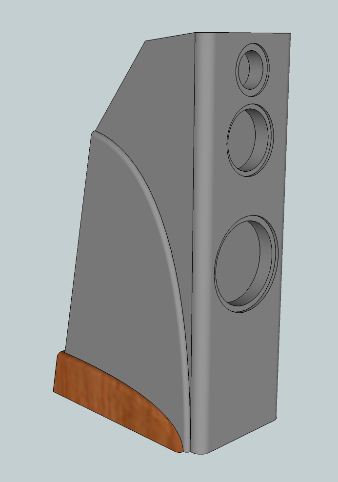

    Well the bug hit again ....... time for another speaker build. Since I had done a couple of 2-way builds already I wanted to try a 3-way design this time. After much looking around I decided to go with Troels Gravesen's Jensen 1071 . I was following some new designs here with interest that were not yet finalized (Mr. Marsh) but due his work commitments, very inconsiderate of them to not give him time off!, and my impatience, I went with the 1071.
    In the past I've typically finished a project before posting pictures, but decided to go ahead and post as I go this time. I've tweaked the look over what Troels did with his build. I have kept baffle dimensions, driver placement, and cabinet volumes all the same. I found Sketchup rather helpful when it came to keeping track of volumes and in particular all of the needed angles when it came to cutting material.

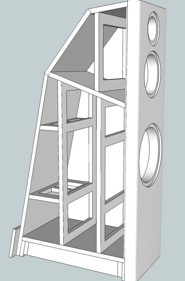

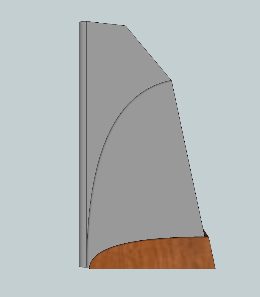

    So I started collecting parts, working on the cabinet design with Sketchup and picked up some wood and started making some saw dust this past summer and here is some of what I've been up to .....
    The cabinet design ......
    Click image for larger version  Name:	Overall Look 2.jpg Views:	9331 Size:	53.8 KB ID:	871088
    Another .....
Name:	Overall Look 3a.jpg

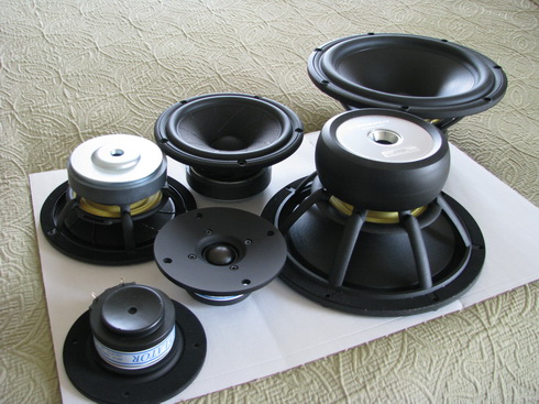

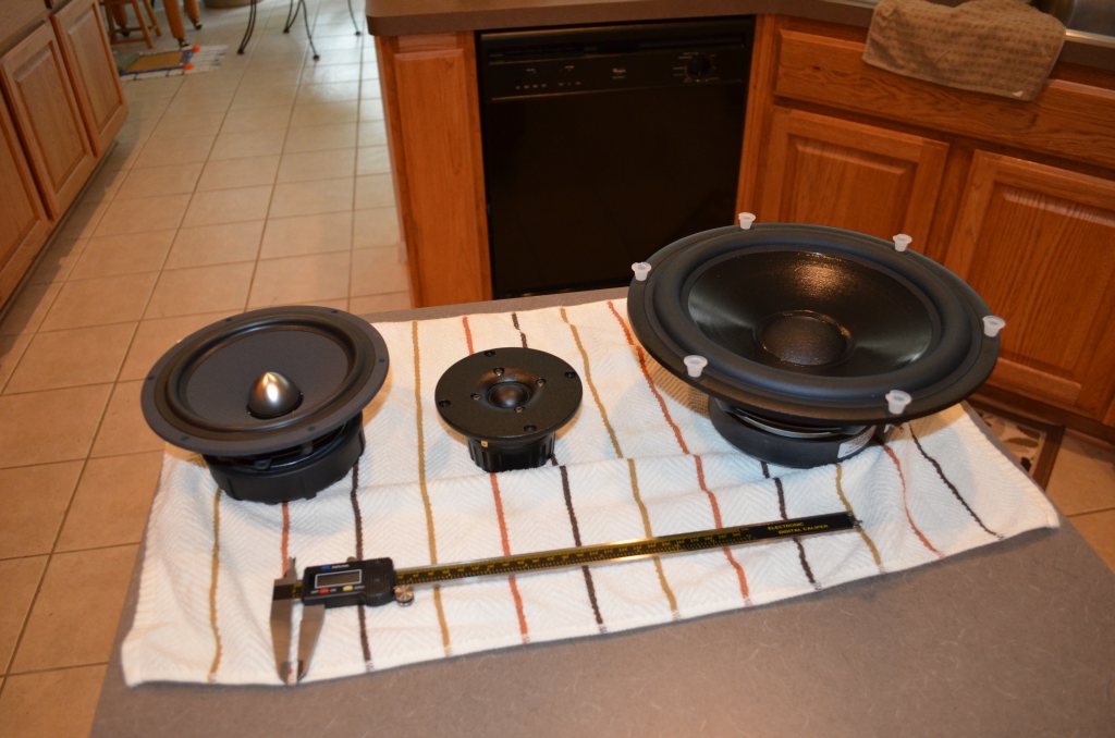

    The important parts .....

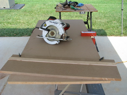

    More Pics

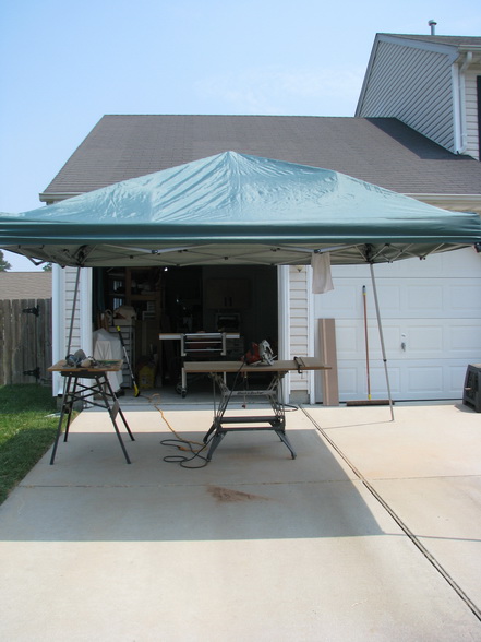

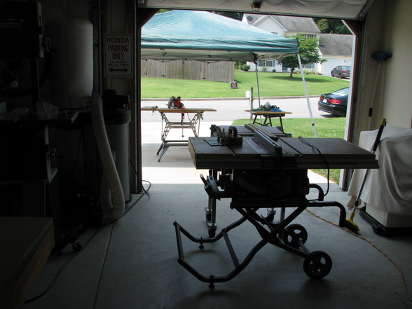

    Setting up some shade for the 100+ degree weather we had over the summer .....

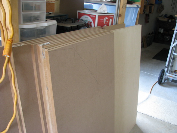

    SOME of the wood getting ready to be cut with some layout lines ......
    Keeping the lines straight ........

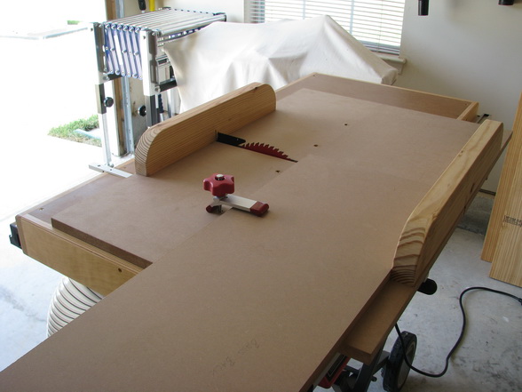

              Some more pics

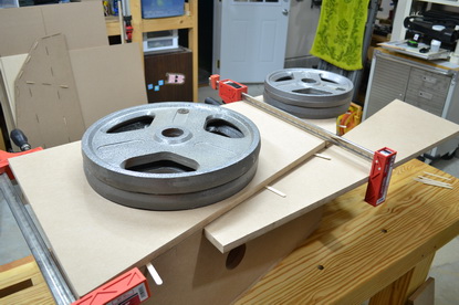

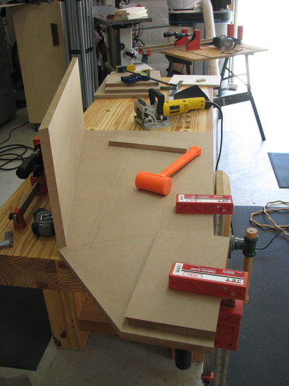

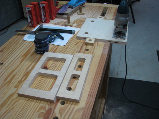

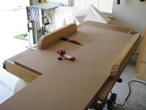

              Finally had to build a cross cut sled for my table saw, seemed like the best way to deal with all of the different angles I had to cut. That of course was after having to build a new top for my Craftsman saw that had not miter slots for the sled .....
              Setting the blade with a digital bevel gauge made things fairly straight forward with pretty good results ....

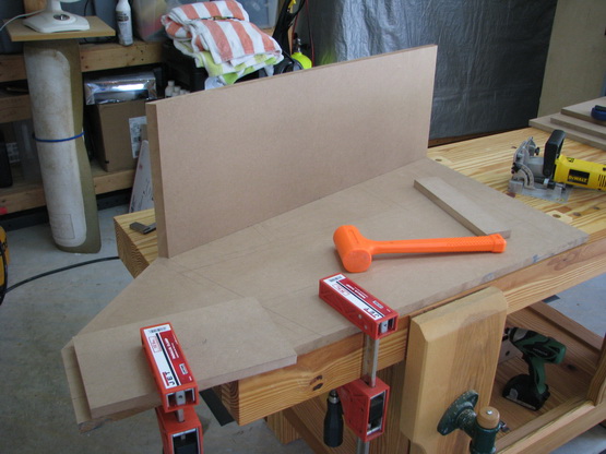

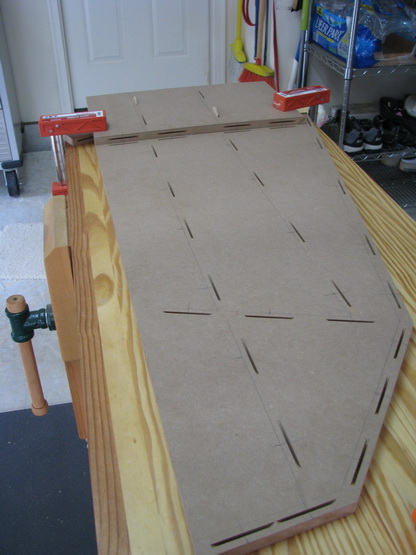

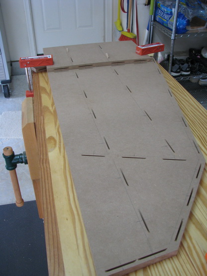

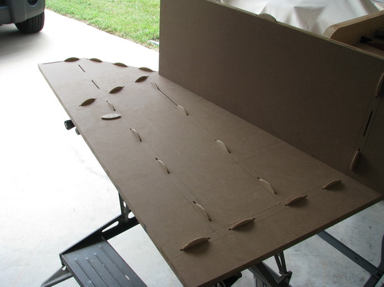

              Getting things lined up for some biscuit joints ......
              As a matter of fact there are 154 biscuit slots per cabinet !!!! I think a CNC router would be much easier .....

              I don't know which is more impressive- that there are 154 biscuit slots per cabinet, or that you've counted them! :W
                Wait, you're supposed to use more than one or two biscuits per panel? 8O
                Nice job so far! :T
                  • 2140
                  Jon I had no idea the count was that high until I ran out of biscuits from the first container that I bought and had to run back up to Lowes and get another one. Since there's a hundred per container I was a little surprised and did the count. Keeps the parts nice and lined up though .......
                    • 16175
                    That it does, that it VERY much does. I'd be using more biscuits on this current build, but that the angles of the top module limit the possibility. The bass modules will be different- more right angles, and more biscuits!

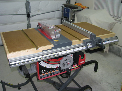

                        If using the right tool for the job is cheating...
                        Did you use any inspiration for the new top, or just wing it? I've been trying to determine the best road to working with larger panels safely, and that's one option - however, it limits my ability to use the fence I have, so I'm curious. Haven't even looked to see what's out there.
                          • 2140

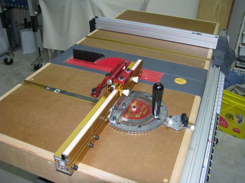

                          cjd,
                          I saw something over at BT3 Central where they are a big fan of my particular saw. Someone had done something very similar and I tweaked it a little for what I needed. I also saw the aftermarket riving knife setup which I purchased. It was the first I had found for my saw. The top gives me a lot more working areas and I can use the fence on both sides of the blade. I also added a better switch for easier access. It's not a Martin but it does a pretty good job over all.
                          Steve
                          Click image for larger version  Name:	IMG_1570_resize.JPG Views:	8226 Size:	81.8 KB ID:	857730
                          Click image for larger version  Name:	IMG_1576_resize.JPG Views:	8122 Size:	84.8 KB ID:	857731
                            • 16175
                            I love what you've done with your Ryobi! If I do any projects next year, I'll have to go look on the BT3 forum and check that out- it's been a while since I've been over there. And your miter jig is the cat's meow- I've been looking at one of those, but it just hasn't been urgent (yet).
                              • 2140
                              Thanks Jon ...... The miter jig was a birthday gift from my wife, I was tired of messing with the one that came with the saw trying to get an accurate cut. Once you square this one to the blade the rest is a breeze.

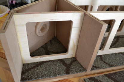

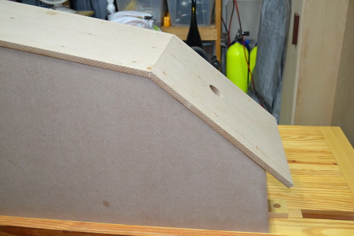

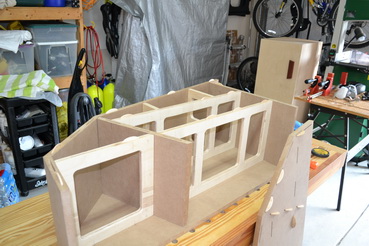

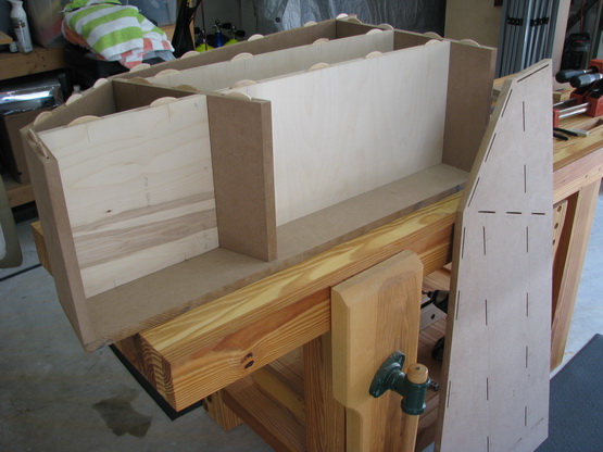

                                • 2140
                                More pics
                                Getting the sides and internal braces in place .......
                                Cutting the braces to final configuration .......

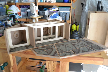

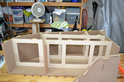

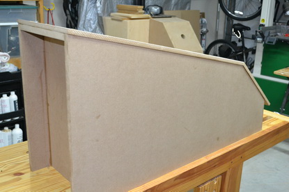

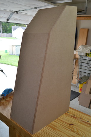

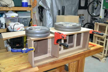

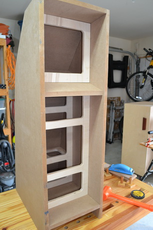

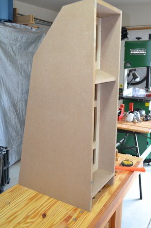

                                    Look Ma no glue ....
                                    Here are a few pictures of a dry fit of most of the panels and internal braces ....
                                    Here's where all those biscuits came in handy .... it let me put the cabinet together and move it around (within reason) without a drop of glue or clamps.

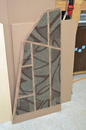

                                                Thanks for the kind words guys ...... cjd has it figured out though and as Jon also pointed out I cheat. I started the actual building back in July. I figured I'd get things rolling along before posting so I would have something to actually show. I think I spend more time planning then I do building, as a result I don't move along too fast. I'm sure the neighbors think I'm nuts just standing there staring at the wood working out the next step in my head.
                                                John as for for the fit up ..... trust me there is still going to be some bondo to fill in cracks and uneven areas. Though I have found with the last few things I have built, not just speakers, drawing it up in Sketchup first has really helped with the quality of the build. It lets me visualize things and make adjustments without having to waste a pile of wood in the process. As a matter of fact I don't think I would have even been able to build these cabinets without using it. Take a look at this picture and look at all the crazy angles and you'll see what I mean.
                                                Steve

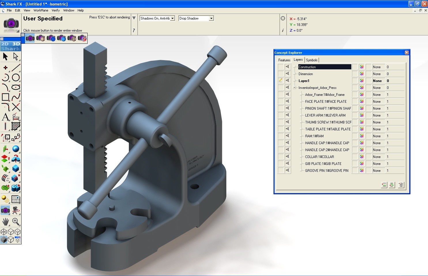

                                                  Yeah, it's one of those things that looks like it was designed either by a drunken sailor or Leonardo DiVinci- more likely the latter.
                                                  I feel the same way about planning, which is why though I had a fair amount in hand back in December when I ordered my 6 piecers of LBL ply, there's been a lot of Shark FX work since then, and rolling changes as I get inspiration or see things differently.
                                                  Last edited by theSven; 16 May 2023, 10:44 Tuesday. Reason: Remove broken image link
                                                    • 2140
                                                    I have not heard of Shark FX is that a Mac specific package? It looks like it is a little more serious than Sketchup.
                                                    One of these days I'm going to have to try some LBL ply. I mostly use Baltic Birch and mdf for my builds. I've looked around, but the closest I could find any LBL was 2 hours away in Richmond.

                                                            • 16175
                                                            Shark FX is both PC and Mac, but I run the Mac version. It has a high degree of interoperability, due to being able to work with file format from other programs (AutoCAD, Sketchup, Catia, etc) and standard exchange formats like STEPS. I was a long time AutoCAD user in the old days. Shark and ViaCAD are descended from a CAD program (Concepts CSI) that developed the automatic cursor alignment techniques used and licensed by several other CAD programs. ViaCAD provides most of the same design functionality, but not the complex rendering capability of Shark FX.
                                                            It's probably overkill, realistically, for speaker design, but I like the software a lot. Model to sheet functionality is quite useful, with a decent printer.

                                                                • 2140
                                                                Click image for larger version  Name:	InventorImport.jpg Views:	0 Size:	264.8 KB ID:	936745
                                                                Thanks Jon, I'm familiar with AutoCAD and Concepts from work, though have not used them. I'm definitely a CAD neophyte but have enjoyed using Sketchup. I would like to put together a CNC router at some point, that may force me to get a little more serious in the CAD world.

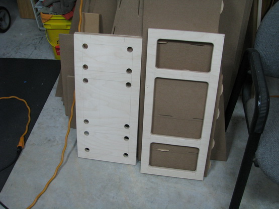

                                                                        • 2140
                                                                        Pics

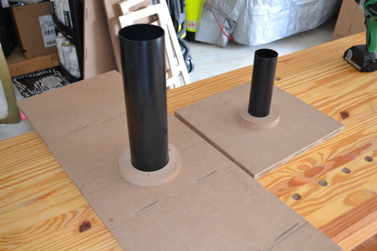

                                                                        Checking out port tube fit .......
                                                                        Cabinet starts getting some glue .......

                                                                          • 2140

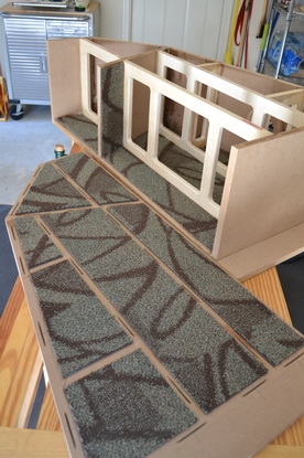

                                                                          Cabinet Dampening
                                                                          Troels design called for using bitumen and felt on the cabinet walls for dampening. After discovering that the type of felt he uses is tough to find in the US, and not wanting to deal with the smell of the bitumen, I decided to give an idea of Tony Gee's over at Humble Homemade Hifi a try .... carpet tile.
                                                                          It took a while to get everything cut and glued into place but it has made a big difference with the knuckle test on the walls.
                                                                            • 571
                                                                            Great job with the carpet tile... :T What did you use for the adhesive?
                                                                              • 2140
                                                                              Thanks ...... I used Loctite Pro Line Premium Construction Adhesive and threw some staples in to hold things in place will that set up. Seems to be holding pretty well so far.
                                                                              • gbegland
                                                                                • 233
                                                                                Make sure to use some 2"+ rigid fiberglass or Bonded Logic inside the cabs behind the mid and woofer. Looking excellent so far. Thanks for all the build porn!
                                                                                Greg
                                                                                  • 2140
                                                                                  Greg
                                                                                  Thanks Greg. I was thinking about using some extra wool stuffing from Madisound that I have for the mid. cabinet and picking up a 5 lb bag of Acousta-Stuf from Parts Express for the bass cabinet.
                                                                                  Steve

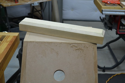

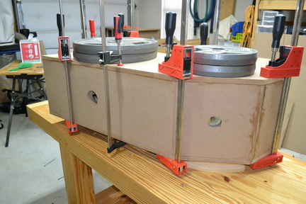

                                                                                    • 2140

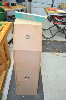

                                                                                    Gluing on the final side .....

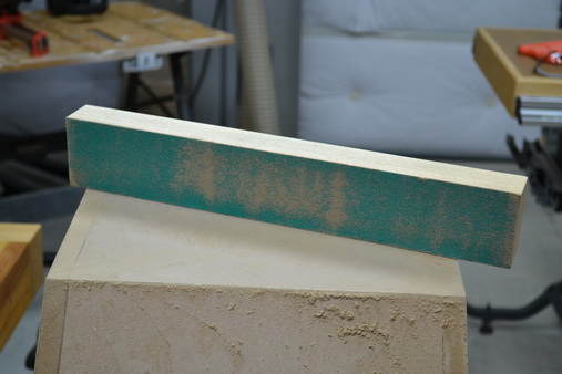

                                                                                    Trying out the new sanding block for a little clean up .....

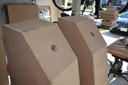

                                                                                      • 2140
                                                                                      After getting the second side on I was not satisfied with how the back sounded during a knuckle test, even with the carpet tiles added. The bracing worked very well on the sides but was not doing as good a job on the back. So I decided to add an additional layer of 1/2" mdf to the back area. This seemed to balance things out well, even though these things are starting to get a bit heavy!
                                                                                      One cabinet with and without the extra layer.
