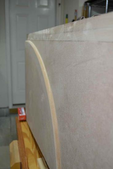

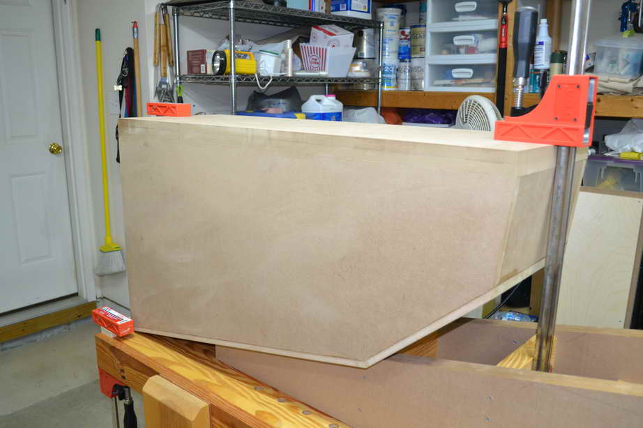

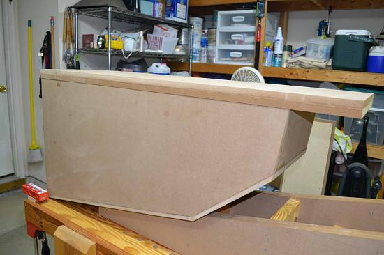

    Side Cladding

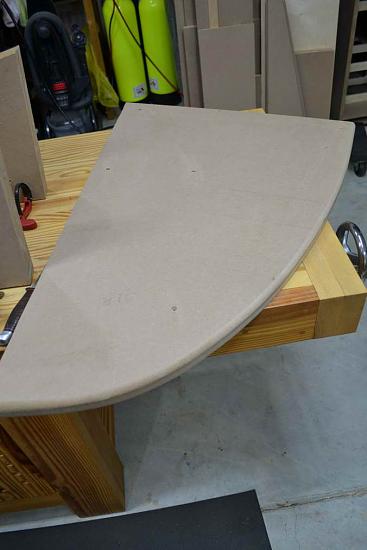

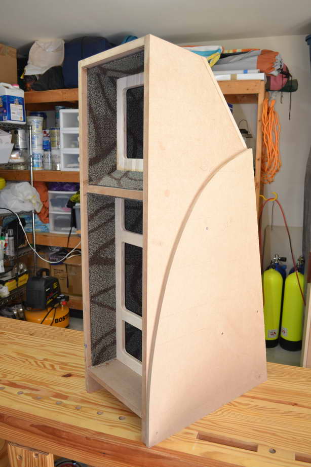

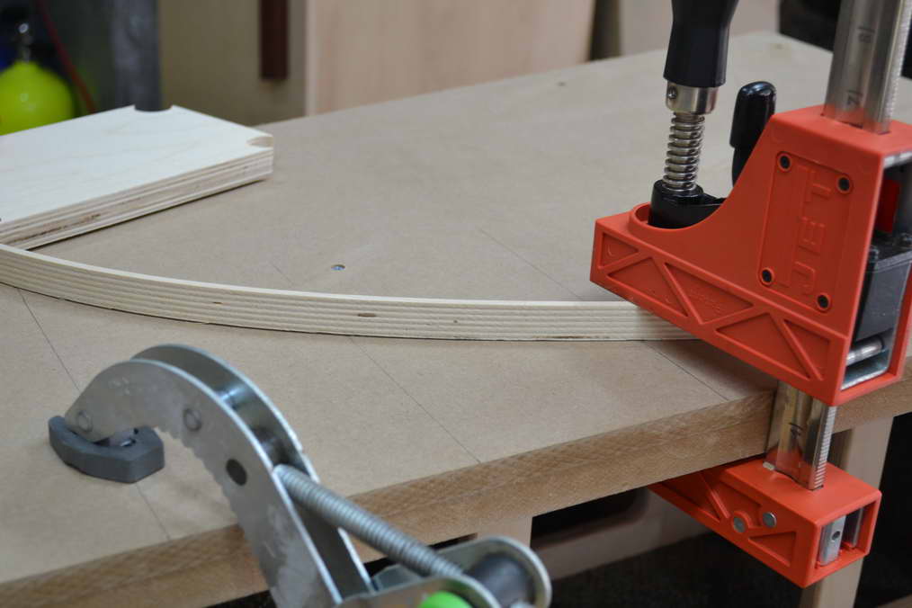

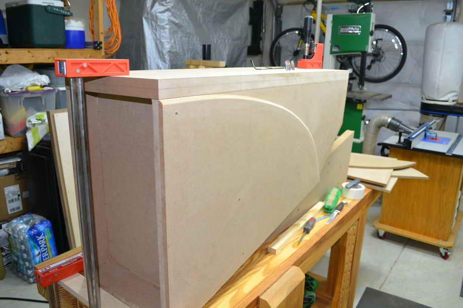

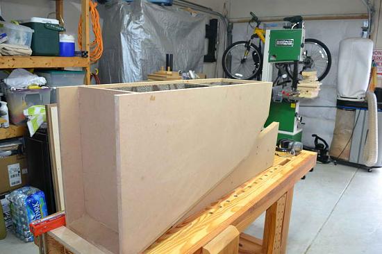

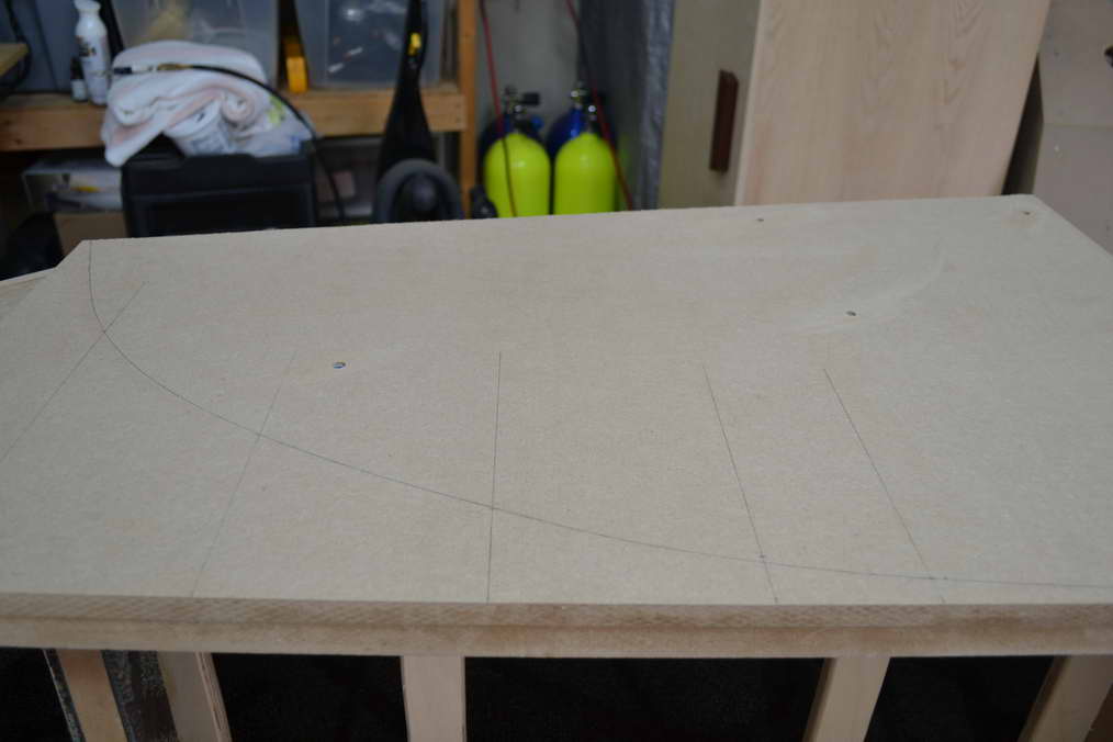

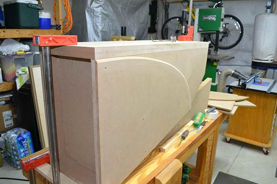

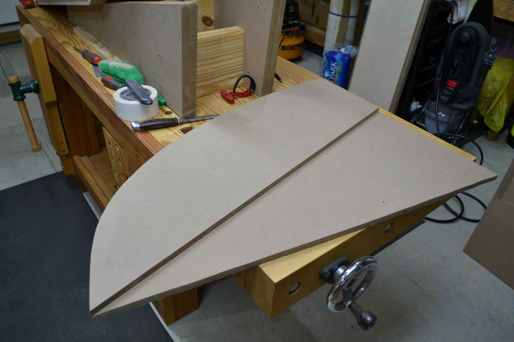

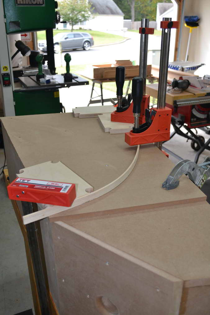

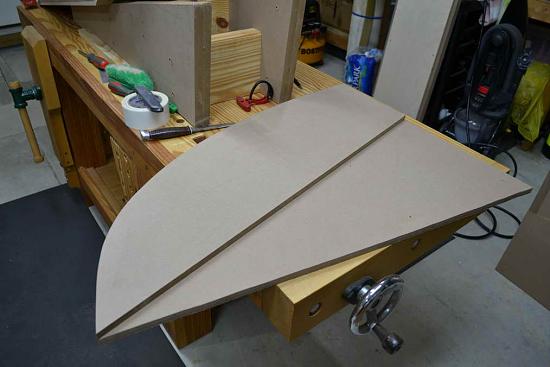

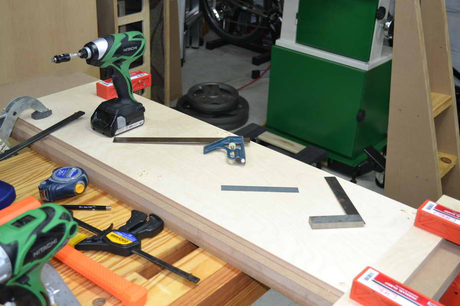

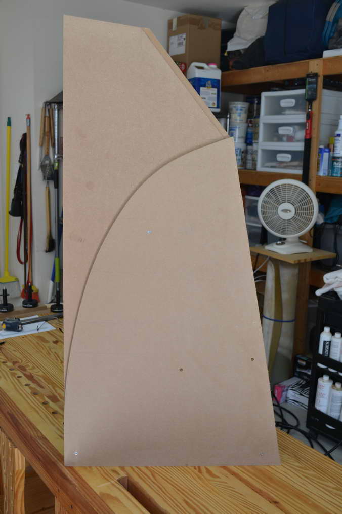

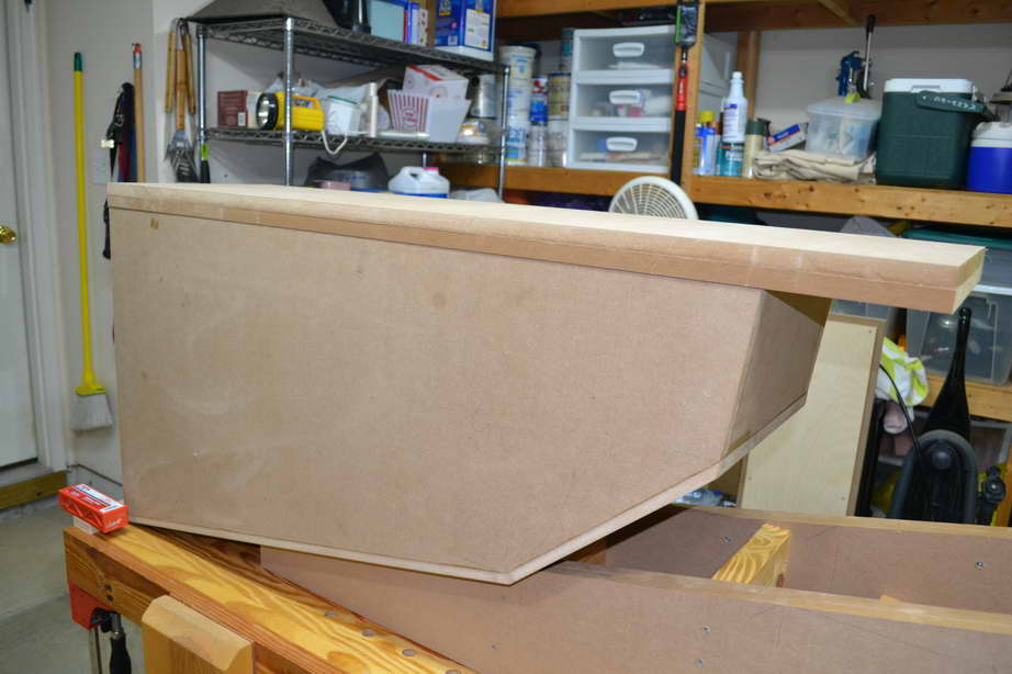

    While trimming boards to size early in the project I end up with a thin piece of baltic birch plywood that came in handy for laying out the curve for side cladding pieces ......

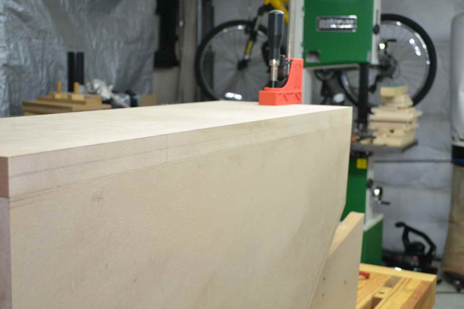

    I ended up with a pretty good curve to follow on the band saw ....

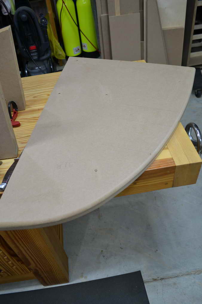

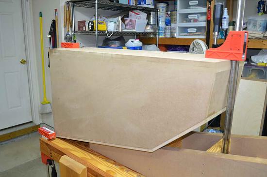

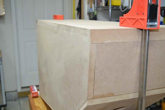

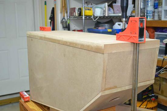

    Temporarily attached one of the sides to get a feel of how it would look ....

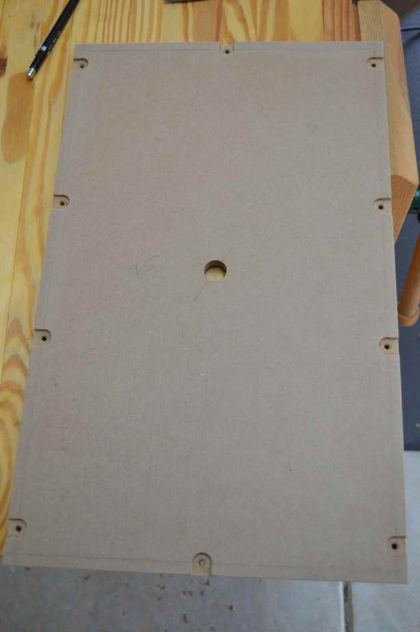

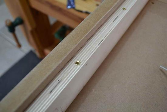

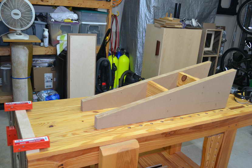

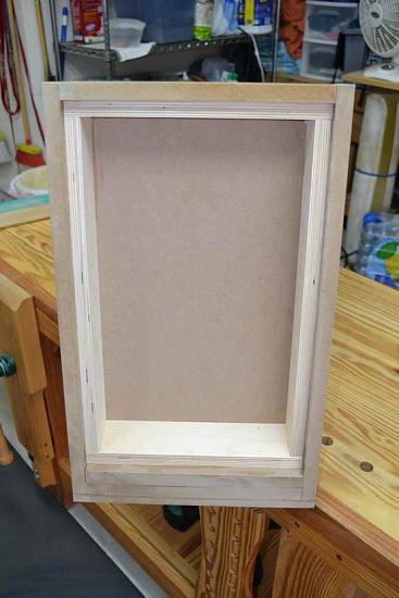

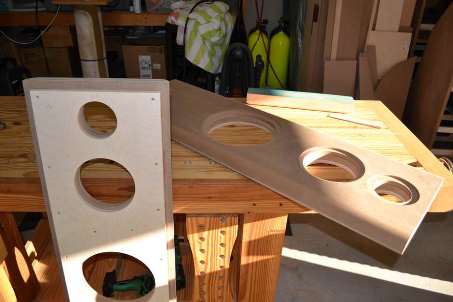

          Starting the baffles
          Getting things setup for the baffles to go in place....
          Not as beefy as one of Jon's baffles but at 2" thick they still add some appreciable weight to the cabinets .......

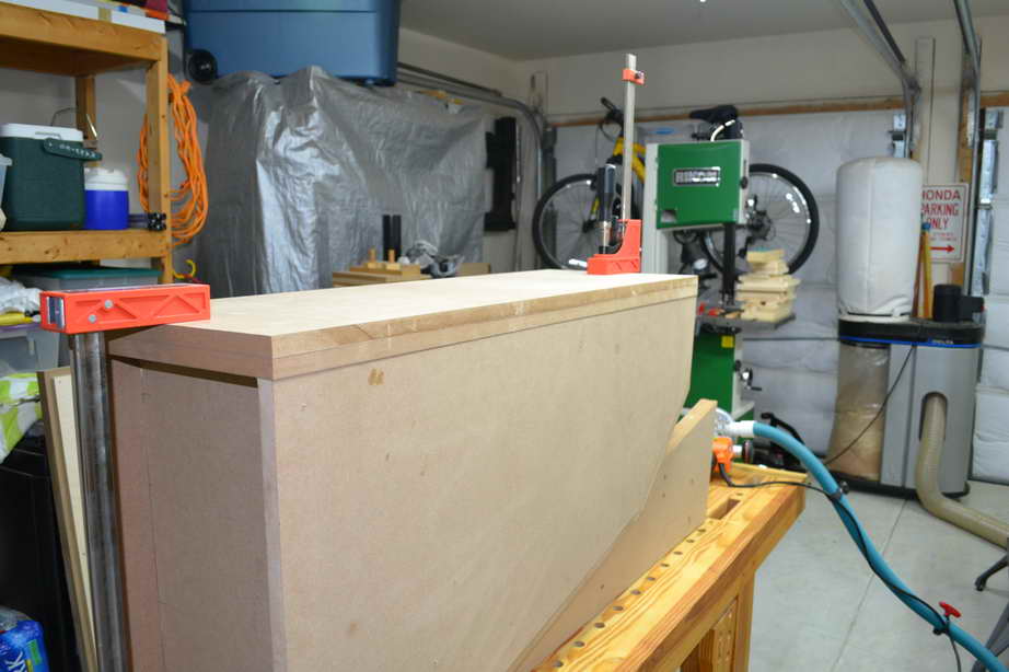

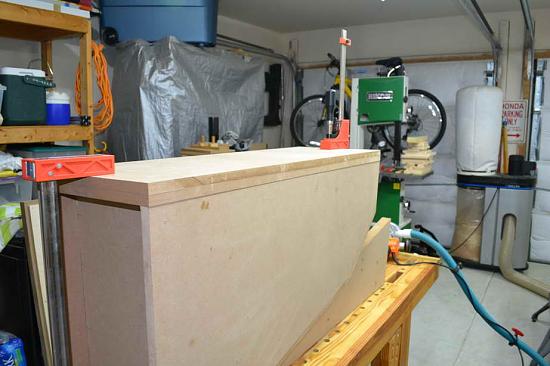

            • 2140
            Trimming baffles

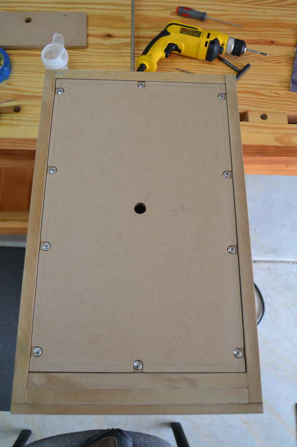

            After trimming baffle to length ....

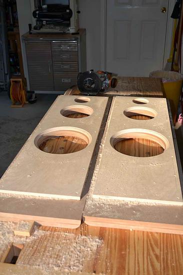

            After flush trimming the baffle. Found that the attached vacuum hose did very little to catch the mdf dust since the bit extended so much lower than the bottom of the router. Had to open both garage doors and turn the leaf blower loose to clean up the mess ....

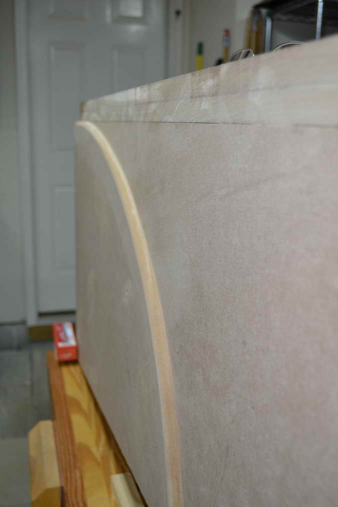

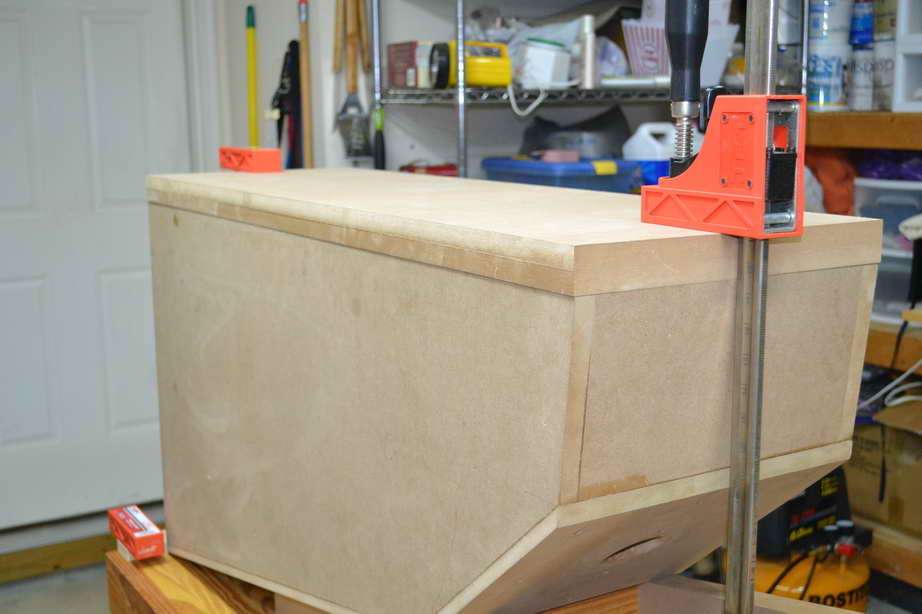

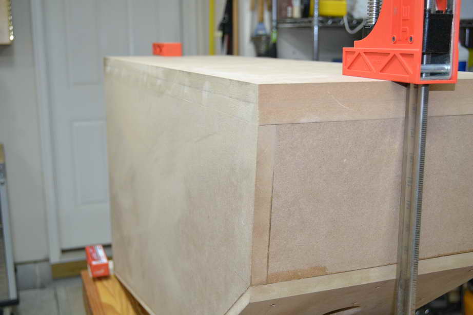

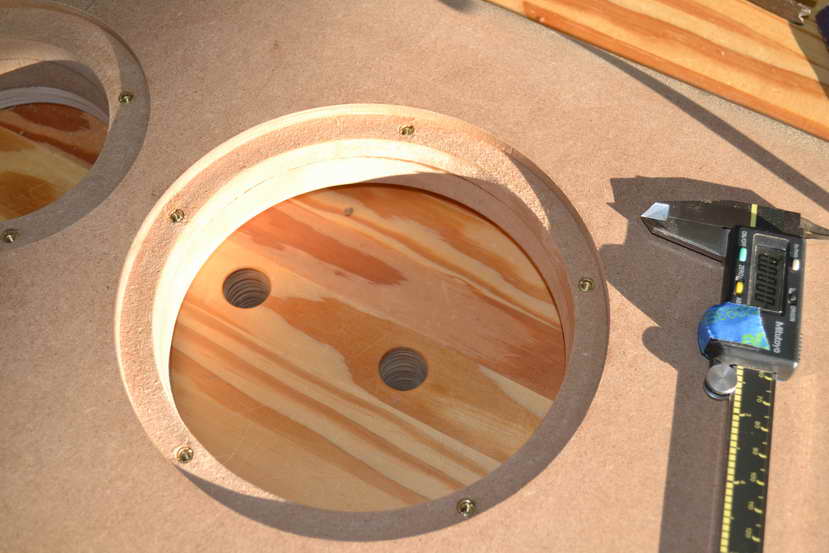

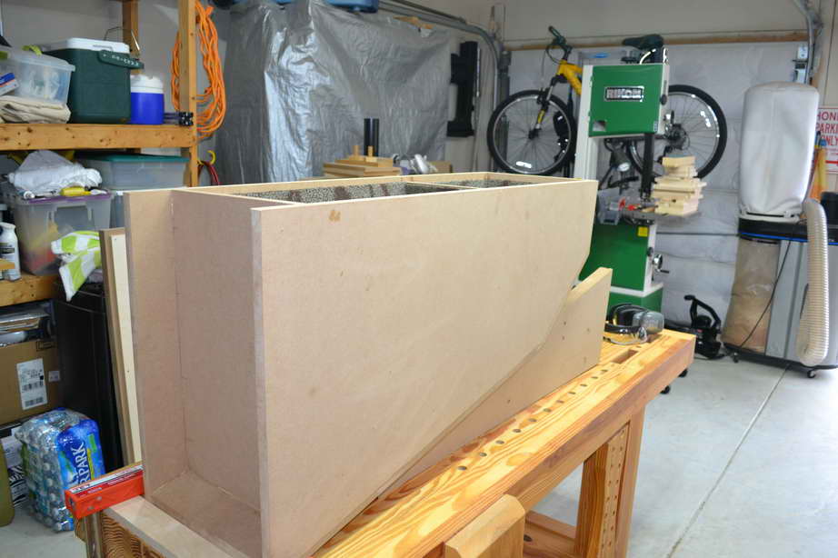

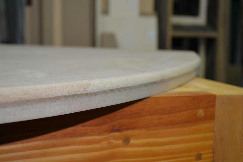

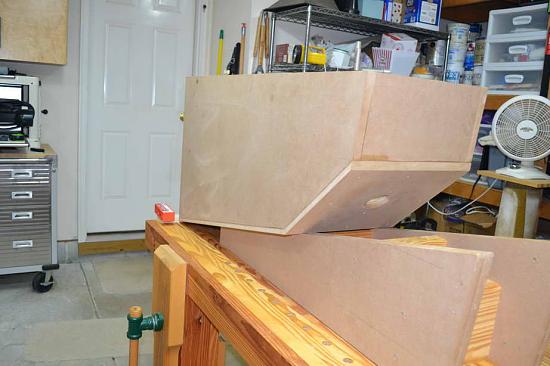

                    A duh moment

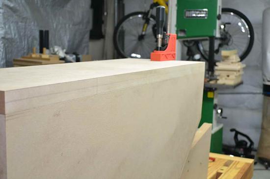

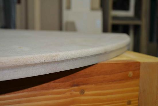

                    Went to put a 1/2" round over on a 1/2" thick board and come to the realization that there is no where for the guide bearing to sit on !! Had to make a template the same shape as side cladding to get around that.

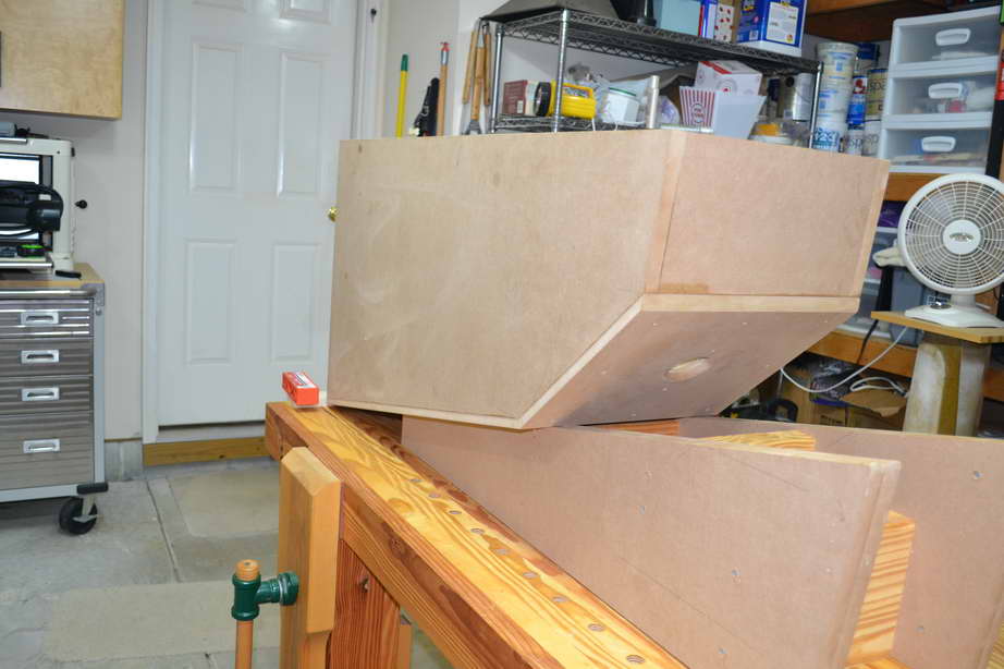

                    Quick look on the cabinet to see how it looks ...
                      • 16175
                      That is a familiar sort of feeling- "Duh!" moments! Innovation is the key to recovery, and you've got yours well under control! :W
                      • Paul K.
                        • Jul 2008
                        • 180
                        What you probably could have done was to use the same-shaped piece for the other side underneath the piece you wanted to round over, do that piece, then flip in over and round over the edge of the other piece. I've done exactly this before.
                        Paul
                          • 2140
                          Paul
                          Good idea Paul, I'll keep it in mind for the next time that I'm sure to to the same thing.

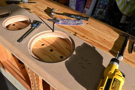

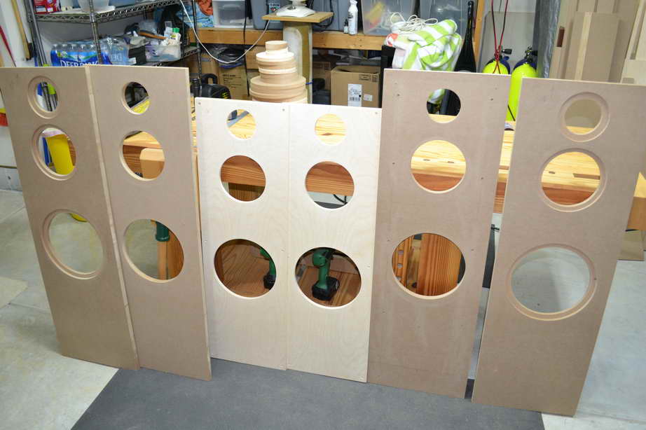

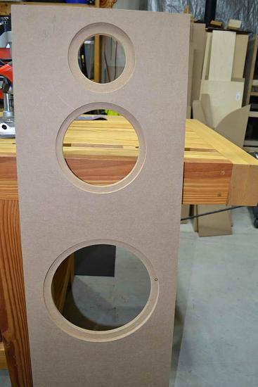

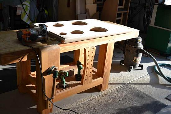

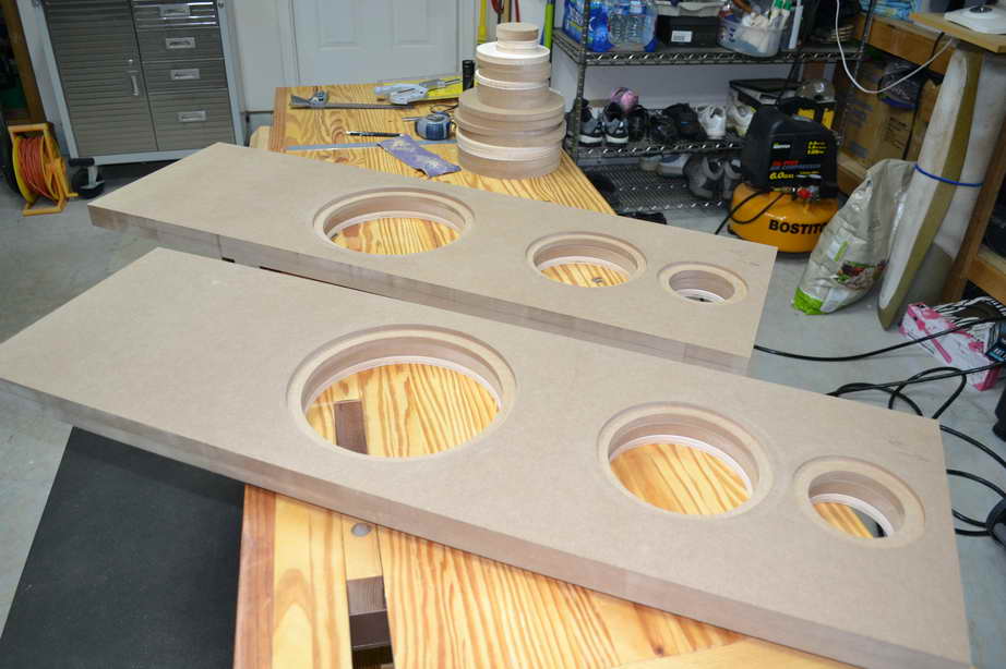

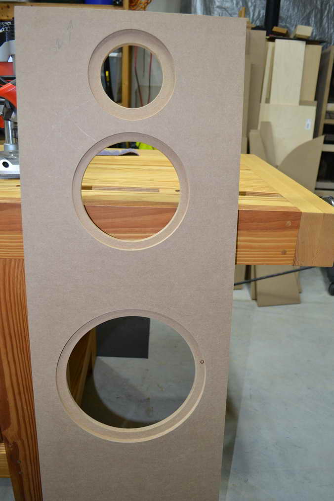

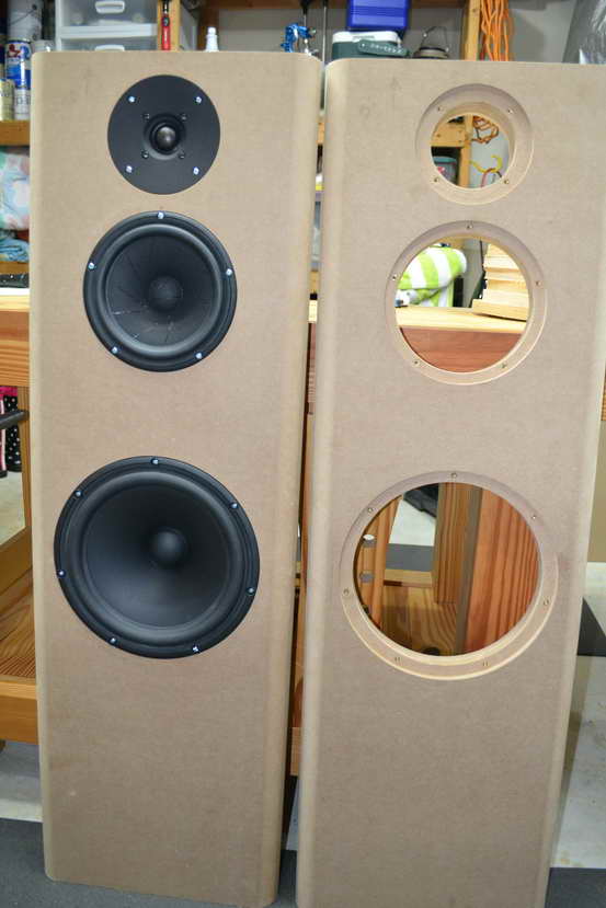

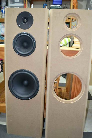

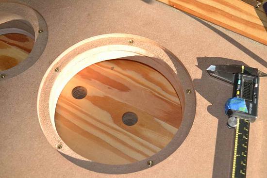

                            Circles and more circles...

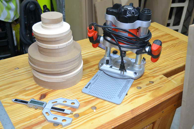

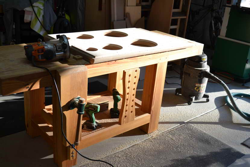

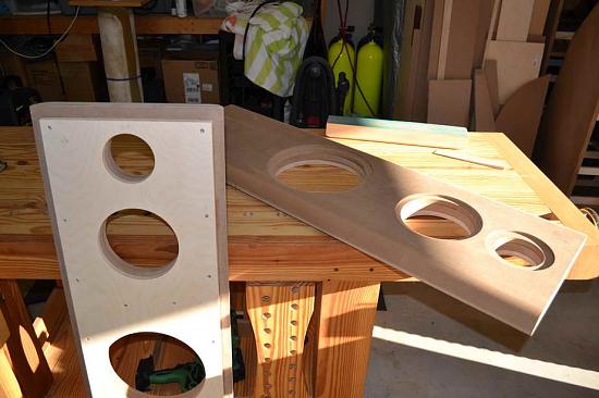

                            Continued with baffle work, had to get a larger Jasper jig for the woofer cutouts ....

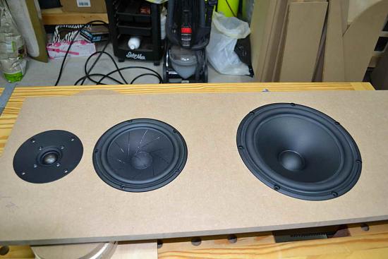

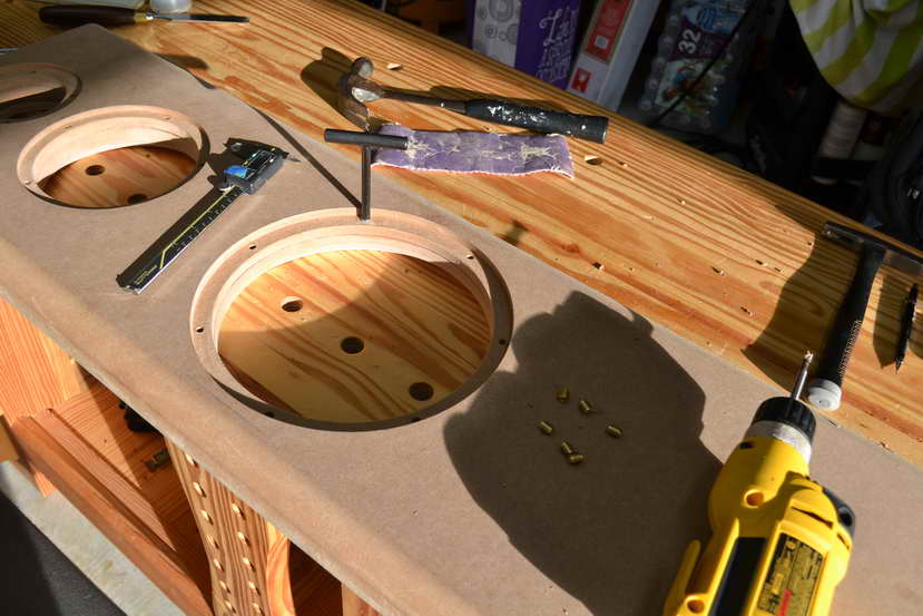

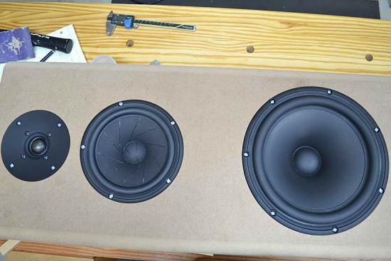

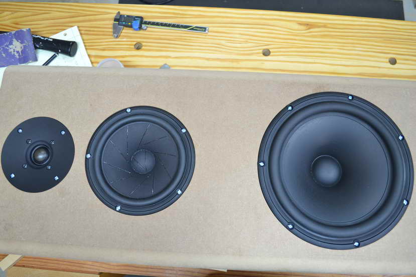

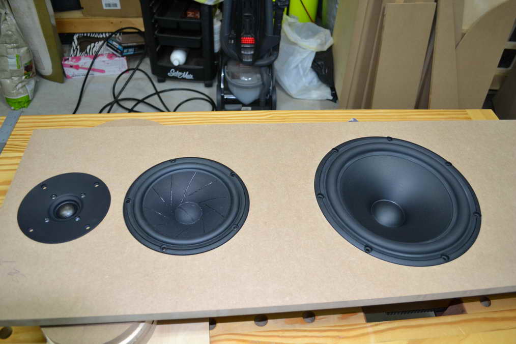

                            Checking the fit of the drivers .....

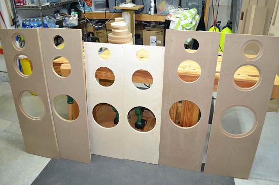

                            All of the layers done ....
                              Very nice work, Steve. I'm liking that heavy duty workbench! Did you build it?
                                • 2140
                                Thanks Hank. Yes I did build the workbench, other than time, it cost me less than a third to do it myself rather than buy one. It's a big jump up from saw horses and plywood to build things on. A 4" thick top with 5" square legs tend to stay where you put it, which is handy when trying to put things together.
                                Steve

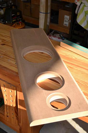

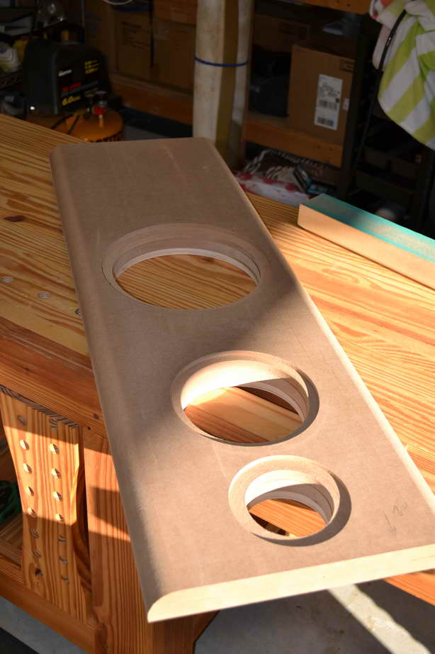

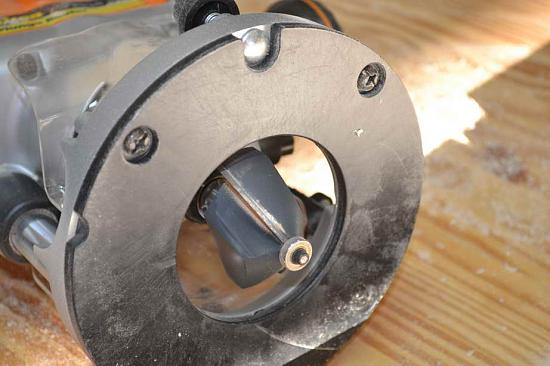

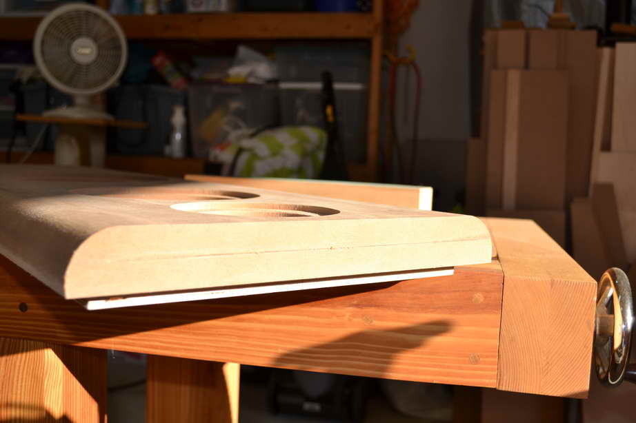

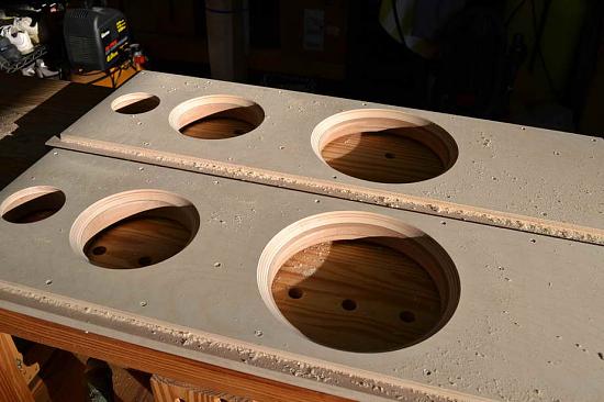

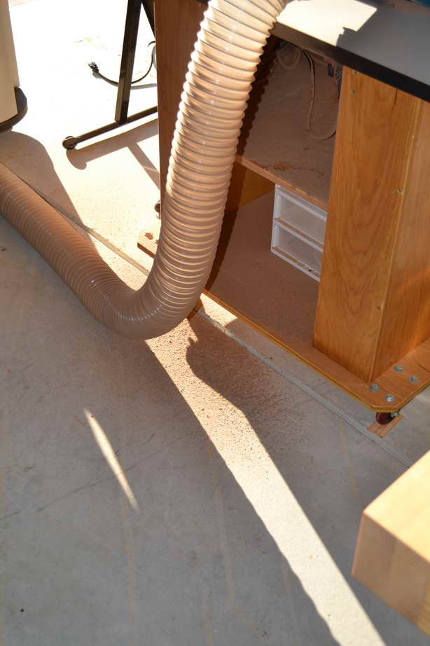

                                  Making a big mess ......

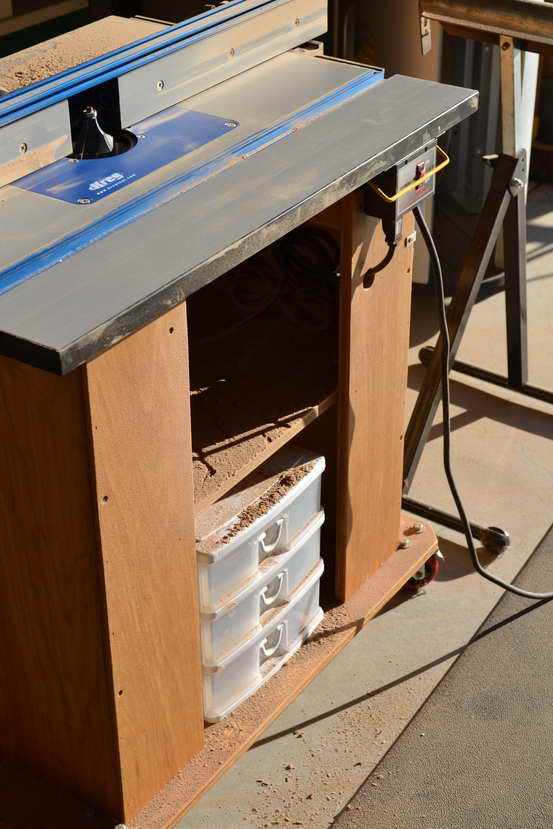

                                  After getting the baffles glued up, I put an 1 1/4" round over on the edges ..... talk about making a major mess of the garage !!!

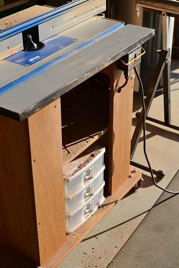

                                  Even though I used the dust collector I apparently need to make some modifications to my dust collection setup on the router table!

                                    That's a ridiculously large round over bit! Probably worth more than my entire router setup!
                                    Zaph SR-71
                                    Zaph ZDT 3.5
                                    Sunflower Redux
                                    12" Dayton HF sub
                                    CJD RS 150 MT
                                    Revelator bookshelf
                                    2x12 Guitar cab
                                    Corner loaded line array
                                      • 2140
                                      Actually not too bad, $39 at http://www.mlcswoodworking.com/shops...ound_over.html they have pretty good prices and free shipping on everything.
                                      • oneplustwo
                                        • Jan 2010
                                        • 666
                                        Hmm, I was thinking double that. Not bad at all. How many passes did you take to get to the final pass?

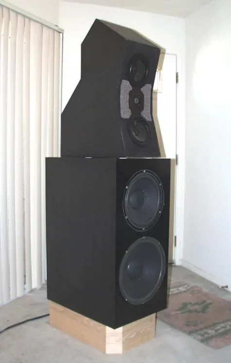

                                          • 16175
                                          MLCS is great, aren't they? I've got some of their big honkers, too, though the project idea I bought those for has been languishing a long time (line array's).
                                          And unbelievably, I even found a pic (though not on my current Mac).
                                          The woofer only assembly is:
                                          Well, I'm already running out of places to put stuff like this... so... umm, ermm, well, never say never...
                                          :rofl:

                                                Steve, I built my router table cabinet with a door to the router compartment that seals, and a 3" vac hose outlet on the back of that compartment - works great, along with a small hose outlet on my fence. With your skills, you could easily build and attach a door to your cab and add a hose outlet.
                                                Jon: have you considered doing that line array as Open Baffle, similar to young John's project?

                                                      Hank, Modifying the router table cabinet dust collection is now on the to-do list, along with a cyclone pre-stage for my dust collector that's been on the list. I have one of these http://www.rockler.com/product.cfm?page=11312 that I am thinking about attaching to the back of the cabinet with some quick disconnect clamps and then put in a tee with a smaller hose to the fence like your suggesting. What ever I do it has to go on and off quickey so I can change bits out easily.

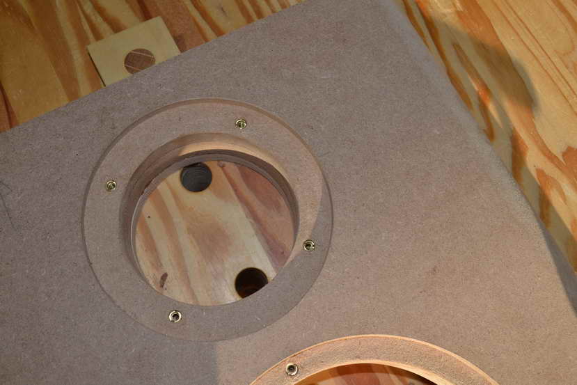

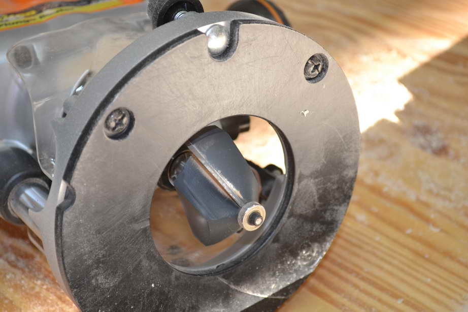

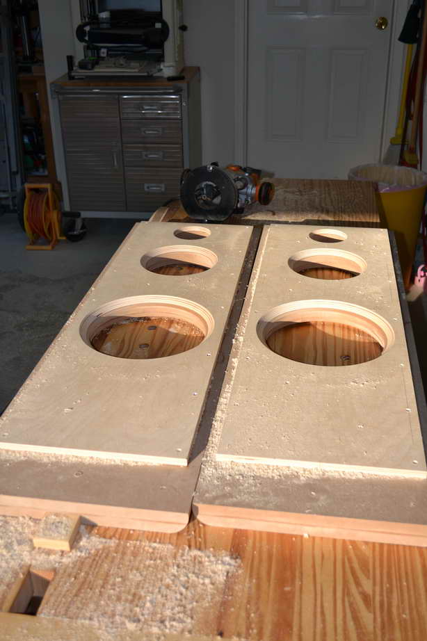

                                                          Another big mess

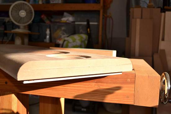

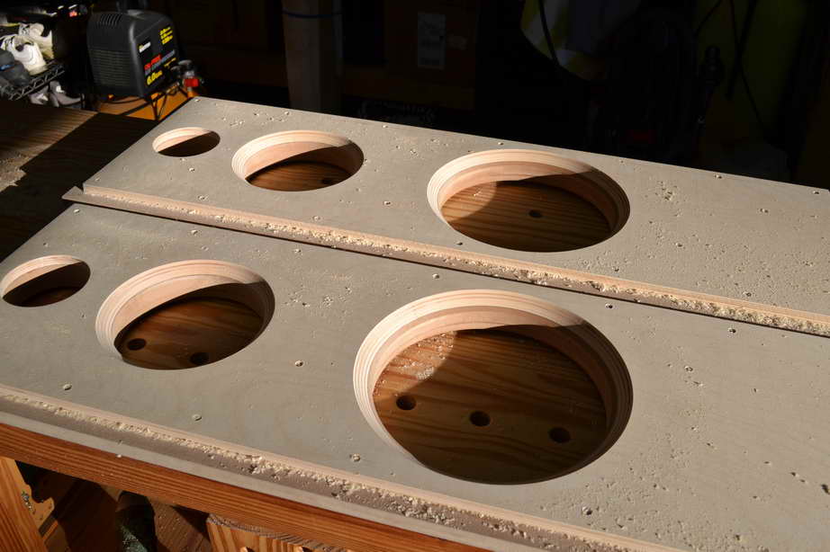

                                                          Another one of the big honking MLCS bits ......

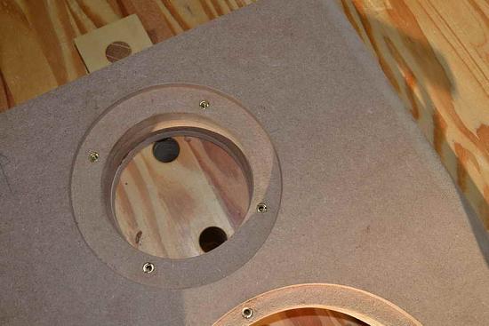

                                                          This time put a bevel on the back side of the mid and bass holes ....
                                                          And then the sawdust clean up ... again.

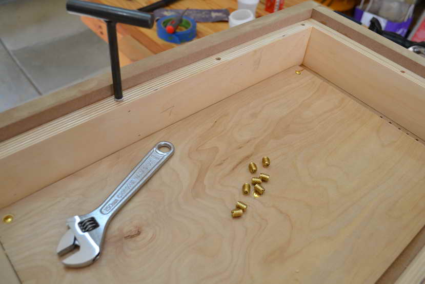

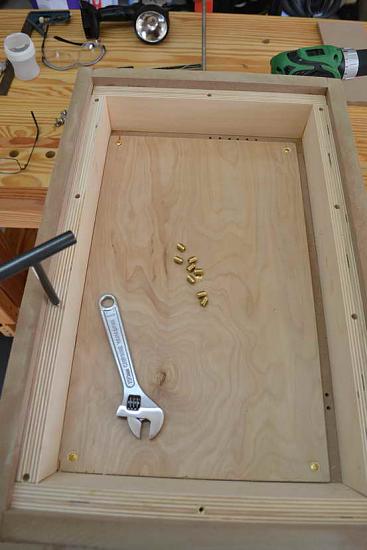

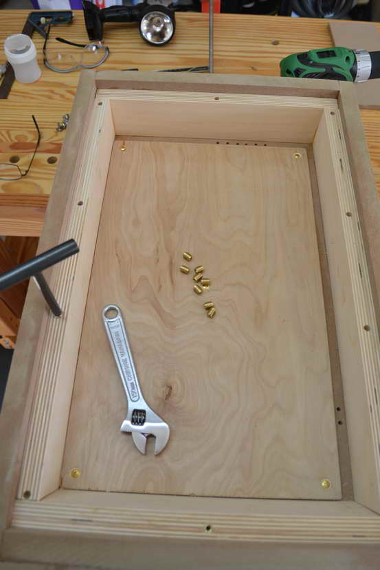

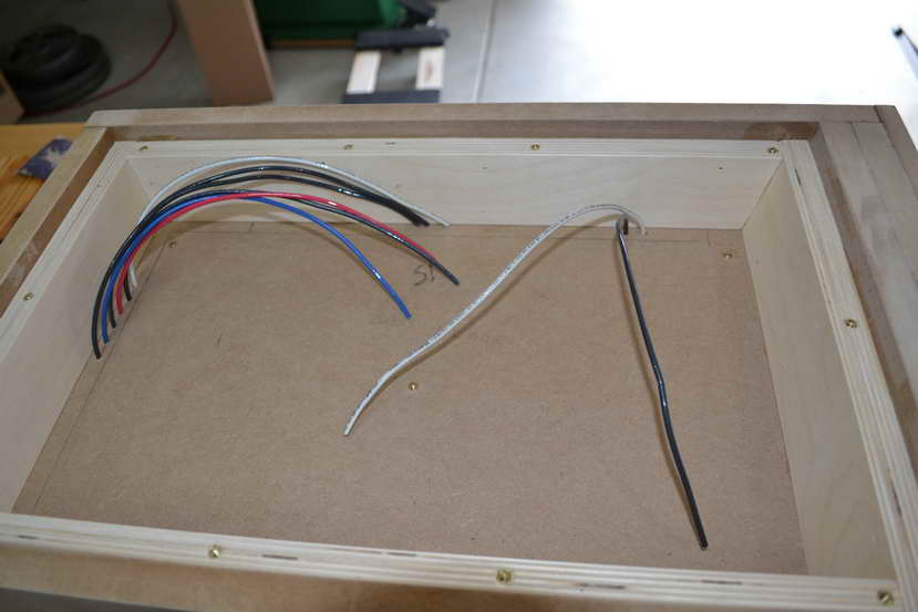

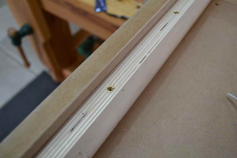

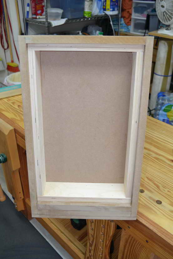

                                                                Working on the crossover compartment
                                                                Framing the crossover compartment with baltic birch plywood ..... I figured I would have less of an issue with splitting once I screwed in threaded inserts.
                                                                You can also see the crossover board that will hold the parts and the holes for feeding wiring in and out of the compartment .....

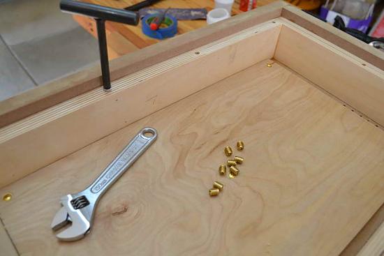

                                                                  For Jon ..... "fiddly bits"
                                                                  As Jon would call it, lots and lots of "fiddly bits". Between the baffles and the crossover compartment, 62 - 8/32" brass inserts ......
                                                                  Checking the fit ... for a change I got the inserts where they were supposed to be. Now I have to order some black screws from McMaster-Carr to blend in with the drivers.
                                                                    • 571
                                                                    Looking good :T Plenty of room for the x-over I see...mine is going to be a little tight.
                                                                      • 16175
                                                                      I don't know why, but it seems to happen to everyone, me included, that space for the crossover is the last thing that gets attention and planning... which can really bite you in the butt later on!

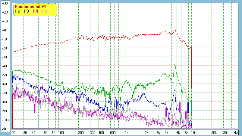

                                                                        Pretty much decided THESE will be the mid woofers, and it will be a corner system, monopole line array.
                                                                        Very smooth SPL response, and very low distortion.
                                                                        My apologies for the minor thread-jack!

                                                                          Nice job with the brass inserts- I've used those before, and as soft as they are, it's harder than you make it look!
                                                                            • 2140
                                                                            Thanks Jon .... The baltic birch was really nice to work with putting in the inserts. I was sweating it when it came to do the ones for the mid's, there was not a lot of material to work with since the holes where so close to the edge and mdf just seems to crumble if you mess with it too much.

                                                                              The x-over board is roughly 10" X 16" with ~ 2.5" of height to work with when the cover is in place, so I should have plenty of room. Just trying to decide what to glue the components in with, since their hanging upside down I want to make sure they stay where I put them.
                                                                                      • 16175
                                                                                      Originally posted by CraigJ
                                                                                      Hi Jon and sorry Steve for the continued hi jack,
                                                                                      Time for a little intervention;
                                                                                      Jon, Glad to hear that things are going very well with the :blonde: friend . But please, for the sake of the forum, don't ever mention that you'd like to build these for her (or yourself for that matter);
                                                                                      Click image for larger version  Name:	X1front.webp Views:	0 Size:	12.5 KB ID:	936744
                                                                                      Been there, done that, Hmmmm, about 14 years ago... all part of the learning curve! Sorry if I wasn't clear...
                                                                                      Those were my previous attempt at an Uber system- you know, the sort of thing I do about every decade and a half or so... :B
                                                                                      Usually the experience makes me acutely aware of my various limitations, yet does something intriguing, and sets a new benchmark of some sort. that was the case for these X1 Klones. Focal TC120 tweeters, Eton 7-360's (which amazingly you can STILL buy at Madisound! they've been around forever!) and Audax 13" and 15" pro woofers; monster drivers with huge magnets and fairly high sensitivity, but xmas, not so much. Made up for it with radiating area and a 6" port, like the original X1's.
                                                                                      I'm rather hoping that the current Isiris project will turn out a bit better, because I REALLY don't think I want to be building another monster system when I'm 75... but who knows? Maybe that would keep me young... or when I'd be ready for my third child hood?
                                                                                        We all have things from our past that should not be revisited. :roll:

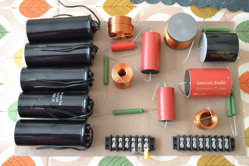

                                                                                            • 2140
                                                                                            No problem on the little detour, it keeps the post going until the next round of pictures ..... Here's a question to you get you back on track. Since I'm putting the x-overs in a some what confined area, I'm toying with the idea of putting some breathing slots in the bottom cover for a little cooling. Do you guys think it's worth the effort? Here's a couple of pictures of the covers ....
                                                                                            Here's a rough layout of the components that will be going in the area.
                                                                                            Here's the wiring that will do the in's and out's ....
