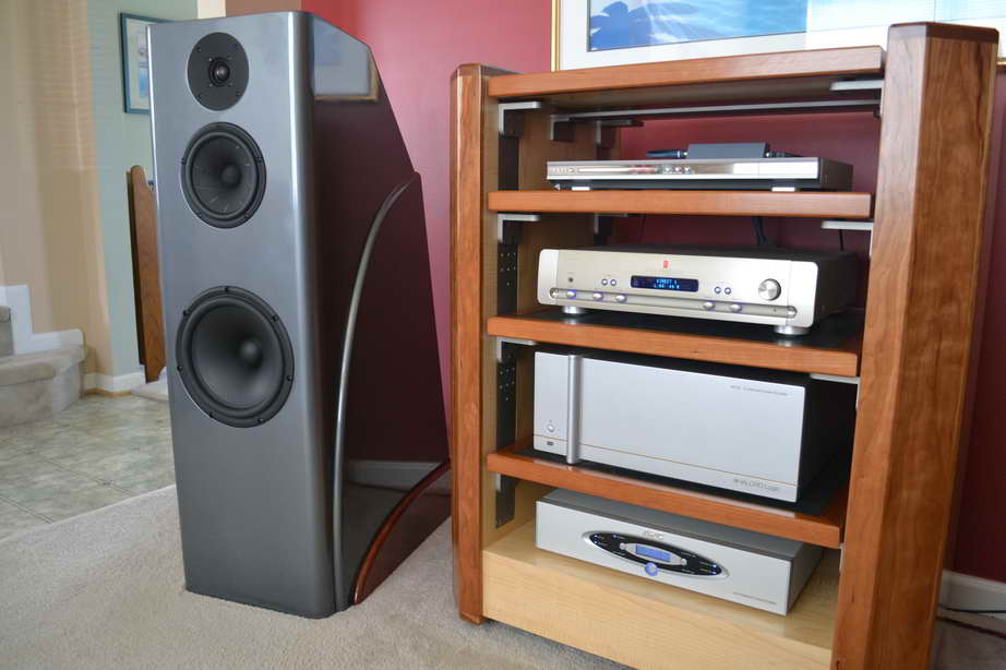

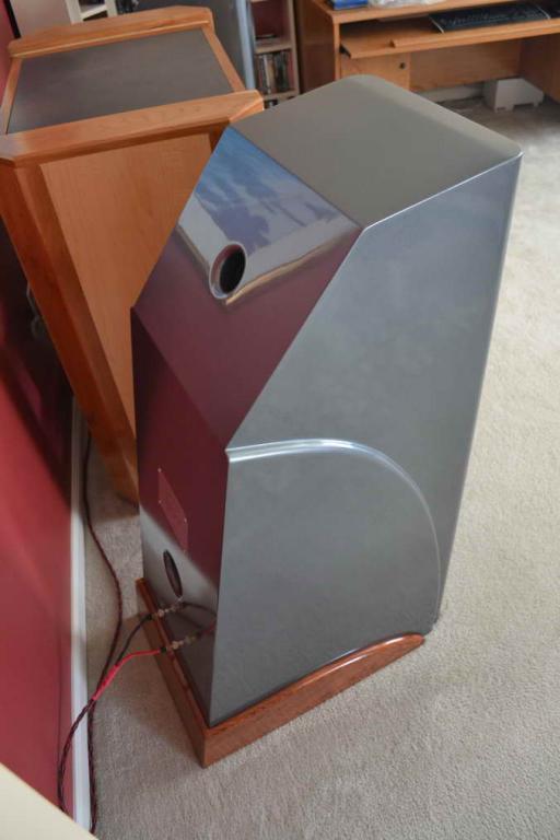

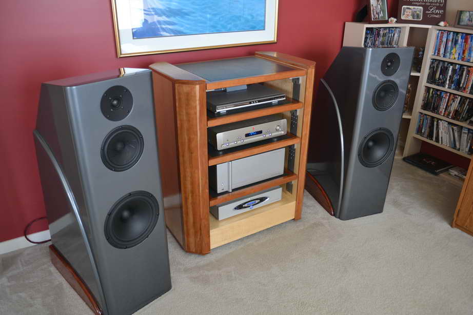

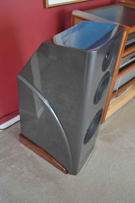

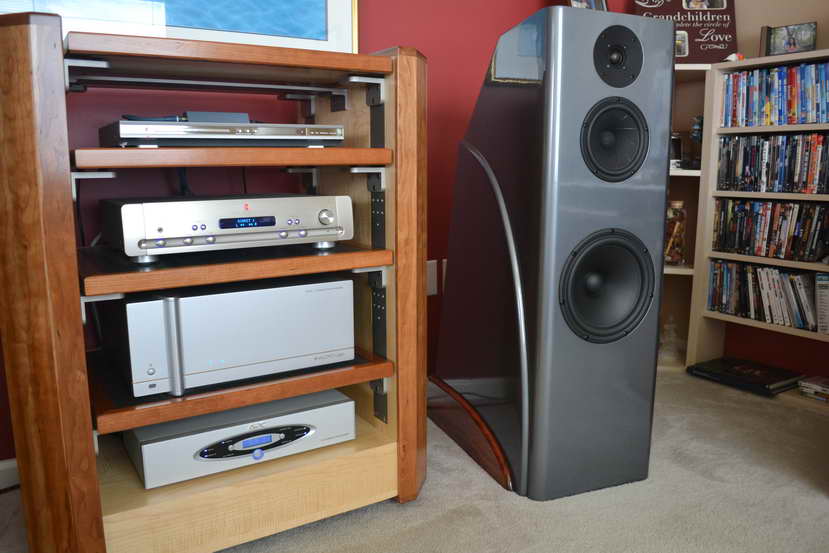

    With fingers crossed that the double checking of the crossovers paid off, I fired them up. Checked all of the drivers for sound, all was good, so I had a seat with my wife, a beer, and turned up the volume. Spent the next hour listening to various favorite tracks, had several goose bump moments, and deemed the last year worth of work a success.
    I'll post some comments on the sound later, it's been a long day at this point, but well worth it.

                  Steve, I Noticed you went ported for the 26w section and curious to know your impressions on the sound as Troels offers porting options but for his test sample went with aperiodic venting. He claimed that it provided a nice dry sound but doesn't say much if anything about the ported sound.
                    • 2140
                    #234
                    Thanks all for the kind words guys, it means a lot ...... I figured I'd pass along my initial thoughts on how they sound, since apparently inquiring minds want to know ..... understandably they will change a little after they settle in with some time on them. You will have to bear with me on this, I am in no means an expert on this stuff and as such can't give you the kind of review you would find in The Absolute Sound or some other magazines.
                    As sort of a preface, I have been listening to Jon's Modula MTM's for the last few years, so those of you that have built them or the Natalie's can use them as a reference point, much as I am.
                    An additional bit of information that I have picked up, and I'm sure many of you already know, just because you spend more money on this stuff (sometimes a lot more) does not mean that it will be proportionally better in sound, such is the case here. Do these speaker sound better than my MTM's?, yes they do, though they do not blow them out of the water, nice job on their design Jon!. Being a three way they do have the extended range you would expect. I picked ~1/2 lb per cubic foot for stuffing for the bass section, and so far that seems (to my ears anyway) like a good starting point. The bass does go considerably lower with the 10" drivers and port tuning than the MTM's, it's also nice and clean and tight, which makes me happy since I tend to prefer sealed cabinets for their bass generally. I believe my comment last night was these things have some "balls".
                    The sound top to bottom is very balanced with nothing really sticking out as it where. They have more detailed and a more open, airy quality overall than the MTM's, those pricier components better give you something is my thought!. Initial impressions where that the sound stage was wider as well.
                    These things do vocals amazingly ..... I was listening to Loreena McKennitt, "The Book of Secrets" - "The Mummers Dance" when she starts singing after the initial intro, her voice just appeared out of space and I was blown away, cool stuff. Miss Norah Jones, "Come Away with Me" was pretty impressive as well.
                    Instrumental is also done equally well, Jacques Loussier Plays Bach -The 50th Anniversary Edition -track 11 is some killer stuff ....... thanks turning me on to this guy Jon!.
                    Well anyway I'm pretty happy with the sound at this point. I would really love to hear these things in a better room, mine is far less than optimal, as well as a few component tweaks (a new NAD M51 to fill in for DAC and pre-amp duties comes to mind), but it is what it is at this point.
                    Hope this was at least somewhat helpful for those of you that were curious.
                    Steve

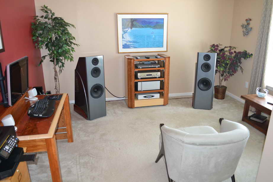

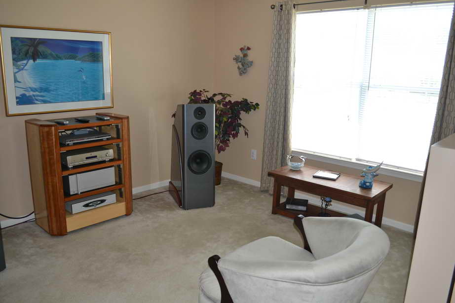

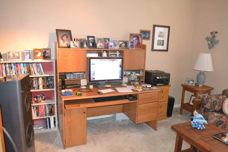

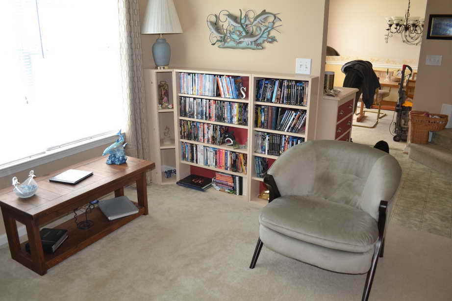

                                        Little Update ..... Room Acoustics
                                        I wanted to do a little update ...... not so much on the speakers themselves, but on a side project that got them sounding considerably better. My listening room/living room/computer room, you get the idea, is less than ideal acoustically shall we say. It is more or less square, 13' X 11' with a large opening to the left of where my speakers sat, and was rather crammed with furniture. Here are a few pictures of what it looked like when I first set up the 1071's:
                                        As one would expect imaging and staging where less than optimal and shifted to one side. I went about removing and replacing what was in the room.

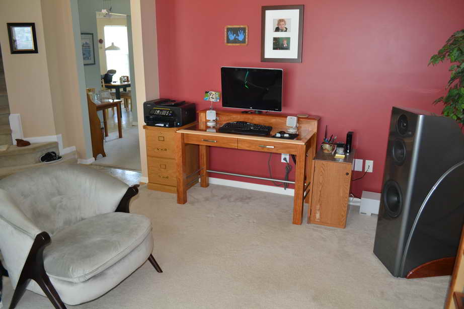

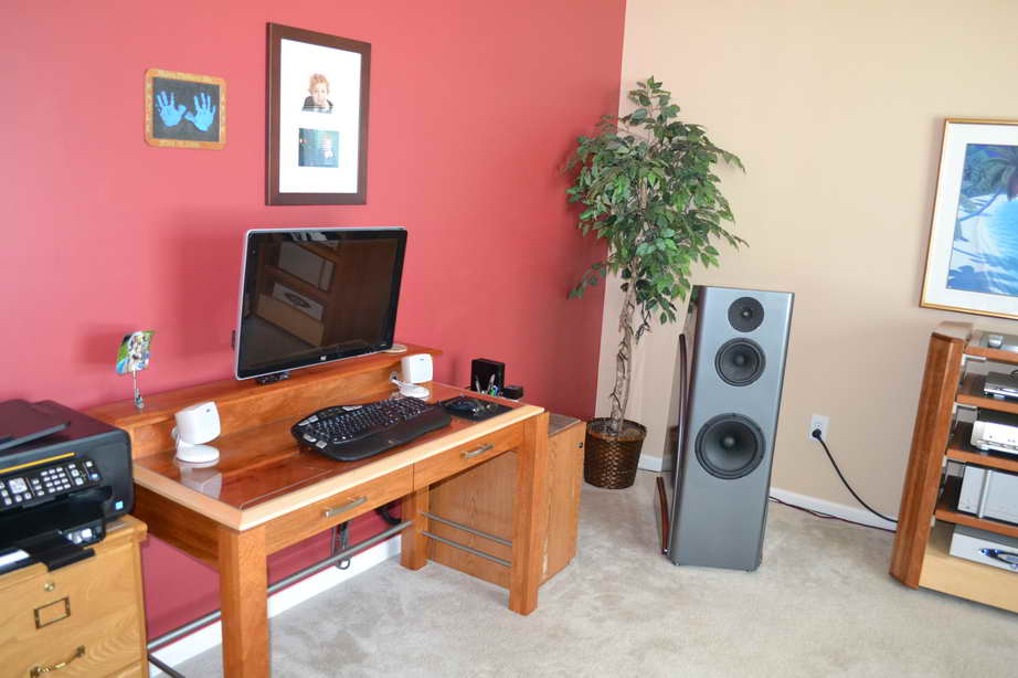

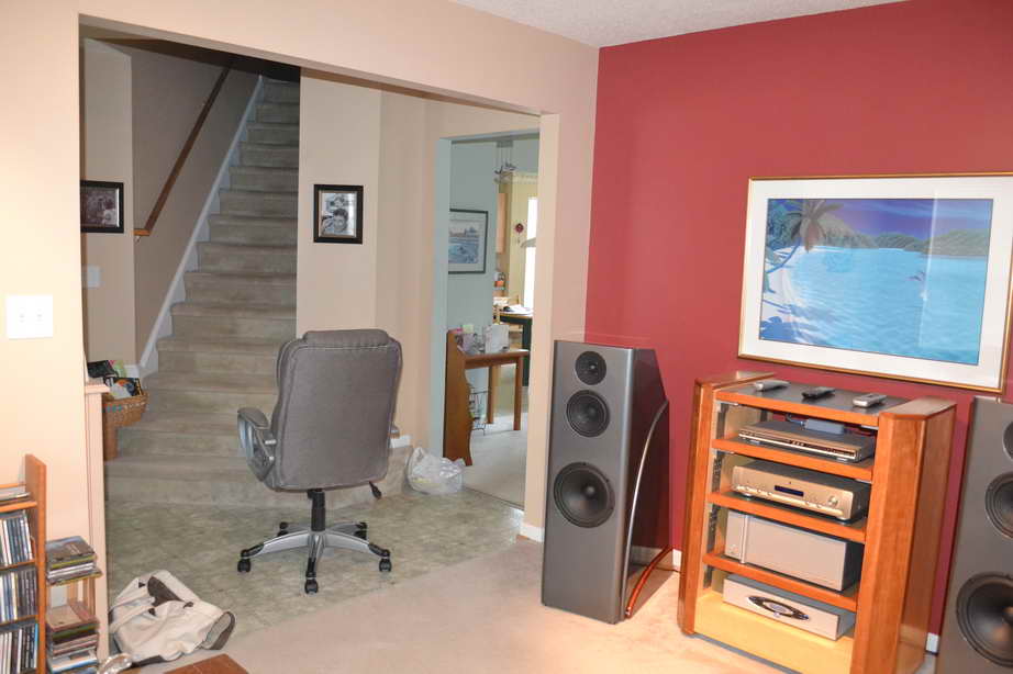

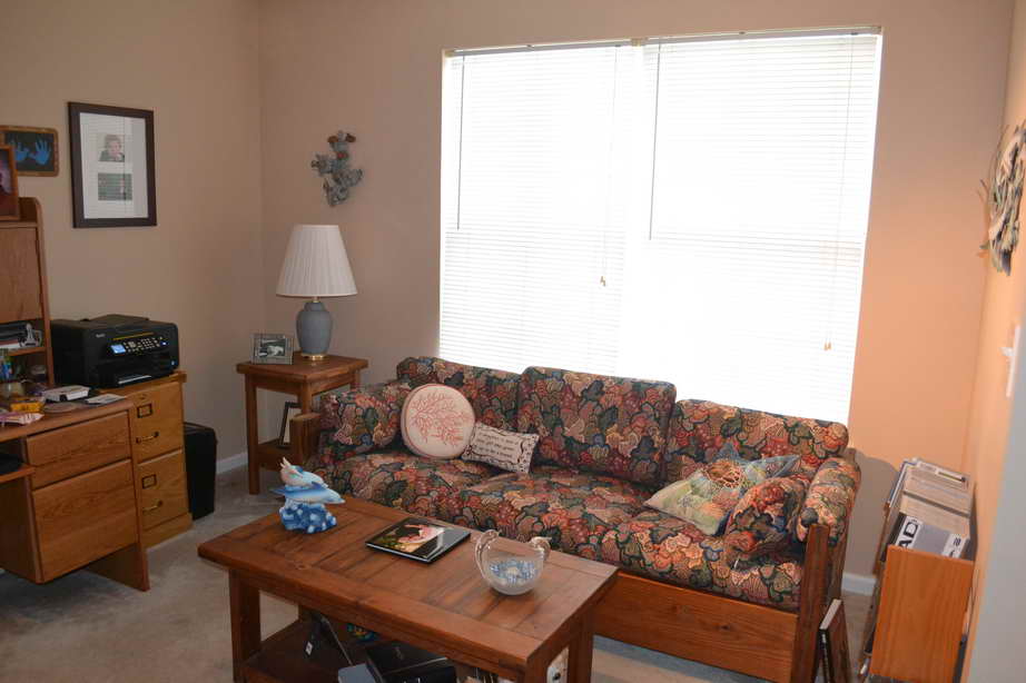

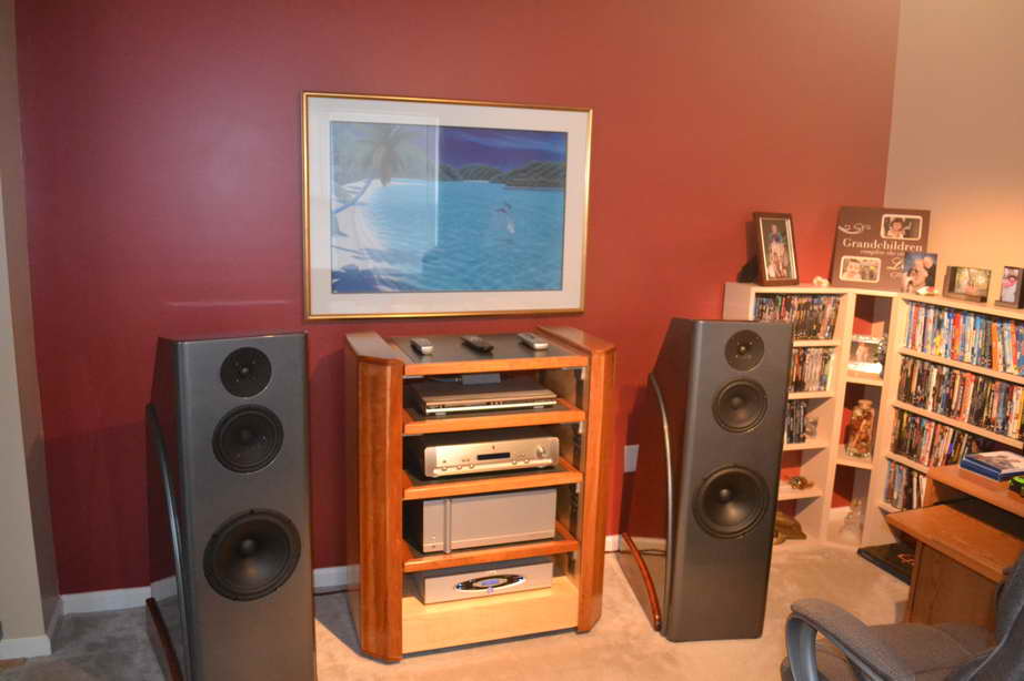

                                          Little Update ..... Room Acoustics, continued.
                                          I got rid of the very large and heavy couch and replaced the rather large computer desk with a new one that I built specifically for the room. I also rotated the setup 90 degrees in the room and set the system up on the long wall (such that it is). The plan was to add some room treatments (bass traps, reflection points, etc.) but that is on hold due to being laid off at the moment. Here is the new lay out:
                                          Even without acoustic treatments the change is very noticeable. Giving the speakers more room to breath and having them further out into the room and further apart really improved staging and imaging considerably. I setup the listening seat such that first reflections arrive after the incident sound which I think has helped until I can add some treatments at the first reflection points.

                                                      This is listening in what I would call a quasi-nearfield mode- you're close enough that the amplitude and level tends to over come the room contributions. This is how professional monitoring tends to be setup. You can get similar clarity and transmission of the recording gestalt in a more far-field situation, but then you MUST spend a lot of time sorting out the room acoustic and minimizing early reflections and comb filtering in the listening position response.
                                                        • 2140
                                                        #252
                                                        Your right about the playing around part. I've spent some time moving the listening seat and changing the speaker positions and angles and it does not take much to hear a difference. Until I put some treatments in place I think I'm going to live with what I have at the moment, which is certainly better than what I had.
                                                          #253

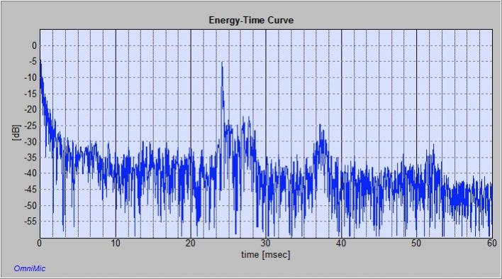

                                                              #255
                                                              Edit - I almost forgot to say, that I too sit with my speakers in a more equilateral triangle, rather than sitting further away and often surprise myself at the presentation. As my room isn't all that big the thing that gets me, is if I listen with my eyes shut it can sound as if I am somewhere much larger than I actually am and then I open my eyes after the CD finishes and I almost take a step back when I see how close the speakers actually are. A lot of the time you will see hifi magazines saying, I had the speakers ~3 meters apart and I listened at ~6 meters away, it makes me feel that I am sometimes doing it 'wrong' as per say, but getting the speakers further apart and sitting somewhat closer can be very enjoyable too.
                                                              Psycho-acoustically speaking, the room size is perceived by the delay of the first significant reflection.
                                                              Imagine being blindfolded in a room of unknown size. A second person starts a conversation. Your hearing sense is going to fixate on how long the time arrival delay is from the nearest wall vs that of of the direct path of the person talking.
                                                              I said this to say that the longer that first significant reflection delay is, the bigger the room will seem from a hearing point of view. This is an additional benefit in attenuating 1st reflection points when one acoustically treats the room. They are the earliest arriving substantial reflections.
                                                              To put this another way, if you can delay the first significant reflection to 25ms lets say, that translates to a path length of 28'.
Name:	04 07 14 ETC R.jpg
                                                              On a ETC, it would look something like this.
                                                              Just pointing out how one can make a room sound much bigger than it actually is.
