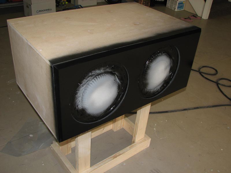

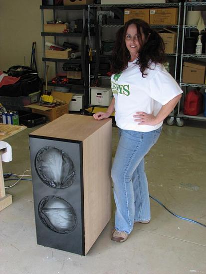

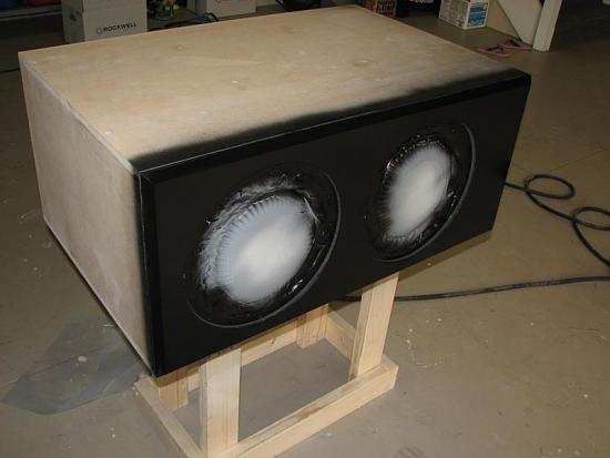

    I'm finally getting around to finishing my bass bins. They will be cherry veneer with piano black lacquer baffles. I don't have an air compressor yet, but I have been using my SCUBA tanks as an air source for the spray gun. Works like a charm.

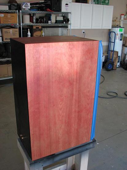

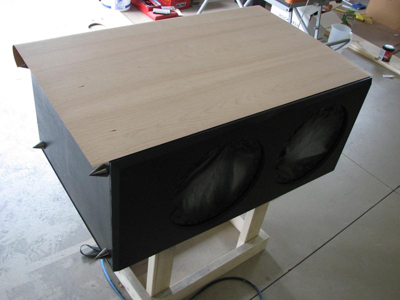

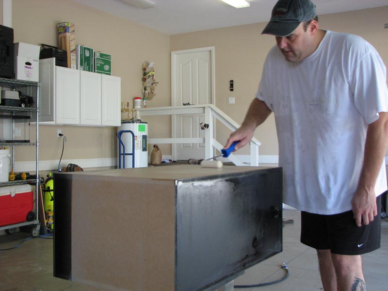

        Today I started applying the cherry veneer to the bass bins. I have never veneered anything so large before, but it all is going rather smoothly.
        Applying the glue with a foam roller.

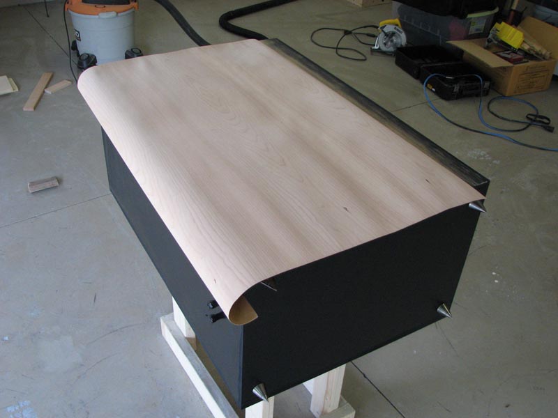

        The veneer wrinkles a bit after applying the glue.
        Ironing it on.

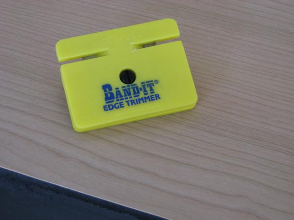

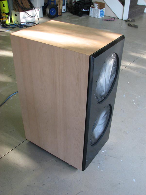

        Ready to trim. In the past I have always trimmed my veneer with a sharp x-acto knife and a straight edge, but because these are so big I am trying a veneer edge trimmer and a veneer saw. I'll see which one is easier.
        Last edited by theSven; 13 August 2023, 13:33 Sunday. Reason: Update image location

                • BigJim_inFLA
                  • 203

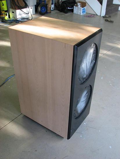

                  I use Titebond wood glue thinned 50:50 with water, goes on smooth and dries fast. Once it is dry its easy to position the veneer where you want it before bonding it by ironing. When you veneer get one of these...

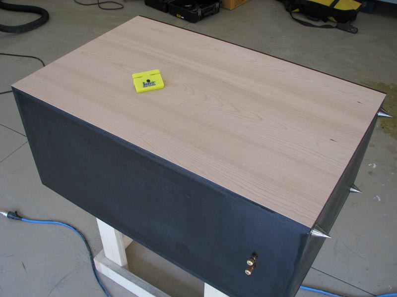

                  makes trimming a breeze. Easily saved me hours over the way I used to do it. Had the whole thing trimmed in just a few minutes, and only needed a bit of sanding to get it just right.
                  Finished with veneer.

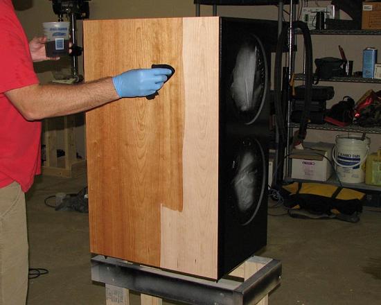

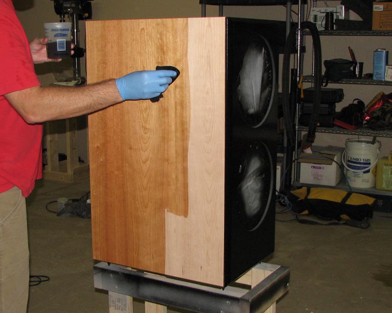

                    Putting on the first coat of boiled linseed oil.
                    I had some left over cherry veneer from when I built my Nat P's that was big enough for the tops and got new for the sides. The older cherry is a bit darker than the new. It is not quite as noticeable as in this picture, but it is darker. I'm hoping it will even out over time.
                    Last edited by theSven; 13 August 2023, 13:35 Sunday. Reason: Update image location

                        • BigJim_inFLA
                          • 203
                          When I first built my Nat P's everyone I asked told me the cherry would darken over time due to UV exposure. I did a number of test panels to decide how I wanted to finish them and ended up using a little bit of red dye, just a tiny bit actually, in the shellac to darken then up a bit. If I knew they would have ended up looking like the tops of these cabinets I might have forgone the dye. Too late now as I will try to match these to the Nat P's that will be sitting on top of them. Here is a pic of the Nat P when it was newly finished, just after completing the bass bin build in March of 2007. (yes it really has taken me three and a half years to get around to finishing these.)
                          I will take a pic of how they look now and post to show how much darker they have gotten in 3 years, it is quite noticeable.
                          Last edited by theSven; 13 August 2023, 13:36 Sunday. Reason: Update image location

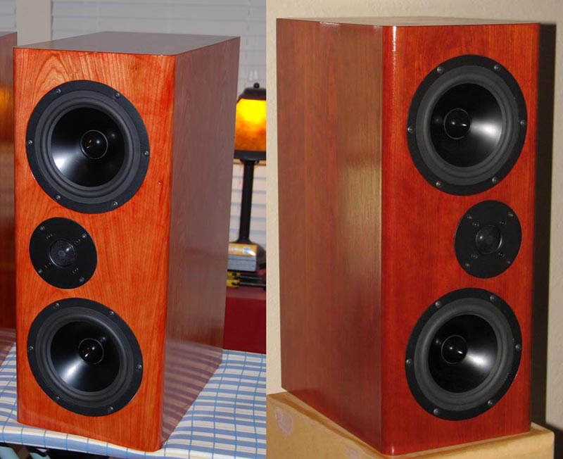

                            Here is a pic of the cherry veneer as it looked just after finishing, on the left, and a pic taken this morning on the right.
                            They have darkened quite a bit in 3 years or so.
                              Yes any real natural wood will darken with age. Some people are horrified at a new finish, but you have to explain to them it will change over time.

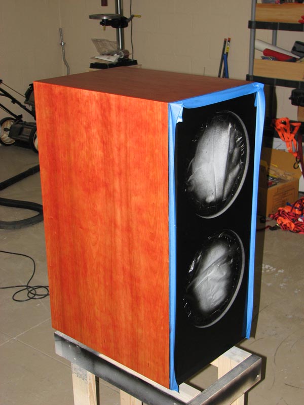

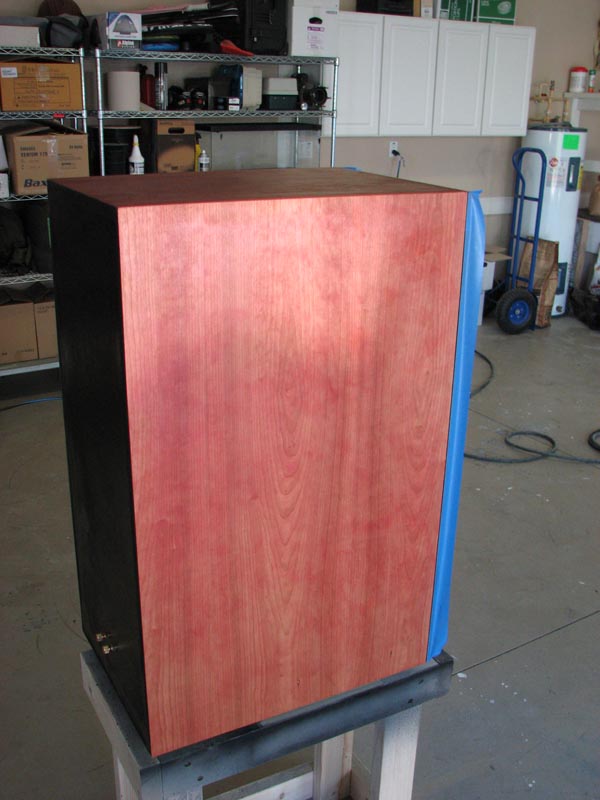

                                A little more progress today. I padded on two coats of shellac...
                                then started with the first of a few coats of polyurethane.
                                Hopefully they will be done before I have to start back to work on Wednesday.

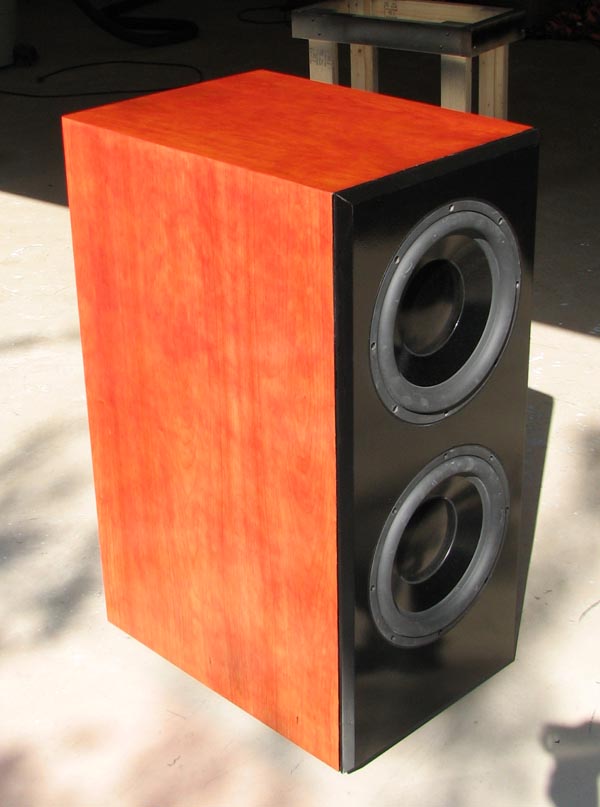

                                  • BigJim_inFLA
                                    • 203

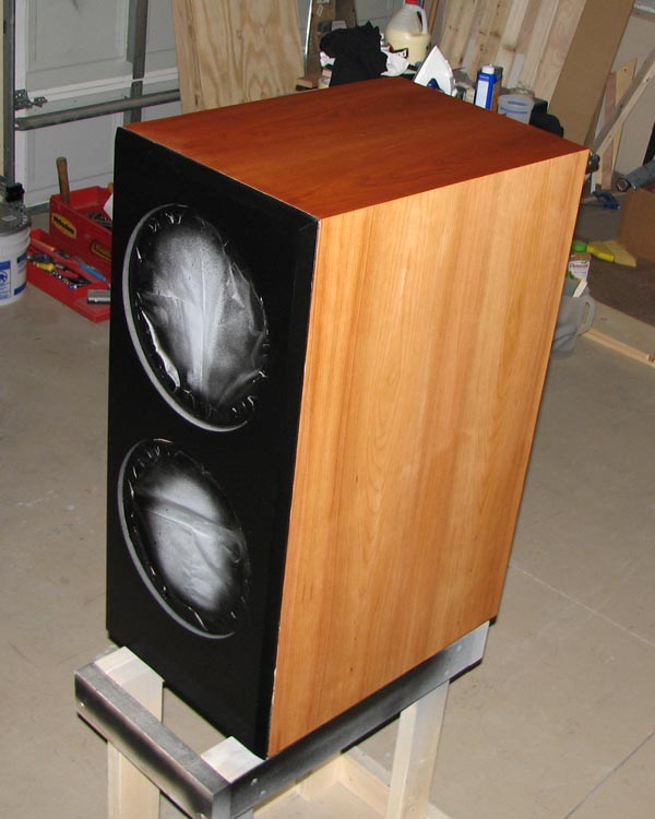

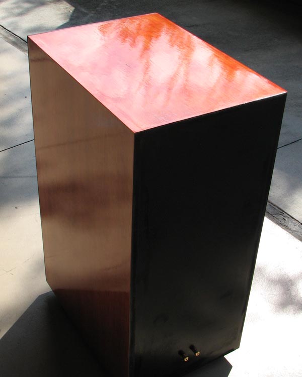

                                    DONE! No crossovers, actively crossed with Behringer CX2310. I had the driver cutouts swell once before so now I always sand them a little oversize before I paint.
                                      Looks good!
                                        Looks great! Just wipe off the surround and they'll be perfect.
