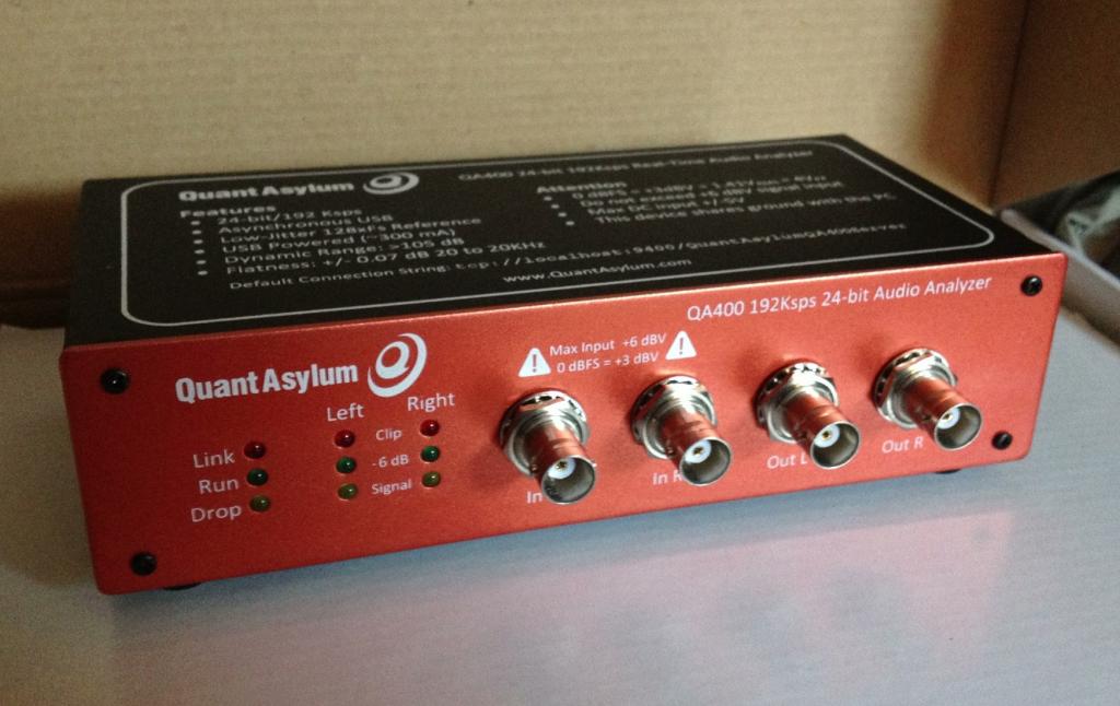

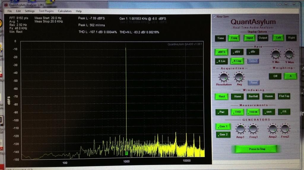

            Well, my Quant Asylum audio analyzer came Monday. It's a nice looking unit and they got it out to me real quick. Going to download the software on my computer and see if I can get it working.

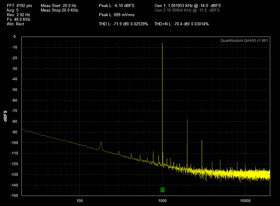

                I LOVE how intuitive and easy it is to set up this Quant Asylum QA400. One page of instructions (12pt type) takes care of software installation, calibration, and measurement taking! It's all right there in front of you ... no hidden menus, technical jargon, confusing instructions.
                It works as advertised ... here is the distortion in loop-back mode:
                John unk:
                  • 1913
                  #413

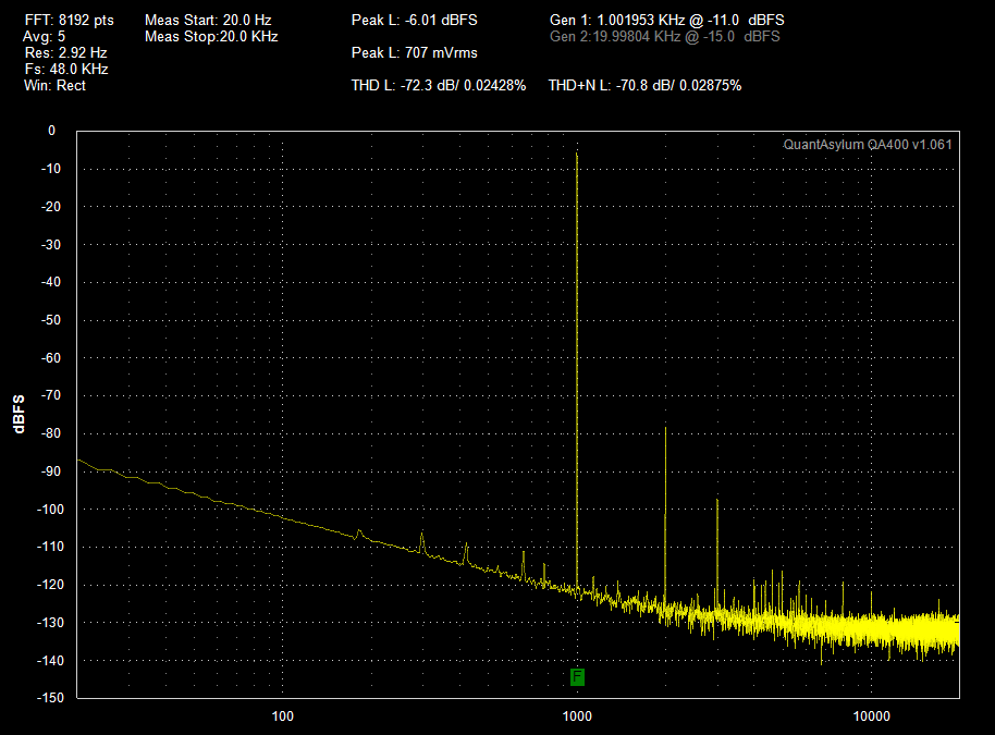

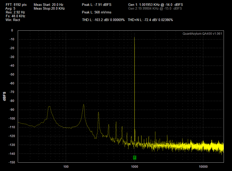

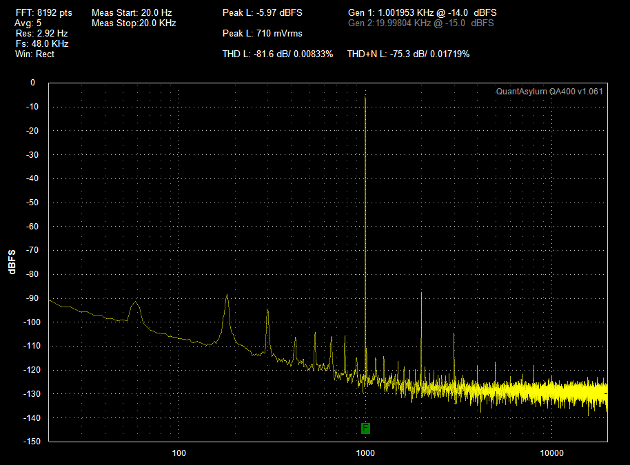

                  Well, I measured the distortion 0.024% at 1V (0.707 VRMS), and you know, it could be better. At least it's mostly 2nd and 3rd harmonic. May try a slightly higher bias on the JFETs so that's it's closer to the Idss. I'll take another measurement at less voltage and see what happens with distortion.

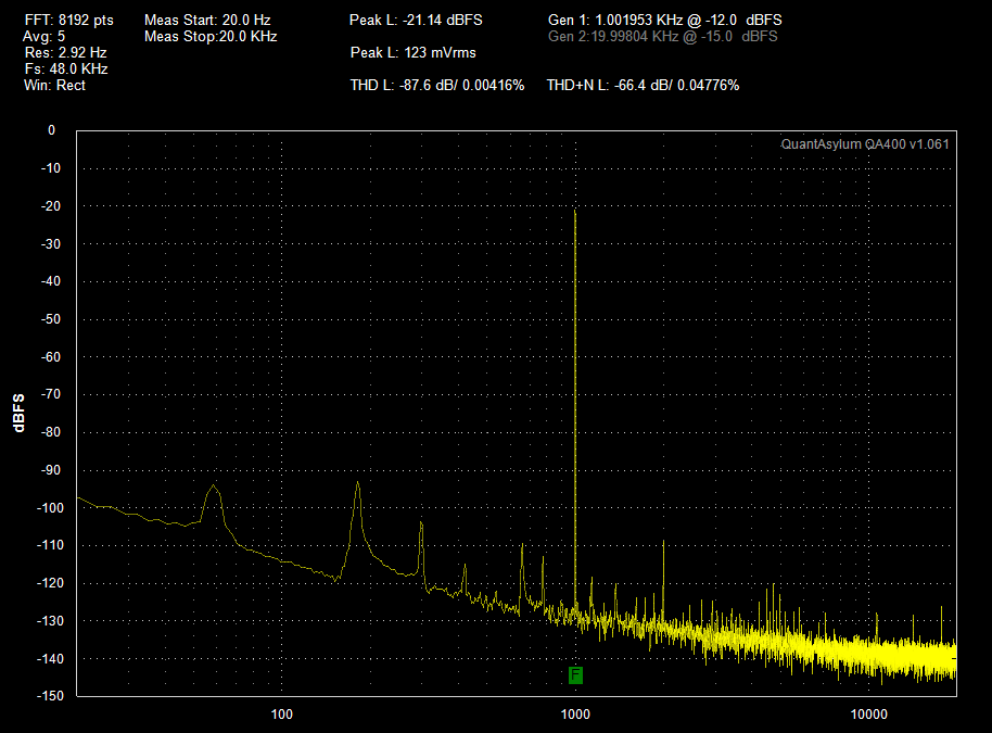

                    Here's another distortion measurement I took, this time at 0.174 volts (0.123 VRMS). As expected the distortion is less, 0.004 percent. But I think I'll try upping the bias on one or two of the JFET buffers by putting a 20-30 ohm resistor in parallel with the 10 ohm one already there, and see what that does.

                      I increased the bias on the JFET buffer on the equalization stage before the op amp. Then I measured the distortion after the op amp and it has really low distortion now ... 0.00069 percent! Mostly 2nd and 3rd harmonic and close the distortion of the analyzer itself. The sweet spot for the Analyzer distortion seems to be around -8dB. A lot of the noise just has to do with changes in my measurement setup, as the lid won't completely close because of measurement cables. Still I should work more on the low frequency noise from the power supply.

                        (note the graph I posted above) So, since the increased bias helped so much on the JFET buffers on equalization stage, I need to order more 22.1 ohm resistors for the crossover JFET buffers. Overall the distortion should be quit low now, at least that's what I'm hopping for.
                        EDIT: just remembered the op amp provides a gain of 5 (14dB) so the JFET is operating at a much low output voltage which will affect disortion. Will just have to see what happens when I get the new parts installed.

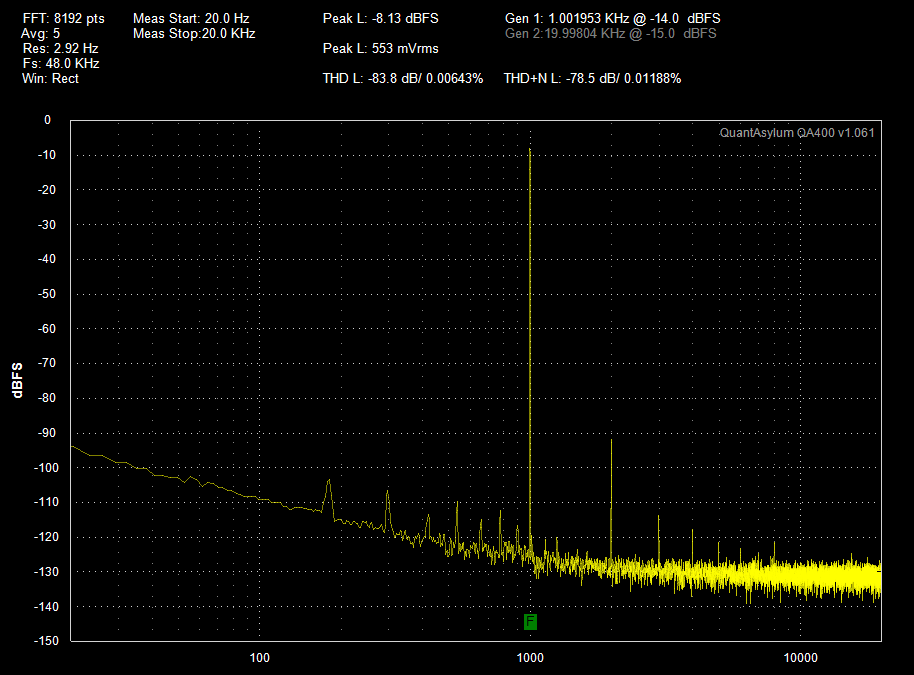

                          Okay, the resistors came and I increased the bias current on all the JFET buffers. It made no difference in the distortion as you can see. I don't know, any opinions out there???!!! I think, JFETs make sense at the input, but I think I'm going to redo the crossover section with the LME49722 opamp. I have some more of my hybrid surface mount generic PCBs that have a pads for the surface mount op amps, so will use one of those.
                            Here's an opinion - you're orders of magnitude below the distortion of your drivers, and above 5kHz, in the range of your measuring instrument's noise floor. So you can stop worrying about distortion in your crossover, and worry about other things
                              • 1913
                              #419
                              Yeah, good point. I was just expecting distortion at around 0.01% or lower at 1 volt, for some reason. I could cascode the current source which would lower distortion. I know 2nd and 3rd harmonic distortion is not easily audible though and might make the sound more pleasant? Anyhow, will think about it.
                              John unk:

                                Light Bulb!!! if I put the EQ/gain stage after the crossover stage, instead of the input stage, the JFETs will operate in their low distortion region even at the maximum amp input voltage of 2.5 volts peak. I'm so happy!!!

                                    Hi Jon, I hope your free time starts expanding soon! I rewired the crossover already and here are the results ... slightly more noise partly because of the rewiring (longer wires) and partly because the op amp is amplifying more of the circuit noise. But, distortion is much lower now.
                                    EDIT: I think the higher order harmonics are just the test setup, and they show up at about -6 dB where the higher order harmonics are supposed to rise on the distortion analyzer. Those harmonics disappear at -8dB.

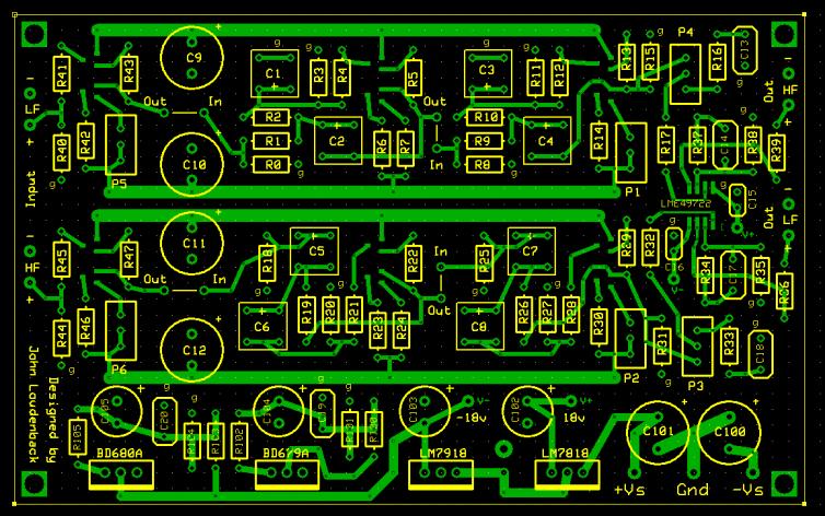

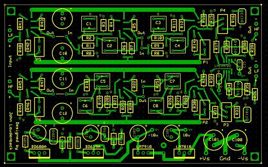

                                              Okay, got the PCB done but still checking it over tooth and nail, and have found a couple errors I corrected.
                                              Last edited by theSven; 11 January 2025, 16:58 Saturday. Reason: Attach image inline

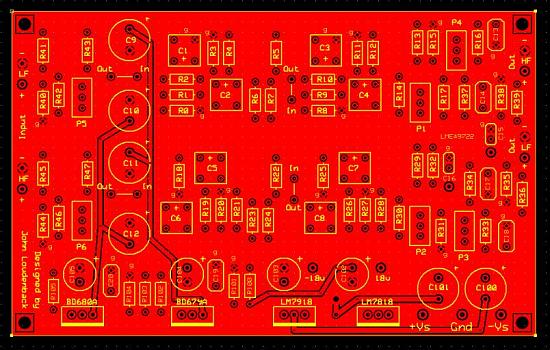

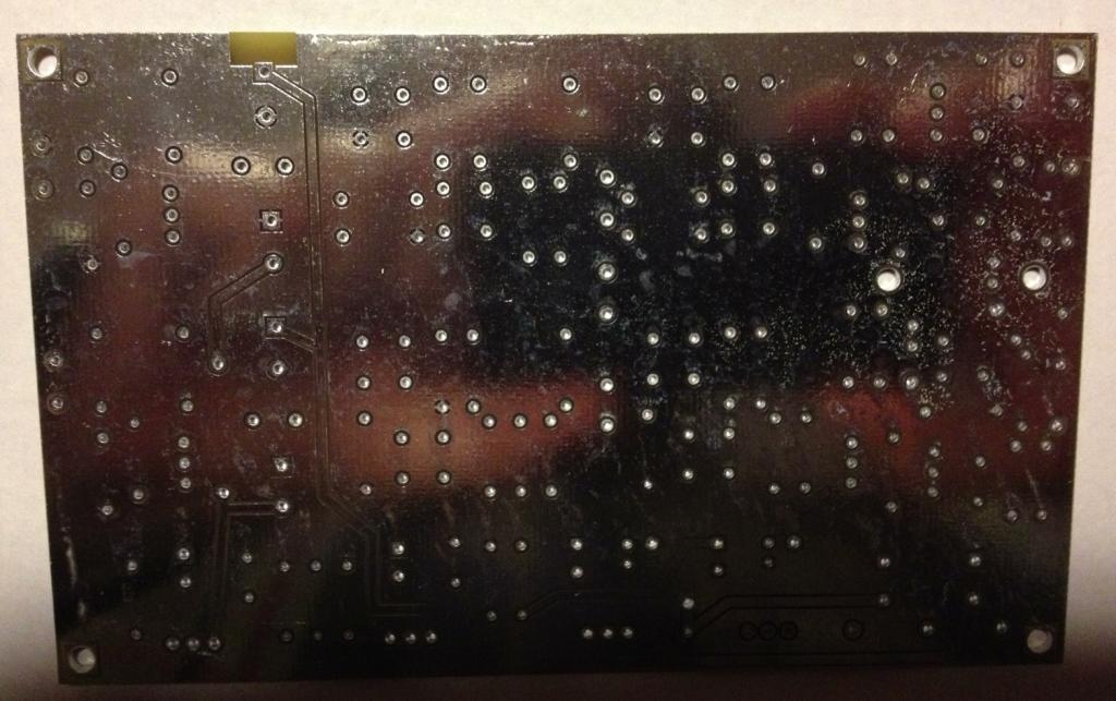

                                                Here is the top layer ground plain, with some needed power supply traces.

                                                  Lookin' good, John. That hole below and to the left of C102 on the ground plane - is that a through-hole or for a component lead?
                                                    #430
                                                    I'm curious about some of your routing choices, where you're sometimes branching to connect multiple components to a trace, other times not bothering.
                                                    IN>R25>C7 being the most curious to me, but R13/R15>P4 also - and others.
                                                    R130/R131/C20 lineup seems odd too - sometimes routing through a through-hole, sometimes branching off a main.
                                                    Why? I have only internet training (i.e. none at all of any particular value, probably) so this I'm not trying to say anything is wrong here, I just don't understand.
                                                    I admit the use of random angles bugs me too, though I have no idea why.
                                                    It's tough for me to follow due to the lack of screen for the surface mount components.
                                                    If it sounds good, that's what matters I think.
                                                      • 16203
                                                      #431
                                                      John, does your software use net list tracking from schematics to PCB? That's the best way to assure proper connectivity of a completed board. Stuff I have to do at work is far to complex to do otherwise, but even a "simple" electronic crossover circuit like this is not so simple.
                                                        • 1913
                                                        #432
                                                        Oh, no component there, that is just where the power ground is connected to the ground plane. I put it close to the regulator ground for lower impedance ground, and less noise.
                                                        I'll label it as such on the silkscreen layer.
                                                          Good catch, well what you're seeing there is my own ambivalence about whether or not it's a good idea to run a trace through a component pad. I've decided it doesn't matter and I think I'll clean it up a bit. Sometimes I have traces at weird angles so the trace is father away from adjacent traces or to keep the trace length shorter. Just don't want any possibility of interference or stray capacitance problems.
                                                          John unk:
                                                            • 1913
                                                            #434
                                                            Very good point. It does have net list tracking of schematics to PCBs. It doesn't support automatic routing though. With a different circuit, I tried doing a schematic once and then producing a PCB from the schematic and it didn't work out as expected. I'll have to look into that more. I think I'll be alright with this though. Going over it very carefully.

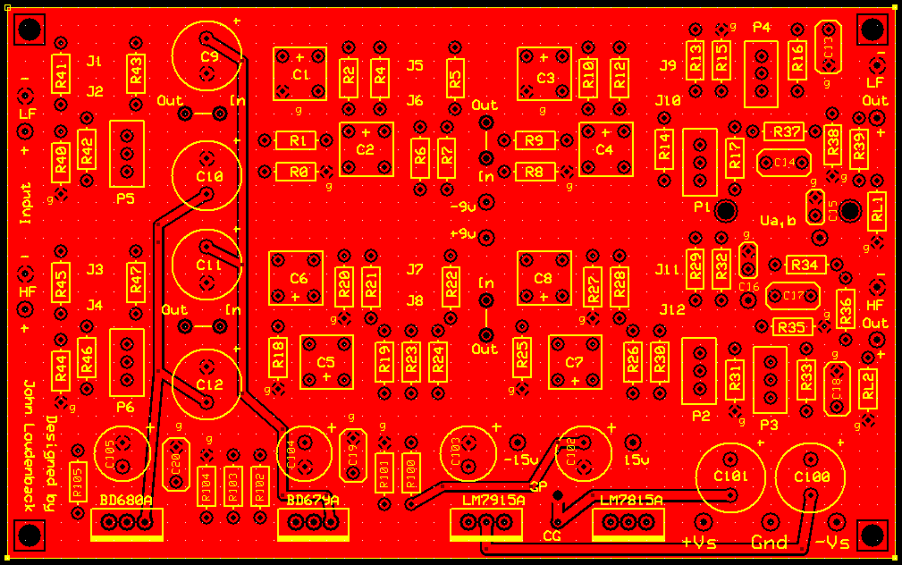

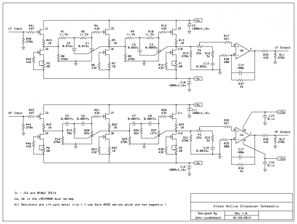

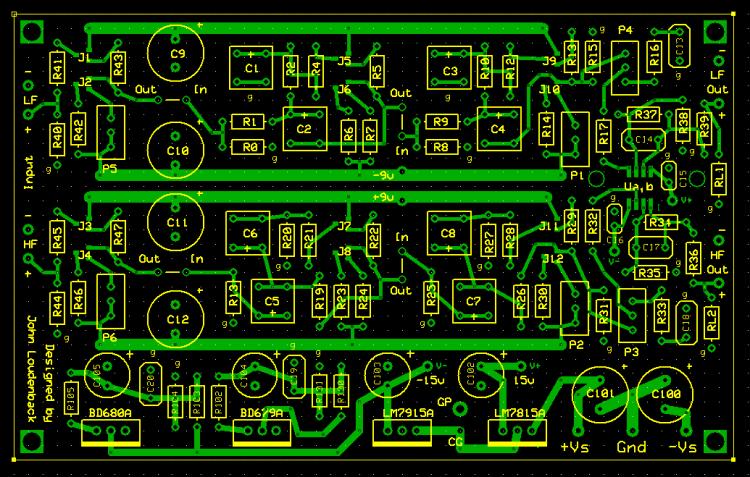

                                                              I've checked out the PCB, made some more adjustments with layout of parts, with short trace paths. Still working on drawing the power supply schematic and will post that soon. I also changed some parts. I'm using the LM7815A and LM7915A positive and negative regulators now as they have lower noise, and will keep the opamp cooler as it won't have dissipate as much power.
                                                              I changed the dual opamp to LME49880 with JFET inputs. It has very similar performance and I've heard very good reports about it's use in crossover circuits. Someone mentioned on DIY that the distortion LME49720 rises significantly with much resistance at it's inputs, which my EQ filter has below 1KHz.
                                                              Schematic -

                                                              Bottom Layer and Silkscreen -
                                                              Top Layer and Silkscreen -
                                                              John unk:

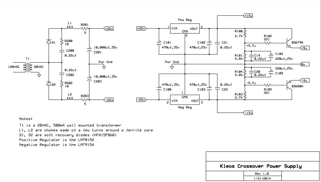

                                                                Okay, got the power supply schematic done. So I guess that does it!
                                                                EDIT: oh yeah, the unregulated supply on the left is not on the board! I'm not doing a board for that.

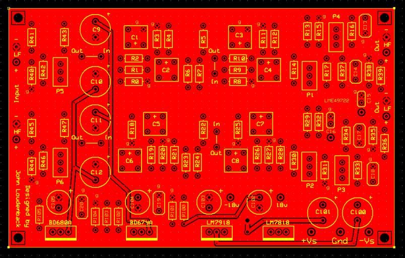

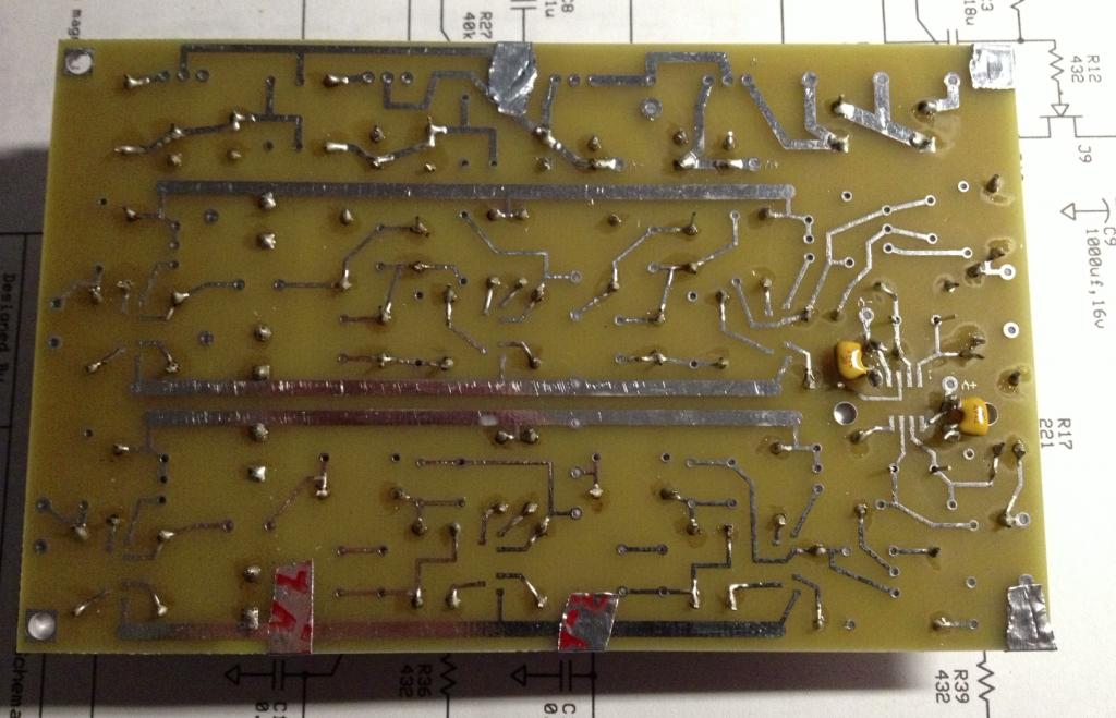

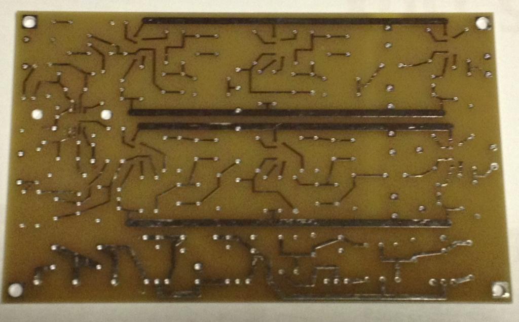

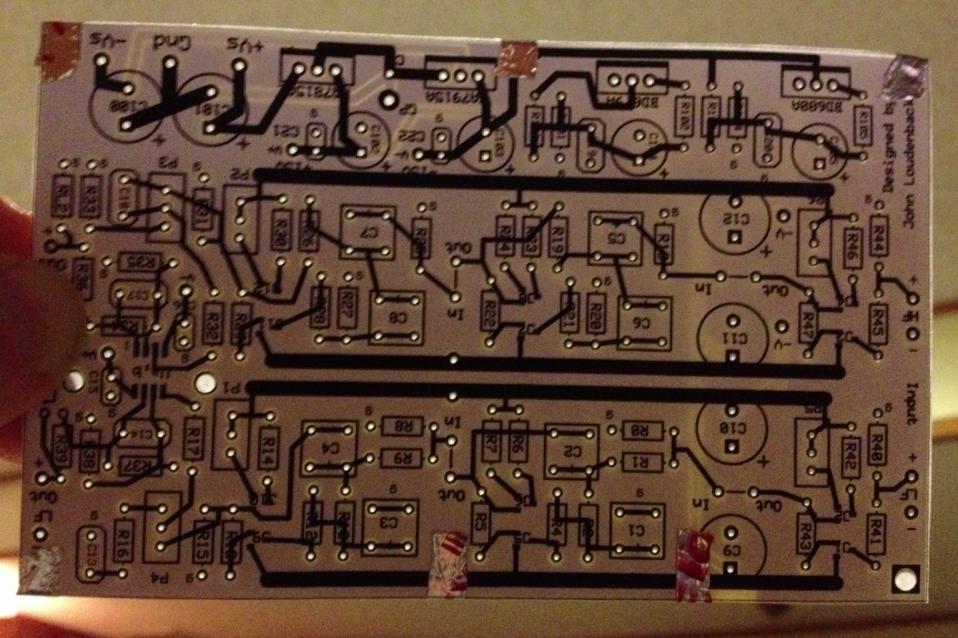

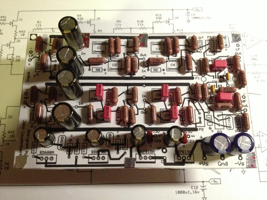

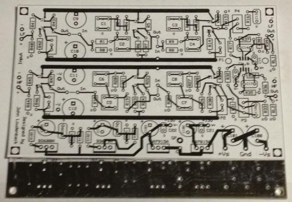

                                                                                Got boards today, and I made a mistake. Fortunately not the catastrophic one, just that I selected standard service and didn't notice that it didn't include silkscreen and solder mask. Anyway, it was still my best option cost wise, and I don't really need silk screen ... just disappointed that I didn't get to see my boards in all there glory.
                                                                                So here's what I got and my work around for having no silkscreen layer:
                                                                                The bottom layer with surface mount components -
                                                                                The top layer ground plain -
                                                                                Here a print out of the silkscreen and pads which the software prints out the same dimensions as the board. Very convenient!
                                                                                And here I have taped the printout so the holes line up. Putting it up to the light helped me line everything up.
                                                                                So, this worked out well. And you know I remember reading recently in Stereophile about an Audio Research product, a preamp I think, that used boards without solder mask because they said the resulting dielectric absorption hurt sound quality!!! I'm on right track, and you know that I've maintained golden ratio dimensions on this board!!! Going for gold here ....
                                                                                John

                                                                                        Great, I'll try the conformal coating. Got one board mostly stuffed with parts ... Pictures at 11:00!
                                                                                        John unk:
                                                                                          • 1913
                                                                                          #449
                                                                                          Here's a picture, and I need to order some more parts tonight cause I forgot heat sinks, and some resistors weren't right. I ordered mostly Dale RN60 1/8 watt but they are the size of 1/2 - 1 watt resistors and a tight fit. I guess all RN60 resistors are the same size? Anyway, I wanted the RN55 which are considerably smaller but Mouser didn't have the values I needed in those.

                                                                                            Here's the underside of the board with most the parts soldered in ... the yellow caps in the bottom are just extra bi-pass caps for the op amp. The LME49880 needs a lot of bi-pass capacitance acording to thd data sheet, and recommends paralleled ceramic caps for lower impedance. Need to get some flux remover too.
