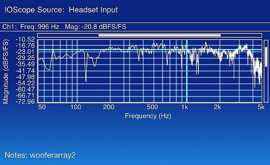

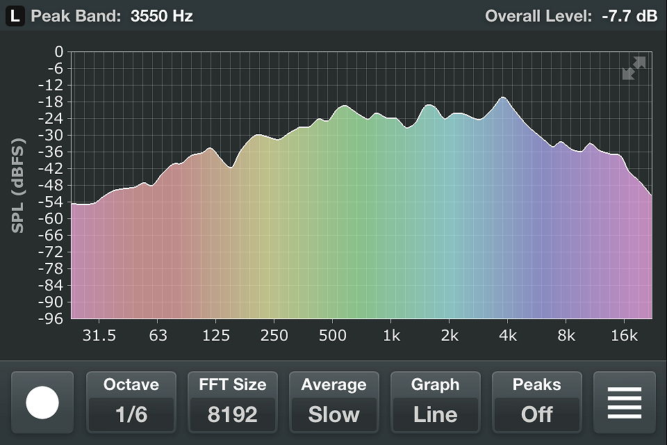

        Hmm, well, I took some frequency response measurements in signal scope's FFT, using random white noise as the source. IOScope is for two channel transfer functions, not a simple frequency response measurement, according to Faberacoustical. But I can use it for impedance measurements, and other stuff.
        Here are plots of the RD50 (top) and woofer array:
        Soooo, looks like there is a considerable dip 350-450Hz in the woofer array, and I think the rise in the 150-250Hz is do to the room. These speakers are facing the length of the room which has some bad room modes. Anything below 50Hz should be disregarded.
          Is there any way to turn on smoothing, like 1/12 or 1/6 octave smoothing? Most measurement programs will do this. Also, if at all possible, to separate what the speakers are doing from multiple room modes, a burst source like a sine chirp (with convolution to MLS) or an MLS pulse (repeated and averaged to improve signal to noise) will give you more info about what the speakers are really doing themselves, apart form their interaction in their current room position and your current mic position.
          Still, you're making progress! :T

            I have not found any smoothing function in the software. It lets you specify the resolution in Hz only, and will let you choose the number of averages. These graphs have a resolution of 5Hz, and 8 averages. And you can see as the frequency increases the jaggies get worse, so this may be a limitation with this software. I've been looking at some other iPhone RTA software in the app store.
            I wish the resolution was given in points per octave. I'll email Faberacoustical and see if I'm missing something. It does have a sweep function, that has a chirp sound (fast sweep) in signal scope, and I may experiment more with that. But, you can specify the duration of the sweep in IOScope only. The two software are very different.
            I'll see what I can find out, and try to get some better measurements.

              I see there is a RTA tool 1/3 octave bands for signal scope, but I just downloaded another inexpensive software with smoothing, so I think I'll give that a shot first. Forgot to mention, the low frequency response of the RD50 is affected by a couple 300Hz F-stops at the amp input to protect the driver.
                Every measurement does that, regardless of what mic / software you use. It's the nature of un-gated in-room measurements. What you're seeing is the effect of comb filtering due to reflections from the walls, floor, etc. Don't worry about it. A smoothed measurement will help you 'see through' that noise, and an experienced eye like Jon can probably see the real data in there without needing a smoothed graph.
                If there's some way to export the raw measurement data from your phone to a Mac or PC, you can probably find other software for post-processing.

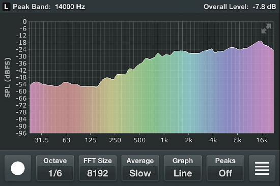

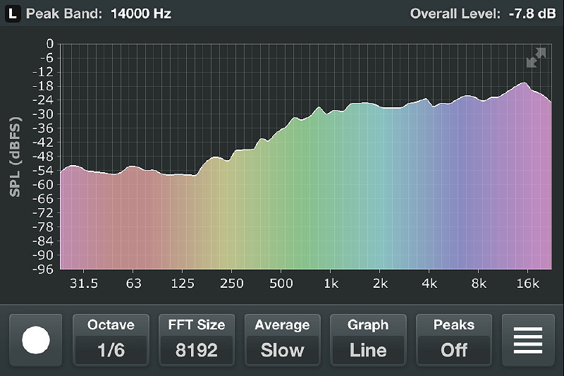

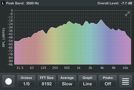

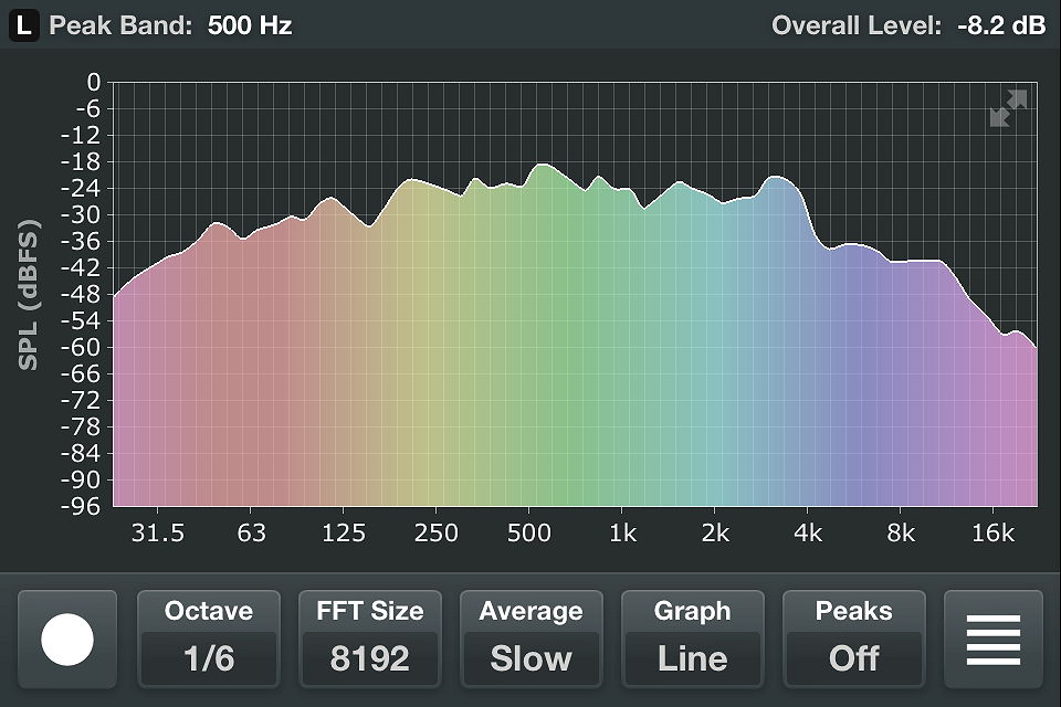

                      Here is another measurement I took of the RD50 using a different RTA software, with 1/6th octave smoothing.
                      Just been kind of busy doing stuff, but will get some of the woofer array, soon.

                        Just want to mention again, the low end response does not roll off that early. I have a fourth order 300 Hz high pass before the amp, so it causes the early roll off.

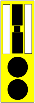

                          Looking nice, John, but about that slot in the middle? Slot loaded port in a dipole?
                          Does this slot actually work to narrow the baffle?
                          I'm pondering something similar if I attempt one of them fancy narrow baffle dipoles a la LX521 Nao Note.

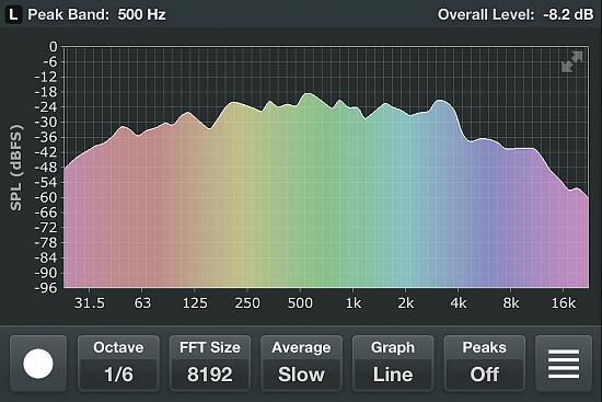

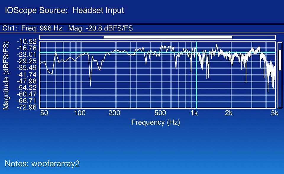

                            Okay, I took measurements of the woofer finally! And it turned out kind of interesting. The first plot is that with white noise input. And if you look careful it kind of looks like a first order roll of below 600 Hz. So, I tried a Pinknoise source (1/f) and it looks a lot flatter in the frequencies of interest.
                            So a first order lowpass filter at 50Hz is something I'm thinking about, and also a shelving filter to bring down the frequencies above 150 Hz, so they are more in line with the lower frequencies.

                            White Noise Response -

                            Pink Noise Response -

                              Pink noise is the one to use.

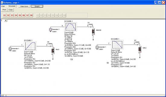

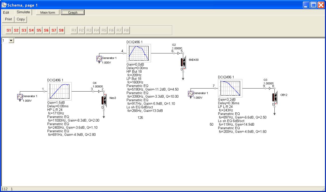

                                It's a dipole, it's supposed to roll off at 6dB/octave, starting at a frequency determined by your baffle width. You need to EQ that back to flat (and take care of any other anomalies) in the crossover. The dipole compensation needs to be part of the overall transfer function applied to each set of drivers.
                                For example, here's what my 3-way dipole XO ended up looking like. You'll notice shelving filters on the midrange and woofer - those handle the dipole compensation. The notch filters were to deal with driver/baffle issues.
                                Of course, if you're only going to use the woofers below 50Hz, then the XO will take care of most of it, and you probably won't need a shelving filter for the whole dipole range. Unless you meant a high-pass at 50Hz instead of a low-pass.
                                BTW, now that I think about it, I'm not sure the free version of ARTA will import any other application's files. Might be a good idea to check into that before you go to the effort of exporting an impulse response. HOLM Impulse is another free PC application that might be able to import an impulse response file.

                                  Okay, baffle step confuses me. There is clearly more than just the baffle width that determines the baffle step frequency, right. Woofer Q? Other stuff?
                                  Well, white noise has a flat spectrum, where as pink noise has a 1/f spectrum, but has equal power per octave. I read that pink noise looks flat on a lothrithmic scale, but I don't see why that would be the case except that RTA's do smoothing? Noise is additive. Also, that plot isn't a true logarithmic scale.
                                  Well, truth lies in the details. What about a frequency sweep? I'll try that.
                                  So if the pink noise is the more accurate measurement, that's wonderful because other wise I'd have to apply 24dB of equalization to get a flat response down to twenty Hz.
