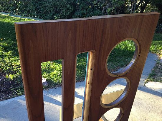

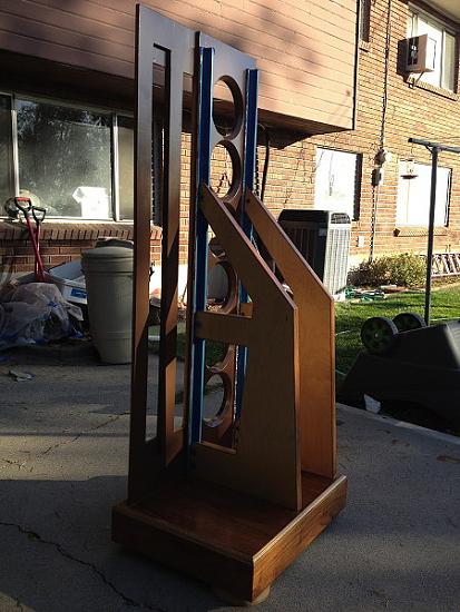

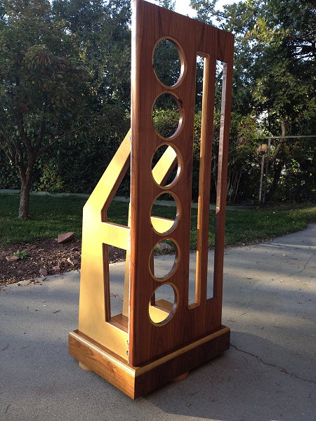

                                              Okay, here's a couple pics. Not the best picture unfortunately but they look nice and are smooth and good enough for me!
                                              Opps, forgot to get the blue tape off the aluminum supports.

                                                  Great job on the finish! Man from the Photo perspective they look to be a story tall.
                                                    • 1913
                                                    #160
                                                    Thanks Dar! Yeah, that's kind of deceiving there. They are 5'6" tall.
                                                    John unk:

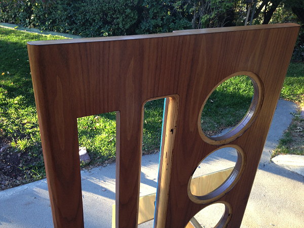

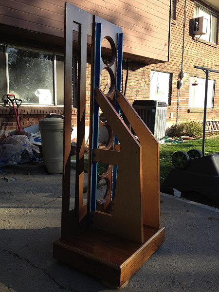

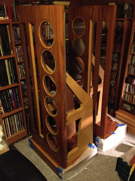

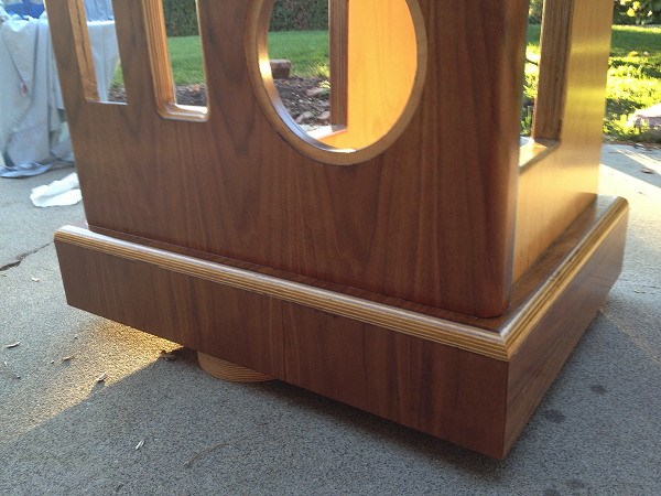

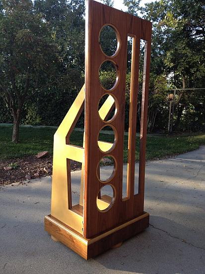

                                                                I finished the other one yesterday. Again I took pictures in the evening when the lighting is not good and casts lots of shadows, so I took a couple close up pics so the picture would turn out better.
                                                                Click image for larger version  Name:	Finish1b.jpg Views:	1390 Size:	94.9 KB ID:	857672
                                                                Click image for larger version  Name:	finish2b.jpg Views:	1366 Size:	96.0 KB ID:	857673
                                                                Click image for larger version  Name:	Finish3b.jpg Views:	594 Size:	96.0 KB ID:	857674

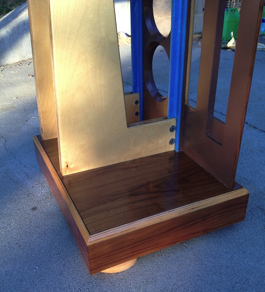

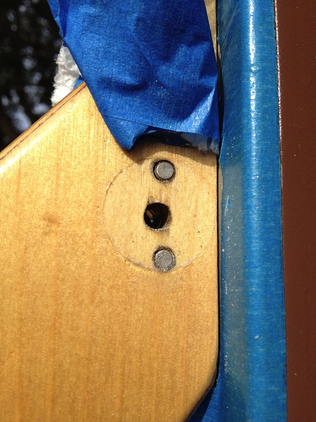

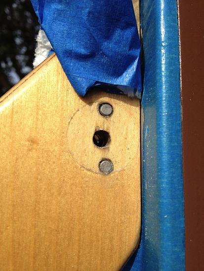

                                                                So, I'm done with the baffle except for one little detail. I'm not happy with the way I've connected the baffle to the support. I used silicone sealant and clamped it tight, and it is solid, but I worry about it coming loose with the weight of the drivers, and vibrations.
                                                                So, I ordered some 3/16" X 3/4" steel dowel pins that I'll glue in with epoxy, where the supports connect to the aluminum. This means drilling some extra 3/16" holes on the inside (woofer side) of the supports.

                                                                  Lookin' good. So, you attached the aluminum L brackets to the baffles with silicon sealant? Was your intent to have a damped attachment? I'm on the fence here - the length of the attachment may be okay re the moderate adhesiveness of the sealant, but part of me would want to attach the brackets to the baffle with screws. How about this: separate the brackets from the baffles, clean up the sealant, then screw the brackets to the baffles with neoprene washers under the screw heads and also between brackets and baffles? Mechanically strong, but decoupled.
                                                                    • 1913
                                                                    #168
                                                                    Oh, the baffles are attached to the aluminum angle with many screws and silicone sealant. It's the connection to the supports that I'm concerned about. There are scews that clamp the supports to the aluminum but are not physically attached to the aluminum. See, I've been moving the speakers around a lot on a hand truck and I'd pull on the top of the baffle when tilting the speaker back on the truck. A while back I heard a creak and saw the baffle move a bit on one speaker. I found the all the screws were loose ... I forgot to tighten them down after I attached the supports to it, long ago. ops: I used silicone cause it's a pretty good glue and will attach to most materials. Anyway, I tightened the screws down good and it won't budge now, but I need a more solid connection. The dowel pins, along with the clamping screws there already, will prevent any movement and make a real strong connection, I think.

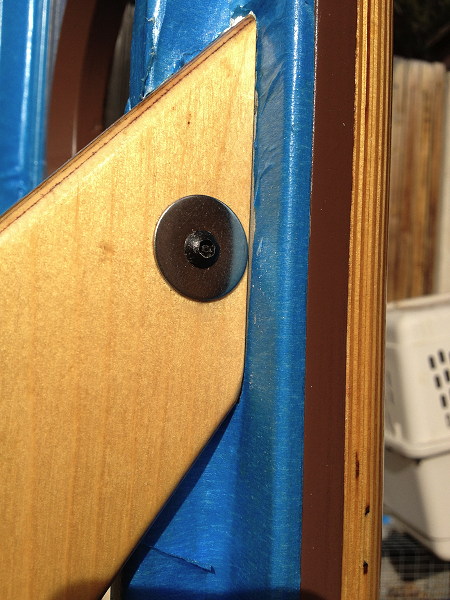

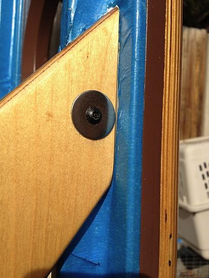

                                                                              My dowel pins came Wednesday, and today I epoxied four of them in my speaker. I placed them so the fender washers would cover them up. Ha ...
                                                                              Covered with fender washer -
                                                                              So, I'll be finishing this next couple days.

                                                                                  Well, I finished my speaker cabinets today. :banana: Will bring them indoors and hope to set up soon. Got to displace my dad's speakers. Unfortunately my dad is on vacation in two days and will likely not let do anything during that time.

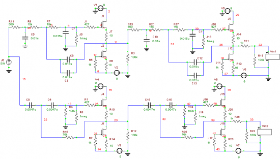

                                                                                          Well, I'm bringing the speakers in today, which are currently outside, protected under our porch. Drivers? Hmm .... I've some work to do on our room first and if I get daring I'll post some pictures ...

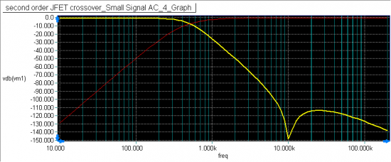

                                                                                          Every speaker needs a crossover ...
                                                                                          Response ... it's forth order, not second order like it says. This is kind of an LR4 but It's not butterworth filters, it's two cascaded Bessel filters, for no reason other than I was too lazy to recalculate the C values for the forth order. Any, I'll have plenty of time to play with it, once i get some speaker measurements.ac
