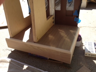

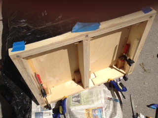

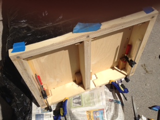

          Okay, for anyone still interested Hank (?) this speaker project is back on track. I decided to wait for warmer weather to finished the cabinet before putting in the drivers.
          I attached the back base board, had to route out some areas so it would fit.

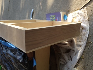

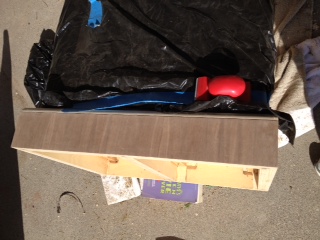

          Veneer.

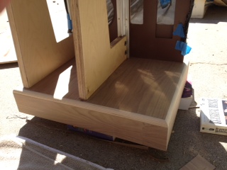

          Got to attach one more piece of veneer on the back, then just have to put on linseed oil and poly to finish the speaker.

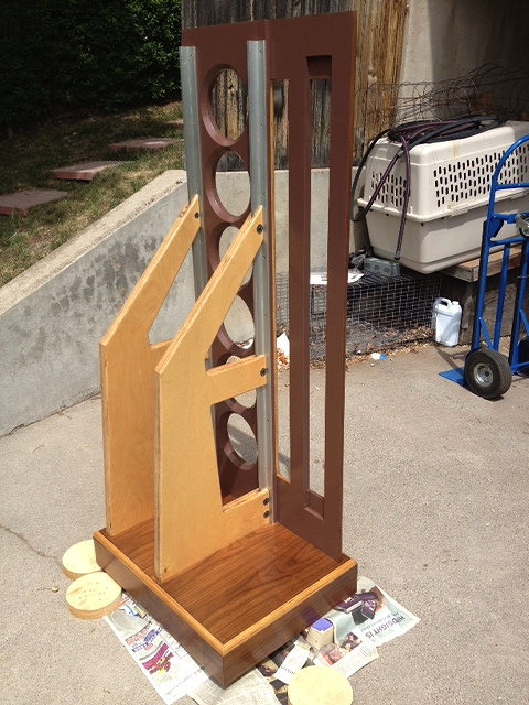

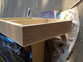

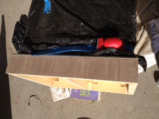

                        Just posting a small update, got the veneer finished on one speaker. Will do some more sanding on the base and then linseed oil and poly.

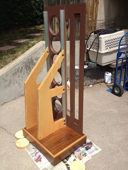

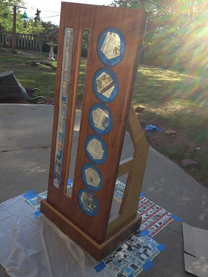

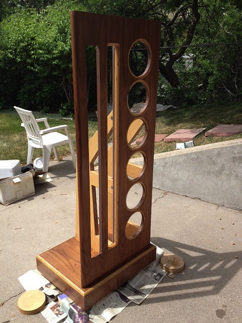

                              Here is what I've done to date with one speaker. Still have to catch up on the other one when I'm finished with this one. It has one coat of polyurethane, and I need to sand and put additional coats on. Anyone have any advice on a putting polyurethane finish on? It is a bit rough in places and the instructions say to use a 220 grit sandpaper to lightly sand and smooth out before putting additional coats on. So, that what I'm going to do, except I think I'll use a 320 grit cause the paper I use is pretty good a taking stuff off.
                              Front -
                              I was shooting into the light, so this picture didn't turn out too well, as it is too dark in front.

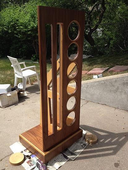

                              Back -

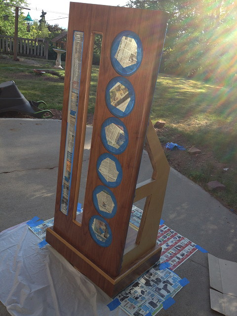

                                                                        To update here is a picture after two coats with the sprayer. I have since sanded it and am ready to put on a third coat. The sun shining toward me caused some glare in the photo.

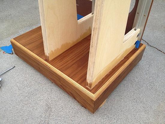

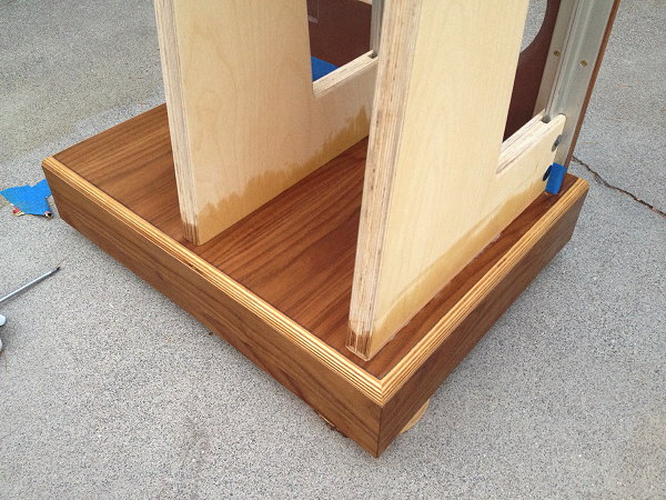

                                                                                        Yep, I'm working on it. Have had some others things to do, but got it sanded and put linseed oil on the base. Hope to get these finished soon. Will not be waiting till next spring again!

                                                                                          I remember my first foray using linseed oil.
                                                                                          I ended up having to re-sand the cabinets after I put about 5 coats on. :E
                                                                                          Oh well, live & learn. Experience is still the best teacher. :lol:

                                                                                            Yeah, I can see how that could be a problem. Linseed is nice for bringing out the wood grain and colors though. I've certainly learned a whole lot from this "experience" in speaker building. Knew almost nothing about speaker building, wood working, or doing any kind of finish the right way. I have made mistakes but nothing devastating yet, AFAIK. Still have to see if these will sound good. Fortunately, the people here do know what they're doing and I'm very appreciative for everyone's advice and ideas!!! ;x(
