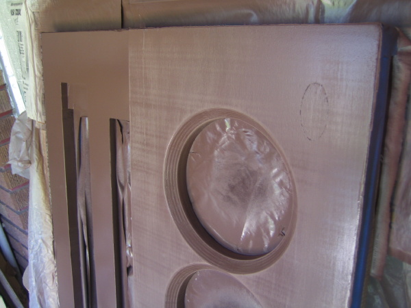

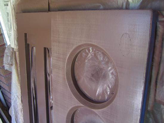

      Okay, first is a picture of the sanded versus unsanded finish. This was before the last two coats which I finished two days ago. So, I haven't sanded yet. I am curious if anyone has tried this kind of look. It looks a bit scratchy with the 415 grit. I also tried a 600 grit which looked kind of smudgy and spotty. Tried both 415 then 600, and it looked a bit too washed out.
      Anyway, once I get the poly on I hope it looks perfect. Still looks better that just plain brown IMO.

      I like, and my dad like, the sanded (weathered look) and it looks better than the picture might indicate.

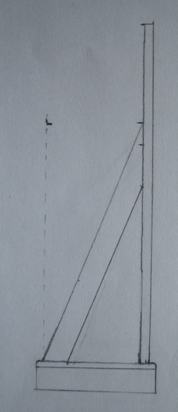

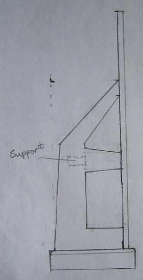

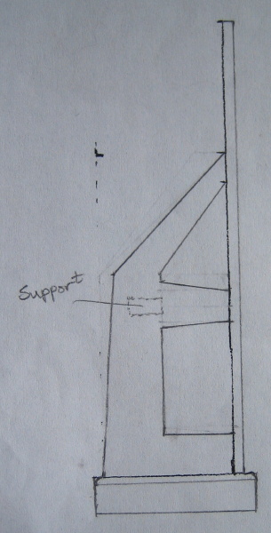

      Here is what I propose for the support structures. They will be 1-1/2" baltic birch ply. I like the bigger supports, and they will be mounted to the aluminum rails (not shown) on each side of the woofers and the base. Both picts are 1/16 scale.
      The rectangle in this pict is just a 2X4" board for lateral support.

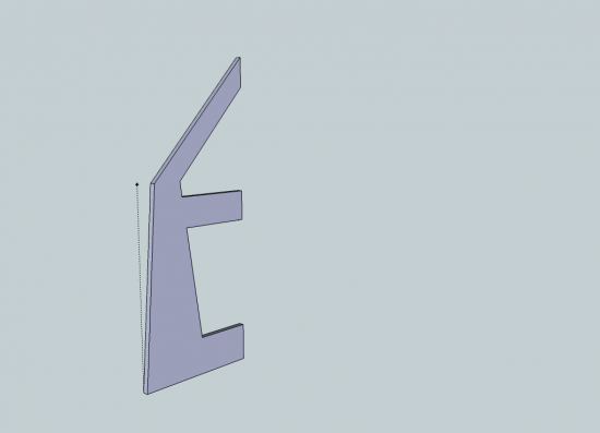

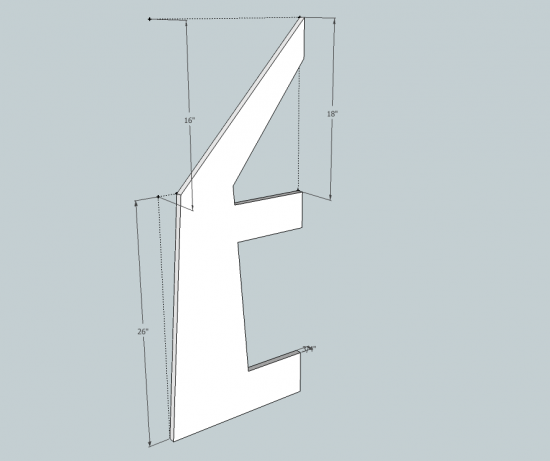

                    I downloaded Google Sketchup for the mac today. Didn't know they had a mac version. Anyway, I got the support drawn up in Sketchup, and exported an AutoCAD file that the CNC shop can use. Sketchup is super easy to use compared to the other crappy software I tried.
                    That is one half of one support board, 3/4" thick ... will be laminating two together for each support.

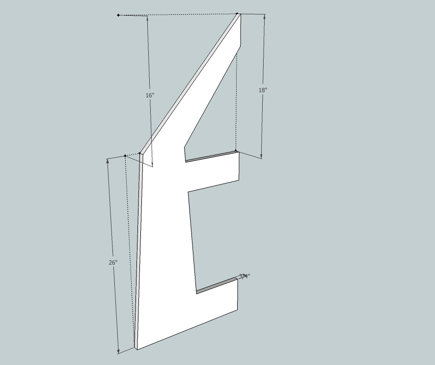

                        • 1913
                        I was looking at the drawing above and realized there was something wrong, and I found that the midpoint of the brace was 4" instead of 6" so I had to fix it. Just sent this 3D file to the CNC shop. Thanks for the tip Hank, didn't know that. I hadn't planned on using regular ply though. They said the can get 3/4" baltic birch ply.

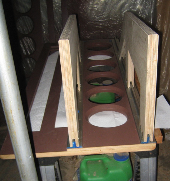

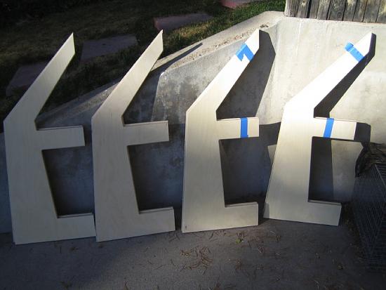

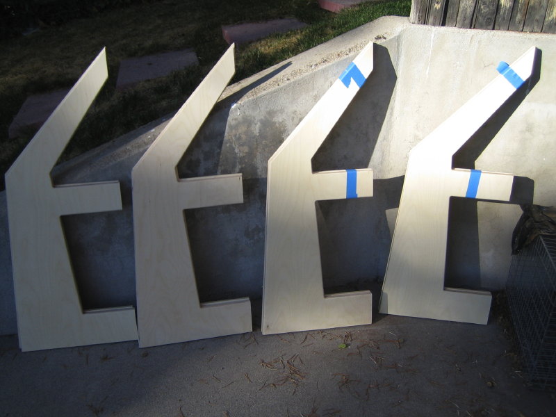

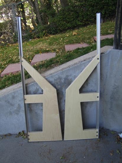

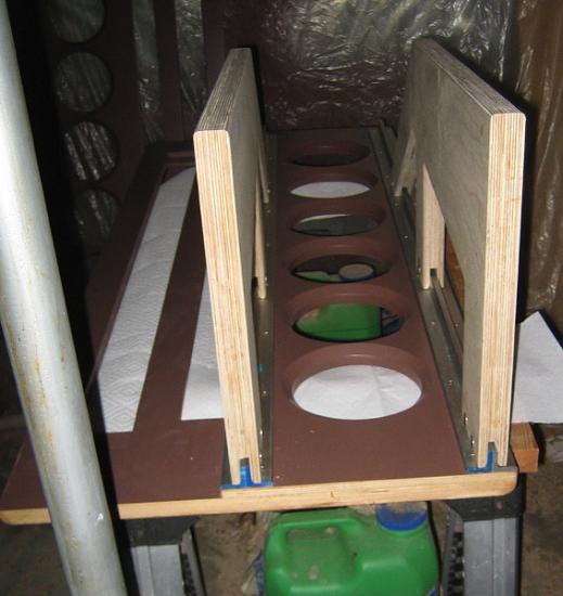

                                            Here are the supports boards all round over routed. Still have to route out the space where they will connect to the aluminum angle.
                                            Have started laminating the boards that will support the base as well.

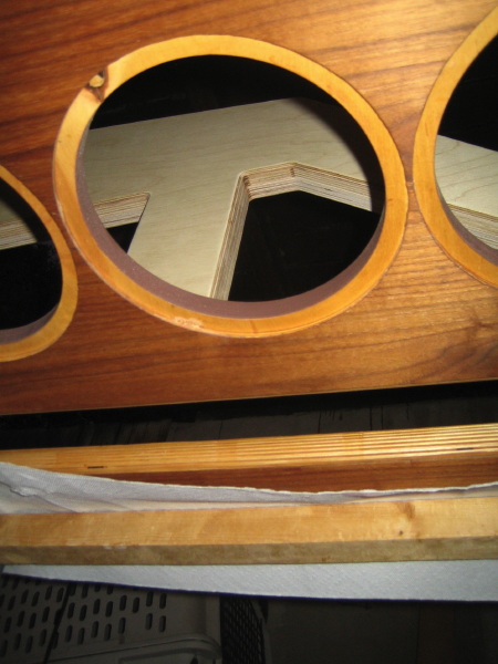

                                                I suppose I need to post ... it's been awhile. I've been working on this, mostly boring stuff like drilling holes laminating the support boards together,flush triming, scraping away residual contact cement on the baffle, and putting linseed oil one of the front baffles (very pretty). Will post some picts soon. It's been in the high 50's and 60' but getting colder Tuesday, and so I'm getting as much as I can done.
                                                Hope to have them put together, but not completely finished soon. Will have to complete the finish in the spring.

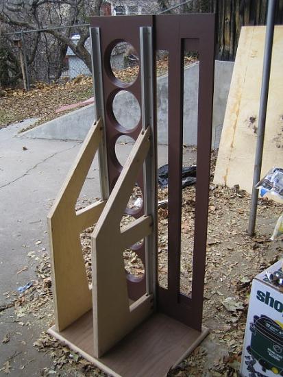

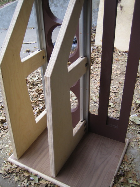

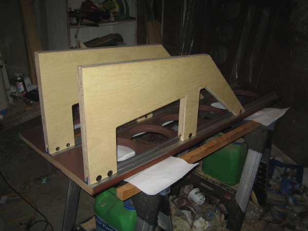

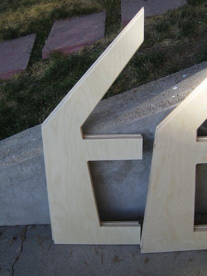

                                                  Okay, here's some picts of the project to this point.

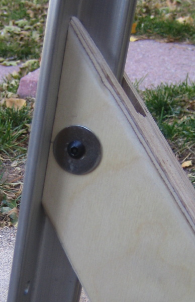

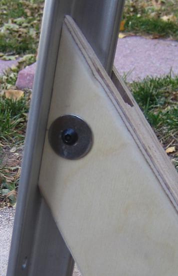

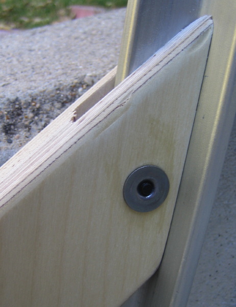

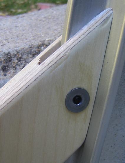

                                                  I used Hurricane nuts to anchor the Reports machine screws. Worked good.
                                                  I used a fender washer on the other side. This clamped the wood against the aluminum angle really tight and it won't budge even without glue when tightened down.

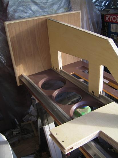

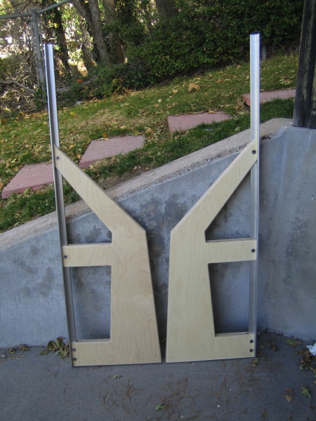

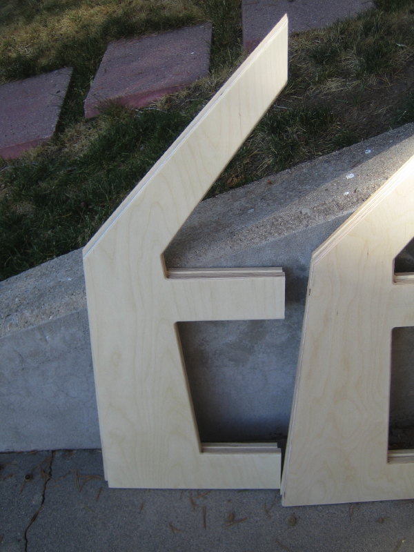

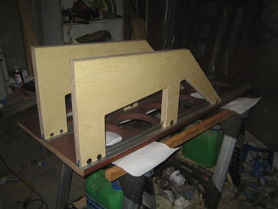

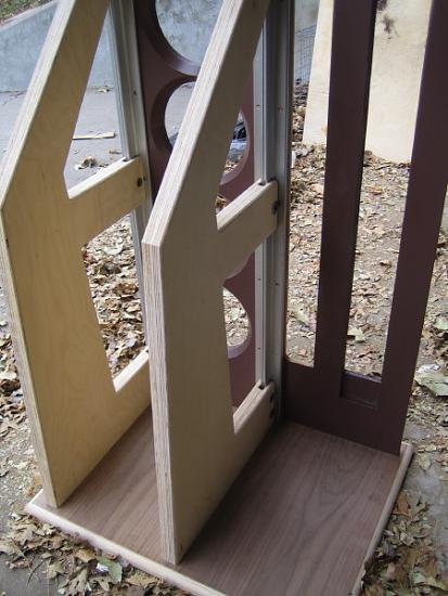

                                                    Here's the rest of the picts.
                                                    This is really solid as verified by a knuckle tap. It's heavy too and I could not lift it off the saw horses - I'm not buff, but weak from inactivity. It's long story which has to do with my phonophobia and global hypersensitivity. Moving forward though.
                                                    Here's the finish.
                                                    I will attach the base with it on the horses and get some help lifting this thing. Unfortunately for me, this will be one heavy speaker.

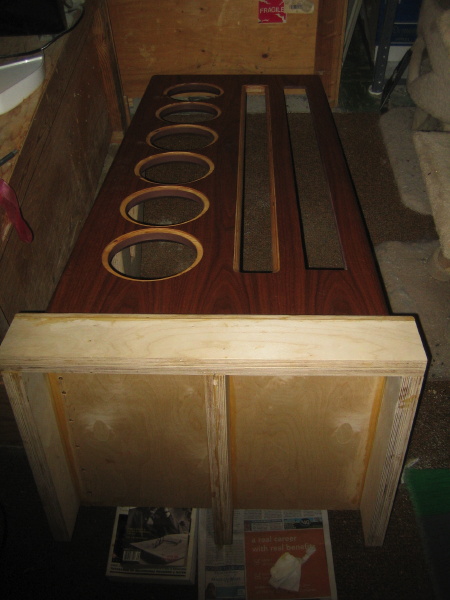

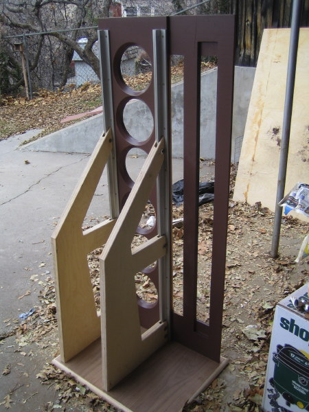

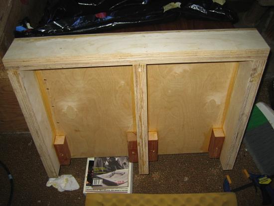

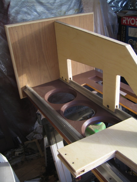

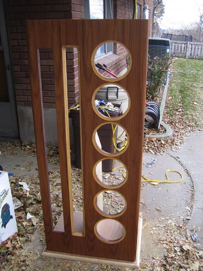

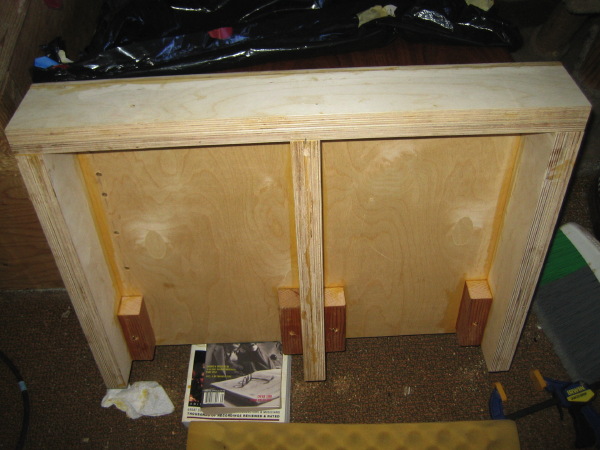

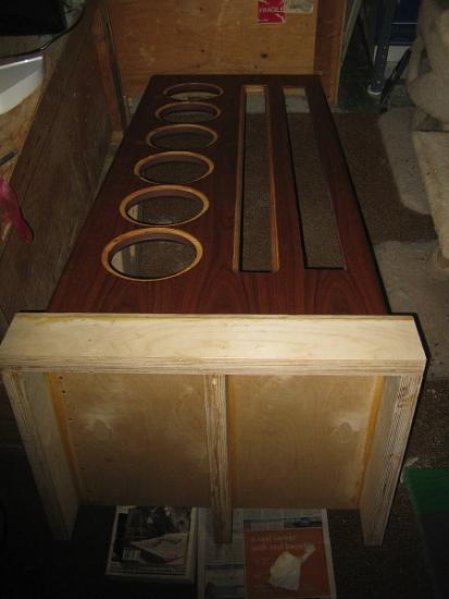

                                                              Okay, here's another update. November has been a bad month for speaker building - woman friends, who needs 'em.
                                                              Click image for larger version  Name:	Base3.jpg Views:	2681 Size:	82.8 KB ID:	856448
                                                              Click image for larger version  Name:	Base1.jpg Views:	2467 Size:	94.4 KB ID:	856449
                                                              Click image for larger version  Name:	Base2.jpg Views:	2462 Size:	88.3 KB ID:	856450
                                                              So, this one is done, at least until spring when I can finish putting on veneer, and put a finish on the rest of it.
                                                              Got to put the supports and base on the other baffle now.

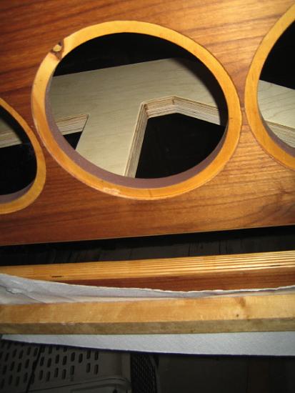

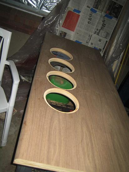

                                                                        Here is my second speaker coming together. I'm taking it indoors to glue on the base boards.
                                                                        The back.
                                                                        Close up of the support boards.
                                                                        The journey continues .... :conveyer:

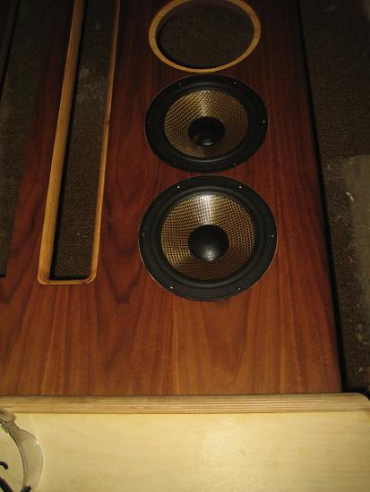

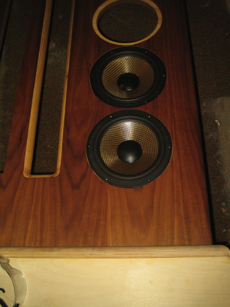

                                                                                Oh, no, Hank, I just can't slap in the drivers! They need to put in very carefully with each screw incrementally torqued, in just the right order. Could take weeks. :P
                                                                                But here is a little teaser:
                                                                                Next up comes house cleaning. My dad doesn't mind messing up a room, but when I try to clean it up ... "Stop that, It's messing up the acoustics!. Oh, now the sound just isn't right anymore ... I'll never get it back."
                                                                                I'm slowly moving out stuff, so he won't notice. Then I got to get some help from my cousin and son to move all the equipment, CD/record cabinets, TV, TV/equipment stand, etc. Then put carpet down.
                                                                                Got to do it when my dad isn't around and all in one day. Then ... "Surprise dad!!!" Ha, Ha, ...
                                                                                John
