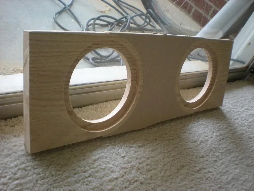

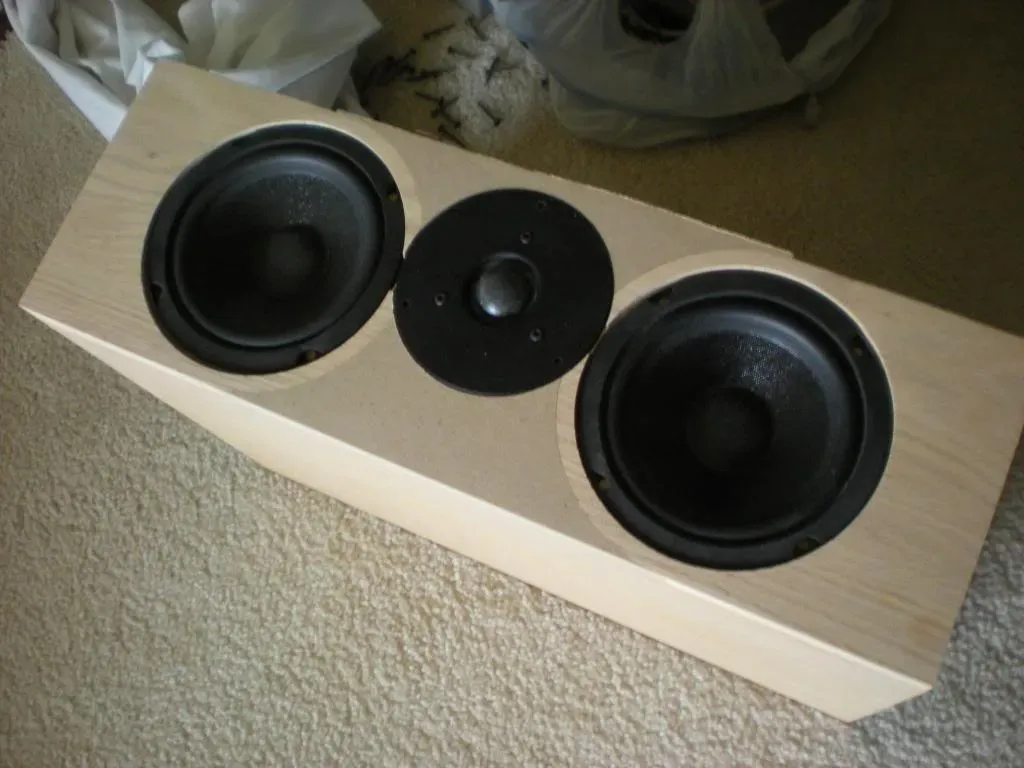

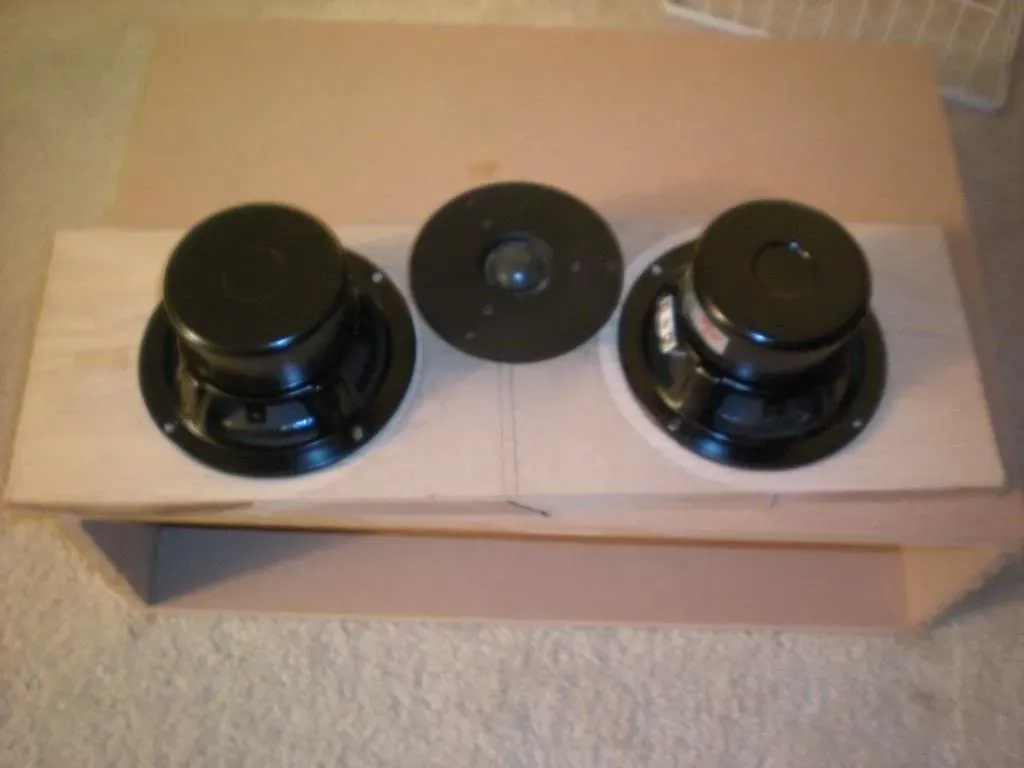

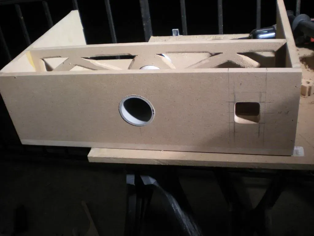

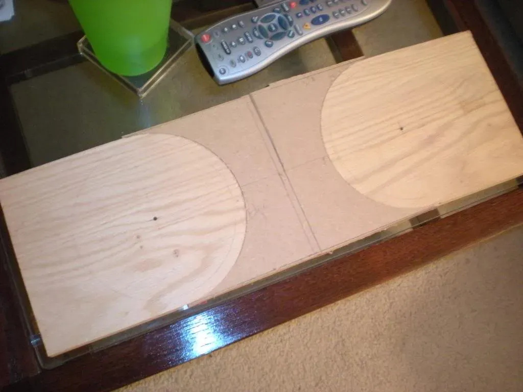

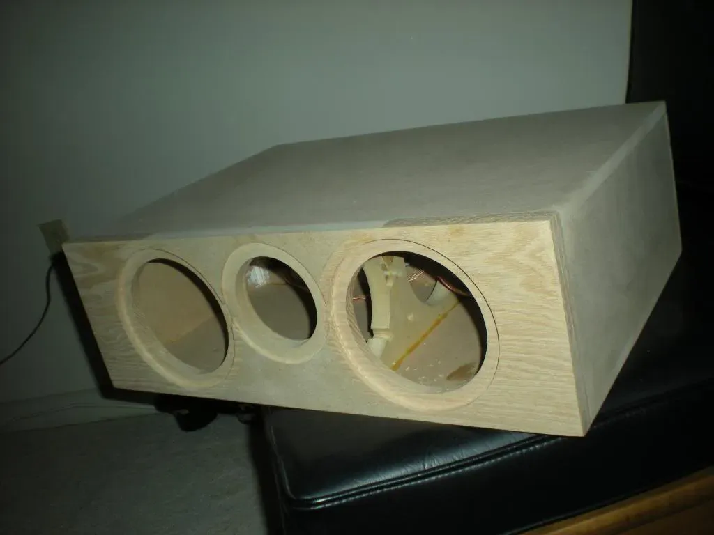

    Enclosure cuts and mock up with one brace -

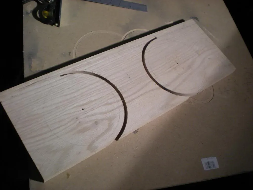

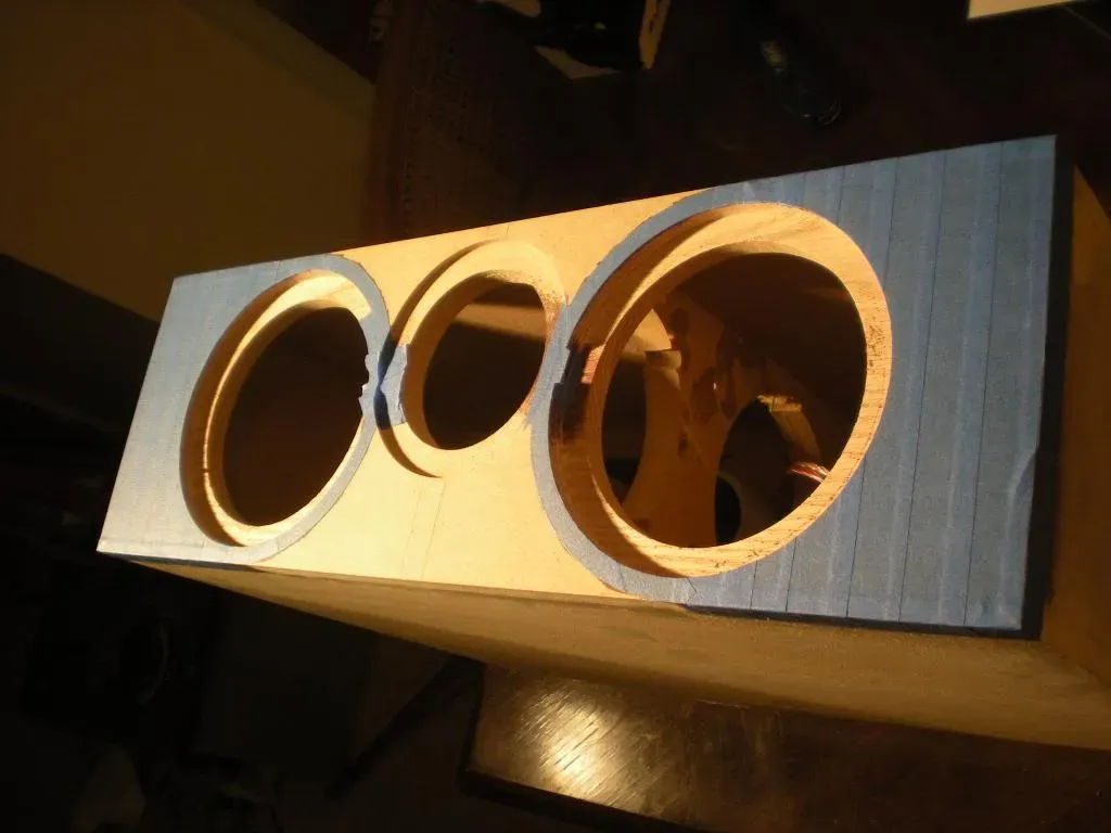

    Baffle design and construction -
    Click image for larger version  Name:	DSCN3328.webp Views:	0 Size:	32.1 KB ID:	938260
    Click image for larger version  Name:	DSCN3330.webp Views:	0 Size:	42.3 KB ID:	938261
    Click image for larger version  Name:	DSCN3337.webp Views:	0 Size:	23.0 KB ID:	938262
    Click image for larger version  Name:	DSCN3346.webp Views:	0 Size:	52.1 KB ID:	938263
    Click image for larger version  Name:	DSCN3350.webp Views:	0 Size:	44.0 KB ID:	938264

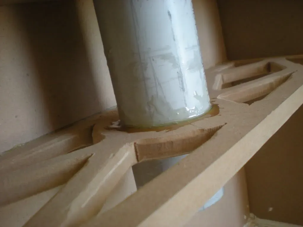

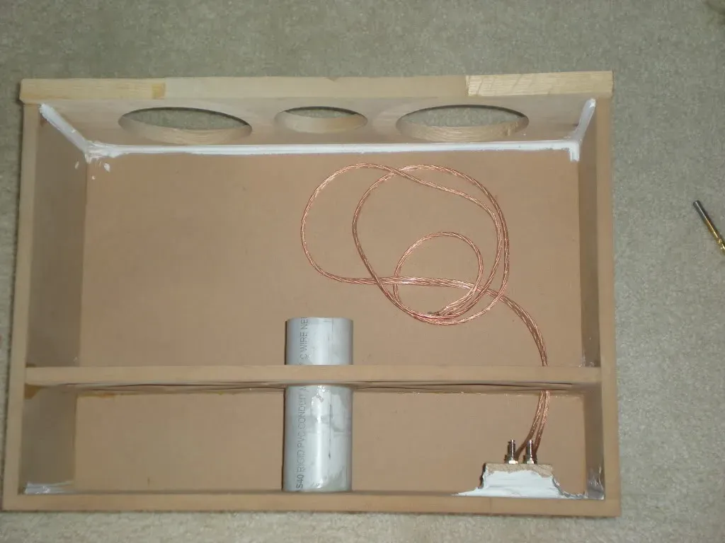

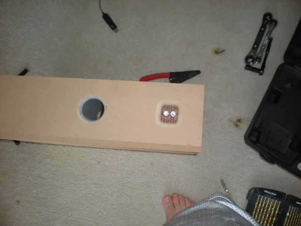

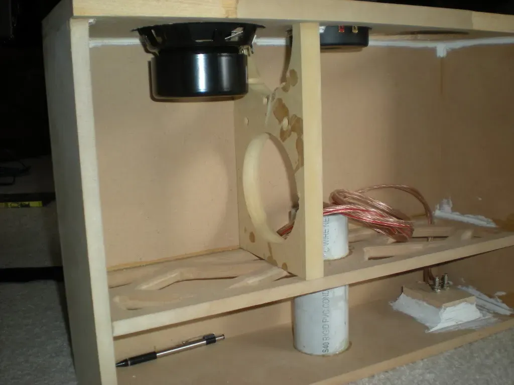

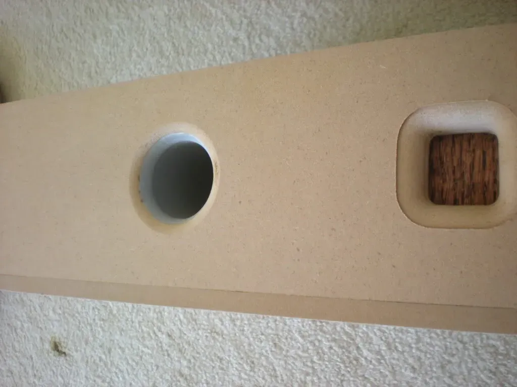

    Port and binding post creation -
    Click image for larger version  Name:	DSCN3334.webp Views:	0 Size:	28.1 KB ID:	938265
    Click image for larger version  Name:	DSCN3371.webp Views:	0 Size:	37.8 KB ID:	938266
    Click image for larger version  Name:	DSCN3373.webp Views:	0 Size:	20.6 KB ID:	938267
    Click image for larger version  Name:	DSCN3382.webp Views:	0 Size:	40.0 KB ID:	938268
    Click image for larger version  Name:	DSCN3385.webp Views:	0 Size:	38.5 KB ID:	938269
    Second brace -
    Click image for larger version  Name:	DSCN3423.webp Views:	0 Size:	30.2 KB ID:	938270

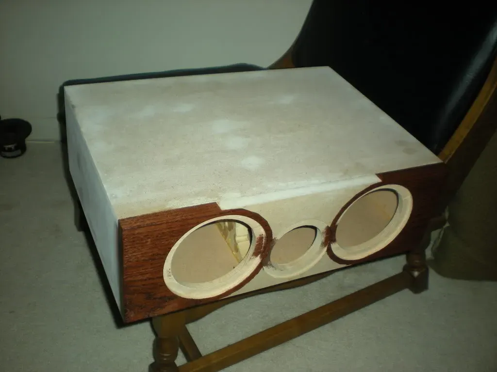

    Stained baffle -
    Click image for larger version  Name:	DSCN3443.webp Views:	0 Size:	30.3 KB ID:	938272

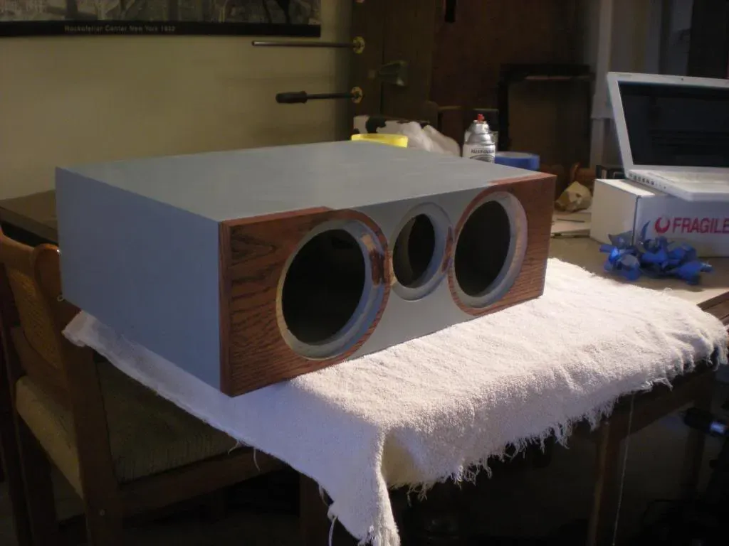

    Paint prep and journey -

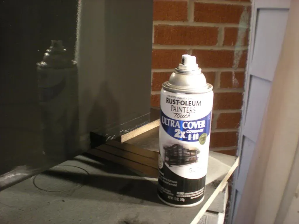

        I recently used the painter's touch glossy white on a set of crown molding shelves, VERY nice rattle can product. Where did you find the filler primer? Need to get me some of that.
        I would suggest some clear coat for protection. :T
        Gavin

          Walmart is reliable and cheap to carry it, Autozone I believe had it but for $1 or $1.50 more per can. They used to carry Duplicolor high build, but have since stopped and now have the Rustoleum brand which is more expensive.

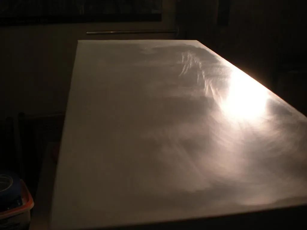

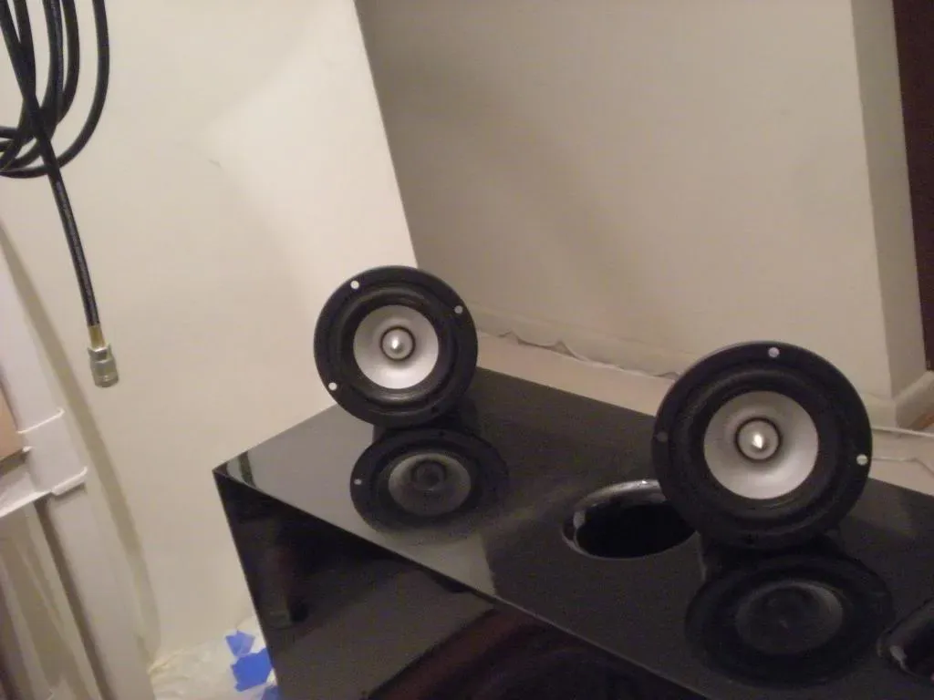

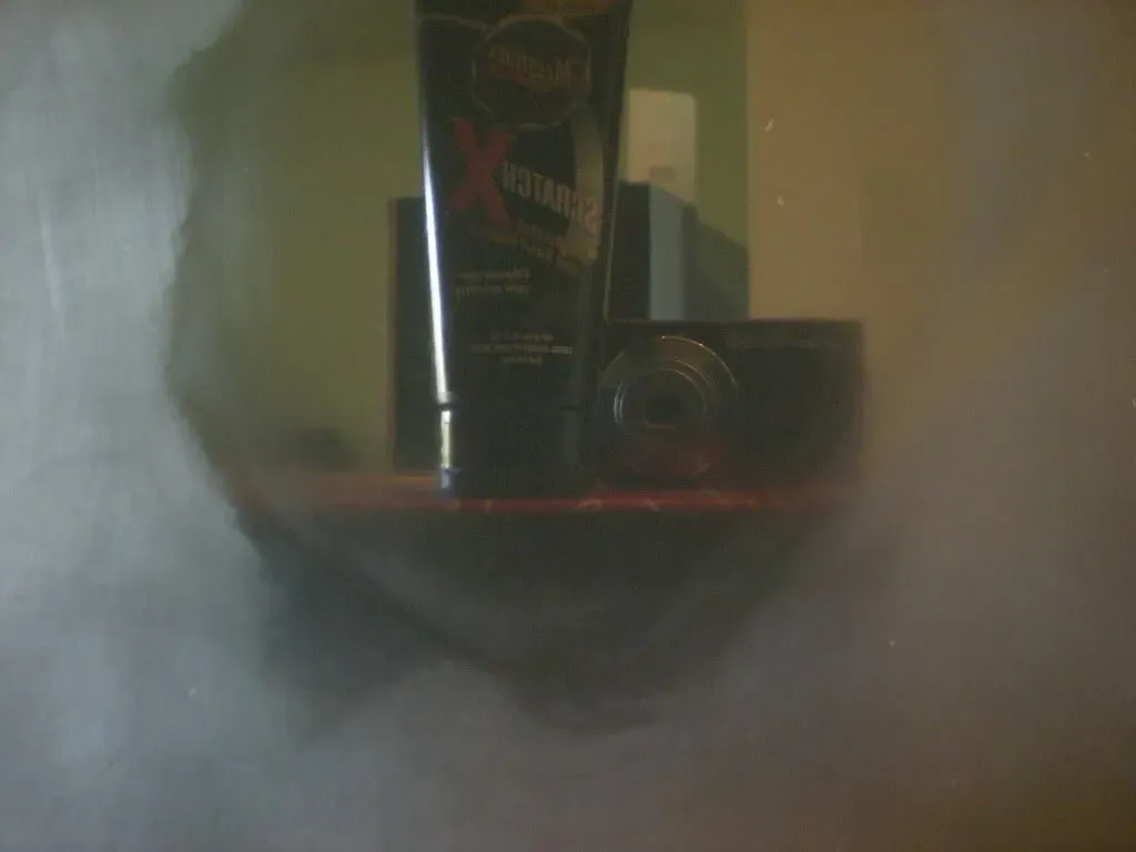

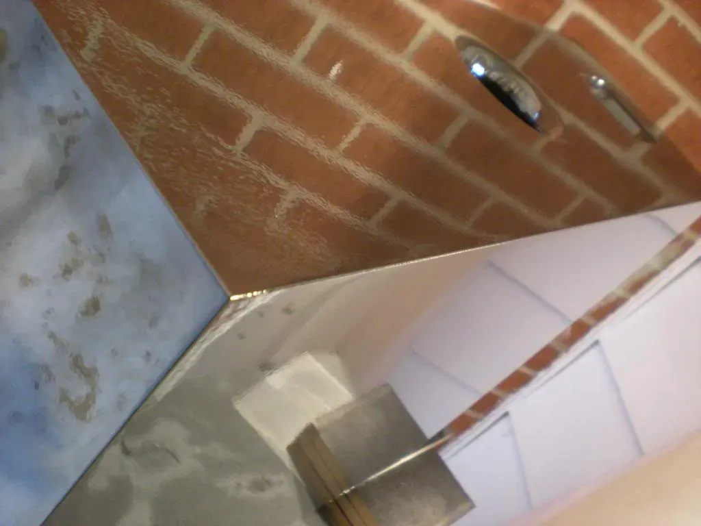

            Can YOU tell which side has been wet sanded with 1500 and buffed with scratch-x, right or left?
            With flash

            Without flash

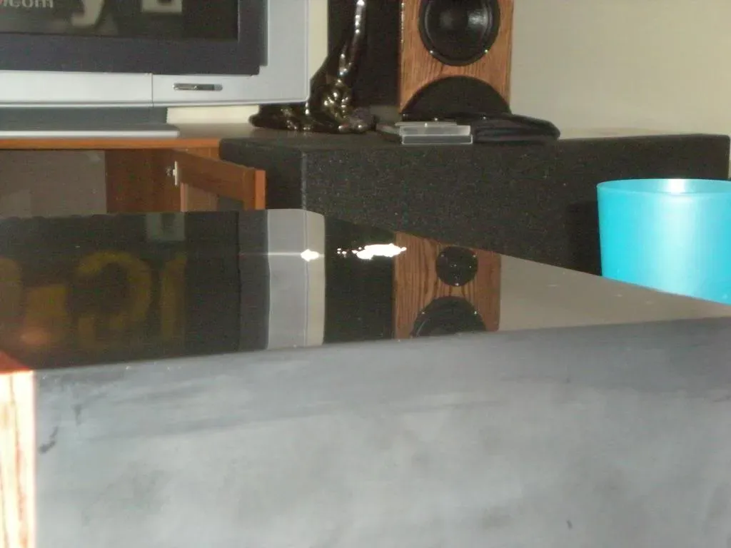

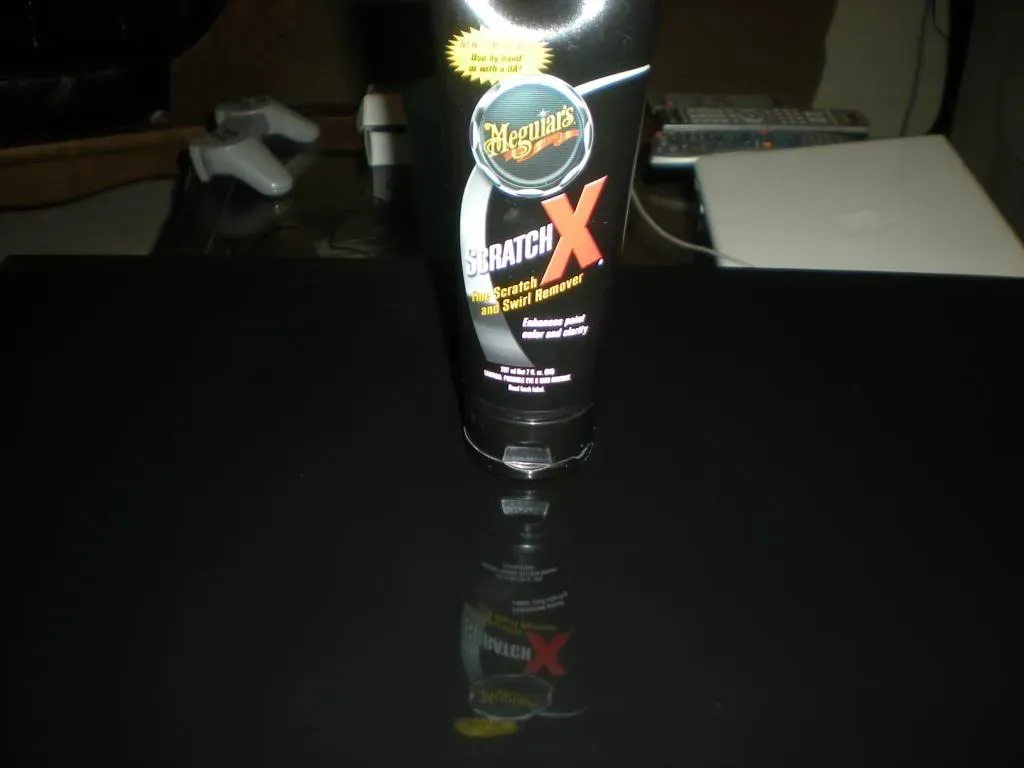

              HELP!
              So tonight I have wet sanded with 1500 and 2000, then scratch-xed and then waxed. Now, this is where I don't feel confident. The paint now looks dull. buttery buttery smooth, but dull. It doesn't reflect at all like the fresh paint. Is this how it should look before clearing?
              • gregnash
                • Dec 2009
                • 67
                Did you buff out the wax? I know that is a dumb question but figured I would ask.
                • numberoneoppa
                  • 535
                  The left side from our vantage point.
                  -Josh
                  • joeybutts
                    • 476
                    Yes the left.
                    I did buff it out, but have been told that I need to dewax and degrease, re-wetsand with 2g and then go ahead and clear.

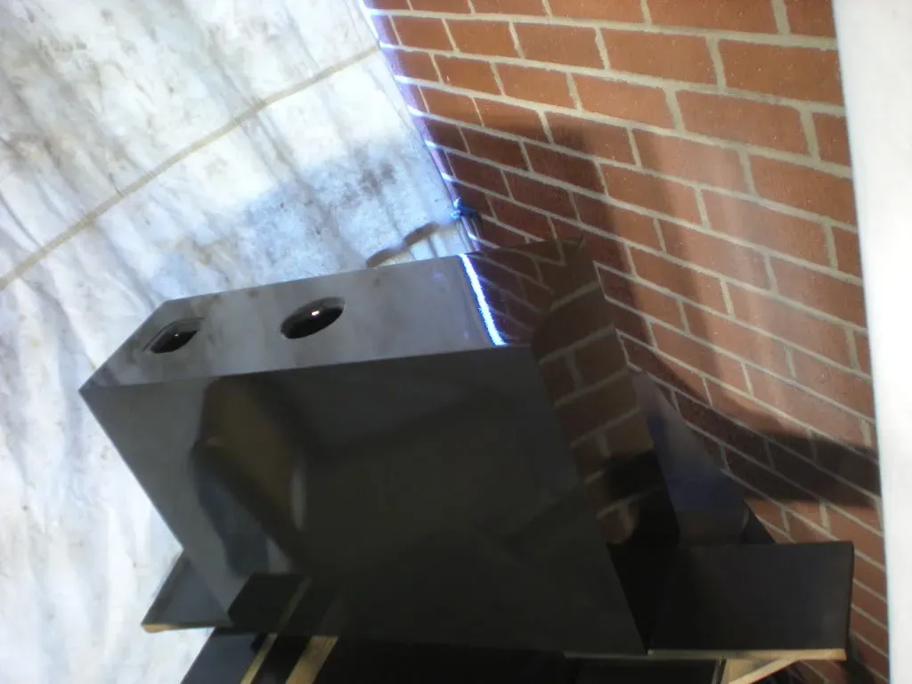

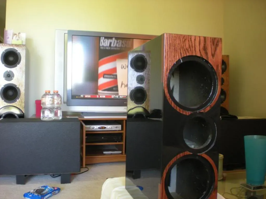

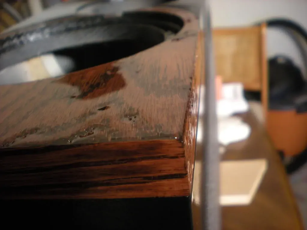

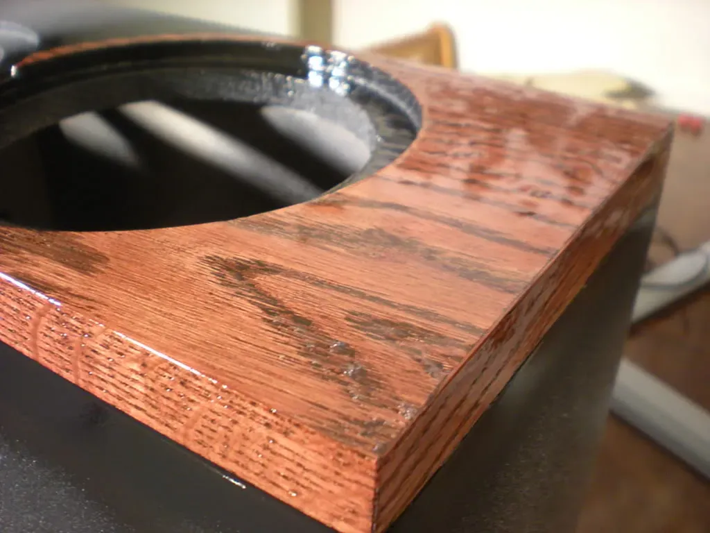

                        Update: Cleared the whole thing. Oak baffle released a LOT of air bubbles, so some sanding and clearing are still in order.
                        Going to look real good though.

                        Can start to see some bubbles here.

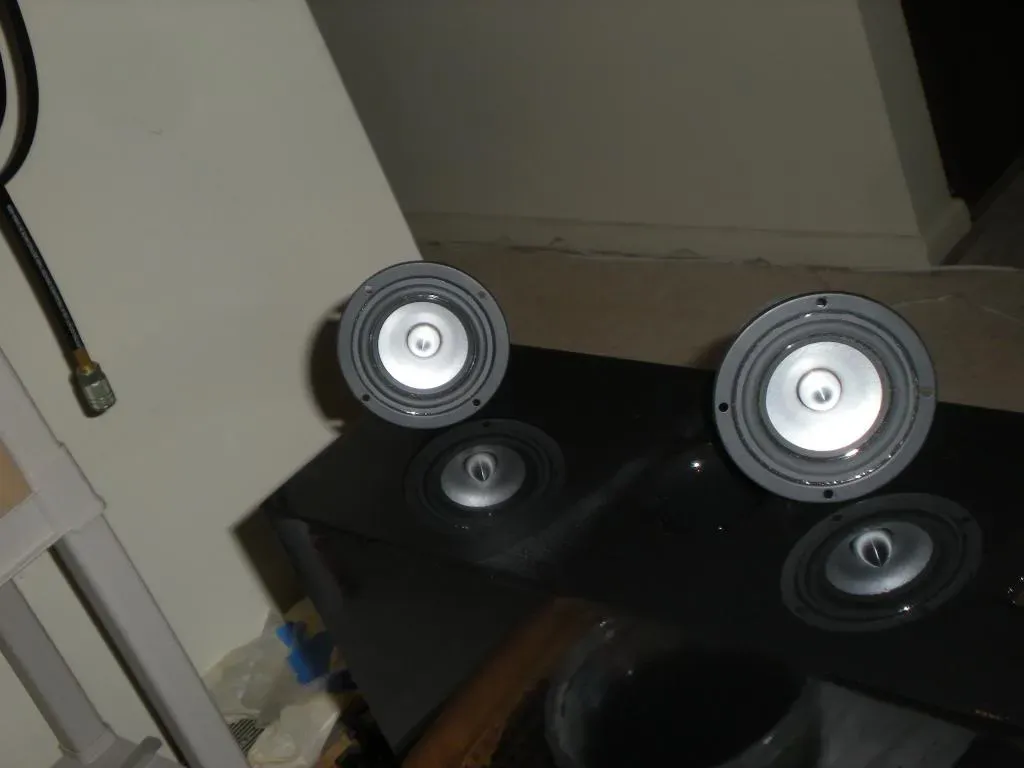

                              Utilizing my subpar Scratch-x till I can get rubbing and buffing compound, the clear is turning out real nice. Wish I was a photographer

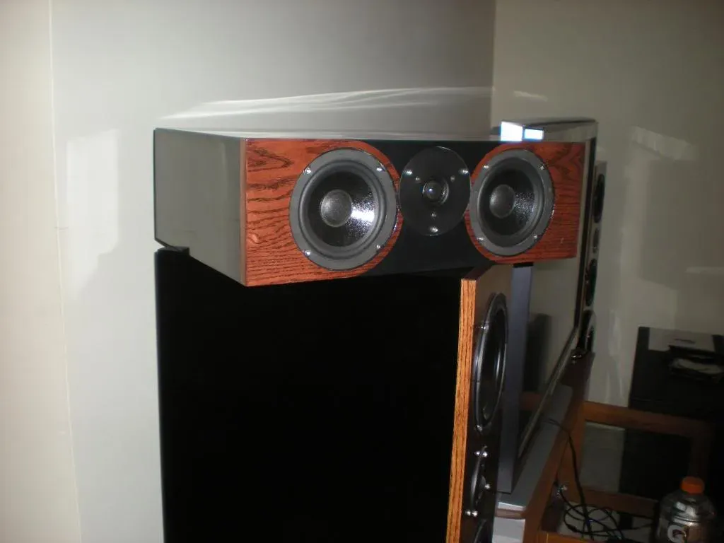

                                      Soooo.......How long does it take for Enamel to completely dry?
                                      • joeybutts
                                        • 476

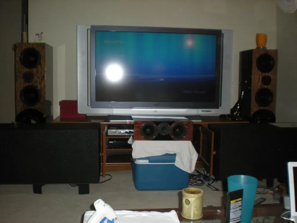

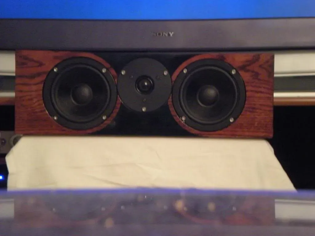

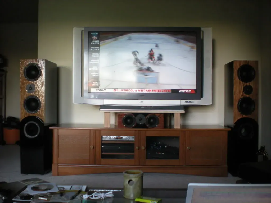

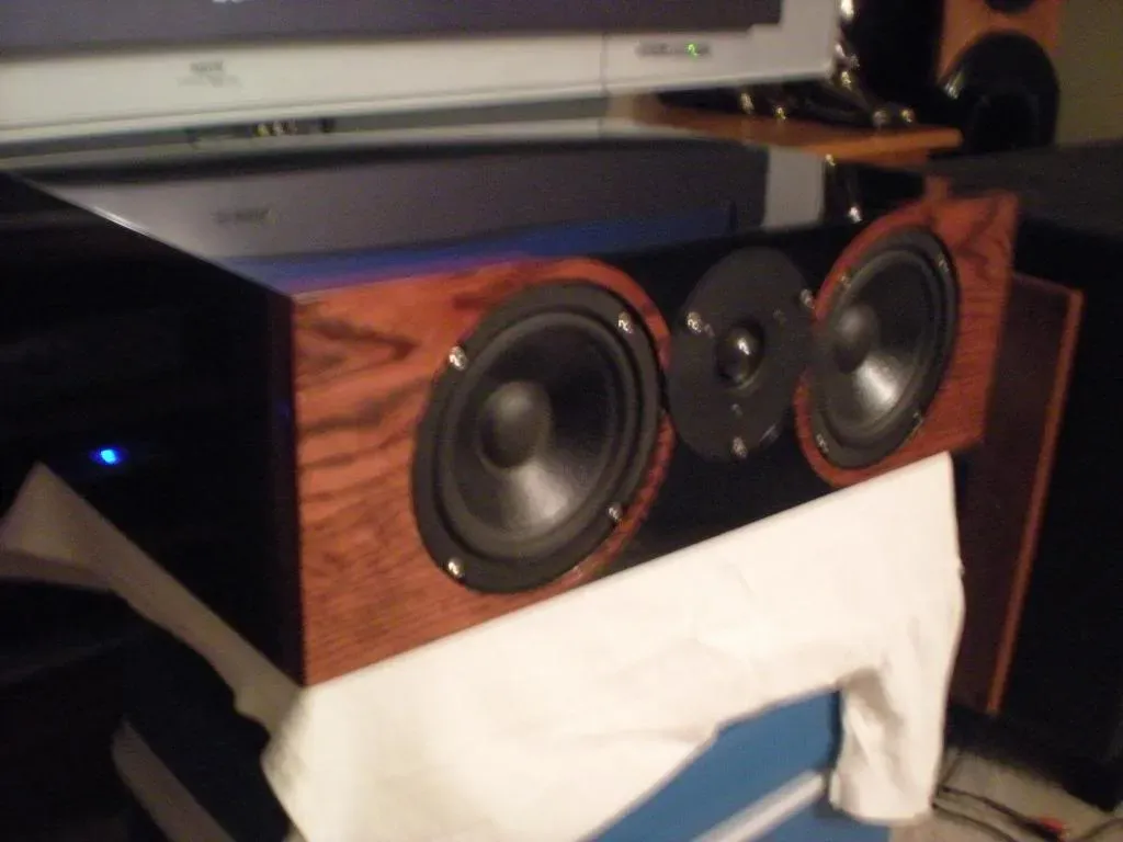

                                        DONE! SOUNDS awesome. Looks real good. Not perfect but no one will notice all the things wrong like i will.
                                        My photography skills suck (though I think part of it is the camera...) so bare with the pics. I can try to take better. If there are any Q's just let me know!
                                        I'm going to wait a month or two to do a final buff and wax so that the enamel gets a good dry and hardening. I also need to build a riser for my TV so I can slide the CC under it.
                                        It matches the towers well though the finish is much smoother and the stain on the oak is richer/darker on the CC. Oh well. Maybe it will fade out. I swear it did on the towers. Could also be that the Oak on the towers is oak ply and the oak on the CC is solid oak.
                                        I can't give it a solid listen right now, but it seems to be real nice with the towers at low levels right now. I need to do some calibrating and REALLY need a mic to fine tune.
                                        I ran the center solo and it is impressive as far as dispersion and freq response. More detailed review to come. (as if there aren't enough reviews on the Tritrix already! )
                                        Here is my pre emptive thanks to Curt for an excellent design and to everyone with their assistance in this build!!
                                        Joey B

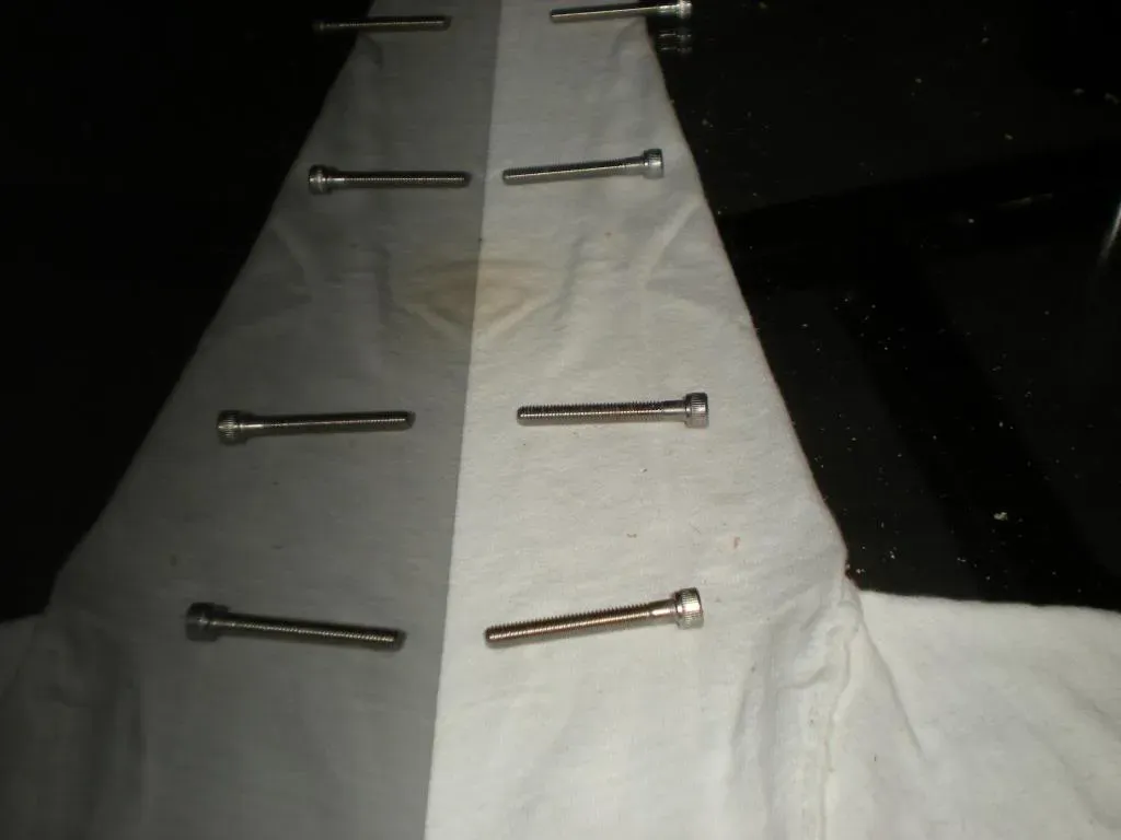

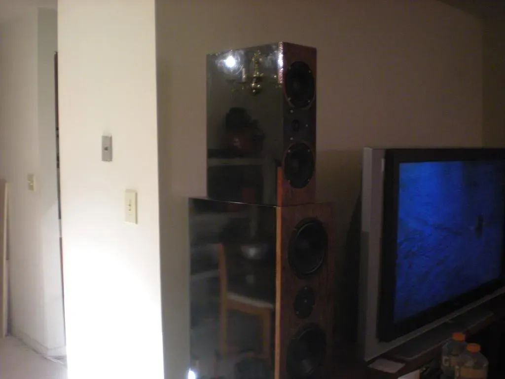

                                        • john trials
                                          • 449
                                          Nice reflection on those speakers! I like the photo with the screws. I don't have the patience for doing such a nice finish (plus I'd be worried about scratching it). You did a great job.
                                          • joeybutts
                                            • 476
                                            Thanks John! The screw photo is my favorite as well. Happened by accident, saw them reflecting off the cabinet right before I stuffed it and put the drivers in.
                                            Trust me. It was tough to not just say "Good enough."
