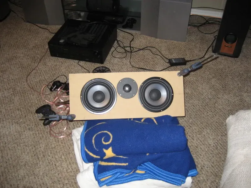

                  I found the drawing on the PE's website that has most of my answers.
                  Gavin
                  BAMTM Build
                    should I use those measurements or wait til my drivers get here and measure myself?
                    One should always wait until the drivers are in hand...

                      ok, will do. how much of the back of the driver opening should i put a 45 degree on if my baffles are 3/4 thick? can you comment on that? I think I have found answers to all my other questions thus far.

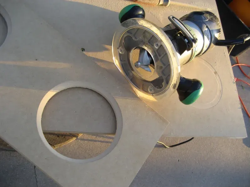

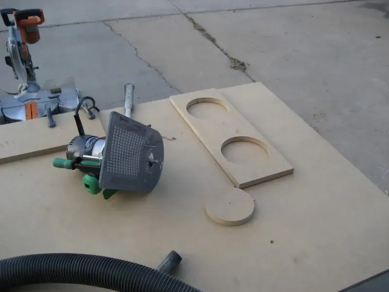

                                    thanks for the link Thomas, got some routering and gluing done last night... I have a new respect for you guys that build perfect cabinets
                                    I also learned the hard way to put the pivot pin for the circle jig down into your work bench so when you cut the last of the work piece it doesnt grab the side of your brace and go crazy... atleast I figured this out before I started on the baffles.

                                            Buy a flush trim bit. It has a roller bearing on the bottom. Use it to make the edges flush with the panels.
                                            !/2" vs 3/4" round-over isn't important
                                            Do you really have a 3/4" roundover bit? Those only come with a 1/2" shafts.

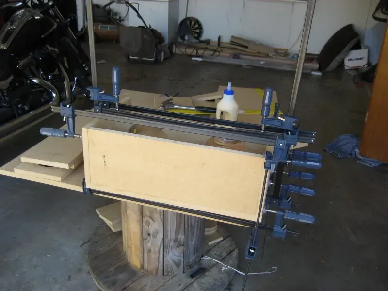

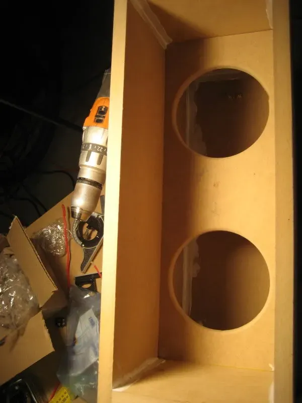

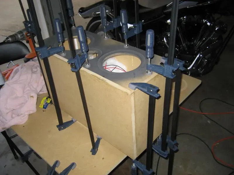

                                                    quick update: my tweeters wont be here til lext tuesday but i got one of the cabinets done and one of the crossovers done and both baffles minus the tweeter holes of course.
                                                    45 degree i put on the back of the woofer holes

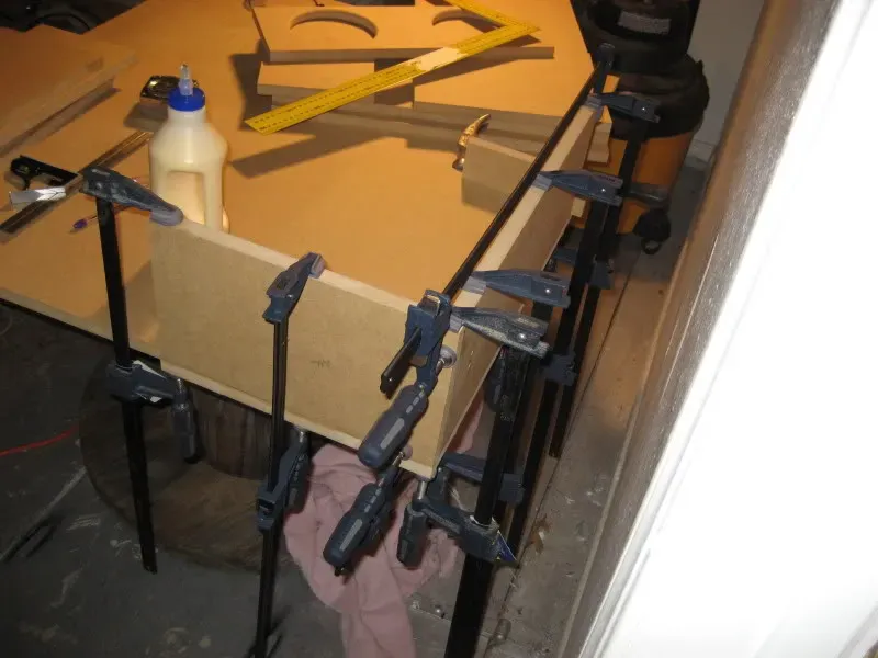

                                                    clamping the side and brace in

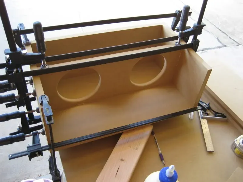

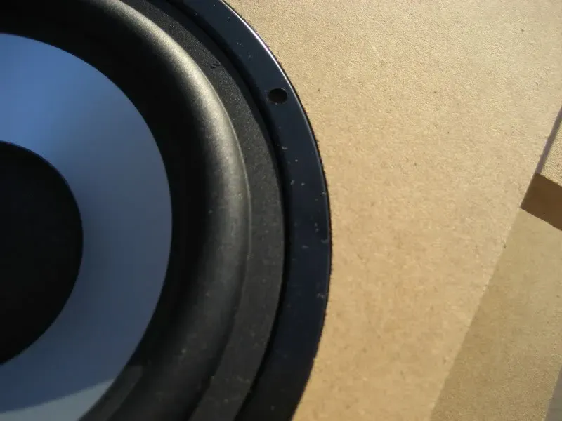

                                                    after the first woofer hole was cut i test fit a driver and it was too loose for my liking so i broke out the calipers and micrometer and got the next 3 holes to within .005 of the diameter of each driver.

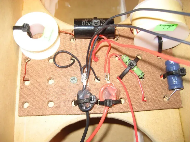

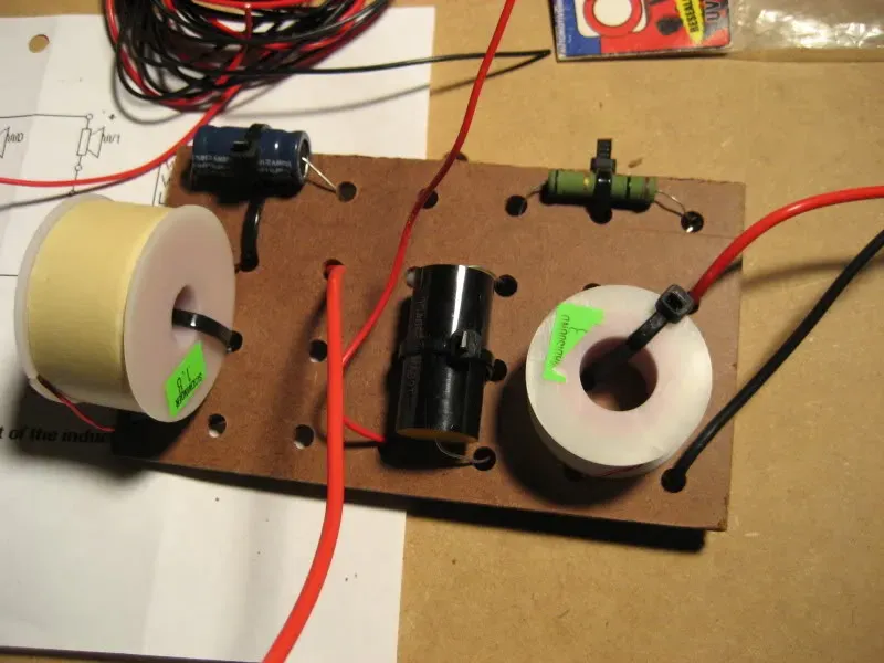

                                                    how does this crossover look? inductors should be good according to the chart I saw somewhere.

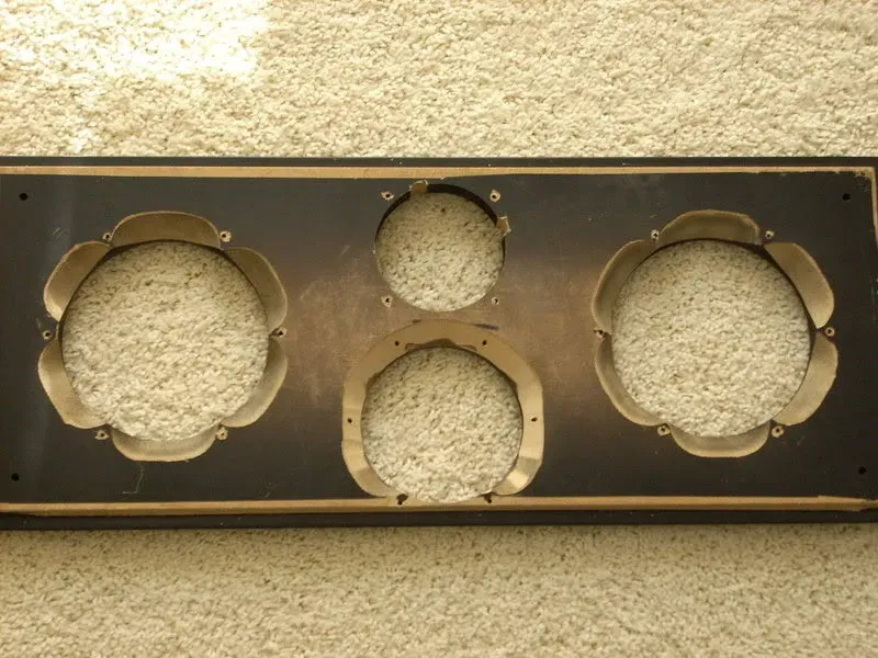

                                                          Thing is you need to leave enough 'meat' for the driver mounting screws.... that's why I posted this picture a while back...
                                                          Click image for larger version  Name:	petra03.webp Views:	1 Size:	70.3 KB ID:	941763
                                                          Last edited by theSven; 24 June 2023, 15:57 Saturday. Reason: Update image location
                                                          • savage25xtreme
                                                            • 305
                                                            kind of hard to see in the pic but I left about .3" on the front flat... with no 45 and the way it looks to me I will have a little over a half inch of meat. If it does not hold I have enough scrap to do 2 more baffles. Its all a learning process.

                                                              how do I know if they will hold? if with the gasket tape in there the drivers suck down to tight? any other signs I should look for?
                                                              I also just noticed my inductors ARE facing the wrong way.... DOH I'll fix it when I get home.
                                                                I believe Thomas is referring to the scalloped relief on his baffle verses the continuous chamber of yours. Behind the screws, his have a full baffle depth of holding power while yours is shallower.

                                                                  Really nice tight fit on for the drivers and baffle rabbet, but what if you want to paint the baffles? What then? :W

                                                                    ya i realize what he is talking about, I just wasn't sure if mine will hold or should I start over?
                                                                      I was going to put a coat black primer in the cut out then mask it off for painting the rest....will that not work?
                                                                        Those are baffles from one of Brandon's projects. You're correct about the scalloping, that's why I posted the pics.
                                                                          I think it will hold just fine.
                                                                          I think that will work too. :dancenana:

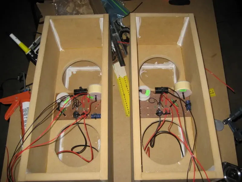

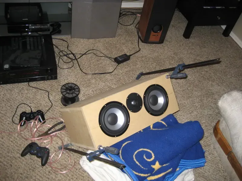

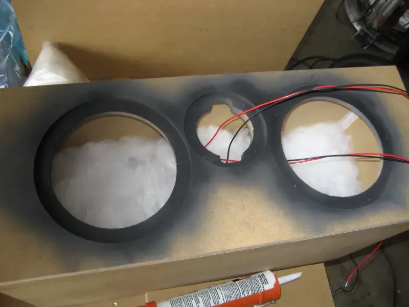

                                                                            I got one of the crossovers done and mounted and got my tweeters in Friday so I decided to clamp one of the baffles on and set the drivers in there to make sure I wired everything right.... I was VERY pleased with how they sounded and I was way to close to the speaker and I only had one going... cant wait til they are both done :T
                                                                            For these sealed enclosures should I put a bead of silicone around the inside to make sure they are sealed good?
                                                                              I usually do that. Instead of silicone I use a siliconized latex caulk. It's cheap, cleans up with water, and doesn't off-gas anything nasty.

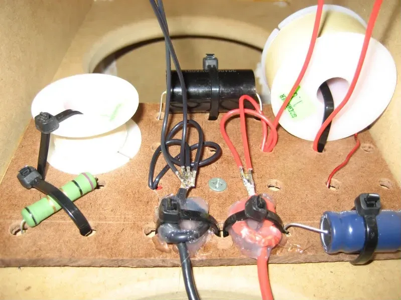

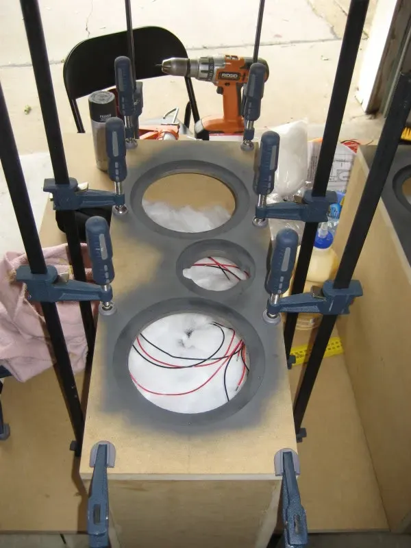

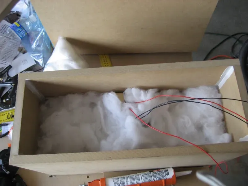

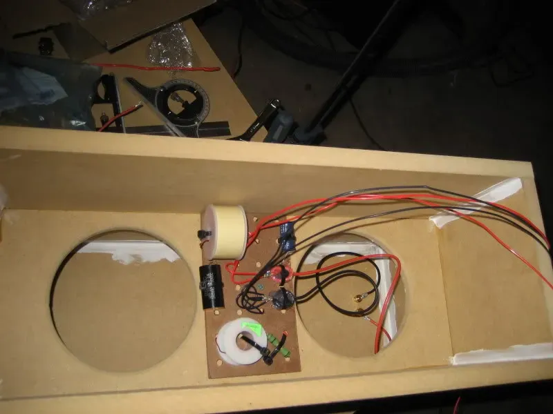

                                                                                      got the cabinets caulked up last night and both crossovers are now done and mounted. I used one screw right in the middle to mount them which holds them really well, and I don't think it will bother the inductors, or am I wrong? tonight I will stuff the cabinets and drill pilot holes for the drivers in the baffles then glue them on and start the finishing process.
                                                                                      one sack of AcoustaStuf should be enough for both cabinets right? any advice on how to put it in? on Zaph's website is just says stuff liberally and stay 5 inches from the midwoofers.
                                                                                        glue stuffing to the sides by that baffles? who knows?
                                                                                        Last edited by theSven; 24 June 2023, 16:05 Saturday. Reason: Update image location
                                                                                        Gavin
                                                                                        BAMTM Build
                                                                                          No need to do that. What you have done is fine.
