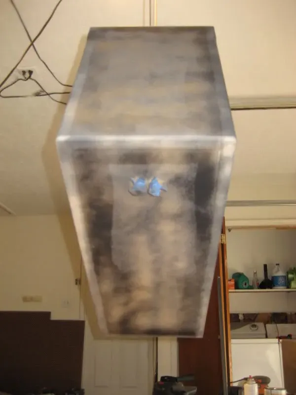

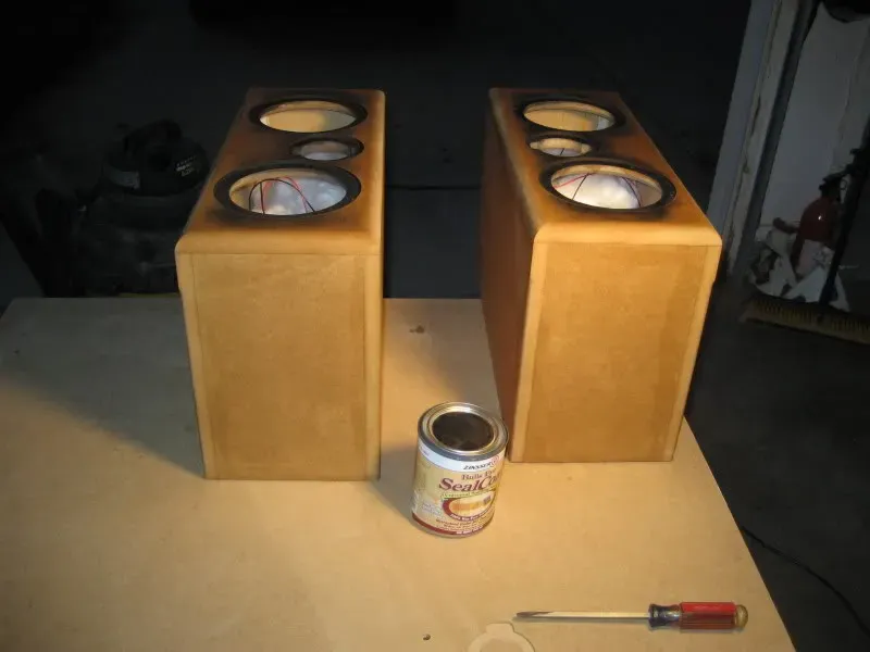

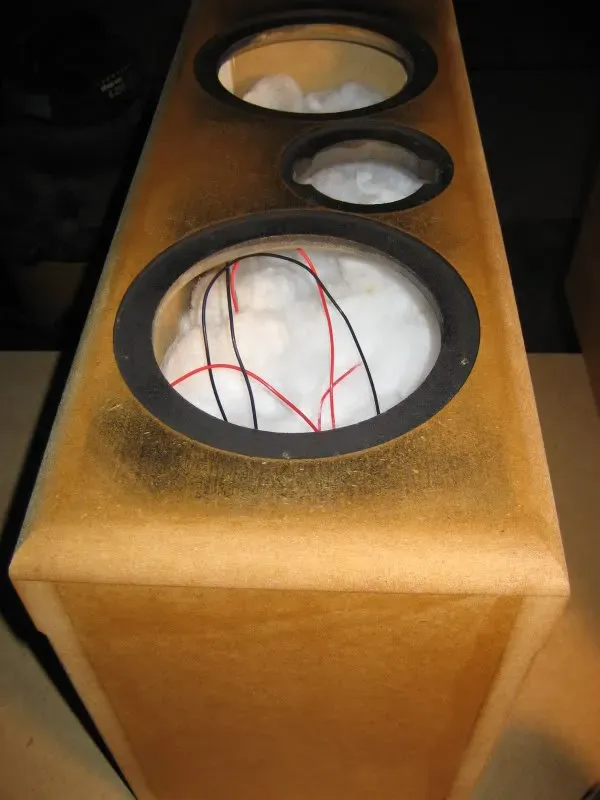

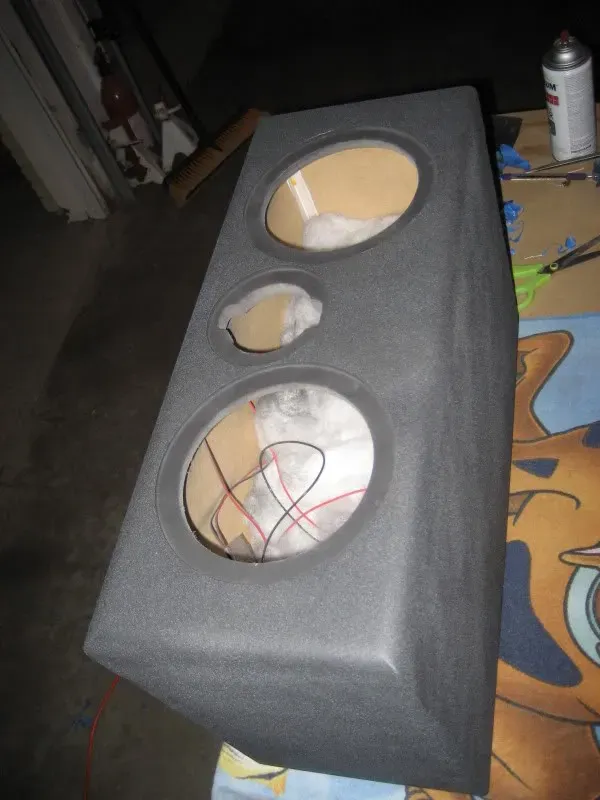

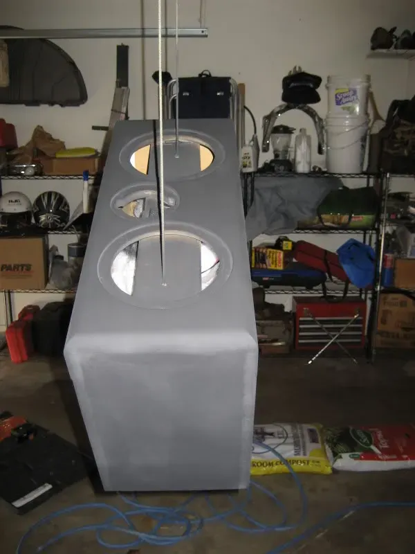

                                                    here comes the boring pics
                                                    SealCoated:

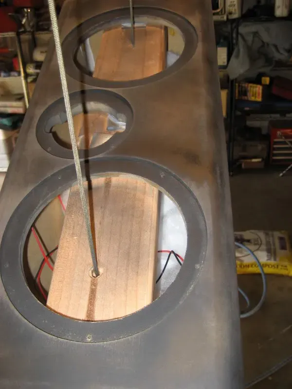

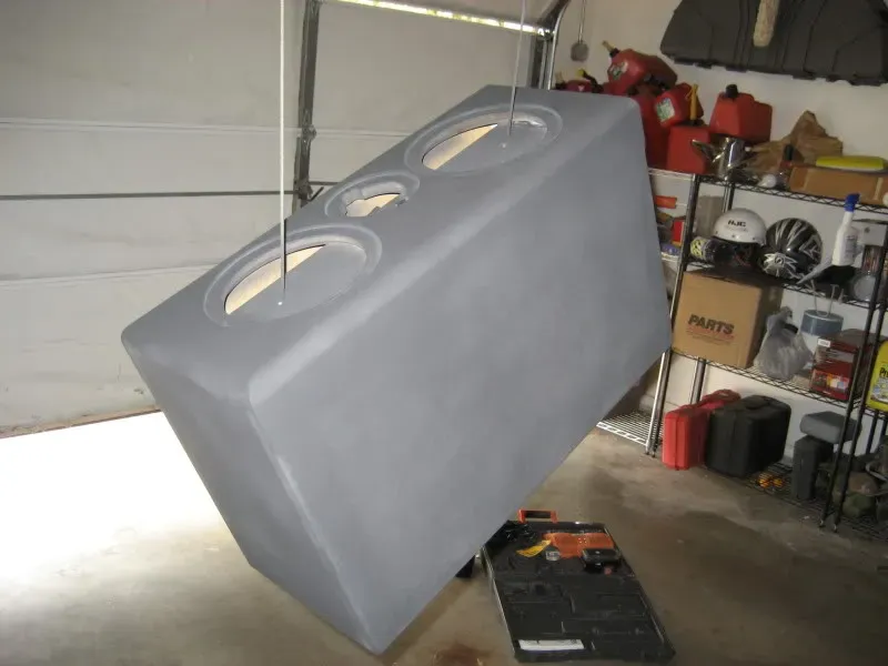

                                                    First coat of primer:
                                                    Hanging apparatus:

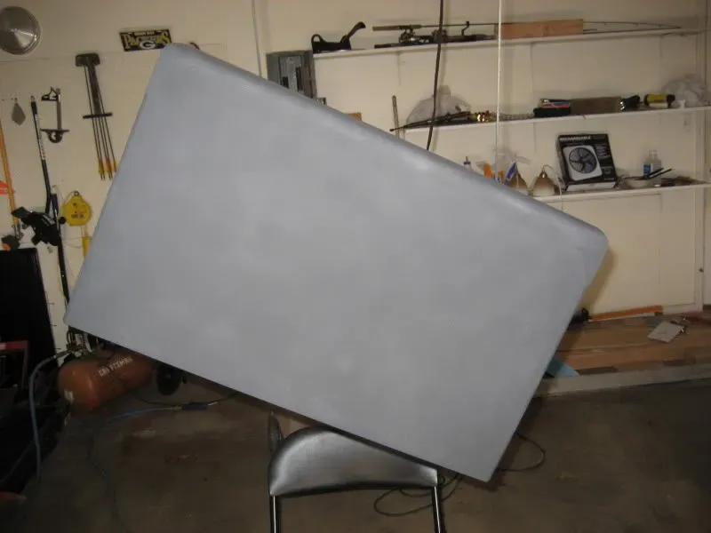

                                                    able to paint the back at the same time:
                                                    primer done on one enclosure:

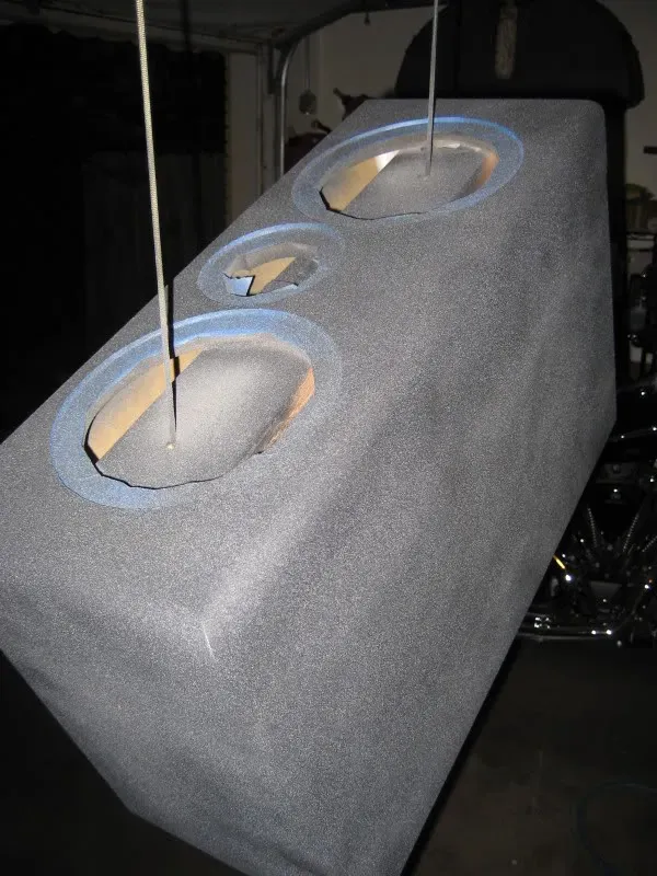

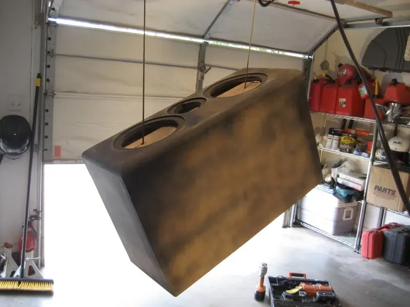

                                                    and multicolored texture paint is done:
                                                    For whatever reason the flash on the camera made the primer and textured paint look really bad, but it looked awesome to me. I will put the drivers in and take some sunlight pics today after work. Thanks to everyone for your help and support. Would not have even attempted this project without a great forum like this one to help me along. ;x( :T
                                                    Last edited by theSven; 24 June 2023, 16:11 Saturday. Reason: Update image location
                                                    Gavin

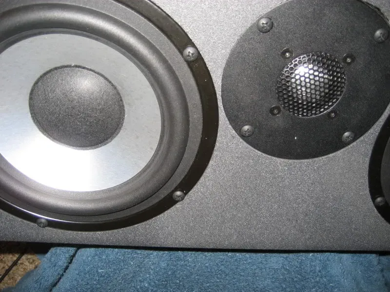

                                                      great build and great results for 350 dollars including cabinets.

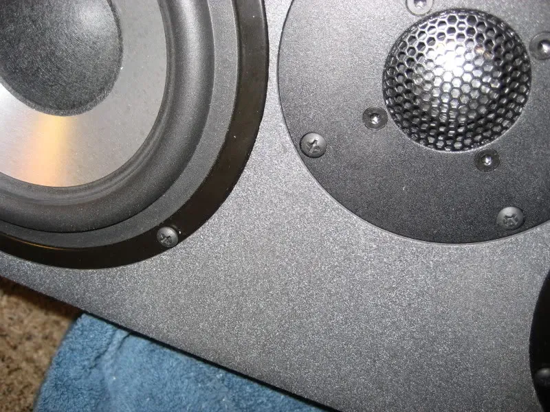

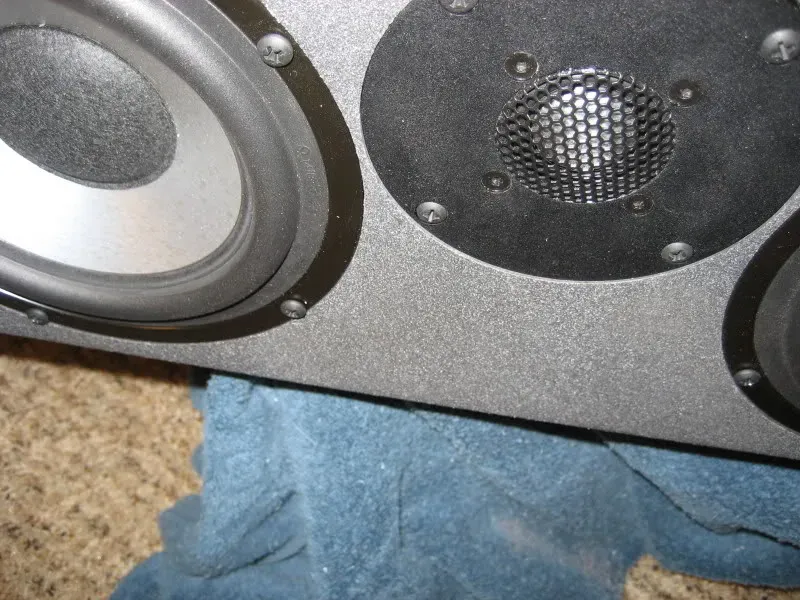

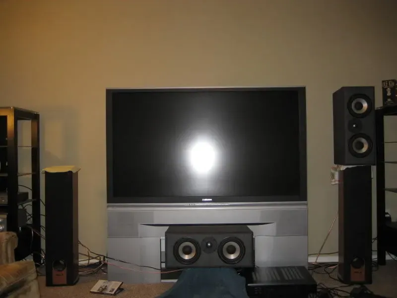

                                                      I didnt get done with the final assembly til late so I only listen for about 10 minutes then moved it to the center channel on my little pioneer receiver. with my Denon 385 I was doing A/B switching between my Polk R30s and my BAMTMs. Anything 200hz and up the BAMTMs destroyed the Polks by a large margin. The sealed BAMTMs are weak in the bass department, but we already knew this. then I hooked it up as my center channel as pictured and just watched some HD American Idol (no comments) it sounded SOOOO much better than what I was using that I couldn't move it... might stay there a while haha, but I'm not even going to tell you what I had there. again thanks for all the help. I will be around the forum keeping up til I start my next build. Its nice to have a project waiting for you at home that your excited to get to every night :T ;x(
