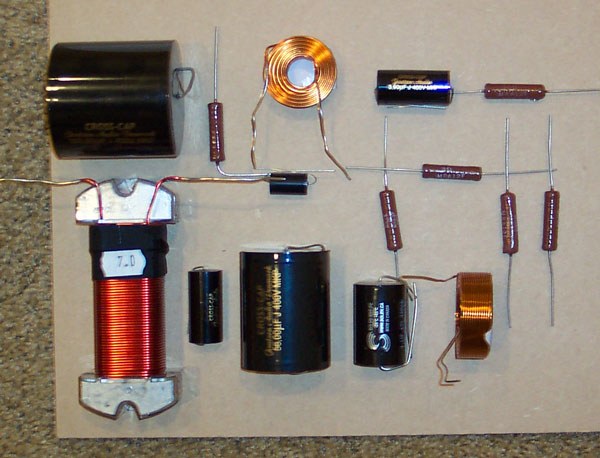

        Inductors
        My crossovers are going to be on single boards in the bases of my statements. Do the inductors look too close?

          In reference to the post above, I just measured the crossover board thickness and the 100 uF cap, and it looks like I'm going to have to make the bases a little higher.

              • 1Michael
                • 295
                The inductors should be at least 20 centimeters apart :T

                  Inductor placement
                  -David
                  As we try and consider
                  • Gusta

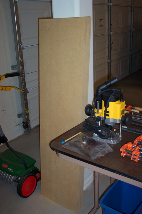

                    DeWalt 621
                    I need kick it up a gear now since my garage will soon turn into an oven (Arizona). I hope the temperatures don't affect the gluing process too much.
                    I finally got all of the pieces cut and I finished gluing the midrange enclosures. Now I need to glue the baffles and start the routing process, but this will be my first time using a router 8O (DW621), and have some questions.
                    1. For small pieces, how do you guys hold them down, if at all, when routing since it seems the clamps will get in the way? For example, internal braces. Has anyone used the Jasper jig (I have this) for small pieces like this?
                    2. On the 621, do you leave the plastic piece on when plunging, or do you put it back on after plunging?? I'm referring to the dust collector aid. The instructions specify not have it on when plunging, but that seems non-beneficial.
                    3. How often do you recommend spraying lubricant on the bits between cuts, if at all?
                    4. I've got a bunch of Whiteside bits, and some cheaper ones that came with the router. Should I use the cheaper ones to practice with and save the Whitesides for the important cuts? I believe all of the cheaper bits are 1/4", and the Whitesides are a mix between 1/2" and 1/4".
                    5. When doing the roundovers on the baffles, is a clamped guide required? Even though there's the bearing on the bit, it seems the potential for error is greater when starting or ending the cut?
                    Thanks!
                      20 centimeters? I think not

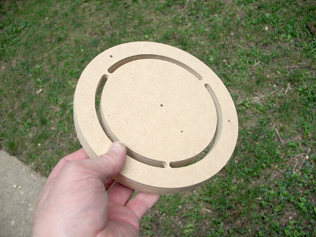

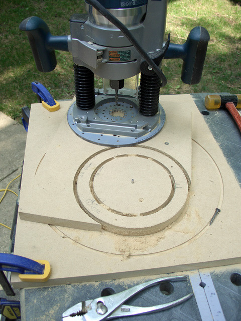

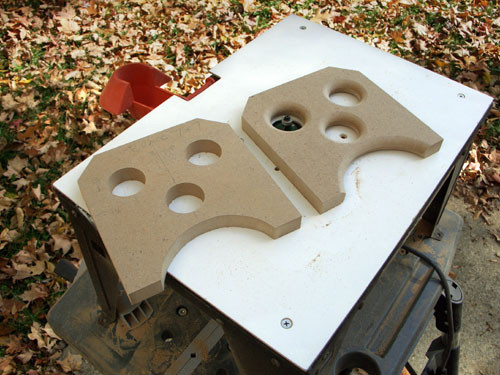

                        I'm not quite sure what kind of routing you desire to do here, but for rounding over small pieces or baffles, I use a router table. This table is a cheapy from Sears with a piece of smooth MDF mounted to the top of it to cover the horrible extruded aluminum "fins" of the original. Something like this could be cobbled together fairly easily from wood.
                        If you need to cut small pieces or small baffles, I usually tack the parts down with countersunk deck screws to a sacrificial backing board to hold the parts in place. This places the clamps well outside of the router path.
                        Plan ahead were the screw holes will be, of course. I try to locate screws in the waste, and leave a little rib of material to prevent the waste from coming free from the parent material. It gets cut apart with a small hand saw later, and smoothed with sandpaper.
                        The small holes on the ring of the part below were for dowel pins to locate them for stacking exactly (not applicable to your question), but there's a screw hole visible in the waste in the middle.
                        Last edited by theSven; 26 August 2023, 07:54 Saturday. Reason: Update image location
                          After checking out that link again, it looks like the 20 centimeters is from center to center, and only if the inductors are the same orientation. In another orientation, they can be placed as close as about 7 or 8 cm. Would you say it's still not a valid reference?
                          My crossovers will be on one board in the base, and there isn't a lot of room. Thanks.

                              • 1Michael
                                • 295
                                I always try to place my inductors 20Cm apart and I put one on its side if possible in accordance with the posted chart.
