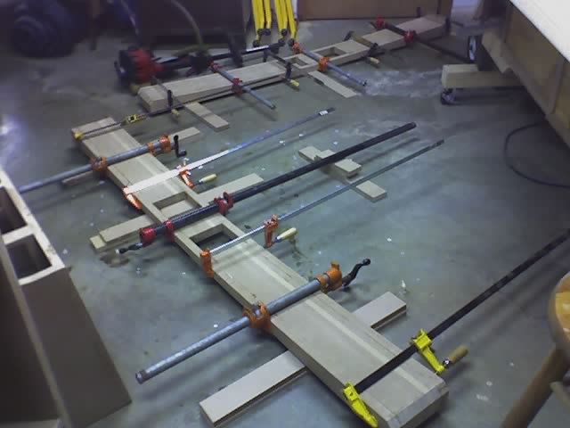

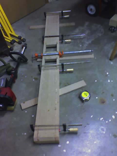

    Once those were all cut out I then began gluing the three layers of curves together - being sure to keep all the parts together for each individual speaker and correctly orienting top and bottom...
    The last two pictures show the curves properly glued up and clamped...
    Again, the two skinny side strip curves are exactly 1" wide each... And, the middle wide curve is 5" wide... That accounts for the 7" wide rear of the speaker and made cutting out the 5" x 5" midrange opening very easy and straightforward...

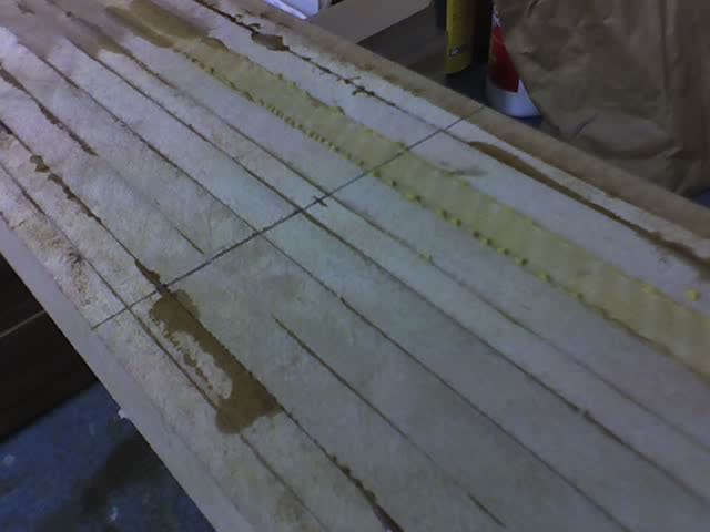

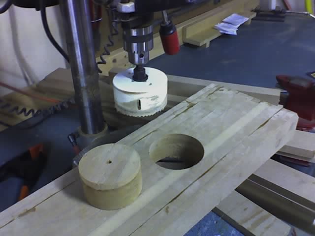

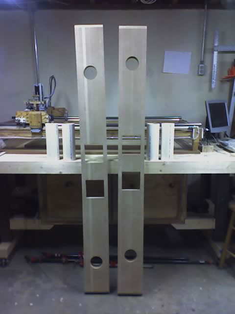

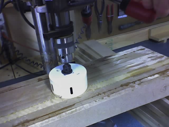

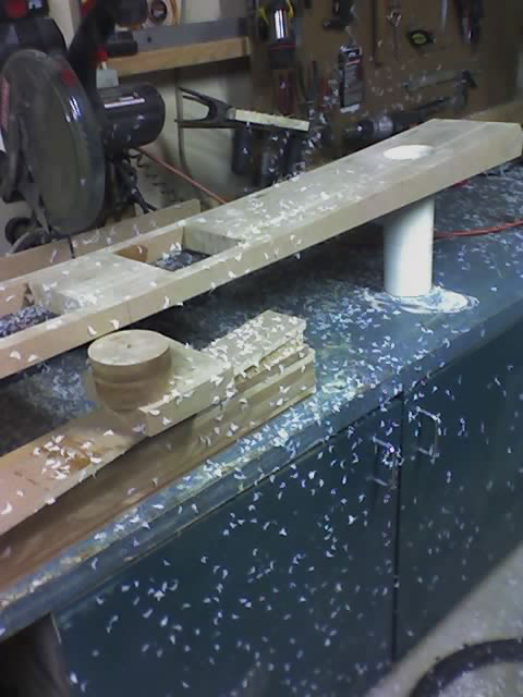

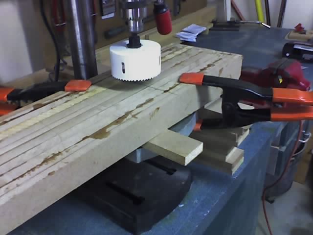

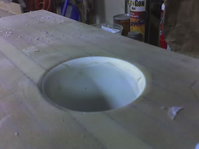

          These pictures show drilling the holes in the rear curves for the ports...
          Pictures 1 shows drawing out the centers of each port hole...
          Pictures 2 and 3 show drilling the port holes using a 3 1/2" hole saw...
          I first drilled a 1/4" hole all the way through the curve because the curves were thick enough to where I had to start the hole saw on one side and finish it on the other... I simply used the center 1/4" hole as an alignment hole for the hole saw... I used lots of scrap wood to shim up the curves to the drill press and be sure that everything was good and flat and parallel so that the hole saw would cut straight through and meet up correctly when drilled from both sides... It worked flawlessly...
          Picture 4 shows the completed port hole(s)...
          The last picture shows the complete curve resting on the back of the speaker as a mock-up...
          More soon!!!
          Mark

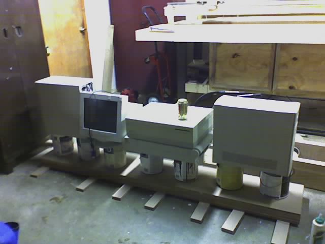

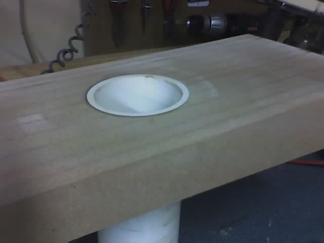

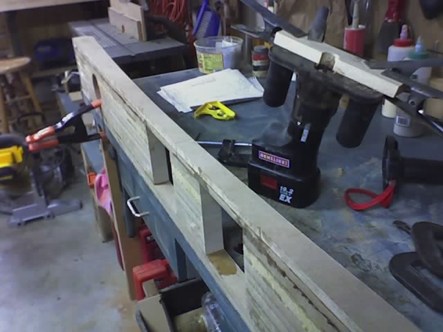

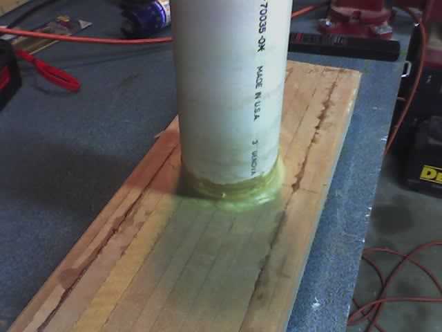

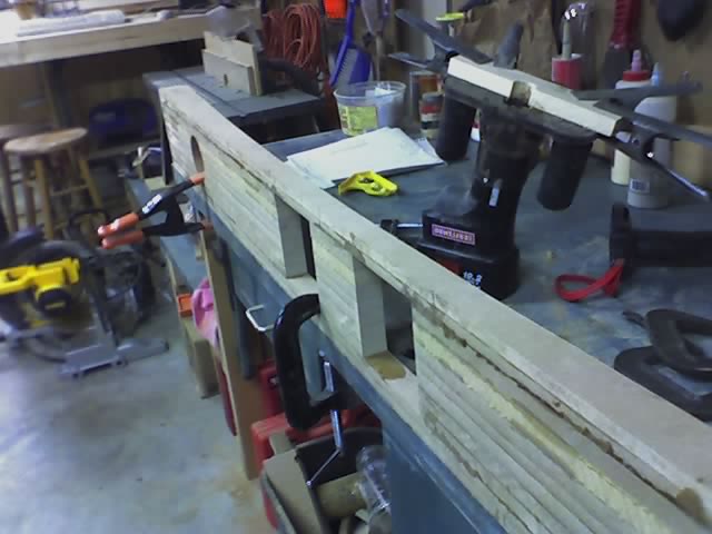

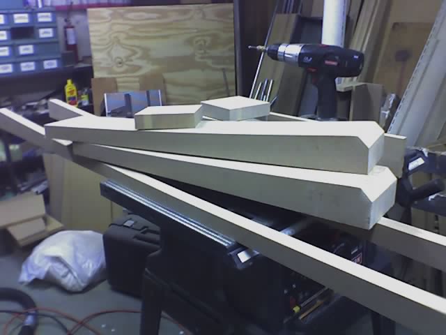

              Next I cut the four 10" by 3" ports and also did another sanding of the rear curves... They are very smooth with no raised edges...
              Picture 1 shows both rear curves and their ports... BTW, don't freak out when you see the "misalignment" of the port holes and the mid chamber holes in picture 1... I accidentally turned one upside down when I took their pictures... :P
              Picture 2 shows the PVC in the rear curve... I spread a generous amount of wood glue around the end of the PVC before I used a rubber mallet to gently tap them into place... I will also run a bead of liquid nail around the inside of the of the rear curve where the port meets the MDF just for good measure and air-tightness...
              You can see that the PVC sticks out slight on the curve due to the curve itself... Once everything dries I will sand that down and then run a 1/2" round over around the opening...
              Picture 3 shows the complete curves... On the left curve you can barely make out the 1/8" rabbet...
              I cut down the rest of my 3/4" and 1/2" MDF to glue up the front baffles... I over cut them by about 1 1/2" for the time being...
              Picture 4 shows what you can do with a ton of paint cans and old computer equipment can do... :P
              Wow... Typing all that reminded me of the long day... I am very happy with the progress and so far all is good...

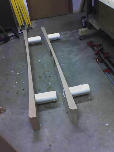

                          Question on Veneering with Heat Lock

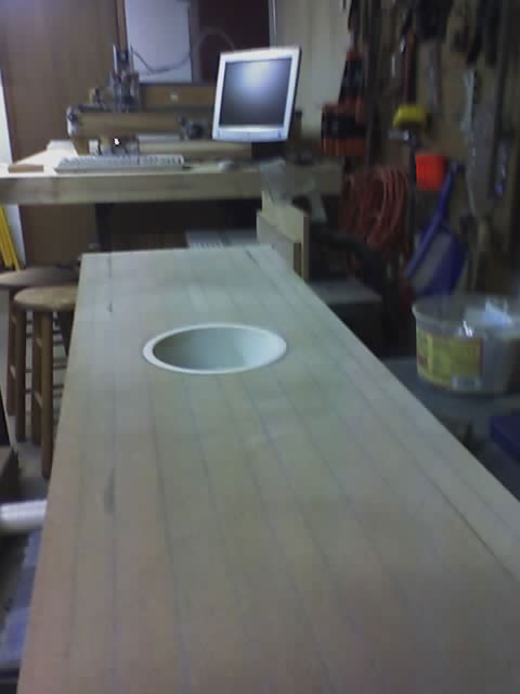

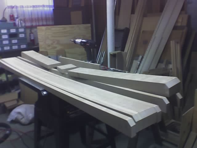

                                  Last night I made great progress on the rear curves...

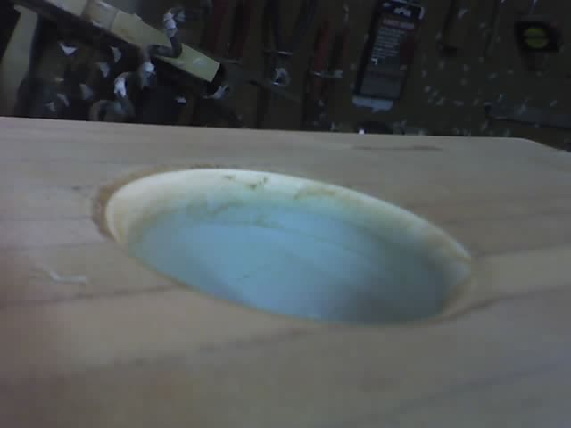

                                  This first set f pictures shows the completed ports...
                                  Picture 1 and 2 show the ports after I sanded the PVC down flush with the MDF... It looks like there is a shadow but really that is just where the MDF is a different color due to the glue... Believe me it is super sooth...
                                  Pictures 3 and 4 show the ports after I routed it with a 1/2" round-over bit... Safe to say that I was just a LITTLE nervous about this step since it was a one shot deal basically... Lots of test cuts in scrap were done first... After I routed them I just took a sanding block and did a few very slight touch-ups... They look awesome...
                                  The last pictures shows the PVC "feathers" (as my wife called it as she laughed at me) that covered my shop after I did the routing... This stuff was horrible... Not only was it super light so it floated everywhere... It was also full of static so it clung to everything... Ha ha...
                                  I am SUPER happy with the way the ports turned out!!!
                                  Mark

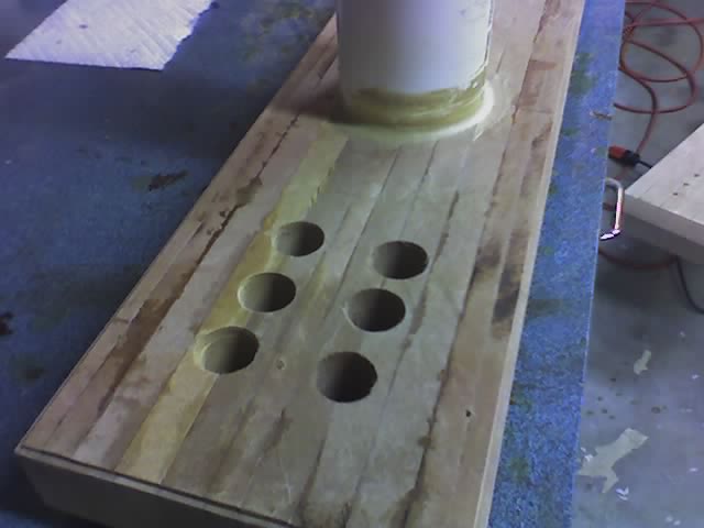

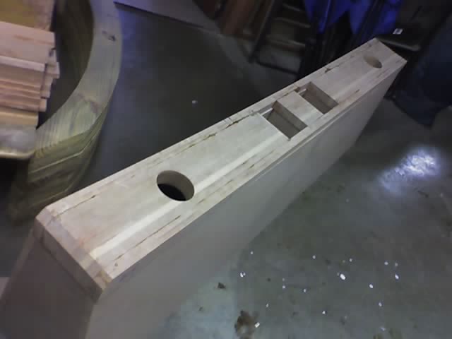

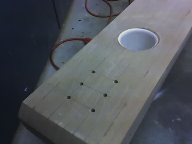

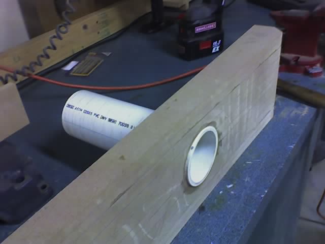

                                    After the ports were complete I turned my attention to where the binding posts will go...
                                    After laying out some nuts on the curves so that I could kind of mock-up what the binding posts will look like I settled on a spacing pattern...
                                    Picture 1 shows the six 1/4" holes I drilled for the bind posts... Yes, there are six binding posts per speaker because I am going to do external crossovers... After shopping around quite a bit I finally determined that whether I use a fancy multi channel plug or just six separate binding posts - the price was within a $10-15 buck of all the options... So, I though the six silver binding posts would look the coolest... :P
                                    Picture 2 shows the larger holes I drilled in the back of the curves... The bind posts I got from Parts Express are for 1" thick walls... The curves are much thicker than that... So, I took a 1" forester bit and hollowed out the back of the curve till it was approximately 3/4" - 1" thick for the binding post to successfully work...
                                    Here is a link to the binding posts I am using:
                                    Finally picture 3 simply shows a bead of liquid nail I spread around the inside of the curve for the ports... Figured it couldn't hurt...
                                    I am super happy with the rear curves... In fact I don't think they could be any better... They took a long time but well worth it and I also learned a lot by building them...

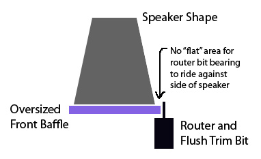

                                                      Question on Trimming Front Baffle
                                                      Hey guys,
                                                      Okay, I have another question:
                                                      I am beginning to layout my front baffles (which glued up beautifully by the way)...
                                                      However, the fronts of my speakers are not perfectly square... They are out maybe a 1/16" to an 1/8" of an inch... :cry:
                                                      So, I know the popular method of dealing with this is to cut the baffles slightly oversized and then trim them with a flush trim router bit...
                                                      This is cool and I did cut my baffles oversized...
                                                      However, my question is since the footprint of my speakers is not a rectangle I do not have a perpendicular surface to run the flush trim but against...
                                                      The footprint of my speakers are more trapezoidal in shape... The front baffles are wider than the rear of the speaker...
                                                      So, what do you guys think would be the best way to get the perimeter of the front baffles to match the shape of the speaker cabinet???
                                                      Any and all ideas are greatly appreciated!!!
                                                      Mark
                                                        #207
                                                        So your saying the baffle should be angled a bit on the side? I don't think it would look bad at all if they weren't. Either that or I'm not sure what you mean
                                                        • David_D
                                                          • 197
                                                          #208
                                                          I would say...
                                                          Glue the oversized baffle on
                                                          Trim a square egde with the flush bit
                                                          Knock off the corners with a 3/4" Roundover
                                                          Then sand with a block on the sides to blend
                                                          You'll take off some of the rear of the round over but, who cares.
                                                          That's my vote anyway.
                                                          -David

                                                            Hey guys,
                                                            Thanks for the quick responses but I don't think I explained myself correctly... Or, maybe I did and I don't understand the answer... :P
                                                            Attached is a quick sketch I did...
                                                            Notices the sides of the speaker are not perpendicular to the edges of the baffle; so there is no place for the bearing of the flush trim bit to ride in order to give a good profile and trim the baffle correctly...
                                                            I hope this makes more sense... Or, maybe I am not thinking this through all the way...
                                                            Any ideas???
                                                            Mark

                                                              #210
                                                              Yeah you're probably going to have to hit it with a belt sander or do it by hand.
                                                              • Jed
                                                                • 3621
                                                                #211
                                                                Originally posted by mlammert
                                                                Hey guys,
                                                                Any ideas???
                                                                Mark
                                                                Create a temporary "wedge" or piece of wood at the angle to make a 90 degree platform to run the router bit against. After you are done routering, remove it. You could use staples to keep the wedge in place and then pry it off later.
                                                                  #212
                                                                  I'm not sure if he wants the edge to be perfectly flat or angled in with the sides?
                                                                  • mlammert
                                                                    • Dec 2007
                                                                    • 373
                                                                    #213
                                                                    Jed, that is a pretty good idea... I could tack on a very thin strip of wood to have the bearing run down... 8)
                                                                    Dougie, I want the edge of the baffle to be "flat"...
                                                                    Attached is a footprint view of the speaker... You can see that the sides of the rear curve and the front baffle are "flat" compared to the "angled" sides of the body of the speaker... Hope that makes sense...
                                                                    If nobody else has any mind storms, I think I will try Jed's idea...
                                                                    Thanks guys,
                                                                    Mark
