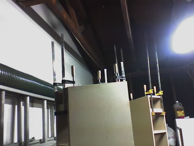

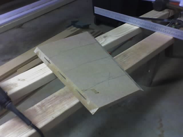

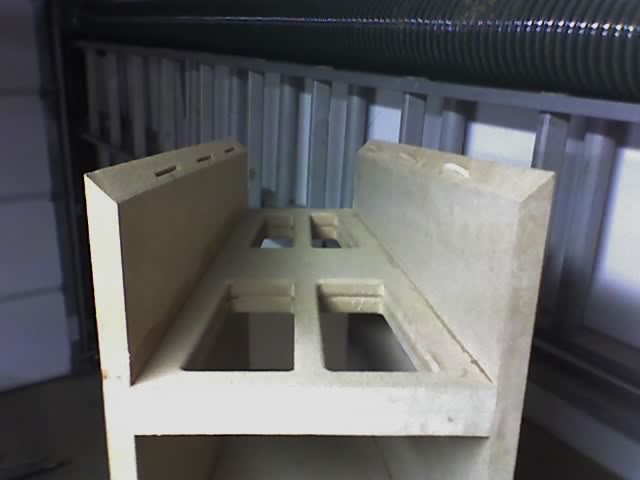

    After all that I cut the tops for each speaker...
    This turned out to be much more straightforward that I was thinking...
    I used the scrap wood that was left over from cutting the angled/beveled top edge of the speakers... That way I already had one side for the top that was at the correct angle and 45 degree bevel... Using those scraps I measured and cut the other side for the tops and they came out perfect...
    The first picture below shows the top panel... You will notice the biscuit slots again...
    The second picture shows the matching biscuit slots that I cut into the top edges of each speaker... A bit precarious to cut; but they came out awesome...
    Now, I must admit at this point I made a very basic goof... :roll: Nothing negative but just not thinking all the way through:
    You will notice that I cut three biscuit slots on each side... Well, due to the 45 degree angle on each side there is no way to "slide" the biscuits and tops down into the sides on BOTH sides...
    So, even though I didn't need all the biscuits I did use biscuits in one side of the speaker so that they would hold/brace the tops very tightly while I clamped them down...
    You can see this in the last two pictures...
    Also, since I cut the 45 degree angles with my skill saw (not perfect) I decided to use liquid nail on these joints just in case there were any slight gaps/voids in the joint...
    Even more to come shortly...
    Mark

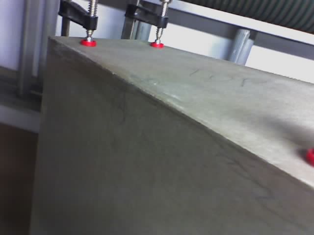

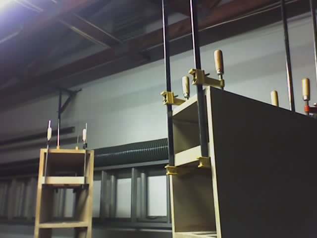

      Two more pictures to show the edges of where the tops meet the sides of the speakers...
      The camera phone really doesn't do these justice... I think you could cut your finger if you ran it down the edge fast enough... 8O
      I am VERY proud of these angles and joints... Very solid, square and tight!!! :B
      Due to the fact that the speaker tops are sloped back; after the glue dries I will once again take the belt sander and lightly remove the ever so slight over hang that appears where the top panel meats the perpendicular front and back planes of the speaker...
      Off to run some errands...
      Thanks guys!!!
      Mark

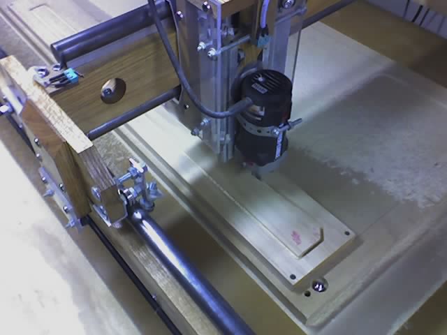

            I made some more good progress on Sunday...
            The tops of the speakers dried perfectly and now the clamps are removed...
            The next thing is to create the rear curve of the speakers...

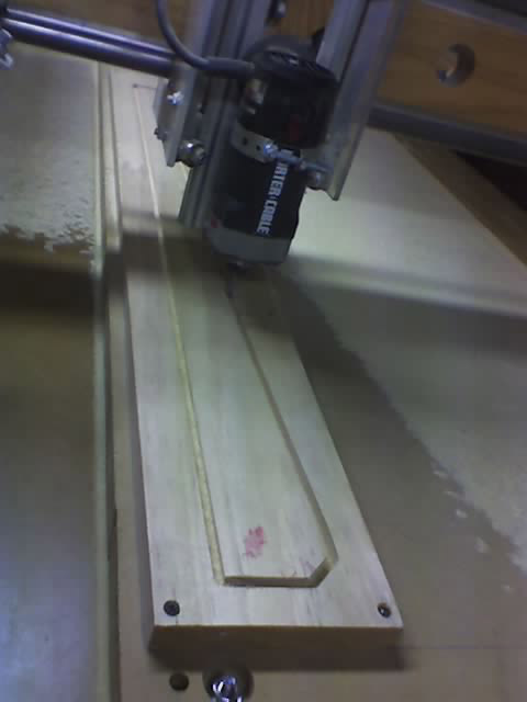

            My first idea of using a fairing stick to create and draw the curve did work (as seen in the first picture)... However, using the band saw to cut the curve and then sanding the curve down failed miserably... The curve is just too shallow to really get a good consistent smooth curve from any sort of band saw or sanding methods... Maybe a better woodworker could do it - but I cannot... ops:
            So, then as I am pondering how to do this, I look across the shop and realize "hey you have a CNC machine that is now actually in working order"...
            So, I quickly exported the curve from Google SketchUp, imported it into Adobe Illustrator and then converted it to G-Code to run on the CNC machine...
            The CNC machine is not big enough to cut the entire curve in one piece so I made two matching halves that I will join when I make the jig for cutting...
            The second and third pictures show the curve being cut on the CNC machine and the last picture shows the final curve cut out... It took the machine 15 minutes to cut each half of the curve...
            It came out beautifully!!!
            Hopefully this week I will be able to cut out ALL the strips of MDF to create the curve and then this weekend route the curves and glue them together...

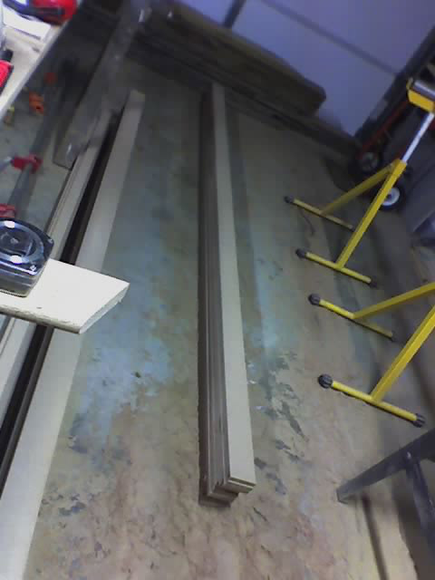

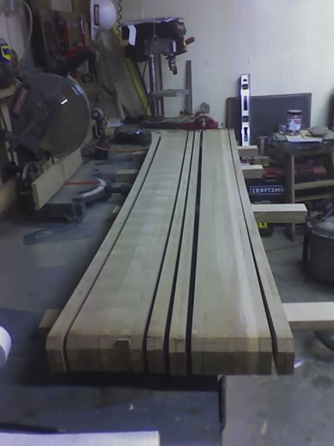

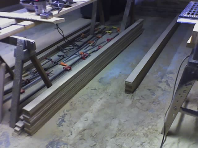

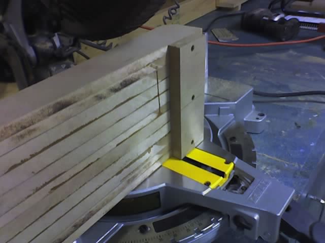

                        I have all the 3/4" and 1/2" MDF strips cut that I will use to laminate together for the rear curve...
                        Picture one and two show the stacks of strips:
                        12 - 3/4" strips
                        10 - 1/2" strips
                        I have a pile of MDF dust in my garage about 4 inches deep... 8O
                        The third pictures shows the jig I made to trace and route the curve template onto the strips...
                        Once the jig dries (I glued and screwed it) I will use it to trace the curve onto the strips...
                        Then make a rough cut on the band saw... After that is the routing and the gluing... Sweet!!!
                        Hopefully more to come this weekend... I don't know though due to a big Halloween party we are going to... I am going as Louis Tully shortly after he has been turned into Vinz Clortho, the Keymaster... :P Should be fun...
                        Later,
                        Mark

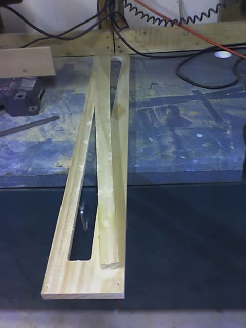

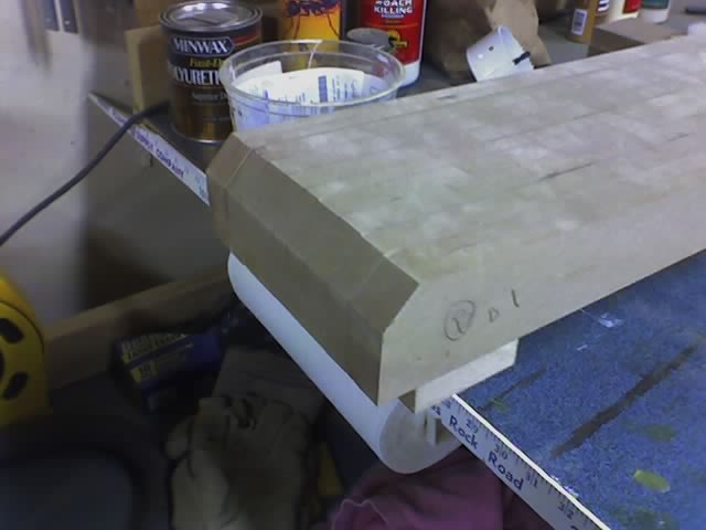

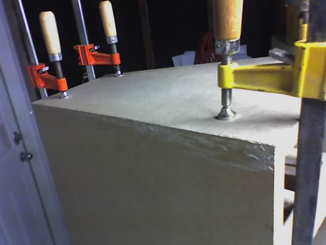

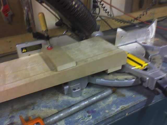

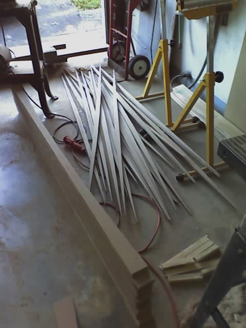

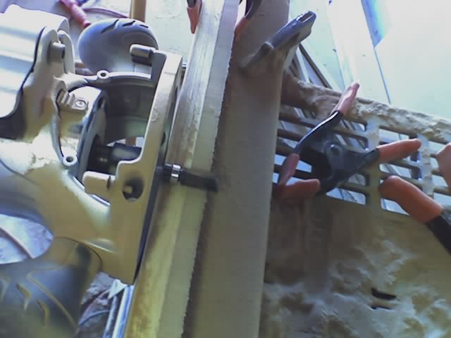

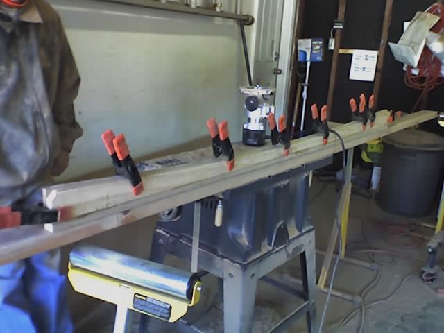

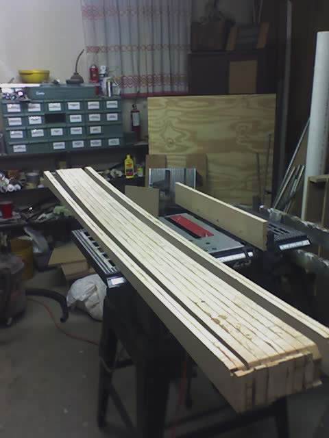

                                    Hey guys,
                                    Here is some more updates and photos...

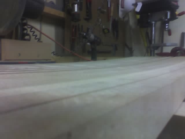

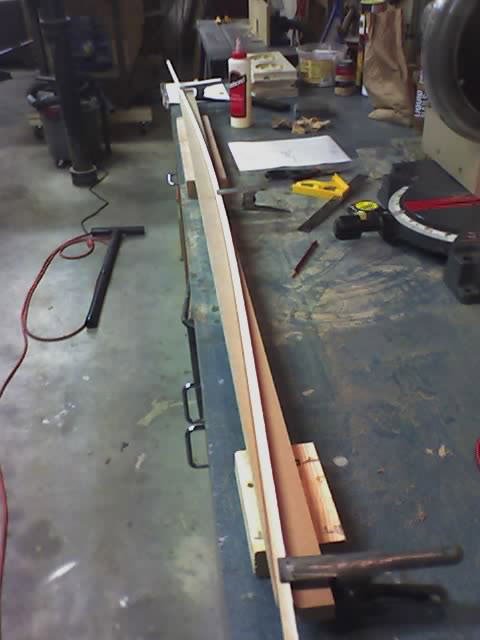

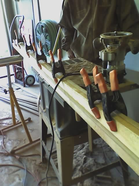

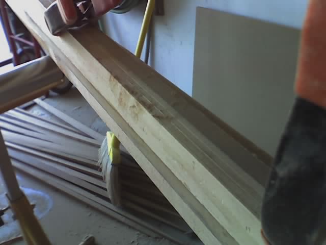

                                    Photo 1 shows all the scraps of the rough cut curves... 22 of them in total... Did the rough cut on the band saw... Went smooth and quickly...
                                    Photos 2 and 3 show my original curve template screwed to a straight 2x4 and then clamped to the edge of the table saw to use as a work surface...
                                    After a bit of contemplating we found that the template worked MUCH better on its side...
                                    BTW, we did try David's dowel idea... It did indeed work very well... However with the drilling inserting and removal of several dowels per curve piece it just simply took too much time...
                                    The way we ended up doing things was I stood on one side of the template and held the router and routed down the curve of the template... My buddy was on the other side of the template and simple swapped out hand clamps as I smoothly routed down the edge of the template... Took just over a minute per curve...
                                    Photo 4 shows the end result of a routed curve piece next to the template... Darn near perfect...
                                    Photo 5 shows the how the router was held on its side and simply road down the side of the template...
                                    All in all it was a very productive and straightforward day... :T
                                    The most annoying thing was going out to purchase the pattern router bit... Had to go to two different places to find one and still could only find a 1/4" shank bit... But, for $13 bucks it did its job well...
                                    I also bought a 3 1/2" hole saw for the ports...
                                    I will update with more pictures tonight as a start gluing together the curve pieces!!!

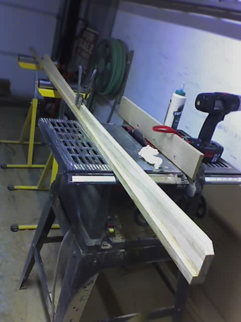

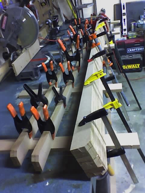

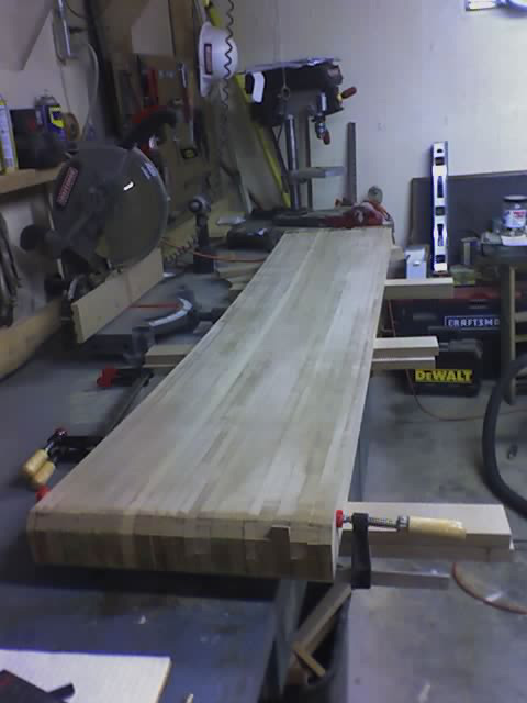

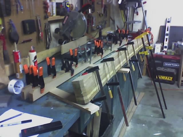

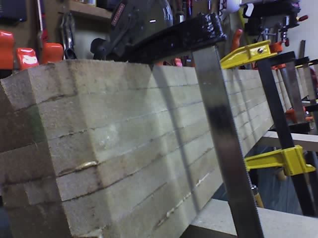

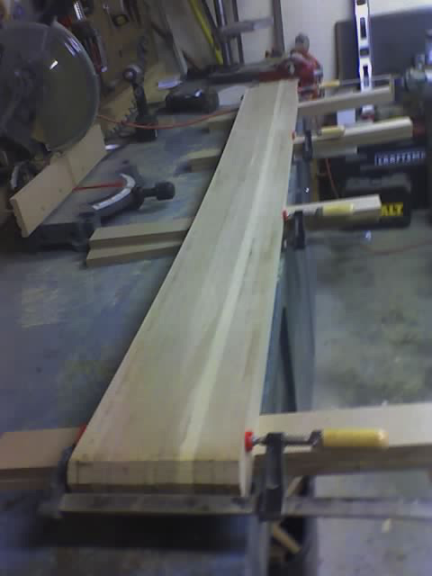

                                        Here are two more pictures of the curves being glues together...
                                        I only have enough clamps to do one side at a time...
                                        So, I am clamping two 1 inch strips together and one 5 inch strip together...
                                        Once the glue dries I will cut appropriately and then glue the three strips together to form the back of the speaker...
                                        The curves came out super smooth and should require minimal sanding to achieve a nice uniform surface...

                                                        #162
                                                        Hey guys,
                                                        Here is another update...
                                                        The first set of curves were successfully glued up...
                                                        The first picture shows the results of the glue up... The curves are very uniform and for the most part very smooth... The "lines" that you see are mostly glue squeeze out... Nothing that a bit of scraping and a little work with the orbital sander can't take care of...
                                                        The second picture is the second set of curves being glued up...
                                                        So far so good...
                                                        After all this I just need to saw them appropriately using the miter saw...

                                                                    I am VERY VERY happy right now!!!
                                                                    One of my big concerns was how good the curves were going to come out...
                                                                    Well, I just got finished sanding them and they turned out awesome!!!
                                                                    They are as smooth as a baby's butt...
                                                                    The first pictures shows all the pieces of both curves clamped together in order... Whenever I cut multiples of the same curve I like to clamp them together when sanding so that they all come out uniform...
                                                                    After I did a decent job sanding all the curves together, I then clamped just the curves for one speaker together and repeated the process... This is show in the second picture...
                                                                    The third picture shows a little trick I use where you scribble a pencil on the surface you are sanding... Sand just enough to erase the pencil and you will see where you have low and high spots where the pencil erases and doesn't erase... This also prevents you from over sanding and area... Works like a charm...
                                                                    The forth pictures shows all the curves lined up after the sanding process...
                                                                    The last photo didn't come out too well but is supposed to show how smooth the curves are...
                                                                    Now all I have to do is cut the holes out for the ports and the midrange chambers and trim the end of the curves...
                                                                    Once that is done I will glue the curve pieces together and then give it one more final light sanding...
                                                                    More soon!!!
                                                                    Mark

                                                                                            #180
                                                                                            Here are some more photos of progress...
                                                                                            Today I trimmed and cut out the curves...
                                                                                            When I glued all the curved strips of MDF together I left he ends rough... So, I used the miter saw to trim the ends and give them the 45 degree angle that I wanted...
                                                                                            Remember, the two skinny strips are still separate from the wide strips so first I temporarily attached those with some braces and screws from the back side (Photo One)...
                                                                                            With those all secured I then measured the speakers again to get the exact measurements and trimmed the ends of both curves (Photo Two)...
                                                                                            Next is a close up of the trimmed and beveled end (Photo Three)... The camera phone makes the cut not look smooth; but believe me the ends are nice and smooth and square...
                                                                                            After that was complete and removed the temporary braces and made measurements for the next step...
                                                                                            To be continued...
