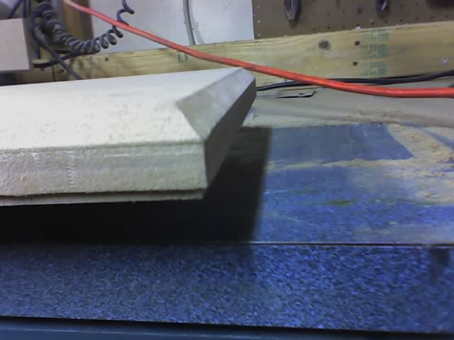

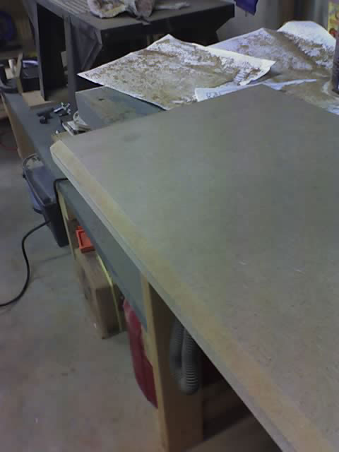

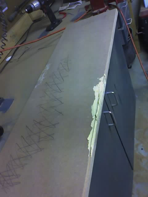

      After I was happy with the edges of the baffle I then did my 45 degree angle on the front edge and my 1/8" rabbet on the back...
      The first pictures shows the 45 degree bevel...
      The second pictures shows a close up of the 45 degree bevel and the 1/8" rabbet at one of the corners...
      The third picture (remember me having the one step forward two steps back day) shows the putty that is currently drying after my rabbeting bit decided to slip for some reason... :M
      Thank goodness it did not come out of the router... 8O But, it did damage the side of the baffle... I have no clue how this happened...
      I had some Durham's laying around (I love that stuff) so I mixed that up and the baffle should be good as new once it dries and I sand it down... The picture makes it look like quite a large area; but it is really only a couple inches...
      So, tomorrow I will hopefully sand down the second baffle, sand down the repairs, and then route all the edges so that the two baffles are complete except for the driver cutouts...
      Hopefully, if tomorrow goes better, I can also cut a few biscuit slots in the fronts and backs to aid in gluing things together when they are ready...
      I need a "beverage"...
      Mark

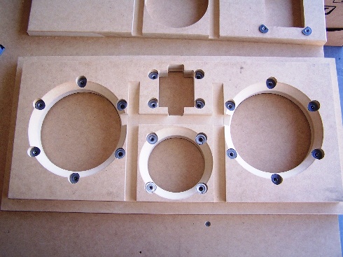

              Jim & Curt recommend that the rear of the mid (behind the front baffle) is releaved to allow the mids to breath. A little difficult with the baffle glued on. They recommend at least a 1/2" chamfer on the rear of the front baffle. There have been a number of folks that use a knife/file/saw to scallop that edge around the nuts.
              Here's an example of how I did mine...

                Wow that looks clean! Would have been hard for me to do it like that because my baffles are not removable. I will probably get hex head screws with threaded inserts with a dab of epoxy or something.

                  David, yes, I know exactly what you mean now...
                  My baffles are not yet glued to the speaker bodies yet (sorry if I gave that impression)... So, I will be using my 45 degree router bit to route the chamfer around the backs of all the speaker openings once they are cut out of the baffle...
                  I had actually already thought of doing the recessed holes for the t-nuts just like what is shown in your picture... Very nice looking by the way!!! :T
                  As Dougie said, I am also planning to do a little dab of glue or something on the t-nuts to help out...
                  Dougie, question: why would the baffles need to be removable in order to do what David shows??? It's been a long day; maybe I am not thinking this through all the way...

                        • 3815
                        #236
                        Mark, this is what I did and it also has the secondary effect of not trashing the entire speaker should you mess up on the baffle.
                        -Chuck

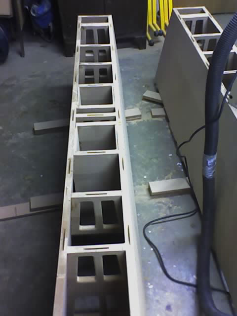

                          I made some really good progress today...
                          I got the second front baffle cut and sanded and the 45 degree bevel routed and the 1/8" rabbet routed...
                          It came out very nice!!!

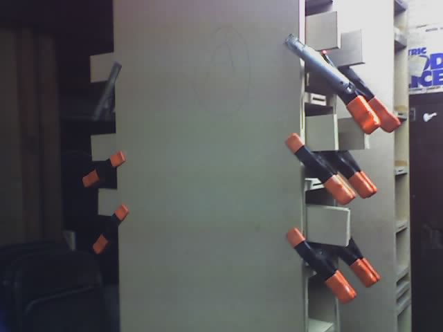

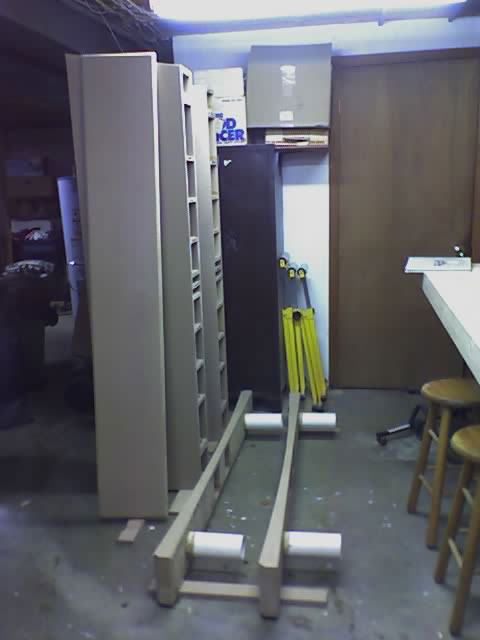

                          I also went ahead and cut biscuit slots in the fronts and backs of the speaker bodies and in the baffles and rear curves...
                          These came out very nice as well...
                          The first four pictures show the biscuit slots in all the pieces...
                          The last pictures shows all the parts!!! I just have to router the driver cutouts and assemble... :B
                          Mark

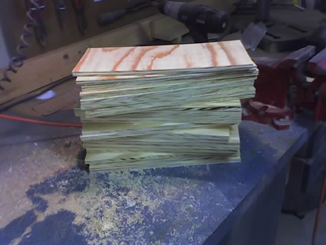

                            I had some 1/4" plywood scrap laying around and remembered reading a post about one person who glued some to the inner sides of the speakers and got good results...
                            This person apparently made two sets of Statements and could tell a difference between the one with and without the plywood...
                            So, since I had it I decided to cut it into strips and will glue this to the side walls where the woofers are...
                            I am going to start laying out the crossovers as well tonight...
                            Mark

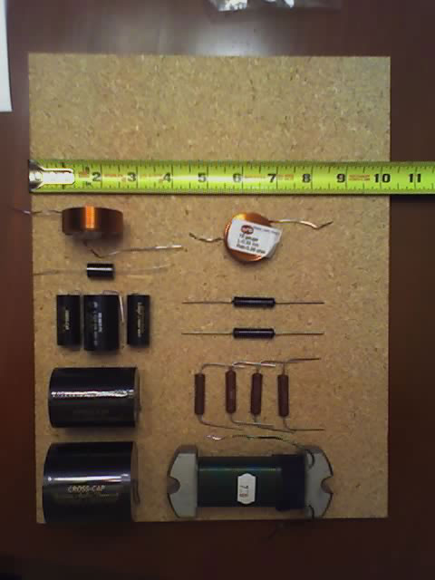

                                  I wanted to get this posted before I left...
                                  Here is a picture of my proposed crossover layout...
                                  I was going off of this page (http://www.troelsgravesen.dk/coils.htm) for proper coil placement...
                                  If anybody sees anything horribly wrong, please let me know...
                                  I appreciate it!!!

                                    #242
                                    Looks like a good layout to me. The crossovers will produce a bit of heat but not a lot in most cases.

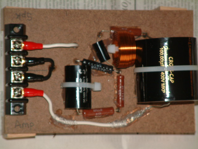

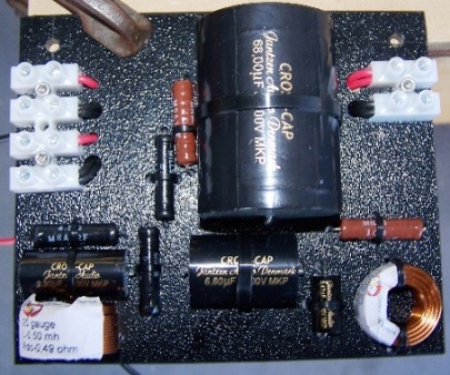

                                              • mlammert
                                                • Dec 2007
                                                • 373
                                                #248
                                                Hey guys,
                                                Quick question:
                                                I have tried to do a ton of searches on the forum looking for pictures of Statement crossovers... I have been able to find zero...
                                                Does anybody have any links to any threads or sites that have pictures of completed or in-progress Statement crossovers...
                                                I have never built a crossover before and am beginning to feel the intimidation...
                                                Thank you!!!
                                                Mark
                                                • FroDaddy
                                                  • 274
                                                  #249

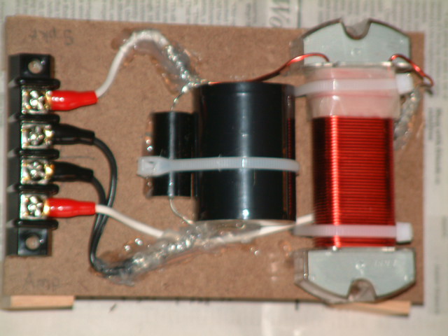

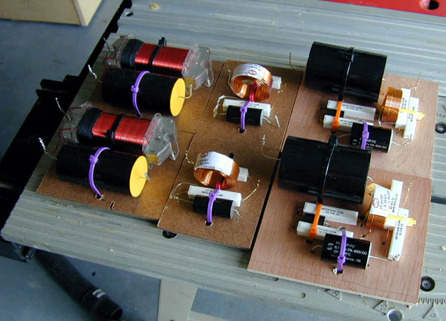

                                                  I found these on my hard drive, they aren't mine though. I know one of the pictures is sefferdog's.
Name:	statements - crossover layout.jpg
Name:	statements - crossover layout1.jpg
Name:	statements - crossover layout2.jpg
Name:	statements - crossover layout3.jpg

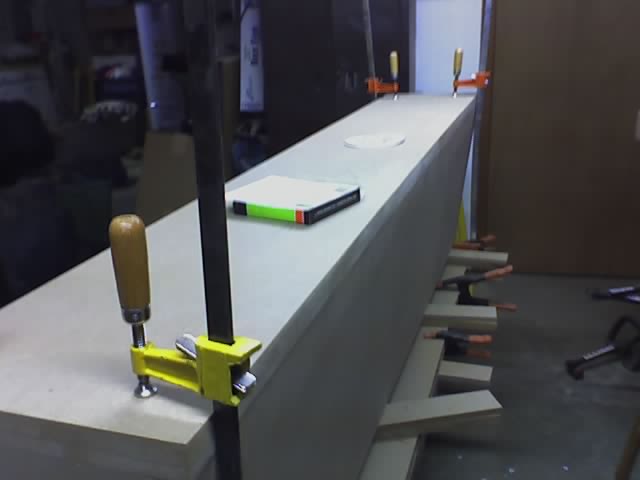

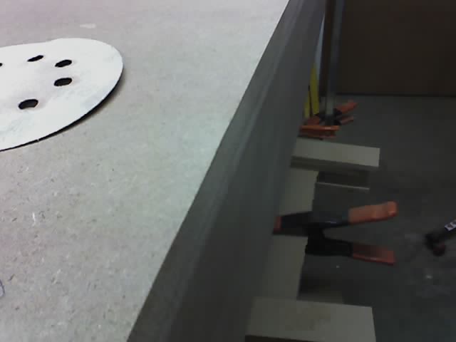

                                                      Here is some more progress pictures...

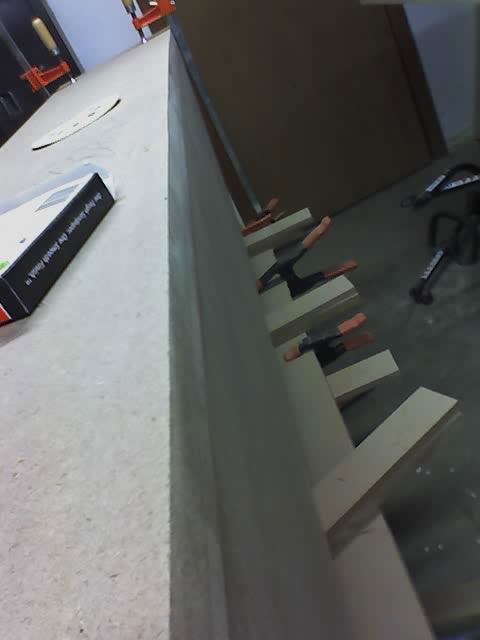

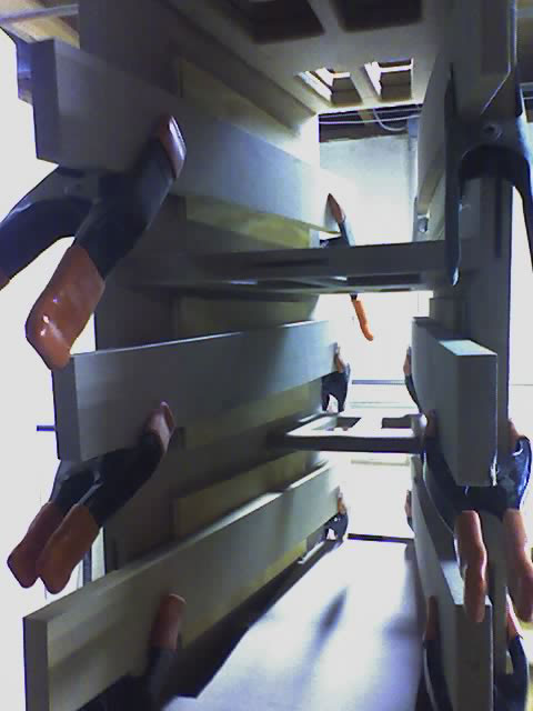

                                                      Here I am gluing the 1/4" plywood panels to the inside of the speaker sides...
                                                      You can see the makeshift clamping blocks I used...
                                                      I had enough clamps to put the plywood in one speaker... I will do the other one tomorrow...

                                                        That's awesome Mark - - - No holds barred!
                                                        FYI: You may want to consider mounting your x-over componants to a piece of Black ABS plastic. Its cheap and has a haircell finish on one side. Here's an example.
Name:	2008 03 06_0199.JPG
Name:	2008 03 06_0209.JPG
                                                        -David
                                                        As we try and consider
                                                        • mlammert
                                                          • Dec 2007
                                                          • 373
                                                          #253
                                                          David, thank you SO much for posting those pictures!!! That is exactly what I am thinking of doing for mine... Awesome!!! :B
                                                          Just got into the office from being out of town and confirmed that my speaker wire and all the veneer and supplies were shipped... I must say Joe Woodworker really does a good job at packaging the materials and supplies...
                                                          I am in the home stretch now!!! :T
                                                          Thanks guys!!!
                                                          Mark

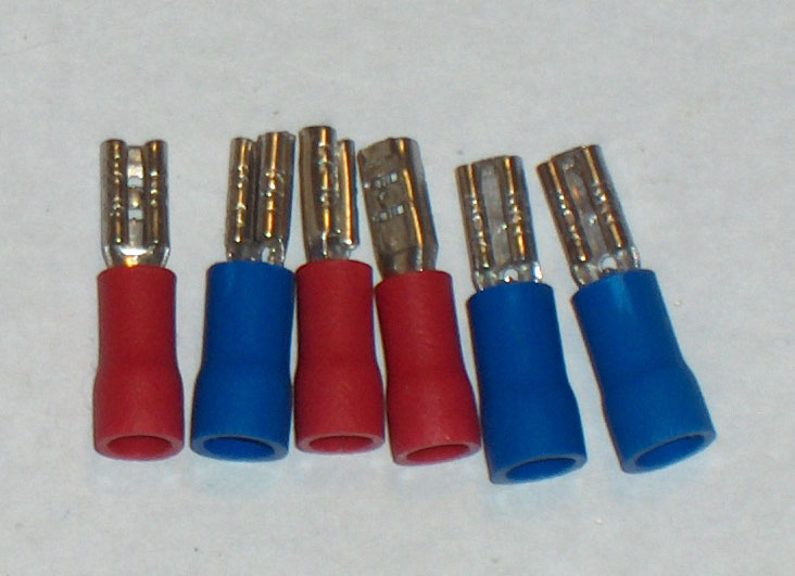

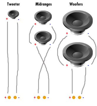

                                                            Speaker Connection Question
                                                            Couple questions on making the actual speaker connections:
                                                            1) When I go to connect my speaker wire to the binding posts and the speaker terminals is it appropriate to use the connectors shown in picture one??? Something that I would get at a big box store or Radio Shack...
                                                            2) Is the wire schematic in picture two the correct way that I would connect all the speakers to the various terminals and binding posts???
                                                            Thanks guys!!!
                                                            Mark
                                                              #255
                                                              I'm using the connectors this time around. Last time I didn't and I ended up ruining a tweeter although it was one of the D26's where they are all plastic. Either way I decided to use the connectors this time around at least until I get them completely finished and what not.
                                                                • 3815
                                                                #256
                                                                Mark, the mid has a smaller connector on the negative than it has on the positive, so just be sure you look at it before you get ready to assemble. Looks good on the wiring.
                                                                -Chuck

                                                                          #261
                                                                          The plywood "deadening" slabs worked great on the first speaker...
                                                                          Last night I removed the clamps and glued the plywood slabs to the second speaker...
                                                                          I also laid out the center points for all the drivers on the front baffles...
                                                                          Need to do a little Durham's touch-up on the front baffles but all in all they turned out super nice!!!
                                                                          This weekend I should have the driver cutouts complete and begin basic assembly... :B
