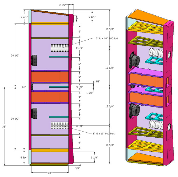

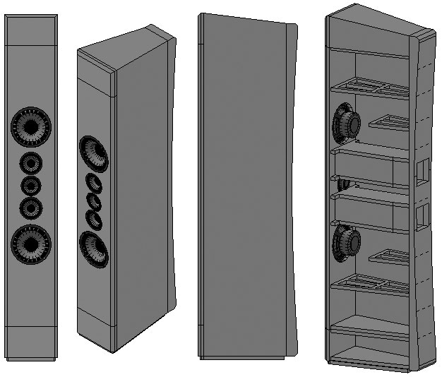

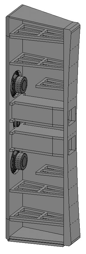

      Some Preliminary Pictures
      Here are some preliminary renderings of the cabinets...
      From left to right you can see front, angled, and side views...
      The last image is from the back wit the right side panel removed so that you can see the internal construction and bracing...
      The only thing left to design/render is where I am going to put the port... A tube port is kind of out of the question due to the curved back of the speaker...
      Curt was kind enough to calculate a 2.25" x 8" port opening 14" long that should provide the same tuning frequency as the original 3" port...
      So, I am thinking of doing that type of port either out the back towards the bottom of the speaker... Or, possibly do that type of port through the top of the speaker which angles back slightly...
      BTW, I got the idea of the curved back from this web site:
      Mark

        I like your cabinet plans, the curves make it more "friendly". Sonus Faber is able to put the ports in the back, so I see no reason you cannot do the same.
        A bottom port will alter the tuning frequency due to the boundary loading of the floor.
        • FroDaddy
          • 274
          Your tweeter looks to be centered in relation to the height of the cabinet, or about 30.5in. You'll want your tweeter height to be about the same height as your ears are when sitting down in your room, so if 30.5in is the height then that's good. But typically it is around 38-42in. For me, Curt signed off on having the edge of the RS225 frame being 3/4in from the top of speaker. So you have some room to play with if desired.
          HTH
            Hey FroDaddy,
            Thanks for the look over... Just to clarify, the center of my tweeter is exactly 38" from the floor in my speaker design... I don't know how you gauged it so perfectly, but the center of the tweeter is exactly 30.5 inch from the horizontal line which is towards the bottom of the speaker... Then, the horizontal line is 7.5 inches from the floor... Thus, making the tweeter's center 38 inches from the floor... FYI, the horizontal line is a "decorative groove" that will be cut into the wood...
            These types of comments/questions/suggestions are awesome... Thank you so much...
            Mark
            • cobblepots
              • 102
              My suggestion for the port is this:
              Put it on the bottom between the lowest shelf and the base. If you cut a circle on the flat side of the board, you can then use a rabbeting bit on the "curved" side to get the flush look. This will make the port go straight into the box as opposed to being at an angle and also not have some of the edges raised off the surface. I don't think that the curve is so great that you can't VERY carefully create a flush recess for the port flange. Someone correct me if I'm wrong but port placement doesn't matter too much just as long as it isn't directly behind a woofer and not next to a wall or baffle.
              Great idea plans though and goodluck!
              • Curt C
                • 792
                Mark
                I didn't go through all the calculations Mark, but it looks correct at a casaul glance... :T
                Are the very bottom and top compartments in your design dead space? I assumed you would be adding the base as Jim did. I may be able to suggest a better port option once I get my addled brain wrapped around your design...
                Curt's Speaker Design Works

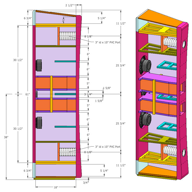

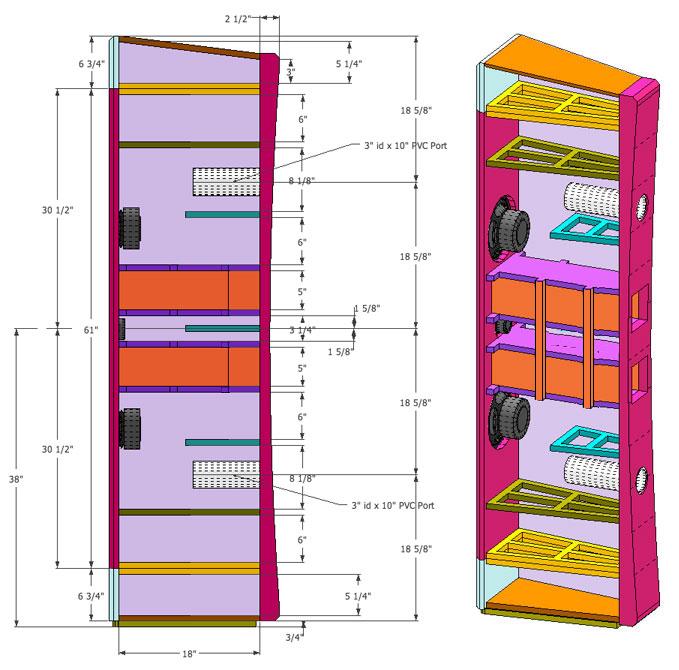

                                  Hey guys,
                                  Attached is a new CAD drawing of my Statements with the "dead areas" now integrated into the speaker cabinet... Took no time at all... I love Google SketchUp...
                                  You will see that I simply used my "vented" braces at the top and bottom instead of using the original solid braces...
                                  I also chamfered the top of the side walls and created a top "lid" for the speakers with chamfered sides as well... Now I have a speaker top with no end grain... Nice... 8)
                                  I guess now I am back to my questions of a couple minutes ago:
                                  Thanks guys; this is exciting!!! :T

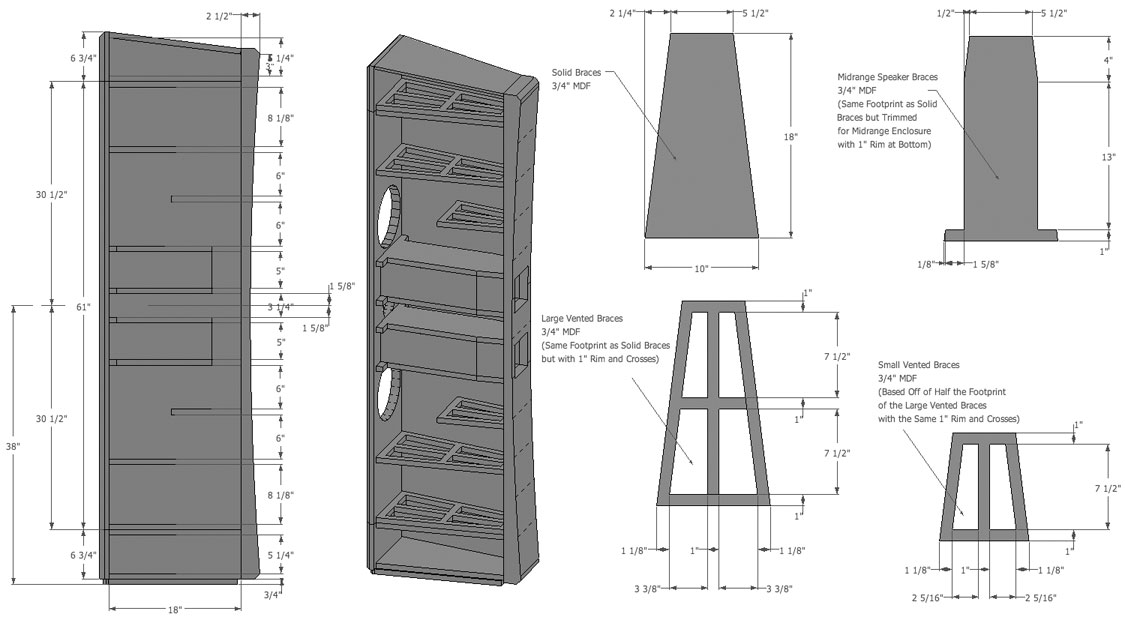

                                            FYI, I am in the process of taking the new speaker design (as shown in post 17) and making dimensional cut diagrams of all the pieces...

                                              Hey guys,
                                              Attached is a graphic of the dimensions of the main parts of the speaker and then also a full view of the assembled speaker with overall dimensions...
                                              Let me know if anybody has any questions or comments or sees any problems with this...
                                              I think all that is left is to determine the ports for the speaker... :T
                                              Thanks again for everyone's help so far!!!
                                              Mark

                                                • 3815
                                                Wow those suckers are going to be enormous! Be sure to share those drawings if you're so inclined
                                                -Chuck
                                                  • 1456
                                                  One thing to consider, is whether you might be creating some possible cabinet resonaces as you narrow it down toward the back, along the open back mid walls. You will have a narrow opening, that tapers to nothing, between the speaker inside walls and outside of the boxes for the open back mids. If this is a ported system, you have air moving along those narrow gaps from the top or bottom woofers, or both, if the port is centered. These narrow gaps could act as ports on their own, causing some odd resonances, which might even effect the peformance of your main port. At first this seems like a non issue, but Roman Bednarek reported resonance problems with a design he had which had this same type of situation, two large volumes separated by a narrow section. It was easily heard and very annoying according to him and he had to scrap the box deisgn and start over.
                                                  Obviously, this was not a problem with the original statements, but you are narrowing them down quite significantly. I'd be concerned about it, if I were you. Maybe you could use pvc pipe for the open back mids. It has 1/4" walls, and since it is rounded, it has a much smaller footpring inside the box and therefore would not have nearly as much potential for creating a "port" inside the box as the square boxes, with 3/4" sides. Food for thought.
                                                  Dan N.
                                                  • mlammert
                                                    • Dec 2007
                                                    • 373
                                                    Hey Dan,
                                                    Thank you VERY much for pointing this out... Hmm... That is quite the predicament...
                                                    I know I had talked to Curt a few days ago and he is suggesting two ports; one at the top and one at the bottom...
                                                    I uploaded the cabinet dimensions so that Curt could finalize on a diameter and length for me... I know he originally said something about either two 2" x 4" ports or two 3" by 10" ports... Wasn't quite sure how I should proceed yet...
                                                    Dan, your main concern seemed to be air moving in the small narrow cavity when I assume the port is at the top or bottom or middle... But, if/when I go with Curt's plan of two ports (one at top and one at bottom) does this issue go away or lessen, in your opinion???
                                                    And, to Dan and any others, what would some potential pro's and con's be for using the PVC for the mid enclosures??? I thought at one point there was a discussion on some thread about someone trying the mid enclosure with PVC and it didn't work out for some reason... However, I could be totally wrong on that...
                                                    Thanks Dan, I appreciate the warning...
                                                    Anybody else have any comments on this situation???
                                                    Thanks guys,
                                                    Mark
                                                      • 1456
                                                      Well, Curt is the guy to give you feedback on this. It is his and Jim's design and they know what they are doing. I just thought that this issue might have been overlooked in your new design. I would think, however, if you are using two ports, one top and one bottom, you could split the cabinets into two separate volumes. That might reduce air movement along the length of the cabinet. I'll search on the PE forum to see if I can find Roman's post about the problem he had.
                                                      As far as the PVC pipe, I used it in my SoundRounds design for the mids and had no problem with it. Being a tube it is naturally very rigid and can have much smaller sidewalls, hence the use of sonotubes for subs. That said, I'm sure Curt and Jim considered PVC in the original design and decided to go with an mdf box instead.
                                                      Dan N.

                                                        • Curt C
                                                          • 792
                                                          Mark
                                                          Let me elaborate on my earlier post:
                                                          “One possibility would be a 2" x 4" flared port in each of what 'was' the dead space compartments. I would think these would fit acceptably in spite of the curve, and will only have slightly more airspeed than the single 3" x 5" port. The advantage of 2 ports being symmetrical acoustic loading of the woofers. If you can make them fit, a pair of 3" x 10" would exhibit lower port airspeeds, and you could probably forgo the large flares.”
                                                          The advantage of ‘symmetrical acoustic loading', is each woofer will ‘see’ for the most part, only the port nearest to it, and each end of the cabinet will ‘see’ the same instantaneous air pressure at any given moment. Consequently, there will be little pressure differential around the midrange enclosures and as a consequence little excitement of any cavity resonances created as a result. The open spaces adjacent and between the mid tunnels certainly could be lined / filled with foam / polyfill / whatever to eliminate any chance of resonance.
                                                          The port choice has to do with port airspeed and what will fit on the rear enclosure panel.
                                                          Dual 2” port will work, but in my experience, must be flared to minimize port noise. The twin 3” ports would be the better choice, as the port airflow is half of the 2” ports, and in practice one could get by with little or no port flare. The 3” ports would be my preference if you can make them fit on your baffle. I’m put them in the void between the first and second brace of the top/bottom and equally spaced from the tweeter height on the cabinet. (Equidistant from the woofers.)
                                                          5” PVC is tough to come by, and expensive when you do find it.
                                                          Let me know if I can further confound this conundrum. :B

                                                            Hi Mark,
                                                            You are undertaking quite a project. They will be a “Statement” to say the least. I really like your tapered & curved back design.
                                                            One thing I did notice on your layout is that there is better then 2 feet of un-braced side panels across the two mid chambers. You may set your self up for some cabinet resonances in that area. You may want to consider some way to tie the mid chambers to the side walls.
                                                            Looking great!
                                                            -David

                                                              Dan, Curt and Dave, thank you guys SO much for your comments!!!
                                                              Curt, I am pretty sure I understand exactly what you are talking about now regarding the ports... Give me a little time and I will mock-up some new drawings with the 3" x 10" ports placed as you described...
                                                              Dan, thanks for that link... I am going to read through that and hopefully with Curt's suggestions and information, it will not be an issue with the new port design...
                                                              David, thank you very much... And, yes, thanks for pointing that out... I am going to re-configure my braces when I add the ports to the drawings and hopefully that will alleviate the issue you pointed out...
                                                              Thanks again guys... My confidence is building back up again... Thank you all SO much!!!
                                                              Mark
                                                              • Curt C
                                                                • 792
                                                                A couple of vertical braces on each side tying the mid cabs to the external side panels should be sufficient.
                                                                I assumed you'd left them off the original drawing for clarity. 8)

                                                                    Hey everyone,
                                                                    Attached you will find a new CAD drawing of the speakers...
                                                                    Couple things to point out:
                                                                    1) I color-coded the various pieces to make discussion easier...
                                                                    2) I added the two 3" x 10" ports and centered them between the tweeter center-line and the top and bottom of the speaker as Curt suggested... Thanks you Curt...
                                                                    3) I added a small vented brace in the center of the speaker behind the tweeter for more bracing in the middle... Thanks David...
                                                                    4) I added additional "stub outs" on the sides of the midrange braces that attach to the sides of the speaker for more bracing in the middle... Thanks David...
                                                                    After reading the post that Dan pointed out... And, Curt's feedback on the port's "symmetrical acoustic loading" and stuffing in the narrow cavity, I am not as worried about any "odd resonances" caused by the narrow midrange enclosure gaps... However, I would still appreciate some feedback on that from people more knowledgeable than me...
                                                                    So at this point, I would kindly ask for some more feedback on the ports and overall structure of the speaker...
                                                                    Thanks again for everyone's help, support and knowledge!!!
                                                                    Mark
                                                                      Like Curt said earlier, stuff the center part of the enclosure around the mid tunnels with fiberglass or polyfill.
                                                                        • 1456
                                                                        I agree with the others, the dual ports top and bottom plus stuffing the mid section of the box should resolve any concern you have about internal "port-like" resonances.
                                                                        Those are some very nice looking boxes :T .
                                                                        Dan N.
                                                                        • Curt C
                                                                          • 792
                                                                          IMO,
                                                                          The input of the ports are too close to having a direct path to the back of the woofers. I'd move them out to between the green and yellow braces.
                                                                          Doubling up the thickness of the yellow braces is unnecessary, as it will do little to increase the stiffness of the side panel.
                                                                          Note my crudely altered example below: I'll still suggest the vertical braces will perform better than the extra horizontal brace. This ties the enclosure sides and the mid enclosures together making a very strong center section.
                                                                          Optional: a vertical brace running between the yellow and green braces. This would support the inner 'free' end of the port and allow for a 3/4" flare at each end of the port.

                                                                            Thank for all the great feedback, Curt!!!
                                                                            Gotcha... I will move the ports so that they are in between the yellow and green braces... I will reflect this in my next mock-up...
                                                                            I have these doubled up because the light-blue top and bottom parts of the front baffle are separate pieces of wood from the purple part of the baffle... I am planning ahead to my finishing process where the light-blue pieces of the baffle will be one wood species and the purple part of the baffle will be another... I figured the doubled up yellow brace would help in the support the separate baffle pieces...
                                                                            Sounds good... I will incorporate something like those into my next design... I will probably only be able to do one vertical brace on each side due to how skinny the gap gets towards the back of the cabinet based on the angled sides of the cabinet...
                                                                            A vertical brace running between the yellow and green braces. This would support the inner 'free' end of the port and allow for a 3/4" flare at each end of the port.
                                                                            Makes sense... I can mock that up in my next design as well... Question: Would the vertical brace be flush with the end of the PVC pipe??? Meaning that when I route the 3/4" flare I would be removing some wood and some PVC plastic at the same time??? Or, am I not thinking that through properly???
                                                                            Okay, sounds like I have some design work when I get home tonight...
                                                                            Thanks again for all your feedback and help!!!
                                                                            Mark

                                                                              Hey guys,
                                                                              Attached is a new design incorporating the suggestions that Curt made...
                                                                              1) The ports have been moved further away from the woofers... I modified the green and yellow braces (wide cross strut) so that I could create and attach a vertical brace at the end of the port...
                                                                              The vertical brace at the end of the port is flush with the end of the PVC... I can change that if I was incorrect in doing so...
                                                                              2) I created yellow vertical braces on the sides of the midrange enclosures that connect the enclosures to the sides of the speaker box...
                                                                              Let me know what you guys think!!!
                                                                              Mark

                                                                              • David_D
                                                                                • 197
                                                                                Those look awesome Mark.
                                                                                I am really interested how you attack the curved backs.
                                                                                Let’s make some saw dust!
                                                                                -David
                                                                                As we try and consider
                                                                                • Curt C
                                                                                  • 792
                                                                                  Two thumbs up! :T :T

                                                                                    Curt, question: Was I correct in making the vertical braces flush with the end of the PVC pipe??? Meaning that when I route the 3/4" flare I would be removing some wood and some PVC plastic at the same time???
                                                                                    Also, is 3/4" flare absolutely necessary or could I make it 1/2"??? Just trying to figure out if I have to buy any router bits...
                                                                                    I was also thinking of using a 1/4" round over on all the internal braces that have holes in them... Is that a standard practice???
                                                                                    Dave, yeah I have some ideas on how I want to tackle the curve of the back... My initial thought is to laminate various strips of MDF together... If I orient them so that the end grain faces the speaker box that will allow me to cut the curve into the various strips using my band saw and then glue them all together and smooth the curve using a belt sander... Also, if I do it this way I can then use the miter saw to cut perfect angles at the top and bottom and also cut out the midrange openings using the miter saw as well...
                                                                                    I will mock-up the actual back curves in SketchUp once I am to that point so that this all makes more sense...
                                                                                    Thanks again guys!!!
                                                                                    Looks like I will be buying some MDF this weekend...

                                                                                    • Curt C
                                                                                      • 792
                                                                                      That should be fine. Alternatively, you could add a backer board to the MDF so the flare is all 'in' the MDF and the end of the pipe is supported more securely.
                                                                                      That will be fine as well. A 3/4" roundover is pretty handy, but its not indispensable.
                                                                                      Lots of folks do this, or something on that theme. While in most cases I don't think its strictly necessary, it certainly can't hurt.
                                                                                      Another possibility: You can easily make a jig:
                                                                                      For example, you can lay out your curve on the side of a couple of 8ft 2x8's. Rip appropriate lengths of 1/4" MDF/HDF/masonite. Glue 2 and clamp between the two halves of your jig. When dry, glue the third layer, etc. until you've built up to the thickness you desire. -Smooth curve with little sanding...
