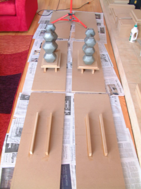

                  Indoor and outdoor gluing operations are underway.

                    Clamp time?
                    How long do most folks leave their clamps on with Titebond III? Is several hours OK?
                    Mike
                      • 16120
                      Yeah thats more then enough. I let it sit up for about an hour or so and then moved on.

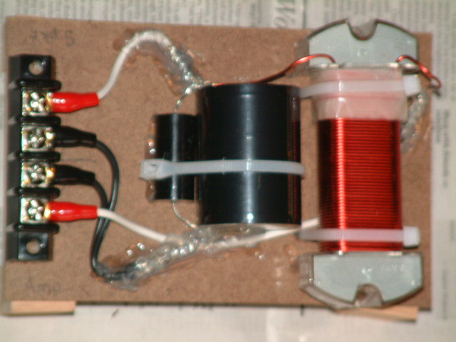

                                                                            Crossovers nearing completion
                                                                            Well it's been slow but crossovers are just about finished. I decided to mount the crossovers in the box even though I anticipate experimenting with the DEQX HDP-3 bypassing the crossovers. I will have 3 separate speaker terminations on the outside of the box. I am mounting the crossovers on small wood blocks that will just sit above the 1.25" Sonic Barrier material. The coils are oriented such that mid and tweeter crossovers can be mounted across from one another. The woofer crossover will be in the opposing end of the cabinet. Almost there :
                                                                            Mike
                                                                              Mike
                                                                              Which crossovers are pictured here? The large statements or the center?
                                                                              • mikela
                                                                                • Mar 2008
                                                                                • 98
                                                                                FroDaddy,
                                                                                These are for the large Statements. I have an SMX acoustically transparent screen and so will be using 3 identical Statements of the sealed variety in the same horizontal plane. If I had a flat panel situation or a non transparent screen then I would be building a Statement Center Channel. I have a Velodyne DD-18 which I will cross over to at 40Hz.
                                                                                Mike
                                                                                • Curt C
                                                                                  • 792
                                                                                  FroDaddy,
                                                                                  Mike
                                                                                  I predict you will enjoy the fruits of your labors, Mike. The 6 RS225's across the front are going to give you some impressive tactile response. I know I was impressed with the pressure wave from just a pair of Statements. The third should be icing on the cake.
                                                                                  Curt's Speaker Design Works
