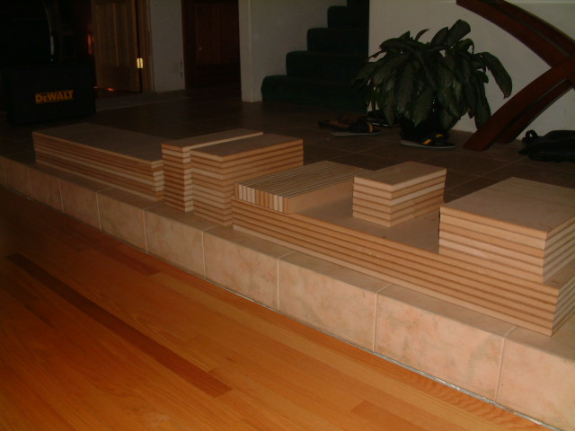

    Well I have decided to take the plunge and build three identical sealed Statements. I plan on placing these behind a 10' wide SMX 2.37 acoustically transparent screen. I have a full Magnepan 1.6QR 5.1 system but feel that I will end up with placement issues with the screen. Mangepan's higher end systems have ribbons and I have allways wanted to try them out. So we shall see. I also have a Velodyne DD18 so the sealed Statements should blend nicely at around 40Hz. I am considering building the crossovers external to the boxes so I have direct access to the drivers. I have a DEQX which is currently being upgraded to the new HDP-3 and will be interested in seeing how that works for critical listening in stereo and possibly tri-amped by Hypex amps.
    Anyway here are some pics of the cut MDF. I am slow so progress won't be anywhere near the pace I have seen from others.
    Mike

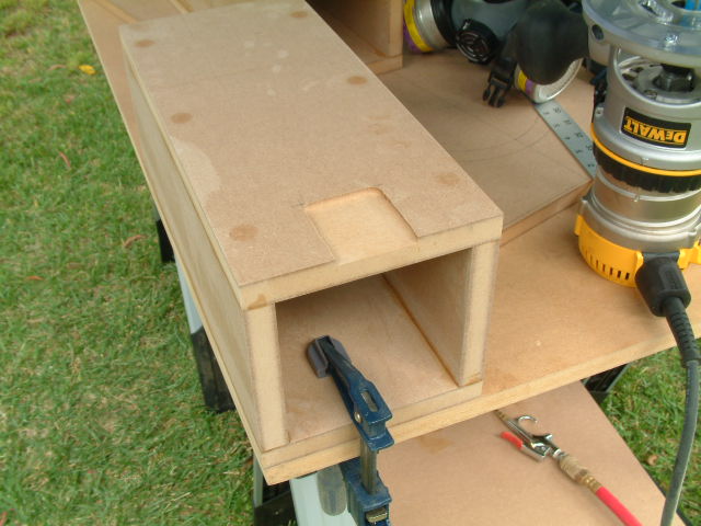

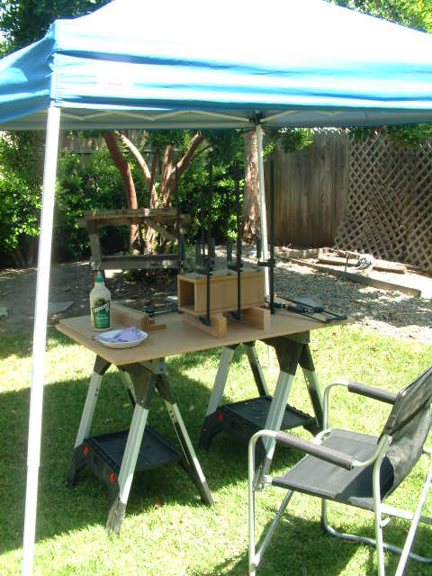

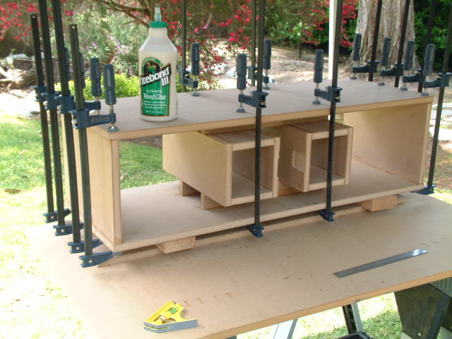

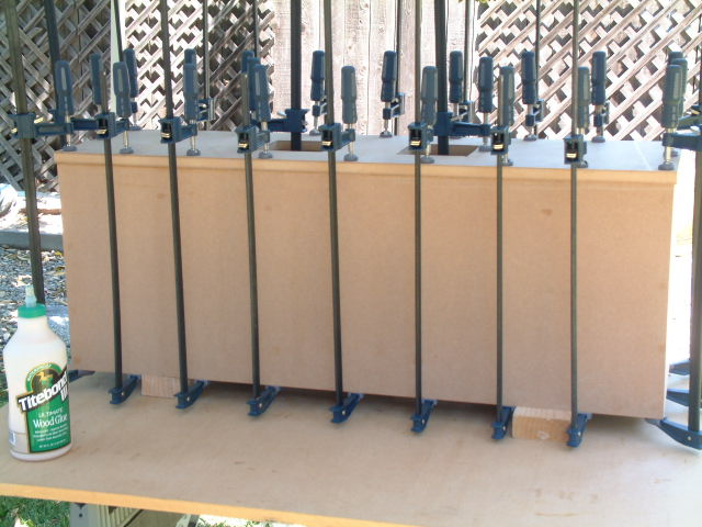

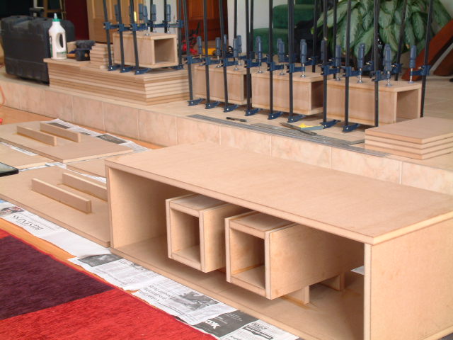

                  Indoor and outdoor gluing operations are underway.

                    Clamp time?
                    How long do most folks leave their clamps on with Titebond III? Is several hours OK?
                    Mike
                      Yeah thats more then enough. I let it sit up for about an hour or so and then moved on.

                          • mikela
                            • Mar 2008
                            • 98
                            Hi Bent,
                            Hope things warm up for you. No. No sawdust in the house. I used the sun canopy in my driveway with a Ridgid table saw that has a caster wheel lift and saw horses with MDF sheet as runoff table for all cutting operations. Great dust system!

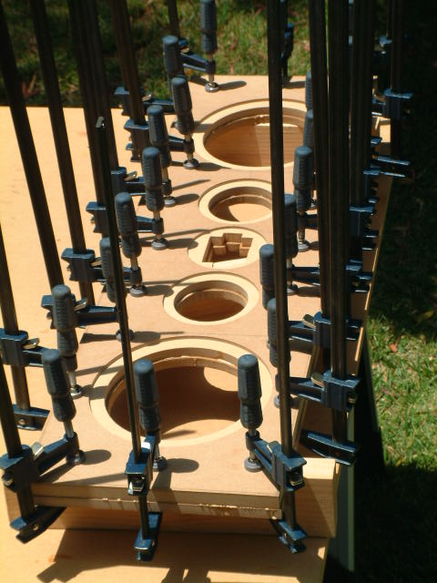

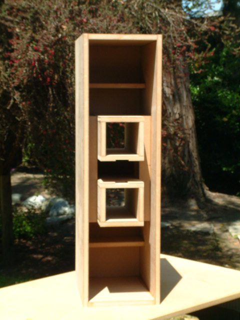

                            Well I got all the 5" wave guides glued and dry fit the system together. Everything is right on the money so far. Also drew out baffle dimensions. I like the way David D did his tweeter cutout and will probably do the same. In some of the photos from others it appears there is very little material remaining for a good seal. Could just be the pictures.
                            Question: Is it really necessary to use silicon inside the box? The Titebond III seems to do a pretty good job of sealing.
                            Mike

                            • David_D
                              • 197
                              ALL RIGHT MIKE!!!!
                              Looking good man!
                              IMHO, If you have decent panel cuts... because it is a vented enclosure, the glue should be just fine. If it was a sealed application, I would spend the extra step.
                              It all depends on how you feel about your seams.
                              BTW Thanks for the props on the tweet cut out.
                              -David

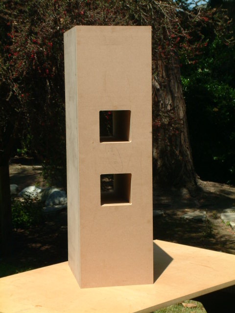

                                All,
                                Thanks for the words of encouragement. I am planning on gluing the boxes together today if all goes well.
                                Question: Is it better to use a 3/4 roundover or use a chamfer bit for the rear of the speaker cut outs?
                                Mike
                                  Originally posted by mikela
                                  All,
                                  Mike
                                  Hi Mike,
                                  If you used a 1 1/4" thick front baffle, the 3/4" roundover is perfect. If it's a 1 1/2" thick front baffle, the chamfer bit might work better. The goal is of course to open up the back of the baffle around the driver frame so it doesn't "tunnel" the back wave. The driver needs room to breath.
                                  HTH

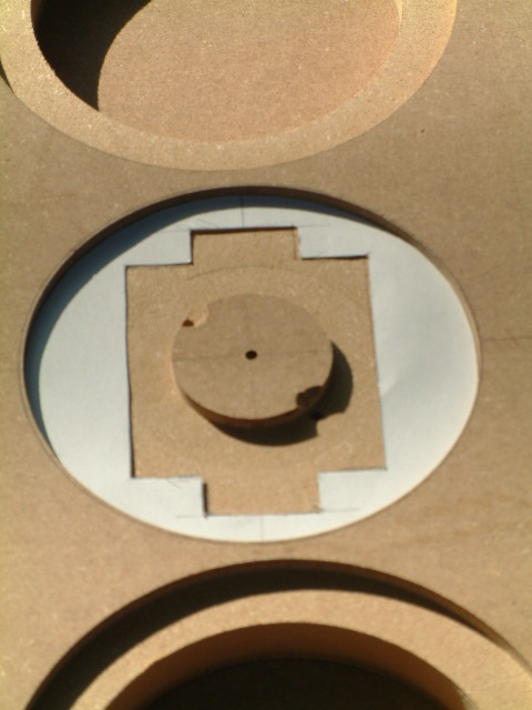

                                    Cut the notches for Founteks using a depth of about 3/16ths. Hopefully, that will be enough. Also, glued all three boxes together. Being a complete novice, I attempted to glue the 5" wave guides in at the same time as the sides, top and bottom on the first one. Luckily, nothing got too far out of control. I may have to plane down an edge of one of the wave guides to make it coplanar when I install the baffle. Can you use a hand planer on MDF? The other 2 boxes are perfect. I am planning on gluing on the backs today and maybe routing the front baffles.
                                    Mike

                                        Told you I was slow. :W Here are some more photos of the cabinets under construction prior to Memorial weekend.
                                        Mike

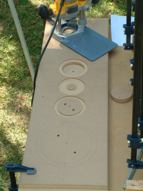

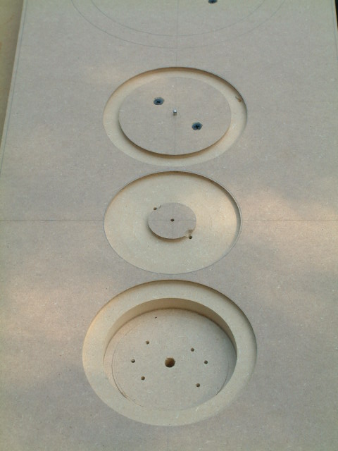

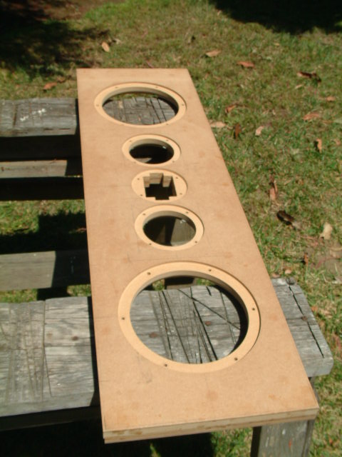

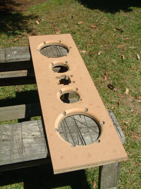

                                          Lately, I have been working on completing one baffle to make sure my drivers properly flush mount with the gasket tape from PE. I also used David D's method of gluing in T-nuts. Works pretty well, but, don't try to pull the nuts in by tightening the button head screws in. I ended up using a 10mm socket head to tap the nuts in place. Also, only put glue on the flange of the nut not on the shaft with the threads. I also used Jim Holtz' recommendation on the 3/4" roundover.
                                          Mike

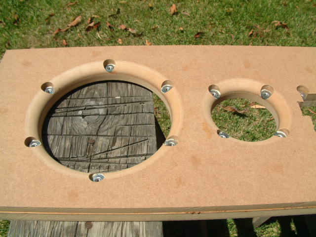

                                                  Hi Mike,
                                                  Sorry, I didn't understand. It doesn't make any difference whether it's inside the screw or outside the screw as long as it seals the driver to the baffle. Use what ever works.
                                                  • David_D
                                                    • 197
                                                    Hi Mike,
                                                    Your cabinets are looking great!
                                                    I am glad you are pleased with the t-nut procedure.
                                                    Will they clear the drivers as they overhang slightly into the cutouts?
                                                    I clipped the flanges of the nuts on my center, but I never did try the drivers in before I snipped them.
                                                    -David
                                                    As we try and consider
                                                    • mikela
                                                      • Mar 2008
                                                      • 98
                                                      Hi David,
                                                      I used a Dremel tool grinder on one edge of the T-nut flanges on the ribbons. Each one is a custom job as I did not have the benefit of a drill press. Any ideas on an inexpensive drill press for this purpose? The T-nuts tend to rotate about an eighth of a turn as they are tapped into place due to the outside threads. In a couple of cases I had to grind them in situ because they rotated more or less than I anticipated. I have to fiddle a little bit to get the bolts to thread but someone in a rush could potentialy cross-thread them. I definitely like the solid mechanical feel. How did you clean up the threads? I just tried a number of them until I found ones that had little or no issues.
                                                      Mike
                                                      • David_D
                                                        • 197
                                                        Hi David,
                                                        Mike
                                                        Hi Mike,
                                                        Yea, they do rotate as they are installed but, I found them pretty predictable in their rotation. I snipped the flange of the nut with a pair of linesman's pliers and offset the rotation amount before I drove them in.
                                                        As far as an inexpensive drill press... I don't have any real good suggestions as of yet. I would find a benchtop or preferably floor model that the table can move up & down a bit. Check Craig's List, I find them on there all the time. There is always Sears.
                                                        As far as the interior threads, I chased each nut with the same size tap.
                                                        BTW, what did you use to do the counterbores? Very nice job.
                                                        -David
                                                        • mikela
                                                          • Mar 2008
                                                          • 98
                                                          I just happen to have a pair of linesmen pliers. I'll try that out on the next one. Also, went to our local B&B Hardware and picked up a die & tap set. What a difference that made...easily cleans up the threads on both nuts and bolts. :T
                                                          • mikela
                                                            • Mar 2008

                                                                      To answer a question I missed...I used the tool recommended in the David D's T-nut evaluation thread https://www.htguide.com/forum/showthread.php?t=29922 to perform the counter bore. I also used a slight amount of counter sink inside the counter bore to ensure the T- nut fit flush against the 3/4" face. This is also described in that thread. Don't forget to order the 3/16" pilot bit with the counter bore tool.
                                                                      Also made progress on the other 2 baffles today:
                                                                      Click image for larger version  Name:	DSCF1035.JPG Views:	667 Size:	71.7 KB ID:	850647
                                                                      Click image for larger version  Name:	DSCF1037.JPG Views:	771 Size:	62.3 KB ID:	850648
                                                                      Click image for larger version  Name:	DSCF1038.JPG Views:	707 Size:	70.7 KB ID:	850649
                                                                      Click image for larger version  Name:	DSCF1034.JPG Views:	709 Size:	74.2 KB ID:	850650

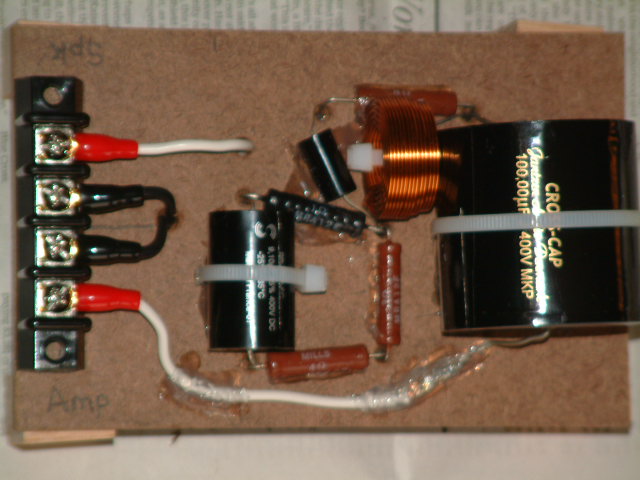

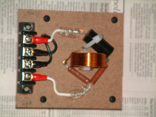

                                                                            Crossovers nearing completion
                                                                            Well it's been slow but crossovers are just about finished. I decided to mount the crossovers in the box even though I anticipate experimenting with the DEQX HDP-3 bypassing the crossovers. I will have 3 separate speaker terminations on the outside of the box. I am mounting the crossovers on small wood blocks that will just sit above the 1.25" Sonic Barrier material. The coils are oriented such that mid and tweeter crossovers can be mounted across from one another. The woofer crossover will be in the opposing end of the cabinet. Almost there :
                                                                              Mike
                                                                              Which crossovers are pictured here? The large statements or the center?
                                                                              • mikela
                                                                                • Mar 2008
                                                                                • 98
                                                                                FroDaddy,
                                                                                These are for the large Statements. I have an SMX acoustically transparent screen and so will be using 3 identical Statements of the sealed variety in the same horizontal plane. If I had a flat panel situation or a non transparent screen then I would be building a Statement Center Channel. I have a Velodyne DD-18 which I will cross over to at 40Hz.
                                                                                Mike
                                                                                • Curt C
                                                                                  • 792
                                                                                  FroDaddy,
                                                                                  Mike
                                                                                  I predict you will enjoy the fruits of your labors, Mike. The 6 RS225's across the front are going to give you some impressive tactile response. I know I was impressed with the pressure wave from just a pair of Statements. The third should be icing on the cake.
