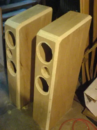

    Here are the the main pieces cut. I am using wkhanna design because frankly I love the shape and wouldn't improve upon it (within my woodworking skill). About that, I am still pretty novice at woodworking, and as an artist by trade, its pretty aggravating having an eye for detail and no skills to back it up.
    I was able to round the insides alright, and I have thick heavy MDF backing the baffles.
    Here they are as the stand now. Some wood filler is drying on one of the hole where the guide slipped off and I cut about 3-4mm to wide, D'oh! They will be Red just like Bill's but I was thinking about maybe putting sparkly black granite on the tops. Either that or a 4 inch wide stripe of natural wood.

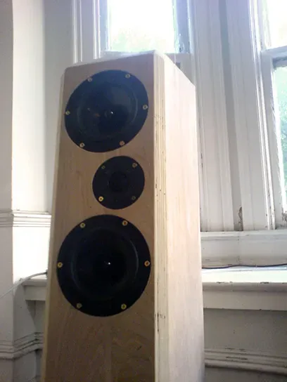

                      The sloping baffle looks nice but there may be a problem. How high is the tweeter above the floor? MTMs should have both woofers at equal distance from your ear. Depending on your chair height, you may need to tip them forward a bit to get the best sound.
                      • Raptor550
                        • 132
                        your right Dennis, the tweeters sit kinda low, allbiet higher than you are seeing because of the 3 inch stands.
                        I took a lazer level and mesured and ear hight should be reached at about 6-9 feet away sitting in a standard sized couch. Im hopeing that Nat P's have a flexible sweet spot. I will get them as close to ideally positioned but I wont fret it if they are 6 inches higher or lower then my ear.
                        Check out my cabinet designs. *Updated 6/16/07*
                        See my finished Dayton/Seas Project
                          That's not the point. As Dennis indicated the NatP crossover is designed (optimized) for a non-sloping baffle. Having one woofer farther back than the other screws up the time alignment of the drivers. The problem is that of 'phase' discrepancy since the sound from the bottom driver will arrive before the upper woofer.
                          This is why we don't encourage 'innovation' or 'creativity' when people are building the designs in the sticky threads....
                            Raptor is using my cabnet design, which has a 5 deg slope to the baffle.
                            I, too was concerned how this might degraded the SQ.
                            I find that my Nat P's have a fairly forgiving sweet spot in vertical dispersion, but my design put the tweeter right at ear-level at my seating position when a line perpendicular to the baffle at the center of the tweeter was run to that location. And as far as time alignment (or should I say mis-alignment) of the woofers due to the sloped baffle, I propped the rears of the stands to make the baffle perpendicular to the floor and my ears could not really notice any change in SQ. Actual measurements may tell a different story, but I have yet to purchase the required tools to do so.

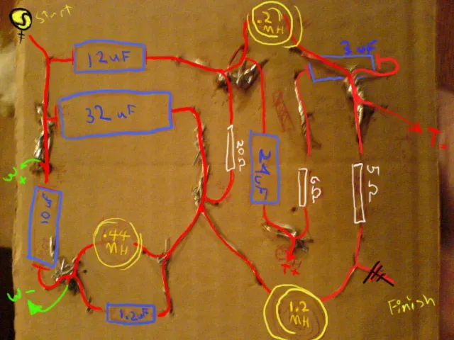

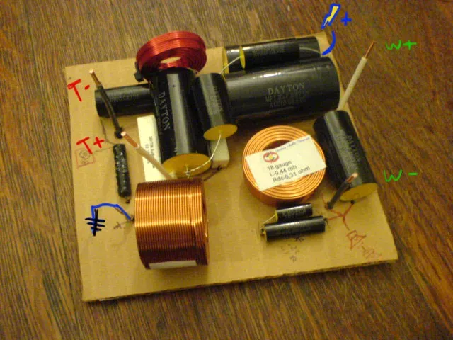

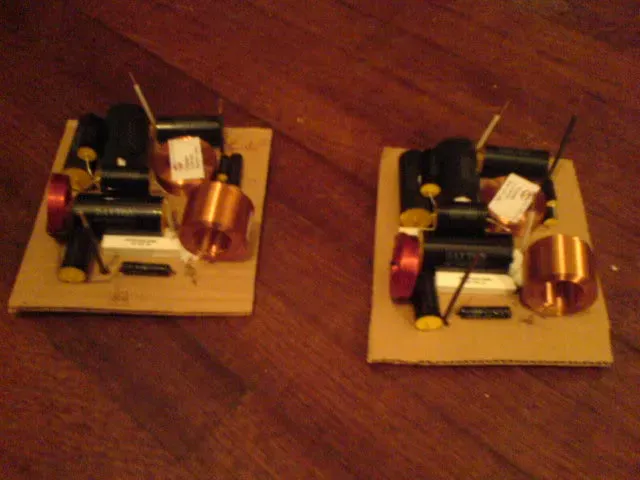

                                    Well I finished the crossovers today
                                    You can take a look to see if it looks right.
                                    I am using cardboard and then nailing it to wood later, cardboard seems nice because you can make the holes really easy. One of my friends said that it could catch fire, I guess maybe that could happen. But I can rest my solder on cardboard and it wont take to flames so I am not too worried. Should I be?

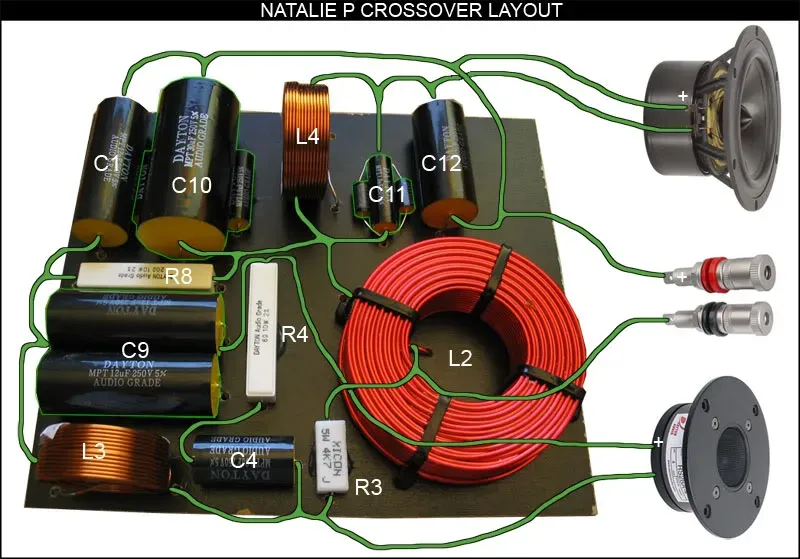

                                      Your layout looks OK, but corrugated cardboard as a base material for the crossover really concerns me - my usual construction is on 1/4" HDF (Home depot or other big box stores), parts hot glued down, some wiring hot glued down (vibration can cause stress cracks over time, especially with foil inductors, for example). The resulting assembly is very inert, dead, and won't be prone to micorphonics or physical issues if you're moving the speakers or even if you knock them over (hopefully on a carpeted floor).

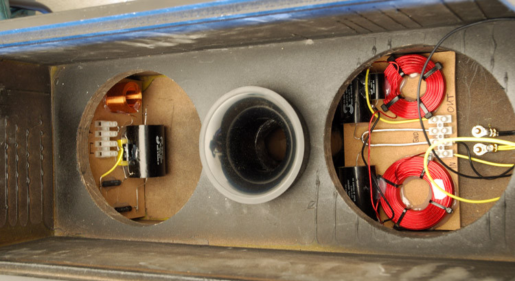

                                      These images are from the Modula MTM, the big brother to the NatlieP; the crossover boards can be mounted with industrial grade velcro, or if you test carefully before installing (with frequency sweeps connected to drivers in the cabinet through the port), then you may just hot glue them down. Don't use screws (unless they're brass) or especially nails- Nails are ferromagnetic and may interact with the crossover coils.
                                        I am useing cardbord and then nailing it to wood later, cardbord seems nice because you can make the holes really easy. One of my friends said that it could catch fire, I guess maby that could happen. But I can rest my solder on cardbord and it wont take to flames so I am not too worried. Should I be?
                                        A friend's adopted son turned the volume control on the Aragon 8008X3 amp powering his MTM's to "11". The result was ignition of the power resistors in the crossovers and melting of the dacron damping into black blobs inside the box. Fortunately the design was a sealed box so the fire self-extinguished do to lack of O2. I shutter to think what would happen should this occur with a cardboard substrate for the crossovers and a ported box...
                                          • 16128
                                          Cardboard mixed with any electronics is a nono in my mind.
                                          • Raptor550
                                            • 132
                                            Oddly enough before I ever made a crossover I assumed caps were really heavy, but for their size they seem surprisingly light, inductors on the other hand...
                                            wow, thats really good to know, I never had any idea that microvibrations could do that but it makes sense. I have some brass screws I think. Thanks so much Jon for looking over my layout. looks like I now have to find some hot glue. About the cardboard, do you think their is some sort of flame retardant in spay form I could use on it? Also, I see you are using GE caps, where do you get those? why do you use them?
                                            8O, All I have to say is wow. I don't know how I am going to take my crossovers apart. for now my Nats are going to be un ported due to technical difficulties.

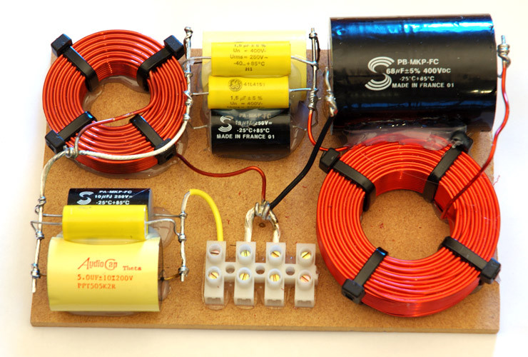

                                              There's no fireproofing spray, throw away the cardboard and mount the parts on Masonite or similar material.
                                              The GE caps come from a Madisound closeout special. It's been going on for years so they only have a few values left.
                                              FWIW high-end caps like the AudioCap Theda are VERY heavy, and VERY expensive.

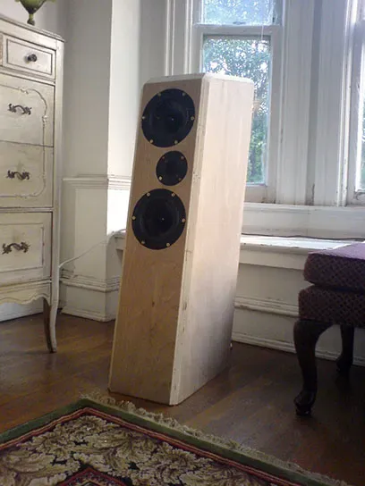

                                                I just finished champhering and sanding.

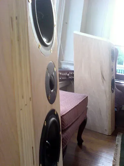

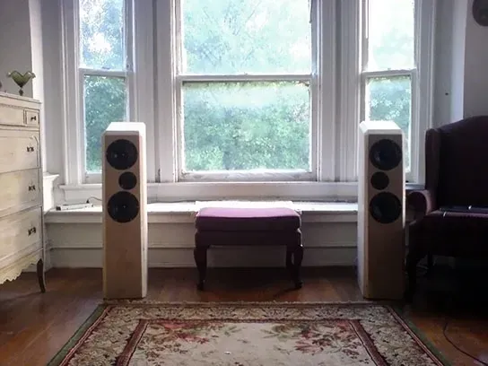

                                                  I added some more internal bracing and put everything together. For now I am finished. when I get some more money I need to put some finish on them. I will also need to port them. I had them playing while I had the bottom cracked because I was messing with them and they had great bass, so I will have that to look forward to. I had them open because in my haste I had switched the woofers and tweeter :E -that's a lesson on the value of crossovers right there, they played the absolute least ideal parts for each speaker. If machines could vomit, I'm sure that's what they would sound like.
                                                  In the mean time they sound excellent and they are still being broken in! Many thanks to the Dark Lord and the Empire, this will surely crush those rebel scum and there little dogs too! Thank you Jon and Thomas, and the rest of the gang on here. ;x( Also thanks to @Wkhenna, for letting me be your slanty-Nat pattawan.
                                                  Enough people have described the NatP sound on here so I will just say this: Its all true, go build one now! Here's some pictures for the kids.

                                                            I do hope you got rid of the cardboard! That is a real No-No!

                                                                        I will however go back and glue all my pieces down because what Jon said about microviberations does sound like a problem.

                                                                          Under normal operating conditions fire isn't a likely problem but the cardboard deteriorating over time would be a concern to me.
