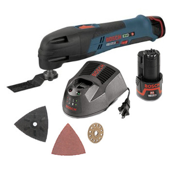

                      Here's my newest toy. A Bosch oscillating tool.
                      These are really handy to have around. You can use it to do small cut-off work, it will plunge cut, and has a scraper and sander attachment as well. If, for instance, you were doing new flooring and had to cut door trim so the flooring could slide underneath, these things are great. We install a lot of our cabinets in existing spaces and these come in handy for cutting existing base and chair rail to accommodate the new casework. The more we use it, the more we find things it will do.

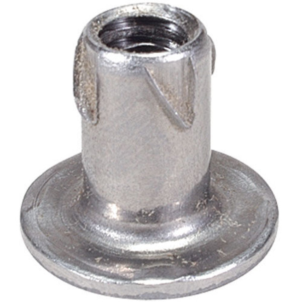

                                    Still using tee nuts? I really prefer the hurricane nuts from Parts Express.
                                    For MDF, I always add a drop of wood glue into the hole first. Q tips work great. Same for any screw holes in MDF except I dab it on the screw before inserting.

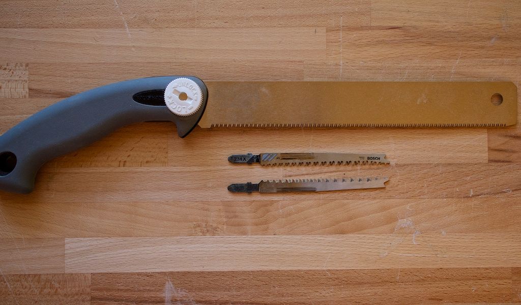

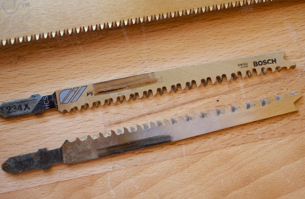

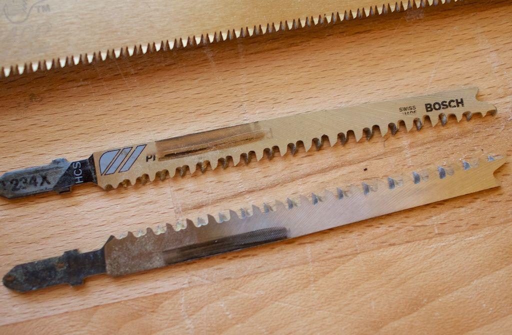

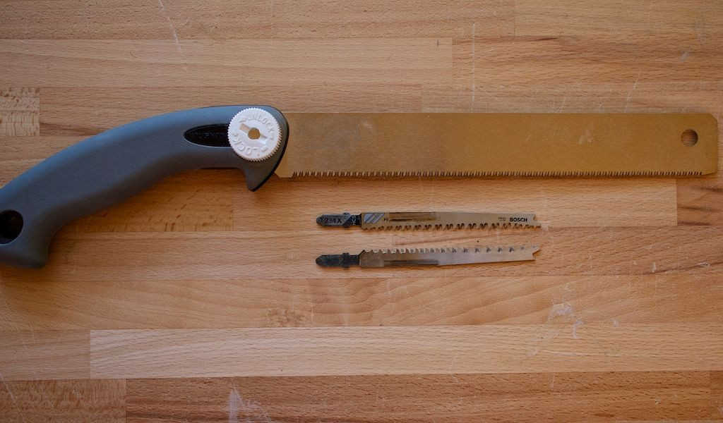

                                          Getting smooth cuts without a table saw and super duper table saw blade...
                                          There's frequently times I have to do some cuts sort of ad hoc, and often where I'd still like to have a very smooth cut after it's done. Sometimes it can be done with a saber saw, sometimes it must be done manually with a hand saw.
                                          One thing that's helped me is looking more closely at the blade types out there and matching the blade to the material and the job. In this case, I've really been happy since I discovered what I'd call flat side saw blades that have their cutting edges towards the inside of the blade, instead of with teeth beveled to the outside. The latter do cut fast, but they can leave a messy surface behind them.
                                          Examples:
                                          Saber Saw Blade: Bosch Progressor
                                          Manual saw: Vaughn Bear Saw (blades made in Japan)
                                          These are now my favorites in these classes of blades, and have become my general purpose go-to solution for when really clean straight cuts are required.
                                          Last edited by theSven; 10 June 2023, 16:21 Saturday. Reason: Update image location
                                              Again, I never knew that these existed!
                                              Have you ever used these in plywood, particularly the ones for saber saws? Do they cut well in there, and not tear out?, or is plywood just hard to cut in general???
                                                These blades also work well for me in BB ply and composites, plus special materials like LBL bamboo. For standard dura steel, nothing beats a high power welding laser, though...

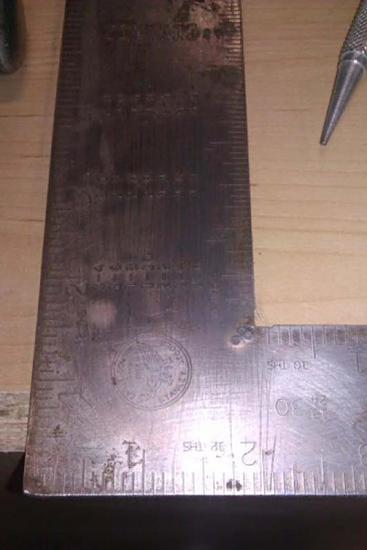

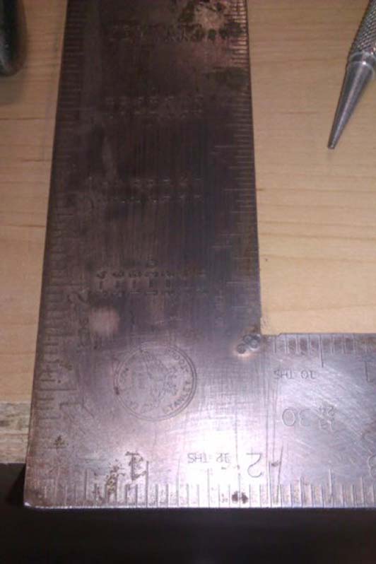

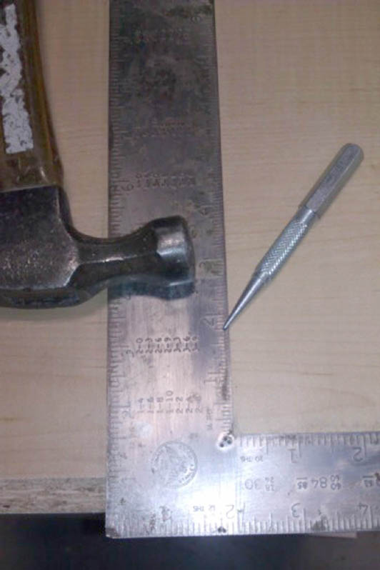

                                                      Here's an old school carpenter's tweak:
                                                      If your steel framing square isn't quite square, you can make minor adjustments by using a nail set to "stretch" it. To check if it's square, square a line on a flat surface, flip the square over right to left (or vice versa) and check if it still lines up.
                                                      Here's mine that was out at an acute angle. Using the nail set, strike a few times right in the inside corner on each side. Repeat as needed.

                                                      It also helps accuracy if you relieve the inside corner slightly with a file.
                                                          I've never had to do this to a square, yet, knock-on-wood.
                                                          I've always wondered though, if there's a practical limit to the number of times that you can do this?
                                                            If there is, the squares are never that far out of whack that I've reached it. We're only talking about really small adjustments being necessary.
                                                            Birth of a Media Center
                                                              Work-hardening steel to the point it breaks with something like this is probably pretty tough, especially considering it is probably NOT tempered and is a fairly mild steel. I'd imagine the same thing could be done with a ball-peen hammer or center-punch.

                                                                For those who use screws to assemble, try these instead of standard flatheads. They are called trim screws and have a much smaller head. They were developed for use with metal studs for commercial work. Same as drywall screws except you wouldn't have to countersink. Just drill an 1/8" hole and run the screw just below the surface. You'll need a Home square drive. Much easier to fill and finish.

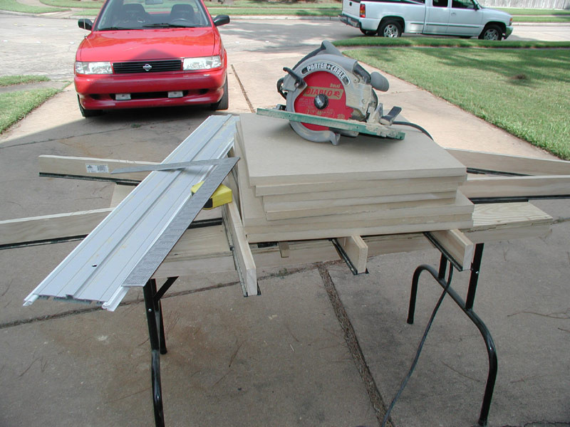

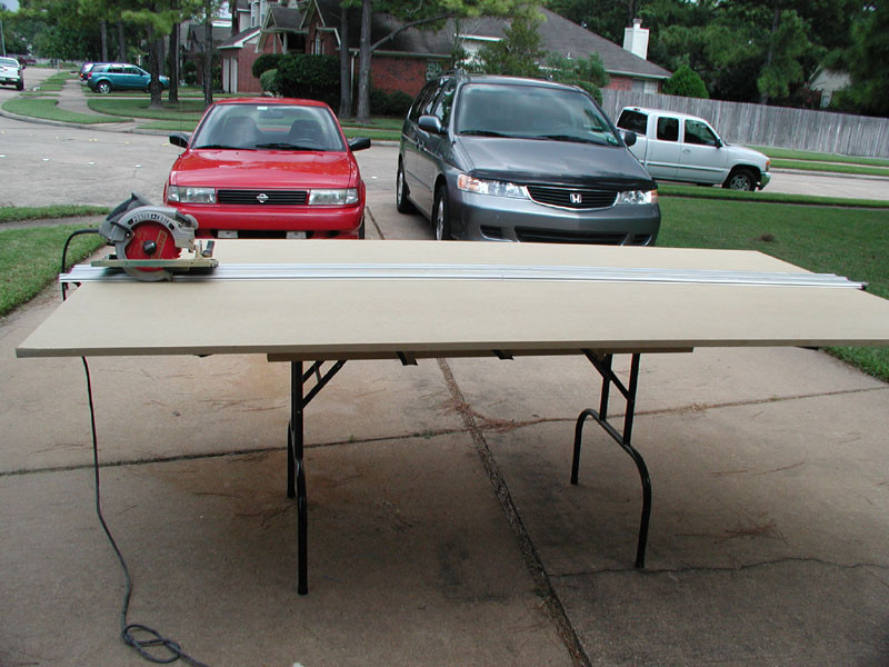

                                                                    No need for a table saw. I like to use a track saw to safely cut large, heavy sheet goods. Just about every major tool brand has their own version. I started with Festool and now I have a Porter Cable saw with a Eurekazone guide. The plastic edge is your finish cut line. When ripping a full sheet, I mark both ends and the center. No need to mark a line the entire length.

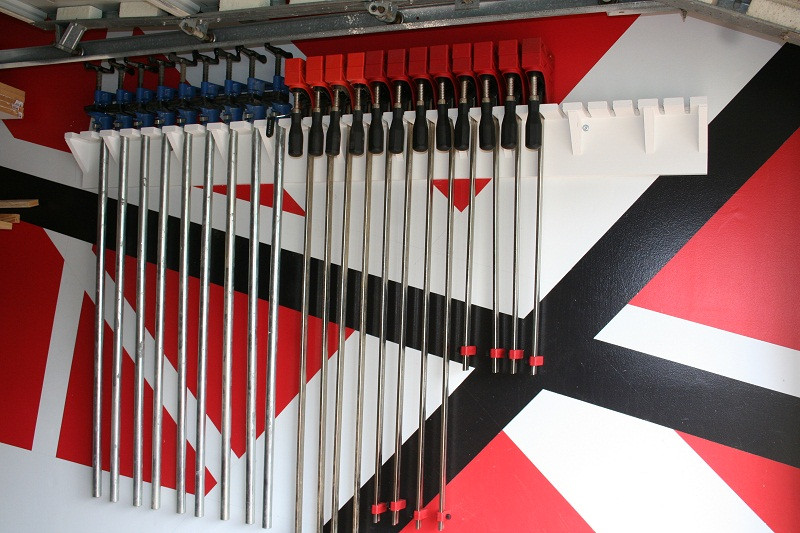

                                                                    • FlashJim
                                                                      • 145
                                                                      Keep organized. You wouldn't believe how funny that is coming from me unless you knew me personally. For a long time, I stacked my pipe clamps on the floor. They were always in the way. When I started buying parallel clamps, I decided to make a rack. It was one of my favorite projects in my garage so far. I no longer trip on my clamps!
