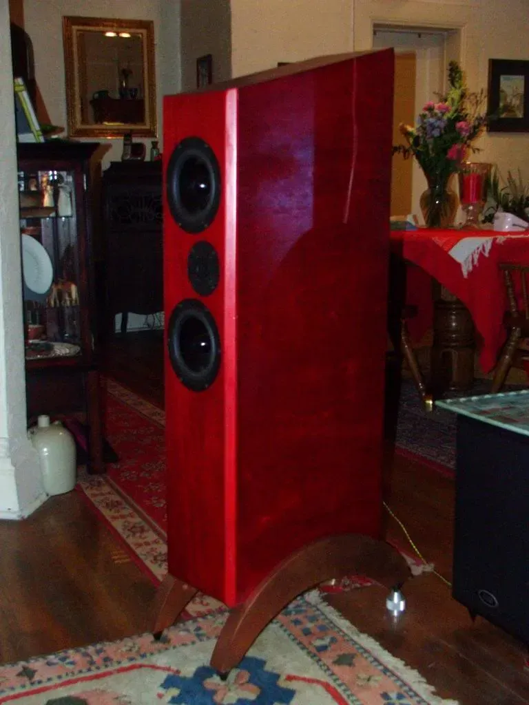

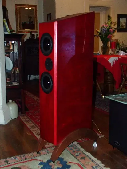

    Definitely a piano black gloss I think would look unreal with them. Though I wouldn't leave out a satin or even a flat black option. But with the colors of the drivers and that fact that you aren't covering them with a grill... stands would look good in black! :T
    This is definitely my favorite design for a stand...looks really good.
      #137
      Thanks for all the compliments and suggestions!

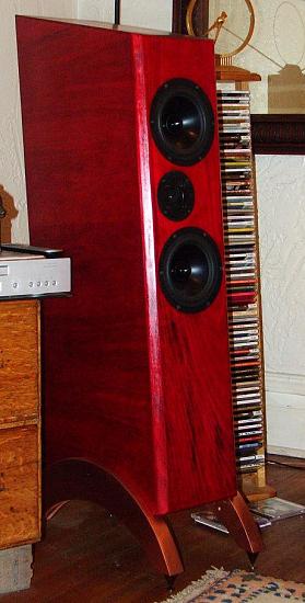

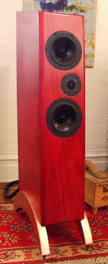

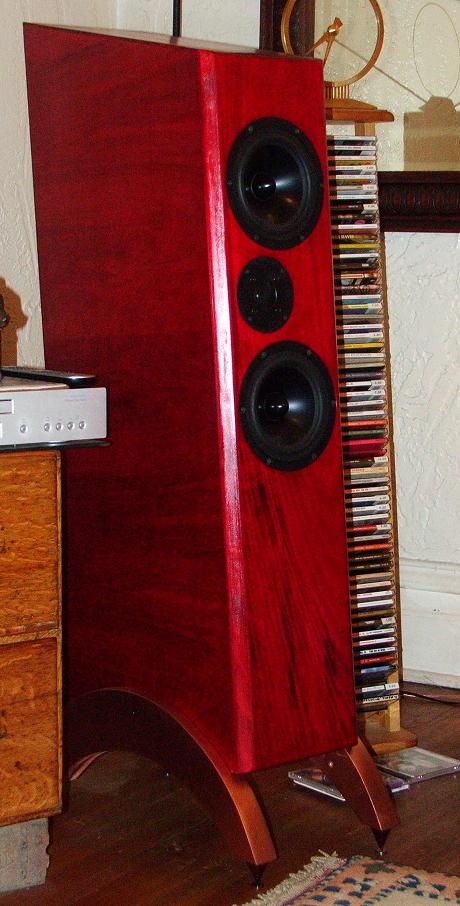

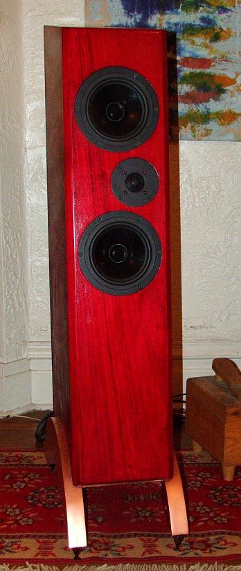

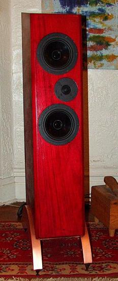

      I was intrigued with the idea of the day-glow green, and initially was considering a bright yellow, actually.
      A few weeks ago I shot them with a metallic copper after a few coats of sanding sealer, some light sanding, a few coats of primmer and some more light sanding. The color seems to bring out and compliment the shade of deep red and blends well with the rest of the room without drawing your attention away from the speakers themselves. All IMHO, of course.
      The pics don’t convey the true contrast and hue, but FWIW.......
      Next I need glue the baffles on! The fit is so tight, I use a leather mallet to get them on and off. But there is some slight leakage during heavy bass at higher SPL, I could feel it on my cheek when I was adjusting the toe while the music was playing. That will most likely improve the SQ and tighten the bass up a bit more, but as it is I am still stunned every time the twins are singing.
      The ‘sock shot’ will be upcoming after the baffles are glued and speakers sealed. BTW, PewterTA, I may need your help for the ‘photo shoot’, and I know my ‘girls’ trust you already!

        I think the copper is a good match. Sharp. And unique. Nice work.

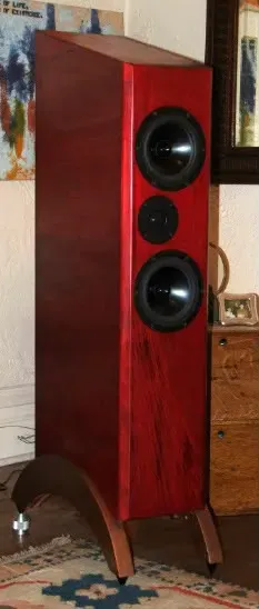

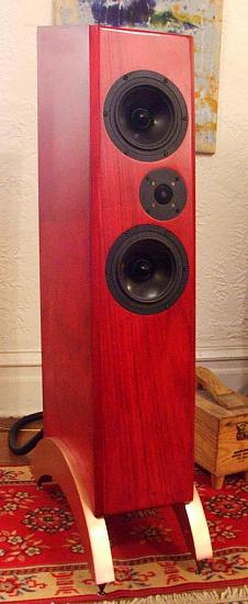

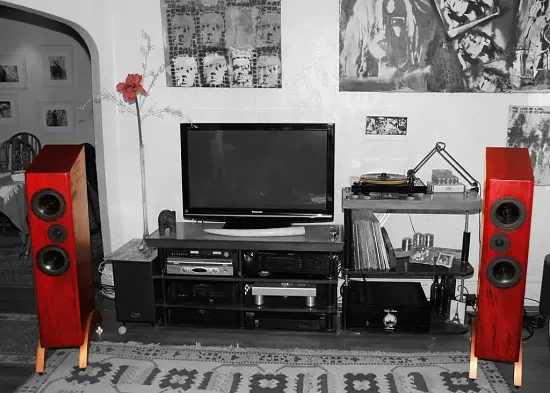

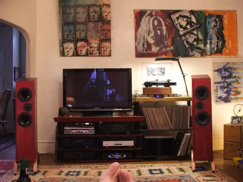

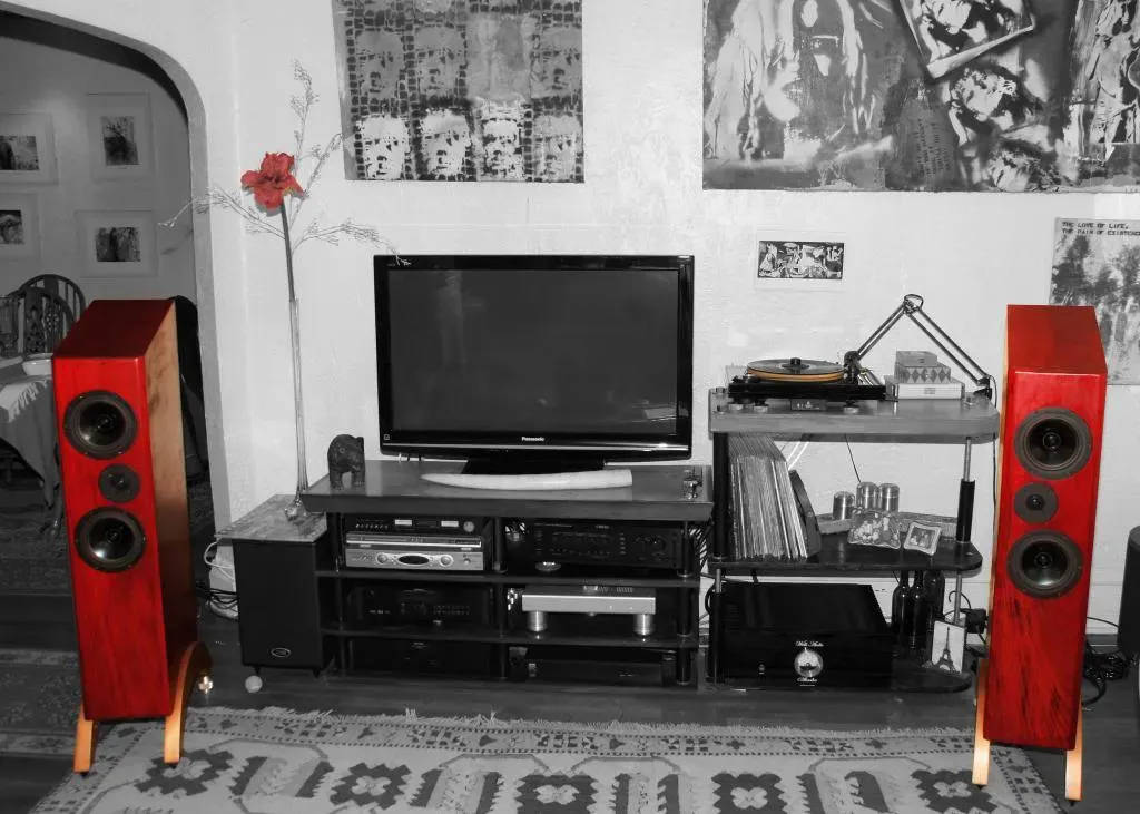

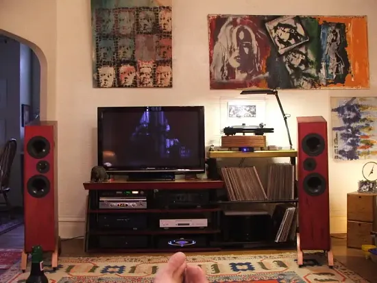

                                          These are probably the smartest thing I ever did concerning my audio trek of many, many years.
                                          Been using these for close to six years.
                                          Yes, there are better, but I get a warm, gratifying feeling every time I sit down & listen to them.
                                          I have heard a lot speakers since I built these. Many in my own system.
                                          They never cease to impress me or anyone else who has ever heard them.

                                            #156
                                            Holy necro thread Batman!
                                            I see that this last photo is the official one since we have a clear foot shot. Nicely done.
                                            And those speakers do sound very nice. Those pictures do not do those justice.

                                                Definitely agree, you can't tell how good they sound from the photos............................................ ...... LOL.
                                                Build quality on these are amazing... good enough that if we were to build anything else Jon Marsh made.... I'd have full trust in Bill being able to make them exactly as needed... of course I'd also help Bill build them, but I'm not too this level...
                                                The last "official" picture is older isn't it... It's missing a sub!

                                                  Originally posted by PewterTA
                                                  ...The last "official" picture is older isn't it... It's missing a sub!
                                                  Judging by the TT, and associated increase in vinyl selections, I'd say the toes are newer... like after he'd realized the sub wasn't doing much! NatP towers are like that...

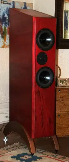

                                                            Got my Speaker and music macbook out, should have the crossover sim update done soon. Another thing I'd recommend is upgrading the resistors, considering the other thing thou plan, Bill- the Mundorf non-inductive from Madisound aren't really all that expensive, and they're now my favorite after trying them out with the Isiris.
                                                              #165
                                                              Originally posted by sdl2112
                                                              ....Your cabinets are beautiful...I may experiment with tinting on my bamboo baffles.
                                                              Firstly, many thanks for the complement - But......
                                                              well.........before you do........
                                                              I initially designed my cabinets with a 15 degree slope on the front baffle - purely for aesthetic function.
                                                              BAD idea.
                                                              Oh, they sounded good, V good.
                                                              & everyone who heard them felt the same.
                                                              In hindsight, I remember a few friends with 'good' ears saying, "they sound good even when I am standing".
                                                              It was months after I had finished the build when late one night when Dan (PewterTA) & I were 'indulging' during one of our sessions........
                                                              I kept saying that after some subsequent equipment upgrades there seemed to still be some lack of detail in the mids.
                                                              In my altered state the epiphany occurred........
                                                              I took some aluminum risers & placed them under the rear feet of the stands.
                                                              As much as I posses no tolerance for one said chief of N.O. origin......the result was not short of BAMMM!!!!!!!
                                                              The angled baffle was severely affecting the time alignment of the top & bottom drivers.
                                                              With the front baffle now perpendicular to the floor everything came into focus, as it were.
                                                              The result was not minor.
                                                              The perceived value of my build was doubled.
                                                              IOW, I do NOT recommend you angle the front baffle unless you are willing to give up the gorgeous sound of which this design is capable of.:W

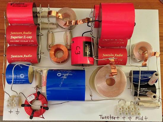

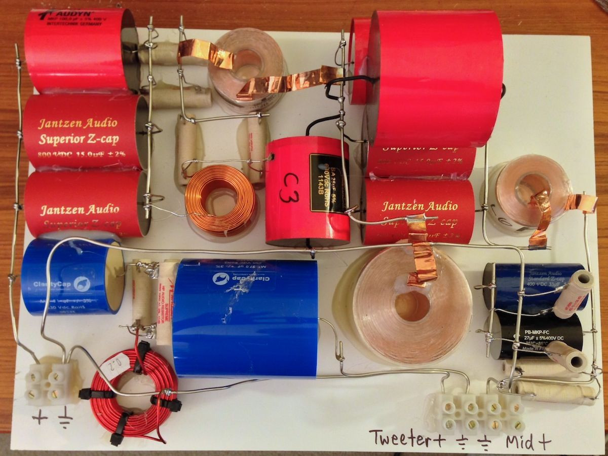

                                                                          Jon, are you talking about the MOX 10 watt resistors or the more expensive M-Resist ones?
                                                                            #172
                                                                            I will let Jon correct me if I am wrong, but I as I understand the M-Resist are the non-inductive resistors he is recommending.
                                                                            From the Madisound website:
                                                                            High quality resistors are hard to find. High power resistors are used in crossover networks to adjust the levels of individual speaker units and they are also used in oscillator circuits and equalisers. Their basic job is to convert surplus or unwanted electrical power into heat. One of the most important specifications of a resistor is thus its power handling capacity, which is expressed in watts.
                                                                            The Mundorf M-Resist Supreme series is specifically designed for high-end loudspeaker and amplifiers applications. With their superior audio quality these 'acoustically no longer perceivable' resistors now match the premium quality standard which distinguishes Mundorf capacitors and conductors!
                                                                            Specifications:
                                                                            •Non-magnetic construction
                                                                            •Virtually inductance-free
                                                                            •Solid core oxygen-free copper with gold
                                                                              • 16205
                                                                              #173
                                                                              Yeah, it's the M-Resit ones...
                                                                              This is one of the early crossover test builds, combining the midrange and tweeter on one board; you can see them littered all over the place.

                                                                              The new crossovers in construction for the Isiris will fit in the enclosures (making GF happy), and will require more boards (two for the mid, one for the tweeter, one for the woofer in each cabinet.)

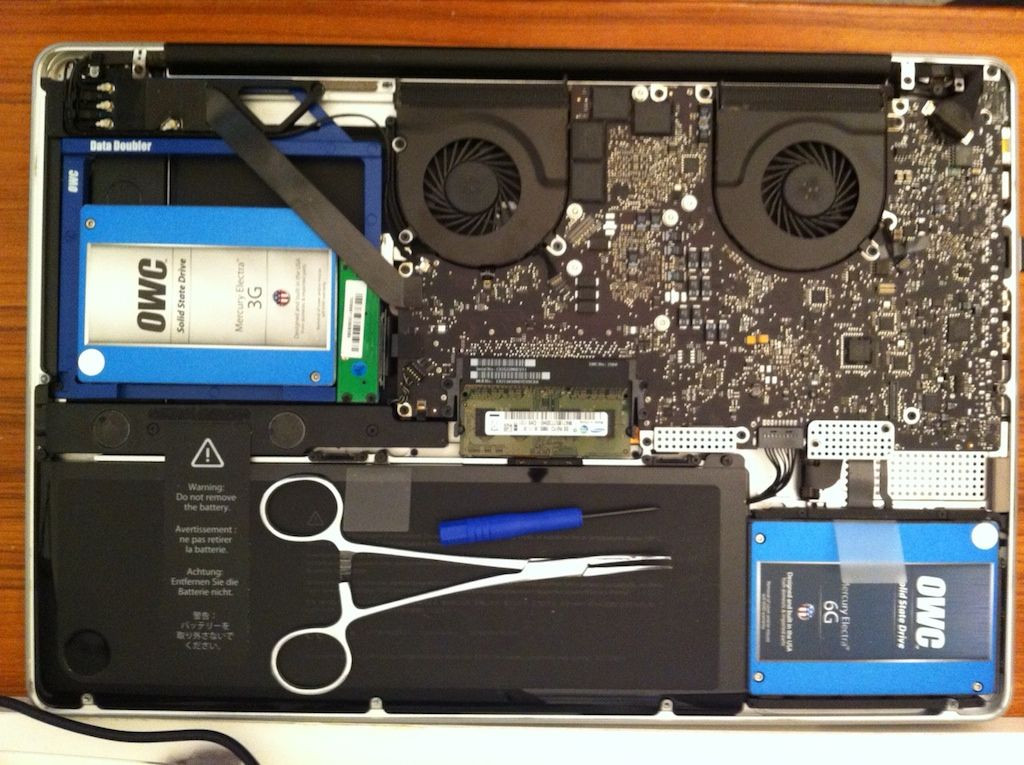

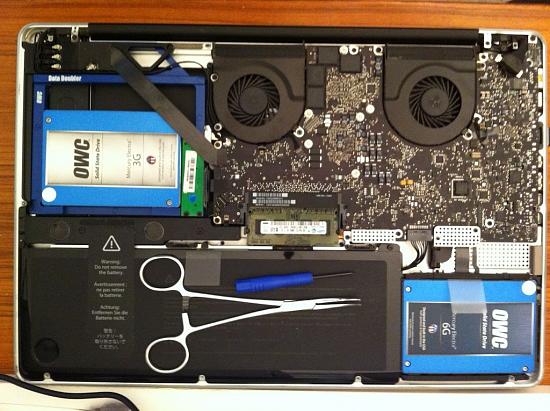

                                                                                    Progress-
                                                                                    all put back together, actually configuring and shuffling data around in new partitions. talk about little itsy bitsy connectors!

                                                                                      #177
                                                                                      Ha!
                                                                                      I will not say thing about the last time someone commented on the hemostats in my tool box!
                                                                                      But mine have a slightly different color on the tips from projects in the far, far past.
                                                                                      These days, I even keep a set of these on the stereo rack for cleaning the stylus on my turntable.

                                                                                          Hee hee, I haven't met a laptop I couldn't take completely apart and put back together... normally with only 1 or 2 screws that were the extra ones they put in there!
                                                                                            • 16205
                                                                                            #180
                                                                                            Yeah, I've always wondered why they put those extra screws in... but now, I understand how Apple makes good margins, there weren't any extra screws in this one!
