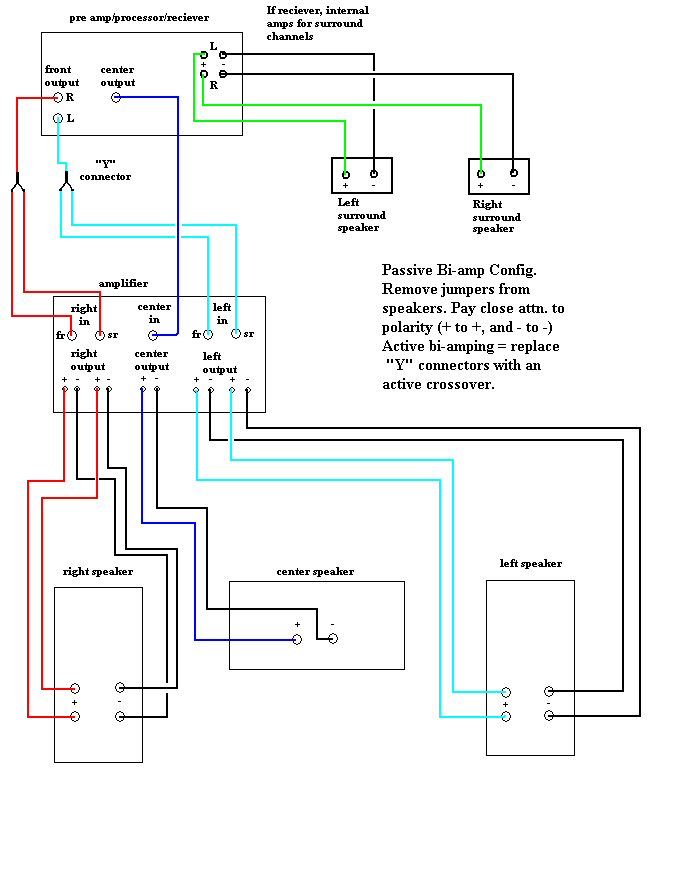

                                                                  Just brought my RMB1075 (silver) home. I haven't even taken it out of the box yet, but :T
                                                                  One more quick, probably foolish, question. I have decided to bi-amp my front speakers with the 1075, and leave the rear speakers on my RSX1055, as was suggested by Andrew & hery. So, I only need 3 interconnects from the RSX1055 to the RMB1075 now, instead of 5, as was listed in Dmantis' post - right?? ops:

                                                                    No, you will need 2 "Y" connectors as well as 5 interconnects. It can get a bit wordy to describe so it may be easiest to do a "biwire illustration" search or find a manual, a picture is worth a thousand words. And congrats on the new amp, they are sweet.........

                                                                      I haven't found much with a search on "biwire illustration" but I am still looking. I have also tried finding info on bi-amping; some of it is rather discouraging, saying that "passive biamping," which I gather is what I am trying to do, really provides no sonic improvements.
                                                                      So you still need to feed the surround channels from the receiver to the amp, even though you are using the amp surround outputs for the mains. But what are the Y cables for - ??
                                                                      • soundhound
                                                                        • Mar 2004
                                                                        • 815
                                                                        You will notice your'e speakers have jumpers between the 2 sets of binding posts on them. These take 1 channel, full frequency, and let the internal passive crossovers in the speakers send lower frequencies to the "woofer", and higher frequencies to the midrange and tweeter respectively. When you bi-wire you will remove the jumpers, have 1 of the 1075 channels drive the woofer, and another channel of the 1075 drive the mid-high frequencies. That is where the "y" connector comes in. You take one channel of the RSX-1055 output, split it with a "Y" connector, and go in to 2 seperate channels of the 1075. Somewhere in the chain the low frequencies need to be seperated from the high frequenciess, as woofers can only respond to low frequency, and tweeters respond to high frequency. Without getting into the science of it better quality speakers are highly "engineered" as far as crossover points, drivers, construction wich all lend them selves to the way the speakers sound. By using passive "bi-wire" you may or may not notice sonic gains. If you want an absolute gain, try an active crossover as I am sure this is what manufacturers had intended when they put dual binding posts on their speakers. I will round up an illustration or 2 of the different options a little later and either post or send to you. By the way, have you tried your'e amp yet? What do ya think?

                                                                          Hey, I think Soundhound's last post is referring to bi-amping not bi-wiring.
                                                                          BiWiring would be running two sets of wire from the same terminals on your amp/receiver.
                                                                          Using the Y adapter like Soundhound mentioned, would be "passive bi-amping"
                                                                          I too have a purchased a set of Y adapters for my 1075, but I haven't had time to make up the needed speaker cables - I am really curious of the outcome.

                                                                            Heya basementjack, your'e assumption is correct about passive bi-amping. Bi -wiring is a complete waste of money, period. I would argue the point with anyone who claims they get sonic benefit from paralleling wires from 1 amp channel to 2 points on a speaker. If they do it is time for money spent on a better speaker cable to begin with.

                                                                                Thank you for your help. Another kind HTGuide member sent me a picture of the set up, so now I finally understand! Splitting the signal for the mains at the pre-amp with the "Y" cable is what I was missing - I was just going to run an interconnect from each of the speaker outputs on the RSX1055 (mains and surrounds) to the RCA inputs on the RMB1075....ops: Obviously, I didn't understand what I was doing. Thanks for your patience!
                                                                                Even though bi-wiring doesn't have any proven benefits, I guess I am going to both bi-wire and bi-amp. Everyone needs cables snaking all over their house, don't they?!?

                                                                                      Here is an illustration for anyone who may need, I also searched and found nothing on the web OakIris
