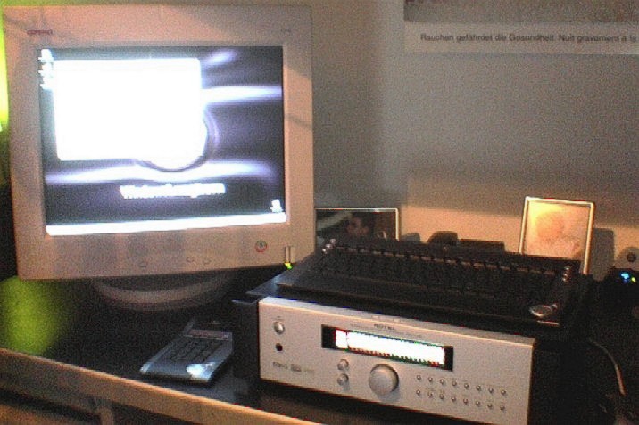

                                            Downloaded and installed the Eprom Update and V1.2.1 to my RSP1068. I used a Dell Inspiron 9100 laptop with a Keyspan USB to serial adapter, WinXP Pro, Flash Up and the new MTTY without a hitch. I have to agree with some of the earlier posts, Rotel could do a much better job of packaging the updates. I am not complaining as I love my Rotel, but compared to others, the Rotel implementation is rough at best, but hey it works.
                                            I had to download the 1098 Eprom Update and extract the Flash Up Files from it because I kept getting an error saying setup could not open the Setup.LST file from the 1068 download. I actually downloaded and unzipped twice just to make sure it was the file. After downloading the 1098 update I checked the file dates and size against the 1068 files and it is the same program, ran the install, then the Rom Update 4, no problems. Next I did the 1.2.1 update, again without problem.
                                            Before doing the update, I wrote down all of my settings, which to be honest is a real pain in the ass. After doing the factory reset per the instructions, I thought the user default settings I saved would be able to be loaded after doing the reset. No go, had to re-input everything. This is one area Rotel can really improve upon. How about a software program to back up your configuration so you can reload it after flashing or dedicating the user default save to non volatile memory, something. Hopefully in the next generation, Rotel will implement these features which I have all but gotten to used to as the norm on other gear I own.
                                            [EDIT 02/25/05] Reverted to 1.1.7. See Firmware Issues Thread for details regarding DD 2.0 issues.

                                                      Installed v1.2.1 on my 1068 last night (comming from v.1.1.7.). Everything worked without any problems 8) .
                                                      Afterwards I did the Eprom update. When finished, the unit stopped responding completely! It didn't even come on when pushing the power switch (front and back) !
                                                      So I installed v.1.2.1 again (the computer was able to connect to the 1068, eventhough the latter showed no sign whatsoever that it was turned on).
                                                      Afterwards everything worked again.
                                                      Bottomline, in my case I guess it did make a difference in which order you update the software and the eprom version:
                                                      First the Eprom update, then the software update...

                                                            Just did the upgrade on the 1068 and now all went well. finally DPLII Game for the xbox and stereo back surround
