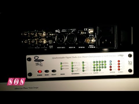

                                                      News on the new Mutec MC-3+.....link
                                                      The latest issue of the highly respected US pro audio magazine Tape Op features an in-depth look at MUTEC's MC-3+ Smart Clock:
                                                      "Two clocks in series? Those nutty audiophiles! ---snip---
                                                      daisychaining two of the clocks together. I’m about to step into audiophile-speak here, but we were able to hear...
                                                      However, audiophiles are a fascinating group who are interested in tiny, incremental improvements in their playback systems. I don’t believe that any single small improvement is really a big deal, but I do believe that enough of those improvements (or the removal of them) can add up to something significant."

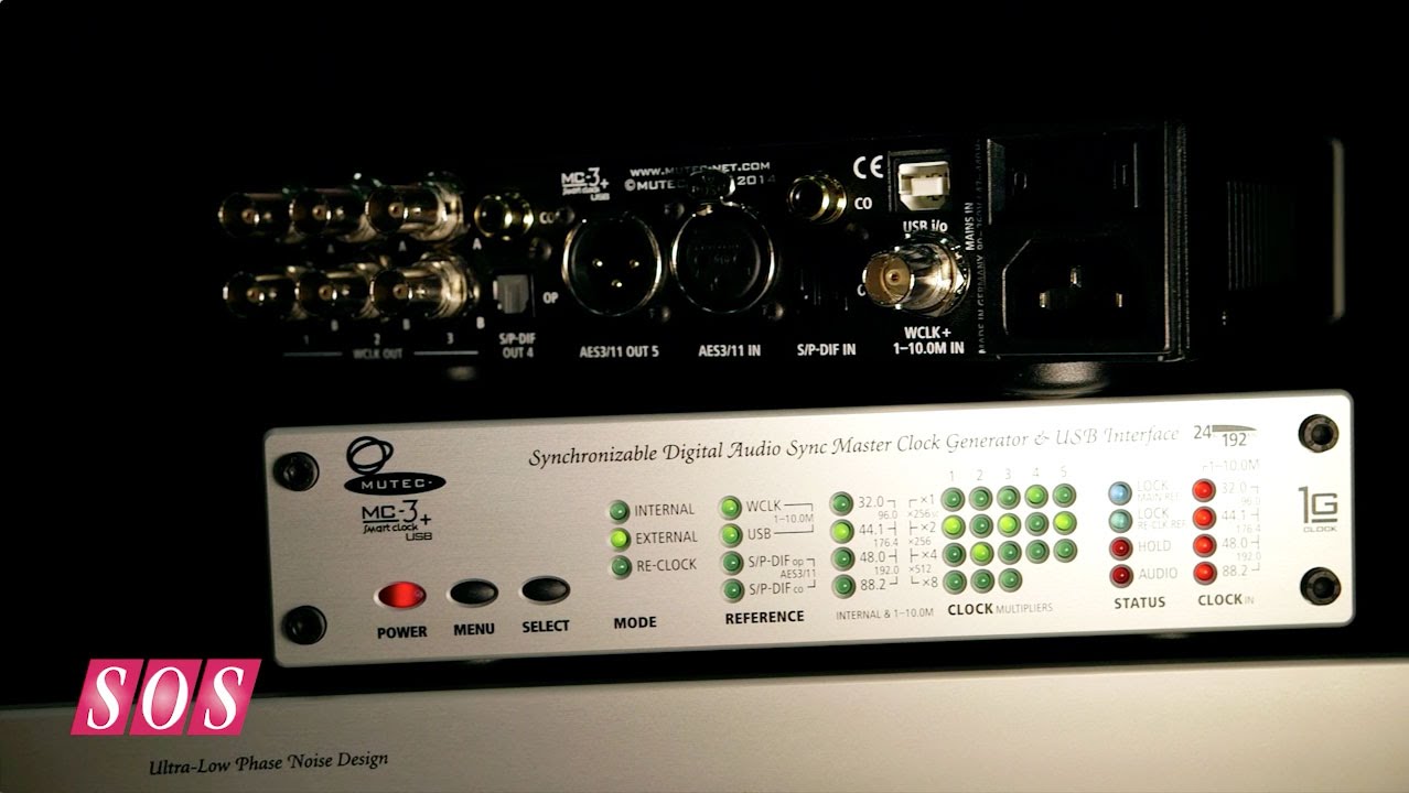

                                                                        I'm going to "run this down by the numbers", and in this case I mean the model numbers.
                                                                        • The black MutecMC3+USB shipped to you today is a Mutec with the a high performance USB interface and the 1G local clocks. - the receiver provides the clock based on the handshaking with the transmission spec, and then gates the signal across at the audio sample rate. This unit can be sync'd externally to a high precision 10MHz Rubidium sine wave oscillator (much cleaner to transmit than a pulse wave version would be) which is divided down as a reference and all the digital circuits are "clocked" by zero crossings (via dividers) of that external low phase noise reference.
                                                                        • The silver front plate image in post #154 above on this page and just below in this post is a similar model NOT with the +USB which has their upgraded local 1GHz oscillator which is very high grade, and yields superior performance compared to the MC3 and MC1, for when you don't have an external 10M sine reference, BUT it supports that, too. It is what we were investigating as an alternative to the DCD8, which in normal stereo mode is "limited" to 88.2 kHz audio sampling rate, and for 196kHz has to be put in a special mono processing mode. In fact, I'd sold my DCD-8 to my colleague in Germany (Arun) so that he could run stereo with the DCD8 and Rubidium oscillators. I was not usually using USB as an audio source, this was prior to Audirvanna developing their exclusive mode audio control, and I was usually using Roon with a specialized computer to render it onto a network, then a signature Rendu or Micro Rendu to go from Ethernet to USB, and USB to AES/EBU via the Berkeley Audio Alpha USB, which was considered to be the best designed and best performing and best isolated USB to AES/EBU device in existence. I have no reason to think still that any one has beaten it. I was looking at this as a DCD8 substitute with stereo capability at higher sampling rates.
                                                                        • The MC3+ WITHOUT +USB typically sells for about $1199, the MC-3+USB about $1649, for example, at Sweetwater pro sound. Below is a link to the one put in shipping this morning- this is the one I should have sent out last Monday, but with everything that had happened on the weekend, I grabbed the "shiny" one instead of the black one.
                                                                        • I have since bought another Brainstorm DCD8 on eBay; that model is superseded, and its successor (DXD-8) is a bit pricey at $3,215 typical resale. Hey, it's all relative, right?
                                                                        • Rubidium oscillators are pricey in general, at normal retail (A Mutec REF10 is $4995) and our (Arun and I) listening evaluations of a variety did not necessarily show a strong correlation between price and audio quality. Believe it or not, we agreed that the LPFRS used we got on eBay many years ago was one of the best sounding regardless of price. Sometimes you get lucky...
                                                                        • Doing this from scratch, I'd go with the Mutec MC3+USB, as it will probably get you 85% of the way there as regards what we found was the "peak subjective performance", and compared with other similar solutions, the price is a relative bargain.
                                                                        • Beverly's pancreatic cancer diagnosis put a lot of stuff on hold in early 2016, where it's remained until retiring and moving here, and old projects are just starting to be addressed again.
                                                                        • Keep in mind, this is all pro studio gear, (including mobile studio) with functionality that is pretty much mandatory in a studio environment with multiple pieces of digital gear that have to work smoothly together. If you just want to keep it simple, with everything in one carefully tuned box, get a Berkeley Alpha DAC Reference Series 3. However, if you want to feed it from USB, you'll still need an Alpha USB isolator. So, going that route, You'll be out $28,000 for the current version of the Reference 3 new, and $2,275 for the Alpha USB. I bought my Alpha DAC Series one and later my Alpha USB at Music Lovers Audio in Berkeley, where oddly enough, Berkeley Audio Designs happens to be located!
                                                                        https://www.sweetwater.com/store/det...b-master-clock
                                                                        You can still get to the link at Sweetwater- their site just doesn't allow a preview.
                                                                        Click image for larger version  Name:	Mujtc 1G.png Views:	0 Size:	1.87 MB ID:	930740
                                                                        The Mutec with MC3+USB is my "bang for the buck" recommendation for most folks interested in optimizing their digital, especially from USB sources. I was using with with my 2nd tier gear back then, the DCD8 with my TotalDAC. (Sign Magnitude R2R ladder DAC, and TotalDAC even offers an input "Digital filter re-clocking unit".
