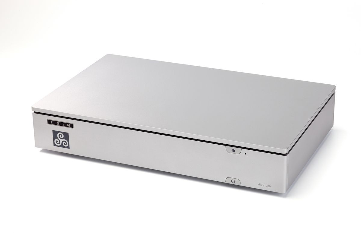

    What else is going to be in this chain? I've been agonizing a bit over the Music server aspect- if budget weren't a consideration, then Aurender would be it! But alas, I live in the real world, or rather, my own little impecunious portion of my unreal world, so....
    My colleague in Munich has a Sonore server. It's hard to argue with the results.
    It uses an internal drive; supplied with 2TB hard disk, my friend has swapped that out for a 500GB SSD. iPhone & iPod app is available; connects via WiFi through the local LAN. And it does sound good. Very good.
    Oh, and it's not unreasonable, $2900 for the version with AES/EBU outputs (USB only is less... and in this case, less isn't more...) (we've compared both). But it needs 19V at 2A power, and their power supply will set you back another cool grand. My friend uses an Li battery stack with chargers and Paul Hynes regulators.

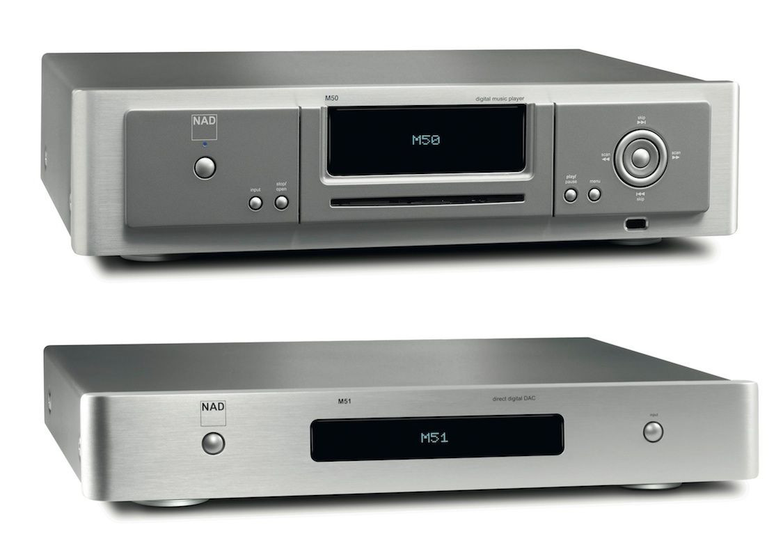

    Being fond of NAD's recent digital products, I've also been intrigued by the M50 music server (shown here with the M51 DAC).
    It has an attractive feature set:
    • plays digital music stored anywhere on your home network or attached USB drivers
    • compatible with FLAC, WAV, AIFF, ALAC, MP3, WMA, OGG Vorbis,
    • Supports sampling rates from 32-192 kHz, 16 or 24 bit
    • Built in disk ripping to FLAC and/or MP3 with internal drive; stick it in, everything else is automatic
    • Music management/control app available fro iPad, iPhone/iPod Touch
    • Re-index command to rebuild data base automatically when new storage is attached or external drives are updated
    • Ethernet port for wired connection
    • Built in WiFi for wireless connections
    • Front and rear panel USB A ports for USB mass storage devices, Linux EXT and FAT32 supported
    • Audio Outputs: HDMI 1.4 (stereo only), AES/EBU, Toslink, and coaxial S/PDIF
    • Includes a remote control for local operation without wireless app
    • Software updatable via USB B port on back panel and ethernet connectivity to internet
    It automatically uses the highest resolution source for any program available on the network. This appeals to me for the ease of use and getting GF comfortable with the system AND for adding her own music to the system.

                                                Speaking of cheaping out, I found the NAD M50 at demo pricing at Audio Advisor, so "pulled the trigger" this AM, as everyone likes to say on the internet... or at least used to like to say?
                                                Today was supposed to be a comp day, and instead I got sucked into a mad scramble over last minute interviews and efforts regarding a potential new hire mainly for HQ, but would be based in our East Coast office- I'll likely be done with that by 2 PM today, but that's been ongoing since 7 AM- not quite a comp day, eh? :W
                                                Other items on the way for the music server side of things, Oyen Digital dual 2.5" raid enclosures, and a set of HGST 7200RPM drives and a set of Samsung 840 EVO drives (plan is that the HD's will e used for CD quality program, the SSD of high res, with faster load times for big files).
                                                From the M50 data sheet you might think that you can only use the M52 drive vault with the back panel USBA connector, but it's always wise to read the owners manual; it tells the real story, and there should be no issue using both the front and rear USB connectors and having 4 TB of local music.
                                                I've already got the iPad app for the M50 loaded on my iPad 4;

                                                                        M50 testing under way...
                                                                        Well, FedEx brought nice things today, and some setup and testing is underway.
                                                                        A lot of potential, but moral of the story is that even if you read owner's manuals carefully, the full details may not be revealed?
                                                                        As near as I can determine, you CAN use either the front panel USB A input or the rear panel USB A input for a drive with data you put on via a computer, the built in ripper only wants to function if there is an M52 digital vault from NAD connected to the rear USB A input- it doesn't seem to recognize a standard drive for that purpose. Also, interestingly, NAD states that the M52 digital vault cannot be read on a Mac or PC. (well, it's probably using a Linux file system, so that's likely only partly true, but you get the gist. In the end, I'd say things could be spelled out more clearly.
                                                                        Also, with my weird blend of music, it has trouble finding album art in a lot of cases.
                                                                        OTOH, the playback appears to be just fine, sounds very good on this quick test setup with my big Shure cans, and the NAD app on the iPad works pretty well. Also did one firmware upgrade without issues. Currently running it wired on Ethernet, haven't setup the WiFi, as I won't be using that here anyway.
                                                                        Promising. I just had a big folder of stuff ripped using XLD, and copied that to the baby mini as a test case. Need to add to it, and ponder if I want the local ripping too- that was the idea to make it easy, but $2k is a steep price for the M51- for that I just may rip off line. Also, it finds outside music on the local network, too. Will have to play with that, though I figure it's likely better off with the local drives.
